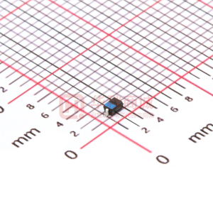

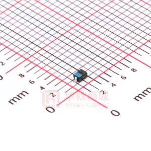

BAR64... Silicon PIN Diode • High voltage current controlled RF resistor for RF attenuator and switches • Frequency range above 1 MHz up to 6 GHz • Very low capacitance at zero volt reverse bias at frequencies above 1 GHz (typ. 0.17 pF) • Low forward resistance (typ. 2.1 Ω @ 10 mA) • Very low signal distortion • Pb-free (RoHS compliant) package 1) • Qualified according AEC Q101 BAR64-02LRH BAR64-02V BAR64-03W BAR64-04 BAR64-04W ! BAR64-05 BAR64-05W ! BAR64-06 BAR64-06W ! BAR64-07 " !  , , , , , , , ,     Type BAR64-02LRH BAR64-02V BAR64-03W BAR64-04 BAR64-04W BAR64-05 BAR64-05W BAR64-06 BAR64-06W BAR64-07 1Pb-containing Package TSLP-2-7 SC79 SOD323 SOT23 SOT323 SOT23 SOT323 SOT23 SOT323 SOT143 Configuration single, leadless single single series series common cathode common cathode common anode common anode parallel pair LS(nH) 0.4 0.6 1.8 1.8 1.4 1.8 1.4 1.8 1.4 2 Marking O O 2 blue PPs PPs PRs PRs PSs PSs PTs package may be available upon special request 1 2007-12-11 BAR64... Maximum Ratings at TA = 25°C, unless otherwise specified Parameter Diode reverse voltage Forward current Total power dissipation BAR64-02LRH, T S ≤ 135 °C BAR64-02V, TS ≤ 125 °C BAR64-03W, BAR64-07, TS ≤ 25 °C BAR64-04, -05, -06, TS ≤ 65 °C BAR64-04W, -05W, -06W, TS ≤ 115 °C Junction temperature Operating temperature range Storage temperature Thermal Resistance Parameter Junction - soldering point1) BAR64-02LRH BAR64-02V, -04W, -05W, -06W BAR64-03W BAR64-04, -05, -06 BAR64-07 Symbol RthJS Symbol VR IF Ptot Value 150 100 250 250 250 250 250 Unit V mA mW Tj Top Tstg 150 -55 ... 125 -55 ... 150 °C Value ≤ 60 ≤ 140 ≤ 370 ≤ 340 ≤ 290 Unit Electrical Characteristics at TA = 25°C, unless otherwise specified Parameter DC Characteristics Breakdown voltage I(BR) = 5 µA Forward voltage IF = 50 mA 1For Symbol min. V(BR) VF 150 - Values typ. max. 1.1 Unit V calculation of RthJA please refer to Application Note Thermal Resistance 2 2007-12-11 BAR64... Electrical Characteristics at TA = 25°C, unless otherwise specified Parameter AC Characteristics Diode capacitance VR = 20 V, f = 1 MHz VR = 0 V, f = 100 MHz VR = 0 V, f = 1...1.8 GHz, BAR64-02LRH VR = 0 V, f = 1...1.8 GHz, all other Reverse parallel resistance VR = 0 V, f = 100 MHz VR = 0 V, f = 1 GHz VR = 0 V, f = 1.8 GHz Forward resistance I F = 1 mA, f = 100 MHz I F = 10 mA, f = 100 MHz I F = 100 mA, f = 100 MHz Charge carrier life time I F = 10 mA, IR = 6 mA, measured at IR = 3 mA, RL = 100 Ω I-region width Insertion loss1) I F = 3 mA, f = 1.8 GHz I F = 5 mA, f = 1.8 GHz I F = 10 mA, f = 1.8 GHz Isolation1) VR = 0 V, f = 0.9 GHz VR = 0 V, f = 1.8 GHz VR = 0 V, f = 2.45 GHz VR = 0 V, f = 5.6 GHz 1BAR64-02LRH Symbol min. CT RP rf τ rr Values typ. max. Unit pF 0.23 0.3 0.13 0.17 10 4 3 12.5 2.1 0.85 1550 0.35 kΩ Ω 20 2.8 1.35 ns - WI IL - 50 0.32 0.23 0.16 22 17 14.5 8.5 - µm dB ISO - in series configuration, Z = 50 Ω 3 2007-12-11 BAR64... Diode capacitance CT = ƒ (VR) f = Parameter 0.7 Reverse parallel resistance RP = ƒ(V R) f = Parameter 10 4 KOhm pF 10 3 100 MHz 1 GHz 1.8 GHz CT Rp 1 MHz 100 MHz 1 GHz 1.8 GHz V 0.5 10 2 0.4 10 1 0.3 10 0 0.2 0.1 0 2 4 6 8 10 12 14 16 20 10 -1 0 5 10 15 20 25 30 V 40 VR VR Forward resistance rf = ƒ (I F) f = 100MHz 10 3 Ohm Forward current IF = ƒ (VF) TA = Parameter 10 0 A 10 -1 10 2 RF 10 -2 10 1 IF 10 -3 10 -4 10 0 10 -5 -40 °C 25 °C 85 °C 125 °C 10 -1 -2 10 10 -1 10 0 10 1 mA 10 2 10 -6 0 0.2 0.4 0.6 0.8 V 1.2 IF VF 4 2007-12-11 BAR64... Intermodulation intercept point IP3 = ƒ (IF); f = Parameter 10 2 Forward current IF = ƒ (T S) BAR64-02LRH 120 mA f=900MHz f=1800MHz IP 3 IF dBm 100 90 80 70 60 50 40 30 20 10 10 1 10 -1 10 0 mA 10 1 0 0 30 60 90 120 °C 165 IF TS Forward current IF = ƒ (T S) BAR64-02V 120 mA Forward current IF = ƒ (T S) BAR64-04, BAR64-05, BAR64-06 120 mA 100 90 80 100 90 80 IF 70 60 50 40 30 20 10 0 0 15 30 45 60 75 90 105 120 °C 150 IF 70 60 50 40 30 20 10 0 0 15 30 45 60 75 90 105 120 °C 150 TS TS 5 2007-12-11 BAR64... Forward current IF = ƒ (T S) BAR64-04W, BAR64-05W, BAR64-06W 120 mA 100 90 80 IF 70 60 50 40 30 20 10 0 0 15 30 45 60 75 90 105 120 °C 150 TS Permissible Puls Load RthJS = ƒ (tp) BAR64-02LRH 10 2 Permissible Pulse Load IFmax / I FDC = ƒ (t p) BAR64-02LRH 10 2 K/W 10 1 IFmax/IFDC - RthJS 10 1 10 0 0.5 0.2 0.1 0.05 0.02 0.01 0.005 D=0 10 -5 D=0 0.005 0.01 0.02 0.05 0.1 0.2 0.5 10 -1 -6 10 10 -4 10 -3 10 -2 s 10 0 10 0 -6 10 10 -5 10 -4 10 -3 10 -2 s 10 0 tp tp 6 2007-12-11 BAR64... Permissible Puls Load RthJS = ƒ (tp) BAR64-02V 10 K/W 3 Permissible Pulse Load IFmax / I FDC = ƒ (t p) BAR64-02V 10 2 I Fmax / I FDC 10 2 - 10 1 10 1 10 0 0.5 0.2 0.1 0.05 0.02 0.01 0.005 D=0 D=0 0.005 0.01 0.02 0.05 0.1 0.2 0.5 RthJS 10 -1 -6 10 10 -5 10 -4 10 -3 10 -2 s 10 0 10 0 -6 10 10 -5 10 -4 10 -3 10 -2 10 -1 s 10 1 tp tp Permissible Puls Load RthJS = ƒ (tp) BAR64-04, BAR64-05, BAR64-06 10 3 K/W Permissible Pulse Load IFmax / I FDC = ƒ (t p) BAR64-04, BAR64-05, BAR64-06 10 2 10 2 IFmax/IFDC - 10 1 10 0 0.5 0.2 0.1 0.05 0.02 0.01 0.005 D=0 10 1 D=0 0.005 0.01 0.02 0.05 0.1 0.2 0.5 RthJS 10 -1 -6 10 10 -5 10 -4 10 -3 10 -2 s 10 0 10 0 -6 10 10 -5 10 -4 10 -3 10 -2 s 10 0 tP tP 7 2007-12-11 BAR64... Permissible Puls Load RthJS = ƒ (tp) BAR64-04W, BAR64-05W, BAR64-06W 10 K/W 3 Permissible Pulse Load IFmax / I FDC = ƒ (t p) BAR64-04W, BAR64-05W, BAR64-06W 10 2 I Fmax/IFDC 10 2 - 10 1 10 1 10 0 0.5 0.2 0.1 0.05 0.02 0.01 0.005 D=0 D=0 0.005 0.01 0.02 0.05 0.1 0.2 0.5 R thJS 10 -1 -6 10 10 -5 10 -4 10 -3 10 -2 s 10 0 10 0 -6 10 10 -5 10 -4 10 -3 10 -2 10 -1 s 10 1 tP tP Insertion loss IL = -|S21|2 = ƒ(f) IF = Parameter BAR64-02LRH in series configuration, Z = 50Ω 0 dB 100 mA Isolation ISO = -|S21| 2 = ƒ(f) VR = Parameter BAR64-02LRH in series configuration, Z = 50Ω 0 dB -0.1 |S21|2 |S21|2 -0.15 10 mA -10 -0.2 5 mA -15 -0.25 -20 -0.3 3 mA -25 -0.35 0V 1V 10 V 1.5 2.5 3.5 4.5 GHz -0.4 0 1 2 3 4 GHz 6 -30 0.5 6.5 f f 8 2007-12-11 Package SC79 BAR64... Package Outline 0.2 0.8 ±0.1 10˚MAX. M A 0.13 -0.03 +0.05 2 1.6 ±0.1 0.55 ±0.04 Foot Print 1.35 0.35 Marking Layout (Example) 2005, June Date code 0.35 BAR63-02V Type code Cathode marking Laser marking Standard Packing Reel ø180 mm = 3.000 Pieces/Reel Reel ø180 mm = 8.000 Pieces/Reel (2 mm Pitch) Reel ø330 mm = 10.000 Pieces/Reel Standard 4 Reel with 2 mm Pitch 2 0.2 1.33 1.96 Cathode marking 0.4 0.93 8 0.2 ±0.05 0.66 Cathode marking 1 0.3 ±0.05 Cathode marking 10˚MAX. 1.2 ±0.1 A 9 2007-12-11 BAR64... Date Code marking for discrete packages with one digit (SCD80, SC79, SC75 1) ) CES-Code M onth 2 0 03 01 02 03 04 05 06 07 08 09 10 11 12 a b c d e f g h j k l n 2 0 04 p q r s t u v x y z 2 3 2005 A B C D E F G H J K L N 2006 P Q R S T U V X Y Z 4 5 2 0 07 a b c d e f g h j k l n 2008 p q r s t u v x y z 2 3 2009 A B C D E F G H J K L N 2010 P Q R S T U V X Y Z 4 5 2011 a b c d e f g h j k l n 2012 p q r s t u v x y z 2 3 2 0 13 A B C D E F G H J K L N 2014 P Q R S T U V X Y Z 4 5 1 ) New Marking Layout for SC75, implemented at October 2005. . 10 2007-12-11 Package SOD323 BAR64... Package Outline 0.9 +0.2 -0.1 +0.2 1.25 -0.1 0 ±0.05 A 1.7 +0.2 -0.1 +0.05 0.3 -0.2 2 Cathode marking 1 0.3 +0.1 -0.05 0.25 M A 0.45 ±0.15 2.5 ±0.2 0.15 +0.1 -0.06 Foot Print 0.6 Marking Layout (Example) 0.8 1.7 0.8 BAR63-03W Type code Cathode marking Laser marking Standard Packing Reel ø180 mm = 3.000 Pieces/Reel Reel ø330 mm = 10.000 Pieces/Reel 4 0.2 2 2.9 8 Cathode marking 0.65 1.35 1 11 2007-12-11 Package SOT143 BAR64... Package Outline 0.15 MIN. 2.9 ±0.1 1.9 4 3 B 1 ±0.1 0.1 MAX. 1.3 ±0.1 2.4 ±0.15 10˚ MAX. 1 2 10˚ MAX. 0.2 0.8 +0.1 -0.05 0.4 +0.1 -0.05 1.7 0.25 M B 0.08...0.1 A 5 0...8˚ 0.2 M A Foot Print 0.8 1.2 0.8 0.9 1.2 0.8 0.8 Marking Layout (Example) Manufacturer RF s Pin 1 56 Standard Packing Reel ø180 mm = 3.000 Pieces/Reel Reel ø330 mm = 10.000 Pieces/Reel 0.9 1.1 2005, June Date code (YM) BFP181 Type code 4 0.2 Pin 1 3.15 2.6 8 1.15 12 2007-12-11 Package SOT23 BAR64... Package Outline 0.15 MIN. 1 ±0.1 0.1 MAX. 1.3 ±0.1 2.9 ±0.1 3 B 2.4 ±0.15 10˚ MAX. 0.4 +0.1 -0.05 1) 1 2 10˚ MAX. C 0.95 1.9 0.08...0.1 A 5 0...8˚ 0.25 M B C 0.2 M A 1) Lead width can be 0.6 max. in dambar area Foot Print 0.8 0.9 0.8 1.2 Marking Layout (Example) Manufacturer EH s Pin 1 0.9 1.3 2005, June Date code (YM) BCW66 Type code Standard Packing Reel ø180 mm = 3.000 Pieces/Reel Reel ø330 mm = 10.000 Pieces/Reel 4 0.9 2.13 2.65 0.2 8 Pin 1 3.15 1.15 13 2007-12-11 Package SOT323 BAR64... Package Outline 2 ±0.2 0.3 +0.1 -0.05 3 1.25 ±0.1 2.1 ±0.1 0.9 ±0.1 3x 0.1 M 0.1 MAX. 0.1 A 1 0.65 0.65 2 0.1 MIN. 0.15 +0.1 -0.05 0.2 M A Foot Print 0.6 0.8 0.65 0.65 Marking Layout (Example) Manufacturer 1.6 2005, June Date code (YM) Pin 1 BCR108W Type code Standard Packing Reel ø180 mm = 3.000 Pieces/Reel Reel ø330 mm = 10.000 Pieces/Reel 4 0.2 Pin 1 2.15 2.3 8 1.1 14 2007-12-11 Package TSLP-2-7 BAR64... Package Outline Top view 0.39 +0.01 -0.03 0.05 MAX. 0.65 ±0.05 Bottom view 0.6 ±0.05 2 2 1 1 Cathode marking 0.5 ±0.035 1) 1) Dimension applies to plated terminal Foot Print For board assembly information please refer to Infineon website "Packages" 0.35 0.45 0.3 0.925 1 0.275 0.275 0.375 0.6 Copper Solder mask 0.35 Stencil apertures Marking Layout (Example) BAR90-02LRH Type code Cathode marking Laser marking Standard Packing Reel ø180 mm = 15.000 Pieces/Reel Reel ø330 mm = 50.000 Pieces/Reel (optional) 4 1.16 0.5 Cathode marking 0.76 8 0.25 ±0.035 1) 1±0.05 15 2007-12-11 BAR64... Edition 2006-02-01 Published by Infineon Technologies AG 81726 München, Germany © Infineon Technologies AG 2007. All Rights Reserved. Attention please! The information given in this dokument shall in no event be regarded as a guarantee of conditions or characteristics (“Beschaffenheitsgarantie”). With respect to any examples or hints given herein, any typical values stated herein and/or any information regarding the application of the device, Infineon Technologies hereby disclaims any and all warranties and liabilities of any kind, including without limitation warranties of non-infringement of intellectual property rights of any third party. Information For further information on technology, delivery terms and conditions and prices please contact your nearest Infineon Technologies Office (www.infineon.com ). Warnings Due to technical requirements components may contain dangerous substances. For information on the types in question please contact your nearest Infineon Technologies Office. Infineon Technologies Components may only be used in life-support devices or systems with the express written approval of Infineon Technologies, if a failure of such components can reasonably be expected to cause the failure of that life-support device or system, or to affect the safety or effectiveness of that device or system. Life support devices or systems are intended to be implanted in the human body, or to support and/or maintain and sustain and/or protect human life. If they fail, it is reasonable to assume that the health of the user or other persons may be endangered. 16 2007-12-11
