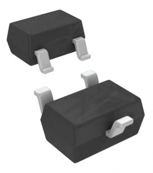

BAT17... Silicon Schottky Diode • For mixer applications in VHF/UHF range • For high-speed switching application • Pb-free (RoHS compliant) package 1) • Qualified according AEC Q101 BAT17 ! BAT17-04 BAT17-04W ! BAT17-05 BAT17-05W ! BAT17-06W ! BAT17-07 " ! , , , , , , , ,      ESD (Electrostatic discharge) sensitive device, observe handling precaution! Type BAT17 BAT17-04 BAT17-04W BAT17-05 BAT17-05W BAT17-06W BAT17-07 1Pb-containing Package SOT23 SOT23 SOT323 SOT23 SOT323 SOT323 SOT143 Configuration single series series common cathode common cathode common anode parallel pair LS(nH) 1.8 1.8 1.4 1.8 1.4 1.4 2 Marking 53s 54s 54s 55s 55s 56s 57s package may be available upon special request 1 2007-04-19 BAT17... Maximum Ratings at TA = 25°C, unless otherwise specified Parameter Diode reverse voltage Forward current Total power dissipation BAT17, TS ≤ 77°C BAT17-04, TS ≤ 61°C BAT17-05, TS ≤ 46°C BAT17-04W, -05W, -6W, T S ≤ 92 °C BAT17-07, TS ≤ 60 °C Junction temperature Operating temperature range Storage temperature Thermal Resistance Parameter Junction - soldering point 1) BAT17 BAT17-04, BAT17-07 BAT17-05 BAT17-04W, BAT17-05W, BAT17-06W 1For Symbol VR IF Ptot Value 4 130 150 150 150 150 150 Unit V mA mW Tj T op T stg 150 -55 ... 125 -55 ... 150 °C Symbol RthJS Value ≤ 490 ≤ 590 ≤ 690 ≤ 390 Unit K/W calculation of RthJA please refer to Application Note Thermal Resistance 2 2007-04-19 BAT17... Electrical Characteristics at TA = 25°C, unless otherwise specified Parameter DC Characteristics Breakdown voltage I(BR) = 10 µA Reverse current VR = 3 V VR = 4 V VR = 3 V, TA = 60 °C Forward voltage IF = 0.1 mA IF = 1 mA IF = 10 mA Forward voltage matching1) IF = 1 mA ∆ VF VF 200 250 350 275 340 425 350 450 600 20 IR 0.25 10 1.25 mV µA V(BR) 4 V Symbol min. Values typ. max. Unit AC Characteristics Diode capacitance VR = 0 , f = 1 MHz Differential forward resistance I F = 5 mA, f = 10 kHz 1∆V CT RF 0.4 - 0.55 8 0.75 15 pF Ω F is the difference between lowest and highest V F in multiple diode component. 3 2007-04-19 BAT17... Diode capacitance CT = ƒ (VR) f = 1MHz Forward resistance rf = ƒ (I F) f = 10kHz 10 3 rf pF EHD07109 0.6 Ω CT 10 2 0.4 0.3 10 1 0.2 0.1 0 0.5 1 1.5 2 2.5 3 3.5 4 V 5 10 0 10 -1 10 0 10 1 mA 10 2 VR ΙF Reverse current IR = ƒ(VR) TA = Parameter 10 2 EHD07107 Forward current IF = ƒ (VF) TA = Parameter 10 2 EHD07106 Ι R µA 10 1 TA =150 ˚C ΙF mA 10 1 TA = -40 ˚C 25 ˚C 85 ˚C 150 ˚C 10 0 85 ˚C 10 0 10 -1 10 -1 10 -2 25 ˚C 10 -3 0.0 1.0 2.0 3.0 V VR 4.0 10 -2 0.0 0.1 0.2 0.3 0.4 0.5 V 0.6 VF 4 2007-04-19 BAT17... Forward current IF = ƒ (T S) BAT17 Forward current IF = ƒ (T S) BAT17-04, BAT17-07 140 mA 140 mA 100 100 IF 80 IF 80 60 60 40 40 20 20 0 0 90 105 120 °C 0 0 15 30 45 60 75 150 15 30 45 60 75 90 105 120 °C 150 TS TS Forward current IF = ƒ (T S) BAT17-05 140 mA 100 IF 80 60 40 20 0 0 15 30 45 60 75 90 105 120 °C 150 TS 5 2007-04-19 Package SOT143 BAT17... Package Outline 0.15 MIN. 2.9 ±0.1 1.9 4 3 B 1 ±0.1 0.1 MAX. 1.3 ±0.1 2.4 ±0.15 10˚ MAX. 1 2 10˚ MAX. 0.2 0.8 +0.1 -0.05 0.4 +0.1 -0.05 1.7 0.25 M B 0.08...0.1 A 5 0...8˚ 0.2 M A Foot Print 0.8 1.2 0.8 0.9 1.2 0.8 0.8 Marking Layout (Example) Manufacturer RF s Pin 1 56 Standard Packing Reel ø180 mm = 3.000 Pieces/Reel Reel ø330 mm = 10.000 Pieces/Reel 0.9 1.1 2005, June Date code (YM) BFP181 Type code 4 0.2 Pin 1 3.15 2.6 8 1.15 6 2007-04-19 Package SOT23 BAT17... Package Outline 0.15 MIN. 1 ±0.1 0.1 MAX. 1.3 ±0.1 2.9 ±0.1 3 B 2.4 ±0.15 10˚ MAX. 0.4 +0.1 -0.05 1) 1 2 10˚ MAX. C 0.95 1.9 0.08...0.1 A 5 0...8˚ 0.25 M B C 0.2 M A 1) Lead width can be 0.6 max. in dambar area Foot Print 0.8 0.9 0.8 1.2 Marking Layout (Example) Manufacturer EH s Pin 1 0.9 1.3 2005, June Date code (YM) BCW66 Type code Standard Packing Reel ø180 mm = 3.000 Pieces/Reel Reel ø330 mm = 10.000 Pieces/Reel 4 0.9 2.13 2.65 0.2 8 Pin 1 3.15 1.15 7 2007-04-19 Package SOT323 BAT17... Package Outline 2 ±0.2 0.3 +0.1 -0.05 3 1.25 ±0.1 2.1 ±0.1 0.9 ±0.1 3x 0.1 M 0.1 MAX. 0.1 A 1 0.65 0.65 2 0.1 MIN. 0.15 +0.1 -0.05 0.2 M A Foot Print 0.6 0.8 0.65 0.65 Marking Layout (Example) Manufacturer 1.6 2005, June Date code (YM) Pin 1 BCR108W Type code Standard Packing Reel ø180 mm = 3.000 Pieces/Reel Reel ø330 mm = 10.000 Pieces/Reel 4 0.2 Pin 1 2.15 2.3 8 1.1 8 2007-04-19 BAT17... Edition 2006-02-01 Published by Infineon Technologies AG 81726 München, Germany © Infineon Technologies AG 2007. All Rights Reserved. Attention please! The information given in this dokument shall in no event be regarded as a guarantee of conditions or characteristics (“Beschaffenheitsgarantie”). With respect to any examples or hints given herein, any typical values stated herein and/or any information regarding the application of the device, Infineon Technologies hereby disclaims any and all warranties and liabilities of any kind, including without limitation warranties of non-infringement of intellectual property rights of any third party. Information For further information on technology, delivery terms and conditions and prices please contact your nearest Infineon Technologies Office ( www.infineon.com ). Warnings Due to technical requirements components may contain dangerous substances. For information on the types in question please contact your nearest Infineon Technologies Office. Infineon Technologies Components may only be used in life-support devices or systems with the express written approval of Infineon Technologies, if a failure of such components can reasonably be expected to cause the failure of that life-support device or system, or to affect the safety or effectiveness of that device or system. Life support devices or systems are intended to be implanted in the human body, or to support and/or maintain and sustain and/or protect human life. If they fail, it is reasonable to assume that the health of the user or other persons may be endangered. 9 2007-04-19

### 物料型号 - BAT17 - BAT17-04 - BAT17-04W - BAT17-05 - BAT17-05W - BAT17-06W - BAT17-07
### 器件简介 BAT17系列是硅肖特基二极管,适用于VHF/UHF范围的混频器应用、高速开关应用,并且符合RoHS标准,通过AEC Q101认证。
### 引脚分配 | 类型 | 封装 | 配置 | Ls(nH) | 标记 | |-----------|--------|--------|---------|------| | BAT17 | SOT23 | 单极 | 1.8 | 53s | | BAT17-04 | SOT23 | 串联 | 1.8 | 54s | | BAT17-04W | SOT323 | 串联 | 1.4 | 54s | | BAT17-05 | SOT23 | 共阴极 | 1.8 | 55s | | BAT17-05W | SOT323 | 共阴极 | 1.4 | 55s | | BAT17-06W | SOT323 | 共阳极 | 1.4 | 56s | | BAT17-07 | SOT143 | 并联对 | 2 | 57s |
### 参数特性 - 最大额定值(Ta=25°C): - 二极管反向电压(VR):4V - 正向电流(IF):130mA - 总功率耗散(Ptot):150mW(不同型号有不同的工作温度限制)
- 结温(Tj):150°C - 工作温度范围(Top):-55...125°C - 存储温度(Tstg):-55...150°C
- 热阻(RthJS): - BAT17:≤490 K/W - BAT17-04, BAT17-07:≤590 K/W - BAT17-05:≤690 K/W - BAT17-04W, BAT17-05W, BAT17-06W:≤390 K/W
### 功能详解 - 该系列二极管具有低正向电压降、快速开关特性,适用于高频应用。
### 应用信息 - 适用于混频器应用、高速开关应用。
### 封装信息 - SOT23、SOT323和SOT143封装,具体尺寸和标记布局图在文档中有详细描述。
