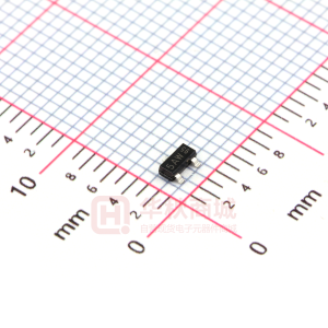

BC807, BC808 PNP Silicon AF Transistors For general AF applications High collector current High current gain Low collector-emitter saturation voltage Comlementary types: BC817, BC818 (NPN) 3      2 1 VPS05161 Type BC807-16 BC807-25 BC807-40 BC808-16 BC808-25 BC808-40 Maximum Ratings Parameter Marking 5As 5Bs 5Cs 5Es 5Fs 5Gs 1=B 1=B 1=B 1=B 1=B 1=B Pin Configuration 2=E 2=E 2=E 2=E 2=E 2=E 3=C 3=C 3=C 3=C 3=C 3=C Package SOT23 SOT23 SOT23 SOT23 SOT23 SOT23 Symbol VCEO VCBO VEBO BC807 45 50 5 500 1 100 200 330 150 BC808 25 30 5 Unit V Collector-emitter voltage Collector-base voltage Emitter-base voltage DC collector current Peak collector current Base current Peak base current Total power dissipation, TS = 79 °C Junction temperature Storage temperature IC ICM IB IBM Ptot Tj Tstg mA A mA mW °C -65 ... 150 Thermal Resistance Junction - soldering point 1) RthJS 215 K/W 1For calculation of R thJA please refer to Application Note Thermal Resistance 1 Nov-29-2001 BC807, BC808 Electrical Characteristics at TA = 25°C, unless otherwise specified. Parameter DC Characteristics Collector-emitter breakdown voltage IC = 10 mA, IB = 0 Collector-base breakdown voltage IC = 10 µA, IE = 0 Emitter-base breakdown voltage IE = 10 µA, IC = 0 Collector cutoff current VCB = 25 V, IE = 0 Collector cutoff current VCB = 25 V, IE = 0 , TA = 150 °C Emitter cutoff current VEB = 4 V, IC = 0 DC current gain 1) IC = 100 mA, VCE = 1 V h FE-grp. 16 h FE-grp. 25 h FE-grp. 40 DC current gain 1) IC = 500 mA, VCE = 1 V Collector-emitter saturation voltage1) IC = 500 mA, IB = 50 mA Base-emitter saturation voltage 1) IC = 500 mA, IB = 50 mA VBEsat VCEsat hFE hFE IEBO ICBO ICBO V(BR)CEO Symbol min. Values typ. max. Unit V 45 25 100 50 100 nA µA nA 100 160 250 40 160 250 350 250 400 630 0.7 1.2 V BC807 BC808 V(BR)CBO BC807 BC808 V(BR)EBO 50 30 5 - 1) Pulse test: t ≤ 300µs, D = 2% 2 Nov-29-2001 BC807, BC808 Electrical Characteristics at TA = 25°C, unless otherwise specified. Parameter AC Characteristics Transition frequency IC = 50 mA, VCE = 5 V, f = 100 MHz Collector-base capacitance VCB = 10 V, f = 1 MHz Emitter-base capacitance VEB = 0.5 V, f = 1 MHz Ceb 60 Ccb 10 pF fT 200 MHz Symbol min. Values typ. max. Unit 3 Nov-29-2001 BC807, BC808 Total power dissipation Ptot = f(TS) Transition frequency fT = f (IC) VCE = 5V 10 3 fT MHz 5 EHP00210 360 mW 300 270 P tot 240 210 180 150 120 90 60 30 0 0 15 30 45 60 75 90 105 120 10 2 5 °C 150 TS 10 1 10 0 10 1 10 2 mA 10 3 ΙC Permissible pulse load Ptotmax / PtotDC = f (tp ) 10 3 Ptot max Ptot DC tp D= T tp T EHP00212 Collector cutoff current ICBO = f(TA) VCBO = 25V 10 5 EHP00213 Ι CBO nA 10 4 10 2 5 10 1 5 D= 0 0.005 0.01 0.02 0.05 0.1 0.2 0.5 10 3 max 10 2 typ 10 1 10 0 10 -6 10 -5 10 -4 10 -3 10 -2 s tp 10 0 10 0 0 50 100 ˚C TA 150 4 Nov-29-2001 BC807, BC808 Base-emitter saturation voltage IC = f(VBEsat ), hFE = 10 10 3 EHP00214 Collector-emitter saturation voltage IC = f (VCEsat), h FE = 10 10 3 EHP00215 ΙC mA 150 ˚C 25 ˚C -50 ˚C ΙC mA 150 ˚C 25 ˚C -50 ˚C 10 2 5 10 2 5 10 1 5 10 1 5 10 0 5 10 0 5 10 -1 0 1.0 2.0 3.0 V 4.0 10 -1 0 0.2 0.4 0.6 V 0.8 V BEsat V CEsat DC current gain hFE = f(IC) VCE = 1V 10 3 h FE 5 100 ˚C 25 ˚C -50 ˚C 10 5 2 EHP00216 10 1 5 10 0 10 -1 10 0 10 1 10 2 mA 10 3 ΙC 5 Nov-29-2001
BC807-16
### 物料型号 - BC807-16(5As) - BC807-25(5Bs) - BC807-40(5Cs) - BC808-16(5Es) - BC808-25(5Fs) - BC808-40(5Gs)
### 器件简介 BC807和BC808是PNP型硅晶体管,适用于一般音频频率(AF)应用。它们具有高集电极电流、高电流增益和低集电极-发射极饱和电压。BC817和BC818是它们的互补类型(NPN)。
### 引脚分配 | 类型 | 标记 | 引脚配置 | |-----------|------|----------| | BC807-16 | 5As | 1=B, 2=E, 3=C | | BC807-25 | 5Bs | 1=B | | BC807-40 | 5Cs | 1=B | | BC808-16 | 5Es | 1=B | | BC808-25 | 5Fs | 1=B, 2=E | | BC808-40 | 5Gs | 1=B, 2=E, 3=C |
### 参数特性 - 最大额定值: - 集电极-发射极电压(VCEO):BC807为45V,BC808为25V - 集电极-基极电压(VCBO):BC807为50V,BC808为30V - 基极-发射极电压(VEBO):两者均为5V - DC集电极电流(Ic):BC807为500mA - 基极电流(Ib):两者均为100mA - 总功率耗散(Ptot):BC807为330mW
- 电气特性(Ta=25°C): - 集电极-发射极击穿电压(V(BR)CEO):BC807为45V,BC808为25V - 集电极-基极击穿电压(V(BR)CBO):BC807为50V,BC808为30V - 基极-发射极击穿电压(V(BR)EBO):两者均为5V - 集电极截止电流(ICBO):BC807为100nA,BC808为50uA - 发射极截止电流(IEBO):两者均为100nA - DC电流增益(hFE):BC807-16为100-160-250,BC807-25为160-250-400,BC807-40为250-350-630 - 集电极-发射极饱和电压(VCEsat):BC807为0.7V,BC808为1.2V
### 功能详解 这些晶体管主要用于音频频率应用,具有较高的集电极电流和电流增益,以及较低的集电极-发射极饱和电压,适合需要这些特性的电路设计。
### 应用信息 适用于一般音频频率应用,具体应用可能包括音频放大器、开关电路等。
### 封装信息 所有型号均采用SOT23封装。
