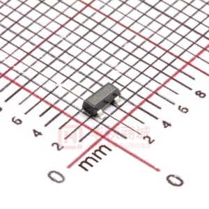

BCR146... NPN Silicon Digital Transistor • Switching circuit, inverter, interface circuit, driver circuit • Built in bias resistor (R1=47kΩ, R2 =22kΩ) • Pb-free (RoHS compliant) package1) • Qualified according AEC Q101 BCR146/F C 3 R1 R2 1 B 2 E EHA07184 Type BCR146 BCR146F 1Pb-containing Marking WLs WLs 1=B 1=B Pin Configuration 2=E 2=E 3=C 3=C - Package SOT23 TSFP-3 package may be available upon special request Maximum Ratings Parameter Collector-emitter voltage Collector-base voltage Input forward voltage Input reverse voltage Collector current Total power dissipationBCR146, TS ≤ 102°C BCR146F, TS ≤ 128°C Junction temperature Storage temperature Tj Tstg Symbol VCEO VCBO Vi(fwd) Vi(rev) IC Ptot 200 250 150 -65 ... 150 °C Value 50 50 80 10 70 mA mW Unit V 1 2007-09-19 BCR146... Thermal Resistance Parameter Junction - soldering point1) BCR146 BCR146F Symbol RthJS Value ≤ 240 ≤ 90 Unit K/W Electrical Characteristics at TA = 25°C, unless otherwise specified Parameter Symbol Values min. typ. max. DC Characteristics Collector-emitter breakdown voltage V(BR)CEO 50 IC = 100 µA, IB = 0 Collector-base breakdown voltage IC = 10 µA, IE = 0 Collector-base cutoff current VCB = 40 V, IE = 0 Emitter-base cutoff current VEB = 10 V, IC = 0 DC current gain2) IC = 5 mA, VCE = 5 V Collector-emitter saturation voltage2) IC = 10 mA, IB = 0.5 mA Input off voltage IC = 100 µA, VCE = 5 V Input on voltage IC = 2 mA, VCE = 0.3 V Input resistor Resistor ratio R1 R1/R2 32 1.92 47 2.14 62 2.36 Vi(on) 1.5 4 Vi(off) 1.2 2.6 VCEsat 0.3 hFE 50 IEBO 220 ICBO 100 V(BR)CBO 50 - Unit V nA µA V kΩ - AC Characteristics Transition frequency IC = 10 mA, VCE = 5 V, f = 100 MHz Collector-base capacitance VCB = 10 V, f = 1 MHz 1For fT Ccb - 150 3 - MHz pF calculation of RthJA please refer to Application Note Thermal Resistance test: t < 300µs; D < 2% 2Pulse 2 2007-09-19 BCR146... DC current gain hFE = ƒ(IC) VCE = 5V (common emitter configuration) 10 3 Collector-emitter saturation voltage VCEsat = ƒ(IC ), IC/IB = 20 0.5 V 0.4 VCEsat hFE 10 2 0.35 0.3 0.25 0.2 -40 °C -25 °C 25 °C 85 °C 125 °C 10 1 -40 °C -25 °C 25 °C 85 °C 125 °C 0.15 0.1 0.05 10 0 -4 10 10 -3 10 -2 A 10 -1 0 -3 10 10 -2 A 10 -1 IC IC Input on Voltage Vi (on) = ƒ(IC) VCE = 0.3V (common emitter configuration) 10 2 Input off voltage Vi(off) = ƒ(IC) VCE = 5V (common emitter configuration) 10 1 V Vi(off) 10 1 -40 °C -25 °C 25 °C 85 °C 125 °C V -40 °C -25 °C 25 °C 85 °C 125 °C Vi(on) 10 0 10 0 10 -1 -5 10 10 -4 10 -3 10 -2 A 10 -1 10 -1 -5 10 10 -4 10 -3 10 -2 A IC 10 -1 IC 3 2007-09-19 BCR146... Total power dissipation P tot = ƒ(TS) BCR146 Total power dissipation P tot = ƒ(TS) BCR146F 300 mW 300 mW 250 225 250 225 Ptot 175 150 125 100 75 50 25 0 0 15 30 45 60 75 90 105 120 °C 150 Ptot 200 200 175 150 125 100 75 50 25 0 0 15 30 45 60 75 90 105 120 °C 150 TS TS Permissible Pulse Load RthJS = ƒ(tp) BCR146 10 3 K/W Permissible Pulse Load Ptotmax/PtotDC = ƒ(tp ) BCR146 10 3 Ptotmax / PtotDC - 10 2 10 2 10 1 10 0 0.5 0.2 0.1 0.05 0.02 0.01 0.005 D=0 D=0 0.005 0.01 0.02 0.05 0.1 0.2 0.5 RthJS 10 1 10 -1 -6 10 10 -5 10 -4 10 -3 10 -2 s 10 0 10 0 -6 10 10 -5 10 -4 10 -3 10 -2 s 10 0 tp tp 4 2007-09-19 BCR146... Permissible Puls Load RthJS = ƒ (t p) BCR146F 10 2 Permissible Pulse Load Ptotmax/PtotDC = ƒ(tp ) BCR146F 10 3 10 1 10 0 D=0.5 0.2 0.1 0.05 0.02 0.01 0.005 0 Ptotmax/PtotDC K/W RthJS 10 2 10 1 D=0 0.005 0.01 0.02 0.05 0.1 0.2 0.5 10 -1 -6 10 10 -5 10 -4 10 -3 10 -2 s 10 0 10 0 -6 10 10 -5 10 -4 10 -3 10 -2 s 10 0 tp tp 5 2007-09-19 Package SOT23 BCR146... Package Outline 0.15 MIN. 1 ±0.1 0.1 MAX. 1.3 ±0.1 2.9 ±0.1 3 B 2.4 ±0.15 10˚ MAX. 0.4 +0.1 -0.05 1) 1 2 10˚ MAX. C 0.95 1.9 0.08...0.1 0...8˚ A 5 0.25 M B C 0.2 M A 1) Lead width can be 0.6 max. in dambar area Foot Print 0.8 0.9 0.8 1.2 Marking Layout (Example) Manufacturer EH s Pin 1 0.9 1.3 2005, June Date code (YM) BCW66 Type code Standard Packing Reel ø180 mm = 3.000 Pieces/Reel Reel ø330 mm = 10.000 Pieces/Reel 4 0.9 2.13 2.65 0.2 8 Pin 1 3.15 1.15 6 2007-09-19 Package TSFP-3 BCR146... Package Outline 1.2 ±0.05 10˚ MAX. 0.8 ±0.05 0.2 ±0.05 1.2 ±0.05 0.2 ±0.05 3 0.55 ±0.04 1 2 0.2 ±0.05 0.4 ±0.05 0.4 ±0.05 0.15 ±0.05 Foot Print 0.4 0.45 0.4 0.4 Marking Layout (Example) Manufacturer 1.05 Pin 1 BCR847BF Type code Standard Packing Reel ø180 mm = 3.000 Pieces/Reel Reel ø330 mm = 10.000 Pieces/Reel 4 0.3 1.2 1.5 8 0.2 Pin 1 1.35 0.7 7 2007-09-19 BCR146... Edition 2006-02-01 Published by Infineon Technologies AG 81726 München, Germany © Infineon Technologies AG 2007. All Rights Reserved. Attention please! The information given in this dokument shall in no event be regarded as a guarantee of conditions or characteristics (“Beschaffenheitsgarantie”). With respect to any examples or hints given herein, any typical values stated herein and/or any information regarding the application of the device, Infineon Technologies hereby disclaims any and all warranties and liabilities of any kind, including without limitation warranties of non-infringement of intellectual property rights of any third party. Information For further information on technology, delivery terms and conditions and prices please contact your nearest Infineon Technologies Office (www.infineon.com). Warnings Due to technical requirements components may contain dangerous substances. For information on the types in question please contact your nearest Infineon Technologies Office. Infineon Technologies Components may only be used in life-support devices or systems with the express written approval of Infineon Technologies, if a failure of such components can reasonably be expected to cause the failure of that life-support device or system, or to affect the safety or effectiveness of that device or system. Life support devices or systems are intended to be implanted in the human body, or to support and/or maintain and sustain and/or protect human life. If they fail, it is reasonable to assume that the health of the user or other persons may be endangered. 8 2007-09-19
