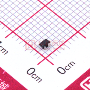

BFP193 NPN Silicon RF Transistor 3 For low noise, high-gain amplifiers up to 2 GHz For linear broadband amplifiers fT = 8 GHz F = 1.3 dB at 900 MHz    4 2 1 VPS05178 ESD: Electrostatic discharge sensitive device, observe handling precaution! Type BFP193 Maximum Ratings Parameter Marking RCs 1=C Pin Configuration 2=E 3=B 4=E Package SOT143 Unit V Symbol VCEO VCES VCBO VEBO IC IB Ptot Tj TA Tstg Value 12 20 20 2 80 10 580 150 -65 ... 150 -65 ... 150 Collector-emitter voltage Collector-emitter voltage Collector-base voltage Emitter-base voltage Collector current Base current Total power dissipation Junction temperature Ambient temperature Storage temperature TS 72 °C 1) mA mW °C Thermal Resistance Junction - soldering point 2) RthJS 1T is measured on the collector lead at the soldering point to the pcb S 2For calculation of R please refer to Application Note Thermal Resistance thJA   135 K/W 1 Aug-09-2001 BFP193 Electrical Characteristics at TA = 25°C, unless otherwise specified. Parameter DC characteristics Collector-emitter breakdown voltage IC = 1 mA, IB = 0 Collector-emitter cutoff current VCE = 20 V, VBE = 0 Collector-base cutoff current VCB = 10 V, IE = 0 Emitter-base cutoff current VEB = 1 V, IC = 0 DC current gain IC = 30 mA, VCE = 8 V hFE 50 100 200 IEBO 1 µA ICBO 100 nA ICES 100 µA V(BR)CEO 12 V Symbol min. Values typ. max. Unit 2 Aug-09-2001 BFP193 Electrical Characteristics at TA = 25°C, unless otherwise specified. Parameter Symbol Values min. AC characteristics (verified by random sampling) Transition frequency IC = 50 mA, VCE = 8 V, f = 500 MHz Collector-base capacitance VCB = 10 V, f = 1 MHz Collector-emitter capacitance VCE = 10 V, f = 1 MHz Emitter-base capacitance VEB = 0.5 V, f = 1 MHz Noise figure IC = 10 mA, VCE = 8 V, ZS = ZSopt , f = 900 MHz f = 1.8 GHz Power gain, maximum available 1) IC = 30 mA, VCE = 8 V, ZS = ZSopt, ZL = ZLopt , f = 900 MHz f = 1.8 GHz Transducer gain |S21e|2 , 14.5 8.5 IC = 30 mA, VCE = 8 V, ZS = ZL = 50 f = 900 MHz f = 1.8 GHz 1G ma Unit max. 0.9 dB GHz pF typ. 8 0.6 0.25 1.8 fT Ccb Cce Ceb F 6 - Gma - 1.3 2.1 - 17.5 11.5 - = |S21 / S12 | (k-(k2-1)1/2 )  3 Aug-09-2001 BFP193 SPICE Parameters (Gummel-Poon Model, Berkley-SPICE 2G.6 Syntax) : Transistor Chip Data IS = VAF = NE = VAR = NC = RBM = CJE = TF = ITF = VJC = TR = MJS = XTI = 0.2738 24 1.935 3.8742 0.94371 1 1.1824 18.828 0.96893 1.1828 1.0037 0 3 fA V V BF = IKF = BR = IKR = RB = RE = VJE = XTF = PTF = MJC = CJS = XTB = FC = 125 0.26949 14.267 0.037925 1.8368 0.76534 0.70276 0.69477 0 0.30002 0 0 0.72063 A A NF = ISE = NR = ISC = IRB = RC = MJE = VTF = CJC = XCJC = VJS = EG = TNOM 0.95341 10.627 1.4289 0.037409 0.91763 0.11938 0.48654 0.8 935.03 0.053563 0.75 1.11 300 fA fA mA - fF ps V deg fF - V fF V eV K mA V ns - All parameters are ready to use, no scalling is necessary. Extracted on behalf of Infineon Technologies AG by: Institut für Mobil-und Satellitentechnik (IMST) Package Equivalent Circuit: L BI = L BO = L EI = L EO = L CI = L CO = C BE = C CB = C CE = 0.84 0.65 0.31 0.14 0.07 0.42 145 19 281 fF fF Valid up to 6GHz For examples and ready to use parameters please contact your local Infineon Technologies distributor or sales office to obtain a Infineon Technologies CD-ROM or see Internet: http://www.infineon.com/silicondiscretes 4 Aug-09-2001  nH nH nH nH nH nH fF   BFP193 Total power dissipation Ptot = f (TS ) 600 mW 500 450 P tot 400 350 300 250 200 150 100 50 0 0 20 40 60 80 100 120 °C 150 TS Permissible Pulse Load RthJS = f (tp ) Permissible Pulse Load Ptotmax/P totDC = f (tp) 10 3 10 2 K/W Ptotmax / PtotDC - 10 2 10 1 10 1 0.5 0.2 0.1 0.05 0.02 0.01 0.005 D=0 D=0 0.005 0.01 0.02 0.05 0.1 0.2 0.5 RthJS 10 0 -7 10 10 -6 10 -5 10 -4 10 -3 10 -2 s 10 0 10 0 -7 10 10 -6 10 -5 10 -4 10 -3 10 -2 s 10 0 IC tp 5 Aug-09-2001 BFP193 Collector-base capacitance Ccb = f (VCB ) f = 1MHz Transition frequency f T = f (I C) V CE = Parameter 1.3 pF 10 GHz 10V 1.1 1.0 8 7 6 5 0.6 0.5 0.4 0.3 0.2 0.1 0.0 0 4 8 12 16 V Ccb 0.9 5V 3V 2V 0.7 f 0.8 4 3 2 1 0 0 1V 0.7V 22 10 20 30 40 50 60 70 mA 85 VCB IC Power Gain Gma , Gms = f(IC ) f = 0.9GHz VCE = Parameter 20 Power Gain Gma, Gms = f(I C) f = 1.8GHz VCE = Parameter 13 dB 10V dB 10V 11 5V 10 5V 3V 16 3V 2V 9 G 14 2V G 12 8 7 6 5 1V 10 4 1V 3 8 0.7V 0.7V 2 1 0 0 10 20 30 40 50 60 70 mA 85 6 0 10 20 30 40 50 60 70 mA 85 IC IC 6 Aug-09-2001 BFP193 Power Gain Gma , Gms = f(VCE):_____ |S21|2 = f(VCE):--------f = Parameter 20 dB Intermodulation Intercept Point IP3=f(IC) (3rd order, Output, ZS=ZL=50 ) VCE = Parameter, f = 900MHz 34 dBm IC=30mA 0.9GHz 16 0.9GHz 30 28 14 IP 3 G 12 10 8 26 24 1.8GHz 1.8GHz 22 20 2V 6 4 2 0 0 18 16 14 2 4 6 8 V 1V 12 12 0 10 20 30 40 VCE Power Gain Gma , Gms = f(f) VCE = Parameter 34 dB Power Gain |S21|2= f(f) V CE = Parameter 32 dB IC=30mA IC =30mA 28 26 24 22 G 20 16 S21 18 14 12 10V 1V 0.7V 10 8 4 6 10V 2 0 0.0 0.5 1.0 1.5 2.0 2.5 GHz 3.5 -2 0.0 0.5 1.0 1.5 2.0 f 7  8V 5V 3V 50 60 mA 80 IC 1V 0.7V 2.5 GHz 3.5 f Aug-09-2001

1. 物料型号: - 型号:BFP193
2. 器件简介: - 低噪声、高增益放大器,适用于高达2GHz的线性宽带放大器。 - 特征频率(fT)为8GHz。 - 在900MHz时噪声系数(F)为1.3dB。
3. 引脚分配: - 引脚1:集电极(C) - 引脚2:发射极(E) - 引脚3:基极(B) - 引脚4:发射极(E) - 封装类型:SOT143
4. 参数特性: - 最大额定值包括:集电极-发射极电压、集电极-基极电压、基极-发射极电压、集电极电流、基极电流等。 - 直流特性包括:集电极-发射极击穿电压、集电极-发射极截止电流、集电极-基极截止电流、基极-发射极截止电流、直流电流增益等。 - 交流特性包括:过渡频率、集基电容、集射电容、发射极-基极电容、噪声系数、最大功率增益、最大可用增益、传感器增益等。
5. 功能详解: - BFP193是一款NPN硅射频晶体管,适用于低噪声、高增益放大器,特别适用于线性宽带放大器。它具有高特征频率和低噪声系数,适合高频应用。
6. 应用信息: - 适用于低噪声、高增益放大器,特别适用于2GHz以下的线性宽带放大器。
7. 封装信息: - 封装类型为SOT143,这是一种小外形晶体管封装。
