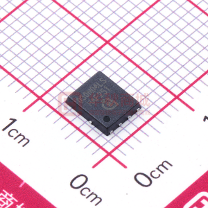

BSC050N04LS G OptiMOS™3 Power-Transistor Features • Fast switching MOSFET for SMPS • Optimized technology for DC/DC converters • Qualified according to JEDEC1) for target applications • N-channel; Logic level • Excellent gate charge x R DS(on) product (FOM) • Very low on-resistance R DS(on) • Superior thermal resistance • 100% Avalanche tested • Pb-free plating; RoHS compliant • Halogen-free according to IEC61249-2-21 Type BSC050N04LS G Package PG-TDSON-8 Marking 050N04LS Product Summary V DS R DS(on),max ID 40 5.0 85 PG-TDSON-8 V mΩ A Maximum ratings, at T j=25 °C, unless otherwise specified Parameter Continuous drain current Symbol Conditions ID V GS=10 V, T C=25 °C V GS=10 V, T C=100 °C V GS=4.5 V, T C=25 °C V GS=4.5 V, T C=100 °C V GS=10 V, T A=25 °C, R thJA=50 K/W 2) Pulsed drain current3) Avalanche current, single pulse 4) Avalanche energy, single pulse Gate source voltage 1) Value 85 54 71 45 Unit A 18 340 50 35 ±20 mJ V I D,pulse I AS E AS V GS T C=25 °C T C=25 °C I D=50 A, R GS=25 Ω J-STD20 and JESD22 Rev. 1.04 page 1 2009-10-22 BSC050N04LS G Maximum ratings, at T j=25 °C, unless otherwise specified Parameter Power dissipation Symbol Conditions P tot T C=25 °C T A=25 °C, R thJA=50 K/W 2) Operating and storage temperature IEC climatic category; DIN IEC 68-1 T j, T stg Value 57 2.5 -55 ... 150 55/150/56 °C Unit W Parameter Symbol Conditions min. Values typ. max. Unit Thermal characteristics Thermal resistance, junction - case R thJC bottom top Device on PCB R thJA 6 cm2 cooling area2) 2.2 20 50 K/W Electrical characteristics, at T j=25 °C, unless otherwise specified Static characteristics Drain-source breakdown voltage Gate threshold voltage Zero gate voltage drain current V (BR)DSS V GS=0 V, I D=1 mA V GS(th) I DSS V DS=V GS, I D=27 µA V DS=40 V, V GS=0 V, T j=25 °C V DS=40 V, V GS=0 V, T j=125 °C Gate-source leakage current Drain-source on-state resistance I GSS R DS(on) V GS=20 V, V DS=0 V V GS=4.5 V, I D=50 A V GS=10 V, I D=50 A Gate resistance Transconductance 2) 40 1.2 - 0.1 2 1 V µA - 10 10 5.8 4.2 1.5 100 100 100 7.2 5 Ω S nA mΩ RG g fs |V DS|>2|I D|R DS(on)max, I D=50 A 50 Device on 40 mm x 40 mm x 1.5 mm epoxy PCB FR4 with 6 cm2 (one layer, 70 µm thick) copper area for drain connection. PCB is vertical in still air. See figure 3 for more detailed information See figure 13 for more detailed information 3) 4) Rev. 1.04 page 2 2009-10-22 BSC050N04LS G Parameter Symbol Conditions min. Dynamic characteristics Input capacitance Output capacitance Reverse transfer capacitance Turn-on delay time Rise time Turn-off delay time Fall time Gate Charge Characteristics 5) Gate to source charge Gate charge at threshold Gate to drain charge Switching charge Gate charge total Gate plateau voltage Gate charge total Q gs Q g(th) Q gd Q sw Qg V plateau Qg V DD=20 V, I D=30 A, V GS=0 to 4.5 V V DS=0.1 V, V GS=0 to 10 V V DD=20 V, V GS=0 V V DD=20 V, I D=30 A, V GS=0 to 10 V 9.0 4.5 3.8 8.2 36 3.2 17 47 23 V nC nC C iss C oss Crss t d(on) tr t d(off) tf V DD=20 V, V GS=10 V, I D=30 A, R G=1.6 Ω V GS=0 V, V DS=20 V, f =1 MHz 2800 630 33 6.4 3.8 26 4.2 3700 840 ns pF Values typ. max. Unit Gate charge total, sync. FET Output charge Reverse Diode Diode continuous forward current Diode pulse current Diode forward voltage Q g(sync) Q oss - 34 24 - IS I S,pulse V SD T C=25 °C V GS=0 V, I F=50 A, T j=25 °C V R=20 V, I F=I S, di F/dt =400 A/µs - 0.87 47 340 1.2 A V Reverse recovery charge 5) Q rr - 27 - nC See figure 16 for gate charge parameter definition Rev. 1.04 page 3 2009-10-22 BSC050N04LS G 1 Power dissipation P tot=f(T C) 2 Drain current I D=f(T C); V GS≥10 V 60 100 50 80 40 60 P tot [W] 30 I D [A] 40 20 0 0 40 80 120 160 0 40 80 120 160 20 10 0 T C [°C] T C [°C] 3 Safe operating area I D=f(V DS); T C=25 °C; D =0 parameter: t p 103 limited by on-state resistance 1 µs 10 µs 4 Max. transient thermal impedance Z thJC=f(t p) parameter: D =t p/T 10 102 100 µs 1 0.5 Z thJC [K/W] DC I D [A] 0.2 0.1 0.05 10 1 1 ms 10 ms 0 0.1 0.02 0.01 single pulse 10 10-1 10-1 100 101 102 0.01 0 0 0 0 0 0 1 10-6 10-5 10-4 10-3 10-2 10-1 100 V DS [V] t p [s] Rev. 1.04 page 4 2009-10-22 BSC050N04LS G 5 Typ. output characteristics I D=f(V DS); T j=25 °C parameter: V GS 200 5V 10 V 4.5 V 3.2 V 6 Typ. drain-source on resistance R DS(on)=f(I D); T j=25 °C parameter: V GS 16 160 12 R DS(on) [mΩ ] 120 4V 3.5 V I D [A] 8 4V 4.5 V 5V 80 3.5 V 10 V 4 40 3.2 V 3V 2.8 V 0 0 1 2 3 0 0 10 20 30 40 50 V DS [V] I D [A] 7 Typ. transfer characteristics I D=f(V GS); |V DS|>2|I D|R DS(on)max parameter: T j 120 8 Typ. forward transconductance g fs=f(I D); T j=25 °C 200 100 160 80 120 60 g fs [S] 80 40 150 °C 25 °C I D [A] 40 20 0 0 1 2 3 4 5 0 0 40 80 120 160 V GS [V] I D [A] Rev. 1.04 page 5 2009-10-22 BSC050N04LS G 9 Drain-source on-state resistance R DS(on)=f(T j); I D=50 A; V GS=10 V 10 Typ. gate threshold voltage V GS(th)=f(T j); V GS=V DS; I D=27 µA 8 2.5 2 6 98 % R DS(on) [mΩ ] 4 typ V GS(th) [V] 100 140 180 1.5 1 2 0.5 0 -60 -20 20 60 0 -60 -20 20 60 100 140 180 T j [°C] T j [°C] 11 Typ. capacitances C =f(V DS); V GS=0 V; f =1 MHz 12 Forward characteristics of reverse diode I F=f(V SD) parameter: T j 104 1000 25 °C Ciss 150 °C, 98% 103 Coss 100 C [pF] 102 Crss I F [A] 150 °C 25 °C, 98% 10 101 100 0 10 20 30 40 1 0.0 0.5 1.0 1.5 2.0 V DS [V] V SD [V] Rev. 1.04 page 6 2009-10-22 BSC050N04LS G 13 Avalanche characteristics I AS=f(t AV); R GS=25 Ω parameter: T j(start) 100 14 Typ. gate charge V GS=f(Q gate); I D=30 A pulsed parameter: V DD 12 20 V 10 8V 32 V 25 °C 8 10 V GS [V] 100 1000 I AV [A] 100 °C 125 °C 6 4 2 1 1 10 0 0 10 20 30 40 t AV [µs] Q gate [nC] 15 Drain-source breakdown voltage V BR(DSS)=f(T j); I D=1 mA 16 Gate charge waveforms 45 V GS Qg 40 V BR(DSS) [V] 35 30 V g s(th) 25 Q g(th) Q gs -60 -20 20 60 100 140 180 Q sw Q gd Q g ate 20 T j [°C] Rev. 1.04 page 7 2009-10-22 BSC050N04LS G Package Outline PG-TDSON-8: Outline PG-TDSON-8 Footprint Dimensions in mm Rev. 1.04 page 8 2009-10-22 BSC050N04LS G Package Outline PG-TDSON-8: Tape Dimensions in mm Rev. 1.04 page 9 2009-10-22 BSC050N04LS G Published by Infineon Technologies AG 81726 Munich, Germany © 2008 Infineon Technologies AG All Rights Reserved. Legal Disclaimer The information given in this document shall in no event be regarded as a guarantee of conditions or characteristics. With respect to any examples or hints given herein, any typical values stated herein and/or any information regarding the application of the device, Infineon Technologies hereby disclaims any and all warranties and liabilities of any kind, including without limitation, warranties of non-infringement of intellectual property rights of any third party. Information For further information on technology, delivery terms and conditions and prices, please contact the nearest Infineon Technologies Office (www.infineon.com). Warnings Due to technical requirements, components may contain dangerous substances. For information on the types in question, please contact the nearest Infineon Technologies Office. Infineon Technologies components may be used in life-support devices or systems only with the express written approval of Infineon Technologies, if a failure of such components can reasonably be expected to cause the failure of that life-support device or system or to affect the safety or effectiveness of that device or system. Life support devices or systems are intended to be implanted in the human body or to support and/or maintain and sustain and/or protect human life. If they fail, it is reasonable to assume that the health of the user or other persons may be endangered. Rev. 1.04 page 10 2009-10-22
