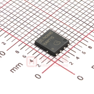

BSC057N08NS3 G OptiMOSTM3 Power-Transistor Features • Ideal for high frequency switching and sync. rec. • Optimized technology for DC/DC converters • Excellent gate charge x R DS(on) product (FOM) • Very low on-resistance RDS(on) • Superior thermal resistance • N-channel, normal level • 100% avalanche tested • Pb-free plating; RoHS compliant • Qualified according to JEDEC1) for target applications • Halogen-free according to IEC61249-2-21 Type BSC057N08NS3 G Product Summary V DS R DS(on),max ID 80 5.7 100 V mΩ A Package Marking PG-TDSON-8 057N08NS Maximum ratings, at T j=25 °C, unless otherwise specified Parameter Continuous drain current Symbol Conditions ID V GS=10 V, T C=25 °C V GS=10 V, T C=100 °C V GS=10 V, T A=25 °C, R thJA=50 K/W 2) Pulsed drain current3) Avalanche energy, single pulse4) Gate source voltage 1) 2) Value 100 68 Unit A 16 I D,pulse E AS V GS T C=25 °C I D=50 A, R GS=25 Ω 400 216 ±20 mJ V J-STD20 and JESD22 Device on 40 mm x 40 mm x 1.5 mm epoxy PCB FR4 with 6 cm2 (one layer, 70 µm thick) copper area for drain connection. PCB is vertical in still air. 3) See figure 3 for more detailed information 4) See figure 13 for more detailed information Rev. 2.4 page 1 2009-10-22 BSC057N08NS3 G Maximum ratings, at T j=25 °C, unless otherwise specified Parameter Power dissipation Symbol Conditions P tot T C=25 °C T A=25 °C, R thJA=50 K/W 2) Operating and storage temperature IEC climatic category; DIN IEC 68-1 T j, T stg Value 114 2.5 -55 ... 150 55/150/56 °C Unit W Parameter Symbol Conditions min. Values typ. max. Unit Thermal characteristics Thermal resistance, junction - case R thJC bottom top Device on PCB R thJA minimal footprint 6 cm2 cooling area2) Electrical characteristics, at T j=25 °C, unless otherwise specified Static characteristics Drain-source breakdown voltage Gate threshold voltage Zero gate voltage drain current V (BR)DSS V GS=0 V, I D=1 mA V GS(th) I DSS V DS=V GS, I D=73 µA V DS=80 V, V GS=0 V, T j=25 °C V DS=80 V, V GS=0 V, T j=125 °C Gate-source leakage current Drain-source on-state resistance I GSS R DS(on) V GS=20 V, V DS=0 V V GS=10 V, I D=50 A V GS=6 V, I D=25 A Gate resistance Transconductance RG g fs |V DS|>2|I D|R DS(on)max, I D=50 A 80 2 2.8 0.1 3.5 1 µA V 1.1 18 62 50 K/W 40 10 10 4.7 6.4 1.9 80 100 100 5.7 11 Ω S nA mΩ Rev. 2.4 page 2 2009-10-22 BSC057N08NS3 G Parameter Symbol Conditions min. Dynamic characteristics Input capacitance Output capacitance Reverse transfer capacitance Turn-on delay time Rise time Turn-off delay time Fall time Gate Charge Characteristics 5) Gate to source charge Gate charge at threshold Gate to drain charge Switching charge Gate charge total Gate plateau voltage Output charge Reverse Diode Diode continuous forward current Diode pulse current Diode forward voltage Reverse recovery time Reverse recovery charge 5) Values typ. max. Unit C iss C oss Crss t d(on) tr t d(off) tf V DD=40 V, V GS=10 V, I D=25 A, R G=1.6 Ω V GS=0 V, V DS=40 V, f =1 MHz - 2900 780 30 16 14 32 9 3900 1000 - pF ns Q gs Q g(th) Q gd Q sw Qg V plateau Q oss V DD=40 V, V GS=0 V V DD=40 V, I D=25 A, V GS=0 to 10 V - 13 8 8 13 42 4.6 56 56 75 nC V nC IS I S,pulse V SD t rr Q rr T C=25 °C V GS=0 V, I F=50 A, T j=25 °C V R=40 V, I F=25A, di F/dt =100 A/µs - 0.9 48 77 100 400 1.2 - A V ns nC See figure 16 for gate charge parameter definition Rev. 2.4 page 3 2009-10-22 BSC057N08NS3 G 1 Power dissipation P tot=f(T C) 2 Drain current I D=f(T C); V GS≥10 V 150 120 125 100 100 80 P tot [W] 75 I D [A] 0 25 50 75 100 125 150 175 60 50 40 25 20 0 0 0 25 50 75 100 125 150 175 T C [°C] T C [°C] 3 Safe operating area I D=f(V DS); T C=25 °C; D =0 parameter: t p 103 limited by on-state resistance 1 µs 4 Max. transient thermal impedance Z thJC=f(t p) parameter: D =t p/T 10 102 10 µs 1 Z thJC [K/W] 100 µs 0.5 I D [A] 101 0.2 1 ms 0.1 0.1 0.05 100 10 ms 0.02 DC 0.01 single pulse 10-1 10 -1 0.01 10 0 0 0 0 0 0 0 1 10 1 10 2 10 -6 10 -5 10 -4 10 -3 10 -2 10 -1 100 V DS [V] t p [s] Rev. 2.4 page 4 2009-10-22 BSC057N08NS3 G 5 Typ. output characteristics I D=f(V DS); T j=25 °C parameter: V GS 400 9V 6 Typ. drain-source on resistance R DS(on)=f(I D); T j=25 °C parameter: V GS 15 5V 5.5 V 6V 7V 360 320 280 10 V 8V 7V 10 200 160 120 5.5 V 6V R DS(on) [mΩ ] 240 I D [A] 8V 5 9V 10 V 80 40 0 0 1 2 3 4 5 5V 4.5 V 0 0 0 50 100 150 200 250 300 350 400 V DS [V] I D [A] 7 Typ. transfer characteristics I D=f(V GS); |V DS|>2|I D|R DS(on)max parameter: T j 150 140 130 120 110 100 90 8 Typ. forward transconductance g fs=f(I D); T j=25 °C 160 140 120 100 I D [A] 80 70 60 50 40 30 20 10 0 0 1 2 3 4 5 6 7 8 150 °C 25 °C g fs [S] 80 60 40 20 0 0 40 80 120 160 V GS [V] I D [A] Rev. 2.4 page 5 2009-10-22 BSC057N08NS3 G 9 Drain-source on-state resistance R DS(on)=f(T j); I D=50 A; V GS=10 V 10 Typ. gate threshold voltage V GS(th)=f(T j); V GS=V DS 10 4 8 3 max 73 µA 730 µA R DS(on) [mΩ ] typ V GS(th) [V] 6 2 4 1 2 0 -60 -20 20 60 100 140 180 0 -60 -20 20 60 100 140 180 T j [°C] T j [°C] 11 Typ. capacitances C =f(V DS); V GS=0 V; f =1 MHz 12 Forward characteristics of reverse diode I F=f(V SD) parameter: T j 104 Ciss 1000 103 Coss 25 °C 100 150 °C 150°C, max C [pF] 102 I F [A] 25°C, max Crss 10 10 1 100 0 20 40 60 80 1 0.0 0.5 1.0 1.5 2.0 V DS [V] V SD [V] Rev. 2.4 page 6 2009-10-22 BSC057N08NS3 G 13 Avalanche characteristics I AS=f(t AV); R GS=25 Ω parameter: T j(start) 100 14 Typ. gate charge V GS=f(Q gate); I D=25 A pulsed parameter: V DD 12 40 V 10 100 °C 125 °C 25 °C 8 16 V 64 V 10 V GS [V] 0.1 1 10 100 1000 I AV [A] 6 4 2 1 0 0 10 20 30 40 50 t AV [µs] Q gate [nC] 15 Drain-source breakdown voltage V BR(DSS)=f(T j); I D=1 mA 16 Gate charge waveforms 100 V GS 90 Qg 80 V BR(DSS) [V] 70 V g s(th) 60 50 Q g(th) Q gs -60 -20 20 60 100 140 180 Q sw Q gd Q g ate 40 T j [°C] Rev. 2.4 page 7 2009-10-22 BSC057N08NS3 G PG-TDSON-8 Rev. 2.4 page 8 2009-10-22 BSC057N08NS3 G Published by Infineon Technologies AG 81726 Munich, Germany © 2008 Infineon Technologies AG All Rights Reserved. Legal Disclaimer The information given in this document shall in no event be regarded as a guarantee of conditions or characteristics. With respect to any examples or hints given herein, any typical values stated herein and/or any information regarding the application of the device, Infineon Technologies hereby disclaims any and all warranties and liabilities of any kind, including without limitation, warranties of non-infringement of intellectual property rights of any third party. Information For further information on technology, delivery terms and conditions and prices, please contact the nearest Infineon Technologies Office (www.infineon.com). Warnings Due to technical requirements, components may contain dangerous substances. For information on the types in question, please contact the nearest Infineon Technologies Office. Infineon Technologies components may be used in life-support devices or systems only with the express written approval of Infineon Technologies, if a failure of such components can reasonably be expected to cause the failure of that life-support device or system or to affect the safety or effectiveness of that device or system. Life support devices or systems are intended to be implanted in the human body or to support and/or maintain and sustain and/or protect human life. If they fail, it is reasonable to assume that the health of the user or other persons may be endangered. Rev. 2.4 page 9 2009-10-22

4. 参数特性: - 漏源电压(V DS):80V - 最大漏源导通电阻(R DS(on), max):5.7 mΩ - 漏极电流(I D):100A - 栅极电荷与R DS(on)的乘积(FOM):优秀 - 热阻:优越 - N沟道,正常电平 - 100%雪崩测试 - 无铅镀层;符合RoHS标准
5. 功能详解: - 该器件具有优秀的门极电荷与R DS(on)的乘积,非常低的导通电阻R DS(on),以及优越的热阻。适用于需要高频率开关和同步整流的应用场合。
6. 应用信息: - 根据JEDEC标准,适用于目标应用的合格产品,并且符合IEC61249-2-21的无卤素标准。
7. 封装信息: - 封装类型为PG-TDSON-8,标记为057N08NS,HAL表示无卤素。
