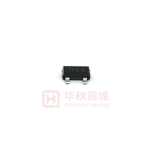

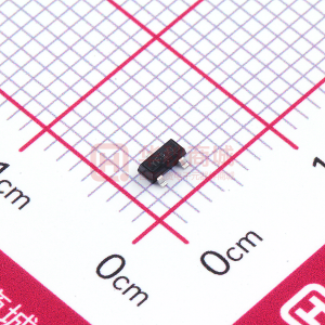

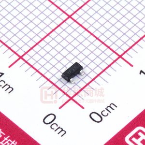

BSS308PE OptiMOS™ P3 Small-Signal-Transistor Features • P-channel • Enhancement mode • Logic level (4.5V rated) • ESD protected • Qualified according to AEC Q101 • 100% lead-free; RoHS compliant Product Summary V DS R DS(on),max V GS=-10 V V GS=-4.5 V ID 30 80 130 -2.0 PG-SOT-23 3 V mΩ A 1 2 Type BSS308PE Package PG-SOT-23 Tape and Reel Information L6327: 3000 pcs/ reel Marking YFs Lead Free Yes Packing Non dry Maximum ratings, at T j=25 °C, unless otherwise specified Parameter Continuous drain current Symbol Conditions ID T A=25 °C T A=70 °C Pulsed drain current Avalanche energy, single pulse I D,pulse E AS T A=25 °C I D=-2 A, R GS=25 Ω I D=-2 A, V DS=-16V, di /dt =-200A/µs, T j,max=150 °C Value -2.0 -1.6 -8.0 -10.7 mJ Unit A Reverse diode d v /dt dv /dt 6 kV/µs Gate source voltage Power dissipation1) Operating and storage temperature ESD Class Soldering Temperature IEC climatic category; DIN IEC 68-1 V GS P tot T j, T stg JESD22-A114 -HBM T A=25 °C ±20 0.5 -55 ... 150 2 (2kV to 4kV) 260 °C 55/150/56 V W °C °C °C Rev 2.02 page 1 2010-03-29 BSS308PE Parameter Symbol Conditions min. Thermal characteristics Thermal resistance, junction - ambient R thJA minimal footprint1) Values typ. max. Unit - - 250 K/W Electrical characteristics, at T j=25 °C, unless otherwise specified Static characteristics V (BR)DSS V GS= 0V, I D=-250µA V GS(th) I DSS V DS=VGS, I D=-11µA V DS=-30V, V GS=0 V, T j=25 °C V DS=-30V, V GS=0V, T j=150 °C Gate-source leakage current Drain-source on-state resistance I GSS R DS(on) V GS=-20V, V DS=0V V GS=-4.5 V, I D=-1.7 A V GS=-10 V, I D=-2 A Transconductance g fs |V DS|>2|I D|R DS(on)max, I D=-1.6 A Drain-source breakdown voltage Gate threshold voltage Drain-source leakage current -30 -2.0 - -1.5 - -1.0 -1 V µA - 88 62 4.6 -100 -5 130 80 S µA mΩ 1) Performed on 40mm2 FR4 PCB. The traces are 1mm wide, 70µm thick and 20mm long; they are present on both sides of the PCB. Rev 2.02 page 2 2010-03-29 BSS308PE Parameter Symbol Conditions min. Dynamic characteristics Input capacitance Output capacitance Reverse transfer capacitance Turn-on delay time Rise time Turn-off delay time Fall time Gate Charge Characteristics Gate to source charge Gate to drain charge Gate charge total Gate plateau voltage Reverse Diode Diode continous forward current Diode pulse current Diode forward voltage Reverse recovery time Reverse recovery charge IS I S,pulse V SD t rr Q rr T A=25 °C V GS=0 V, I F=-2 A, T j=25 °C V R=10 V, I F=-2 A, di F/dt =100 A/µs -0.8 14 -5.9 -0.4 -8.4 -1.1 V ns nC A Q gs Q gd Qg V plateau V DD=-15 V, I D=-2 A, V GS=0 to -10 V -1.2 -0.6 -5.0 -3.1 V nC C iss C oss Crss t d(on) tr t d(off) tf V DD=-15V, V GS=-10 V, I D=-2 A, R G=6 Ω V GS=0 V, V DS=-15 V, f =1 MHz 376 196 12 5.6 7.7 15.3 2.8 500 261 18 ns pF Values typ. max. Unit Rev 2.02 page 3 2010-03-29 BSS308PE 1 Power dissipation P tot=f(T A) 2 Drain current I D=f(T A); V GS≥10 V 2.2 0.5 2 1.8 1.6 0.375 1.4 P tot [W] 0.25 I D [A] 0 40 80 120 160 1.2 1 0.8 0.6 0.125 0.4 0.2 0 0 0 20 40 60 80 100 120 140 160 T A [°C] T A [°C] 3 Safe operating area I D=f(V DS); T A=25 °C; D =0 parameter: t p 101 10 µs 100 µs 1 µs 4 Max. transient thermal impedance Z thJA=f(t p) parameter: D =t p/T 103 100 1 ms 102 10 ms 0.2 0.5 Z thJA [K/W] 10-1 0.1 0.05 I D [A] 101 0.02 0.01 10-2 DC single pulse 10 10-3 0 10-4 10 -1 10-1 10 0 10 1 10 2 10-5 10-4 10-3 10-2 10-1 100 101 102 V DS [V] t p [s] Rev 2.02 page 4 2010-03-29 BSS308PE 5 Typ. output characteristics I D=f(V DS); T j=25 °C parameter: V GS 6 4.5 V 10 V 4V 6 Typ. drain-source on resistance R DS(on)=f(I D); T j=25 °C parameter: V GS 400 2.8 V 350 3V 3.5 V 5 300 250 200 3.5 V 4 3.3 V 3 3.3 V R DS(on) [mΩ] I D [A] 150 100 50 0 4V 4.5 V 10 V 2 3V 1 2.8 V 0 0.0 0.5 1.0 1.5 2.0 2.5 3.0 0 0.5 1 1.5 2 2.5 3 3.5 4 V DS [V] I D [A] 7 Typ. transfer characteristics I D=f(V GS); |V DS|>2|I D|R DS(on)max 8 Typ. forward transconductance g fs=f(I D); T j=25 °C 4 8 3 6 25 °C 2 g fs [S] 150 °C I D [A] 4 1 2 0 0.0 0.5 1.0 1.5 2.0 2.5 3.0 3.5 4.0 0 0 1 2 3 4 5 6 V GS [V] I D [A] Rev 2.02 page 5 2010-03-29 BSS308PE 9 Drain-source on-state resistance R DS(on)=f(T j); I D=-2 A; V GS=-10 V 10 Typ. gate threshold voltage V GS(th)=f(T j); V DS=VGS; I D=11 µA parameter: I D 140 2.4 120 2 98 % 100 98 % 1.6 typ R DS(on) [mΩ ] V GS(th) [V] 80 1.2 2% 60 typ 0.8 40 20 0.4 0 -60 -20 20 60 100 140 180 0 -60 -20 20 60 100 140 180 T j [°C] T j [°C] 11 Typ. capacitances C =f(V DS); V GS=0 V; f =1 MHz; Tj=25°C 12 Forward characteristics of reverse diode I F=f(V SD) parameter: T j 103 Ciss 101 150 °C Coss 100 102 25 °C C [pF] I F [A] 10-1 150 °C, 98% Crss 101 10-2 25 °C, 98% 100 0 5 10 15 20 10-3 0 0.4 0.8 1.2 1.6 V DS [V] V SD [V] Rev 2.02 page 6 2010-03-29 BSS308PE 13 Avalanche characteristics I AS=f(t AV); R GS=25 Ω parameter: T j(start) 101 14 Typ. gate charge V GS=f(Q gate); I D=-2 A pulsed parameter: V DD 10 8 25 °C 6 15 V 6V 24 V 100 100 °C V GS [V] 4 2 0 103 I AV [A] 125 °C 10-1 100 101 102 0 1 2 3 4 5 6 t AV [µs] Q gate [nC] 15 Drain-source breakdown voltage V BR(DSS)=f(T j); I D=250 µA 16 Gate charge waveforms 33 V GS 32 Qg 31 V BR(DSS) [V] 30 V g s(th) 29 28 Q g(th) Q gs -60 -20 20 60 100 140 Q sw Q gd Q g ate 27 T j [°C] Rev 2.02 page 7 2010-03-29 BSS308PE SOT-23 Package Outline: Footprint: Packaging: Rev 2.02 page 8 2010-03-29 BSS308PE Published by Infineon Technologies AG 81726 Munich, Germany © 2009 Infineon Technologies AG All Rights Reserved. Legal Disclaimer The information given in this document shall in no event be regarded as a guarantee of conditions or characteristics. With respect to any examples or hints given herein, any typical values stated herein and/or any information regarding the application of the device, Infineon Technologies hereby disclaims any and all warranties and liabilities of any kind, including without limitation, warranties of non-infringement of intellectual property rights of any third party. Information For further information on technology, delivery terms and conditions and prices, please contact the nearest Infineon Technologies Office (www.infineon.com). Warnings Due to technical requirements, components may contain dangerous substances. For information on the types in question, please contact the nearest Infineon Technologies Office. Infineon Technologies components may be used in life-support devices or systems only with the express written approval of Infineon Technologies, if a failure of such components can reasonably be expected to cause the failure of that life-support device or system or to affect the safety or effectiveness of that device or system. Life support devices or systems are intended to be implanted in the human body or to support and/or maintain and sustain and/or protect human life. If they fail, it is reasonable to assume that the health of the user or other persons may be endangered. Rev 2.02 page 9 2010-03-29
