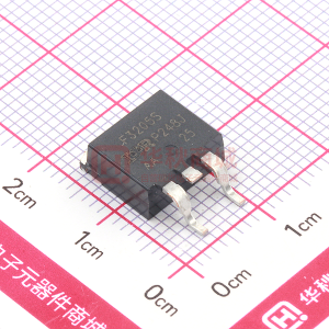

    IRF3205S - Power MOSFET(Vdss=55V, Rds(on)=8.0mohm, Id=110A⑤) - International Rectifier
IRF3205S 数据手册
PD - 94149 IRF3205S/L HEXFET® Power MOSFET l l l l l l Advanced Process Technology Ultra Low On-Resistance Dynamic dv/dt Rating 175°C Operating Temperature Fast Switching Fully Avalanche Rated D VDSS = 55V RDS(on) = 8.0mΩ G S ID = 110A… Description Advanced HEXFET® Power MOSFETs from International Rectifier utilize advanced processing techniques to achieve extremely low onresistance per silicon area. This benefit, combined with the fast switching speed and ruggedized device design that HEXFET power MOSFETs are well known for, provides the designer with an extremely efficient and reliable device for use in a wide variety of applications. The D 2 Pak is a surface mount power package capable of accommodating die sizes up to HEX-4. It provides the highest power capability and the lowest possible on-resistance in any existing surface mount package. The D2Pak is suitable for high current applications because of its low internal connection resistance and can dissipate up to 2.0W in a typical surface mount application. The through-hole version (IRF3205L) is available for low-profile applications. D2Pak IRF3205S TO-262 IRF3205L Absolute Maximum Ratings Parameter ID @ TC = 25°C ID @ TC = 100°C IDM PD @TC = 25°C VGS IAR EAR dv/dt TJ TSTG Continuous Drain Current, VGS @ 10V Continuous Drain Current, VGS @ 10V Pulsed Drain Current  Power Dissipation Linear Derating Factor Gate-to-Source Voltage Avalanche Current Repetitive Avalanche Energy Peak Diode Recovery dv/dt ƒ Operating Junction and Storage Temperature Range Soldering Temperature, for 10 seconds Mounting torque, 6-32 or M3 srew Max. 110 … 80 390 200 1.3 ± 20 62 20 5.0 -55 to + 175 300 (1.6mm from case ) 10 lbf•in (1.1N•m) Units A W W/°C V A mJ V/ns °C Thermal Resistance Parameter RθJC RθJA Junction-to-Case Junction-to-Ambient (PCB mounted, steady-state)* Typ. ––– ––– Max. 0.75 40 Units °C/W www.irf.com 1 03/09/01 IRF3205S/L Electrical Characteristics @ TJ = 25°C (unless otherwise specified) V(BR)DSS ∆V(BR)DSS/∆TJ RDS(on) VGS(th) gfs IDSS IGSS Qg Qgs Qgd td(on) tr td(off) tf LD LS Ciss Coss Crss EAS Parameter Drain-to-Source Breakdown Voltage Breakdown Voltage Temp. Coefficient Static Drain-to-Source On-Resistance Gate Threshold Voltage Forward Transconductance Drain-to-Source Leakage Current Gate-to-Source Forward Leakage Gate-to-Source Reverse Leakage Total Gate Charge Gate-to-Source Charge Gate-to-Drain ("Miller") Charge Turn-On Delay Time Rise Time Turn-Off Delay Time Fall Time Internal Drain Inductance Internal Source Inductance Input Capacitance Output Capacitance Reverse Transfer Capacitance Single Pulse Avalanche Energy‚ Min. 55 ––– ––– 2.0 44 ––– ––– ––– ––– ––– ––– ––– ––– ––– ––– ––– ––– ––– ––– ––– ––– ––– Max. Units Conditions ––– V VGS = 0V, ID = 250µA ––– V/°C Reference to 25°C, ID = 1mA 8.0 mΩ VGS = 10V, ID = 62A „ 4.0 V VDS = VGS, ID = 250µA ––– S VDS = 25V, ID = 62A„ 25 VDS = 55V, VGS = 0V µA 250 VDS = 44V, VGS = 0V, TJ = 150°C 100 VGS = 20V nA -100 VGS = -20V 146 ID = 62A 35 nC VDS = 44V 54 VGS = 10V, See Fig. 6 and 13 ––– VDD = 28V ––– ID = 62A ns ––– RG = 4.5Ω ––– VGS = 10V, See Fig. 10 „ Between lead, 4.5 ––– 6mm (0.25in.) nH G from package 7.5 ––– and center of die contact 3247 ––– VGS = 0V 781 ––– VDS = 25V 211 ––– pF ƒ = 1.0MHz, See Fig. 5 1050† 264‡ mJ IAS = 62A, L = 138µH Typ. ––– 0.057 ––– ––– ––– ––– ––– ––– ––– ––– ––– ––– 14 101 50 65 D S Source-Drain Ratings and Characteristics IS ISM VSD trr Qrr ton Notes: Parameter Continuous Source Current (Body Diode) Pulsed Source Current (Body Diode) Diode Forward Voltage Reverse Recovery Time Reverse Recovery Charge Forward Turn-On Time Min. Typ. Max. Units Conditions D MOSFET symbol ––– ––– 110 showing the A G integral reverse ––– ––– 390 S p-n junction diode. ––– ––– 1.3 V TJ = 25°C, IS = 62A, VGS = 0V „ ––– 69 104 ns TJ = 25°C, IF = 62A ––– 143 215 nC di/dt = 100A/µs „ Intrinsic turn-on time is negligible (turn-on is dominated by LS+LD)  Repetitive rating; pulse width limited by max. junction temperature. ( See fig. 11 ) ‚ Starting TJ = 25°C, L = 138µH RG = 25Ω, IAS = 62A. (See Figure 12) „ Pulse width ≤ 400µs; duty cycle ≤ 2%. … Calculated continuous current based on maximum allowable junction temperature. Package limitation current is 75A. ƒ ISD ≤ 62A, di/dt ≤ 207A/µs, VDD ≤ V(BR)DSS, TJ ≤ 175°C † This is a typical value at device destruction and represents operation outside rated limits. ‡This is a calculated value limited to TJ = 175°C. * When mounted on 1" square PCB ( FR-4 or G-10 Material ). For recommended footprint and soldering techniques refer to application note #AN-994. 2 www.irf.com IRF3205S/L 1000 I D , Drain-to-Source Current (A) 100 I D , Drain-to-Source Current (A) VGS 15V 10V 8.0V 7.0V 6.0V 5.5V 5.0V BOTTOM 4.5V TOP 1000 VGS 15V 10V 8.0V 7.0V 6.0V 5.5V 5.0V BOTTOM 4.5V TOP 100 4.5V 10 10 4.5V 1 0.1 20µs PULSE WIDTH TJ = 25 °C 1 10 100 1 0.1 20µs PULSE WIDTH TJ = 175°C 1 10 100 VDS , Drain-to-Source Voltage (V) VDS , Drain-to-Source Voltage (V) Fig 1. Typical Output Characteristics Fig 2. Typical Output Characteristics RDS(on) , Drain-to-Source On Resistance (Normalized) 1000 2.5 ID = 107A I D , Drain-to-Source Current (A) TJ = 25 ° C TJ = 175° C 2.0 100 1.5 1.0 10 0.5 1 4 6 8 V DS = 25V 20µs PULSE WIDTH 10 12 0.0 -60 -40 -20 0 VGS = 10V 20 40 60 80 100 120 140 160 180 VGS , Gate-to-Source Voltage (V) TJ , Junction Temperature ( ° C) Fig 3. Typical Transfer Characteristics Fig 4. Normalized On-Resistance Vs. Temperature www.irf.com 3 IRF3205S/L 6000 VGS , Gate-to-Source Voltage (V) 5000 VGS = 0V, f = 1 MHZ Ciss = Cgs + Cgd, Cds SHORTED Crss = Cgd Coss = Cds + Cgd 16 14 12 10 8 6 4 2 0 ID = 62A V DS= 44V V DS= 27V V DS= 11V C, Capacitance(pF) 4000 Ciss 3000 2000 Coss 1000 Crss 0 1 10 100 0 20 40 60 80 100 120 VDS, Drain-to-Source Voltage (V) QG , Total Gate Charge (nC) Fig 5. Typical Capacitance Vs. Drain-to-Source Voltage 1000 10000 Fig 6. Typical Gate Charge Vs. Gate-to-Source Voltage ISD , Reverse Drain Current (A) OPERATION IN THIS AREA LIMITED BY RDS(on) TJ = 175° C ID , Drain Current (A) 100 1000 10us 10 100 100us TJ = 25 ° C 1 10 1ms 0.1 0.2 V GS = 0 V 0.8 1.4 2.0 2.6 1 1 TC = 25 ° C TJ = 175 °C Single Pulse 10 10ms 100 1000 VSD ,Source-to-Drain Voltage (V) VDS , Drain-to-Source Voltage (V) Fig 7. Typical Source-Drain Diode Forward Voltage 4 Fig 8. Maximum Safe Operating Area www.irf.com IRF3205S/L RD 120 VDS LIMITED BY PACKAGE 100 VGS RG D.U.T. + VDD ID , Drain Current (A) - 80 10V Pulse Width ≤ 1 µs Duty Factor ≤ 0.1 % 60 Fig 10a. Switching Time Test Circuit 40 VDS 20 90% 0 25 50 75 100 125 150 175 TC , Case Temperature ( ° C) 10% VGS td(on) tr t d(off) tf Fig 9. Maximum Drain Current Vs. Case Temperature 1 Fig 10b. Switching Time Waveforms Thermal Response (Z thJC ) D = 0.50 0.20 0.1 0.10 0.05 0.02 0.01 SINGLE PULSE (THERMAL RESPONSE) PDM t1 t2 Notes: 1. Duty factor D = t 1 / t 2 2. Peak TJ = P DM x ZthJC + TC 0.0001 0.001 0.01 0.1 1 0.01 0.00001 t1 , Rectangular Pulse Duration (sec) Fig 11. Maximum Effective Transient Thermal Impedance, Junction-to-Case www.irf.com 5 IRF3205S/L EAS , Single Pulse Avalanche Energy (mJ) 500 15V 400 ID 25A 44A BOTTOM 62A TOP VDS L D R IV E R RG 20V D .U .T IA S tp 300 + - VD D A 0 .0 1 Ω 200 Fig 12a. Unclamped Inductive Test Circuit V (B R )D S S tp 100 0 25 50 75 100 125 150 175 Starting TJ , Junction Temperature ( ° C) Fig 12c. Maximum Avalanche Energy Vs. Drain Current IAS Fig 12b. Unclamped Inductive Waveforms Current Regulator Same Type as D.U.T. 50KΩ QG 12V .2µF .3µF 10 V QGS VG QGD VGS 3mA D.U.T. + V - DS IG ID Charge Current Sampling Resistors Fig 13a. Basic Gate Charge Waveform Fig 13b. Gate Charge Test Circuit 6 www.irf.com IRF3205S/L Peak Diode Recovery dv/dt Test Circuit D.U.T + ƒ + Circuit Layout Considerations • Low Stray Inductance • Ground Plane • Low Leakage Inductance Current Transformer ‚ - „ +  RG • • • • dv/dt controlled by RG Driver same type as D.U.T. ISD controlled by Duty Factor "D" D.U.T. - Device Under Test + VDD Driver Gate Drive P.W. Period D= P.W. Period VGS=10V * D.U.T. ISD Waveform Reverse Recovery Current Body Diode Forward Current di/dt D.U.T. VDS Waveform Diode Recovery dv/dt VDD Re-Applied Voltage Inductor Curent Body Diode Forward Drop Ripple ≤ 5% ISD * VGS = 5V for Logic Level Devices Fig 14. For N-Channel HEXFETS www.irf.com 7 IRF3205S/L D2Pak Package Outline 10.54 (.415) 10.29 (.405) 1.40 (.055) M A X. -A2 4.69 (.185) 4.20 (.165) -B1.32 (.052) 1.22 (.048) 10.16 (.400) REF. 6.47 (.255) 6.18 (.243) 15.49 (.610) 14.73 (.580) 5.28 (.208) 4.78 (.188) 2.79 (.110) 2.29 (.090) 2.61 (.103) 2.32 (.091) 8.89 (.350) REF. 1.78 (.070) 1.27 (.050) 1 3 3X 1.40 (.055) 1.14 (.045) 5.08 (.200 ) 0.93 (.037) 3X 0.69 (.027) 0.25 (.010) M BAM 0.55 (.022) 0.46 (.018) 1 .39 (.055) 1 .14 (.045) M IN IM U M R E C O M M E N D E D F O O TP R IN T 11.43 (.4 50) N O TE S : 1 D IM E N S IO N S A F T E R S O LD E R D IP . 2 D IM E N S IO N IN G & TO LE R A N C IN G P E R A N S I Y 14.5M , 1982. 3 C O N T R O LLIN G D IM E N S IO N : IN C H . 4 H E A TS IN K & LE A D D IM E N S IO N S D O N O T IN C LU D E B U R R S . LE A D A S S IG N M E N TS 1 - G A TE 2 - D R A IN 3 - SOURCE 8.89 (.350) 17.78 (.700) 3.81 (.150) 2.08 (.082) 2X 2.54 (.100) 2X D2Pak Part Marking Information IN TE R N A T IO N A L R E C TIF IE R LOGO ASSEMBLY LOT CODE 8 PART NUMBER F530S 9246 9B 1M A D A TE C O D E (Y Y W W ) YY = YEAR W W = W EEK www.irf.com IRF3205S/L TO-262 Package Outline TO-262 Part Marking Information www.irf.com 9 IRF3205S/L D2Pak Tape & Reel Information TRR 1 .6 0 (.0 6 3 ) 1 .5 0 (.0 5 9 ) 4 .1 0 (.1 6 1 ) 3 .9 0 (.1 5 3 ) 1.60 (.06 3) 1.50 (.05 9) 0 .3 68 (.014 5 ) 0 .3 42 (.013 5 ) F E E D D IR E C T IO N 1 .8 5 (.0 7 3 ) 1 .6 5 (.0 6 5 ) 1 1 .6 0 (.4 57 ) 1 1 .4 0 (.4 49 ) 15 .4 2 (.60 9 ) 15 .2 2 (.60 1 ) 2 4.30 (.9 5 7) 2 3.90 (.9 4 1) TR L 10 .9 0 (.42 9 ) 10 .7 0 (.42 1 ) 1.75 (.0 69 ) 1.25 (.0 49 ) 1 6 .10 (.6 3 4) 1 5 .90 (.6 2 6) 4.7 2 (.1 36 ) 4.5 2 (.1 78 ) F E E D D IR E C T IO N 13.50 (.532) 12.80 (.504) 27.40 (1.079) 23.90 (.941) 4 330.00 (14.1 73) M A X. 60.00 (2.362) M IN . NOTES : 1. C O M F O R M S TO E IA-418. 2. C O N T R O LLIN G D IM EN S IO N : M ILLIM E T ER . 3. D IM E N S IO N M E A S U R E D @ H U B . 4. IN C LU D E S F LA N G E D IS T O R T IO N @ O U T E R E D G E . 26 .40 (1.039) 24 .40 (.961) 3 30.40 (1.197) M AX. 4 Data and specifications subject to change without notice. This product has been designed and qualified for the industrial market. Qualification Standards can be found on IR’s Web site. IR WORLD HEADQUARTERS: 233 Kansas St., El Segundo, California 90245, USA Tel: (310) 252-7105 TAC Fax: (310) 252-7903 Visit us at www.irf.com for sales contact information.3/01 10 www.irf.com
