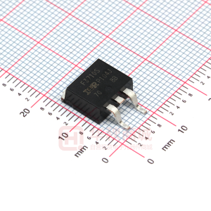

    IRF3710S - Power MOSFET(Vdss=100V, Rds(on)=0.025ohm, Id=57A) - International Rectifier
IRF3710S 数据手册
PD -91310C IRF3710S/L HEXFET® Power MOSFET l l l l l l Advanced Process Technology Surface Mount (IRF3710S) Low-profile through-hole (IRF3710L) 175°C Operating Temperature Fast Switching Fully Avalanche Rated D VDSS = 100V RDS(on) = 0.025Ω G Description Fifth Generation HEXFETs from International Rectifier utilize advanced processing techniques to achieve extremely low on-resistance per silicon area. This benefit, combined with the fast switching speed and ruggedized device design that HEXFET Power MOSFETs are well known for, provides the designer with an extremely efficient and reliable device for use in a wide variety of applications. The D2Pak is a surface mount power package capable of accommodating die sizes up to HEX-4. It provides the highest power capability and the lowest possible onresistance in any existing surface mount package. The D2Pak is suitable for high current applications because of its low internal connection resistance and can dissipate up to 2.0W in a typical surface mount application. The through-hole version (IRF3710L) is available for lowprofile applications. ID = 57A S D 2 P ak T O -26 2 Absolute Maximum Ratings Parameter ID @ TC = 25°C ID @ TC = 100°C IDM PD @TA = 25°C PD @TC = 25°C VGS EAS IAR EAR dv/dt TJ TSTG Continuous Drain Current, VGS @ 10V… Continuous Drain Current, VGS @ 10V… Pulsed Drain Current  … Power Dissipation Power Dissipation Linear Derating Factor Gate-to-Source Voltage Single Pulse Avalanche Energy‚… Avalanche Current Repetitive Avalanche Energy Peak Diode Recovery dv/dt ƒ … Operating Junction and Storage Temperature Range Soldering Temperature, for 10 seconds Max. 57 40 180 3.8 200 1.3 ± 20 530 28 20 5.0 -55 to + 175 300 (1.6mm from case ) Units A W W W/°C V mJ A mJ V/ns °C Thermal Resistance Parameter RθJC RθJA Junction-to-Case Junction-to-Ambient ( PCB Mounted,steady-state)** Typ. ––– ––– Max. 0.75 40 Units °C/W 5/13/98 IRF3710S/L Electrical Characteristics @ TJ = 25°C (unless otherwise specified) V(BR)DSS ∆V(BR)DSS/∆TJ RDS(on) VGS(th) gfs IDSS IGSS Qg Qgs Qgd td(on) tr td(off) tf LS Ciss Coss Crss Parameter Drain-to-Source Breakdown Voltage Breakdown Voltage Temp. Coefficient Static Drain-to-Source On-Resistance Gate Threshold Voltage Forward Transconductance Drain-to-Source Leakage Current Gate-to-Source Forward Leakage Gate-to-Source Reverse Leakage Total Gate Charge Gate-to-Source Charge Gate-to-Drain ("Miller") Charge Turn-On Delay Time Rise Time Turn-Off Delay Time Fall Time Internal Source Inductance Input Capacitance Output Capacitance Reverse Transfer Capacitance Min. 100 ––– ––– 2.0 20 ––– ––– ––– ––– ––– ––– ––– ––– ––– ––– ––– ––– ––– ––– ––– Typ. ––– 0.12 ––– ––– ––– ––– ––– ––– ––– ––– ––– ––– 14 59 58 48 7.5 3000 640 330 Max. Units Conditions ––– V VGS = 0V, ID = 250µA ––– V/°C Reference to 25°C, ID = 1mA … 0.025 Ω VGS = 10V, ID = 28A „ 4.0 V VDS = V GS, ID = 250µA ––– S VDS = 25V, ID = 28A… 25 VDS = 100V, VGS = 0V µA 250 VDS = 80V, VGS = 0V, TJ = 150°C 100 VGS = 20V nA -100 VGS = -20V 190 ID = 28A 26 nC VDS = 80V 82 VGS = 10V, See Fig. 6 and 13 „ … ––– VDD = 50V ––– ID = 28A ns ––– RG = 2.5Ω ––– RD = 1.7Ω, See Fig. 10 „ … Between lead, nH ––– and center of die contact ––– VGS = 0V ––– pF VDS = 25V ––– ƒ = 1.0MHz, See Fig. 5… Source-Drain Ratings and Characteristics IS ISM VSD trr Qrr ton Notes: Parameter Continuous Source Current (Body Diode) Pulsed Source Current (Body Diode) … Diode Forward Voltage Reverse Recovery Time Reverse RecoveryCharge Forward Turn-On Time Min. Typ. Max. Units Conditions D MOSFET symbol ––– ––– 57 showing the A G integral reverse ––– ––– 180 S p-n junction diode. ––– ––– 1.3 V TJ = 25°C, IS = 28A, VGS = 0V „ ––– 210 320 ns TJ = 25°C, IF = 28A ––– 1.7 2.6 µC di/dt = 100A/µs „ … Intrinsic turn-on time is negligible (turn-on is dominated by LS+LD)  Repetitive rating; pulse width limited by max. junction temperature. ( See fig. 11 ) „ Pulse width ≤ 300µs; duty cycle ≤ 2%. … Uses IRF3710 data and test conditions ‚ VDD = 25V, starting TJ = 25°C, L = 1.4mH RG = 25Ω, IAS = 28A. (See Figure 12) TJ ≤ 175°C ** When mounted on FR-4 board using minimum recommended footprint. For recommended footprint and soldering techniques refer to application note #AN-994. ƒ ISD ≤ 28A, di/dt ≤ 460A/µs, VDD ≤ V(BR)DSS, IRF3710S/L 1000 VGS 15V 10V 8.0V 7.0V 6.0V 5.5V 5.0V BOTTOM 4.5V TOP 1000 I , D rain-to-Source Current (A ) D 100 I , D rain-to-S ource C urrent (A ) D V GS 15V 10V 8.0V 7.0V 6.0V 5.5V 5.0V BOTTOM 4.5V TOP 100 4 .5V 10 10 4 .5 V 1 0.1 1 2 0 µ s P U LS E W ID TH TC = 2 5°C 10 100 A 1 0.1 2 0 µ s P U L S E W ID T H T C = 17 5°C 1 10 A 100 V D S , D rain-to-S ourc e V olta g e ( V ) V DS , D rain-to-S ource V olta g e ( V ) Fig 1. Typical Output Characteristics Fig 2. Typical Output Characteristics 1000 3.0 R D S (on ) , D rain -to-S ou rc e O n R es is tan c e (N orm a liz ed) I D = 46 A I D , D ra in -to-S ourc e C urrent (A) 2.5 TJ = 2 5 °C 100 2.0 T J = 1 7 5 °C 1.5 10 1.0 0.5 1 4 5 6 7 V DS = 50V 2 0 µ s P UL S E W ID TH 8 9 10 A 0.0 -60 -40 -20 0 20 40 60 80 V G S = 1 0V 100 120 140 160 180 A V G S , G ate-to -So urce Volta g e (V) T J , J unc tion T em perature (°C ) Fig 3. Typical Transfer Characteristics Fig 4. Normalized On-Resistance Vs. Temperature IRF3710S/L 6000 5000 C , Capacitance (pF) C i ss 4000 3000 V G S , G ate-to-S ource V oltage (V ) V GS C iss C rs s C o ss = = = = 0V , f = 1MHz C g s + C g d , C d s S H O R TE D C gd C ds + C g d 20 I D = 28 A V D S = 80 V V D S = 50 V V D S = 20 V 16 12 C o ss 2000 8 C r ss 1000 4 0 1 10 100 A 0 0 40 80 F O R TE S T C IR C U IT S E E FIG U R E 1 3 120 160 200 A V D S , D rain-to-S ourc e V olta g e ( V ) Q G , T otal G ate C har g e ( nC ) Fig 5. Typical Capacitance Vs. Drain-to-Source Voltage Fig 6. Typical Gate Charge Vs. Gate-to-Source Voltage 1000 1000 I S D , R everse Drain C urrent (A ) O P E R A T IO N IN T H IS A R E A L IM ITE D B Y R D S (o n) I D , D rain Current (A ) 100 100 10µ s T J = 17 5 °C T J = 2 5°C 10 100µ s 10 1m s 10m s 1 0.4 0.8 1.2 1.6 V G S = 0V A 1 1 T C = 2 5 °C T J = 17 5°C S in g le P u lse 10 100 2.0 A 1000 V S D , S ourc e-to-D rain V oltage (V ) V D S , D rain-to-S ource V olta g e ( V ) Fig 7. Typical Source-Drain Diode Forward Voltage Fig 8. Maximum Safe Operating Area IRF3710S/L 60 VDS 50 RD VGS RG D.U.T. + I D , Drain Current (A) 40 -VDD 10V 30 Pulse Width ≤ 1 µs Duty Factor ≤ 0.1 % 20 Fig 10a. Switching Time Test Circuit 10 VDS 90% 0 25 50 75 100 125 150 175 TC , Case Temperature ( °C) 10% VGS td(on) tr t d(off) tf Fig 9. Maximum Drain Current Vs. Case Temperature Fig 10b. Switching Time Waveforms 1 Thermal Response (Z thJC ) D = 0.50 0.20 0.1 0.10 0.05 0.02 0.01 P DM t1 SINGLE PULSE (THERMAL RESPONSE) Notes: 1. Duty factor D = t 1 / t 2 2. Peak T J = P DM x Z thJC + TC 0.0001 0.001 0.01 0.1 1 t2 0.01 0.00001 t1 , Rectangular Pulse Duration (sec) Fig 11. Maximum Effective Transient Thermal Impedance, Junction-to-Case IRF3710S/L 1200 E A S , S ingle P ulse A valanche E nergy (m J) TO P 1000 1 5V B O TTO M ID 11 A 2 0A 28 A VDS L D R IV E R 800 600 RG 20V tp D .U .T IA S + V - DD A 400 0 .0 1 Ω Fig 12a. Unclamped Inductive Test Circuit 200 0 V DD = 25 V 25 50 75 100 125 150 A 175 V (B R )D SS tp S tartin g T J , J unc tion T em perature ( °C ) Fig 12c. Maximum Avalanche Energy Vs. Drain Current IAS Fig 12b. Unclamped Inductive Waveforms Current Regulator Same Type as D.U.T. 50KΩ QG 12V .2µF .3µF 10 V QGS VG QGD VGS 3mA D.U.T. + V - DS Charge IG ID Current Sampling Resistors Fig 13a. Basic Gate Charge Waveform Fig 13b. Gate Charge Test Circuit IRF3710S/L Peak Diode Recovery dv/dt Test Circuit D.U.T + ƒ + Circuit Layout Considerations • Low Stray Inductance • Ground Plane • Low Leakage Inductance Current Transformer ‚ - „ +  RG • • • • dv/dt controlled by RG Driver same type as D.U.T. ISD controlled by Duty Factor "D" D.U.T. - Device Under Test + VDD Driver Gate Drive P.W. Period D= P.W. Period VGS=10V * D.U.T. ISD Waveform Reverse Recovery Current Body Diode Forward Current di/dt D.U.T. VDS Waveform Diode Recovery dv/dt VDD Re-Applied Voltage Inductor Curent Body Diode Forward Drop Ripple ≤ 5% ISD * VGS = 5V for Logic Level Devices Fig 14. For N-Channel HEXFETS IRF3710S/L D2Pak Package Outline 1 0.54 (.4 15) 1 0.29 (.4 05) 1.4 0 (.055 ) M AX. -A2 4.69 (.1 85) 4.20 (.1 65) -B 1.3 2 (.05 2) 1.2 2 (.04 8) 1 0.16 (.4 00 ) RE F. 6.47 (.2 55 ) 6.18 (.2 43 ) 15 .4 9 (.6 10) 14 .7 3 (.5 80) 5 .28 (.20 8) 4 .78 (.18 8) 2.7 9 (.110 ) 2.2 9 (.090 ) 2.61 (.1 03 ) 2.32 (.0 91 ) 1.3 9 (.0 5 5) 1.1 4 (.0 4 5) 8.8 9 (.3 50 ) R E F. 1.7 8 (.07 0) 1.2 7 (.05 0) 1 3 3X 1.40 (.0 55) 1.14 (.0 45) 5 .08 (.20 0) 0 .93 (.03 7 ) 3X 0 .69 (.02 7 ) 0 .25 (.01 0 ) M BAM 0.5 5 (.022 ) 0.4 6 (.018 ) M IN IM U M R E CO M M E ND E D F O O TP R IN T 1 1.43 (.4 50 ) NO TE S: 1 D IM EN S IO N S A FTER SO L D ER D IP. 2 D IM EN S IO N IN G & TO LE RA N C IN G PE R A N S I Y1 4.5M , 198 2. 3 C O N TRO L LIN G D IM EN SIO N : IN C H . 4 H E ATSINK & L EA D D IM EN S IO N S D O N O T IN C LU D E B UR R S. LE A D A SS IG N M E N TS 1 - G A TE 2 - D R AIN 3 - S O U RC E 8.89 (.3 50 ) 17 .78 (.70 0) 3 .8 1 (.15 0) 2 .08 (.08 2) 2X 2.5 4 (.100 ) 2X Part Marking Information D2Pak IN TE R N A TIO N A L R E C T IF IE R LO G O A S S E M B LY LO T C O D E PART NUM BER F530S 9 24 6 9B 1M A DATE CODE (Y YW W ) YY = Y E A R W W = W EEK IRF3710S/L Package Outline TO-262 Outline Part Marking Information TO-262 IRF3710S/L Tape & Reel Information D2Pak TR R 1 .6 0 (.0 6 3 ) 1 .5 0 (.0 5 9 ) 4 .1 0 (.1 6 1 ) 3 .9 0 (.1 5 3 ) 1 .6 0 (.0 6 3 ) 1 .5 0 (.0 5 9 ) 0 .3 6 8 (.0 1 4 5 ) 0 .3 4 2 (.0 1 3 5 ) F E E D D IRE CTIO N 1 .8 5 (.0 7 3 ) 1 .6 5 (.0 6 5 ) 1 1.6 0 (.4 57 ) 1 1.4 0 (.4 49 ) 1 5.4 2 (.6 0 9 ) 1 5.2 2 (.6 0 1 ) 2 4 .3 0 (.9 5 7 ) 2 3 .9 0 (.9 4 1 ) TR L 1 0.9 0 (.4 2 9 ) 1 0.7 0 (.4 2 1 ) 1 .7 5 (.0 6 9 ) 1 .2 5 (.0 4 9 ) 1 6 .1 0 (.6 3 4 ) 1 5 .9 0 (.6 2 6 ) 4 .7 2 (.1 3 6) 4 .5 2 (.1 7 8) F E E D D IRE CTIO N 13 .5 0 (.53 2) 12 .8 0 (.50 4) 27 .40 (1.0 79) 23 .90 (.94 1) 4 3 30 .0 0 (14.1 73) MAX. 60.00 (2.3 62) M IN . NO TES : 1. C O M F O R M S T O E IA-4 18. 2. C O N TR O LL IN G D IM E N S IO N : M IL LIM E T E R . 3. D IM E N S IO N M E A SU R E D @ H U B . 4. IN C LU D E S F L AN G E D IS T O R T IO N @ O U TE R E D G E. 26 .40 (1 .03 9) 24 .40 (.9 61 ) 3 30 .40 (1.19 7) MAX. 4 WORLD HEADQUARTERS: 233 Kansas St., El Segundo, California 90245, Tel: (310) 322 3331 EUROPEAN HEADQUARTERS: Hurst Green, Oxted, Surrey RH8 9BB, UK Tel: ++ 44 1883 732020 IR CANADA: 7321 Victoria Park Ave., Suite 201, Markham, Ontario L3R 2Z8, Tel: (905) 475 1897 IR GERMANY: Saalburgstrasse 157, 61350 Bad Homburg Tel: ++ 49 6172 96590 IR ITALY: Via Liguria 49, 10071 Borgaro, Torino Tel: ++ 39 11 451 0111 IR FAR EAST: K&H Bldg., 2F, 30-4 Nishi-Ikebukuro 3-Chome, Toshima-Ku, Tokyo Japan 171 Tel: 81 3 3983 0086 IR SOUTHEAST ASIA: 315 Outram Road, #10-02 Tan Boon Liat Building, Singapore 0316 Tel: 65 221 8371 http://www.irf.com/ Data and specifications subject to change without notice. 5/98
