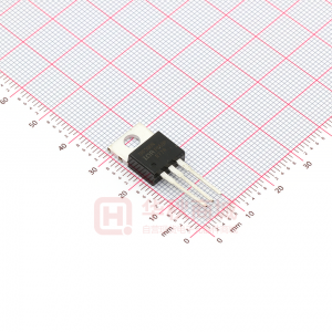

    IRF530N - Power MOSFET(Vdss=100V, Rds(on)=90mohm, Id=17A) - International Rectifier
IRF530N 数据手册
PD - 91351 IRF530N HEXFET® Power MOSFET l l l l l l Advanced Process Technology Ultra Low On-Resistance Dynamic dv/dt Rating 175°C Operating Temperature Fast Switching Fully Avalanche Rated D VDSS = 100V RDS(on) = 90mΩ G S ID = 17A Description Advanced HEXFET® Power MOSFETs from International Rectifier utilize advanced processing techniques to achieve extremely low on-resistance per silicon area. This benefit, combined with the fast switching speed and ruggedized device design that HEXFET power MOSFETs are well known for, provides the designer with an extremely efficient and reliable device for use in a wide variety of applications. The TO-220 package is universally preferred for all commercial-industrial applications at power dissipation levels to approximately 50 watts. The low thermal resistance and low package cost of the TO-220 contribute to its wide acceptance throughout the industry. TO-220AB Absolute Maximum Ratings Parameter ID @ TC = 25°C ID @ TC = 100°C IDM PD @TC = 25°C VGS IAR EAR dv/dt TJ TSTG Continuous Drain Current, VGS @ 10V Continuous Drain Current, VGS @ 10V Pulsed Drain Current  Power Dissipation Linear Derating Factor Gate-to-Source Voltage Avalanche Current Repetitive Avalanche Energy Peak Diode Recovery dv/dt ƒ Operating Junction and Storage Temperature Range Soldering Temperature, for 10 seconds Mounting torque, 6-32 or M3 srew Max. 17 12 60 70 0.47 ± 20 9.0 7.0 7.4 -55 to + 175 300 (1.6mm from case ) 10 lbf•in (1.1N•m) Units A W W/°C V A mJ V/ns °C Thermal Resistance Parameter RθJC RθCS RθJA Junction-to-Case Case-to-Sink, Flat, Greased Surface Junction-to-Ambient Typ. ––– 0.50 ––– Max. 2.15 ––– 62 Units °C/W www.irf.com 1 3/16/01 IRF530N Electrical Characteristics @ TJ = 25°C (unless otherwise specified) V(BR)DSS ∆V(BR)DSS/∆TJ RDS(on) VGS(th) gfs IDSS IGSS Qg Qgs Qgd td(on) tr td(off) tf LD LS Ciss Coss Crss EAS Parameter Drain-to-Source Breakdown Voltage Breakdown Voltage Temp. Coefficient Static Drain-to-Source On-Resistance Gate Threshold Voltage Forward Transconductance Drain-to-Source Leakage Current Gate-to-Source Forward Leakage Gate-to-Source Reverse Leakage Total Gate Charge Gate-to-Source Charge Gate-to-Drain ("Miller") Charge Turn-On Delay Time Rise Time Turn-Off Delay Time Fall Time Internal Drain Inductance Internal Source Inductance Input Capacitance Output Capacitance Reverse Transfer Capacitance Single Pulse Avalanche Energy‚ Min. 100 ––– ––– 2.0 12 ––– ––– ––– ––– ––– ––– ––– ––– ––– ––– ––– ––– ––– Typ. ––– 0.11 ––– ––– ––– ––– ––– ––– ––– ––– ––– ––– 9.2 22 35 25 4.5 7.5 ––– 920 ––– 130 ––– 19 ––– 340… Max. Units Conditions ––– V VGS = 0V, ID = 250µA ––– V/°C Reference to 25°C, ID = 1mA 90 mΩ VGS = 10V, ID = 9.0A „ 4.0 V VDS = VGS, ID = 250µA ––– S VDS = 50V, ID = 9.0A„ 25 VDS = 100V, VGS = 0V µA 250 VDS = 80V, VGS = 0V, TJ = 150°C 100 VGS = 20V nA -100 VGS = -20V 37 ID = 9.0A 7.2 nC VDS = 80V 11 VGS = 10V, See Fig. 6 and 13 ––– VDD = 50V ––– ID = 9.0A ns ––– RG = 12Ω ––– VGS = 10V, See Fig. 10 „ Between lead, ––– 6mm (0.25in.) nH G from package ––– and center of die contact ––– VGS = 0V ––– VDS = 25V ––– pF ƒ = 1.0MHz, See Fig. 5 93 † mJ IAS = 9.0A, L = 2.3mH D S Source-Drain Ratings and Characteristics IS ISM VSD trr Qrr ton Notes: Parameter Continuous Source Current (Body Diode) Pulsed Source Current (Body Diode) Diode Forward Voltage Reverse Recovery Time Reverse Recovery Charge Forward Turn-On Time Min. Typ. Max. Units Conditions D MOSFET symbol 17 ––– ––– showing the A G integral reverse 60 ––– ––– S p-n junction diode. ––– ––– 1.3 V TJ = 25°C, IS = 9.0A, VGS = 0V „ ––– 93 140 ns TJ = 25°C, I F = 9.0A ––– 320 480 nC di/dt = 100A/µs „ Intrinsic turn-on time is negligible (turn-on is dominated by LS+LD)  Repetitive rating; pulse width limited by max. junction temperature. (See fig. 11) „ Pulse width ≤ 400µs; duty cycle ≤ 2%. … This is a typical value at device destruction and represents operation outside rated limits. ‚ Starting TJ = 25°C, L = 2.3mH TJ ≤ 175°C RG = 25Ω, IAS = 9.0A, VGS=10V (See Figure 12) † This is a calculated value limited to TJ = 175°C . ƒ ISD ≤ 9.0A, di/dt ≤ 410A/µs, VDD ≤ V(BR)DSS, 2 www.irf.com IRF530N 100 VGS 15V 10V 8.0V 7.0V 6.0V 5.5V 5.0V BOTTOM 4.5V TOP 100 I D , Drain-to-Source Current (A) I D , Drain-to-Source Current (A) VGS 15V 10V 8.0V 7.0V 6.0V 5.5V 5.0V BOTTOM 4.5V TOP 4.5V 10 10 4.5V 1 0.1 20µs PULSE WIDTH TJ = 25 °C 1 10 100 1 0.1 20µs PULSE WIDTH TJ = 175 °C 1 10 100 VDS , Drain-to-Source Voltage (V) VDS , Drain-to-Source Voltage (V) Fig 1. Typical Output Characteristics Fig 2. Typical Output Characteristics 100 3.5 ID = 15A RDS(on) , Drain-to-Source On Resistance (Normalized) I D , Drain-to-Source Current (A) 3.0 2.5 TJ = 25 ° C TJ = 175 ° C 2.0 1.5 1.0 0.5 0.0 -60 -40 -20 10 4.0 V DS = 50V 20µs PULSE WIDTH 5.0 6.0 7.0 8.0 VGS = 10V 0 20 40 60 80 100 120 140 160 180 VGS , Gate-to-Source Voltage (V) TJ , Junction Temperature ( °C) Fig 3. Typical Transfer Characteristics Fig 4. Normalized On-Resistance Vs. Temperature www.irf.com 3 IRF530N 1600 VGS , Gate-to-Source Voltage (V) VGS = 0V, f = 1MHz Ciss = Cgs + Cgd , Cds SHORTED Crss = Cgd Coss = Cds + Cgd 20 ID = 9.0A VDS = 80V VDS = 50V VDS = 20V 16 1200 C, Capacitance (pF) Ciss 12 800 Coss 400 8 Crss 0 1 10 100 4 0 0 10 20 FOR TEST CIRCUIT SEE FIGURE 13 30 40 VDS , Drain-to-Source Voltage (V) Q G , Total Gate Charge (nC) Fig 5. Typical Capacitance Vs. Drain-to-Source Voltage Fig 6. Typical Gate Charge Vs. Gate-to-Source Voltage 100 1000 OPERATION IN THIS AREA LIMITED BY R DS (on) TJ = 175 ° C ISD , Reverse Drain Current (A) ID , Drain-to-Source Current (A) 100 10 10 100µsec 1 1msec 1 Tc = 25°C Tj = 175°C Single Pulse 1 10 100 10msec TJ = 25 ° C V GS = 0 V 0.4 0.6 0.8 1.0 1.2 1.4 0.1 0.2 0.1 VSD ,Source-to-Drain Voltage (V) 1000 VDS , Drain-toSource Voltage (V) Fig 7. Typical Source-Drain Diode Forward Voltage Fig 8. Maximum Safe Operating Area 4 www.irf.com IRF530N 20 VDS 16 RD VGS RG D.U.T. + I D , Drain Current (A) -VDD 12 VGS 8 Pulse Width ≤ 1 µs Duty Factor ≤ 0.1 % Fig 10a. Switching Time Test Circuit 4 VDS 90% 0 25 50 75 100 125 150 175 TC , Case Temperature ( °C) 10% VGS td(on) tr t d(off) tf Fig 9. Maximum Drain Current Vs. Case Temperature Fig 10b. Switching Time Waveforms 10 Thermal Response (Z thJC ) 1 D = 0.50 0.20 0.10 0.05 P DM SINGLE PULSE (THERMAL RESPONSE) t1 t2 Notes: 1. Duty factor D = t 1 / t 2 2. Peak T J = P DM x Z thJC + TC 0.0001 0.001 0.01 0.1 0.1 0.02 0.01 0.01 0.00001 t1 , Rectangular Pulse Duration (sec) Fig 11. Maximum Effective Transient Thermal Impedance, Junction-to-Case www.irf.com 5 IRF530N 200 EAS , Single Pulse Avalanche Energy (mJ) 1 5V TOP 160 VDS L D R IV E R BOTTOM ID 3.7A 6.4A 9.0A RG VV 2 0GS D .U .T IA S tp 0 .0 1 Ω + - VD D 120 A 80 Fig 12a. Unclamped Inductive Test Circuit V (B R )D SS tp 40 0 25 50 75 100 125 150 175 Starting TJ , Junction Temperature ( °C) Fig 12c. Maximum Avalanche Energy Vs. Drain Current IAS Fig 12b. Unclamped Inductive Waveforms Current Regulator Same Type as D.U.T. 50KΩ QG 12V .2µF .3µF VGS QGS VG QGD VGS 3mA D.U.T. + V - DS IG ID Charge Current Sampling Resistors Fig 13a. Basic Gate Charge Waveform Fig 13b. Gate Charge Test Circuit 6 www.irf.com IRF530N Peak Diode Recovery dv/dt Test Circuit D.U.T* + ƒ + Circuit Layout Considerations • Low Stray Inductance • Ground Plane • Low Leakage Inductance Current Transformer ‚ - „ +  RG VGS • dv/dt controlled by RG • ISD controlled by Duty Factor "D" • D.U.T. - Device Under Test + VDD * Reverse Polarity of D.U.T for P-Channel Driver Gate Drive P.W. Period D= P.W. Period [VGS=10V ] *** D.U.T. ISD Waveform Reverse Recovery Current Body Diode Forward Current di/dt D.U.T. VDS Waveform Diode Recovery dv/dt [VDD] Re-Applied Voltage Inductor Curent Body Diode Forward Drop Ripple ≤ 5% [ ISD ] *** VGS = 5.0V for Logic Level and 3V Drive Devices Fig 14. For N-channel HEXFET® power MOSFETs www.irf.com 7 IRF530N Package Outline TO-220AB Dimensions are shown in millimeters (inches) 2.87 (.11 3) 2.62 (.10 3) 10 .54 (.4 15) 10 .29 (.4 05) 3 .7 8 (.149 ) 3 .5 4 (.139 ) -A 6.47 (.25 5) 6.10 (.24 0) -B 4.69 ( .18 5 ) 4.20 ( .16 5 ) 1 .32 (.05 2) 1 .22 (.04 8) 4 1 5.24 (.60 0) 1 4.84 (.58 4) 1.15 (.04 5) M IN 1 2 3 L E A D A S S IG NM E NT S 1 - GATE 2 - D R A IN 3 - S O U RC E 4 - D R A IN 1 4.09 (.55 5) 1 3.47 (.53 0) 4.06 (.16 0) 3.55 (.14 0) 3X 3X 1 .4 0 (.0 55 ) 1 .1 5 (.0 45 ) 0.93 (.03 7) 0.69 (.02 7) M BAM 3X 0.55 (.02 2) 0.46 (.01 8) 0 .3 6 (.01 4) 2.54 (.10 0) 2X N O TE S : 1 D IM E N S IO N IN G & TO L E R A N C ING P E R A N S I Y 1 4.5M , 1 9 82. 2 C O N TR O L LIN G D IM E N S IO N : IN C H 2 .92 (.11 5) 2 .64 (.10 4) 3 O U T LIN E C O N F O R M S TO JE D E C O U T LIN E TO -2 20 A B . 4 H E A TS IN K & LE A D M E A S U R E M E N T S D O N O T IN C LU DE B U R R S . Part Marking Information TO-220AB E X A M P L E : TH IS IS A N IR F1 0 1 0 W IT H A S S E M B L Y LOT C ODE 9B1M A IN TE R N A TIO N A L R E C TIF IE R LOGO ASSEMBLY LOT CO DE PART NU MBER IR F 10 1 0 9246 9B 1M D A TE C O D E (Y Y W W ) YY = YEAR W W = W EEK Data and specifications subject to change without notice. This product has been designed and qualified for the Industrial market. Qualification Standards can be found on IR’s Web site. IR WORLD HEADQUARTERS: 233 Kansas St., El Segundo, California 90245, USA Tel: (310) 252-7105 TAC Fax: (310) 252-7903 Visit us at www.irf.com for sales contact information.3/01 8 www.irf.com
