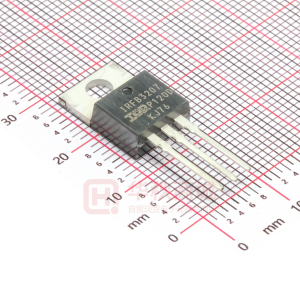

PD - 96893A IRFB3207 IRFS3207 IRFSL3207 Applications l High Efficiency Synchronous Rectification in SMPS l Uninterruptible Power Supply l High Speed Power Switching l Hard Switched and High Frequency Circuits Benefits l Worldwide Best RDS(on) in TO-220 l Improved Gate, Avalanche and Dynamic dV/dt Ruggedness l Fully Characterized Capacitance and Avalanche SOA l Enhanced body diode dV/dt and dI/dt Capability G S HEXFET® Power MOSFET D VDSS RDS(on) typ. max. ID 75V 3.6m: 4.5m: 180A GDS TO-220AB IRFB3207 GDS D2Pak IRFS3207 GDS TO-262 IRFSL3207 Absolute Maximum Ratings Symbol ID @ TC = 25°C ID @ TC = 100°C IDM PD @TC = 25°C VGS dV/dt TJ TSTG Parameter Continuous Drain Current, VGS @ 10V Continuous Drain Current, VGS @ 10V Pulsed Drain Current d Maximum Power Dissipation Linear Derating Factor Gate-to-Source Voltage Peak Diode Recovery f Operating Junction and Storage Temperature Range Soldering Temperature, for 10 seconds (1.6mm from case) Mounting torque, 6-32 or M3 screw Max. 180c 130c 720 330 2.2 ± 20 5.8 -55 to + 175 300 10lbxin (1.1Nxm) 910 See Fig. 14, 15, 16a, 16b, Units A W W/°C V V/ns °C Avalanche Characteristics EAS (Thermally limited) IAR EAR Single Pulse Avalanche Energy e Avalanche Current c Repetitive Avalanche Energy g mJ A mJ Thermal Resistance Symbol RθJC RθCS RθJA RθJA Parameter Junction-to-Case k Case-to-Sink, Flat Greased Surface , TO-220 Junction-to-Ambient, TO-220 k Junction-to-Ambient (PCB Mount) , D Pak jk 2 Typ. ––– 0.50 ––– ––– Max. 0.45 ––– 62 40 Units °C/W www.irf.com 1 11/3/04 IRF/B/S/SL3207 Static @ TJ = 25°C (unless otherwise specified) Symbol V(BR)DSS Parameter Drain-to-Source Breakdown Voltage Min. Typ. Max. Units 75 ––– ––– 2.0 ––– ––– ––– ––– ––– ––– 0.69 3.6 ––– ––– ––– ––– ––– 1.2 ––– ––– 4.5 4.0 20 250 200 -200 ––– Ω nA V Conditions VGS = 0V, ID = 250µA ∆V(BR)DSS/∆TJ Breakdown Voltage Temp. Coefficient RDS(on) Static Drain-to-Source On-Resistance VGS(th) IDSS IGSS RG Gate Threshold Voltage Drain-to-Source Leakage Current Gate-to-Source Forward Leakage Gate-to-Source Reverse Leakage Gate Input Resistance V/°C Reference to 25°C, ID = 1mAd mΩ VGS = 10V, ID = 75A g V µA VDS = VGS, ID = 250µA VDS = 75V, VGS = 0V VDS = 75V, VGS = 0V, TJ = 125°C VGS = 20V VGS = -20V f = 1MHz, open drain Dynamic @ TJ = 25°C (unless otherwise specified) Symbol gfs Qg Qgs Qgd td(on) tr td(off) tf Ciss Coss Crss Parameter Forward Transconductance Total Gate Charge Gate-to-Source Charge Gate-to-Drain ("Miller") Charge Turn-On Delay Time Rise Time Turn-Off Delay Time Fall Time Input Capacitance Output Capacitance Min. Typ. Max. Units 150 ––– ––– ––– ––– ––– ––– ––– ––– ––– ––– 180 48 68 29 120 68 74 7600 710 390 920 1010 ––– 260 ––– ––– ––– ––– ––– ––– ––– ––– ––– ––– ––– pF ns S nC ID = 75A VDS = 60V VGS = 10V g VDD = 48V ID = 75A RG = 2.6Ω VGS = 10V g VGS = 0V VDS = 50V ƒ = 1.0MHz Conditions VDS = 50V, ID = 75A Reverse Transfer Capacitance ––– Coss eff. (ER) Effective Output Capacitance (Energy Related) ––– Coss eff. (TR) Effective Output Capacitance (Time Related)h ––– VGS = 0V, VDS = 0V to 60V j, See Fig.11 VGS = 0V, VDS = 0V to 60V h, See Fig. 5 Diode Characteristics Symbol IS ISM VSD trr Qrr IRRM ton Parameter Continuous Source Current (Body Diode) Pulsed Source Current (Body Diode) di Diode Forward Voltage Reverse Recovery Time Reverse Recovery Charge Reverse Recovery Current Forward Turn-On Time Min. Typ. Max. Units ––– ––– ––– ––– ––– ––– ––– ––– ––– 180c ––– ––– 42 49 65 92 2.6 720 1.3 63 74 98 140 ––– A nC V ns A Conditions MOSFET symbol showing the integral reverse p-n junction diode. TJ = 25°C, IS = 75A, VGS = 0V g VR = 64V, TJ = 25°C TJ = 125°C TJ = 25°C TJ = 125°C TJ = 25°C IF = 75A di/dt = 100A/µs g G S D Intrinsic turn-on time is negligible (turn-on is dominated by LS+LD) Notes:  Calculated continuous current based on maximum allowable junction temperature. Package limitation current is 75A ‚ Repetitive rating; pulse width limited by max. junction temperature. ƒ Limited by TJmax, starting TJ = 25°C, L = 0.33mH RG = 25Ω, IAS = 75A, VGS =10V. Part not recommended for use above this value. „ ISD ≤ 75A, di/dt ≤ 500A/µs, VDD ≤ V(BR)DSS, TJ ≤ 175°C. … Pulse width ≤ 400µs; duty cycle ≤ 2%. † Coss eff. (TR) is a fixed capacitance that gives the same charging time as Coss while VDS is rising from 0 to 80% VDSS. ‡ Coss eff. (ER) is a fixed capacitance that gives the same energy as ˆ When mounted on 1" square PCB (FR-4 or G-10 Material). For recom ‰ Rθ is measured at TJ approximately 90°C Coss while VDS is rising from 0 to 80% VDSS. mended footprint and soldering techniques refer to application note #AN-994. 2 www.irf.com IRF/B/S/SL3207 1000 TOP VGS 15V 10V 8.0V 6.0V 5.5V 5.0V 4.8V 4.5V 1000 TOP VGS 15V 10V 8.0V 6.0V 5.5V 5.0V 4.8V 4.5V ID, Drain-to-Source Current (A) 100 BOTTOM ID, Drain-to-Source Current (A) BOTTOM 100 10 4.5V ≤ 60µs PULSE WIDTH Tj = 175°C 10 0.1 1 10 100 4.5V 1 0.1 1 ≤ 60µs PULSE WIDTH Tj = 25°C 10 100 VDS , Drain-to-Source Voltage (V) VDS , Drain-to-Source Voltage (V) Fig 1. Typical Output Characteristics 1000.0 2.5 Fig 2. Typical Output Characteristics RDS(on) , Drain-to-Source On Resistance ID = 75A 2.0 ID, Drain-to-Source Current(Α) TJ = 175°C 100.0 VGS = 10V TJ = 25°C (Normalized) 1.5 10.0 1.0 VDS = 50V 1.0 4.0 5.0 6.0 7.0 ≤ 60µs PULSE WIDTH 8.0 9.0 0.5 -60 -40 -20 0 20 40 60 80 100 120 140 160 180 VGS, Gate-to-Source Voltage (V) TJ , Junction Temperature (°C) Fig 3. Typical Transfer Characteristics 12000 VGS = 0V, f = 1 MHZ Ciss = Cgs + Cgd, Cds SHORTED Crss = Cgd Coss = Cds + Cgd Fig 4. Normalized On-Resistance vs. Temperature 20 ID= 75A VGS, Gate-to-Source Voltage (V) VDS = 60V VDS= 38V 10000 16 C, Capacitance (pF) 8000 Ciss 12 6000 8 4000 4 2000 Coss Crss 1 10 100 0 0 0 40 80 120 160 200 240 280 QG Total Gate Charge (nC) VDS , Drain-to-Source Voltage (V) Fig 5. Typical Capacitance vs. Drain-to-Source Voltage Fig 6. Typical Gate Charge vs. Gate-to-Source Voltage www.irf.com 3 IRF/B/S/SL3207 1000.0 10000 ID, Drain-to-Source Current (A) OPERATION IN THIS AREA LIMITED BY R DS (on) ISD , Reverse Drain Current (A) 100.0 TJ = 175°C 1000 100 100µsec 10.0 10 1.0 TJ = 25°C 1 VGS = 0V 0.1 0.2 0.4 0.6 0.8 1.0 1.2 1.4 1.6 1.8 2.0 2.2 Tc = 25°C Tj = 175°C Single Pulse 1 10 1msec 10msec DC 100 1000 0.1 VSD, Source-to-Drain Voltage (V) VDS , Drain-toSource Voltage (V) Fig 7. Typical Source-Drain Diode Forward Voltage V(BR)DSS , Drain-to-Source Breakdown Voltage Fig 8. Maximum Safe Operating Area 100 200 LIMITED BY PACKAGE 150 ID , Drain Current (A) 90 100 80 50 0 25 50 75 100 125 150 175 TC , Case Temperature (°C) 70 -60 -40 -20 0 20 40 60 80 100 120 140 160 180 TJ , Junction Temperature (°C) Fig 9. Maximum Drain Current vs. Case Temperature 3.0 Fig 10. Drain-to-Source Breakdown Voltage 4000 EAS, Single Pulse Avalanche Energy (mJ) 2.5 3000 ID 12A 16A BOTTOM 75A TOP 2.0 Energy (µJ) 1.5 2000 1.0 1000 0.5 0.0 20 30 40 50 60 70 80 0 25 50 75 100 125 150 175 VDS, Drain-to-Source Voltage (V) Starting TJ, Junction Temperature (°C) Fig 11. Typical COSS Stored Energy Fig 12. Maximum Avalanche Energy Vs. DrainCurrent 4 www.irf.com IRF/B/S/SL3207 1 D = 0.50 Thermal Response ( Z thJC ) 0.1 0.20 0.10 0.05 0.02 0.01 τJ R1 R1 τJ τ1 τ2 R2 R2 τC τ τ2 0.01 Ri (°C/W) τi (sec) 0.2151 0.001175 0.2350 0.017994 τ1 0.001 Ci= τi/Ri Ci i/Ri SINGLE PULSE ( THERMAL RESPONSE ) 0.0001 1E-006 1E-005 0.0001 0.001 Notes: 1. Duty Factor D = t1/t2 2. Peak Tj = P dm x Zthjc + Tc 0.01 0.1 t1 , Rectangular Pulse Duration (sec) Fig 13. Maximum Effective Transient Thermal Impedance, Junction-to-Case 10000 Duty Cycle = Single Pulse Avalanche Current (A) 1000 100 0.01 0.05 Allowed avalanche Current vs avalanche pulsewidth, tav assuming ∆ Tj = 25°C due to avalanche losses. Note: In no case should Tj be allowed to exceed Tjmax 10 0.10 1 1.0E-06 1.0E-05 1.0E-04 1.0E-03 1.0E-02 1.0E-01 tav (sec) Fig 14. Typical Avalanche Current vs.Pulsewidth 1000 EAR , Avalanche Energy (mJ) 800 TOP Single Pulse BOTTOM 1% Duty Cycle ID = 75A 600 400 200 Notes on Repetitive Avalanche Curves , Figures 14, 15: (For further info, see AN-1005 at www.irf.com) 1. Avalanche failures assumption: Purely a thermal phenomenon and failure occurs at a temperature far in excess of Tjmax. This is validated for every part type. 2. Safe operation in Avalanche is allowed as long asTjmax is not exceeded. 3. Equation below based on circuit and waveforms shown in Figures 16a, 16b. 4. PD (ave) = Average power dissipation per single avalanche pulse. 5. BV = Rated breakdown voltage (1.3 factor accounts for voltage increase during avalanche). 6. Iav = Allowable avalanche current. 7. ∆T = Allowable rise in junction temperature, not to exceed Tjmax (assumed as 25°C in Figure 14, 15). tav = Average time in avalanche. D = Duty cycle in avalanche = tav ·f ZthJC(D, tav) = Transient thermal resistance, see Figures 13) 175 0 25 50 75 100 125 150 Starting TJ , Junction Temperature (°C) PD (ave) = 1/2 ( 1.3·BV·Iav) = DT/ ZthJC Iav = 2DT/ [1.3·BV·Zth] EAS (AR) = PD (ave)·tav Fig 15. Maximum Avalanche Energy vs. Temperature www.irf.com 5 IRF/B/S/SL3207 5.0 16 VGS(th) Gate threshold Voltage (V) 4.5 4.0 3.5 3.0 2.5 2.0 1.5 -75 -50 -25 0 25 50 75 ID = 1.0A ID = 1.0mA ID = 250µA IRRM - (A) 14 12 10 8 6 4 2 IF = 30A VR = 64V TJ = 125°C TJ = 25°C 100 200 300 400 500 600 700 800 900 1000 100 125 150 175 TJ , Temperature ( °C ) dif / dt - (A / µs) Fig 16. Threshold Voltage Vs. Temperature 16 14 12 10 8 6 4 2 IF = 45A VR = 64V TJ = 125°C TJ = 25°C Fig. 17 - Typical Recovery Current vs. dif/dt 400 300 QRR - (nC) IRRM - (A) 200 100 IF = 30A VR = 64V TJ = 125°C TJ = 25°C 100 200 300 400 500 600 700 800 900 1000 0 100 200 300 400 500 600 700 800 900 1000 dif / dt - (A / µs) dif / dt - (A / µs) Fig. 18 - Typical Recovery Current vs. dif/dt 400 Fig. 19 - Typical Stored Charge vs. dif/dt 300 QRR - (nC) 200 100 IF = 45A VR = 64V TJ = 125°C TJ = 25°C 0 100 200 300 400 500 600 700 800 900 1000 dif / dt - (A / µs) 6 Fig. 20 - Typical Stored Charge vs. dif/dt www.irf.com IRF/B/S/SL3207 D.U.T Driver Gate Drive + P.W. Period D= P.W. Period VGS=10V ƒ + Circuit Layout Considerations • Low Stray Inductance • Ground Plane • Low Leakage Inductance Current Transformer * D.U.T. ISD Waveform Reverse Recovery Current Body Diode Forward Current di/dt D.U.T. VDS Waveform Diode Recovery dv/dt ‚ - - „ +  RG • • • • dv/dt controlled by RG Driver same type as D.U.T. ISD controlled by Duty Factor "D" D.U.T. - Device Under Test VDD VDD + - Re-Applied Voltage Body Diode Forward Drop Inductor Curent Inductor Current Ripple ≤ 5% ISD * VGS = 5V for Logic Level Devices Fig 21. Peak Diode Recovery dv/dt Test Circuit for N-Channel HEXFET® Power MOSFETs V(BR)DSS 15V tp DRIVER VDS L RG VGS 20V D.U.T IAS tp + V - DD A 0.01Ω I AS Fig 22a. Unclamped Inductive Test Circuit LD VDS Fig 22b. Unclamped Inductive Waveforms + VDD D.U.T VGS Pulse Width < 1µs Duty Factor < 0.1% 90% VDS 10% VGS td(on) tr td(off) tf Fig 23a. Switching Time Test Circuit Fig 23b. Switching Time Waveforms Id Vds Vgs L 0 DUT 1K VCC Vgs(th) Qgs1 Qgs2 Qgd Qgodr www.irf.com Fig 24a. Gate Charge Test Circuit Fig 24b. Gate Charge Waveform 7 IRF/B/S/SL3207 TO-220AB Package Outline Dimensions are shown in millimeters (inches) 2.87 (.113) 2.62 (.103) 10.54 (.415) 10.29 (.405) 3.78 (.149) 3.54 (.139) -A6.47 (.255) 6.10 (.240) -B4.69 (.185) 4.20 (.165) 1.32 (.052) 1.22 (.048) 4 15.24 (.600) 14.84 (.584) 1.15 (.045) MIN 1 2 3 LEAD ASSIGNMENTS 1 - GATE 2 - DRAIN 3 - SOURCE 4 - DRAIN 14.09 (.555) 13.47 (.530) 4.06 (.160) 3.55 (.140) 3X 1.40 (.055) 3X 1.15 (.045) 2.54 (.100) 2X NOTES: 0.93 (.037) 0.69 (.027) M BAM 3X 0.55 (.022) 0.46 (.018) 0.36 (.014) 2.92 (.115) 2.64 (.104) 1 DIMENSIONING & TOLERANCING PER ANSI Y14.5M, 1982. 2 CONTROLLING DIMENSION : INCH 3 OUTLINE CONFORMS TO JEDEC OUTLINE TO-220AB. 4 HEATSINK & LEAD MEASUREMENTS DO NOT INCLUDE BURRS. TO-220AB Part Marking Information E XAMPL E : T HIS IS AN IR F 1010 L OT CODE 1789 AS S E MB L E D ON WW 19, 1997 IN T H E AS S E MB L Y L INE "C" INT E R NAT IONAL R E CT IF IE R L OGO AS S E MB L Y L OT CODE PAR T NU MB E R Note: "P" in assembly line position indicates "Lead-Free" DAT E CODE YE AR 7 = 1997 WE E K 19 L INE C TO-220AB packages are not recommended for Surface Mount Application. 8 www.irf.com IRF/B/S/SL3207 TO-262 Package Outline (Dimensions are shown in millimeters (inches)) IGBT 1- GATE 2- COLLECTOR 3- EMITTER 4- COLLECTOR TO-262 Part Marking Information EXAMPLE: THIS IS AN IRL3103L LOT CODE 1789 AS SEMBLED ON WW 19, 1997 IN THE ASS EMBLY LINE "C" Note: "P" in as sembly line pos ition indicates "Lead-Free" INTERNATIONAL RECTIFIER LOGO ASS EMBLY LOT CODE PART NUMBER DAT E CODE YEAR 7 = 1997 WEEK 19 LINE C OR INT ERNATIONAL RECTIFIER LOGO AS SEMBLY LOT CODE PART NUMBER DAT E CODE P = DES IGNATES LEAD-FREE PRODUCT (OPTIONAL) YEAR 7 = 1997 WEEK 19 A = AS SEMBLY SITE CODE www.irf.com 9 IRF/B/S/SL3207 D2Pak Package Outline (Dimensions are shown in millimeters (inches)) D2Pak Part Marking Information T HIS IS AN IRF530S WITH LOT CODE 8024 AS S EMBLED ON WW 02, 2000 IN T HE AS S EMBLY LINE "L" Note: "P" in assembly line pos ition indicates "Lead-Free" INT ERNAT IONAL RECT IFIER LOGO AS S EMBLY LOT CODE PART NUMBER F530S DAT E CODE YEAR 0 = 2000 WEEK 02 LINE L OR INT ERNAT IONAL RECT IFIER LOGO AS S EMBLY LOT CODE PART NUMBER F530S DAT E CODE P = DES IGNAT ES LEAD-FREE PRODUCT (OPT IONAL) YEAR 0 = 2000 WEEK 02 A = AS S EMBLY S IT E CODE 10 www.irf.com IRF/B/S/SL3207 D2Pak Tape & Reel Information TRR 1.60 (.063) 1.50 (.059) 4.10 (.161) 3.90 (.153) 1.60 (.063) 1.50 (.059) 0.368 (.0145) 0.342 (.0135) FEED DIRECTION 1.85 (.073) 1.65 (.065) 11.60 (.457) 11.40 (.449) 15.42 (.609) 15.22 (.601) 24.30 (.957) 23.90 (.941) TRL 10.90 (.429) 10.70 (.421) 1.75 (.069) 1.25 (.049) 16.10 (.634) 15.90 (.626) 4.72 (.136) 4.52 (.178) FEED DIRECTION 13.50 (.532) 12.80 (.504) 27.40 (1.079) 23.90 (.941) 4 330.00 (14.173) MAX. 60.00 (2.362) MIN. NOTES : 1. COMFORMS TO EIA-418. 2. CONTROLLING DIMENSION: MILLIMETER. 3. DIMENSION MEASURED @ HUB. 4. INCLUDES FLANGE DISTORTION @ OUTER EDGE. 26.40 (1.039) 24.40 (.961) 3 30.40 (1.197) MAX. 4 Data and specifications subject to change without notice. This product has been designed and qualified for the Automotive [Q101] market. Qualification Standards can be found on IR’s Web site. IR WORLD HEADQUARTERS: 233 Kansas St., El Segundo, California 90245, USA Tel: (310) 252-7105 TAC Fax: (310) 252-7903 Visit us at www.irf.com for sales contact information. 11/04 www.irf.com 11
