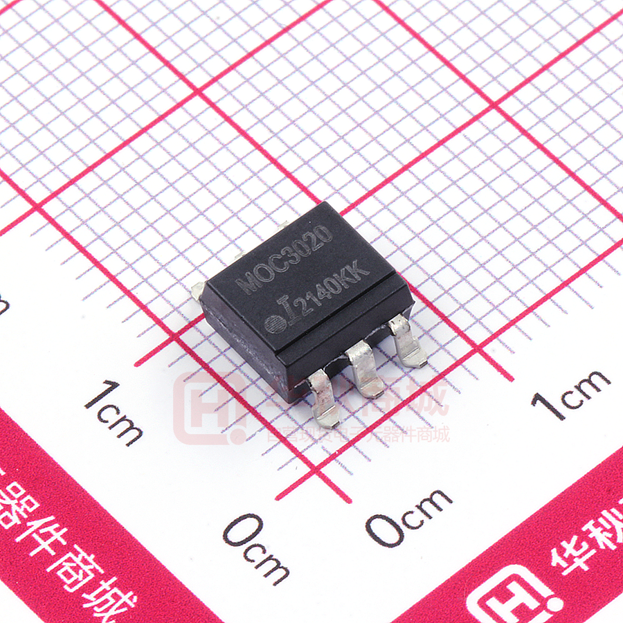

    单向光耦 Viso=5300Vrms VF(typ)=1.2V IF=50mA Vo=400V OC_7.12X6.5MM_SM
MOC3020SM 数据手册
MOC3020X, MOC3021X, MOC3022X, MOC3023X MOC3020, MOC3021, MOC3022, MOC3023 OPTICALLY COUPLED BILATERAL SWITCH NON-ZERO CROSSING TRIAC APPROVALS z UL recognised, File No. E91231 under Package System 'KK' 'X' SPECIFICATIONAPPROVALS z VDE 0884 in 3 available lead forms : - STD - G form - SMD approved to CECC 00802 Dimensions in mm 2.54 7.0 6.0 1 6 2 5 3 4 1.2 7.62 6.62 7.62 4.0 3.0 13° Max 0.5 DESCRIPTION 3.0 The MOC302_ series are optically coupled isolators consisting of a Gallium Arsenide infrared emitting diode coupled with a light activated silicon bilateral switch performing the functions of a triac mounted in a standard 6 pin dual-in-line package. FEATURE z Options :10mm lead spread - add G after part no. Surface mount - add SM after part no. Tape&reel - add SMT&R after part no. z High Isolation Voltage (5.3kVRMS ,7.5kVPK ) z 400V Peak Blocking Voltage z All electrical parameters 100% tested z Custom electrical selections available APPLICATIONS CRTs z Power Triac Driver z Motors z Consumer appliances z Printers z OPTION SM 3.35 0.26 ABSOLUTE MAXIMUM RATINGS (25 °C unless otherwise noted) Storage Temperature -550C - +1500C Operating Temperature -400C - +1000C Lead Soldering Temperature 2600C (1.6mm from case for 10 seconds) INPUTDIODE Forward Current 50mA Reverse Voltage 6V Power Dissipation 70mW (derate linearly 0.93mW/0C above 250C) OUTPUT PHOTO TRIAC OPTION G SURFACE MOUNT 0.5 7.62 Off-State Output Terminal Voltage 400V Forward Current (Peak) 1A Power Dissipation 300mW (derate linearly 4.0mW/0C above 250C) POWER DISSIPATION 0.6 0.1 10.46 9.86 1.25 0.75 0.26 Total Power Dissipation 330mW (derate linearly 4.4mW/0C above 250C) 10.16 ISOCOM COMPONENTS 2004 LTD Unit 25B, Park View Road West, Park View Industrial Estate, Brenda Road Hartlepool, Cleveland, TS25 1UD Tel: (01429) 863609 Fax :(01429) 863581 17/7/08 DB91045 ELECTRICAL CHARACTERISTICS ( TA = 25°C Unless otherwise noted ) PARAMETER MIN TYP MAX UNITS Input Forward Voltage (VF) Reverse Current (IR) Output Peak Off-state Current ( IDRM ) Peak Blocking Voltage ( VDRM ) On-state Voltage ( VTM ) Critical rate of rise of off-state Voltage ( dv/dt ) ( note 1 ) Critical rate of rise of commutating Voltage ( dv/dt ) ( note 1 ) Coupled 1.2 1.5 100 V μA IF = 10mA VR = 6V 100 nA V V VDRM = 400V (note 1 ) IDRM = 100nA ITM = 100mA ( peak ) 400 1.5 0.1 TEST CONDITION 3.0 10 V/μs 0.2 V/μs I load = 15mA, VIN = 30V ( fig 1. ) mA mA mA mA VD = 3V ( note 2 ) Input Current to Trigger ( IFT )(note 2 ) MOC3020 MOC3021 MOC3022 MOC3023 30 15 10 5 Holding Current , either direction ( IH ) 100 μA Input to Output Isolation Voltage VISO 5300 7500 VRMS VPK See note 3 See note 3 Note 1. Test voltage must be applied within dv/dt rating. Note 2. Guaranteed to trigger at an IF value less than or equal to max. IFT , recommended IF lies between Rated IFT and absolute max. IFT . Note 3. Measured with input leads shorted together and output leads shorted together. FIGURE 1 +5v VCC VCC RIN 1 6 + 120Ω 0v 17/7/08 COMMUTATING STATIC dv/dt dv/dt - VIN 2 5 3 4 RL ~ 2kΩ DB91045m-AAS/A5 Normalised repetitive peak off-state voltage RMS on-state current IT (Arms) RMS On-state Current vs. Ambient Temperature 0.1 0.05 0 -30 0 25 50 75 100 Normalised Repetitive Peak Off-state Voltage vs. Ambient Temperature 1.4 1.2 1.0 0.8 Normalised to TA = 25°C 0.6 0.4 0.2 0 -30 125 0 80 2.8 70 2.4 60 100 50 40 30 20 2.0 1.6 1.2 0.8 10 0.4 0 0 -30 0 25 50 75 100 125 Ambient temperature TA ( °C ) 0 25 50 75 100 Ambient temperature TA ( °C ) On-state Current vs. On-state Voltage Normalised Input Trigger Current vs. Ambient Temperature 1.4 100 1.2 On-state current ITM (mA) Normalised input trigger current ( IFT ) 75 On-state Voltage vs. Ambient Temperature On-state voltage VTM (V) Forward current IF (mA) Forward Current vs. Ambient Temperature 1.0 0.8 Normalised to TA = 25°C 0.6 0.4 0.2 0 80 60 IF = 20mA TA = 25°C 40 20 0 -30 0 25 50 75 Ambient temperature TA ( °C ) 17/7/08 50 Ambient temperature TA ( °C ) Ambient temperature TA ( °C ) -30 25 100 0 0.4 0.8 1.2 1.6 2.0 On-state voltage VTM (V) DB91045m-AAS/A5
