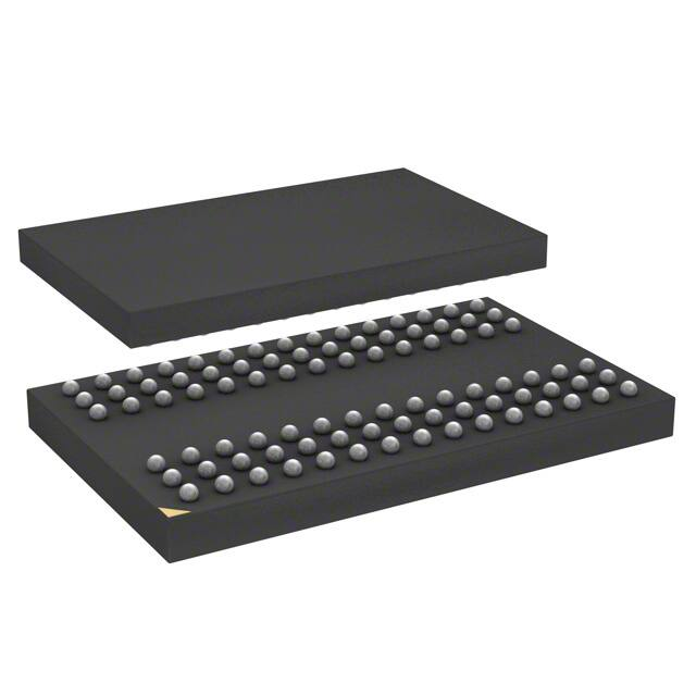

    512MB SDRAM高速数据同步突发传输
IS42S32160D-7BL 数据手册
IS42/45R86400D/16320D/32160D IS42/45S86400D/16320D/32160D 16Mx32, 32Mx16, 64Mx8 MAY 2015 512Mb SDRAM FEATURES • Clock frequency: 200, 166, 143 MHz • Fully synchronous; all signals referenced to a positive clock edge • Internal bank for hiding row access/precharge • Power supply: Vdd/Vddq = 2.3V-3.6V IS42/45SxxxxxD - Vdd/Vddq = 3.3V IS42/45RxxxxxD - Vdd/Vddq = 2.5 • LVTTL interface • Programmable burst length – (1, 2, 4, 8, full page) • Programmable burst sequence: Sequential/Interleave • Auto Refresh (CBR) • Self Refresh • 8K refresh cycles every 64 ms • Random column address every clock cycle • Programmable CAS latency (2, 3 clocks) • Burst read/write and burst read/single write operations capability • Burst termination by burst stop and precharge command • Packages: x8/x16: 54-pin TSOP-II, 54-ball TF-BGA (x16 only) x32: 90-ball TF-BGA • Temperature Range: Commercial (0oC to +70oC) Industrial (-40oC to +85oC) Automotive, A1 (-40oC to +85oC) Automotive, A2 (-40oC to +105oC) device OVERVIEW ISSI's 512Mb Synchronous DRAM achieves high-speed data transfer using pipeline architecture. All inputs and outputs signals refer to the rising edge of the clock input. The 512Mb SDRAM is organized as follows. PACKAGE INFORMATION IS42/45S32160D IS42/45S16320D IS42/45S86400D IS42/45R32160D IS42/45R16320D IS42/45R86400D 4M x 32 x 4 banks 8M x 16 x 4 banks 16M x 8 x 4 banks 90-ball TF-BGA 54-pin TSOP-II 54-pin TSOP-II 54-ball TF-BGA KEY TIMING PARAMETERS Parameter Clk Cycle Time CAS Latency = 3 CAS Latency = 2 Clk Frequency CAS Latency = 3 CAS Latency = 2 Access Time from Clock CAS Latency = 3 CAS Latency = 2 -5 5 10 200 100 5.0 6 -6 6 10 167 100 5.4 6 -7 Unit 7 ns 7.5 ns 143 Mhz 133 Mhz 5.4 ns 5.4 ns ADDRESS TABLE Parameter Configuration Bank Address Pins Autoprecharge Pins Row Address Column Address Refresh Count Com./Ind./A1 A2 16M x 32 4M x 32 x 4 banks BA0, BA1 32M x 16 8M x 16 x 4 banks BA0, BA1 64M x 8 16M x 8 x 4 banks BA0, BA1 A10/AP A10/AP A10/AP 8K(A0 – A12) 512(A0 – A8) 8K(A0 – A12) 8K(A0 – A12) 1K(A0 – A9) 2K(A0 – A9, A11) 8K / 64ms 8K / 16ms 8K / 64ms 8K / 16ms 8K / 64ms 8K / 16ms Copyright © 2015 Integrated Silicon Solution, Inc. All rights reserved. ISSI reserves the right to make changes to this specification and its products at any time without notice. ISSI assumes no liability arising out of the application or use of any information, products or services described herein. Customers are advised to obtain the latest version of this device specification before relying on any published information and before placing orders for products. Integrated Silicon Solution, Inc. does not recommend the use of any of its products in life support applications where the failure or malfunction of the product can reasonably be expected to cause failure of the life support system or to significantly affect its safety or effectiveness. Products are not authorized for use in such applications unless Integrated Silicon Solution, Inc. receives written assurance to its satisfaction, that: a.) the risk of injury or damage has been minimized; b.) the user assume all such risks; and c.) potential liability of Integrated Silicon Solution, Inc is adequately protected under the circumstances Integrated Silicon Solution, Inc. — www.issi.com 1 Rev. B 05/12/2015 IS42/45R86400D/16320D/32160D, IS42/45S86400D/16320D/32160D DEVICE OVERVIEW The 512Mb SDRAM is a high speed CMOS, dynamic random-access memory designed to operate in either 3.3V Vdd/Vddq or 2.5V Vdd/Vddq memory systems, depending on the DRAM option. Internally configured as a quad-bank DRAM with a synchronous interface. The 512Mb SDRAM (536,870,912 bits) includes an AUTO REFRESH MODE, and a power-saving, power-down mode. All signals are registered on the positive edge of the clock signal, CLK. All inputs and outputs are LVTTL compatible. The 512Mb SDRAM has the ability to synchronously burst data at a high data rate with automatic column-address generation, the ability to interleave between internal banks to hide precharge time and the capability to randomly change column addresses on each clock cycle during burst access. A self-timed row precharge initiated at the end of the burst sequence is available with the AUTO PRECHARGE function enabled.  Precharge one bank while accessing one of the other three banks will hide the precharge cycles and provide seamless, high-speed, random-access operation. SDRAM read and write accesses are burst oriented starting at a selected location and continuing for a programmed number of locations in a programmed sequence. The registration of an ACTIVE command begins accesses, followed by a READ or WRITE command. The ACTIVE command in conjunction with address bits registered are used to select the bank and row to be accessed (BA0, BA1 select the bank; A0-A12 select the row). The READ or WRITE commands in conjunction with address bits registered are used to select the starting column location for the burst access. Programmable READ or WRITE burst lengths consist of 1, 2, 4 and 8 locations or full page, with a burst terminate option. FUNCTIONAL BLOCK DIAGRAM (For 8MX16X4 Banks SHOWN) 16 16 REFRESH CONTROLLER MODE REGISTER 13 2 SELF REFRESH A10 A12 CONTROLLER 16 DQ 0-15 VDD/VDDQ DATA OUT BUFFER Vss/VssQ 16 REFRESH COUNTER 13 MULTIPLEXER A11 A9 A8 A7 A6 A5 A4 A3 A2 A1 A0 BA0 BA1 DQML DQMH DATA IN BUFFER COMMAND DECODER & CLOCK GENERATOR ROW ADDRESS LATCH 13 13 COLUMN ADDRESS LATCH ROW ADDRESS BUFFER ROW DECODER CLK CKE CS RAS CAS WE 8192 8192 8192 8192 MEMORY CELL ARRAY BANK 0 SENSE AMP I/O GATE 1024 (x 16) BANK CONTROL LOGIC 10 BURST COUNTER COLUMN ADDRESS BUFFER 2 COLUMN DECODER 10 Integrated Silicon Solution, Inc. — www.issi.com Rev. B 05/12/2015 IS42/45R86400D/16320D/32160D, IS42/45S86400D/16320D/32160D PIN CONFIGURATIONS 54 pin TSOP - Type II for x8 VDD 1 54 VSS DQ0 2 53 DQ7 VDDQ 3 52 VSSQ NC 4 51 NC DQ1 5 50 DQ6 VSSQ 6 49 VDDQ NC 7 48 NC DQ2 8 47 DQ5 VDDQ 9 46 VSSQ NC 10 45 NC DQ3 11 44 DQ4 VSSQ 12 43 VDDQ NC 13 42 NC VDD 14 41 VSS NC 15 40 NC WE 16 39 DQM CAS 17 38 CLK RAS 18 37 CKE CS 19 36 A12 BA0 20 35 A11 BA1 21 34 A9 A10 22 33 A8 A0 23 32 A7 A1 24 31 A6 A2 25 30 A5 A3 26 29 A4 VDD 27 28 VSS PIN DESCRIPTIONS A0-A12 A0-A9, A11 BA0, BA1 DQ0 to DQ7 CLK CKE CS RAS CAS Row Address Input Column Address Input Bank Select Address Data I/O System Clock Input Clock Enable Chip Select Row Address Strobe Command Column Address Strobe Command WE Write Enable DQM Data Input/Output Mask Vdd Power Vss Ground Vddq Power Supply for I/O Pin Vssq Ground for I/O Pin NC No Connection Integrated Silicon Solution, Inc. — www.issi.com 3 Rev. B 05/12/2015 IS42/45R86400D/16320D/32160D, IS42/45S86400D/16320D/32160D PIN CONFIGURATIONS 54 pin TSOP - Type II for x16 VDD 1 54 VSS DQ0 2 53 DQ15 VDDQ 3 52 VSSQ DQ1 4 51 DQ14 DQ2 5 50 DQ13 VSSQ 6 49 VDDQ DQ3 7 48 DQ12 DQ4 8 47 DQ11 VDDQ 9 46 VSSQ DQ5 10 45 DQ10 DQ6 11 44 DQ9 VSSQ 12 43 VDDQ DQ7 13 42 DQ8 VDD 14 41 VSS DQML 15 40 NC WE 16 39 DQMH CAS 17 38 CLK RAS 18 37 CKE CS 19 36 A12 BA0 20 35 A11 BA1 21 34 A9 A10 22 33 A8 A0 23 32 A7 A1 24 31 A6 A2 25 30 A5 A3 26 29 A4 VDD 27 28 VSS PIN DESCRIPTIONS A0-A12 A0-A9 BA0, BA1 DQ0 to DQ15 CLK CKE CS RAS CAS 4 Row Address Input Column Address Input Bank Select Address Data I/O System Clock Input Clock Enable Chip Select Row Address Strobe Command Column Address Strobe Command WE Write Enable DQML x16 Lower Byte, Input/Output Mask DQMH x16 Upper Byte, Input/Output Mask Vdd Power Vss Ground Vddq Power Supply for I/O Pin Vssq Ground for I/O Pin NC No Connection Integrated Silicon Solution, Inc. — www.issi.com Rev. B 05/12/2015 IS42/45R86400D/16320D/32160D, IS42/45S86400D/16320D/32160D PIN CONFIGURATION 54-ball TF-BGA for x16 (Top View) (8.00 mm x 13.00 mm Body, 0.8 mm Ball Pitch) package code: B 1 A B C D E F G H J 2 3 4 5 6 7 8 9 VSS DQ15 VSSQ VDDQ DQ0 VDD DQ14 DQ13 VDDQ VSSQ DQ2 DQ1 DQ12 DQ11 VSSQ VDDQ DQ4 DQ3 DQ10 DQ9 VDDQ VSSQ DQ6 DQ5 DQ8 NC VSS VDD DQML DQ7 DQMH CLK CKE CAS RAS WE A12 A11 A9 BA0 BA1 CS A8 A7 A6 A0 A1 A10 VSS A5 A4 A3 A2 VDD PIN DESCRIPTIONS A0-A12 A0-A9 BA0, BA1 DQ0 to DQ15 CLK CKE CS RAS CAS Row Address Input Column Address Input Bank Select Address Data I/O System Clock Input Clock Enable Chip Select Row Address Strobe Command Column Address Strobe Command WE Write Enable DQML x16 Lower Byte Input/Output Mask DQMH x16 Upper Byte Input/Output Mask Vdd Power Vss Ground Vddq Power Supply for I/O Pin Vssq Ground for I/O Pin NC No Connection Integrated Silicon Solution, Inc. — www.issi.com 5 Rev. B 05/12/2015 IS42/45R86400D/16320D/32160D, IS42/45S86400D/16320D/32160D PIN CONFIGURATION package code: B 90 bALL TF-bga (Top View) (8.00 mm x 13.00 mm Body, 0.8 mm Ball Pitch) 1 2 3 4 5 6 7 8 9 A B C D E F G H J K L M N P R DQ26 DQ24 VSS VDD DQ23 DQ21 DQ28 VDDQ VSSQ VDDQ VSSQ DQ19 VSSQ DQ27 DQ25 DQ22 DQ20 VDDQ VSSQ DQ29 DQ30 DQ17 DQ18 VDDQ VDDQ DQ31 NC NC DQ16 VSSQ VSS DQM3 A3 A2 DQM2 VDD A4 A5 A6 A10 A0 A1 A7 A8 A12 NC BA1 A11 CLK CKE A9 BA0 CS RAS DQM1 NC NC CAS WE DQM0 VDDQ DQ8 VSS VDD DQ7 VSSQ VSSQ DQ10 DQ9 DQ6 DQ5 VDDQ VSSQ DQ12 DQ14 DQ1 DQ3 VDDQ DQ11 VDDQ VSSQ DQ13 DQ15 VSS VDDQ VSSQ DQ4 VDD DQ0 DQ2 PIN DESCRIPTIONS A0-A12 A0-A8 BA0, BA1 DQ0 to DQ31 CLK CKE CS RAS CAS 6 Row Address Input Column Address Input Bank Select Address Data I/O System Clock Input Clock Enable Chip Select Row Address Strobe Command Column Address Strobe Command WE DQM0-DQM3 Vdd Vss Vddq Vssq NC Write Enable x32 Input/Output Mask Power Ground Power Supply for I/O Pin Ground for I/O Pin No Connection Integrated Silicon Solution, Inc. — www.issi.com Rev. B 05/12/2015 IS42/45R86400D/16320D/32160D, IS42/45S86400D/16320D/32160D PIN FUNCTIONS Symbol Type A0-A12 Input Pin BA0, BA1 Input Pin CAS Input Pin CKE Input Pin CLK Input Pin CS Input Pin DQM: x8 DQML, DQMH: x16 DQM0-DQM3: x32 Input Pin DQ0-DQ7: x8 Input/Output DQ0-DQ15: x16 DQ0-DQ31: x32 RAS Input Pin WE Input Pin Vddq Vdd Vssq Vss ower Supply Pin P Power Supply Pin Power Supply Pin Power Supply Pin Function (In Detail) Address Inputs: A0-A12 are sampled during the ACTIVE command (row-address A0-A12) and READ/WRITE command (column address A0-A9, A11 (x8); A0-A9 (x16); A0-A8 (x32); with A10 defining auto precharge) to select one location out of the memory array in the respective bank. A10 is sampled during a PRECHARGE command to determine if all banks are to be precharged (A10 HIGH) or bank selected by BA0, BA1 (LOW). The address inputs also provide the op-code during a LOAD MODE REGISTER command. Bank Select Address: BA0 and BA1 defines which bank the ACTIVE, READ, WRITE or PRECHARGE command is being applied. CAS, in conjunction with the RAS and WE, forms the device command. See the "Command Truth Table" for details on device commands. The CKE input determines whether the CLK input is enabled. The next rising edge of the CLK signal will be valid when is CKE HIGH and invalid when LOW. When CKE is LOW, the device will be in either power-down mode, clock suspend mode, or self refresh mode. CKE is an asynchronous input. CLK is the master clock input for this device. Except for CKE, all inputs to this device are acquired in synchronization with the rising edge of this pin. The CS input determines whether command input is enabled within the device. Command input is enabled when CS is LOW, and disabled with CS is HIGH. The device remains in the previous state when CS is HIGH. DQx pins control the bytes of the I/O buffers. For example with x16, in read mode, DQML and DQMH control the output buffer. When DQML or DQMH is LOW, the corresponding buffer byte is enabled, and when HIGH, disabled. The outputs go to the HIGH impedance state when DQML/DQMH is HIGH. This function corresponds to OE in conventional DRAMs. In write mode, DQML and DQMH control the input buffer. When DQML or DQMH is LOW, the corresponding buffer byte is enabled, and data can be written to the device. When DQML or DQMH is HIGH, input data is masked and cannot be written to the device. Data on the Data Bus is latched on DQ pins during Write commands, and buffered for output after Read commands. RAS, in conjunction with CAS and WE, forms the device command. See the "Command Truth Table" item for details on device commands. WE, in conjunction with RAS and CAS, forms the device command. See the "Command Truth Table" item for details on device commands. Vddq is the output buffer power supply. Vdd is the device internal power supply. Vssq is the output buffer ground. Vss is the device internal ground. Integrated Silicon Solution, Inc. — www.issi.com 7 Rev. B 05/12/2015 IS42/45R86400D/16320D/32160D, IS42/45S86400D/16320D/32160D GENERAL DESCRIPTION READ The READ command selects the bank from BA0, BA1 inputs and starts a burst read access to an active row. Inputs A0-An (For column addresses, n=A8 for x32, n=A9 for x16, n=A11 for x8), provides the starting column location. When A10 is HIGH, this command functions as an AUTO PRECHARGE command. When the auto precharge is selected, the row being accessed will be precharged at the end of the READ burst. The row will remain open for subsequent accesses when AUTO PRECHARGE is not selected. DQ’s read data is subject to the logic level on the DQM inputs two clocks earlier. When a given DQM signal was registered HIGH, the corresponding DQ’s will be High-Z two clocks later. DQ’s will provide valid data when the DQM signal was registered LOW. WRITE A burst write access to an active row is initiated with the WRITE command. BA0, BA1 inputs selects the bank, and the starting column location is provided by inputs A0-An (For column addresses, n=A8 for x32, n=A9 for x16, n=A11 for x8). AUTO-PRECHARGE is determined by A10. The row being accessed will be precharged at the end of the WRITE burst, if AUTO PRECHARGE is selected. If AUTO PRECHARGE is not selected, the row will remain open for subsequent accesses. A memory array is written with corresponding input data on DQ’s and DQM input logic level appearing at the same time. Data will be written to memory when DQM signal is LOW. When DQM is HIGH, the corresponding data inputs will be ignored, and a WRITE will not be executed to that byte/column location. PRECHARGE The PRECHARGE command is used to deactivate the open row in a particular bank or the open row in all banks. BA0, BA1 can be used to select which bank is precharged or they are treated as “Don’t Care”. A10 determined whether one or all banks are precharged. After executing this command, the next command for the selected bank(s) is executed after passage of the period tRP, which is the period required for bank precharging. Once a bank has been precharged, it is in the idle state and must be activated prior to any READ or WRITE commands being issued to that bank. AUTO PRECHARGE The AUTO PRECHARGE function ensures that the precharge is initiated at the earliest valid stage within a burst. This function allows for individual-bank precharge without 8 requiring an explicit command. A10 to enable the AUTO PRECHARGE function in conjunction with a specific READ or WRITE command. For each individual READ or WRITE command, auto precharge is either enabled or disabled. AUTO PRECHARGE does not apply except in full-page burst mode. Upon completion of the READ or WRITE burst, a precharge of the bank/row that is addressed is automatically performed. AUTO REFRESH COMMAND This command executes the AUTO REFRESH operation. The row address and bank to be refreshed are automatically generated during this operation.  The stipulated period (trc) is required for a single refresh operation, and no other commands can be executed during this period.  This command is executed at least 8192 times for every Tref period. During an AUTO REFRESH command, address bits are “Don’t Care”. This command corresponds to CBR Auto-refresh. BURST TERMINATE The BURST TERMINATE command forcibly terminates the burst read and write operations by truncating either fixed-length or full-page bursts and the most recently registered READ or WRITE command prior to the BURST TERMINATE. COMMAND INHIBIT COMMAND INHIBIT prevents new commands from being executed. Operations in progress are not affected, apart from whether the CLK signal is enabled NO OPERATION When CS is low, the NOP command prevents unwanted commands from being registered during idle or wait states. LOAD MODE REGISTER During the LOAD MODE REGISTER command the mode register is loaded from A0-A12. This command can only be issued when all banks are idle. ACTIVE COMMAND When the ACTIVE COMMAND is activated, BA0, BA1 inputs selects a bank to be accessed, and the address inputs on A0-A12 selects the row. Until a PRECHARGE command is issued to the bank, the row remains open for accesses. Integrated Silicon Solution, Inc. — www.issi.com Rev. B 05/12/2015 IS42/45R86400D/16320D/32160D, IS42/45S86400D/16320D/32160D COMMAND TRUTH TABLE CKE A12, A11 Function n–1 n CS RAS CAS WE BA1 BA0 A10 A9 - A0 Device deselect (DESL) H × H × × × × × × × No operation (NOP) H × L H H H × × × × Burst stop (BST) H × L H H L × × × × Read H × L H L H V V L V Read with auto precharge H × L H L H V V H V Write H × L H L L V V L V Write with auto precharge H × L H L L V V H V Bank activate (ACT) H × L L H H V V V V Precharge select bank (PRE) H × L L H L V V L × Precharge all banks (PALL) H × L L H L × × H × CBR Auto-Refresh (REF) H H L L L H × × × × Self-Refresh (SELF) H L L L L H × × × × Mode register set (MRS) H × L L L L L L L V Note: H=Vih, L=Vil x= Vih or Vil, V = Valid Data. DQM TRUTH TABLE CKE Function n-1 n Data write / output enable H × Data mask / output disable H × Upper byte write enable / output enable H × Lower byte write enable / output enable H × Upper byte write inhibit / output disable H × Lower byte write inhibit / output disable H × DQMH L H L × H × DQML L H × L × H Note: 1. H=Vih, L=Vil x= Vih or Vil, V = Valid Data. 2. x16 options shown. x32 DQM0-DQM3 is similar in function. Integrated Silicon Solution, Inc. — www.issi.com 9 Rev. B 05/12/2015 IS42/45R86400D/16320D/32160D, IS42/45S86400D/16320D/32160D CKE TRUTH TABLE Current State /Function Activating Clock suspend mode entry Any Clock suspend mode Clock suspend mode exit Auto refresh command Idle (REF) Self refresh entry Idle (SELF) Power down entry Idle Self refresh exit Power down exit CKE n–1 n H L L L L H H H H L H L L H L H L H CS × × × L L × L H × RAS CAS WE × × × × × × × × × L L H L L H × × × H H H × × × × × × Address × × × × × × × × × Note: H=Vih, L=Vil x= Vih or Vil, V = Valid Data. 10 Integrated Silicon Solution, Inc. — www.issi.com Rev. B 05/12/2015 IS42/45R86400D/16320D/32160D, IS42/45S86400D/16320D/32160D FUNCTIONAL TRUTH TABLE Current State CS RAS CAS WE Address Command Action Idle H X X X X DESL Nop or Power Down(2) L H H H X NOP Nop or Power Down(2) L H H L X BST Nop or Power Down L H L H BA, CA, A10 READ/READA ILLEGAL (3) L H L L A, CA, A10 WRIT/ WRITA ILLEGAL(3) L L H H BA, RA ACT Row activating L L H L BA, A10 PRE/PALL Nop L L L H X REF/SELF Auto refresh or Self-refresh(4) L L L L OC, BA1=L MRS Mode register set Row Active H X X X X DESL Nop L H H H X NOP Nop L H H L X BST Nop L H L H BA, CA, A10 READ/READA Begin read (5) L H L L BA, CA, A10 WRIT/ WRITA Begin write (5) L L H H BA, RA ACT ILLEGAL (3) L L H L BA, A10 PRE/PALL Precharge Precharge all banks(6) L L L H X REF/SELF ILLEGAL L L L L OC, BA MRS ILLEGAL Read H X X X X DESL Continue burst to end to Row active L H H H X NOP Continue burst to end Row Row active Burst stop, Row active L H H L X BST L H L H BA, CA, A10 READ/READA Terminate burst, begin new read (7) L H L L BA, CA, A10 WRIT/WRITA Terminate burst, begin write (7,8) L L H H BA, RA ACT ILLEGAL (3) L L H L BA, A10 PRE/PALL Terminate burst Precharging L L L H X REF/SELF ILLEGAL L L L L OC, BA MRS ILLEGAL Write H X X X X DESL Continue burst to end Write recovering L H H H X NOP Continue burst to end Write recovering L H H L X BST Burst stop, Row active L H L H BA, CA, A10 READ/READA Terminate burst, start read : Determine AP (7,8) L H L L BA, CA, A10 WRIT/WRITA Terminate burst, new write : Determine AP (7) L L H H BA, RA RA ACT ILLEGAL (3) L L H L BA, A10 PRE/PALL Terminate burst Precharging (9) L L L H X REF/SELF ILLEGAL L L L L OC, BA MRS ILLEGAL Note: H=Vih, L=Vil x= Vih or Vil, V = Valid Data, BA= Bank Address, CA+Column Address, RA=Row Address, OC= Op-Code Integrated Silicon Solution, Inc. — www.issi.com 11 Rev. B 05/12/2015 IS42/45R86400D/16320D/32160D, IS42/45S86400D/16320D/32160D FUNCTIONAL TRUTH TABLE Continued: Current State CS RAS CAS WE Address Command Action Read with auto Precharging H × × × × DESL Continue burst to end, Precharge L H H H x NOP Continue burst to end, Precharge L H H L × BST ILLEGAL L H L H BA, CA, A10 READ/READA ILLEGAL (11) L H L L BA, CA, A10 WRIT/ WRITA ILLEGAL (11) L L H H BA, RA ACT ILLEGAL (3) L L H L BA, A10 PRE/PALL ILLEGAL (11) L L L H × REF/SELF ILLEGAL L L L L OC, BA MRS ILLEGAL Write with Auto H × × × × DESL Precharge Continue burst to end, Write recovering with auto precharge L H H H × NOP Continue burst to end, Write recovering with auto precharge L H H L × BST ILLEGAL L H L H BA, CA, A10 READ/READA ILLEGAL(11) L H L L BA, CA, A10 WRIT/ WRITA ILLEGAL (11) L L H H BA, RA ACT ILLEGAL (3,11) L L H L BA, A10 PRE/PALL ILLEGAL (3,11) L L L H × REF/SELF ILLEGAL L L L L OC, BA MRS ILLEGAL Precharging H × × × × DESL Nop, Enter idle after tRP L H H H × NOP Nop, Enter idle after tRP L H H L × BST Nop, Enter idle after tRP L H L H BA, CA, A10 READ/READA ILLEGAL (3) L H L L BA, CA, A10 WRIT/WRITA ILLEGAL (3) L L H H BA, RA ACT ILLEGAL(3) L L H L BA, A10 PRE/PALL Nop Enter idle after tRP L L L H × REF/SELF ILLEGAL L L L L OC, BA MRS ILLEGAL Row Activating H × × × × DESL Nop, Enter bank active after tRCD L H H H × NOP Nop, Enter bank active after tRCD L H H L × BST Nop, Enter bank active after tRCD L H L H BA, CA, A10 READ/READA ILLEGAL (3) L H L L BA, CA, A10 WRIT/WRITA ILLEGAL (3) L L H H BA, RA ACT ILLEGAL (3,9) L L H L BA, A10 PRE/PALL ILLEGAL (3) L L L H × REF/SELF ILLEGAL L L L L OC, BA MRS ILLEGAL Note: H=Vih, L=Vil x= Vih or Vil, V = Valid Data, BA= Bank Address, CA+Column Address, RA=Row Address, OC= Op-Code 12 Integrated Silicon Solution, Inc. — www.issi.com Rev. B 05/12/2015 IS42/45R86400D/16320D/32160D, IS42/45S86400D/16320D/32160D FUNCTIONAL TRUTH TABLE Continued: Current State CS RAS CAS WE Address Command Action Write Recovering H × × L H H × × DESL Nop, Enter row active after tDPL H × NOP Nop, Enter row active after tDPL L H L H H L × BST Nop, Enter row active after tDPL L H BA, CA, A10 READ/READA Begin read (8) L L H L L BA, CA, A10 WRIT/ WRITA Begin new write L H H BA, RA ACT ILLEGAL (3) L L H L BA, A10 PRE/PALL ILLEGAL (3) L L L H × REF/SELF ILLEGAL L L L L OC, BA MRS ILLEGAL Write Recovering H × × × × DESL Nop, Enter precharge after tDPL with Auto L H H H × NOP Nop, Enter precharge after tDPL Precharge L H H L × BST Nop, Enter row active after tDPL L H L H BA, CA, A10 READ/READA ILLEGAL(3,8,11) L H L L BA, CA, A10 WRIT/WRITA ILLEGAL (3,11) L L H H BA, RA ACT ILLEGAL (3,11) L L H L BA, A10 PRE/PALL ILLEGAL (3,11) L L L H × REF/SELF ILLEGAL L L L L OC, BA MRS ILLEGAL Refresh H × × × × DESL Nop, Enter idle after tRC L H H × × NOP/BST Nop, Enter idle after tRC L H L H BA, CA, A10 READ/READA ILLEGAL L H L L BA, CA, A10 WRIT/WRITA ILLEGAL L L H H BA, RA ACT ILLEGAL L L H L BA, A10 PRE/PALL ILLEGAL L L L H × REF/SELF ILLEGAL L L L L OC, BA MRS ILLEGAL Mode Register H × × × × DESL Nop, Enter idle after 2 clocks Accessing L H H H × NOP Nop, Enter idle after 2 clocks L H H L × BST ILLEGAL L H L × BA, CA, A10 READ/WRITE ILLEGAL L L × × BA, RA ACT/PRE/PALL ILLEGAL REF/MRS Note: H=Vih, L=Vil x= Vih or Vil, V = Valid Data, BA= Bank Address, CA+Column Address, RA=Row Address, OC= Op-Code Notes: 1. All entries assume that CKE is active (CKEn-1=CKEn=H). 2. If both banks are idle, and CKE is inactive (Low), the device will enter Power Down mode. All input buffers except CKE will be disabled. 3. Illegal to bank in specified states; Function may be legal in the bank indicated by Bank Address (BA), depending on the state of that bank. 4. If both banks are idle, and CKE is inactive (Low), the device will enter Self-Refresh mode. All input buffers except CKE will be disabled. 5. Illegal if tRCD is not satisfied. 6. Illegal if tRAS is not satisfied. 7. Must satisfy burst interrupt condition. 8. Must satisfy bus contention, bus turn around, and/or write recovery requirements. 9. Must mask preceding data which don’t satisfy tDPL. 10. Illegal if tRRD is not satisfied. 11. Illegal for single bank, but legal for other banks. Integrated Silicon Solution, Inc. — www.issi.com 13 Rev. B 05/12/2015 IS42/45R86400D/16320D/32160D, IS42/45S86400D/16320D/32160D CKE RELATED COMMAND TRUTH TABLE(1) Current State Operation Self-Refresh (S.R.) INVALID, CLK (n - 1) would exit S.R. Self-Refresh Recovery(2) Self-Refresh Recovery(2) Illegal Illegal Maintain S.R. Self-Refresh Recovery Idle After trc Idle After trc Illegal Illegal Begin clock suspend next cycle(5) Begin clock suspend next cycle(5) Illegal Illegal Exit clock suspend next cycle(2) Maintain clock suspend Power-Down (P.D.) INVALID, CLK (n - 1) would exit P.D. EXIT P.D. --> Idle(2) Maintain power down mode All Banks Idle Refer to operations in Operative Command Table Refer to operations in Operative Command Table Refer to operations in Operative Command Table Auto-Refresh Refer to operations in Operative Command Table Refer to operations in Operative Command Table Refer to operations in Operative Command Table Refer to operations in Operative Command Table Self-Refresh(3) Refer to operations in Operative Command Table Power-Down(3) Any state Refer to operations in Operative Command Table other than Begin clock suspend next cycle(4) listed above Exit clock suspend next cycle Maintain clock suspend CKE n-1 n H X L H L H L H L H L L H H H H H H H H H L H L H L H L L H L L H X L H L L H H H H H H H H H H H L H L H L H L H L L X H H H L L H L L CS RAS CAS WE Address X X X X X H X X X X L H H X X L H L X X L L X X X X X X X X H X X X X L H H X X L H L X X L L X X X H X X X X L H H X X L H L X X L L X X X X X X X X X X X X X X X X X — X X X X X X X X X X H X X X — L H X X — L L H X — L L L H X L L L L Op - Code H X X X — L H X X — L L H X — L L L H X L L L L Op - Code X X X X X X X X X X X X X X X X X X X X X X X X X Notes: 1. H : High level, L : low level, X : High or low level (Don’t care). 2. CKE Low to High transition will re-enable CLK and other inputs asynchronously. A minimum setup time must be satisfied before any command other than EXIT. 3. Power down and Self refresh can be entered only from the both banks idle state. 4. Must be legal command as defined in Operative Command Table. 5. Illegal if txsr is not satisfied. 14 Integrated Silicon Solution, Inc. — www.issi.com Rev. B 05/12/2015 IS42/45R86400D/16320D/32160D, IS42/45S86400D/16320D/32160D STATE DIAGRAM Self Refresh SELF SELF exit Mode Register Set MRS REF IDLE CBR (Auto) Refresh CKE CKE ACT Power Down CKE Row Active BST rge th ha wi ec rite Pr W to Au Read CKE POWER ON tio CKE READA (P rec ha CKE READA SUSPEND PR E n) tio ina erm et rge arg ch ter mi Pre na E( CKE READ SUSPEND n) RR WRITEA CKE Write CKE CKE Read READ WRITE WRITEA SUSPEND BST h wit ad arge h ec Pr CKE to WRITE SUSPEND Read Re Write Au Write Active Power Down CKE Precharge Precharge Automatic sequence Manual Input Integrated Silicon Solution, Inc. — www.issi.com 15 Rev. B 05/12/2015 IS42/45R86400D/16320D/32160D, IS42/45S86400D/16320D/32160D ABSOLUTE MAXIMUM RATINGS(1) Symbol Parameters Vdd max Maximum Supply Voltage Vddq max Maximum Supply Voltage for Output Buffer Vin Input Voltage Vout Output Voltage Pd max Allowable Power Dissipation Ics Output Shorted Current Topr Operating Temperature Com. Ind. A1 A2 Tstg Storage Temperature Rating Unit –0.5 to +4.6 V –0.5 to +4.6 V –0.5 to Vdd + 0.5 V –1.0 to Vddq + 0.5 V 1 W 50 mA 0 to +70 °C -40 to +85 -40 to +85 -40 to +105 –65 to +150 °C Notes: 1.  Stress greater than those listed under ABSOLUTE MAXIMUM RATINGS may cause permanent damage to the device. This is a stress rating only and functional operation of the device at these or any other conditions above those indicated in the operational sections of this specification is not implied. Exposure to absolute maximum rating conditions for extended periods may affect reliability. 2.  All voltages are referenced to Vss. DC RECOMMENDED OPERATING CONDITIONS IS42/45SxxxxxD - 3.3V Operation Symbol Vdd Vddq Vih(1) Vil(2) Iil Iol Voh Vol Parameters Supply Voltage I/O Supply Voltage Input High Voltage Input Low Voltage Input Leakage Current (0V ≤ Vin ≤ Vdd) Output Leakage Current (Output disabled, 0V ≤ Vout ≤ Vdd) Output High Voltage Current (Ioh = -2mA) Output Low Voltage Current (Iol = 2mA) Min. 3.0 3.0 2.0 -0.3 -5 -5 2.4 – Typ. 3.3 3.3 – – – – – – Max. 3.6 3.6 Vddq+0.3 0.8 +5 +5 – 0.4 Unit V V V V µA µA V V IS42/45RxxxxxD - 2.5V Operation Symbol Vdd Vddq Vih(1) Vil(2) Iil Iol Voh Vol Parameters Supply Voltage I/O Supply Voltage Input High Voltage Input Low Voltage Input Leakage Current (0V ≤ Vin ≤ Vdd) Output Leakage Current (Output disabled, 0V ≤ Vout ≤ Vdd) Output High Voltage Current (Ioh = -2mA) Output Low Voltage Current (Iol = 2mA) Min. 2.3 2.3 2.0 -0.3 -5 -5 Vddq-0.2 - Typ. 2.5 2.5 – – – – Max. 2.7 2.7 Vddq+0.3 0.55 +5 +5 0.2 Unit V V V V µA µA V V Notes: 1. Vih (overshoot): Vih (max) = Vddq +1.2V (pulse width < 3ns). 2. Vil (undershoot): Vih (min) = -1.2V (pulse width < 3ns). 3. All voltages are referenced to Vss. 16 Integrated Silicon Solution, Inc. — www.issi.com Rev. B 05/12/2015 IS42/45R86400D/16320D/32160D, IS42/45S86400D/16320D/32160D CAPACITANCE CHARACTERISTICS(1) (At Ta = 0 to +25°C, Vdd = Vddq = 3.3 ± 0.3V, f = 1MHz) Symbol Cin1 Cin2 Ci/o Parameter Input Capacitance: CLK Input Capacitance:All other input pins Data Input/Output Capacitance: DQS Min. 2.5 2.5 4.0 Max. 3.5 3.8 6.0 Unit pF pF pF Note: 1.  The parameter is characterized. THERMAL RESISTANCE Package Substrate Theta-ja (Airflow = 0m/s) Theta-ja (Airflow = 1m/s) Theta-ja (Airflow = 2m/s) Theta-jc Units Alloy42 TSOP2(54) 4-layer 53.3 45.2 42.0 7.8 C/W Copper TSOP2(54) 4-layer 42.3 37.1 34.5 7.5 C/W BGA(54) 4-layer 36.7 30.5 28.9 4.2 C/W BGA(90) 4-layer 36.1 30.7 27.7 3.0 C/W DC ELECTRICAL CHARACTERISTICS (x8, x16) (Recommended Operation Conditions unless otherwise noted.) Symbol Parameter Test Condition -5 -6 -7 Unit (1) Idd1 Operating Current One bank active, CL = 3, BL = 1, 170 150 140 mA tclk = tclk (min), trc = trc (min) Idd2p Precharge Standby Current CKE ≤ Vil (max), tck = 15ns 8 8 8 mA (In Power-Down Mode) Idd2ps Precharge Standby Current CKE ≤ Vil (max), CLK ≤ Vil (max) 8 8 8 mA (In Power-Down Mode) (2) Idd2n Precharge Standby Current CS ≥ Vcc - 0.2V, CKE ≥ Vih (min) 35 35 35 mA (In Non Power-Down Mode) tck = 15ns Idd2ns Precharge Standby Current CS ≥ Vcc - 0.2V, CKE ≥ Vih (min) or 30 30 30 mA (In Non Power-Down Mode) CKE ≤ Vil (max), All inputs stable Idd3p Active Standby Current CKE ≤ Vil (max), tck = 15ns 15 15 15 mA (Power-Down Mode) Idd3ps Active Standby Current CKE ≤ Vil (max), CLK ≤ Vil (max) 15 15 15 mA (Power-Down Mode) (2) CS ≥ Vcc - 0.2V, CKE ≥ Vih (min) 40 40 40 mA Idd3n Active Standby Current (In Non Power-Down Mode) tck = 15ns Idd3ns Active Standby Current CS ≥ Vcc - 0.2V, CKE ≥ Vih (min) or 30 30 30 mA (In Non Power-Down Mode) CKE ≤ Vil (max), All inputs stable Idd4 Operating Current All banks active, BL = 4, CL = 3, 200 180 160 mA tck = tck (min) Idd5 Auto-Refresh Current trc = trc (min), tclk = tclk (min) 250 230 210 mA Idd6 Self-Refresh Current CKE ≤ 0.2V 12 12 12 mA Notes: 1. Idd (max) is specified at the output open condition. 2.  Input signals are changed one time during 30ns. 3. All values applicable for operation with Ta ≤ 85°C. 4. For A2 temperature grade with Ta > 85°C: IDD2P and IDD2PS are derated to 50% above the values; IDD3P and IDD3PS are derated to 30% above the values. Integrated Silicon Solution, Inc. — www.issi.com 17 Rev. B 05/12/2015 IS42/45R86400D/16320D/32160D, IS42/45S86400D/16320D/32160D DC ELECTRICAL CHARACTERISTICS (x32) (Recommended Operation Conditions unless otherwise noted.) Symbol Parameter Test Condition -5 -6 -7 Unit (1) Idd1 Operating Current One bank active, CL = 3, BL = 1, 190 180 170 mA tclk = tclk (min), trc = trc (min) Idd2p Precharge Standby Current CKE ≤ Vil (max), tck = 15ns 4 4 4 mA (In Power-Down Mode) Idd2ps Precharge Standby Current CKE ≤ Vil (max), CLK ≤ Vil (max) 4 4 4 mA (In Power-Down Mode) (2) Idd2n Precharge Standby Current CS ≥ Vdd - 0.2V, CKE ≥ Vih (min) 45 45 45 mA (In Non Power-Down Mode) tck = 15ns Idd2ns Precharge Standby Current CS ≥ Vdd - 0.2V, CKE ≥ Vih (min) or 20 20 20 mA (In Non Power-Down Mode) CKE ≤ Vil (max), All inputs stable Active Standby Current CKE ≤ Vil (max), tck = 15ns 15 15 15 mA Idd3p (Power-Down Mode) Idd3ps Active Standby Current CKE ≤ Vil (max), CLK ≤ Vil (max) 15 15 15 mA (Power-Down Mode) (2) Idd3n Active Standby Current CS ≥ Vdd - 0.2V, CKE ≥ Vih (min) 65 65 65 mA (In Non Power-Down Mode) tck = 15ns Idd3ns Active Standby Current CS ≥ Vdd - 0.2V, CKE ≥ Vih (min) or 45 45 45 mA (In Non Power-Down Mode) CKE ≤ Vil (max), All inputs stable Idd4 Operating Current All banks active, BL = 4, CL = 3, 285 245 230 mA tck = tck (min) Idd5 Auto-Refresh Current trc = trc (min), tclk = tclk (min) 270 260 250 mA Idd6 Self-Refresh Current CKE ≤ 0.2V 6 6 6 mA Notes: 1. Idd (max) is specified at the output open condition. 2.  Input signals are changed one time during 30ns. 3. All values applicable for operation with Ta ≤ 85°C. 4. For A2 temperature grade with Ta > 85°C: IDD1 is derated to 10% above the values. 18 Integrated Silicon Solution, Inc. — www.issi.com Rev. B 05/12/2015 IS42/45R86400D/16320D/32160D, IS42/45S86400D/16320D/32160D AC ELECTRICAL CHARACTERISTICS (1,2,3) -5 -6 -7 Symbol Parameter Min. Max. Min. Max. Min. Max. Units tck3 Clock Cycle Time CAS Latency = 3 5 — 6 — 7 — ns tck2 CAS Latency = 2 10 — 10 — 7.5 — ns tac3 Access Time From CLK CAS Latency = 3 — 5.0 — 5.4 — 5.4 ns tac2 CAS Latency = 2 — 6 — 6 — 5.4 ns tch CLK HIGH Level Width 2 — 2.5 — 2.5 — ns tcl CLK LOW Level Width 2 — 2.5 — 2.5 — ns toh3 Output Data Hold Time CAS Latency = 3 2.5 — 2.7 — 2.7 — ns toh2 CAS Latency = 2 2.5 — 2.7 — 2.7 — ns tlz Output LOW Impedance Time 0 — 0 — 0 — ns thz3 Output HIGH Impedance Time — 5 — 5.4 — 5.4 ns thz2 — 6 — 6 — 5.4 ns tds Input Data Setup Time(2) 1.8 — 1.5 — 1.5 — ns (2) Input Data Hold Time 0.8 — 0.8 — 0.8 — ns tdh tas Address Setup Time(2) 1.5 — 1.5 — 1.5 — ns (2) tah Address Hold Time 0.8 — 0.8 — 0.8 — ns (2) tcks CKE Setup Time 1.5 — 1.5 — 1.5 — ns tckh CKE Hold Time(2) 0.8 — 0.8 — 0.8 — ns tcms Command Setup Time (CS, RAS, CAS, WE, DQM)(2) 1.5 — 1.5 — 1.5 — ns (2) tcmh Command Hold Time (CS, RAS, CAS, WE, DQM) 0.8 — 0.8 — 0.8 — ns trc Command Period (REF to REF / ACT to ACT) 55 — 60 — 60 — ns tras Command Period (ACT to PRE) 38 100K 42 100K 37 100K ns trp Command Period (PRE to ACT) 15 — 18 — 15 — ns trcd Active Command To Read / Write Command Delay Time 15 — 18 — 15 — ns trrd Command Period (ACT [0] to ACT[1]) 10 — 12 — 14 — ns tdpl Input Data To Precharge 10 — 12 — 14 — ns Command Delay time tdal Input Data To Active / Refresh 25 — 30 — 29 — ns Command Delay time (During Auto-Precharge) tmrd Mode Register Program Time 10 — 12 — 14 — ns tdde Power Down Exit Setup Time 5 — 6 — 7 — ns txsr Self-Refresh Exit Time 60 — 70 — 67 — ns tt Transition Time 0.3 1.2 0.3 1.2 0.3 1.2 ns o tref Refresh Cycle Time (8192) Ta ≤ 70 C Com, Ind, A1, A2 — 64 — 64 — 64 ms Ta ≤ 85oC Ind, A1, A2 — 64 — 64 — 64 ms Ta > 85oC A2 — — — — — 16 ms Notes: 1.  The power-on sequence must be executed before starting memory operation. 2.  Measured with tt = 1 ns. If clock rising time is longer than 1ns, (tt /2 - 0.5) ns should be added to the parameter. 3. The reference level is 1.4V when measuring input signal timing. Rise and fall times are measured between Vih(min.) and Vil (max). Integrated Silicon Solution, Inc. — www.issi.com 19 Rev. B 05/12/2015 IS42/45R86400D/16320D/32160D, IS42/45S86400D/16320D/32160D OPERATING FREQUENCY / LATENCY RELATIONSHIPS Symbol Parameter -5 -6 -7 -7 Units — Clock Cycle Time 5 6 7 7.5 ns — Operating Frequency 200 167 143 133 MHz tcac CAS Latency 3 3 3 2 cycle trcd Active Command To Read/Write Command Delay Time 3 3 3 2 cycle trac RAS Latency (trcd + tcac) CAS Latency = 3 CAS Latency = 2 6 — 6 — 6 — — 4 cycle trc Command Period (REF to REF / ACT to ACT) 10 10 9 8 cycle tras Command Period (ACT to PRE) 7 7 6 5 cycle trp Command Period (PRE to ACT) 3 3 3 2 cycle trrd Command Period (ACT[0] to ACT [1]) 2 2 2 2 cycle tccd Column Command Delay Time (READ, READA, WRIT, WRITA) 1 1 1 1 cycle tdpl Input Data To Precharge Command Delay Time 2 2 2 2 cycle tdal Input Data To Active/Refresh Command Delay Time (During Auto-Precharge) 5 5 5 4 cycle trbd Burst Stop Command To Output in HIGH-Z Delay Time CAS Latency = 3 3 — 3 — 3 — — 2 cycle twbd Burst Stop Command To Input in Invalid Delay Time (Write) 0 0 0 0 cycle trql Precharge Command To Output in HIGH-Z Delay Time CAS Latency = 3 (Read) CAS Latency = 2 3 — 3 — 3 — — 2 cycle twdl Precharge Command To Input in Invalid Delay Time (Write) 0 0 0 0 cycle tpql Last Output To Auto-Precharge Start Time (Read) CAS Latency = 3 CAS Latency = 2 -2 — -2 — –2 — — -1 cycle tqmd DQM To Output Delay Time (Read) 2 2 2 2 cycle tdmd DQM To Input Delay Time (Write) 0 0 0 0 cycle tmrd Mode Register Set To Command Delay Time 2 2 2 2 cycle 20 (Read) CAS Latency = 2 Integrated Silicon Solution, Inc. — www.issi.com Rev. B 05/12/2015 IS42/45R86400D/16320D/32160D, IS42/45S86400D/16320D/32160D AC TEST CONDITIONS: 3.3V Input Load Output Load tCK tCH tCL 3.0V CLK 1.4V 0V tCMS 1.4V tCMH 3.0V 50Ω Z = 50Ω INPUT 1.4V Output 0V OUTPUT 50 pF tAC tOH 1.4V 1.4V AC TEST CONDITIONS Parameter AC Input Levels Input Rise and Fall Times Input Timing Reference Level Output Timing Measurement Reference Level IS42/45Sxxxxx Rating 0V to 3.0V 1 ns 1.4V 1.4V IS42/45Rxxxxx Rating 0V to 2.5V 1 ns 1.25V 1.25V AC TEST CONDITIONS: 2.5V Output Load Input Load tCH tCK tCL 2.5V CLK 1.25V 1.25V 0.0V tCMS Output 2.5V 50 pF INPUT 1.25V 0.0V tAC tOH OUTPUT 50Ω Z = 50Ω tCMH 1.25V 1.25V Integrated Silicon Solution, Inc. — www.issi.com 21 Rev. B 05/12/2015 IS42/45R86400D/16320D/32160D, IS42/45S86400D/16320D/32160D FUNCTIONAL DESCRIPTION Initialization The 512Mb SDRAMs are quad-bank DRAMs which operate at 3.3V or 2.5V and include a synchronous interface (all signals are registered on the positive edge of the clock signal, CLK). Read and write accesses to the SDRAM are burst oriented; accesses start at a selected location and continue for a programmed number of locations in a programmed sequence. Accesses begin with the registration of an ACTIVE command which is then followed by a READ or WRITE command. The address bits registered coincident with the ACTIVE command are used to select the bank and row to be accessed (BA0 and BA1 select the bank, A0-A12 select the row). The address bits A0-An; registered coincident with the READ or WRITE command are used to select the starting column location for the burst access. Prior to normal operation, the SDRAM must be initialized. The following sections provide detailed information covering device initialization, register definition, command descriptions and device operation. SDRAMs must be powered up and initialized in a predefined manner. The 512Mb SDRAM is initialized after the power is applied to Vdd and Vddq (simultaneously) and the clock is stable with DQM High and CKE High. A 100µs delay is required prior to issuing any command other than a COMMAND INHIBIT or a NOP. The COMMAND INHIBIT or NOP may be applied during the 100us period and should continue at least through the end of the period. With at least one COMMAND INHIBIT or NOP command having been applied, a PRECHARGE command should be applied once the 100µs delay has been satisfied. All banks must be precharged. This will leave all banks in an idle state after which at least two AUTO REFRESH cycles must be performed.  After the AUTO REFRESH cycles are complete, the SDRAM is then ready for mode register programming. The mode register should be loaded prior to applying any operational command because it will power up in an unknown state. 22 Integrated Silicon Solution, Inc. — www.issi.com Rev. B 05/12/2015 IS42/45R86400D/16320D/32160D, IS42/45S86400D/16320D/32160D Initialize and Load Mode Register(1) T0 CLK T1 tCK Tn+1 tCH To+1 tCL Tp+1 Tp+2 Tp+3 tCKS tCKH CKE COMMAND tCMS tCMH tCMS tCMH tCMS tCMH NOP PRECHARGE AUTO REFRESH NOP AUTO REFRESH NOP Load MODE REGISTER NOP ACTIVE DQM/ DQML, DQMH tAS tAH A0-A9, A11, A12 ALL BANKS A10 SINGLE BANK BA0, BA1 CODE tAS tAH ROW CODE ROW tAS tAH ALL BANKS BANK CODE DQ T Power-up: VCC and CLK stable T = 100µs Min. tRP Precharge all banks tRC AUTO REFRESH tRC AUTO REFRESH At least 2 Auto-Refresh Commands tMRD Program MODE REGISTER (2, 3, 4) DON'T CARE Notes: 1. If CS is High at clock High time, all commands applied are NOP. 2. The Mode register may be loaded prior to the Auto-Refresh cycles if desired. 3. JEDEC and PC100 specify three clocks. 4. Outputs are guaranteed High-Z after the command is issued. Integrated Silicon Solution, Inc. — www.issi.com 23 Rev. B 05/12/2015 IS42/45R86400D/16320D/32160D, IS42/45S86400D/16320D/32160D Auto-Refresh Cycle T0 CLK tCK T1 tCL T2 Tn+1 tCH To+1 tCKS tCKH CKE tCMS tCMH COMMAND PRECHARGE NOP Auto Refresh NOP Auto Refresh NOP ACTIVE DQM/ DQML, DQMH A0-A9, A11, A12 ROW ALL BANKS A10 ROW SINGLE BANK BA0, BA1 DQ BANK BANK(s) tAS tAH High-Z tRP tRC tRC DON'T CARE Notes: 1. CAS latency = 2, 3 24 Integrated Silicon Solution, Inc. — www.issi.com Rev. B 05/12/2015 IS42/45R86400D/16320D/32160D, IS42/45S86400D/16320D/32160D Self-Refresh Cycle T0 T1 tCK CLK T2 tCH tCKS tCKH Tn+1 To+1 To+2 tCL tCKS ≥ tRAS CKE tCKS tCMS tCMH COMMAND PRECHARGE NOP Auto Refresh NOP NOP Auto Refresh DQM/ DQML, DQMH A0-A9, A11, A12 ALL BANKS A10 SINGLE BANK tAS tAH BA0, BA1 BANK DQ High-Z Precharge all active banks tRP Enter self refresh mode tXSR CLK stable prior to exiting Exit self refresh mode self refresh mode (Restart refresh time base) DON'T CARE Notes: 1. Self-Refresh mode is not supported for A2 grade with Ta > +85oC. Integrated Silicon Solution, Inc. — www.issi.com 25 Rev. B 05/12/2015 IS42/45R86400D/16320D/32160D, IS42/45S86400D/16320D/32160D Register Definition Mode Register Mode register bits M0-M2 specify the burst length, M3 specifies the type of burst (sequential or interleaved), M4- M6 specify the CAS latency, M7 and M8 specify the operating mode, M9 specifies the WRITE burst mode, and M10, M11, and M12 are reserved for future use. The mode register must be loaded when all banks are idle, and the controller must wait the specified time before initiating the subsequent operation.Violating either of these requirements will result in unspecified operation. The mode register is used to define the specific mode of operation of the SDRAM. This definition includes the selection of a burst length, a burst type, a CAS latency, an operating mode and a write burst mode, as shown in MODE REGISTER DEFINITION. The mode register is programmed via the LOAD MODE REGISTER command and will retain the stored information until it is programmed again or the device loses power. MODE REGISTER DEFINITION BA1 BA0 A12 A11 A10 A9 A8 A7 A6 A5 A4 A3 A2 A1 A0 Address Bus (Ax) Mode Register (Mx) Burst Length (1) Reserved M2 M1 M0 M3=0 M3=1 0 0 0 0 1 1 1 1 0 0 1 1 0 0 1 1 0 1 0 1 0 1 0 1 1 2 4 8 Reserved Reserved Reserved Full Page 1 2 4 8 Reserved Reserved Reserved Reserved Burst Type M3 Type 0 1 Sequential Interleaved Latency Mode M6 M5 M4 0 0 0 0 1 1 1 1 0 0 1 1 0 0 1 1 0 1 0 1 0 1 0 1 CAS Latency Reserved Reserved 2 3 Reserved Reserved Reserved Reserved Operating Mode M8 M7 M6-M0 Mode 0 0 — — Defined — Standard Operation All Other States Reserved Write Burst Mode M9 0 1 26 Mode Programmed Burst Length Single Location Access 1. To ensure compatibility with future devices, should program BA1, BA0, A12, A11, A10 = "0" Integrated Silicon Solution, Inc. — www.issi.com Rev. B 05/12/2015 IS42/45R86400D/16320D/32160D, IS42/45S86400D/16320D/32160D Burst Length Read and write accesses to the SDRAM are burst oriented, with the burst length being programmable, as shown in MODE REGISTER DEFINITION. The burst length determines the maximum number of column locations that can be accessed for a given READ or WRITE command. Burst lengths of 1, 2, 4 or 8 locations are available for both the sequential and the interleaved burst types, and a full-page burst is available for the sequential type. The full-page burst is used in conjunction with the BURST TERMINATE command to generate arbitrary burst lengths. Reserved states should not be used, as unknown operation or incompatibility with future versions may result. When a READ or WRITE command is issued, a block of columns equal to the burst length is effectively selected. All accesses for that burst take place within this block, meaning that the burst will wrap within the block if a boundary is reached. The block is uniquely selected by A1-An when the burst length is set to two; by A2-An when the burst length is set to four; and by A3-An when the burst length is set to eight. An = A8 for x32, An = A9 for x16, and An = A11 for x8. The remaining (least significant) address bit(s) is (are) used to select the starting location within the block. Full-page bursts wrap within the page if the boundary is reached. Burst Type Accesses within a given burst may be programmed to be either sequential or interleaved; this is referred to as the burst type and is selected via bit M3. The ordering of accesses within a burst is determined by the burst length, the burst type and the starting column address, as shown in BURST DEFINITION table. Burst Definition Burst Starting Column Order of Accesses Within a Burst Length Address Type = Sequential Type = Interleaved A 0 2 0 0-1 0-1 1 1-0 1-0 A 1 A 0 0 0 0-1-2-3 0-1-2-3 4 0 1 1-2-3-0 1-0-3-2 1 0 2-3-0-1 2-3-0-1 1 1 3-0-1-2 3-2-1-0 A2 A1 A0 0 0 0 0-1-2-3-4-5-6-7 0-1-2-3-4-5-6-7 0 0 1 1-2-3-4-5-6-7-0 1-0-3-2-5-4-7-6 0 1 0 2-3-4-5-6-7-0-1 2-3-0-1-6-7-4-5 8 0 1 1 3-4-5-6-7-0-1-2 3-2-1-0-7-6-5-4 1 0 0 4-5-6-7-0-1-2-3 4-5-6-7-0-1-2-3 1 0 1 5-6-7-0-1-2-3-4 5-4-7-6-1-0-3-2 1 1 0 6-7-0-1-2-3-4-5 6-7-4-5-2-3-0-1 1 1 1 7-0-1-2-3-4-5-6 7-6-5-4-3-2-1-0 Full n = A0-A8 (x32) Cn, Cn + 1, Cn + 2 Not Supported Page n = A0-A9 (x16) Cn + 3, Cn + 4... n = A0-A9, A11 (x8) …Cn - 1, (y) (location 0-y) Cn… Integrated Silicon Solution, Inc. — www.issi.com 27 Rev. B 05/12/2015 IS42/45R86400D/16320D/32160D, IS42/45S86400D/16320D/32160D CAS Latency Operating Mode The CAS latency is the delay, in clock cycles, between the registration of a READ command and the availability of the first piece of output data. The latency can be set to two or three clocks. If a READ command is registered at clock edge n, and the latency is m clocks, the data will be available by clock edge n + m. The DQs will start driving as a result of the clock edge one cycle earlier (n + m - 1), and provided that the relevant access times are met, the data will be valid by clock edge n + m. For example, assuming that the clock cycle time is such that all relevant access times are met, if a READ command is registered at T0 and the latency is programmed to two clocks, the DQs will start driving after T1 and the data will be valid by T2, as shown in CAS Latency diagrams. The Allowable Operating Frequency table indicates the operating frequencies at which each CAS latency setting can be used. Reserved states should not be used as unknown operation or incompatibility with future versions may result. The normal operating mode is selected by setting M7 and M8 to zero; the other combinations of values for M7 and M8 are reserved for future use and/or test modes. The programmed burst length applies to both READ and WRITE bursts. Test modes and reserved states should not be used because unknown operation or incompatibility with future versions may result. Write Burst Mode When M9 = 0, the burst length programmed via M0-M2 applies to both READ and WRITE bursts; when M9 = 1, the programmed burst length applies to READ bursts, but write accesses are single-location (nonburst) accesses. CAS Latency Allowable Operating Frequency (MHz) Speed -5 -6 -7 CAS Latency = 2 100 100 133 CAS Latency = 3 200 167 143 CAS Latency T0 T1 T2 T3 READ NOP NOP CLK COMMAND tAC DOUT DQ tOH tLZ CAS Latency - 2 T0 T1 T2 T3 T4 READ NOP NOP NOP CLK COMMAND tAC DOUT DQ tLZ tOH CAS Latency - 3 DON'T CARE UNDEFINED 28 Integrated Silicon Solution, Inc. — www.issi.com Rev. B 05/12/2015 IS42/45R86400D/16320D/32160D, IS42/45S86400D/16320D/32160D Activating Specific Row Within Specific Bank CHIP Operation BANK/ROW ACTIVATION Before any READ or WRITE commands can be issued to a bank within the SDRAM, a row in that bank must be “opened.” This is accomplished via the ACTIVE command, which selects both the bank and the row to be activated (see Activating Specific Row Within Specific Bank). After opening a row (issuing an ACTIVE command), a READ or WRITE command may be issued to that row, subject to the trcd specification. Minimum trcd should be divided by the clock period and rounded up to the next whole number to determine the earliest clock edge after the ACTIVE command on which a READ or WRITE command can be entered. For example, a trcd specification of 15ns with a 143 MHz clock (7ns period) results in 2.14 clocks, rounded to 3. This is reflected in the following example, which covers any case where 2 < [trcd (MIN)/tck] ≤ 3. (The same procedure is used to convert other specification limits from time units to clock cycles). A subsequent ACTIVE command to a different row in the same bank can only be issued after the previous active row has been “closed” (precharged). The minimum time interval between successive ACTIVE commands to the same bank is defined by trc. CLK HIGH CKE CS RAS CAS WE A0-A12 ROW ADDRESS BA0, BA1 BANK ADDRESS A subsequent ACTIVE command to another bank can be issued while the first bank is being accessed, which results in a reduction of total row-access overhead. The minimum time interval between successive ACTIVE commands to different banks is defined by trrd. Example: Meeting trcd (MIN) when 2 < [trcd (min)/tck] ≤ 3 T0 T1 T2 ACTIVE NOP NOP T3 T4 CLK COMMAND READ or WRITE tRCD DON'T CARE Integrated Silicon Solution, Inc. — www.issi.com 29 Rev. B 05/12/2015 IS42/45R86400D/16320D/32160D, IS42/45S86400D/16320D/32160D READs READ bursts are initiated with a READ command, as shown in the READ COMMAND diagram. The starting column and bank addresses are provided with the READ command, and auto precharge is either enabled or disabled for that burst access. If auto precharge is enabled, the row being accessed is precharged at the completion of the burst. For the generic READ commands used in the following illustrations, auto precharge is disabled. During READ bursts, the valid data-out element from the starting column address will be available following the CAS latency after the READ command. Each subsequent data-out element will be valid by the next positive clock edge. The CAS Latency diagram shows general timing for each possible CAS latency setting. Upon completion of a burst, assuming no other commands have been initiated, the DQs will go High-Z. A full-page burst will continue until terminated. (At the end of the page, it will wrap to column 0 and continue.) Data from any READ burst may be truncated with a subsequent READ command, and data from a fixed-length READ burst may be immediately followed by data from a READ command. In either case, a continuous flow of data can be maintained. The first data element from the new burst follows either the last element of a completed burst or the last desired data element of a longer burst which is being truncated. The new READ command should be issued x cycles before the clock edge at which the last desired data element is valid, where x equals the CAS latency minus one. This is shown in Consecutive READ Bursts for CAS latencies of two and three; data element n + 3 is either the last of a burst of four or the last desired of a longer burst. The 512Mb SDRAM uses a pipelined architecture and therefore does not require the 2n rule associated with a prefetch architecture. A READ command can be initiated on any clock cycle following a previous READ command. Full-speed random read accesses can be performed to the same bank, as shown in Random READ Accesses, or each subsequent READ may be performed to a different bank. Data from any READ burst may be truncated with a subsequent WRITE command, and data from a fixed-length READ burst may be immediately followed by data from a WRITE command (subject to bus turnaround limitations). The WRITE burst may be initiated on the clock edge immediately following the last (or last desired) data element from the READ burst, provided that I/O contention can be avoided. In a given system design, there may be a possibility that the device driving the input data will go Low-Z before the SDRAM DQs go High-Z. In this case, at least a single-cycle delay should occur between the last read data and the WRITE command. 30 READ COMMAND CLK CKE HIGH CS RAS CAS WE A0-A9, A11 COLUMN ADDRESS A12 AUTO PRECHARGE A10 NO PRECHARGE BA0, BA1 BANK ADDRESS Note: x32: A9 and A11 are "Don't Care" x16: A11 is "Don't Care" The DQM input is used to avoid I/O contention, as shown in Figures RW1 and RW2. The DQM signal must be asserted (HIGH) at least three clocks prior to the WRITE command (DQM latency is two clocks for output buffers) to suppress data-out from the READ. Once the WRITE command is registered, the DQs will go High-Z (or remain High-Z), regardless of the state of the DQM signal, provided the DQM was active on the clock just prior to the WRITE command that truncated the READ command. If not, the second WRITE will be an invalid WRITE. For example, if DQM was LOW during T4 in Figure RW2, then the WRITEs at T5 and T7 would be valid, while the WRITE at T6 would be invalid. The DQM signal must be de-asserted prior to the WRITE command (DQM latency is zero clocks for input buffers) to ensure that the written data is not masked. A fixed-length READ burst may be followed by, or truncated with, a PRECHARGE command to the same bank (provided that auto precharge was not activated), and a full-page burst may be truncated with a PRECHARGE command to the same bank.The PRECHARGE command should be issued x cycles before the clock edge at which the last desired data element is valid, where x equals the CAS latency minus one. This is shown in the READ to PRECHARGE Integrated Silicon Solution, Inc. — www.issi.com Rev. B 05/12/2015 IS42/45R86400D/16320D/32160D, IS42/45S86400D/16320D/32160D diagram for each possible CAS latency; data element n + 3 is either the last of a burst of four or the last desired of a longer burst. Following the PRECHARGE command, a subsequent command to the same bank cannot be issued until trp is met. Note that part of the row precharge time is hidden during the access of the last data element(s). In the case of a fixed-length burst being executed to completion, a PRECHARGE command issued at the optimum time (as described above) provides the same operation that would result from the same fixed-length burst with auto precharge. The disadvantage of the PRECHARGE command is that it requires that the command and address buses be available at the appropriate time to issue the command; the advantage of the PRECHARGE command is that it can be used to truncate fixed-length or full-page bursts. Full-page READ bursts can be truncated with the BURST TERMINATE command, and fixed-length READ bursts may be truncated with a BURST TERMINATE command, provided that auto precharge was not activated.The BURST TERMINATE command should be issued x cycles before the clock edge at which the last desired data element is valid, where x equals the CAS latency minus one. This is shown in the READ Burst Termination diagram for each possible CAS latency; data element n + 3 is the last desired data element of a longer burst. Integrated Silicon Solution, Inc. — www.issi.com 31 Rev. B 05/12/2015 IS42/45R86400D/16320D/32160D, IS42/45S86400D/16320D/32160D RW1 - READ to WRITE T0 T1 T2 T3 T4 T5 T6 COMMAND READ NOP NOP NOP NOP NOP WRITE ADDRESS BANK, COL n CLK DQM BANK, COL b tHZ DOUT n DQ DOUT n+1 DIN b DOUT n+2 CAS Latency - 2 tDS DON'T CARE RW2 - READ to WRITE T0 T1 T2 T3 T4 T5 COMMAND READ NOP NOP NOP NOP WRITE ADDRESS BANK, COL n CLK DQM BANK, COL b tHZ DQ DOUT n CAS Latency - 3 DIN b tDS DON'T CARE 32 Integrated Silicon Solution, Inc. — www.issi.com Rev. B 05/12/2015 IS42/45R86400D/16320D/32160D, IS42/45S86400D/16320D/32160D Consecutive READ Bursts T0 T1 T2 T3 T4 T5 T6 COMMAND READ NOP NOP NOP READ NOP NOP ADDRESS BANK, COL n DOUT n+3 DOUT b CLK BANK, COL b DQ DOUT n DOUT n+1 DOUT n+2 CAS Latency - 2 DON'T CARE T0 T1 T2 T3 T4 T5 T6 T7 COMMAND READ NOP NOP NOP READ NOP NOP NOP ADDRESS BANK, COL n DOUT n+2 DOUT n+3 DOUT b CLK BANK, COL b DQ DOUT n DOUT n+1 CAS Latency - 3 DON'T CARE Integrated Silicon Solution, Inc. — www.issi.com 33 Rev. B 05/12/2015 IS42/45R86400D/16320D/32160D, IS42/45S86400D/16320D/32160D Random READ Accesses T0 T1 T2 T3 T4 T5 COMMAND READ READ READ READ NOP NOP ADDRESS BANK, COL n BANK, COL b BANK, COL m BANK, COL x CLK DQ DOUT n DOUT b DOUT m DOUT x CAS Latency - 2 DON'T CARE T0 T1 T2 T3 T4 T5 T6 COMMAND READ READ READ READ NOP NOP NOP ADDRESS BANK, COL n BANK, COL b BANK, COL m BANK, COL x CLK DQ DOUT n DOUT b DOUT m DOUT x CAS Latency - 3 DON'T CARE 34 Integrated Silicon Solution, Inc. — www.issi.com Rev. B 05/12/2015 IS42/45R86400D/16320D/32160D, IS42/45S86400D/16320D/32160D READ Burst Termination T0 T1 T2 T3 T4 READ NOP NOP NOP T5 T6 NOP NOP CLK COMMAND BURST TERMINATE x = 1 cycle BANK a, COL n ADDRESS DQ DOUT n DOUT n+1 DOUT n+2 DOUT n+3 CAS Latency - 2 DON'T CARE T0 T1 T2 T3 READ NOP NOP NOP T4 T5 T6 T7 NOP NOP NOP CLK COMMAND BURST TERMINATE x = 2 cycles ADDRESS BANK, COL n DQ DOUT n DOUT n+1 DOUT n+2 DOUT n+3 CAS Latency - 3 DON'T CARE Integrated Silicon Solution, Inc. — www.issi.com 35 Rev. B 05/12/2015 IS42/45R86400D/16320D/32160D, IS42/45S86400D/16320D/32160D ALTERNATING BANK READ ACCESSES T0 CLK tCK T1 tCL T2 tCH T3 T4 T5 T6 T7 T8 NOP READ NOP tCKS tCKH CKE tCMS tCMH COMMAND ACTIVE NOP READ NOP ACTIVE ACTIVE tCMS tCMH DQM/ DQML, DQMH tAS tAH A0-A9, A11, A12 COLUMN m(2) ROW tAS tAH A10 ROW tAS tAH BA0, BA1 BANK 0 COLUMN b(2) ROW ENABLE AUTO PRECHARGE ROW ENABLE AUTO PRECHARGE ROW BANK 0 ROW BANK 3 tLZ BANK 3 tOH tOH DQ DOUT m tAC tRCD - BANK 0 tRRD tOH DOUT m+1 tAC BANK 0 tAC tOH DOUT m+2 tOH DOUT m+3 tAC tAC tRP - BANK 0 CAS Latency - BANK 0 tRCD - BANK 3 DOUT b tAC tRCD - BANK 0 CAS Latency - BANK 3 tRAS - BANK 0 tRC - BANK 0 DON'T CARE Notes: 1) CAS latency = 2, Burst Length = 4 2) x8: A12 = "Don't Care" x16: A11, A12 = "Don't Care" x32: A9, A11, A12 = "Don't Care" 36 Integrated Silicon Solution, Inc. — www.issi.com Rev. B 05/12/2015 IS42/45R86400D/16320D/32160D, IS42/45S86400D/16320D/32160D READ - FULL-PAGE BURST T0 CLK tCK T1 tCL T2 tCH T3 T4 T5 T6 Tn+1 NOP NOP NOP NOP Tn+2 Tn+3 Tn+4 NOP NOP tCKS tCKH CKE tCMS tCMH COMMAND ACTIVE NOP READ NOP BURST TERM tCMS tCMH DQM/ DQML, DQMH tAS tAH A0-A9, A11, A12 ROW tAS tAH A10 ROW tAS tAH BA0, BA1 BANK COLUMN m(2) BANK tAC DQ tLZ tRCD CAS Latency tAC DOUT m tOH tAC DOUT m+1 tAC DOUT m+2 tAC DOUT m-1 tAC DOUT m tHZ DOUT m+1 tOH tOH tOH tOH tOH DON'T CARE Full page Full-page burst not self-terminating. completion Use BURST TERMINATE command. UNDEFINED Notes: 1) Cas latency = 2, Burst Length = Full Page 2) x8: A12 = "Don't Care" x16: A11, A12 = "Don't Care" x32: A9, A11, A12 = "Don't Care" Integrated Silicon Solution, Inc. — www.issi.com 37 Rev. B 05/12/2015 IS42/45R86400D/16320D/32160D, IS42/45S86400D/16320D/32160D READ - DQM OPERATION T0 CLK tCK T1 tCL T2 T3 T4 T5 T6 T7 T8 NOP NOP NOP NOP NOP NOP tCH tCKS tCKH CKE tCMS tCMH COMMAND ACTIVE NOP READ tCMS tCMH DQM/ DQML, DQMH tAS tAH A0-A9, A11, A12 ROW tAS tAH A10 ROW tAS tAH DISABLE AUTO PRECHARGE BANK BANK BA0, BA1 COLUMN m(2) ENABLE AUTO PRECHARGE tAC DQ tLZ tRCD CAS Latency tOH DOUT m tHZ tAC tLZ tOH DOUT m+2 tAC tOH DOUT m+3 tHZ DON'T CARE UNDEFINED Notes: 1) Cas latency = 2, Burst Length = 4 2) x8: A12 = "Don't Care" x16: A11, A12 = "Don't Care" x32: A9, A11, A12 = "Don't Care" 38 Integrated Silicon Solution, Inc. — www.issi.com Rev. B 05/12/2015 IS42/45R86400D/16320D/32160D, IS42/45S86400D/16320D/32160D READ to PRECHARGE T0 T1 T2 T3 T4 T5 T6 T7 CLK tRP COMMAND READ ADDRESS BANK a, COL n NOP NOP NOP PRECHARGE NOP ACTIVE BANK (a or all) BANK a, ROW tRQL DQ DOUT n DOUT n+1 DOUT n+2 NOP High-Z DOUT n+3 CAS Latency - 2 DON'T CARE T0 T1 T2 T3 T4 T5 T6 T7 CLK tRP COMMAND READ ADDRESS BANK, COL n NOP NOP NOP PRECHARGE NOP NOP BANK, COL b BANK a, ROW tRQL DQ DOUT n DOUT n+1 ACTIVE DOUT n+2 High-Z DOUT n+3 CAS Latency - 3 DON'T CARE Integrated Silicon Solution, Inc. — www.issi.com 39 Rev. B 05/12/2015 IS42/45R86400D/16320D/32160D, IS42/45S86400D/16320D/32160D WRITEs WRITE bursts are initiated with a WRITE command, as shown in WRITE Command diagram. WRITE Command CLK CKE HIGH CS RAS CAS WE A0-A9, A11 COLUMN ADDRESS A12 AUTO PRECHARGE A10 NO PRECHARGE BA0, BA1 BANK ADDRESS Note: x32: A9 and A11 are "Don't Care" x16: A11 is "Don't Care" The starting column and bank addresses are provided with the WRITE command, and auto precharge is either enabled or disabled for that access. If auto precharge is enabled, the row being accessed is precharged at the completion of the burst. For the generic WRITE commands used in the following illustrations, auto precharge is disabled. During WRITE bursts, the first valid data-in element will be registered coincident with the WRITE command. Subsequent data elements will be registered on each successive positive clock edge. Upon completion of a fixed-length burst, assuming no other commands have been initiated, the DQs will remain High-Z and any additional input data will be ignored (see WRITE Burst). A full-page burst will continue until terminated. (At the end of the page, it will wrap to column 0 and continue.) Data for any WRITE burst may be truncated with a subsequent WRITE command, and data for a fixed-length WRITE burst may be immediately followed by data for a WRITE command. The new WRITE command can be issued on any clock following the previous WRITE command, and the data provided coincident with the new command applies to the new command. 40 An example is shown in WRITE to WRITE diagram. Data n + 1 is either the last of a burst of two or the last desired of a longer burst. The 512Mb SDRAM uses a pipelined architecture and therefore does not require the 2n rule associated with a prefetch architecture. A WRITE command can be initiated on any clock cycle following a previous WRITE command. Full-speed random write accesses within a page can be performed to the same bank, as shown in Random WRITE Cycles, or each subsequent WRITE may be performed to a different bank. Data for any WRITE burst may be truncated with a subsequent READ command, and data for a fixed-length WRITE burst may be immediately followed by a subsequent READ command. Once the READ com mand is registered, the data inputs will be ignored, and WRITEs will not be executed. An example is shown in WRITE to READ. Data n + 1 is either the last of a burst of two or the last desired of a longer burst. Data for a fixed-length WRITE burst may be followed by, or truncated with, a PRECHARGE command to the same bank (provided that auto precharge was not activated), and a full-page WRITE burst may be truncated with a PRECHARGE command to the same bank. The PRECHARGE command should be issued tdpl after the clock edge at which the last desired input data element is registered. The auto precharge mode requires a tdpl of at least one clock plus time, regardless of frequency. In addition, when truncating a WRITE burst, the DQM signal must be used to mask input data for the clock edge prior to, and the clock edge coincident with, the PRECHARGE command. An example is shown in the WRITE to PRECHARGE diagram. Data n+1 is either the last of a burst of two or the last desired of a longer burst. Following the PRECHARGE command, a subsequent command to the same bank cannot be issued until trp is met. In the case of a fixed-length burst being executed to completion, a PRECHARGE command issued at the optimum time (as described above) provides the same operation that would result from the same fixed-length burst with auto precharge.The disadvantage of the PRECHARGE command is that it requires that the command and address buses be available at the appropriate time to issue the command; the advantage of the PRECHARGE command is that it can be used to truncate fixed-length or full-page bursts. Fixed-length or full-page WRITE bursts can be truncated with the BURST TERMINATE command. When truncating a WRITE burst, the input data applied coincident with the BURST TERMINATE command will be ignored. The last data written (provided that DQM is LOW at that time) will be the input data applied one clock previous to the BURST TERMINATE command. This is shown in WRITE Burst Termination, where data n is the last desired data element of a longer burst. Integrated Silicon Solution, Inc. — www.issi.com Rev. B 05/12/2015 IS42/45R86400D/16320D/32160D, IS42/45S86400D/16320D/32160D WRITE Burst T0 T1 T2 T3 COMMAND WRITE NOP NOP NOP ADDRESS BANK, COL n CLK DQ DIN n DIN n+1 DON'T CARE WRITE to WRITE T0 T1 T2 COMMAND WRITE NOP WRITE ADDRESS BANK, COL n CLK DQ BANK, COL b DIN n DIN n+1 DIN b DON'T CARE Random WRITE Cycles T0 T1 T2 T3 COMMAND WRITE WRITE WRITE WRITE ADDRESS BANK, COL n BANK, COL b BANK, COL m BANK, COL x DIN b DIN m DIN x CLK DQ DIN n Integrated Silicon Solution, Inc. — www.issi.com 41 Rev. B 05/12/2015 IS42/45R86400D/16320D/32160D, IS42/45S86400D/16320D/32160D WRITE to READ T0 T1 T2 T3 T4 T5 COMMAND WRITE NOP READ NOP NOP NOP ADDRESS BANK, COL n DOUT b DOUT b+1 CLK DQ BANK, COL b DIN n DIN n+1 CAS Latency - 2 DON'T CARE WP1 - WRITE to PRECHARGE T0 T1 T2 T3 T4 T5 T6 CLK DQM tRP COMMAND WRITE ADDRESS BANK a, COL n NOP NOP PRECHARGE BANK (a or all) NOP ACTIVE NOP BANK a, ROW tDPL DQ DIN n DIN n+1 DIN n+2 DON'T CARE 42 Integrated Silicon Solution, Inc. — www.issi.com Rev. B 05/12/2015 IS42/45R86400D/16320D/32160D, IS42/45S86400D/16320D/32160D WP2 - WRITE to PRECHARGE T0 T1 T2 T3 T4 T5 T6 CLK DQM tRP COMMAND WRITE ADDRESS BANK a, COL n NOP NOP PRECHARGE NOP BANK (a or all) NOP ACTIVE BANK a, ROW tDPL DQ DIN n DIN n+1 DON'T CARE WRITE Burst Termination T0 T1 T2 COMMAND WRITE BURST TERMINATE NEXT COMMAND ADDRESS BANK, COL n CLK DQ DIN n (ADDRESS) (DATA) DON'T CARE Integrated Silicon Solution, Inc. — www.issi.com 43 Rev. B 05/12/2015 IS42/45R86400D/16320D/32160D, IS42/45S86400D/16320D/32160D write - full page burst T0 T1 tCK CLK T2 T3 T4 T5 Tn+1 Tn+2 NOP NOP NOP NOP BURST TERM tDS tDH tDS tDH tDS tDH tDS DIN m DIN m+1 DIN m+2 DIN m+3 tCL tCH tCKS tCKH CKE tCMS tCMH COMMAND ACTIVE NOP WRITE NOP tCMS tCMH DQM/DQML DQMH tAS tAH A0-A9, A11, A12 ROW tAS tAH A10 ROW tAS tAH BA0, BA1 BANK COLUMN m(2) BANK DQ tRCD tDH tDS tDH tDS tDH DIN m-1 Full page completed DON'T CARE Notes: 1) Burst Length = Full Page 2) x8: A12 = "Don't Care" x16: A11, A12 = "Don't Care" x32: A9, A11, A12 = "Don't Care" 44 Integrated Silicon Solution, Inc. — www.issi.com Rev. B 05/12/2015 IS42/45R86400D/16320D/32160D, IS42/45S86400D/16320D/32160D WRITE - DQM OPERATION T0 T1 T2 tCK CLK tCL T3 T4 T5 T6 T7 NOP NOP NOP NOP NOP tCH tCKS tCKH CKE tCMS tCMH COMMAND ACTIVE NOP WRITE tCMS tCMH DQM/DQML DQMH tAS tAH A0-A9, A11, A12 A10 BA0, BA1 COLUMN m(2) ROW tAS tAH ENABLE AUTO PRECHARGE ROW tAS tAH DISABLE AUTO PRECHARGE BANK BANK tDS tDH DIN m DQ tRCD tDS tDH tDS tDH DIN m+2 DIN m+3 DON'T CARE Notes: 1) Burst Length = 4 2) x8: A12 = "Don't Care" x16: A11, A12 = "Don't Care" x32: A9, A11, A12 = "Don't Care" Integrated Silicon Solution, Inc. — www.issi.com 45 Rev. B 05/12/2015 IS42/45R86400D/16320D/32160D, IS42/45S86400D/16320D/32160D ALTERNATING BANK WRITE ACCESSES T0 tCK CLK T1 T2 tCL tCH T3 T4 T5 T6 T7 T8 T9 NOP NOP tCKS tCKH CKE tCMS tCMH COMMAND ACTIVE NOP WRITE NOP ACTIVE NOP WRITE ACTIVE tCMS tCMH DQM/DQML DQMH tAS tAH A0-A9, A11, A12 ROW tAS tAH A10 ROW tAS tAH BA0, BA1 BANK 0 COLUMN m(2) COLUMN b(2) ROW ENABLE AUTO PRECHARGE ROW ENABLE AUTO PRECHARGE ROW BANK 0 tDS DQ tDH DIN m tRCD - BANK 0 tRRD tRAS - BANK 0 tRC - BANK 0 ROW BANK 1 tDS tDH DIN m+1 BANK 1 tDS tDS tDH DIN m+2 tDH DIN m+3 tDS tDH DIN b tDPL - BANK 0 tRCD - BANK 1 BANK 0 tDS tDH DIN b+1 tDS tDH DIN b+2 tRP - BANK 0 tDS tDH DIN b+3 tRCD - BANK 0 tDPL - BANK 1 DON'T CARE Notes: 1) Burst Length = 4 2) x8: A12 = "Don't Care" x16: A11, A12 = "Don't Care" x32: A9, A11, A12 = "Don't Care" 46 Integrated Silicon Solution, Inc. — www.issi.com Rev. B 05/12/2015 IS42/45R86400D/16320D/32160D, IS42/45S86400D/16320D/32160D CLOCK SUSPEND Clock suspend mode occurs when a column access/burst is in progress and CKE is registered LOW. In the clock suspend mode, the internal clock is deactivated, “freezing” the synchronous logic. For each positive clock edge on which CKE is sampled LOW, the next internal positive clock edge is suspended. Any command or data present on the input pins at the time of a suspended internal clock edge is ignored; any data present on the DQ pins remains driven; and burst counters are not incremented, as long as the clock is suspended. (See following examples.) Clock suspend mode is exited by registering CKE HIGH; the internal clock and related operation will resume on the subsequent positive clock edge. Clock Suspend During WRITE Burst T0 T1 NOP WRITE T2 T3 T4 T5 NOP NOP DIN n+1 DIN n+2 CLK CKE INTERNAL CLOCK COMMAND BANK a, COL n ADDRESS DQ DIN n DON'T CARE Clock Suspend During READ Burst T0 T1 T2 COMMAND READ NOP NOP ADDRESS BANK a, COL n T3 T4 T5 T6 NOP NOP NOP CLK CKE INTERNAL CLOCK DQ DOUT n DOUT n+1 DOUT n+2 DOUT n+3 DON'T CARE Integrated Silicon Solution, Inc. — www.issi.com 47 Rev. B 05/12/2015 IS42/45R86400D/16320D/32160D, IS42/45S86400D/16320D/32160D Clock Suspend Mode T0 CLK tCK T1 tCKS tCKH tCL T2 tCH T3 T4 T5 T6 NOP NOP NOP T7 T8 T9 tCKS tCKH CKE tCMS tCMH COMMAND READ NOP NOP WRITE NOP tCMS tCMH DQM/DQML DQMH tAS tAH A0-A9, A11, A12 COLUMN m(2) tAS tAH COLUMN n(2) A10 tAS tAH BA0, BA1 BANK BANK tAC tAC DOUT m DQ tLZ tHZ DOUT m+1 tDS tDH DIN e DIN e+1 tOH DON'T CARE UNDEFINED Notes: 1) Cas latency = 3, Burst Length = 2, Auto Precharge is disabled. 2) x8: A12 = "Don't Care" x16: A11, A12 = "Don't Care" x32: A9, A11, A12 = "Don't Care" 48 Integrated Silicon Solution, Inc. — www.issi.com Rev. B 05/12/2015 IS42/45R86400D/16320D/32160D, IS42/45S86400D/16320D/32160D PRECHARGE PRECHARGE Command The PRECHARGE command (see figure) is used to deactivate the open row in a particular bank or the open row in all banks.The bank(s) will be available for a subsequent row access some specified time (trp) after the PRECHARGE command is issued. Input A10 determines whether one or all banks are to be precharged, and in the case where only one bank is to be precharged, inputs BA0, BA1 select the bank. When all banks are to be precharged, inputs BA0, BA1 are treated as “Don’t Care.” Once a bank has been precharged, it is in the idle state and must be activated prior to any READ or WRITE commands being issued to that bank. CLK CKE HIGH CS RAS CAS WE POWER-DOWN Power-down occurs if CKE is registered LOW coincident with a NOP or COMMAND INHIBIT when no accesses are in progress. If power-down occurs when all banks are idle, this mode is referred to as precharge power-down; if power-down occurs when there is a row active in either bank, this mode is referred to as active power-down. Entering power-down deactivates the input and output buffers, excluding CKE, for maximum power savings while in standby. The device may not remain in the power-down state longer than the refresh period (64ms) since no refresh operations are performed in this mode. The power-down state is exited by registering a NOP or COMMAND INHIBIT and CKE HIGH at the desired clock edge (meeting tcks). See figure "Power-Down". A0-A9, A11, A12 ALL BANKS A10 BANK SELECT BA0, BA1 BANK ADDRESS POWER-DOWN CLK ≥ tCKS tCKS CKE COMMAND NOP All banks idle NOP Input buffers gated off Enter power-down mode Exit power-down mode less than 64ms ACTIVE tRCD tRAS tRC DON'T CARE Integrated Silicon Solution, Inc. — www.issi.com 49 Rev. B 05/12/2015 IS42/45R86400D/16320D/32160D, IS42/45S86400D/16320D/32160D Power-Down Mode Cycle T0 T1 tCK CLK tCKS tCKH T2 tCL Tn+1 Tn+2 tCH tCKS tCKS CKE tCMS tCMH COMMAND PRECHARGE NOP NOP NOP ACTIVE DQM/DQML DQMH ROW A0-A9, A11, A12 ALL BANKS A10 ROW SINGLE BANK tAS tAH BA0, BA1 BANK BANK DQ High-Z Two clock cycles Precharge all active banks 50 All banks idle, enter power-down mode Input buffers gated off while in power-down mode All banks idle Exit power-down mode DON'T CARE Integrated Silicon Solution, Inc. — www.issi.com Rev. B 05/12/2015 IS42/45R86400D/16320D/32160D, IS42/45S86400D/16320D/32160D BURST READ/SINGLE WRITE SDRAMs support CONCURRENT AUTO PRECHARGE. Four cases where CONCURRENT AUTO PRECHARGE occurs are defined below. The burst read/single write mode is entered by programming the write burst mode bit (M9) in the mode register to a logic 1. In this mode, all WRITE commands result in the access of a single column location (burst of one), regardless of the programmed burst length. READ commands access columns according to the programmed burst length and sequence, just as in the normal mode of operation (M9 = 0). READ with Auto Precharge 1. Interrupted by a READ (with or without auto precharge): A READ to bank m will interrupt a READ on bank n, CAS latency later. The PRECHARGE to bank n will begin when the READ to bank m is registered. 2. Interrupted by a WRITE (with or without auto precharge): A WRITE to bank m will interrupt a READ on bank n when registered. DQM should be used three clocks prior to the WRITE command to prevent bus contention. The PRECHARGE to bank n will begin when the WRITE to bank m is registered. CONCURRENT AUTO PRECHARGE An access command (READ or WRITE) to another bank while an access command with auto precharge enabled is executing is not allowed by SDRAMs, unless the SDRAM supports CONCURRENT AUTO PRECHARGE. ISSI READ With Auto Precharge interrupted by a READ T0 T1 T2 T3 T4 T5 T6 T7 NOP NOP NOP NOP CLK NOP COMMAND BANK n READ - AP BANK n Page Active READ - AP BANK m NOP READ with Burst of 4 Interrupt Burst, Precharge Idle tRP - BANK n Internal States BANK m Page Active READ with Burst of 4 BANK n, COL a ADDRESS tRP - BANK m Precharge BANK n, COL b DQ DOUT a DOUT a+1 DOUT b DOUT b+1 CAS Latency - 3 (BANK n) DON'T CARE CAS Latency - 3 (BANK m) READ With Auto Precharge interrupted by a WRITE T0 T1 T2 T3 NOP NOP NOP T4 T5 T6 T7 NOP NOP NOP CLK COMMAND READ - AP BANK n BANK n READ with Burst of 4 Internal States Interrupt Burst, Precharge Page Active BANK m ADDRESS WRITE - AP BANK m tRP - BANK n Page Active WRITE with Burst of 4 BANK n, COL a Idle tDPL - BANK m Write-Back BANK m, COL b DQM DOUT a DQ CAS Latency - 3 (BANK n) DIN b DIN b+1 DIN b+2 DIN b+3 DON'T CARE Integrated Silicon Solution, Inc. — www.issi.com 51 Rev. B 05/12/2015 IS42/45R86400D/16320D/32160D, IS42/45S86400D/16320D/32160D WRITE with Auto Precharge 4. Interrupted by a WRITE (with or without auto precharge): AWRITE to bank m will interrupt a WRITE on bank n when registered. The PRECHARGE to bank n will begin after tdpl is met, where tdpl begins when the WRITE to bank m is registered. The last valid data WRITE to bank n will be data registered one clock prior to a WRITE to bank m. 3. Interrupted by a READ (with or without auto precharge): A READ to bank m will interrupt a WRITE on bank n when registered, with the data-out appearing (CAS latency) later. The PRECHARGE to bank n will begin after tdpl is met, where tdpl begins when the READ to bank m is registered. The last valid WRITE to bank n will be data-in registered one clock prior to the READ to bank m. WRITE With Auto Precharge interrupted by a READ T0 T1 T2 T3 T4 T5 T6 T7 NOP NOP NOP NOP CLK NOP COMMAND BANK n WRITE - AP BANK n Page Active NOP READ - AP BANK m WRITE with Burst of 4 Interrupt Burst, Write-Back Precharge tDPL - BANK n tRP - BANK n Internal States BANK m Page Active READ with Burst of 4 BANK n, COL a ADDRESS DQ DIN a tRP - BANK m Precharge BANK m, COL b DIN a+1 DOUT b DOUT b+1 CAS Latency - 3 (BANK m) DON'T CARE WRITE With Auto Precharge interrupted by a WRITE T0 T1 T2 T3 NOP NOP T4 T5 T6 T7 NOP NOP NOP CLK NOP COMMAND BANK n WRITE - AP BANK n Page Active WRITE with Burst of 4 WRITE - AP BANK m Interrupt Burst, Write-Back tDPL - BANK n Internal States BANK m ADDRESS DQ Page Active WRITE with Burst of 4 BANK n, COL a DIN a Precharge tRP - BANK n tDPL - BANK m Write-Back BANK m, COL b DIN a+1 DIN a+2 DIN b DIN b+1 DIN b+2 DIN b+3 DON'T CARE 52 Integrated Silicon Solution, Inc. — www.issi.com Rev. B 05/12/2015 IS42/45R86400D/16320D/32160D, IS42/45S86400D/16320D/32160D READ WITH AUTO PRECHARGE T0 CLK tCK T1 tCL T2 T3 tCH T4 T5 T6 T7 T8 NOP NOP NOP NOP ACTIVE tCKS tCKH CKE tCMS tCMH COMMAND ACTIVE NOP READ NOP tCMS tCMH DQM/DQML DQMH tAS tAH A0-A9, A11, A12 ROW tAS tAH A10 ROW tAS tAH BA0, BA1 BANK COLUMN m(2) ROW ENABLE AUTO PRECHARGE ROW BANK BANK tAC DQ tRCD tRAS tRC tLZ CAS Latency tAC DOUT m tAC DOUT m+1 tAC DOUT m+2 tHZ DOUT m+3 tOH tOH tOH tOH tRP DON'T CARE UNDEFINED Notes: 1) Cas latency = 2, Burst Length = 4 2) x8: A12 = "Don't Care" x16: A11, A12 = "Don't Care" x32: A9, A11, A12 = "Don't Care" Integrated Silicon Solution, Inc. — www.issi.com 53 Rev. B 05/12/2015 IS42/45R86400D/16320D/32160D, IS42/45S86400D/16320D/32160D READ WITHOUT AUTO PRECHARGE T0 CLK tCK T1 tCL T2 tCH T3 T4 T5 T6 T7 T8 NOP NOP PRECHARGE NOP ACTIVE tCKS tCKH CKE tCMS tCMH COMMAND ACTIVE NOP READ NOP tCMS tCMH DQM/DQML DQMH tAS tAH A0-A9, A11, A12 ROW tAS tAH A10 ROW tAS tAH DISABLE AUTO PRECHARGE SINGLE BANK BANK BANK BANK BA0, BA1 COLUMN m(2) ROW ALL BANKS ROW tAC DQ tRCD tRAS tRC tLZ CAS Latency BANK tAC DOUT m tAC DOUT m+1 tAC DOUT m+2 tHZ DOUT m+3 tOH tOH tOH tOH DON'T CARE tRP UNDEFINED Notes: 1) Cas latency = 2, Burst Length = 4 2) x8: A12 = "Don't Care" x16: A11, A12 = "Don't Care" x32: A9, A11, A12 = "Don't Care" 54 Integrated Silicon Solution, Inc. — www.issi.com Rev. B 05/12/2015 IS42/45R86400D/16320D/32160D, IS42/45S86400D/16320D/32160D SINGLE READ WITH AUTO PRECHARGE T0 tCK CLK T1 tCL T2 tCH T3 T4 T5 T6 T7 NOP NOP T8 tCKS tCKH CKE tCMS tCMH COMMAND ACTIVE NOP NOP NOP READ ACTIVE NOP tCMS tCMH DQM/DQML DQMH tAS tAH A0-A9, A11, A12 ROW tAS tAH A10 ROW tAS tAH BA0, BA1 BANK COLUMN m(2) ROW ENABLE AUTO PRECHARGE ROW BANK BANK tOH tAC DOUT m DQ tRCD tRAS tRC tHZ CAS Latency tRP DON'T CARE UNDEFINED Notes: 1) Cas latency = 2, Burst Length = 1 2) x8: A12 = "Don't Care" x16: A11, A12 = "Don't Care" x32: A9, A11, A12 = "Don't Care" Integrated Silicon Solution, Inc. — www.issi.com 55 Rev. B 05/12/2015 IS42/45R86400D/16320D/32160D, IS42/45S86400D/16320D/32160D SINGLE READ WITHOUT AUTO PRECHARGE T0 CLK tCK T1 tCL T2 tCH T3 T4 T5 T6 T7 T8 NOP NOP PRECHARGE NOP ACTIVE NOP tCKS tCKH CKE tCMS tCMH COMMAND ACTIVE NOP READ tCMS tCMH DQM/DQML DQMH tAS tAH A0-A9, A11, A12 ROW tAS tAH A10 ROW tAS tAH DISABLE AUTO PRECHARGE SINGLE BANK BANK BANK BANK BA0, BA1 COLUMN m(2) ROW ALL BANKS ROW tAC BANK tOH DOUT m DQ tRCD tRAS tRC tLZ CAS Latency tHZ DON'T CARE tRP UNDEFINED Notes: 1) Cas latency = 2, Burst Length = 1 2) x8: A12 = "Don't Care" x16: A11, A12 = "Don't Care" x32: A9, A11, A12 = "Don't Care" 56 Integrated Silicon Solution, Inc. — www.issi.com Rev. B 05/12/2015 IS42/45R86400D/16320D/32160D, IS42/45S86400D/16320D/32160D WRITE - WITH AUTO PRECHARGE T0 CLK tCK T1 tCL T2 tCH T3 T4 T5 T6 T7 T8 T9 NOP NOP NOP NOP NOP NOP ACTIVE tCKS tCKH CKE tCMS tCMH COMMAND ACTIVE NOP WRITE tCMS tCMH DQM/DQML DQMH tAS tAH A0-A9, A11, A12 ROW tAS tAH A10 ROW tAS tAH BA0, BA1 BANK COLUMN m(2) ROW ENABLE AUTO PRECHARGE ROW BANK tDS tDH DQ DIN m tRCD tRAS tRC BANK tDS tDH DIN m+1 tDS tDH DIN m+2 tDS tDH DIN m+3 tDPL tRP DON'T CARE Notes: 1) Burst Length = 4 2) x8: A12 = "Don't Care" x16: A11, A12 = "Don't Care" x32: A9, A11, A12 = "Don't Care" Integrated Silicon Solution, Inc. — www.issi.com 57 Rev. B 05/12/2015 IS42/45R86400D/16320D/32160D, IS42/45S86400D/16320D/32160D WRITE - WITHOUT AUTO PRECHARGE T0 CLK tCK T1 tCL T2 tCH T3 T4 T5 T6 NOP NOP NOP T7 T8 tCKS tCKH CKE tCMS tCMH COMMAND ACTIVE NOP WRITE PRECHARGE NOP ACTIVE tCMS tCMH DQM/DQML DQMH tAS tAH A0-A9, A11, A12 ROW tAS tAH A10 ROW tAS tAH BA0, BA1 COLUMN m(2) ROW ALL BANKS ROW SINGLE BANK DISABLE AUTO PRECHARGE BANK BANK tDS tDH DQ DIN m tRCD tRAS tRC BANK tDS tDH DIN m+1 tDS tDS tDH DIN m+2 BANK tDH DIN m+3 tDPL(3) tRP DON'T CARE Notes: 1) Burst Length = 4 2) x8: A12 = "Don't Care" x16: A11, A12 = "Don't Care" x32: A9, A11, A12 = "Don't Care" 3) tras must not be violated. 58 Integrated Silicon Solution, Inc. — www.issi.com Rev. B 05/12/2015 IS42/45R86400D/16320D/32160D, IS42/45S86400D/16320D/32160D SINGLE WRITE WITH AUTO PRECHARGE T0 tCK CLK T1 tCL T2 tCH T3 T4 T5 T6 T7 NOP NOP NOP T8 T9 tCKS tCKH CKE tCMS tCMH COMMAND ACTIVE NOP NOP NOP WRITE ACTIVE NOP tCMS tCMH DQM/DQML, DQMH A0-A9, A11, A12 A10 BA0, BA1 tAS tAH COLUMN m(2) ROW tAS tAH ROW ENABLE AUTO PRECHARGE ROW tAS tAH ROW BANK BANK tDS DQ BANK tDH DIN m tRCD tRAS tRC tDPL tRP DON'T CARE Notes: 1) Burst Length = 1 2) x8: A12 = "Don't Care" x16: A11, A12 = "Don't Care" x32: A9, A11, A12 = "Don't Care" Integrated Silicon Solution, Inc. — www.issi.com 59 Rev. B 05/12/2015 IS42/45R86400D/16320D/32160D, IS42/45S86400D/16320D/32160D SINGLE WRITE - WITHOUT AUTO PRECHARGE T0 tCK CLK T1 tCL T2 tCH T3 T4 T5 NOP NOP T6 T7 T8 tCKS tCKH CKE tCMS tCMH COMMAND ACTIVE NOP WRITE PRECHARGE NOP ACTIVE NOP tCMS tCMH DQM/DQML DQMH tAS tAH A0-A9, A11, A12 ROW tAS tAH A10 ROW tAS tAH BA0, BA1 ROW COLUMN m(2) DISABLE AUTO PRECHARGE ALL BANKS ROW SINGLE BANK BANK BANK BANK BANK tDS tDH DQ DIN m tRCD tRAS tRC tDPL(3) tRP DON'T CARE Notes: 1) Burst Length = 1 2) x8: A12 = "Don't Care" x16: A11, A12 = "Don't Care" x32: A9, A11, A12 = "Don't Care" 3) tras must not be violated. 60 Integrated Silicon Solution, Inc. — www.issi.com Rev. B 05/12/2015 IS42/45R86400D/16320D/32160D, IS42/45S86400D/16320D/32160D ORDERING INFORMATION - Vdd = 2.5V for x16 Commercial Range: 0oC to +70oC requency F 200 MHz 167 MHz 143 MHz Speed (ns) 5 6 7 Order Part No. IS42R16320D-5TL IS42R16320D-5BL IS42R16320D-6TL IS42R16320D-6BL IS42R16320D-7TL IS42R16320D-7BL Package 54-Pin TSOPII, Lead-free 54-ball BGA, Lead-free 54-Pin TSOPII, Lead-free 54-ball BGA, Lead-free 54-Pin TSOPII, Lead-free 54-ball BGA, Lead-free Industrial Range: -40oC to +85oC requency F 167 MHz 143 MHz Speed (ns) 6 7 Order Part No. IS42R16320D-6TLI IS42R16320D-6BLI IS42R16320D-7TLI IS42R16320D-7BLI Package 54-Pin TSOPII, Lead-free 54-ball BGA, Lead-free 54-Pin TSOPII, Lead-free 54-ball BGA, Lead-free ORDERING INFORMATION - VDD = 2.5V for x32 Commercial Range: 0°C to +70°C Frequency 167 MHz 143 MHz Speed (ns) 6 7 Order Part No. IS42R32160D-6BL IS42R32160D-7BL Package 90-Ball BGA, Lead-free 90-Ball BGA, Lead-free Order Part No. IS42R32160D-6BLI IS42R32160D-7BLI Package 90-Ball BGA, Lead-free 90-Ball BGA, Lead-free Industrial Range: -40°C to +85°C Frequency 167 MHz 143 MHz Speed (ns) 6 7 For 2.5V and automotive product support, please contact ISSI. Integrated Silicon Solution, Inc. — www.issi.com 61 Rev. B 05/12/2015 IS42/45R86400D/16320D/32160D, IS42/45S86400D/16320D/32160D ORDERING INFORMATION - Vdd = 3.3V for x8 Commercial Range: 0oC to +70oC requency F 200 MHz 167 MHz 143 MHz Speed (ns) 5 6 7 Order Part No. IS42S86400D-5TL IS42S86400D-6TL IS42S86400D-7TL Package 54-Pin TSOPII, Lead-free 54-Pin TSOPII, Lead-free 54-Pin TSOPII, Lead-free Industrial Range: -40oC to +85oC requency F 167 MHz 143 MHz Speed (ns) 6 7 Order Part No. IS42S86400D-6TLI IS42S86400D-7TLI Package 54-Pin TSOPII, Lead-free 54-Pin TSOPII, Lead-free ORDERING INFORMATION - Vdd = 3.3V for x16 Commercial Range: 0oC to +70oC requency F 200 MHz 167 MHz 143 MHz Speed (ns) 5 6 7 Order Part No. IS42S16320D-5TL IS42S16320D-5BL IS42S16320D-6TL IS42S16320D-6BL IS42S16320D-7TL IS42S16320D-7BL Package 54-Pin TSOPII, Lead-free 54-ball BGA, Lead-free 54-Pin TSOPII, Lead-free 54-ball BGA, Lead-free 54-Pin TSOPII, Lead-free 54-ball BGA, Lead-free Industrial Range: -40oC to +85oC requency F 167 MHz 143 MHz 62 Speed (ns) 6 7 Order Part No. IS42S16320D-6TLI IS42S16320D-6BLI IS42S16320D-7TLI IS42S16320D-7BLI Package 54-Pin TSOPII, Lead-free 54-ball BGA, Lead-free 54-Pin TSOPII, Lead-free 54-ball BGA, Lead-free Integrated Silicon Solution, Inc. — www.issi.com Rev. B 05/12/2015 IS42/45R86400D/16320D/32160D, IS42/45S86400D/16320D/32160D ORDERING INFORMATION - Vdd = 3.3V for x16 Automotive Range, A1: -40oC to +85oC requency F 167 MHz 143 MHz Speed (ns) 6 7 Order Part No. IS45S16320D-6TLA1 IS45S16320D-6BLA1 IS45S16320D-7TLA1 IS45S16320D-7CTLA1 IS45S16320D-7BLA1 Package 54-Pin TSOPII, Lead-free 54-ball BGA, Lead-free 54-Pin TSOPII, Lead-free 54-Pin TSOPII, Copper Lead frame, Lead-free 54-ball BGA, Lead-free Automotive Range, A2: -40oC to +105oC requency F 143 MHz Speed (ns) 7 Order Part No. IS45S16320D-7TLA2 IS45S16320D-7CTLA2 IS45S16320D-7BLA2 Package 54-Pin TSOPII, Lead-free 54-Pin TSOPII, Copper Lead frame, Lead-free 54-ball BGA, Lead-free ORDERING INFORMATION - VDD = 3.3V for x32 Commercial Range: 0°C to +70°C Frequency 200 MHz 167 MHz 143 MHz Speed (ns) 5 6 7 Order Part No. IS42S32160D-5BL IS42S32160D-6BL IS42S32160D-7BL Package 90-Ball BGA, Lead-free 90-Ball BGA, Lead-free 90-Ball BGA, Lead-free Order Part No. IS42S32160D-6BLI IS42S32160D-7BLI IS42S32160D-7BI Package 90-Ball BGA, Lead-free 90-Ball BGA, Lead-free 90-Ball BGA, Leaded Industrial Range: -40°C to +85°C Frequency 167 MHz 143 MHz 143 MHz Speed (ns) 6 7 7 Note: Contact ISSI for leaded parts support. Integrated Silicon Solution, Inc. — www.issi.com 63 Rev. B 05/12/2015 IS42/45R86400D/16320D/32160D, IS42/45S86400D/16320D/32160D D1 0.80 Package Outline 0.45 NOTE : 1. CONTROLLING DIMENSION : MM . 2. Reference document : JEDEC MO-207 08/14/2008 64 Integrated Silicon Solution, Inc. — www.issi.com Rev. B 05/12/2015 IS42/45R86400D/16320D/32160D, IS42/45S86400D/16320D/32160D Integrated Silicon Solution, Inc. — www.issi.com 65 Rev. B 05/12/2015 IS42/45R86400D/16320D/32160D, IS42/45S86400D/16320D/32160D NOTE : 1. CONTROLLING DIMENSION : MM . 2. Reference document : JEDEC MS-207 Package Outline 08/29/2008 66 Integrated Silicon Solution, Inc. — www.issi.com Rev. B 05/12/2015
