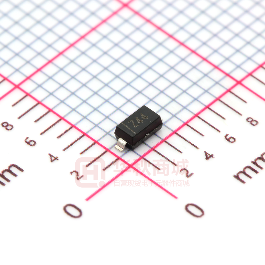

    SOD-123塑料封装二极管VR=400V IF=1A 15pF
2CZ4004 数据手册
JIANGSU CHANGJIANG ELECTRONICS TECHNOLOGY CO., LTD SOD-123 Plastic-Encapsulate Diodes 2CZ4004 RECTIFICATION DIODE SOD-123 FEATURES   Low Leakage Current Ideal for Surface Mounted Applications MARKING:Z44 Z44 Z44 The marking bar indicates the cathode Solid dot = Green molding compound device, if none,the normal device. MAXIMUM RATINGS (Ta=25℃ unless otherwise noted) Symbol VRM VR VR(RMS) IO Parameter Non-repetitive peak reverse voltage Reverse Voltage RMS reverse voltage Average rectified output current Value Unit 400 V 280 V 1 A IFSM Non-repetitive peak forward surge current @t=8.3ms 7.5 A PD Power dissipation 350 mW Thermal resistance from junction to ambient 357 ℃/W TJ Junction temperature 150 ℃ Tstg Storage temperature -55~+150 ℃ RθJA ELECTRICAL CHARACTERISTICS(Ta=25℃ unless otherwise specified) Parameter Symbol Test conditions Reverse voltage V(BR) IR=100μA Reverse current IR VR=400V Forward voltage VF Total capacitance Ctot www.cj-elec.com Min Typ Max 400 Unit V 5 μA IF=1A 1.1 V VR=4V,f=1MHz 15 pF 1 F,Mar,2015 Typical Characteristics Forward Characteristics Reverse 100 Characteristics 1000 Ta=100 ℃ (nA) REVERSE CURRENT IR T= a 2 5℃ =1 00 ℃ a 100 T FORWARD CURRENT IF (mA) 10000 10 10 Ta=25 ℃ 1 0.1 250 500 750 FORWARD VOLTAGE 1000 VF 1 50 1250 100 (mV) 200 300 REVERSE VOLTAGE Capacitance Characteristics 20 VR 400 (V) Power Derating Curve 400 Ta=25℃ (mW) 300 PD 15 POWER DISSIPATION CAPACITANCE BETWEEN TERMINALS CT (pF) f=1MHz 10 5 0 0 5 10 15 REVERSE VOLTAGE www.cj-elec.com 20 VR 25 200 100 0 30 0 25 50 75 AMBIENT TEMPERATURE (V) 2 100 Ta 125 150 (℃) F,Mar,2015 SOD-123 Package Outline Dimensions Dimensions In Millimeters Min Max 1.050 1.250 0.000 0.100 1.050 1.150 0.450 0.650 0.080 0.150 1.500 1.700 2.600 2.800 3.550 3.850 0.500 REF 0.250 0.450 0° 8° Symbol A A1 A2 b c D E E1 L L1 θ Dimensions In Inches Min Max 0.041 0.049 0.000 0.004 0.041 0.045 0.018 0.026 0.003 0.006 0.059 0.067 0.102 0.110 0.140 0.152 0.020 REF 0.010 0.018 0° 8° SOD-123 Suggested Pad Layout www.cj-elec.com 3 F,Mar,2015 SOD-123 Tape and Reel www.cj-elec.com 4 F,Mar,2015
