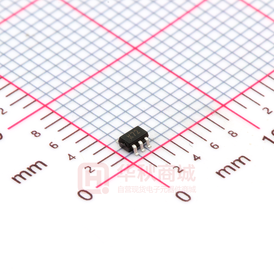

2N7002DW
2N7002DW
    JIANGSU(长晶)
    SOT-363
    MOSFETs 2个N-沟道 60V 115mA SOT-363
2N7002DW 数据手册
JIANGSU CHANGJIANG ELECTRONICS TECHNOLOGY CO., LTD SOT-363 Plastic-Encapsulate MOSFETs 2N7002DW Dual N-channel MOSFET V(BR)DSS ID RDS(on)MAX SOT-363  5Ω@10V  60 V 115mA 6  7Ω@5V   5 4 1 2 3 APPLICATION z Load Switch for Portable Devices z DC/DC Converter FEATURE High density cell design for low RDS(ON) z Voltage controlled small signal switch z Rugged and reliable z High saturation current capability z Equivalent Circuit MARKING MAXIMUM RATINGS (Ta=25℃ unless otherwise noted) Symbol Parameter Value Unit VDS Drain-Source voltage 60 V VGS Gate-Source voltage ±20 V ID Drain Current 115 mA PD Power Dissipation 150 mW RӨJA Thermal Resistance from Junction to Ambient 833 ℃/W TJ Junction Temperature 150 ℃ Tstg Storage Temperature -55-150 ℃ www.cj-elec.com 1 I,Sep,2016 MOSFET ELECTRICAL CHARACTERISTICS Ta =25 ℃ unless otherwise specified Parameter Symbol Drain-source breakdown voltage Test conditions Min Typ Max 1.6 2.5 V(BR)DSS VGS=0 V, ID=250 µA 60 Gate-threshold voltage * Vth(GS) VDS=VGS, ID=250 µA 1 Gate-body leakage lGSS VDS=0 V, VGS=±20 V ±80 Zero gate voltage drain current IDSS VDS=60 V, VGS=0 V 80 Drain-source on-resistance * RDS(on) Forward transconductance * gfs Drain-source on-voltage * VDS(on) Diode forward voltage VSD Input capacitance ** Ciss Output capacitance ** Coss Reverse transfer capacitance ** Crss VGS=10 V, ID=500mA 1.1 5 VGS=5 V, ID=50mA 1.2 7 VDS=10 V, ID=200mA Unit V nA nA Ω 80 500 VGS=10V, ID=500mA 0.5 3.75 V VGS=5V, ID=50mA 0.05 0.375 V IS=115mA, VGS=0 V 0.55 1.2 V ms 50 VDS=25V, VGS=0V, f=1MHz 25 pF 5 SWITCHING TIME Turn-on time ** td(on) VDD=25 V, RL=50Ω 20 Turn-off time ** td(off) ID=500mA,VGEN=10V,G=25 Ω 40 ns * Pulse Test: Pulse width ≤300µs,duty cycle≤2%. ** These parameters have no way to verify. www.cj-elec.com 2 I,Sep,2016 Typical Characteristics Output Characteristics 1.0 0.9 Ta=25℃ VGS=4V,5V,6V Pulsed (A) 0.8 0.7 Ta=25℃ ID 0.7 0.6 VGS=3V DRAIN CURRENT (A) ID VDS=3V 0.9 Pulsed 0.8 DRAIN CURRENT Transfer Characteristics 1.0 0.5 0.4 VGS=2.5V 0.3 0.2 0.5 0.4 0.3 0.2 VGS=2V 0.1 0.0 0.0 Ta=100℃ 0.6 0.5 1.0 1.5 2.0 2.5 3.0 3.5 DRAIN TO SOURCE VOLTAGE 4.0 VDS 4.5 0.1 0.0 5.0 0 1 (V) 2 3 4 5 GATE TO SOURCE VOLTAGE 6 VGS 7 RDS(ON) —— VGS RDS(ON) —— ID 2.0 7 Pulsed Ta=25℃ Pulsed RDS(ON) ON-RESISTANCE 1.4 VGS=5V ON-RESISTANCE RDS(ON) 1.6 ( ) 6 ( ) 1.8 8 (V) 1.2 VGS=10V 1.0 ID=500mA 5 4 3 Ta=100℃ 2 1 Ta=25℃ 0.8 0.1 0.2 0.3 0.4 0.5 0.7 0.6 DRAIN CURRENT ID 0.8 0.9 0 1.0 0 (A) 1 2 3 4 5 7 6 GATE TO SOURCE VOLTAGE VGS 8 9 10 (V) Threshold Voltage IS —— VSD 1 2.0 1.8 VTH THRESHOLD VOLTAGE SOURCE CURRENT IS (A) (V) Pulsed 0.1 Ta=100℃ 0.01 0.0 0.2 0.4 Ta=25℃ 0.6 0.8 1.0 SOURCE TO DRAIN VOLTAGE www.cj-elec.com 1.2 1.4 1.4 1.2 1.0 25 1.6 VSD (V) ID=250uA 1.6 50 75 JUNCTION TEMPERATURE 3 100 Tj 125 (℃ ) I,Sep,2016 SOT-363 Package Outline Dimensions Symbol A A1 A2 b c D E E1 e e1 L L1 θ Dimensions In Millimeters Min Max 0.900 1.100 0.000 0.100 0.900 1.000 0.150 0.350 0.100 0.150 2.000 2.200 1.150 1.350 2.150 2.400 0.650 TYP 1.200 1.400 0.525 REF 0.260 0.460 0° 8° Dimensions In Inches Max Min 0.035 0.043 0.000 0.004 0.035 0.039 0.006 0.014 0.004 0.006 0.079 0.087 0.045 0.053 0.085 0.094 0.026 TYP 0.047 0.055 0.021 REF 0.010 0.018 0° 8° SOT-363 Suggested Pad Layout www.cj-elec.com 4 I,Sep,2016 SOT-363 Tape and Reel SOT-363 Tape and reel SOT-363 Embossed Carrier Tape P0 C d P1 Packaging Description: SOT-363 parts are shipped in tape. The carrier tape is made from a dissipative (carbon filled) polycarbonate resin. The cover tape is a multilayer film (Heat Activated Adhesive in nature) primarily composed of polyester film, adhesive layer, sealant, and anti-static sprayed agent. These reeled parts in standard option are shipped with 3,000 units per 7" or 17.8cm diameter reel. The reels are clear in color and is made of polystyrene plastic (anti-static coated). B F W E A P A A A-A Dimensions are in millimeter Pkg type A B C d E F P0 P P1 W SOT-363 2.25 2.55 1.20 Ø1.50 1.75 3.50 4.00 4.00 2.00 8.00 SOT-363 Tape Leader and Trailer Leader Tape Trailer Tape 50±2 Empty Pockets 100±2 Empty Pockets Components SOT-363 Reel D I G W2 3000 H 2500 2000 1500 1000 D2 D1 500 W1 Dimensions are in millimeter Reel Option D D1 D2 G H I W1 W2 7''Dia Ø178.00 54.40 13.00 R78.00 R25.60 R6.50 9.50 12.30 G.W.(kg) REEL Reel Size Box Box Size(mm) Carton Carton Size(mm) 3000 pcs 7 inch 30,000 pcs 203×203×195 120,000 pcs 438×438×220 www.cj-elec.com 5 I,Sep,2016
