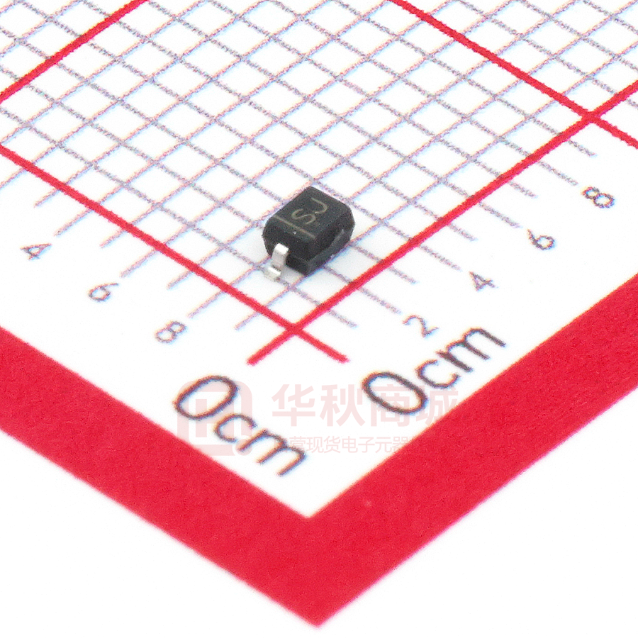

JIANGSU CHANGJING ELECTRONICS TECHNOLOGY CO., LTD SOD-323 Plastic-Encapsulate Diodes B5817WS-5819WS SCHOTTKY BARRIER DIODE SOD-323 FEATURES For use in low voltage, high frequency inverters Free wheeling, and polarity protection applications MARKING: B5817WS:SJ B5818WS:SK B5819WS:SL The marking bar indicates the cathode Solid dot = Green molding compound device,if none, the normal device. Maximum Ratings and Electrical Characteristics, Single Diode @Ta=25℃ Parameter Symbol B5818WS B5817WS B5819WS Unit Non-repetitive peak reverse voltage VRM 20 30 40 V Peak repetitive peak reverse voltage Working peak reverse voltage DC blocking voltage VRRM VRWM VR 20 30 40 V RMS reverse voltage VR(RMS) 14 21 28 V Average rectified output current IO Non-repetitive Peak Forward Surge Current @t=8.3ms Repetitive peak forward current 1 A IFSM 9 A IFRM 1.5 A Pd 250 mW Thermal resistance junction to ambient RθJA 400 ℃/W Operating Junction Temperature Range TJ 125 ℃ TSTG -55~+150 ℃ Power dissipation Storage Temperature Range ELECTRICAL CHARACTERISTICS (Ta= 25℃ unles s other wise specified) Pa rameter Symbol Test c onditions IR= 1mA Reverse breakdown voltage Reverse voltage leakage current Forward voltage VF VR= 20V VR= 30V VR= 40V B5817WS IF=1A 0.45 IF=3A 0.75 IF=1A 0.55 IF=3A 0.875 IF=1A 0.6 IF=3A 0.9 B5818WS B5819WS Diode capacitance www.jscj-elec.com CD Max B5817WS B5818WS B5819WS B5817WS B5818WS B5819WS V(BR) IR Min VR=4V, f=1MHz 1 20 30 40 Unit V 1 120 mA V V V pF Rev. - 2.1 B5817WS Typical Characteristics Forward Characteristics Reverse 1000 (mA) Ta=100℃ REVERSE CURRENT IR FORWARD CURRENT Characteristics 1 IF (mA) 3000 100 Ta=25℃ Ta=100℃ 0.1 Ta=25℃ 0.01 10 200 400 FORWARD VOLTAGE 600 1E-3 0.1 800 Capacitance Characteristics 250 1 10 REVERSE VOLTAGE VF (mV) VR 20 (V) Power Derating Curve 300 (mW) f=1MHz PD 200 150 POWER DISSIPATION CAPACITANCE BETWEEN TERMINALS CT (pF) Ta=25℃ 100 50 0 250 200 150 100 50 0 www.jscj-elec.com 5 10 REVERSE VOLTAGE VR (V) 15 0 20 0 25 50 75 AMBIENT TEMPERATURE 2 100 Ta 125 150 (℃ ) Rev. - 2.1 CHANGJING ELEC.TECH. PACKAGE OUTLINE AND PAD LAYOUT INFORMATION Dimensions In Millimeters Min Max 1.100 0.000 0.100 1.000 0.800 0.250 0.350 0.080 0.150 1.200 1.400 1.600 1.800 2.750 2.500 0.475 REF 0.250 0.400 0° 8° Symbol A A1 A2 b c D E E1 L L1 θ Dimensions In Inches Min Max 0.043 0.000 0.004 0.039 0.031 0.010 0.014 0.003 0.006 0.047 0.055 0.063 0.071 0.098 0.108 0.019 REF 0.010 0.016 0° 8° NOTICE JSCJ reserves the right to make modifications,enhancements,improvements,corrections or other changes without further notice to any product herein. JSCJ does not assume any liability arising out of the application or use of any product described herein. www.jscj-elec.com 3 Rev. - 2.1 SOD-323 Tape and Reel www.jscj-elec.com 4 Rev. - 2.1

1. 物料型号:B5817WS、B5818WS、B5819WS,这些是肖特基势垒二极管,用于低电压、高频率的逆变器、自由轮和极性保护应用。
2. 器件简介:这些二极管适用于低电压、高频率的逆变器、自由轮和极性保护应用。
3. 引脚分配:文档中提到了SOD-323封装的引脚布局,但没有具体说明每个引脚的功能。
4. 参数特性:提供了最大额定值和电气特性,包括非重复峰值反向电压、峰值重复峰值反向电压、RMS反向电压、平均整流输出电流、非重复峰值正向浪涌电流、重复峰值正向电流、功率耗散、结到环境的热阻、工作结温范围和存储温度范围。
5. 功能详解:文档提供了正向特性和反向特性的图表,展示了在不同条件下的电压和电流表现。
6. 应用信息:二极管适用于低电压、高频率的逆变器、自由轮和极性保护应用。
7. 封装信息:详细介绍了SOD-323封装的尺寸和建议的焊盘布局,以及胶带和卷轴的包装描述。
