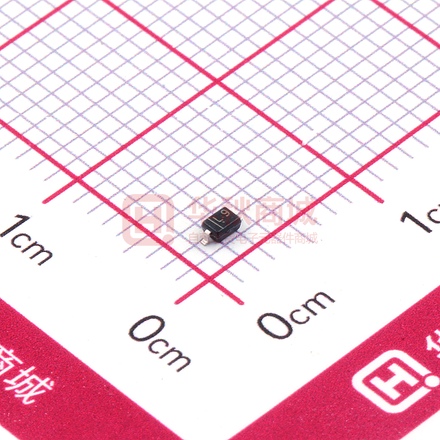

JIANGSU CHANGJING ELECTRONICS TECHNOLOGY CO., LTD SOD-323 Plastic-Encapsulate Diodes BAT54WS SOD-323 Schottky Barrier Diode FEATURES z Extremely Fast Switching Speed z Low Forward Voltage MARKING: L9 The marking bar indicates the cathode Solid dot = Green molding compound device,if none, the normal device. Maximum Ratings @Ta=25℃ Parameter Symbol Limit Unit Non-Repetitive Peak Reverse Voltage VRM 30 V DC Blocking Voltage VR 21 V Average Rectified Output Current IO 100 mA Forward Continuous Current IF 200 mA Repetitive Peak Forward Current IFRM 300 mA Non-repetitive Peak Forward Surge Current @t=8.3ms IFSM 600 mA Power Dissipation PD 200 mW RθJA 500 ℃/W Thermal Resistance Junction to Ambient Operating Junction Temperature Range TJ -40 ~ +125 ℃ Storage Temperature Range TSTG -55 ~ +150 ℃ Electrical Characteristics @Ta=25℃ Parameter Symbol Conditions Min V (BR) IR=100μA 30 VF1 IF=0.1mA 240 mV VF2 = IF 1.0mA 320 mV VF3 = IF 10mA 400 mV VF4 = IF 30mA 500 mV VF5 = IF 100mA 1000 mV Reverse current IR = VR 25V 2.0 uA Reverse recovery time trr 5.0 ns Capacitance between terminals CT 10 pF Reverse breakdown voltage Forward voltage www.jscj-elec.com IF=10mA, IR=10mA to 1mA , RL=100Ω VR=1V,f=1MHz 1 Typ Max Unit V Rev. - 2.1 Typical Characteristics Forward Characteristics 200 Reverse Characteristics 100 Pulsed Pulsed (uA) T= a 2 5℃ FORWARD CURRENT 10 REVERSE CURRENT IR a T IF =1 00 ℃ (mA) 100 1 0.1 0 200 400 FORWARD VOLTAGE 600 VF Ta=25℃ 0.1 0 (mV) 5 10 15 20 REVERSE VOLTAGE Capacitance Characteristics 20 1 0.01 800 Ta=100℃ 10 25 VR 30 (V) Power Derating Curve 250 (mW) f=1MHz 200 PD 16 12 POWER DISSIPATION CAPACITANCE BETWEEN TERMINALS CT (pF) Ta=25℃ 8 4 0 0 5 10 REVERSE VOLTAGE www.jscj-elec.com 15 VR 150 100 50 0 20 0 25 50 75 AMBIENT TEMPERATURE (V) 2 100 Ta 125 (℃) Rev. - 2.1 CHANGJING ELEC.TECH. PACKAGE OUTLINE AND PAD LAYOUT INFORMATION Dimensions In Millimeters Min Max 1.100 0.000 0.100 1.000 0.800 0.250 0.350 0.080 0.150 1.200 1.400 1.600 1.800 2.750 2.500 0.475 REF 0.250 0.400 0° 8° Symbol A A1 A2 b c D E E1 L L1 θ Dimensions In Inches Min Max 0.043 0.000 0.004 0.039 0.031 0.010 0.014 0.003 0.006 0.047 0.055 0.063 0.071 0.098 0.108 0.019 REF 0.010 0.016 0° 8° NOTICE JSCJ reserves the right to make modifications,enhancements,improvements,corrections or other changes without further notice to any product herein. JSCJ does not assume any liability arising out of the application or use of any product described herein. www.jscj-elec.com 3 Rev. - 2.1 SOD-323 Tape and Reel www.jscj-elec.com 4 Rev. - 2.1
