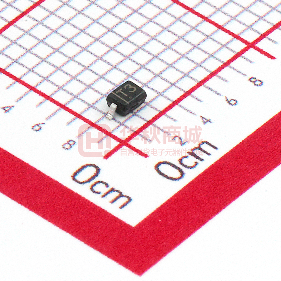

BAV21WS
BAV21WS
    JIANGSU(长晶)
    SOD-323
    开关二极管(小信号)SOD323 VR=250V Io=200mA IR=0.1μA
BAV21WS 数据手册
JIANGSU CHANGJING ELECTRONICS TECHNOLOGY CO., LTD SOD-323 Plastic-Encapsulate Diodes BAV19WS~BAV21WS SWITCHING DIODE SOD-323 FEATURES Low Reverse Current z Surface Mount Package Ideally Suited for Automatic Insertion z Fast Switching Speed For General Purpose Switching Applications z z MARKING: BAV19WS A8 BAV20WS T2 BAV21WS T3 T2 T3 A8 The marking bar indicates the cathode Solid dot = Green molding compound device. MAXIMUM RATINGS ( Ta=25℃ unless otherwise noted ) Value Symbol Parameter VRM Non-Repetitive Peak Reverse Voltage VRRM Peak Repetitive Reverse Voltage VRWM Working Peak Reverse Voltage VR(RMS) Unit BAV19WS BAV20WS BAV21WS 120 200 250 100 150 200 71 106 141 RMS Reverse Voltage V V V Average Rectified Output Current 200 mA IFSM Non-repetitive Peak Forward Surge Current @ t= 8.3ms 2.0 A IFRM Repetitive Peak Forward Surge Current 625 mA Power Dissipation 250 mW Thermal Resistance from Junction to Ambient 500 ℃/W -55~+150 ℃ IO PD RΘJA Operation Junction and Storage Temperature Range TJ,Tstg ELECTRICAL CHARACTERISTICS(Ta=25℃ unless otherwise specified) Parameter Reverse current Symbol Test conditions Min BAV19WS 0.1 IR = VR 150V BAV20WS 0.1 VR 200V = BAV21WS 0.1 1 1.25 Total capacitance = = VR 0V,f 1MHz Ctot www.jscj-elec.com Max = VR 100V = IF 100mA VF Forward voltage = IF 200mA Reverse recovery time Typ trr IF= IR =30mA, Irr=0.1*IR , RL=100Ω 1 Unit uA V 5 pF 50 ns Rev. - 2.2 BAV19WS Typical Characteristics Forward Characteristics Reverse 1000 400 100 (nA) REVERSE CURRENT IR 30 Ta =2 5℃ Ta =1 00 ℃ FORWARD CURRENT Ta=100℃ 100 IF (mA) 300 Characteristics 10 30 Ta=25℃ 10 3 1 3 0.3 1 0.2 0.4 0.6 0.8 FORWARD VOLTAGE 1.0 VF 1.2 0.1 1.4 20 40 60 REVERSE VOLTAGE 80 VR 100 120 125 150 (V) Power Derating Curve Capacitance Characteristics 1.4 0 (V) 300 250 PD (mW) 1.2 1.0 POWER DISSIPATION CAPACITANCE BETWEEN TERMINALS CT (pF) Ta=25℃ f=1MHz 0.8 0.6 0.4 200 150 100 50 0 5 10 REVERSE VOLTAGE www.jscj-elec.com 15 VR 0 20 (V) 0 25 50 75 AMBIENT TEMPERATURE 2 100 Ta (℃) Rev. - 2.2 CHANGJING ELEC.TECH. PACKAGE OUTLINE AND PAD LAYOUT INFORMATION Dimensions In Millimeters Min Max 1.100 0.000 0.100 1.000 0.800 0.250 0.350 0.080 0.150 1.200 1.400 1.600 1.800 2.750 2.500 0.475 REF 0.250 0.400 0° 8° Symbol A A1 A2 b c D E E1 L L1 θ Dimensions In Inches Min Max 0.043 0.000 0.004 0.039 0.031 0.010 0.014 0.003 0.006 0.047 0.055 0.063 0.071 0.098 0.108 0.019 REF 0.010 0.016 0° 8° NOTICE JSCJ reserves the right to make modifications,enhancements,improvements,corrections or other changes without further notice to any product herein. JSCJ does not assume any liability arising out of the application or use of any product described herein. www.jscj-elec.com 3 Rev. - 2.2 SOD-323 Tape and Reel www.jscj-elec.com 4 Rev. - 2.2
