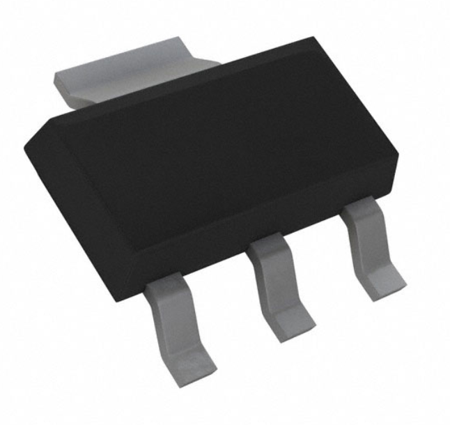

BCP52-16
BCP52-16
    JIANGSU(长晶)
    SOT-223
    Triode PNP Ic=-1A Vceo=-60V hfe=100~250 P=1.5W SOT223
BCP52-16 数据手册
JIANGSU CHANGJIANG ELECTRONICS TECHNOLOGY CO., LTD SOT-223 Plastic-Encapsulate Transistors BCP51,52,53 TRANSISTOR (PNP) SOT-223 FEATURES z z z z For AF driver and output stages High collector current Low collector-emitter saturation voltage Complementary types: BCP54...BCP56 (NPN) 1. BASE 2. COLLECTOR 3. EMITTER MAXIMUM RATINGS (Ta=25℃ unless otherwise noted) Symbol Parameter VCBO Unit BCP51 BCP52 BCP53 Collector-Base Voltage -45 -60 -100 V VCEO Collector-Emitter Voltage -45 -60 -80 V VEBO Emitter-Base Voltage -5 V IC Collector Current -Continuous -1 A PC Collector Power Dissipation 1.5 W RθJA Thermal Resistance Junction to Ambient 94 ℃/W Tstg Storage Temperature Range ℃ -65~+150 ELECTRICAL CHARACTERISTICS (Ta=25℃ unless otherwise specified) Symbol Parameter Collector-base breakdown voltage Min BCP51 BCP52 Collector-emitter breakdown voltage Test conditions V(BR)CBO IC=- 0.1mA,IE=0 -60 -100 BCP51 -45 V(BR)CEO V -80 V(BR)EBO Collector cut-off current V -60 IC= -10mA,IB=0 BCP53 Base-emitter breakdown voltage Unit -45 BCP53 BCP52 Max IE = -10μA,IC=0 -5 V ICBO VCB= -30 V, IE=0 hFE(1) VCE=-2V, IC=-5mA 25 hFE(2) VCE= -2V, IC=-150m A 63 hFE(3) VCE= -2V, IC=-500m A 25 VCE(sat) IC=-500mA,IB=-50mA -0.5 V Base-emitter voltage VBE VCE=-2V, IC=-500m A -1 V Transition frequency fT DC current gain Collector-emitter saturation voltage -100 VCE=-10V,IC=-50mA,f=100MHz 100 nA 250 MHz CLASSIFICATION OF hFE(2) Rank Range www.cj-elec.com BCP51-10, BCP52-10, BCP53-10 BCP51-16, BCP52-16, BCP53-16 63-160 100-250 14 E,Jan,2017 hTypical Characteristics Typical Characteristics ha Static Characteristic —— IC COMMON EMITTER VCE= -2V Ta=100℃ -1mA hFE (mA) COMMON EMITTER Ta=25℃ -200 DC CURRENT GAIN IC -0.9mA -0.8mA -150 COLLECTOR CURRENT hFE 1000 -250 -0.7mA -0.6mA -100 -0.5mA -0.4mA Ta=25℃ 100 -0.3mA -50 -0.2mA IB=-0.1mA 10 -0 -0 -1 -2 -3 -4 COLLECTOR-EMITTER VOLTAGE VBEsat —— -1000 -5 -1 IC VCEsat -1000 COLLECTOR-EMITTER SATURATION VOLTAGE VCEsat (mV) -800 BASE-EMITTER SATURATION VOLTAGE VBEsat (mV) -100 IC —— -1000 (mA) IC β=10 β=10 Ta=25℃ -600 Ta=100 ℃ -400 -200 -0 -0.1 -1 -10 IC -1000 —— IC Ta=100 ℃ -100 Ta=25℃ -10 -0.1 -1000 -100 COLLECTOR CURREMT -1 -10 COLLECTOR CURREMT (mA) VBE fT 300 -1000 (mA) IC Ta=25℃ T =2 5℃ a -10 TRANSITION FREQUENCY 100 T =1 00℃ a COLLECTOR CURRENT IC fT -100 —— -100 IC COMMON EMITTER VCE=-10V (MHz) COMMON EMITTER VCE=-2V (mA) -10 COLLECTOR CURRENT VCE (V) -1 -0.1 -0 -200 -400 -600 -800 -1000 10 -3 -1200 -10 -20 1000 Cob/Cib —— VCB/VEB COLLECTOR POWER DISSIPATION PC (mW) (pF) —— IC -50 -60 125 150 (mA) Ta 1200 100 C CAPACITANCE -40 1500 Ta=25 ℃ Cib Cob 10 900 600 300 0 -1 REVERSE VOLTAGE www.cj-elec.com PC 1800 f=1MHz IE=0/IC=0 1 -0.1 -30 COLLECTOR CURRENT BASE-EMMITER VOLTAGE VBE (mV) -10 V 0 -30 25 50 75 AMBIENT TEMPERATURE (V) 2 100 Ta (℃ ) E,Jan,2017 SOT-223 Package Outline Dimensions Symbol A A1 A2 b b1 c D E E1 e L θ Dimensions In Millimeters Min. Max. —— 1.800 0.020 0.100 1.500 1.700 0.660 0.840 2.900 3.100 0.230 0.350 6.300 6.700 6.700 7.300 3.300 3.700 2.300(BSC) 0.750 —— 0° 10° Dimensions In Inches Min. Max. —— 0.071 0.001 0.004 0.059 0.067 0.026 0.033 0.114 0.122 0.009 0.014 0.248 0.264 0.264 0.287 0.130 0.146 0.091(BSC) 0.030 —— 0° 10° SOT-223 Suggested Pad Layout www.cj-elec.com 3 E,Jan,2017 SOT-223 Tape and Reel P1 C A E P0 d SOT-223 Embossed Carrier Tape A B F W A A A A-A P Packaging Description: SOT-223 parts are shipped in tape. The carrier tape is made from a dissipative (carbon filled) polycarbonate resin. The cover tape is a multilayer film (Heat Activated Adhesive in nature) primarily composed of polyester film, adhesive layer, sealant, and anti-static sprayed agent. These reeled parts in standard option are shipped with 2,500 units per 13" or 33.0cm diameter reel. The reels are clear in color and is made of polystyrene plastic (anti-static coated). Dimensions are in millimeter Pkg type A B C d E F P0 SOT-223 6.765 7.335 1.88 Ø1.50 1.75 5.50 4.00 P P1 W 8.00 2.00 12.00 SOT-223 Tape Leader and Trailer Leader Tape Trailer Tape Components 51±1 Empty Pockets G SOT-223 Reel 51±1 Empty Pockets H W1 D1 D2 I W2 D Dimensions are in millimeter Reel Option D D1 D2 G H I W1 W2 13''Dia Ø330.00 100.00 13.00 R151.00 R56.00 R6.50 12.40 17.60 Carton Size(mm) G.W.(kg) REEL 2,500 pcs www.cj-elec.com Reel Size 13 inch Box 2,500 pcs Box Size(mm) 336×336×48 4 Carton 20,000 pcs 445×355×365 E,Jan,2017
