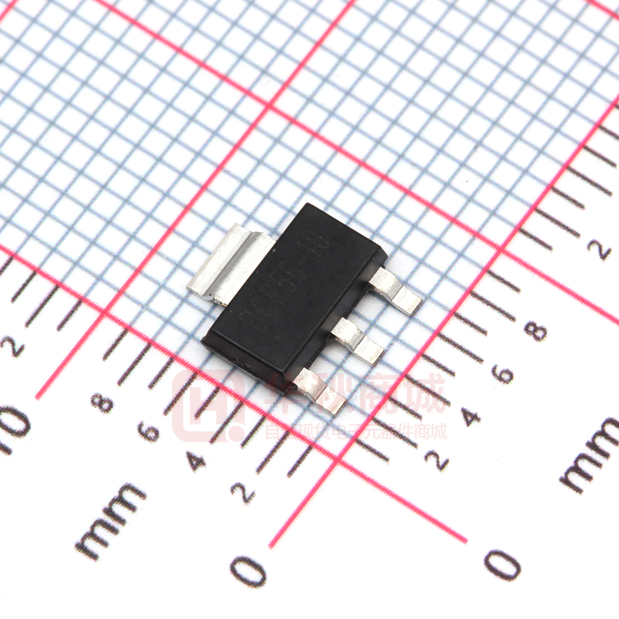

    NPN Ic=1A Vceo=80V hfe=63~160 P=1.5W SOT-223
BCP56-10 数据手册
JIANGSU CHANGJIANG ELECTRONICS TECHNOLOGY CO., LTD SOT-223 Plastic-Encapsulate Transistors BCP54,55,56 SOT-223 TRANSISTOR (NPN) FEATURES z For AF driver and output stages z High collector current z Low collector-emitter saturation voltage z Complementary types: BCP51 ... BCP53 (PNP) 1. BASE 2. COLLECTOR 3. EMITTER MAXIMUM RATINGS (Ta=25℃ unless otherwise noted) Symbol Parameter BCP54 BCP55 BCP56 Unit VCBO Collector-Base Voltage 45 60 100 V VCEO Collector-Emitter Voltage 45 60 80 V VEBO Emitter-Base Voltage 5 V IC Collector Current -Continuous 1 A PC Collector Power Dissipation 1.5 W RθJA Thermal Resistance Junction to Ambient 83.3 ℃/W Tstg Storage Temperature Range ℃ -65~+150 ELECTRICAL CHARACTERISTICS (Ta=25℃ unless otherwise specified) Symbol Parameter Collector-base breakdown voltage Min V(BR)CBO IC= 0.1mA,IE=0 100 BCP54 45 V(BR)CEO IC= 10mA,IB=0 V V 60 80 BCP56 V(BR)EBO Base-emitter breakdown voltage Unit 60 BCP56 BCP55 Max 45 BCP54 BCP55 Collector-emitter breakdown voltage Test conditions IE = 10μA,IC=0 5 V ICBO VCB= 30 V, IE=0 hFE(1) VCE= 2V, IC=5mA 25 hFE(2) VCE= 2V, IC=150m A 63 hFE(3) VCE= 2V, IC=500m A 25 VCE(sat) IC=500mA,IB=50mA 0.5 V Base-emitter voltage VBE VCE=2V, IC=500m A 1 V Transition frequency fT Collector cut-off current DC current gain Collector-emitter saturation voltage 100 VCE=10V,IC=50mA,f=100MHz 100 nA 250 MHz CLASSIFICATION OF hFE(2) Rank Range Marking www.cj-elec.com BCP54-10, BCP55-10, BCP56-10 BCP54-16, BCP55-16, BCP56-16 63-160 100-250 BCP54-10, BCP55-10, BCP56-10 BCP54-16, BCP55-16, BCP56-16 1 G,Jan,2017 hTypical Characteristics Typical Characteristics Static Characteristic (mA) 250 hFE IC 0.8mA DC CURRENT GAIN COLLECTOR CURRENT —— IC COMMON EMITTER VCE=2V COMMON EMITTER Ta=25℃ 0.9mA 150 hFE 1000 1.0mA 200 ha 0.7mA 0.6mA 100 0.5mA 0.4mA 0.3mA 50 Ta=100℃ 300 Ta=25℃ 100 30 0.2mA IB=0.1mA 0 10 0 1 2 3 4 COLLECTOR-EMITTER VOLTAGE VCEsat 1000 —— VCE 5 1 IC VBEsat 1.0 BASE-EMMITTER SATURATION VOLTAGE VBEsat (V) COLLECTOR-EMMITTER SATURATION VOLTAGE VCEsat (mV) 300 100 Ta=100℃ Ta=25℃ 30 —— 1000 (mA) IC 0.8 Ta=25℃ Ta=100℃ 0.6 0.4 1 10 100 COLLECTOR CURRENT IC 1000 —— IC 1000 1 (mA) 10 (mA) 100 COLLECTOR CURRENT VBE Cob/ Cib 300 COMMON EMITTER VCE=2V —— IC 1000 (mA) VCB/ VEB f=1MHz IE=0/IC=0 Cib 100 Ta=25℃ (pF) Ta=100℃ C 100 Ta=25℃ 10 1 0.2 0.4 0.6 0.8 BASE-EMITTER VOLTAGE fT —— VBE 10 1 0.3 (V) PC 1800 COLLECTOR POWER DISSIPATION PC (mW) 100 COMMON EMITTER VCE=10V 10 3 REVERSE BIAS VOLTAGE IC TRANSITION FREQUENCY Cob 1 0.1 1.0 (MHz) 300 CAPACITANCE IC IC β=10 10 COLLECTOR CURRENT 100 COLLECTOR CURRENT β=10 fT 10 (V) —— V 20 (V) Ta 1500 1200 900 600 300 Ta=25℃ 10 10 COLLECTOR CURRENT www.cj-elec.com 0 100 30 IC 0 (mA) 25 50 75 AMBIENT TEMPERATURE 2 100 Ta 125 150 (℃ ) G,Jan,2017 SOT-223 Package Outline Dimensions Symbol A A1 A2 b b1 c D E E1 e L θ Dimensions In Millimeters Min. Max. —— 1.800 0.020 0.100 1.500 1.700 0.660 0.840 2.900 3.100 0.230 0.350 6.300 6.700 6.700 7.300 3.300 3.700 2.300(BSC) 0.750 —— 0° 10° Dimensions In Inches Min. Max. —— 0.071 0.001 0.004 0.059 0.067 0.026 0.033 0.114 0.122 0.009 0.014 0.248 0.264 0.264 0.287 0.130 0.146 0.091(BSC) 0.030 —— 0° 10° SOT-223 Suggested Pad Layout www.cj-elec.com 3 G,Jan,2017 SOT-223 Tape and Reel P1 C A E P0 d SOT-223 Embossed Carrier Tape A B F W A A A A-A P Packaging Description: SOT-223 parts are shipped in tape. The carrier tape is made from a dissipative (carbon filled) polycarbonate resin. The cover tape is a multilayer film (Heat Activated Adhesive in nature) primarily composed of polyester film, adhesive layer, sealant, and anti-static sprayed agent. These reeled parts in standard option are shipped with 2,500 units per 13" or 33.0cm diameter reel. The reels are clear in color and is made of polystyrene plastic (anti-static coated). Dimensions are in millimeter Pkg type A B C d E F P0 SOT-223 6.765 7.335 1.88 Ø1.50 1.75 5.50 4.00 P P1 W 8.00 2.00 12.00 SOT-223 Tape Leader and Trailer Leader Tape Trailer Tape Components 51±1 Empty Pockets G SOT-223 Reel 51±1 Empty Pockets H W1 D1 D2 I W2 D Dimensions are in millimeter Reel Option D D1 D2 G H I W1 W2 13''Dia Ø330.00 100.00 13.00 R151.00 R56.00 R6.50 12.40 17.60 Carton Size(mm) G.W.(kg) REEL 2,500 pcs www.cj-elec.com Reel Size 13 inch Box 2,500 pcs Box Size(mm) 336×336×48 4 Carton 20,000 pcs 445×355×365 G,Jan,2017
