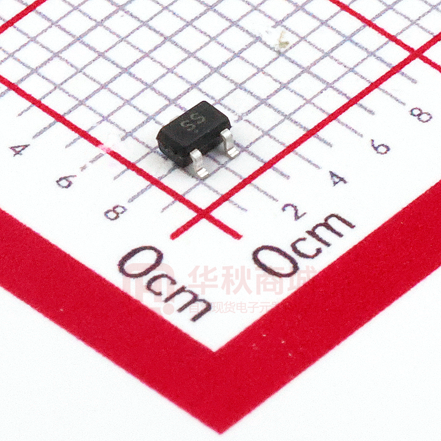

SOT-23 Plastic-Encapsulate MOSFETS
BSS138:
N-Channel 50-V(D-S) MOSFET
V(BR)DSS
ID
RDS(on)MAX
SOT-23
3
3.5Ω@10V
50 V
220mA
6Ω@4.5V
1. GATE
2. SOURCE
1
2
3. DRAIN
FEATURE
z High density cell design for extremely low RDS(on)
z Rugged and Relaible
APPLICATION
z
Direct Logic-Level Interface: TTL/CMOS
z
Drivers: Relays, Solenoids, Lamps, Hammers,Display,
Memories, Transistors, etc.
z
Battery Operated Systems
z
Solid-State Relays
Equivalent Circuit
MARKING
Maximum ratings (Ta=25℃ unless otherwise noted)
Parameter
Symbol
Value
Unit
Drain-Source Voltage
VDS
50
Continuous Gate-Source Voltage
VGSS
±20
Continuous Drain Current
ID
0.22
A
Power Dissipation
PD
0.3
W
RθJA
417
℃/W
Tj
150
Tstg
-55 ~+150
Thermal Resistance from Junction to Ambient
Operating Temperature
Storage Temperature
