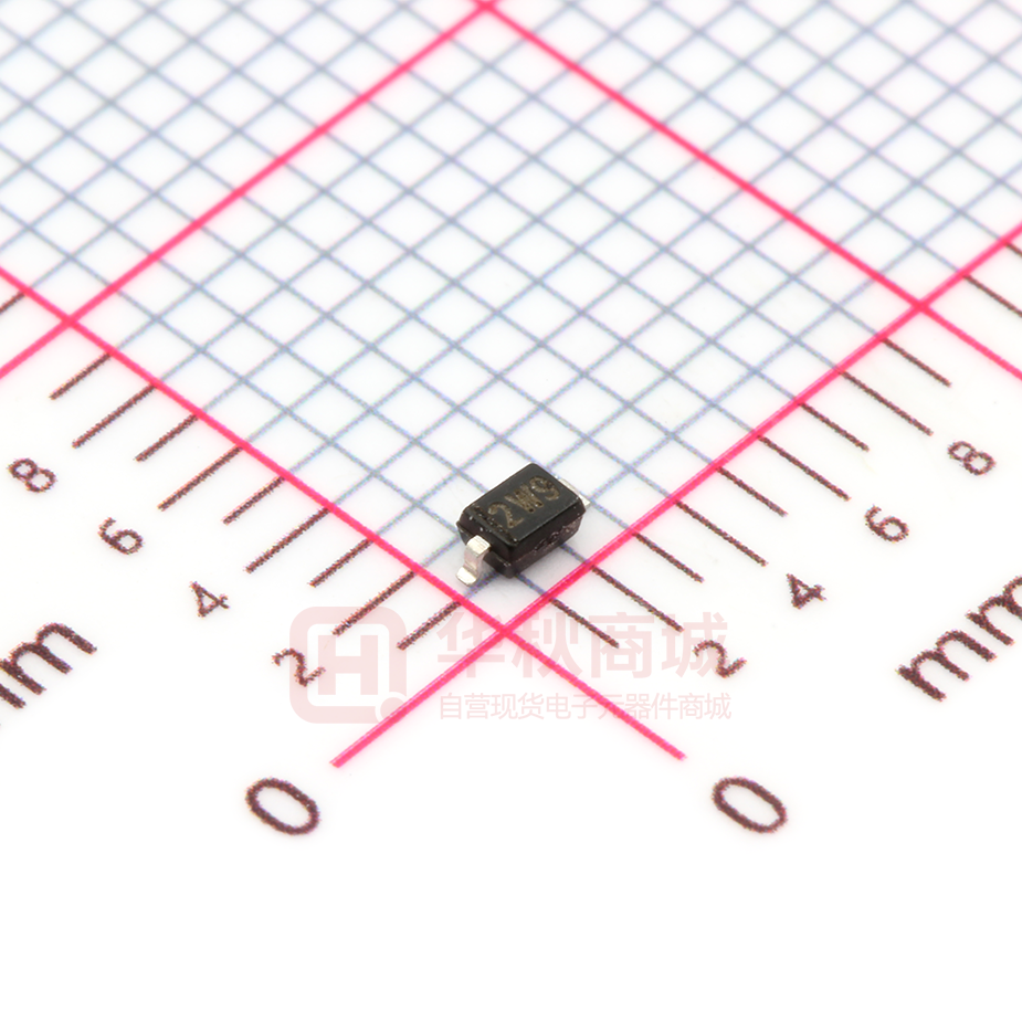

BZT52B5V6S
BZT52B5V6S
    JIANGSU(长晶)
    SOD-323
    稳压二极管 Vz=5.6V 5.49V~5.71V Izt=5mA P=200mW SOD323
BZT52B5V6S 数据手册
JIANGSU CHANGJIANG ELECTRONICS TECHNOLOGY CO., LTD SOD-323 Plastic-Encapsulate Diodes BZT52B2V4S-BZT52B39S ZENER DIODE SOD-323 FEATURE z Planar Die Construction z General Purpose, Medium Current z Ideally Suited for Automated Assembly Processes z Available in Lead Free Version Maximum Ratings(Ta=25℃ unless otherwise specified) Characteristic Symbol Value Unit VF 0.9 V Power Dissipation(Note 1) Pd 200 mW Thermal Resistance from Junction to Ambient RθJA 625 Я/W Junction Temperature Tj 150 Storage Temperature Range Tstg -55 ~ +150 Forward Voltage (Note 2) www.cj-elec.com @ IF = 10mA 1 Я Я E,Mar,2015 ELECTRICAL CHARACTERISTICS Ta=25℃ unless otherwise specified Type Type Number Code Maximum Zener Impedance Zener Voltage Range (Note 2) VZ@IZT Maximum Reverse (Note 3) IZT Nom(V) Min(V) Max(V) mA ZZT@IZT ZZK@IZK Ω Current Typical Temperature Coefficent @IZTC Test Current IZTC IZK IR VR mV/°C mA μA V Min Max mA BZT52B2V4S 2WX 2.4 2.35 2.45 5 100 600 1.0 50 1.0 -3.5 0 5 BZT52B2V7S 2W1 2.7 2.65 2.75 5 100 600 1.0 20 1.0 -3.5 0 5 BZT52B3V0S 2W2 3.0 2.94 3.06 5 95 600 1.0 10 1.0 -3.5 0 5 BZT52B3V3S 2W3 3.3 3.23 3.37 5 95 600 1.0 5 1.0 -3.5 0 5 BZT52B3V6S 2W4 3.6 3.53 3.67 5 90 600 1.0 5 1.0 -3.5 0 5 BZT52B3V9S 2W5 3.9 3.82 3.98 5 90 600 1.0 3 1.0 -3.5 0 5 BZT52B4V3S 2W6 4.3 4.21 4.39 5 90 600 1.0 3 1.0 -3.5 0 5 BZT52B4V7S 2W7 4.7 4.61 4.79 5 80 500 1.0 3 2.0 -3.5 0.2 5 BZT52B5V1S 2W8 5.1 5.00 5.20 5 60 480 1.0 2 2.0 -2.7 1.2 5 BZT52B5V6S 2W9 5.6 5.49 5.71 5 40 400 1.0 1 2.0 -2.0 2.5 5 BZT52B6V2S 2WA 6.2 6.08 6.32 5 10 150 1.0 3 4.0 0.4 3.7 5 BZT52B6V8S 2WB 6.8 6.66 6.94 5 15 80 1.0 2 4.0 1.2 4.5 5 BZT52B7V5S 2WC 7.5 7.35 7.65 5 15 80 1.0 1 5.0 2.5 5.3 5 BZT52B8V2S 2WD 8.2 8.04 8.36 5 15 80 1.0 0.7 5.0 3.2 6.2 5 BZT52B9V1S 2WE 9.1 8.92 9.28 5 15 100 1.0 0.5 6.0 3.8 7.0 5 BZT52B10S 2WF 10 9.80 10.20 5 20 150 1.0 0.2 7.0 4.5 8.0 5 BZT52B11S 2WG 11 10.78 11.22 5 20 150 1.0 0.1 8.0 5.4 9.0 5 BZT52B12S 2WH 12 11.76 12.24 5 25 150 1.0 0.1 8.0 6.0 10.0 5 BZT52B13S 2WI 13 12.74 13.26 5 30 170 1.0 0.1 8.0 7.0 11.0 5 BZT52B15S 2WJ 15 14.70 15.30 5 30 200 1.0 0.1 10.5 9.2 13.0 5 BZT52B16S 2WK 16 15.68 16.32 5 40 200 1.0 0.1 11.2 10.4 14.0 5 BZT52B18S 2WL 18 17.64 18.36 5 45 225 1.0 0.1 12.6 12.4 16.0 5 BZT52B20S 2WM 20 19.60 20.40 5 55 225 1.0 0.1 14.0 14.4 18.0 5 BZT52B22S 2WN 22 21.56 22.44 5 55 250 1.0 0.1 15.4 16.4 20.0 5 BZT52B24S 2WO 24 23.52 24.48 5 70 250 1.0 0.1 16.8 18.4 22.0 5 BZT52B27S 2WP 27 26.46 27.54 2 80 300 0.5 0.1 18.9 21.4 25.3 2 BZT52B30S 2WQ 30 29.40 30.60 2 80 300 0.5 0.1 21.0 24.4 29.4 2 BZT52B33S 2WR 33 32.34 33.66 2 80 325 0.5 0.1 23.1 27.4 33.4 2 BZT52B36S 2WS 36 35.28 36.72 2 90 350 0.5 0.1 25.2 30.4 37.4 2 BZT52B39S 2WT 39 38.22 39.78 2 130 350 0.5 0.1 27.3 33.4 41.2 2 Notes: 1. Device mounted on ceramic PCB: 7.6mm x 9.4mm x 0.87mm with pad areas 25mm2 . 2. Short duration test pulse used to minimize self-heating effect. 3. f = 1kHz. www.cj-elec.com 2 E,Mar,2015 Typical Characteristics Notes: Our company currently provide 5.1 V - 20 V products only Zener Characteristics(VZ 5.1V to 20 V) 100 θVZ, TEMPERATURE COEFFICIENT (mV/℃) Ta =25℃ Pulsed PD =200mW 20 18 16 15 13 11 12 10 9.1 7.5 8.2 6.2 6.8 5.1 10 5.6 IZ, ZENER CURRENT (mA) Temperature Coefficients 20 1 0.5 TYPICAL Ta VALUES FOR BZT52BXXXS SERIES 15 VZ @ IZT 10 5 0 4 6 8 10 12 14 16 18 20 4 22 6 8 VZ, ZENER VOLTAGE (V) 12 14 16 18 20 22 Typical Capacitance Typical Leakage Current 0.1 10 VZ, NOMINAL ZENER VOLTAGE (V) 1000 Ta=25℃ Pulsed C, CAPACITANCE (pF) IR, LEAKAGE CURRENT (uA) f=1MHz 0.01 Ta=100℃ 1E-3 0V BIAS 100 1V BIAS 10 BIAS AT 50% OF VZ NOM Ta=25℃ 1E-4 1 4 6 8 10 12 14 16 18 20 22 4 8 6 10 14 12 16 18 20 22 VZ, NOMINAL ZENER VOLTAGE (V) VZ, NOMINAL ZENER VOLTAGE (V) Power Derating Curve Effect of Zener Voltage on Zener Impedance 250 1000 Ta=25℃ (mW) f=1kHz 200 PD 100 10 POWER DISSIPATION ZZT, DYNAMIC IMPEDANCE(Ω) IZ(AC)=0.1IZ(DC) IZ=5mA 150 100 50 IZ=1mA 1 0 4 6 8 10 12 14 16 18 20 22 0 VZ, NOMINAL ZENER VOLTAGE (V) www.cj-elec.com 25 50 75 AMBIENT TEMPERATURE 3 100 Ta 125 150 (℃ ) E,Mar,2015 SOD-323 Package Outline Dimensions SOD-323 Suggested Pad Layout www.cj-elec.com 4 E,Mar,2015 SOD-323 Tape and Reel www.cj-elec.com 5 E,Mar,2015
