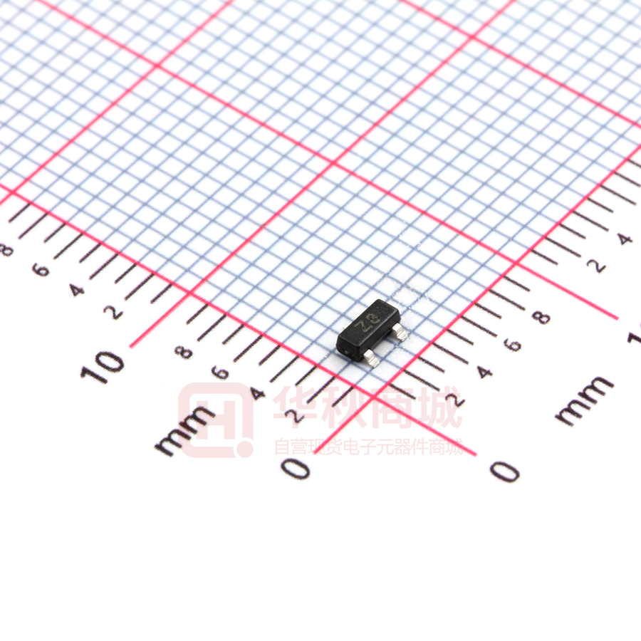

BZX84C9V1
BZX84C9V1
    JIANGSU(长晶)
    SOT-23
    SOT23-3 9.10V 300mW
BZX84C9V1 数据手册
JIANGSU CHANGJIANG ELECTRONICS TECHNOLOGY CO., LTD SOT-23 Plastic-Encapsulate DLRGHV BZX84C2V4-BZX84C43 ZENER DIODE SOT-23 FEATURES z Planar Die Construction z 300mW Power Dissipation Zener Voltages from 2.4V - 43V z z Ultra-Small Surface Mount Package Power Dissipation Maximum Ratings(Ta=25℃ unless otherwise specified) Characteristic Forward Voltage (Note 2) Power Dissipation(Note 1) @ IF = 10mA Symbol Value Unit VF Pd 0.9 300 V mW RθJA 417 Junction Temperature Tj 150 ℃ /W ℃ Storage Temperature Range Tstg -55~+150 ℃ Thermal Resistance from Junction to Ambient  1 Du ELECTRICAL CHARACTERISTICS Ta=25℃ unless otherwise specified Maximum Zener ZenerVoltage Range (Note 2) Type Number Impedance VZ@IZT IZT ZZT@IZT ZZK@IZK (Ω) Temperature Reverse Coefficent of Current (Note 3) Code Maximum Zener voltage @ IZT=5mA IZK IR mV/°C VR Nom(V) Min(V) Max(V) (mA) (mA) (μA) (V) Min Max BZX84C2V4 Z11 2.4 2.20 2.60 5 100 600 1.0 50 1.0 -3.5 0 BZX84C2V7 Z12 2.7 2.5 2.9 5 100 600 1.0 20 1.0 -3.5 0 BZX84C3V0 Z13 3.0 2.8 3.2 5 95 600 1.0 10 1.0 -3.5 0 BZX84C3V3 Z14 3.3 3.1 3.5 5 95 600 1.0 5 1.0 -3.5 0 BZX84C3V6 Z15 3.6 3.4 3.8 5 90 600 1.0 5 1.0 -3.5 0 BZX84C3V9 Z16 3.9 3.7 4.1 5 90 600 1.0 3 1.0 -3.5 0 BZX84C4V3 Z17 4.3 4.0 4.6 5 90 600 1.0 3 1.0 -3.5 0 BZX84C4V7 Z1 4.7 4.4 5.0 5 80 500 1.0 3 2.0 -3.5 0.2 BZX84C5V1 Z2 5.1 4.8 5.4 5 60 480 1.0 2 2.0 -2.7 1.2 BZX84C5V6 Z3 5.6 5.2 6.0 5 40 400 1.0 1 2.0 -2.0 2.5 BZX84C6V2 Z4 6.2 5.8 6.6 5 10 150 1.0 3 4.0 0.4 3.7 BZX84C6V8 Z5 6.8 6.4 7.2 5 15 80 1.0 2 4.0 1.2 4.5 BZX84C7V5 Z6 7.5 7.0 7.9 5 15 80 1.0 1 5.0 2.5 5.3 BZX84C8V2 Z7 8.2 7.7 8.7 5 15 80 1.0 0.7 5.0 3.2 6.2 BZX84C9V1 Z8 9.1 8.5 9.6 5 15 100 1.0 0.5 6.0 3.8 7.0 BZX84C10 Z9 10 9.4 10.6 5 20 150 1.0 0.2 7.0 4.5 8.0 BZX84C11 Y1 11 10.4 11.6 5 20 150 1.0 0.1 8.0 5.4 9.0 BZX84C12 Y2 12 11.4 12.7 5 25 150 1.0 0.1 8.0 6.0 10.0 BZX84C13 Y3 13 12.4 14.1 5 30 170 1.0 0.1 8.0 BZX84C15 Y4 15 13.8 15.6 5 30 200 1.0 0.1 10.5 9.2 13.0 BZX84C16 Y5 16 15.3 17.1 5 40 200 1.0 0.1 11.2 10.4 14.0 BZX84C18 Y6 18 16.8 19.1 5 BZX84C20 Y7 20 18.8 21.2 5 55 225 1.0 0.1 14.0 14.4 18.0 BZX84C22 Y8 22 20.8 23.3 5 55 250 1.0 0.1 15.4 16.4 20.0 BZX84C24 Y9 24 22.8 25.6 5 70 250 1.0 0.1 16.8 18.4 22.0 BZX84C27 Y10 27 25.1 28.9 2 80 300 0.5 0.1 18.9 21.4 25.3 BZX84C30 Y11 30 28.0 32.0 2 BZX84C33 Y12 33 31.0 35.0 2 BZX84C36 Y13 36 34.0 38.0 2 90 350 0.5 0.1 25.2 30.4 37.4 BZX84C39 Y14 39 37.0 41.0 2 130 350 0.5 0.1 27.3 33.4 41.2 BZX84C43 Y15 43 40.0 46.0 2 100 700 1 0.1 32 45 80 80 225 300 325 1.0 0.5 0.5 0.1 0.1 0.1 12.6 21.0 23.1 7.0 12.4 24.4 27.4 10 11.0 16.0 29.4 33.4 12 Notes: 1. Valid provided that device terminals are kept at ambient temperature. 2. Tested with pulses, period=5ms,pulse width =300μs. 3. f = 1kHZ.  2 Du ELECTRICAL CHARACTERISTICS Zener Characteristics(VZ Up to 10 V) Zener Characteristics(11 V to 43 V) 100 100 43 39 36 33 30 27 1 0.5 1 2 3 4 5 6 7 8 9 10 0.5 10 11 15 20 VZ, ZENER VOLTAGE (V) 25 30 35 40 50 Typical Leakage Current 100 Pulsed TYPICAL Ta VALUES 35 45 VZ, ZENER VOLTAGE (V) Temperature Coefficients 40 FOR BZX84CXXX SERIES 10 30 IR, LEAKAGE CURRENT (uA) θVZ, TEMPERATURE COEFFICIENT (mV/℃) 24 20 22 10 18 10 9.1 8.2 7.5 6.2 6.8 5.1 5.6 4.7 1 PD =300mW 11 12 13 IZ, ZENER CURRENT (mA) Pulsed 10 2.4 IZ, ZENER CURRENT (mA) Ta =25℃ PD =300mW Pulsed 15 16 Ta =25℃ 25 20 VZ @ IZT 15 10 5 1 0.1 0.01 Ta=100℃ 1E-3 0 Ta=25℃ -5 1E-4 0 4 8 12 16 20 24 28 32 36 40 0 44 5 VZ, NOMINAL ZENER VOLTAGE (V) 10 15 20 25 35 40 45 Effect of Zener Voltage on Zener Impedance Typical Capacitance 1000 1000 Ta=25℃ Ta=25℃ f=1MHz ZZT, DYNAMIC IMPEDANCE(Ω) 100 1V BIAS BIAS AT 50% OF VZ NOM 10 IZ(AC)=0.1IZ(DC) IZ=1mA 0V BIAS C, CAPACITANCE (pF) 30 VZ, NOMINAL ZENER VOLTAGE (V) 1 f=1kHz 100 IZ=5mA 10 1 1 10 100 1 VZ, NOMINAL ZENER VOLTAGE (V) 10 100 VZ, NOMINAL ZENER VOLTAGE (V) Power Derating Curve 350 250 POWER DISSIPATION PD (mW) 300 200 150 100 50 0 0 25 50 75 AMBIENT TEMPERATURE www.cj-elec.com 100 Ta 125 150 (℃ ) 3 D,Aug,2014 SOT-23 Package Outline Dimensions Symbol A A1 A2 b c D E E1 e e1 L L1 θ Dimensions In Millimeters Min Max 0.900 1.150 0.000 0.100 0.900 1.050 0.300 0.500 0.080 0.150 2.800 3.000 1.200 1.400 2.250 2.550 0.950 TYP 1.800 2.000 0.550 REF 0.300 0.500 0° 8° Dimensions In Inches Min Max 0.035 0.045 0.000 0.004 0.035 0.041 0.012 0.020 0.003 0.006 0.110 0.118 0.047 0.055 0.089 0.100 0.037 TYP 0.071 0.079 0.022 REF 0.012 0.020 0° 8° SOT-23 Suggested Pad Layout www.cj-elec.com 4 Du SOT-23 Tape and Reel www.cj-elec.com 5 Du
