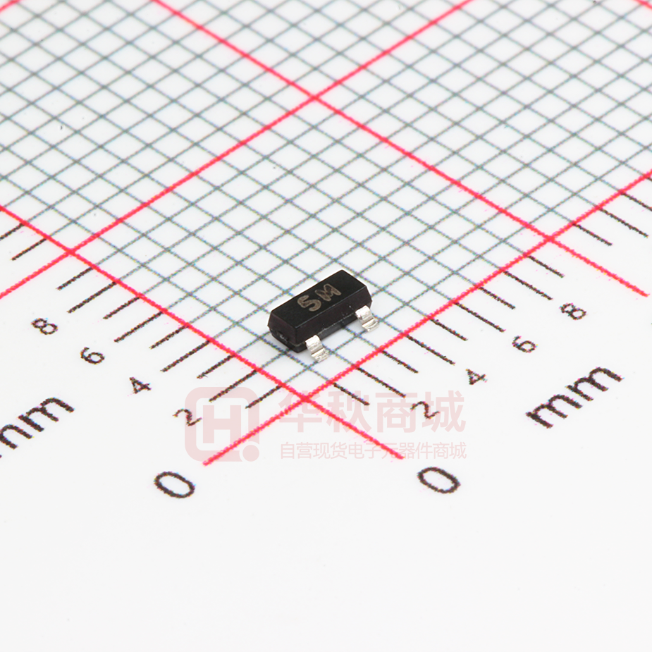

MARKING
5M= Device code
Solid dot = Green molding compound device,if none,
the normal device
