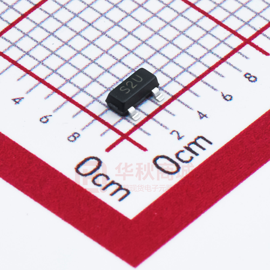

CJ2302S 数据手册
JIANGSU CHANGJIANG ELECTRONICS TECHNOLOGY CO., LTD SOT-23 Plastic-Encapsulate MOSFETS CJ2302S N-Channel 20-V(D-S) MOSFET V(BR)DSS 20 V ID RDS(on)MAX   SOT-23 60mΩ@4.5V  2.1A 115mΩ@ 2.5V   1. GATE 2. SOURCE 3. DRAIN FEATURE z TrenchFET Power MOSFET APPLICATION z Load Switch for Portable Devices z DC/DC Converter MARKING Equivalent Circuit Maximum ratings (Ta=25℃ unless otherwise noted) Parameter Unit Symbol Value Drain-Source Voltage VDS 20 Gate-Source Voltage VGS ±8 Continuous Drain Current (TJ=150℃) ID 2.1 Pulsed Drain Current IDM 10 Continuous Source-Drain Current(Diode Conduction) IS 0.6 Power Dissipation PD 0.35 W RθJA 357 ℃/W Operating Junction TJ 150 Storage Temperature TSTG -55 ~+150 Thermal Resistance from Junction to Ambient (t≤5s) www.cj-elec.com 1 V A ℃ D,Aug,2015 MOSFET ELECTRICAL CHARACTERISTICS Ta =25 ℃ unless otherwise specified Parameter Symbol Test Condition Min Typ Max 0.95 1.2 Units Static Drain-source breakdown voltage V(BR)DSS VGS = 0V, ID =10µA 20 VGS(th) VDS =VGS, ID =50µA 0.65 Gate-body leakage IGSS VDS =0V, VGS =±8V ±100 nA Zero gate voltage drain current IDSS VDS =20V, VGS =0V 1 µA Gate-threshold voltage VGS =4.5V, ID =3.6A 0.035 0.060 VGS =2.5V, ID =3.1A 0.045 0.115 Drain-source on-resistancea rDS(on) Forward transconductancea gfs VDS =5V, ID =3.6A 8 Diode forward voltage VSD IS=0.94A,VGS=0V 0.76 1.2 4.0 10 V Ω S V Dynamic Total gate charge Qg Gate-source charge Qgs Gate-drain charge Qgd 1.5 Input capacitance Ciss 300 Output capacitance Coss Reverse transfer capacitance Crss VDS =10V,VGS =4.5V,ID =3.6A VDS =10V,VGS =0V,f=1MHz nC 0.65 pF 120 80 Switching Turn-on delay time Rise time Turn-off delay time Fall time td(on) tr td(off) tf VDD=10V, RL=5.5Ω, ID ≈3.6A, VGEN=4.5V,Rg=6Ω 7 15 55 80 16 60 10 25 ns Notes : a. Pulse Test : Pulse width≤300µs, duty cycle ≤2%. www.cj-elec.com 2 D,Aug,2015 Typical Characteristics Transfer Characteristics Output Characteristics 20 VGS=3.5、3.0、2.5V 10 Ta=25℃ Ta=25℃ Pulsed Pulsed 8 15 (A) VGS=1.5V 5 ID 10 6 DRAIN CURRENT DRAIN CURRENT ID (A) VGS=2.0V 4 2 0 0 2 4 6 DRAIN TO SOURCE VOLTAGE RDS(ON) 120 —— 8 VDS 0 0.0 10 (V) 0.5 1.0 1.5 GATE TO SOURCE VOLTAGE RDS(ON) ID —— 2.0 VGS VGS 300 Ta=25℃ Ta=25℃ Pulsed Pulsed 250 (mΩ) 200 RDS(ON) 80 VGS=2.5V ON-RESISTANCE ON-RESISTANCE RDS(ON) (mΩ) 100 60 VGS=4.5V 40 20 2.5 (V) 150 100 ID=3.6A 50 0 5 10 15 DRAIN CURRENT 10 IS —— 20 ID 25 30 (A) 0 0 2 4 6 GATE TO SOURCE VOLTAGE 8 VGS 10 (V) VSD Ta=25℃ SOURCE CURRENT IS (A) Pulsed 1 0.1 0.0 0.4 0.8 1.2 SOURCE TO DRAIN VOLTAGE 1.6 VSD 2.0 (V)  3 D,Aug,2015 SOT-23 Package Outline Dimensions Symbol A A1 A2 b c D E E1 e e1 L L1 θ Dimensions In Millimeters Min Max 0.900 1.150 0.000 0.100 0.900 1.050 0.300 0.500 0.080 0.150 2.800 3.000 1.200 1.400 2.250 2.550 0.950 TYP 1.800 2.000 0.550 REF 0.300 0.500 0° 8° Dimensions In Inches Min Max 0.035 0.045 0.000 0.004 0.035 0.041 0.012 0.020 0.003 0.006 0.110 0.118 0.047 0.055 0.089 0.100 0.037 TYP 0.071 0.079 0.022 REF 0.012 0.020 0° 8° SOT-23 Suggested Pad Layout www.cj-elec.com 4 D,Aug,2015 SOT-23 Tape and Reel SOT-23 Tape and reel SOT-23 Embossed Carrier Tape P0 d P1 Packaging Description: SOT-23 parts are shipped in tape. The carrier tape is made from a dissipative (carbon filled) polycarbonate resin. The cover tape is a multilayer film (Heat Activated Adhesive in nature) primarily composed of polyester film, adhesive layer, sealant, and anti-static sprayed agent. These reeled parts in standard option are shipped with 3,000 units per 7" or 17.8cm diameter reel. The reels are clear in color and is made of polystyrene plastic (anti-static coated). B W A F E C A A P A-A Dimensions are in millimeter Pkg type A B C d E F P0 P P1 W SOT-23 3.15 2.77 1.22 Ø1.50 1.75 3.50 4.00 4.00 2.00 8.00 SOT-23 Tape Leader and Trailer Trailer Tape Leader Tape 100±2 Empty Pockets Components 50±2 Empty Pockets SOT-23 Reel D I G W2 3000 H 2500 2000 1500 1000 D2 D1 500 W1 Dimensions are in millimeter Reel Option D D1 D2 G H I W1 W2 7''Dia Ø178.00 54.40 13.00 R78.00 R25.60 R6.50 9.50 12.30 G.W.(kg) REEL Reel Size Box Box Size(mm) Carton Carton Size(mm) 3000 pcs 7 inch 30,000 pcs 203×203×195 120,000 pcs 438×438×220 www.cj-elec.com 5 D,Aug,2015
