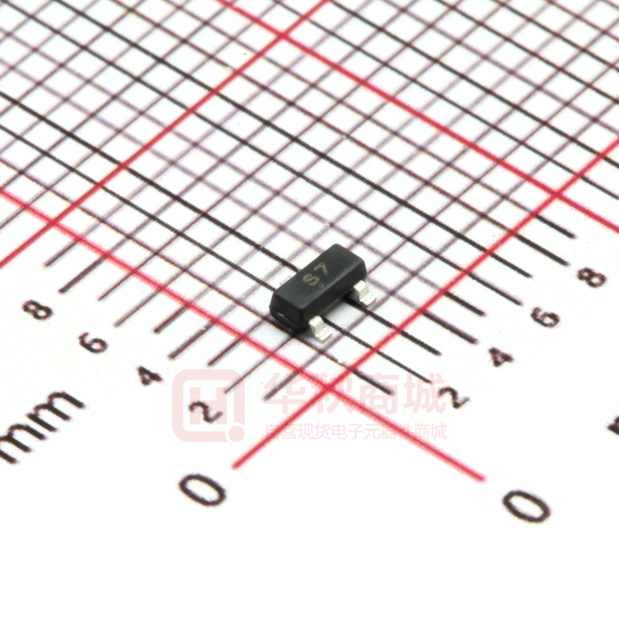

    MOSFETs P-沟道 30V 2.7A SOT-23
CJ2307 数据手册
JIANGSU CHANGJIANG ELECTRONICS TECHNOLOGY CO., LTD SOT-23 Plastic-Encapsulate MOSFETS CJ2307 P-Channel 30-V(D-S) MOSFET V(BR)DSS ID RDS(on)MAX 88mΩ@-10V    -30 V SOT-23 -2.7A 138mΩ@-4.5V  1. GATE 2. SOURCE 3. DRAIN FEATURE TrenchFET Power MOSFET APPLICATION z Load Switch for Portable Devices z MARKING Equivalent Circuit Maximum ratings ( Ta=25℃ unless otherwise noted) . Parameter Symbol Value Unit Drain-Source Voltage VDS -30 Gate-Source Voltage VGS ±20 ID -2.7 Continuous Source-Drain Current IS -0.91 Power Dissipationa,b PD 1.1 W RθJA 114 ℃/W Operating Junction Temperature TJ 150 Storage Temperature Tstg -55 ~+150 Continuous Drain Current a,b a,b Thermal Resistance from Junction to Ambient (t≤5s) www.cj-elec.com 1 V A ℃ E,Apr,2015 MOSFET ELECTRICAL CHARACTERISTICS Ta =25 ℃ unless otherwise specified Parameter Symbol Test Condition Min Typ Max Unit Static Drain-Source Breakdown Voltage V (BR)DSS VGS = 0V, ID =-250µA -30 VGS(th) VDS =VGS, ID =-250µA -1 Gate-Source Leakage IGSS VDS =0V, VGS =±20V ±100 Zero Gate Voltage Drain Current IDSS VDS =-30V, VGS =0V -1 VDS =-30V, VGS =0V, TJ=55℃ -10 Gate-Source Threshold Voltage Drain-Source On-State Resistancec RDS(on) Forward Transconductancec gfs -3 VGS =-4.5V, ID =-2.5A 0.110 0.138 VGS =-10V, ID =-3.5A 0.073 0.088 VDS =-10V, ID =-3.5A 7 V nA µA Ω S d Dynamic Input Capacitance Ciss Output Capacitance Coss Reverse Transfer Capacitance Crss Total Gate Charge Qg Gate-Source Charge Qgs Gate-Drain Charge Qgd Gate Resistance Rg Turn-On Delay Time Rise Time Turn-Off Delay Time Fall Time td(on) tr td(off) tf 340 VDS =-15V,VGS =0V,f =1MHz pF 67 51 VDS =-15V,VGS =-4.5V, ID =-2.5A f =1MHz VDD=-15V, RL=15Ω, ID =-1A, VGEN=-4.5V,Rg=1Ω 4.1 6.2 nC 1.3 1.8 10 Ω 40 60 40 60 20 40 17 30 -0.8 -1.2 ns Drain-source Body diode characteristics Body Diode Voltage VSD IS=-0.75A, ,VGS =0 V Notes: a. t=5s. b. Surface mounted on 1” ×1” FR4 board. c. Pulse Test : Pulse Width < 300µs, Duty Cycle ≤2%. d. Guaranteed by design, not subject to production testing. www.cj-elec.com 2 E,Apr,2015 Typical Characteristics Output Characteristics -20 Ta=25℃ Pulsed Ta=25℃ Pulsed VGS=-4.5V (A) -8 (A) -16 ID ID VGS=-4.0V -6 VGS=-3.5V -8 VGS=-3.0V DRAIN CURRENT DRAIN CURRENT -12 -4 -0 -0 -1 -2 -3 -4 DRAIN TO SOURCE VOLTAGE RDS(ON) —— VDS -5 -0 -1 -2 -3 GATE TO SOURCE VOLTAGE (V) ID RDS(ON) —— 500 -4 VGS -5 (V) VGS Ta=25℃ Ta=25℃ Pulsed Pulsed 400 RDS(ON) (m) 250 200 ON-RESISTANCE (m) 300 RDS(ON) -4 -2 -0 ON-RESISTANCE Transfer Characteristics -10 VGS=-10V,-8V,-6V VGS=-4.5V 150 VGS=-10V 100 300 ID=-3.5A 200 100 50 0 -0 -4 -8 DRAIN CURRENT -12 ID -16 -20 (A) -0 -4 -8 -12 GATE TO SOURCE VOLTAGE -16 VGS -20 (V) IS —— VSD -10 Ta=25℃ SOURCE CURRENT IS (A) Pulsed -1 -0.1 -0.01 -0.0 -0.3 -0.6 -0.9 SOURCE TO DRAIN VOLTAGE -1.2 -1.5 VSD (V)  3 E,Apr,2015 SOT-23 Package Outline Dimensions Symbol A A1 A2 b c D E E1 e e1 L L1 θ Dimensions In Millimeters Min Max 0.900 1.150 0.000 0.100 0.900 1.050 0.300 0.500 0.080 0.150 2.800 3.000 1.200 1.400 2.250 2.550 0.950 TYP 1.800 2.000 0.550 REF 0.300 0.500 0° 8° Dimensions In Inches Min Max 0.035 0.045 0.000 0.004 0.035 0.041 0.012 0.020 0.003 0.006 0.110 0.118 0.047 0.055 0.089 0.100 0.037 TYP 0.071 0.079 0.022 REF 0.012 0.020 0° 8° SOT-23 Suggested Pad Layout www.cj-elec.com 4 E,Apr,2015 SOT-23 Tape and Reel SOT-23 Tape and reel SOT-23 Embossed Carrier Tape P0 d P1 Packaging Description: SOT-23 parts are shipped in tape. The carrier tape is made from a dissipative (carbon filled) polycarbonate resin. The cover tape is a multilayer film (Heat Activated Adhesive in nature) primarily composed of polyester film, adhesive layer, sealant, and anti-static sprayed agent. These reeled parts in standard option are shipped with 3,000 units per 7" or 17.8cm diameter reel. The reels are clear in color and is made of polystyrene plastic (anti-static coated). B W A F E C A A P A-A Dimensions are in millimeter Pkg type A B C d E F P0 P P1 W SOT-23 3.15 2.77 1.22 Ø1.50 1.75 3.50 4.00 4.00 2.00 8.00 SOT-23 Tape Leader and Trailer Trailer Tape Leader Tape 100±2 Empty Pockets Components 50±2 Empty Pockets SOT-23 Reel D I G W2 3000 H 2500 2000 1500 1000 D2 D1 500 W1 Dimensions are in millimeter Reel Option D D1 D2 G H I W1 W2 7''Dia Ø178.00 54.40 13.00 R78.00 R25.60 R6.50 9.50 12.30 G.W.(kg) REEL Reel Size Box Box Size(mm) Carton Carton Size(mm) 3000 pcs 7 inch 30,000 pcs 203×203×195 120,000 pcs 438×438×220 www.cj-elec.com 5 E,Apr,2015
