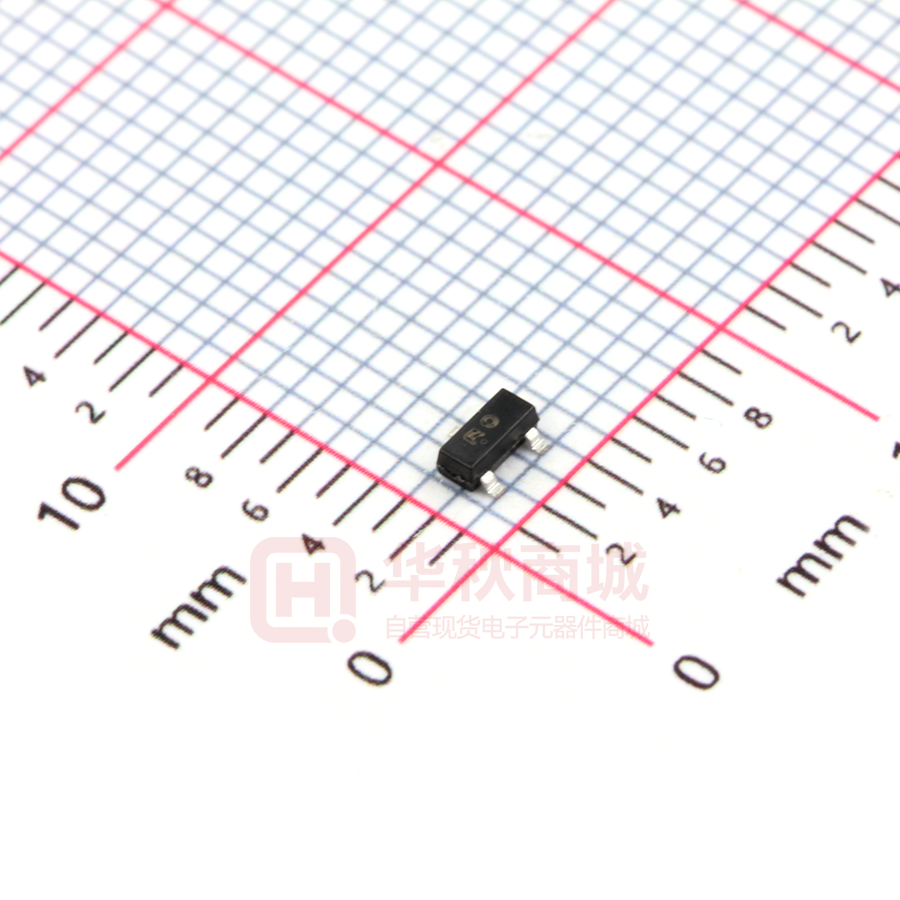

    MOSFETs N-沟道 30V 5.8A SOT-23
CJ3400 数据手册
JIANGSU CHANGJIANG ELECTRONICS TECHNOLOGY CO., LTD SOT-23 Plastic-Encapsulate MOSFETS CJ3400 N-Channel Enhancement Mode Field Effect Transistor V(BR)DSS ID RDS(on)MAX   30 V SOT-23 35mΩ@ 10V  40mΩ@4.5V  5.8A 52mΩ@2.5V   1. GATE 2. SOURCE 3. DRAIN FEATURE APPLICATION z High dense cell design for extremely low RDS(ON) z Load/Power Switching z Exceptional on-resistance and maximum DC current capability z Interfacing Switching MARKING Equivalent Circuit Maximum ratings ( Ta=25℃ unless otherwise noted) Parameter Symbol Value Unit Drain-Source Voltage VDS 30 V Gate-Source Voltage VGS ±12 V Continuous Drain Current ID 5.8 A Drain Current-Pulsed (note 1) IDM 30 A Power Dissipation PD 350 mW RθJA 357 ℃/W Junction Temperature TJ 150 ℃ Storage Temperature TSTG -55~+150 ℃ Thermal Resistance from Junction to Ambient (note 2) B Dec,2013 www.cj-elec.com 1 C,Apr,2015 MOSFET ELECTRICAL CHARACTERISTICS Ta =25 ℃ unless otherwise specified Parameter Test Condition Symbol Min Typ Max Unit Off Characteristics Drain-source breakdown voltage V(BR) DSS VGS = 0V, ID =250µA Zero gate voltage drain current IDSS VDS =24V,VGS = 0V Gate-source leakage current IGSS VGS =±12V, VDS = 0V 30 V 1 µA ±100 nA VGS =10V, ID =5.8A 35 mΩ VGS =4.5V, ID =5A 40 mΩ VGS =2.5V,ID=4A 52 mΩ On characteristics Drain-source on-resistance RDS(on) (note 3) Forward tranconductance gFS Gate threshold voltage Dynamic Characteristics VGS(th) VDS =VGS, ID =250µA 8 S 0.7 1.4 V 1050 pF (note 4,5) Input capacitance Ciss Output capacitance Coss Reverse transfer capacitance Crss Gate resistance Rg Switching Characteristics VDS =5V, ID =5A VDS =15V,VGS =0V,f =1MHz VDS =0V,VGS =0V,f =1MHz 99 pF 77 pF 3.6 Ω 5 ns (note 4,5) Turn-on delay time Turn-on rise time Turn-off delay time Turn-off fall time td(on) tr VGS=10V,VDS=15V, 7 ns td(off) RL=2.7Ω,RGEN=3Ω 40 ns 6 ns 1 V tf Drain-source diode characteristics and maximum ratings Diode forward voltage (note 3) VSD IS=1A,VGS=0V Note : 1. Repetitive Rating : Pulse width limited by maximum junction temperature. 2. Surface Mounted on FR4 Board, t < 5 sec. 3. Pulse Test : Pulse Width≤300µs, Duty Cycle ≤ 2%. 4. Guaranteed by design, not subject to production testing. www.cj-elec.com 2 C,Apr,2015 Typical Characteristics Transfer Characteristics Output Characteristics 25 5 Pulsed VDS=5.0V VGS=10.0V、4.5V、3.0V Pulsed 20 4 (A) ID 15 3 10 DRAIN CURRENT DRAIN CURRENT ID (A) VGS=2.5V VGS=2.0V 2 Ta=100℃ 5 1 Ta=25℃ 0 0 1 2 4 3 DRAIN TO SOURCE VOLTAGE RDS(ON) —— VDS 0 0.0 5 ID RDS(ON) 400 —— 2.5 (V) VGS Pulsed 350 (mΩ) 50 (mΩ) 300 RDS(ON) 45 RDS(ON) Pulsed 250 ON-RESISTANCE VGS=2.5V 40 35 VGS=4.5V 30 25 2.0 VGS Ta=25℃ Ta=25℃ 55 1.5 GATE TO SOURCE VOLTAGE 60 ON-RESISTANCE 1.0 0.5 (V) 200 150 100 ID=5A 50 VGS=10V 20 0 4 1 8 12 DRAIN CURRENT ID 16 20 0 4 6 8 GATE TO SOURCE VOLTAGE (A) IS —— VSD 10 2 VGS 10 (V) Threshold Voltage 1.0 Ta=25℃ Pulsed 0.9 VTH 0.1 THRESHOLD VOLTAGE SOURCE CURRENT IS (A) (V) 1 0.01 1E-3 1E-4 0 200 400 600 SOURCE TO DRAIN VOLTAGE www.cj-elec.com 800 1000 0.7 0.6 0.5 25 1200 VSD (mV) ID=250uA 0.8 50 75 JUNCTION TEMPERATURE 3 100 TJ 125 (℃ ) C,Apr,2015 SOT-23 Package Outline Dimensions Symbol A A1 A2 b c D E E1 e e1 L L1 θ Dimensions In Millimeters Min Max 0.900 1.150 0.000 0.100 0.900 1.050 0.300 0.500 0.080 0.150 2.800 3.000 1.200 1.400 2.250 2.550 0.950 TYP 1.800 2.000 0.550 REF 0.300 0.500 0° 8° Dimensions In Inches Min Max 0.035 0.045 0.000 0.004 0.035 0.041 0.012 0.020 0.003 0.006 0.110 0.118 0.047 0.055 0.089 0.100 0.037 TYP 0.071 0.079 0.022 REF 0.012 0.020 0° 8° SOT-23 Suggested Pad Layout www.cj-elec.com 4 C,Apr,2015 SOT-23 Tape and Reel SOT-23 Tape and reel SOT-23 Embossed Carrier Tape P0 d P1 Packaging Description: SOT-23 parts are shipped in tape. The carrier tape is made from a dissipative (carbon filled) polycarbonate resin. The cover tape is a multilayer film (Heat Activated Adhesive in nature) primarily composed of polyester film, adhesive layer, sealant, and anti-static sprayed agent. These reeled parts in standard option are shipped with 3,000 units per 7" or 17.8cm diameter reel. The reels are clear in color and is made of polystyrene plastic (anti-static coated). B W A F E C A A P A-A Dimensions are in millimeter Pkg type A B C d E F P0 P P1 W SOT-23 3.15 2.77 1.22 Ø1.50 1.75 3.50 4.00 4.00 2.00 8.00 SOT-23 Tape Leader and Trailer Trailer Tape Leader Tape 100±2 Empty Pockets Components 50±2 Empty Pockets SOT-23 Reel D I G W2 3000 H 2500 2000 1500 1000 D2 D1 500 W1 Dimensions are in millimeter Reel Option D D1 D2 G H I W1 W2 7''Dia Ø178.00 54.40 13.00 R78.00 R25.60 R6.50 9.50 12.30 G.W.(kg) REEL Reel Size Box Box Size(mm) Carton Carton Size(mm) 3000 pcs 7 inch 30,000 pcs 203×203×195 120,000 pcs 438×438×220 www.cj-elec.com 5 C,Apr,2015
