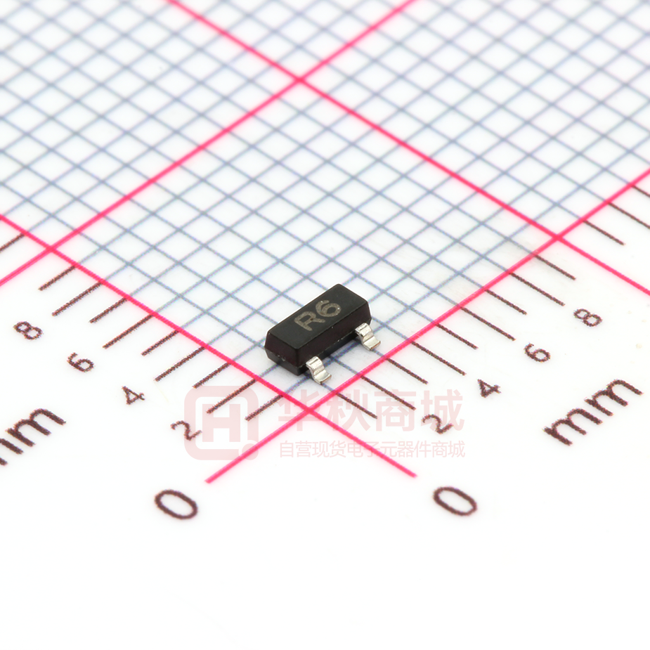

JIANGSU CHANGJIANG ELECTRONICS TECHNOLOGY CO., LTD SOT-23 Plastic-Encapsulate MOSFETs CJ3406 N-Channel Enhancement Mode Field Effect Transistor V(BR)DSS ID RDS(on)MAX SOT-23  65 mΩ@10V  30V 3.6A 105 mΩ@4.5V 1. GATE 2. SOURCE 3. DRAIN   DESCRIPTION The CJ3406 use advanced trench technology to provide excellent RDS(ON) and low gate charge. This device is suitable for use as a load switch or in PWM applications. Equivalent Circuit MARKING R6 Maximum ratings ( Ta=25℃ unless otherwise noted) Parameter Symbol Value Unit Drain-Source Voltage VDS 30 V Gate-Source Voltage VGS ±20 V Continuous Drain Current ID 3.6 A Drain Current-Pulsed (note 1) IDM 15 A Power Dissipation PD 0.35 W RθJA 357 ℃/W Junction Temperature TJ 150 ℃ Storage Temperature TSTG -55~ +150 ℃ Thermal Resistance from Junction to Ambient www.cj-elec.com 1 B,Mar,2015 MOSFET ELECTRICAL CHARACTERISTICS Ta =25 ℃ unless otherwise specified Parameter Test Condition Symbol Min Typ Max Units STATIC PARAMETERS Drain-source breakdown voltage V (BR) DSS VGS = 0V, ID =250µA Zero gate voltage drain current IDSS VDS =24V,VGS = 0V Gate-body leakage current IGSS VGS =±20V, VDS = 0V Gate threshold voltage VGS(th) VDS =VGS, ID =250µA Drain-source on-resistance (note 2) RDS(on) 30 V 1 µA ±100 nA 3 V VGS =10V, ID =3.6A 65 mΩ VGS =4.5V, ID =2.8A 105 mΩ Forward tranconductance (note 2) gFS VDS =5V, ID =3.6A Diode forward voltage VSD IS=1A 1 3 S 1 V 375 pF DYNAMIC PARAMETERS (note 3) Input capacitance Ciss Output capacitance Coss Reverse transfer capacitance Crss Gate resistance Rg VDS =15V,VGS =0V,f =1MHz 57 pF 39 pF VDS =0V,VGS =0V,f =1MHz 6 Ω SWITCHING PARAMETERS (note 3) Turn-on delay time td(on) Turn-on rise time Turn-off delay time 4.6 ns tr VGS=10V,VDS=15V, 1.9 ns td(off) RL=2.2Ω,RGEN=3Ω 20.1 ns 2.6 ns Turn-off fall time tf Notes : 1. Repetitive Rating : Pulse width limited by maximum junction temperature. 2. Pulse Test : Pulse width ≤300µs, duty cycle≤ 0.5%. 3. These parameters have no way to verify. www.cj-elec.com 2 B,Mar,2015 Typical Characteristics Output Characteristics Transfer Characteristics 12 15 VGS=10V VDS=3V VGS=6V 10 VGS=4.5V ID 9 DRAIN CURRENT DRAIN CURRENT ID (A) (A) 12 VGS=4V 6 Ta=25℃ 8 Ta=100℃ 6 4 VGS=3.5V 3 2 VGS=3V 0 0 1 2 3 DRAIN TO SOURCE VOLTAGE 4 VDS 0 5 0 (V) 1 2 3 4 GATE TO SOURCE VOLTAGE VGS 5 6 (V) RDS(ON) —— VGS RDS(ON) —— ID 90 200 Ta=25℃ Pulsed RDS(ON) 70 VGS=4.5V 60 ON-RESISTANCE RDS(ON) ON-RESISTANCE (mΩ) 160 (mΩ) 80 50 VGS=10V 40 30 1.0 1.5 2.0 2.5 3.0 DRAIN CURRENT 3.5 ID 4.0 4.5 ID=3.6A 120 40 0 5.0 Ta=100℃ 80 Ta=25℃ 0 (A) 2 4 6 GATE TO SOURCE VOLTAGE 8 VGS 10 (V) Threshold Voltage IS —— VSD 5 2.0 THRESHOLD VOLTAGE VTH IS (A) (V) 1.8 SOURCE CURRENT 1 Ta=100℃ T=25℃ 1.6 ID=250uA 1.4 1.2 1.0 0.8 0.1 0.4 0.6 0.8 1.0 SOURCE TO DRAIN VOLTAGE www.cj-elec.com 1.2 0.6 25 1.4 VSD (V) 50 75 JUNCTION TEMPERATURE 3 100 Tj 125 (℃ ) B,Mar,2015 SOT-23 Package Outline Dimensions Symbol A A1 A2 b c D E E1 e e1 L L1 θ Dimensions In Millimeters Min Max 0.900 1.150 0.000 0.100 0.900 1.050 0.300 0.500 0.080 0.150 2.800 3.000 1.200 1.400 2.250 2.550 0.950 TYP 1.800 2.000 0.550 REF 0.300 0.500 0° 8° Dimensions In Inches Min Max 0.035 0.045 0.000 0.004 0.035 0.041 0.012 0.020 0.003 0.006 0.110 0.118 0.047 0.055 0.089 0.100 0.037 TYP 0.071 0.079 0.022 REF 0.012 0.020 0° 8° SOT-23 Suggested Pad Layout www.cj-elec.com 4 B,Mar,2015 SOT-23 Tape and Reel SOT-23 Tape and reel SOT-23 Embossed Carrier Tape P0 d P1 Packaging Description: SOT-23 parts are shipped in tape. The carrier tape is made from a dissipative (carbon filled) polycarbonate resin. The cover tape is a multilayer film (Heat Activated Adhesive in nature) primarily composed of polyester film, adhesive layer, sealant, and anti-static sprayed agent. These reeled parts in standard option are shipped with 3,000 units per 7" or 17.8cm diameter reel. The reels are clear in color and is made of polystyrene plastic (anti-static coated). B W A F E C A A P A-A Dimensions are in millimeter Pkg type A B C d E F P0 P P1 W SOT-23 3.15 2.77 1.22 Ø1.50 1.75 3.50 4.00 4.00 2.00 8.00 SOT-23 Tape Leader and Trailer Trailer Tape Leader Tape 100±2 Empty Pockets Components 50±2 Empty Pockets SOT-23 Reel D I G W2 3000 H 2500 2000 1500 1000 D2 D1 500 W1 Dimensions are in millimeter Reel Option D D1 D2 G H I W1 W2 7''Dia Ø178.00 54.40 13.00 R78.00 R25.60 R6.50 9.50 12.30 G.W.(kg) REEL Reel Size Box Box Size(mm) Carton Carton Size(mm) 3000 pcs 7 inch 30,000 pcs 203×203×195 120,000 pcs 438×438×220 www.cj-elec.com 5 B,Mar,2015
