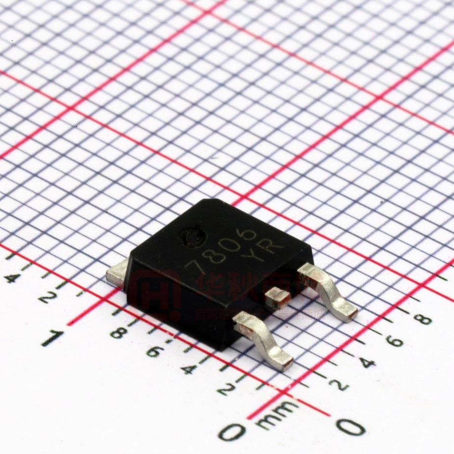

    TO-252(DPAK)
    输出类型:固定 输出极性:正 最大输入电压:35V 输出电压:6V 输出电流:1.5A
CJ7806 数据手册
JIANGSU CHANGJIANG ELECTRONICS TECHNOLOGY CO., LTD TO-251-3L/TO-252-2L Plastic-Encapsulate Voltage Regulators TO-251-3L/TO-252-2L CJ7806 Three-terminal positive voltage regulator FEATURES z z z Maximum output current IOM: 1.5 A Output voltage VO: 6V Continuous total dissipation PD: 1.25 W (Ta= 25 ℃ ) 1.IN 1 2 3 2 2.GND 1 3 3.OUT ABSOLUTE MAXIMUM RATINGS (Operating temperature range applies unless otherwise specified) Parameter Symbol Value Unit Vi 35 V Thermal Resistance from Junction to Ambient RθJA 80 Operating Junction Temperature Range TOPR -25~+125 ℃/W Storage Temperature Range TSTG -65~+150 Input Voltage ℃ ℃ ELECTRICAL CHARACTERISTICS AT SPECIFIED VIRTUAL JINCTION TEMPERATURE (Vi=11V,Io=500mA,Ci=0.33μF, Co=0.1μF, unless otherwise specified ) Parameter Symbol Output Voltage Vo Load Regulation 8V≤V i≤21V, Io=5mA-1A △Vo △Vo Quiescent Current Iq Output voltage drift △Iq △Vo/△T -25-125℃ 5.75 5.7 Typ Max Unit 6 6.25 V 6 6.3 V Io=5mA-1.5A 25℃ 14 120 mV Io=250mA-750mA 25℃ 4 60 mV 8V≤V i≤25V 25℃ 5 120 mV 9V≤V i≤13V 25℃ 1.5 60 mV 25℃ 4.3 8 mA 8V≤V i≤25V -25-125℃ 1.3 mA 5mA≤I O≤1A -25-125℃ 0.5 mA IO=5mA -25-125℃ -0.8 mV/℃ 45 μV/Vo 75 dB 25℃ 2 V 25℃ 10 mΩ Isc 25℃ 550 mA Ipk 25℃ 2.2 A Output Noise Voltage VN 10Hz≤f≤100KHz Ripple Rejection RR 9V≤V i≤19V,f=120Hz Dropout Voltage Vd Io=1A Output resistance RO f=1KHZ Short Circuit Current Peak Current * Pulse test. TYPICAL APPLICATION Min 25℃ Line Regulation Quiescent Current Change Test conditions Vi 25℃ 1 -25-125℃ 3 59 Vo CJ7806 UTC 2 Ci Co 0.33μF 0.1μF Note: Bypass capacitors are recommended for optimum stability and transient response and should be located as close as possible to the regulators. www.cj-elec.com 1 F,Jun,2016 Typical Characteristics Dropout Characteristics Output Characteristics 8 8 Tj =25℃ IO=0mA Tj=25℃ 7 4 3 2 1 0 A =0 m 5 I 5 6 O VO (V) 6 OUTPUT VOLTAGE OUTPUT VOLTAGE VO (V) 7 4 IO=250mA、500mA、750mA、1A、1.5A 3 2 1 0 5 10 15 20 INPUT VOLTAGE VIN 25 30 0 35 4 5 6 Quiescent Current vs Input Voltage 11 Tj =25℃ (V) Pulsed 6 VO 4 OUTPUT VOLTAGE (mA) IQ 10 (V) 7 Tj =25℃ 5 9 VIN VIN=11V IO=0mA QUIESCENT CURRENT 8 Current Cut-off Grid Voltage 8 6 3 2 1 0 7 INPUT VOLTAGE (V) 5 4 3 2 1 0 5 10 15 20 INPUT VOLTAGE VIN 25 30 0 0.0 35 0.5 1.0 1.5 OUTPUT CURRENT (V) Output Voltage vs Ambient Temperature 2.0 IO 2.5 (A) Power Derating Curve 1.50 6.50 Vin=11V IO=5mA PD 6.00 POWER DISSIPATION OUTPUT VOLTAGE VO (V) (W) 6.25 5.75 5.50 5.25 -25 0 25 50 JUNCTION TEMPERATURE www.cj-elec.com 75 TJ 100 1.25 1.00 0.75 0.50 0.25 0.00 -25 125 (℃ ) 0 25 50 JUNCTION TEMPERATURE 2 75 TJ 100 125 (℃ ) F,Jun,2016 Symbol A A1 B b c c1 D D1 E e e1 M N L L1 L2 V ĭ www.cj-elec.com Dimensions In Millimeters Max. Min. 2.380 2.200 0.000 0.100 0.800 1.400 0.710 0.810 0.460 0.560 0.460 0.560 6.500 6.700 5.130 5.460 6.000 6.200 2.286 TYP. 4.327 4.727 1.778REF. 0.762REF. 9.800 10.400 2.9REF. 1.400 1.700 4.830 REF.   3 Dimensions In Inches Min. Max. 0.087 0.094 0.000 0.004 0.031 0.055 0.028 0.032 0.018 0.022 0.018 0.022 0.256 0.264 0.202 0.215 0.236 0.244 0.090 TYP. 0.170 0.186 0.070REF. 0.018REF. 0.386 0.409 0.114REF. 0.055 0.067 0.190 REF.   F,Jun,2016 To-252(4R)-2L Tape and Reel www.cj-elec.com 4 F,Jun,2016
