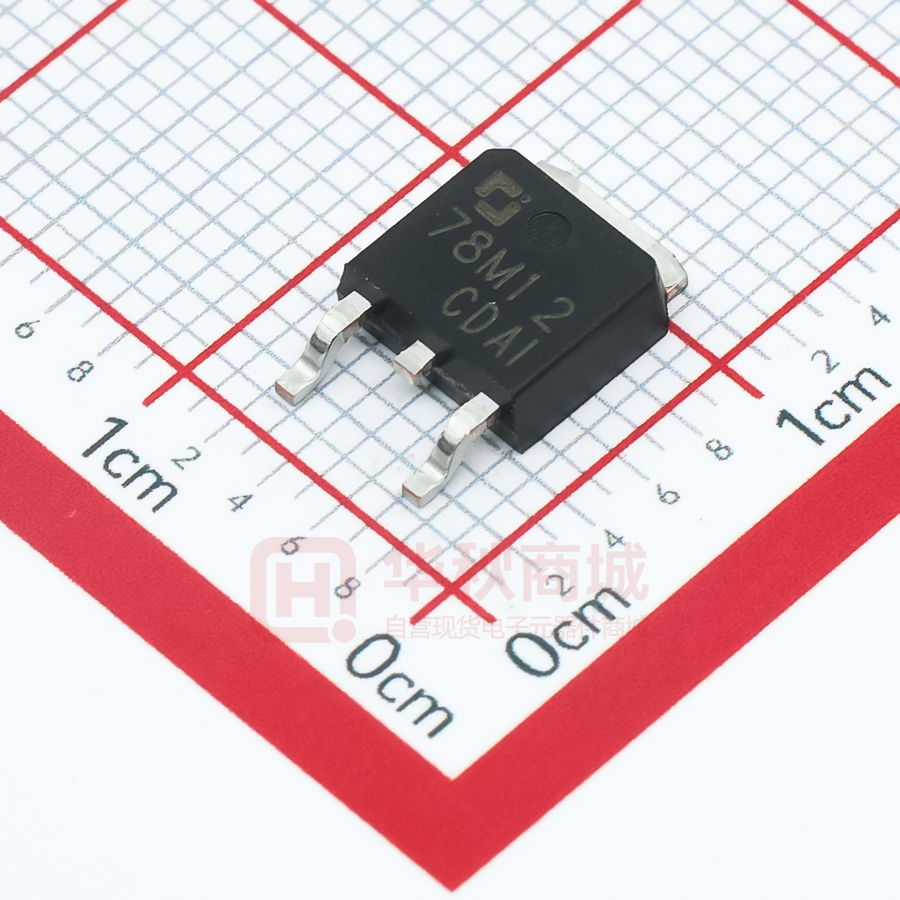

JIANGSU CHANGJIANG ELECTRONICS TECHNOLOGY CO., LTD
TO-251-3L Plastic-Encapsulate Regulators
CJ78M12 Three-terminal positive voltage regulator
FEATURES
z
z
z
TO-251-3L
Maximum output current
IOM: 0.5 A
Output voltage
VO: 12 V
Continuous total dissipation
PD: 1.25 W (Ta= 25 ℃ )
1.IN
2.GND
1
3.OUT
2
3
