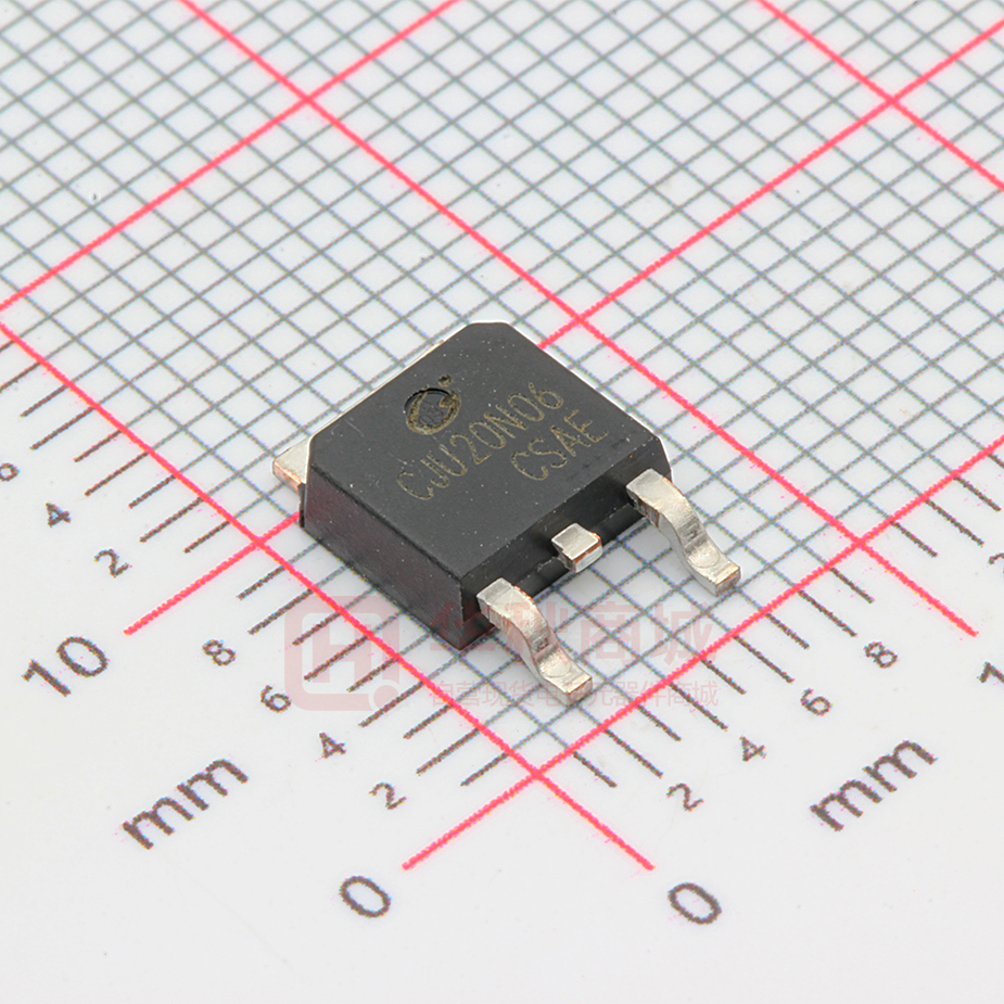

    TO-252(DPAK)
    MOS管 N-channel Id=20A VDS=60V TO252-2
CJU20N06 数据手册
JIANGSU CHANGJIANG ELECTRONICS TECHNOLOGY CO., LTD TO-252-2L Plastic-Encapsulate MOSFETS CJU20N06 N-Channel Power MOSFET V(BR)DSS ID RDS(on)MAX TO-252-2L 20A   45mΩ@ 10V   60V GENERAL DESCRIPTION The CJU20N06 uses advanced trench technology and design to provide excellent RDS(ON) with low gate charge. It can be used in a wide variety of applications. 1. GATE 2. DRAIN 3. SOURCE FEATURE z High density cell design for ultra low Rdson z Fully characterized avalanche voltage and current z Good stability and uniformity with high EAS z Excellent package for good heat dissipation z Special process technology for high ESD capability APPLICATION z Power switching application z Hard switched and high frequency circuits z Uninterruptible power supply Equivalent Circuit MARKING: CJU20N06= Device code Solid dot = Green molding compound device, if none, the normal device XXX=Date Code Maximum ratings (Ta=25℃ unless otherwise noted) Parameter Symbol Value Drain-Source Voltage VDS 60 Gate-Source Voltage VGS ±20 Continuous Drain Current ID 20 Pulsed Drain Current IDM 60 Single Pulsed Avalanche Energy (1) Unit V A 72 mJ PD 1.25 W RθJA 100 ℃/W Junction Temperature TJ 150 Storage Temperature Tstg -55~+150 Power Dissipation Thermal Resistance from Junction to Ambient EAS ℃ (1).EAS condition: Tj=25℃,VDD=30V,L=0.5mH, RG=25Ω, Starting TJ = 25°C www.cj-elec.com 1 A,Mar,2016 026)(7(/(&75,&$/&+$5$&7(5,67,&6 Ta =25 Я unless otherwise specified Parameter Test Condition Symbol Min Typ Max Unit Off characteristics Drain-source breakdown voltage V(BR) DSS VGS = 0V, ID =250µA Zero gate voltage drain current IDSS VDS =60V, VGS =0V 1 µA Gate-body leakage current IGSS VDS =0V, VGS =±20V ±100 nA Gate-threshold voltage VGS(th) VDS =VGS, ID =250µA 2 3 V Static drain-source on-resistance RDS(on) VGS =10V, ID =20A 37 45 mΩ 60 V On characteristics (note1) 1 Dynamic characteristics (note 2) Input capacitance Ciss Output capacitance Coss Reverse transfer capacitance Crss VDS =30V,VGS =0V, f =1MHz 500 pF 60 25 Switching characteristics (note 2) Total gate charge Qg Gate-source charge Qgs Gate-drain charge Qgd Turn-on delay time td(on) Turn-on rise time Turn-off delay time Turn-off fall time tr td(off) tf VDS=48V, VGS=10V, ID=15A VDD=30V,ID=2A, VGS=10V,RG=3Ω, RL=6.7Ω 12 nC 4.1 4.5 5 2.6 ns 16.1 2.3 Drain-Source Diode Characteristics Drain-source diode forward voltage(note1) Continuous drain-source diode forward current Pulsed drain-source diode forward current VSD VGS =0V, IS=20A 1.2 V IS 20 A ISM 60 A Notes: 1. Pulse Test : Pulse Width≤300µs, duty cycle ≤2%. 2. Guaranteed by design, not subject to production. www.cj-elec.com 2 A,Mar,2016 Typical Characteristics Transfer Characteristics Output Characteristics 20 20 VGS=6V,8V,10V,12V Ta=25℃ VDS=3V Pulsed Pulsed ID VGS=4V 12 DRAIN CURRENT DRAIN CURRENT ID (A) 16 (A) 16 8 VGS= 3.5V 4 12 8 Ta=25℃ Ta=100℃ 4 0 0 0 1 2 3 DRAIN TO SOURCE VOLTAGE RDS(ON) —— 4 VDS 5 0 2 (V) 4 6 GATE TO SOURCE VOLTAGE VGS RDS(ON)—— VGS ID 70 140 Ta=25℃ Pulsed Pulsed ID=20A (m) 120 RDS(ON) 50 VGS=10V 40 ON-RESISTANCE ON-RESISTANCE RDS(ON) (m) 60 30 20 10 100 80 Ta=100℃ 60 40 Ta=25℃ 20 0 0 4 8 12 16 DRAIN CURRENT ID 20 3 (A) 4 5 8 VGS 9 10 (V) 3 (V) Pulsed VTH 1 Ta=100℃ THRESHOLD VOLTAGE IS (A) 7 Threshold Voltage IS —— VSD 10 6 GATE TO SOURCE VOLTAGE 20 SOURCE CURRENT 8 (V) Ta=25℃ 0.1 0.01 1E-3 0.0 0.2 0.4 0.6 0.8 SOURCE TO DRAIN VOLTAGE www.cj-elec.com 1.0 1.2 2 ID=250uA 1 0 25 1.4 VSD (V) 50 75 JUNCTION TEMPERATURE 3 100 TJ 125 ( ℃) A,Mar,2016 72 5 /3DFNDJH2XWOLQH'LPHQVLRQV Symbol A A1 B b c c1 D D1 E e e1 M N L L1 L2 V ĭ Dimensions In Millimeters Max. Min. 2.380 2.200 0.000 0.100 0.800 1.400 0.710 0.810 0.460 0.560 0.460 0.560 6.500 6.700 5.130 5.460 6.000 6.200 2.286 TYP. 4.327 4.727 1.778REF. 0.762REF. 9.800 10.400 2.9REF. 1.400 1.700 4.830 REF.   Dimensions In Inches Min. Max. 0.087 0.094 0.000 0.004 0.031 0.055 0.028 0.032 0.018 0.022 0.018 0.022 0.256 0.264 0.202 0.215 0.236 0.244 0.090 TYP. 0.170 0.186 0.070REF. 0.018REF. 0.386 0.409 0.114REF. 0.055 0.067 0.190 REF.   72 5 /6XJJHVWHG3DG/D\RXW www.cj-elec.com 4 A,Mar,2016 To-252(4R)-2L Tape and Reel www.cj-elec.com  A,Mar,2016
