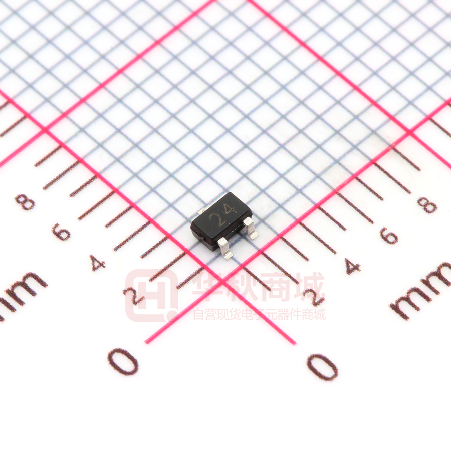

DTC114EUA
DTC114EUA
    JIANGSU(长晶)
    SOT-323
    NPN Ic=50mA Vce=50V fT=250MHz P=200mW SOT-323
DTC114EUA 数据手册
JIANGSU CHANGJIANG ELECTRONICS TECHNOLOGY CO., LTD JC(T Digital Transistors (Built-in Resistors) DTC114EM/DTC114EE/DTC114EUA DTC114EKA /DTC114ECA/DTC114ESA ·Equivalent Circuit DIGITAL TRANSISTOR (NPN) FEATURES  Built-in bias resistors enable the configuration of an inverter circuit without connecting external input resistors(see equivalent circuit)  The bias resistors consist of thin-film resistors with complete isolation to allow negative biasing of the input.They also have the advantage of almost completely eliminating parasitic effects  Only the on/off conditions need to be set for operation, making device design easy PIN CONNENCTIONS and MARKING DTC114EM DTC114EE SOT-723 1. IN 1. IN 2. GND 2. GND 3. OUT 3. OUT MARKING:24 DTC114EUA MARKING:24 DTC114EKA SOT-323 SOT-23-3L 1. IN 1. IN 2. GND 2. GND 3. OUT 3. OUT MARKING:24 DTC114ECA SOT-523 MARKING:24 SOT-23 DTC114ESA TO-92S 1. IN 1. GND 2. GND 2. OUT 3. OUT 3. IN MARKING:24 www.cj-elec.com 1 C,Mar,2012 E,Oct,2014 ,ul,2011 C,Mar,2012 MAXIMUM RATINGS(Ta=25℃ unless otherwise noted) Symbol Limits(DTC114E□) Parameter M VCC Supply Voltage VIN Input Voltage IO E UA Unit KA CA SA 50 V -10~+40 V Output Current 50 mA ICM Peak Collector Current 100 mA PD Power Dissipation Tj Junction Temperature 150 ℃ Tstg Storage Temperature -55~+150 ℃ 100 150 200 300 mW ELECTRICAL CHARACTERISTICS (Ta=25℃ unless otherwise specified) Parameter Input voltage Output voltage Input current Symbol Conditions Min Typ Max VI(off) VCC=5V,IO=100µA VI(on) VO=0.3V,IO=10mA 3 V VO(on) IO/II=10mA/0.5mA 0.3 V VI=5V 0.88 mA 0.5 μA kΩ II 0.5 V Output current IO(off) VCC=50V,VI=0 DC current gain GI VO=5V,IO=5mA Input resistance R1 7 10 13 Resistance ratio R2/R1 0.8 1 1.2 Transition frequency www.cj-elec.com Unit fT VO=10V,IO=5mA,f=100MHz 2 30 250 MHz E,Oct,2014 ,ul,2011 C,Mar,2012 Typical Characteristics OFF Characteristics ON Characteristics 10 100 VCC=5V VO=0.3V Ta=100℃ (mA) (V) 10 1 OUTPUT CURRENT IO VI(ON) INPUT VOLTAGE 25℃ 3 30 Ta=25℃ 3 100℃ 1 0.1 0.03 0.3 0.1 0.1 0.3 1 0.3 10 3 OUTPUT CURRENT VO(ON) IO —— 0.01 0.0 100 30 0.4 (mA) 0.8 1.2 INPUT VOLTAGE VI(OFF) IO 1 GI 1000 —— 1.6 IO IO/II=20 VO=5V Ta=100℃ 25℃ GI 0.3 Ta=100℃ VO(ON) 25℃ DC CURRENT GAIN (V) 300 OUTPUT VOLTAGE 2.0 (V) 0.1 100 30 10 0.03 3 0.01 3 1 10 OUTPUT CURRENT CO 10 —— 30 IO 1 0.1 100 3 1 OUTPUT CURRENT VR PD 400 f=1MHz Ta=25℃ —— 10 IO 30 100 125 150 (mA) Ta 350 (mW) 250 POWER DISSIPATION 6 300 PD CO (pF) 8 OUTPUT CAPACITANCE 0.3 (mA) 4 2 DTC114ESA DTC114EUA/KA/CA 200 DTC114EE 150 DTC114EM 100 50 0 0 0 4 8 12 REVERSE BIAS VOLTAGE www.cj-elec.com 16 VR 20 0 (V) 25 50 75 AMBIENT TEMPERATURE 3 100 Ta (℃ ) E,Oct,2014 ,ul,2011 C,Mar,2012 Symbol A A1 b b1 c D E E1 e θ www.cj-elec.com 4 Dimensions In Millimeters Max. Min. 0.500 0.000 0.050 0.170 0.270 0.270 0.370 0.150 1.150 1.250 1.150 1.250 0.750 0.850 0.800TYP. 7° REF. Dimensions In Inches Min. Max. 0.020 0.000 0.002 0.007 0.011 0.011 0.015 0.006 0.045 0.049 0.045 0.049 0.030 0.033 0.031TYP. 7° REF. A,Jun,2014 E,Oct,2014 www.cj-elec.com 5 A,Jun,2014 E,Oct,2014 Symbol A A1 A2 b1 b2 c D E E1 e e1 L L1 θ www.cj-elec.com 6 Dimensions In Millimeters Min. Max. 0.700 0.900 0.000 0.100 0.700 0.800 0.150 0.250 0.250 0.350 0.100 0.200 1.500 1.700 0.700 0.900 1.450 1.750 0.500 TYP. 0.900 1.100 0.400 REF. 0.260 0.460 0° 8° Dimensions In Inches Min. Max. 0.028 0.035 0.000 0.004 0.028 0.031 0.006 0.010 0.010 0.014 0.004 0.008 0.059 0.067 0.028 0.035 0.057 0.069 0.020 TYP. 0.035 0.043 0.016 REF. 0.010 0.018 0° 8° A,Jun,2014 E,Oct,2014 www.cj-elec.com 7 A,Jun,2014 E,Oct,2014 Dimensions In Millimeters Min Max 0.900 1.100 0.000 0.100 0.900 1.000 0.200 0.400 0.080 0.150 2.000 2.200 1.150 1.350 2.150 2.450 0.650 TYP 1.200 1.400 0.525 REF 0.260 0.460 0° 8° Symbol A A1 A2 b c D E E1 e e1 L L1 θ www.cj-elec.com 8 Dimensions In Inches Min Max 0.035 0.043 0.000 0.004 0.035 0.039 0.008 0.016 0.003 0.006 0.079 0.087 0.045 0.053 0.085 0.096 0.026 TYP 0.047 0.055 0.021 REF 0.010 0.018 0° 8° A,Jun,2014 E,Oct,2014 www.cj-elec.com 9 A,Jun,2014 E,Oct,2014 Symbol A A1 A2 b c D E1 E e e1 L θ www.cj-elec.com 10 Dimensions In Millimeters Min Max 1.050 1.250 0.000 0.100 1.050 1.150 0.300 0.500 0.100 0.200 2.820 3.020 1.500 1.700 2.650 2.950 0.950(BSC) 1.800 2.000 0.300 0.600 0° 8° Dimensions In Inches Min Max 0.041 0.049 0.000 0.004 0.041 0.045 0.012 0.020 0.004 0.008 0.111 0.119 0.059 0.067 0.104 0.116 0.037(BSC) 0.071 0.079 0.012 0.024 0° 8° A,Jun,2014 E,Oct,2014 www.cj-elec.com 11 A,Jun,2014 E,Oct,2014 Symbol A A1 A2 b c D E E1 e e1 L L1 θ www.cj-elec.com 12 Dimensions In Millimeters Min Max 0.900 1.150 0.000 0.100 0.900 1.050 0.300 0.500 0.080 0.150 2.800 3.000 1.200 1.400 2.250 2.550 0.950 TYP 1.800 2.000 0.550 REF 0.300 0.500 0° 8° Dimensions In Inches Min Max 0.035 0.045 0.000 0.004 0.035 0.041 0.012 0.020 0.003 0.006 0.110 0.118 0.047 0.055 0.089 0.100 0.037 TYP 0.071 0.079 0.022 REF 0.012 0.020 0° 6° A,Jun,2014 E,Oct,2014 www.cj-elec.com 13 A,Jun,2014 E,Oct,2014 Dimensions In Millimeters Min. Max. 1.420 1.620 0.660 0.860 0.330 0.480 0.400 0.510 0.330 0.510 3.900 4.100 2.280 2.680 3.050 3.250 1.270 TYP. 2.440 2.640 15.100 15.500 45° TYP. Symbol A A1 b b1 c D D1 E e e1 L θ www.cj-elec.com 14 Dimensions In Inches Min. Max. 0.056 0.064 0.026 0.034 0.013 0.019 0.016 0.020 0.013 0.020 0.154 0.161 0.090 0.106 0.120 0.128 0.050 TYP. 0.096 0.104 0.594 0.610 45° TYP. A,Jun,2014 E,Oct,2014 www.cj-elec.com 15 A,Jun,2014 E,Oct,2014
