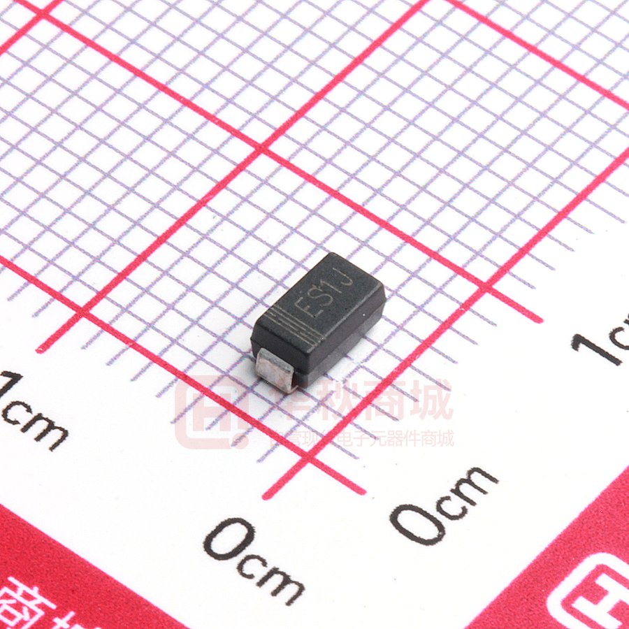

ES1J
ES1J
    JIANGSU(长晶)
    SMAG
    耐压:600V 电流:1A 反向恢复时间:35NS
ES1J 数据手册
JIANGSU CHANGJING ELECTRONICS TECHNOLOGY CO., LTD SMAG Plastic-Encapsulate Diodes ES1A THRU ES1J Super Fast Recovery Rectifier Diodes Features ●IF(AV) 1A ● VRRM 50V-600V SMAG ●High surge current capability ● Polarity: Color band denotes cathode Applications ● Rectifier Marking ● ES1X X : From A To J Item Symbol Unit Test Conditions ES1 A B C D E G H J Repetitive Peak Reverse Voltage VRRM V 50 100 150 200 300 400 Maximum RMS Voltage VRMS V 35 70 105 140 210 280 350 420 Average Forward Current IF(AV) A 60Hz Half-sine wave, Resistance load,T L=75℃ ℃ 1.0 Surge(Non-repetitive)Forward IFSM A 60Hz Half-sine wave, 1 cycle,Ta=25℃ ℃ 30 Current Operation Junction and Storage Temperature Range TJ,TSTG Electrical Characteristics (T=25 -55 ~ +150 Unless otherwise specified Symbol Unit Peak Forward Voltage VF V Maximum reverse recovery time trr ns Item Test Condition IF =1.0A Thermal Resistance(Typical) IRRM2 R J-A R J-L A /W VRM=VRRM ES1 A B C D E 0.95 IF=0.5A,IR=1.0A,Irr=0.25A IRRM1 Peak Reverse Current 500 600 G 1.25 H J 1.70 35 Ta =25 5 Ta =100 100 Between junction and ambient 85 Between junction and terminal 35 Notes: Thermal resistance from junction to ambient and from junction to lead mounted on P.C.B. with 0.2" x 0.2" (5.0 mm x 5.0 mm) copper ) pad areas www.jscj-elec.com 1 Rev. - 1.1 IO(A) FIG.1: FORWARD CURRENT DERATING CURVE FIG.2: MAXIMUM NON-REPETITIVE FORWARD URGE CURRENT 1.2 30 1.0 25 8.3ms Single Half Sine Wave 0.8 20 0.6 15 0.4 10 0.2 5 Resistive or Inductive Load P.C.B. Mounted on 0.2"×0.2" (5.0mm×5.0mm)Copper Pad Areas 0 80 90 100 110 120 130 0 140 150 TL( ) 1 10 FIG.4 TYPICAL REVERSE CHARACTERISTICS FIG.3: TYPICAL FORWARD CHARACTERISTICS 100 100 Number of Cycles 1000 TJ=25 Pulse width=300us 1% Duty Cycle Tj=150 ES1A-ES1D 10 Tj=125 100 Tj=100 ES1E-ES1G 1.0 10 ES1H-ES1J 0.1 1.0 Tj=25 0.01 0.4 0.1 0.6 0.8 1.0 1.2 1.4 1.6 VF(V) 0 20 40 60 80 100 Voltage(%) FIG.5: Diagram of circuit and Testing wave form of reverse recovery time I D t rr IF VR IF RL t 0 IR R IR www.jscj-elec.com 2 Rev. - 1.1 SMAG 0.106(2.70) 0.096(2.45) SMAG 4.12 1.8 NOTICE JSCJ reserves the right to make modifications,enhancements,improvements,corrections or other changes without further notice to any product herein.JSCJ does not assume any liability arising out of the application or use of any product described herein. www.jscj-elec.com 3 Rev. - 1.1 Reel Taping Specifications For Surface Mount Dev ices- SMAG FIG:CONFIGURATION OF SURFACE MOUNTED DEVICES TAPING G 279 2.0 (11 0.079) 75 1.0 2.95 0.039 www.jscj-elec.com 4 Rev. - 1.1
