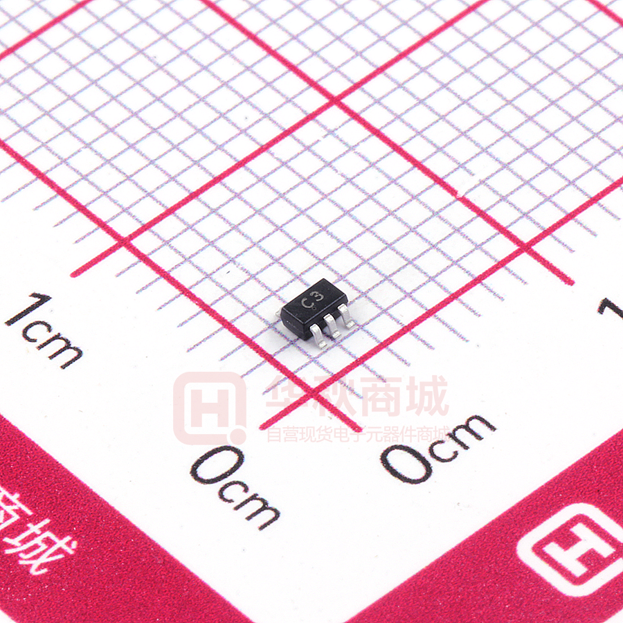

    双数字晶体管(NPN+PNP)Io=50mA VCC=50V PD=150mW SOT353
UMC3N 数据手册
JIANGSU CHANGJIANG ELECTRONICS TECHNOLOGY CO., LTD Digital Transistors (Built-in Resistors) JC(T UMC3N Dual Digital Transistors (NPN+PNP) SOT-353 FEATURES z DTA114E and DTC114E transistors are built-in a package z Ideal for power switch circuits z Mounting cost and area can be cut in half MARKING: C3 NPN DTC114E Absolute maximum ratings (Ta=25℃) Limits Parameter Symbol Supply voltage VCC 50 V Input voltage VIN -10~+40 V Output current IO 50 ICM 100 Unit mA Power dissipation PD 150 Junction temperature Tj 150 ℃ Storage temperature Tstg -55~150 ℃ mW Electrical characteristics (Ta=25℃) Parameter Input voltage Symbol VI(off) Min Typ Max 0.5 Unit V Conditions VCC=5V ,IO=100μA VI(on) 3 VO(on) 0.3 V Input current II 0.88 mA VI=5V Output current IO(off) 0.5 μA VCC=50V, VI=0 Output voltage DC current gain GI 30 Input resistance R1 7 Resistance ratio R2/R1 0.8 Transition frequency VO=0.3V ,IO=10mA IO/II=10mA/0.5mA VO=5V,IO=5mA 10 13 1 1.2 250 fT kΩ MHz VCE=10V ,IE=-5mA,f=100MHz PNP DTA114E Absolute maximum ratings (Ta=25℃) Parameter Symbol Limits Unit Supply voltage VCC -50 V Input voltage VIN -40~+10 V IO -50 ICM -100 Output current mA Power dissipation PD 150 mW Junction temperature Tj 150 ℃ Storage temperature Tstg -55~150 ℃ Electrical characteristics (Ta=25℃) Parameter Input voltage Symbol VI(off) Min Typ Max -0.5 Unit V Conditions VCC=-5V ,IO=-100μA VI(on) -3 Output voltage VO(on) -0.3 V IO/II=-10mA/-0.5mA Input current II -0.88 mA VI=-5V Output current IO(off) -0.5 μA DC current gain GI VCC=-50V, VI=0 VO=-5V,IO=-5mA 30 Input resistance R1 7 10 13 Resistance ratio R2/R1 0.8 1 1.2 Transition frequency fT www.cj-elec.com VO=-0.3V ,IO=-10mA 250 kΩ MHz 1 VCE=-10V ,IE=5mA,f=100MHz E,Mar,2016 Typical Characteristics DTC114E OFF Characteristics ON Characteristics 100 1 VCC=5V VO=0.3V 30 (mA) (V) 0.3 0.1 OUTPUT CURRENT INPUT VOLTAGE IO VI(ON) 10 3 Ta=25℃ Ta=100℃ 1 0.3 Ta=100℃ 0.03 Ta=25℃ 0.01 3E-3 0.1 0.1 0.3 1 3 OUTPUT CURRENT IO VO(ON) —— 1E-3 0.0 30 10 0.4 (mA) 0.8 1.2 INPUT VOLTAGE VI(OFF) GI IO 1000 1.6 IO —— 1000 IO/II=20 VO=5V Ta=100℃ GI 300 DC CURRENT GAIN VO(ON) (mV) 300 OUTPUT VOLTAGE 2.0 (V) 100 Ta=100℃ Ta=25℃ 30 Ta=25℃ 100 30 10 3 10 0.5 1 OUTPUT CURRENT CO 30 10 3 —— IO 1 0.1 50 0.3 (mA) 1 PD VR 8 10 3 OUTPUT CURRENT IO 30 100 125 150 (mA) —— Ta 200 (mW) f=1MHz Ta=25℃ POWER DISSIPATION CO CAPACITANCE 150 PD (pF) 6 4 2 0 100 50 0 0 5 10 REVERSE BIAS VOLTAGE www.cj-elec.com 15 VR 0 20 (V) 25 50 75 AMBIENT TEMPERATURE 2 100 Ta (℃ ) E,Mar,2016 Typical Characteristics DTA 114E ON Characteristics OFF Characteristics -100 -10 VO=-0.3V -30 (mA) (V) -3 -1 OUTPUT CURRENT INPUT VOLTAGE IO VI(ON) -10 Ta=25℃ -3 Ta=100℃ -1 Ta=100℃ -0.3 Ta=25℃ -0.1 -0.03 -0.3 -0.1 -0.1 -0.3 -3 -1 -30 -10 OUTPUT CURRENT IO GI IO —— -0.01 -0.0 -100 VCC=-5V -0.4 (mA) -0.8 -1.2 INPUT VOLTAGE VI(OFF) VO(ON) —— -1000 1000 -1.6 -2.0 (V) IO VO=-5V IO/II=20 -300 VO(ON) 100 Ta=100℃ 30 OUTPUT VOLTAGE DC CURRENT GAIN GI (mV) 300 Ta=25℃ 10 Ta=100℃ -100 Ta=25℃ -30 3 1 -0.1 -10 -0.3 -3 -1 OUTPUT CURRENT CO 12 —— -10 IO -1 -100 -30 -10 -3 OUTPUT CURRENT (mA) PD VR —— -100 -30 IO (mA) Ta 200 f=1MHz Ta=25℃ 150 PD 8 POWER DISSIPATION OUTPUT CAPACITANCE CO (pF) (mW) 10 6 4 100 50 2 0 0 0 4 8 12 REVERSE BIAS VOLTAGE www.cj-elec.com 16 VR 0 20 (V) 25 50 75 AMBIENT TEMPERATURE 3 100 Ta 125 150 (℃ ) E,Mar,2016 SOT-353 Package Outline Dimensions Symbol A A1 A2 b c D E E1 e e1 L L1 θ Dimensions In Millimeters Max Min 0.900 1.100 0.000 0.100 0.900 1.000 0.150 0.350 0.100 0.150 2.000 2.200 1.150 1.350 2.150 2.400 0.650 TYP 1.200 1.400 0.525 REF 0.260 0.460 0° 8° Dimensions In Inches Min Max 0.035 0.043 0.000 0.004 0.035 0.039 0.006 0.014 0.004 0.006 0.079 0.087 0.045 0.053 0.085 0.094 0.026 TYP 0.047 0.055 0.021 REF 0.010 0.018 0° 8° SOT-353 Suggested Pad Layout www.cj-elec.com 4 E,Mar,2016 SOT-353 Tape and Reel www.cj-elec.com 5 E,Mar,2016
