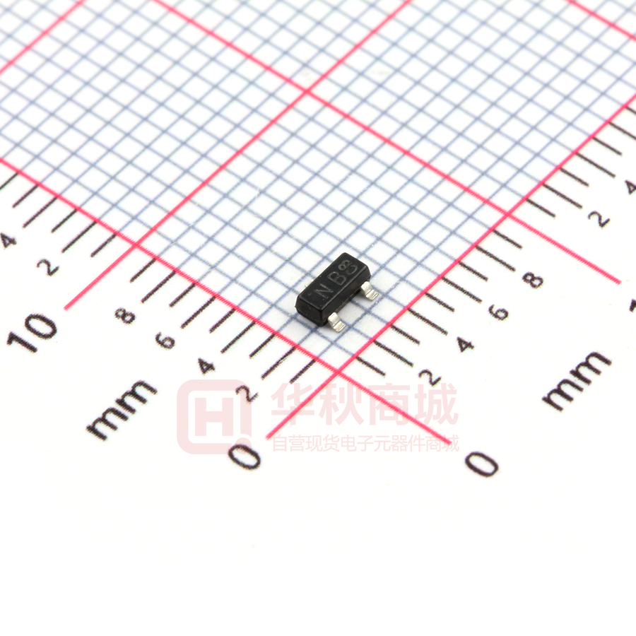

    SOT-23
    晶体管类型:NPN - 预偏压 集电极电流Ic:100mA 集射极击穿电压Vce:50V 额定功率:200mW NPN,Vo=50V,Io=100mA
KRC102S-RTK/P 数据手册
SEMICONDUCTOR KRC101S~KRC106S TECHNICAL DATA EPITAXIAL PLANAR NPN TRANSISTOR SWITCHING APPLICATION. INTERFACE CIRCUIT AND DRIVER CIRCUIT APPLICATION. E B L FEATURES L ・With Built-in Bias Resistors. D ・Simplify Circuit Design. 2 H A 3 G ・Reduce a Quantity of Parts and Manufacturing Process. 1 Q J EQUIVALENT CIRCUIT P N C P OUT K BIAS RESISTOR VALUES TYPE NO. R1(kΩ) R2(kΩ) KRC101S 4.7 4.7 KRC102S 10 10 KRC103S 22 22 KRC104S 47 47 KRC105S 2.2 47 KRC106S 4.7 47 DIM A B C D E G H J K L M N P Q MILLIMETERS 2.93 +_ 0.20 1.30+0.20/-0.15 1.30 MAX 0.40+0.15/-0.05 2.40+0.30/-0.20 1.90 0.95 0.13+0.10/-0.05 0.00 ~ 0.10 0.55 0.20 MIN 1.00+0.20/-0.10 7 0.1 MAX M 1. COMMON (EMITTER) 2. IN (BASE) R1 IN R2 COMMON 3. OUT (COLLECTOR) SOT-23 MAXIMUM RATING (Ta=25℃) CHARACTERISTIC Output Voltage SYMBOL RATING UNIT VO 50 V KRC101S~106S KRC101S 20, -10 KRC102S 30, -10 KRC103S 40, -10 VI Input Voltage V KRC104S 40, -10 KRC105S 12, -5 KRC106S 20, -5 IO 100 mA PD 200 mW Tj 150 ℃ Tstg -55~150 ℃ Output Current Power Dissipation KRC101S~106S Junction Temperature Storage Temperature Range Marking TYPE KRC101S KRC102S KRC103S KRC104S KRC105S KRC106S MARK NA NB NC ND NE NF 2008. 10. 28 Revision No : 3 Lot No. Type Name 1/6 KRC101S~KRC106S ELECTRICAL CHARACTERISTICS (Ta=25℃) CHARACTERISTIC Output Cut-off Current SYMBOL MIN. TYP. MAX. UNIT - - 500 nA KRC101S 30 55 - KRC102S 50 80 - 70 120 - KRC104S 80 200 - KRC105S 80 200 - KRC106S 80 200 - - 0.1 0.3 KRC101S - 1.5 2.0 KRC102S - 1.8 2.4 - 2.1 3.0 KRC104S - 2.8 5.0 KRC105S - 0.8 1.1 KRC106S - 0.9 1.3 1.0 1.2 - 0.5 0.65 - - 200 - KRC101S - - 1.8 KRC102S - - 0.88 - - 0.36 KRC104S - - 0.18 KRC105S - - 3.6 KRC106S - - 1.8 KRC101S 3.29 4.7 6.11 KRC102S 7 10 13 15.4 22 28.6 KRC104S 32.9 47 61.1 KRC105S 1.54 2.2 2.86 KRC106S 3.29 4.7 6.11 KRC101S~104S 0.8 1.0 1.2 17 21 26 8 10 12 KRC101S~106S IO(OFF) TEST CONDITION VO=50V, VI=0 KRC103S GI DC Current Gain Output Voltage KRC101S~106S VO(ON) VO=5V, IO=10mA IO=10mA, II=0.5mA KRC103S VI(ON) Input Voltage (ON) VO=0.2V, IO=5mA KRC101S~104S VI(OFF) Input Votlage (OFF) Transition Frequency KRC101S~106S fT * VO=10V, IO=5mA KRC103S II Input Current KRC103S Input Resistor Resistor Ratio KRC105S KRC106S R1 R2/R1 V VO=5V, IO=0.1mA KRC105S~106S V V VI=5V MHz mA - - kΩ Note : * Characteristic of Transistor Only. 2008. 10. 28 Revision No : 3 2/6 KRC101S~KRC106S ELECTRICAL CHARACTERISTICS (Ta=25℃) CHARACTERISTIC SYMBOL TEST CONDITION MIN. TYP. MAX. KRC101S - 0.03 - KRC102S - 0.05 - - 0.12 - - 0.22 - KRC105S - 0.01 - KRC106S - 0.03 - KRC101S - 2.0 - - 2.0 - - 2.0 - - 2.0 - KRC105S - 2.0 - KRC106S - 2.0 - KRC101S - 0.12 - KRC102S - 0.36 - - 0.35 - KRC104S - 0.6 - KRC105S - 0.1 - KRC106S - 0.19 - KRC103S Rise Time KRC104S tr KRC102S UNIT VO=5V KRC103S Switching Time tstg Storage Time KRC104S RL=1kΩ KRC103S μS tf Fall Time 2008. 10. 28 VIN=5V Revision No : 3 3/6 KRC101S~KRC106S I O - VI(ON) 100 Ta=25 C Ta=-25 C 5 3 1 VO =0.2V 50 30 10 5 3 C 10 KRC102S 1 0.5 0.3 0.5 0.3 0.1 0.3 1 3 10 30 0.1 100 INPUT ON VOLTAGE V I(ON) (V) 0.3 1 Ta=25 C Ta=-25 C 1 0.5 0.3 1 3 10 30 VO =0.2V 50 30 10 5 3 1 100 0.1 0.3 1 3 10 30 100 INPUT ON VOLTAGE V I(ON) (V) I O - V I(ON) I O - VI(ON) KRC105S KRC106S 100 OUTPUT CURRENT I O (mA) VO =0.2V 50 30 00 C 10 Ta=25 C Ta=-25 C Ta=1 5 3 1 0.5 0.3 VO =0.2V 50 30 10 Ta=1 00 C 100 OUTPUT CURRENT I O (mA) Ta=25 C Ta=-25 C 0.5 0.3 INPUT ON VOLTAGE V I(ON) (V) 5 3 Ta=25 C Ta=-25 C 1 0.5 0.3 0.1 0.3 1 3 10 30 INPUT ON VOLTAGE V I(ON) (V) 2008. 10. 28 100 C 0 C 10 0.3 30 KRC104S Ta =1 00 OUTPUT CURRENT I O (mA) 50 30 Ta= 10 OUTPUT CURRENT I O (mA) 100 VO =0.2V 0.1 10 I O - VI(ON) KRC103S 5 3 3 INPUT ON VOLTAGE V I(ON) (V) I O - VI(ON) 100 Ta=25 C Ta=-25 C Ta=1 00 50 30 OUTPUT CURRENT I O (mA) 25 -25 100 VO =0.2V Ta=1 00 C OUTPUT CURRENT I O (mA) 100 I O - VI(ON) KRC101S Revision No : 3 100 0.1 0.3 1 3 10 30 100 INPUT ON VOLTAGE V I(ON) (V) 4/6 KRC101S~KRC106S I O - VI(OFF) I O - V I(OFF) KRC101S 10k KRC102S 10k VO =5V 100 50 30 0.6 0.8 1.0 1.2 1.4 1.6 1.8 2.0 C Ta= -25 500 300 100 50 30 0.6 0.8 INPUT OFF VOLTAGE V I(OFF) (V) 1.0 1.2 1.4 1.6 KRC104S 10k VO =5V 100 50 30 0.8 1.0 1.2 1.4 1.6 1.8 C 5 Ta =2 Ta =2 5 C 500 300 100 50 30 2.0 0.8 INPUT OFF VOLTAGE V I(OFF) (V) 1.0 1.2 1.4 1.6 1.8 I O - V I(OFF) I O - V I(OFF) KRC106S 10k 100 50 30 0.2 0.4 0.6 0.8 1.0 1.2 INPUT OFF VOLTAGE V I(OFF) (V) Revision No : 3 1.4 5k 3k 500 300 Ta=25 C Ta=-2 5 C 1k Ta=1 00 C OUTPUT CURRENT I O (µA) Ta=25 C Ta=-2 5 C 00 C 1k 0 2008. 10. 28 VO =5V 5k 3k Ta=1 OUTPUT CURRENT I O (µA) VO =5V 500 300 2.0 INPUT OFF VOLTAGE V I(OFF) (V) KRC105S 10k C 1k 0 C -25 100 Ta= C Ta= 25 C 1k 5k 3k Ta =1 0 OUTPUT CURRENT I O (µA) 5k 3k Ta= OUTPUT CURRENT I O (µA) VO =5V 0.6 2.0 I O - V I(OFF) KRC103S 500 300 1.8 INPUT OFF VOLTAGE V I(OFF) (V) I O - V I(OFF) 10k C 1k Ta= 25 C Ta= -25 500 300 Ta= 25 100 C C 1k 5k 3k Ta= 100 C OUTPUT CURRENT I O (µA) 5k 3k Ta= OUTPUT CURRENT I O (µA) VO =5V 100 50 30 0 0.2 0.4 0.6 0.8 1.0 1.2 1.4 INPUT OFF VOLTAGE V I(OFF) (V) 5/6 KRC101S~KRC106S GI - I O 300 GI - IO KRC101S 300 KRC102S VO =5V VO =5V DC CURRENT GAIN G I DC CURRENT GAIN G I Ta=100 C Ta=100 C 100 50 Ta=25 C Ta=-25 C 30 10 5 0.5 1 3 30 10 100 Ta=25 C Ta=-25 C 50 30 10 5 0.5 100 1 OUTPUT CURRENT I O (mA) 3 300 KRC104S DC CURRENT GAIN G I DC CURRENT GAIN G I Ta=100 C Ta=25 C Ta=-25 C 50 30 Ta=100 C 100 Ta=25 C Ta=-25 C 50 30 10 10 VO =5V 5 0.5 VO =5V 5 1 3 10 30 0.5 100 1 OUTPUT CURRENT I O (mA) 3 300 DC CURRENT GAIN G I Ta=25 C Ta=-25 C 50 30 10 Ta=100 C 100 Ta=25 C Ta=-25 C 50 30 10 VO =5V VO =5V 5 1 3 10 30 OUTPUT CURRENT I O (mA) 2008. 10. 28 100 KRC106S 100 5 0.5 30 GI - IO KRC105S Ta=100 C DC CURRENT GAIN G I 10 OUTPUT CURRENT I O (mA) GI - IO 300 100 GI - IO KRC103S 100 30 OUTPUT CURRENT I O (mA) GI - IO 300 10 Revision No : 3 100 0.5 1 3 10 30 100 OUTPUT CURRENT I O (mA) 6/6
