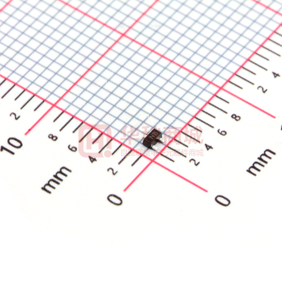

SEMICONDUCTOR KRC401E~KRC406E TECHNICAL DATA EPITAXIAL PLANAR NPN TRANSISTOR SWITCHING APPLICATION. INTERFACE CIRCUIT AND DRIVER CIRCUIT APPLICATION. FEATURES E ・With Built-in Bias Resistors. B ・Simplify Circuit Design. D 2 DIM A B C D G H A ・Reduce a Quantity of Parts and Manufacturing Process. ・High Packing Density. 3 1 ・Suffix U : Qualified to AEC-Q101. E F ex) KRC401E-RTK/HU G C J BIAS RESISTOR VALUES EQUIVALENT CIRCUIT OUT IN R1 R2 COMMON F TYPE NO. R1(kΩ) R2(kΩ) KRC401E 4.7 4.7 KRC402E 10 10 KRC403E 22 22 KRC404E 47 47 KRC405E 2.2 47 KRC406E 4.7 47 H J MILLIMETERS _ 0.20 1.60 + _ 0.10 0.85+ _ 0.10 0.70 + _ 0.10 0.27 + _ 0.10 1.60 + _ 0.10 0.39 + _ 0.10 1.00 + 0.50 _ 0.05 0.13 + F 1. COMMON (EMITTER) 2. IN (BASE) 3. OUT (COLLECTOR) ESM ℃) MAXIMUM RATING (Ta=25℃ CHARACTERISTIC Output Voltage SYMBOL RATING UNIT VO 50 V KRC401E~406E KRC401E 20, -10 KRC402E 30, -10 KRC403E KRC404E V 40, -10 KRC405E 12, -5 KRC406E 20, -5 IO 100 mA PD 100 mW Tj -55~150 ℃ Tstg -55~150 ℃ Output Current Power Dissipation KRC401E~406E Junction Temperature 40, -10 VI Input Voltage Storage Temperature Range Marking MARK SPEC TYPE KRC401E KRC402E KRC403E KRC404E KRC405E KRC406E MARK NA NB NC ND NE NF 2021. 04. 07 Revision No : 5 Type Name 1/7 KRC401E~KRC406E ℃) ELECTRICAL CHARACTERISTICS (Ta=25℃ CHARACTERISTIC Output Cut-off Current SYMBOL MIN. TYP. MAX. UNIT - - 500 nA KRC401E 30 55 - KRC402E 50 80 - 70 120 - 80 200 - KRC405E 80 200 - KRC406E 80 200 - - 0.1 0.3 KRC401E - 1.5 2.0 KRC402E - 1.8 2.4 - 2.1 3.0 - 2.8 5.0 KRC405E - 0.8 1.1 KRC406E - 0.9 1.3 1.0 1.2 - 0.5 0.65 - - 200 - KRC401E - - 1.8 KRC402E - - 0.88 - - 0.36 - - 0.18 KRC405E - - 3.6 KRC406E - - 1.8 KRC401E 3.29 4.7 6.11 KRC402E 7 10 13 15.4 22 28.6 KRC404E 32.9 47 61.1 KRC405E 1.54 2.2 2.86 KRC406E 3.29 4.7 6.11 KRC401E~404E 0.8 1.0 1.2 17 21 26 8 10 12 KRC401E~406E IO(OFF) TEST CONDITION VO=50V, VI=0 KRC403E DC Current Gain Output Voltage KRC404E KRC401E~406E KRC403E Input Voltage (ON) KRC404E KRC401E~404E Input Votlage (OFF) GI VO(ON) VI(ON) VO=5V, IO=10mA IO=10mA, II=0.5mA VO=0.2V, IO=5mA VI(OFF) VO=5V, IO=0.1mA fT * VO=10V, IO=5mA KRC405E~406E Transition Frequency KRC401E~406E KRC403E Input Current KRC404E Input Resistor Resistor Ratio KRC403E KRC405E KRC406E II R1 R2/R1 VI=5V V V V MHz mA - - kΩ Note : * Characteristic of Transistor Only. 2021. 04. 07 Revision No : 5 2/7 KRC401E~KRC406E ℃) ELECTRICAL CHARACTERISTICS (Ta=25℃ CHARACTERISTIC SYMBOL TEST CONDITION MIN. TYP. MAX. KRC401E - 0.03 - KRC402E - 0.05 - - 0.12 - - 0.22 - KRC405E - 0.01 - KRC406E - 0.03 - KRC401E - 2.0 - - 2.0 - - 2.0 - - 2.0 - KRC405E - 2.0 - KRC406E - 2.0 - KRC401E - 0.12 - KRC402E - 0.36 - - 0.35 - - 0.6 - KRC405E - 0.1 - KRC406E - 0.19 - KRC403E Rise Time KRC404E tr KRC402E KRC403E Switching Time Storage Time KRC404E VO=5V tstg RL=1kΩ KRC403E Fall Time KRC404E 2021. 04. 07 Revision No : 5 VIN=5V tf UNIT μS 3/7 KRC401E~KRC406E 10 5 3 Ta=25 C Ta=-25 C 1 0.5 0.3 0.1 0.3 1 3 10 30 100 VO =0.2V 50 30 10 5 3 0.5 0.3 0.1 100 0.1 0.3 1 3 10 30 C 5 3 1 0.1 100 0.1 0.3 1 3 10 30 INPUT ON VOLTAGE VI(ON) (V) 2021. 04. 07 Revision No : 5 1 3 10 30 100 100 I O - V I(ON) KRC406E VO =0.2V 50 30 00 C 10 5 3 Ta=25 C Ta=-25 C Ta=1 OUTPUT CURRENT I O (mA) 00 C Ta=25 C Ta=-25 C 1 0.5 0.3 0.3 INPUT ON VOLTAGE V I(ON) (V) 10 5 3 Ta=25 C Ta=-25 C 0.5 0.3 100 VO =0.2V 50 30 100 10 I O - V I(ON) Ta=1 OUTPUT CURRENT I O (mA) 100 30 VO =0.2V 50 30 INPUT ON VOLTAGE VI(ON) (V) KRC405E 10 I O - V I(ON) KRC404E 00 Ta=25 C Ta=-25 C 1 0.5 0.3 3 =1 10 5 3 1 Ta OUTPUT CURRENT I O (mA) VO =0.2V 50 30 0.3 INPUT ON VOLTAGE V I(ON) (V) I O - V I(ON) Ta= 100 C OUTPUT CURRENT I O (mA) 100 Ta=25 C Ta=-25 C 1 INPUT ON VOLTAGE VI(ON) (V) KRC403E I O - V I(ON) KRC402E Ta=1 00 C OUTPUT CURRENT I O (mA) 50 30 100 25 -25 100 VO =0.2V Ta=1 00 C OUTPUT CURRENT I O (mA) 100 I O - V I(ON) KRC401E 1 0.5 0.3 0.1 0.3 1 3 10 30 100 INPUT ON VOLTAGE V I(ON) (V) 4/7 KRC401E~KRC406E 10k 100 50 30 1.6 1.8 2.0 0.6 0.8 INPUT OFF VOLTAGE V I(OFF) (V) 1.0 100 50 30 1.0 1.2 1.4 1.6 1.8 2.0 =2 0 500 300 Ta 50 30 1.0 1.2 0.6 0.8 1.0 1.2 INPUT OFF VOLTAGE V I(OFF) (V) 2021. 04. 07 2.0 Revision No : 5 1.4 VO =5V 5k 3k 1k Ta=1 00 C OUTPUT CURRENT I O (μA) Ta=25 C Ta=-2 5 C 00 C 100 0.4 1.8 KRC406E 10k 1k Ta=1 OUTPUT CURRENT I O (μA) 5k 3k 0.2 1.6 I O - V I(OFF) VO =5V 0 1.4 INPUT OFF VOLTAGE V I(OFF) (V) I O - V I(OFF) 50 30 C 100 0.8 KRC405E 500 300 Ta= -25 5 C C 1k INPUT OFF VOLTAGE V I(OFF) (V) 10k 2.0 VO =5V 5k 3k Ta =1 0 OUTPUT CURRENT I O (μA) C -25 Ta= 100 Ta= 25 C C 1k Ta= OUTPUT CURRENT I O (μA) 5k 3k 0.8 1.8 KRC404E 10k VO =5V 0.6 1.6 I O - V I(OFF) KRC403E 500 300 1.4 INPUT OFF VOLTAGE V I(OFF) (V) I O - V I(OFF) 10k 1.2 C 1.4 50 30 5 1.2 100 Ta =2 1.0 500 300 500 300 Ta=25 C Ta=-2 5 C 0.8 0.6 1k C C Ta= -25 500 300 Ta= 25 Ta= 100 C C 1k VO =5V 5k 3k Ta= 25 OUTPUT CURRENT I O (μA) 5k 3k 100 C VO =5V I O - V I(OFF) KRC402E Ta= 10k OUTPUT CURRENT I O (μA) I O - V I(OFF) KRC401E 100 50 30 0 0.2 0.4 0.6 0.8 1.0 1.2 1.4 INPUT OFF VOLTAGE V I(OFF) (V) 5/7 KRC401E~KRC406E GI - IO 300 VO =5V DC CURRENT GAIN G I DC CURRENT GAIN G I 300 GI - IO KRC401E Ta=100 C 100 50 Ta=25 C Ta=-25 C 30 10 5 0.5 1 3 10 30 VO =5V Ta=25 C Ta=-25 C 50 30 10 1 OUTPUT CURRENT I O (mA) 300 3 300 DC CURRENT GAIN G I DC CURRENT GAIN G I Ta=25 C Ta=-25 C 50 30 10 Ta=100 C 100 Ta=25 C Ta=-25 C 50 30 VO =5V 1 3 10 30 5 0.5 100 VO =5V 1 3 OUTPUT CURRENT I O (mA) GI - IO KRC405E 300 DC CURRENT GAIN G I DC CURRENT GAIN G I 100 Ta=25 C Ta=-25 C 50 30 10 5 0.5 VO =5V 1 3 10 30 OUTPUT CURRENT I O (mA) Revision No : 5 10 -3 -00 OUTPUT CURRENT I O (mA) 100 GI - IO KRC406E Ta=100 C 2021. 04. 07 100 10 5 0.5 300 30 GI - IO KRC404E Ta=100 C 100 10 OUTPUT CURRENT I O (mA) GI - IO KRC403E Ta=100 C 100 5 0.5 100 KRC402E Ta=100 C 100 Ta=25 C Ta=-25 C 50 30 10 5 0.5 VO =5V 1 3 10 30 100 OUTPUT CURRENT I O (mA) 6/7 COLLECTOR POWER DISSIPATION PC (mW) KRC401E~KRC406E Pc - Ta 125 100 75 50 25 0 0 25 50 75 100 125 150 AMBIENT TEMPERATURE Ta ( C) 2021. 04. 07 Revision No : 5 7/7
