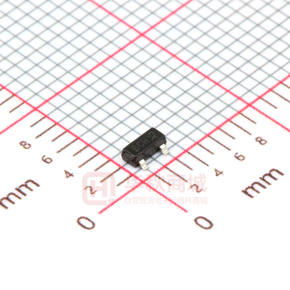

    NPN Ic=500mA Vceo=30V hfe=96~246 fT=140MHz
KTC9013S-H-RTK/P 数据手册
SEMICONDUCTOR KTC9013S TECHNICAL DATA EPITAXIAL PLANAR NPN TRANSISTOR GENERAL PURPOSE APPLICATION. SWITCHING APPLICATION. E B L FEATURES L ・Excellent hFE Linearity. D ・Complementary to KTC9012S. H MAXIMUM RATING (Ta=25℃) 3 G A 2 1 Q UNIT Collector-Base Voltage VCBO 40 V Collector-Emitter Voltage VCEO 30 V Emitter-Base Voltage VEBO 5 V Collector Current IC 500 mA Emitter Current IE -500 mA PC * 350 mW Tj 150 ℃ Tstg -55~150 ℃ P K J RATING C SYMBOL N P CHARACTERISTIC DIM A B C D E G H J K L M N P Q MILLIMETERS 2.93 +_ 0.20 1.30+0.20/-0.15 1.30 MAX 0.40+0.15/-0.05 2.40+0.30/-0.20 1.90 0.95 0.13+0.10/-0.05 0.00 ~ 0.10 0.55 0.20 MIN 1.00+0.20/-0.10 7 0.1 MAX M 1. EMITTER 2. BASE 3. COLLECTOR Collector Power Dissipation Junction Temperature Storage Temperature Range SOT-23 * PC : Package Mounted On 99.5% Alumina (10×8×0.6㎜) Marking h FE Rank Type Name Lot No. BC ELECTRICAL CHARACTERISTICS (Ta=25℃) CHARACTERISTIC SYMBOL TEST CONDITION MIN. TYP. MAX. UNIT Collector Cut-off Current ICBO VCB=35V, IE=0 - - 0.1 μA Emitter Cut-off Current IEBO VEB=5V, IC=0 - - 0.1 μA 96 - 246 - 0.1 0.25 V 0.8 1.0 V 140 - - MHz - 7.0 - pF hFE (Note) DC Current Gain VCE=1V, IC=50mA VCE(sat) IC=100mA, IB=10mA Base-Emitter Voltage VBE IC=100mA, VCE=1V Transition Frequency fT Collector-Emitter Saturation Voltage Cob Collector Output Capacitance Note : hFE Classification 2003. 3. 25 F:96~135, G:118~166, Revision No : 1 VCE=6V, IC=20mA, f=100MHz VCB=6V, IE=0, f=1MHz H:144~202, I:176~246 1/2 KTC9013S h FE - I C 500 500 COMMON EMITTER Ta=25 C 400 4.0 6.0 DC CURRENT GAIN h FE 3.0 2.0 300 200 1.0 0.5 100 VCE =6V Ta =100 C Ta =25 C C Ta =-25 100 VCE =1V 50 30 I B =0.1mA COMMON EMITTER 0 10 0 2 1 3 4 5 0.5 1 3 10 30 100 300 COLLECTOR-EMITTER VOLTAGE VCE (V) COLLECTOR CURRENT I C (mA) VCE(sat) - I C I B - VBE 1 1K 2K 0.1 Ta =25 C Ta =-25 C Ta =100 C 0.05 100 50 30 C 500 300 5 C 0.3 Ta =-2 5 0.5 COMMON EMITTER VCE =6V 1K Ta =2 COMMON EMITTER I C /I B =10 BASE CURRENT I B (µA) COLLECTOR-EMITTER SATURATION VOLTAGE VCE(sat) (V) 300 Ta = 100 C COLLECTOR CURRENT I C (mA) I C - VCE (LOW VOLTAGE REGION) 10 5 0.03 0.5 1 3 10 30 100 300 1K COLLECTOR CURRENT I C (mA) 0 0.2 0.4 0.6 0.8 1.0 1.2 BASE-EMITTER VOLTAGE VBE (V) COLLECTOR POWER DISSIPATION Pc (mW) Pc - Ta 500 1 MOUNTED ON 99.5% ALUMINA 10x8x0.6mm 400 2 Ta=25 C 1 300 200 2 100 0 0 25 50 75 100 125 150 175 AMBIENT TEMPERATURE Ta ( C) 2003. 3. 25 Revision No : 1 2/2
