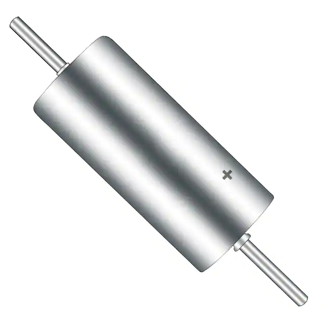

Tantalum Polymer Capacitors – Hermetically Sealed T550 Axial & T555 Surface Mount 105°C Overview The T550 axial leaded and T555 surface mount polymer hermetically sealed (PHS) devices are tantalum capacitors with a Ta anode and Ta2O5 dielectric. A conductive organic polymer replaces the traditionally used MnO2 or wet electrolyte as the cathode plate of the capacitor. This results in very low ESR and improved capacitance retention at high frequency and low temperature. The PHS device also exhibits a benign failure mode, which eliminates the case breach that can occur in wet tantalum capacitors. Additionally, this part may be operated at voltages up to 80% of rated voltage, with equivalent or better reliability than traditional MnO2 or wet tantalum capacitors operated at 50% of rated voltage. PHS capacitors also offer higher ripple current handling capability and a lower ESR range than wet tantalums. With reduced ESR and enhanced capacitance retention at higher frequencies and low temperatures, these parts provide the highest total capacitance and the most economical solution for high power applications, all within an approximately 25% lighter package than the equivalent wet tantalum capacitor. Benefits • Includes F-Tech anode which eliminates hidden defects in the dielectric • 100% simulated breakdown screening • Maximum operating temperature of +105°C • DLA drawing 13030 qualified parts available • Polymer cathode technology • Extremely low ESR • High frequency and low temperature capacitance retention • 100% constant voltage conditioning (240 hours) • 100% surge current tested • Volumetrically efficient • Non-ignition failure mode • Approximately 25% lighter than equivalent wet tantalum • T550 case dimensions equivalent to MIL–PRF–39006/22/25/30/31 • T555 surface mount design (see dimensions diagram) Applications Typical applications include high voltage power management, such as buck/boost converters, filtering, hold-up capacitors, and other high ripple current applications. Built Into Tomorrow © KEMET Electronics Corporation • KEMET Tower • One East Broward Boulevard Fort Lauderdale, FL 33301 USA • 954-766-2800 • www.kemet.com T2059_T550 • 10/19/2020 1 Tantalum Polymer Capacitors – Hermetically Sealed T550 Axial & T555 Surface Mount 105°C Ordering Information T 550 Capacitor Class Series T= Tantalum B 107 M 025 A T 4251 Product Level Termination Finish Surge Option** A = N/A B* = DLA 13030 standard reliability T* = DLA 13030 high reliability E* = DLA 13030 "B" level equivalent for T termination F* = DLA 13030 "T" level equivalent for T termination T = 100% tin (Sn)plated H = Tin/lead (SnPb) solder coated (5% Pb minimum) Case Capacitance Capacitance Rated Voltage Size Code (pF) Tolerance (VDC) 550 = Axial Leaded PHS 555 = Surface Mount PHS B First two digits represent significant figures. Third digit specifies number of zeros. K = ±10% M = ±20% 006 = 6.3 008 = 8 010 = 10 015 = 15 025 = 25 030 = 30 035 = 35 040 = 40 050 = 50 060 = 60 075= 75 100 = 100 Blank = 25°C ±5°C, 10 cycles, after constant voltage conditioning (KEMET standard) 4251 = 10 cycles, –55°C and +85°C after constant voltage conditioning 4252 = 10 cycles, –55°C and +85°C before constant voltage conditioning Packaging** Blank = Bulk/Sleeved 0100 = Bulk/ Unsleeved 7200 = Tape & Reel/ Sleeved 7293 = Ammo/Sleeved 7443 = Ammo/Sleeved * Only available on select parts. Refer to part number table for details. ** Only for T550 (Surge options/Packaging) Ordering Information – DLA 13030 -01 K A S L B Drawing Number Dash Number Capacitance Tolerance Surge Current Testing Insulation Lead Length Product Level See Part Number Table K = ±10% M = ±20% A = +25°C ±5°C, 10 cycles, after constant voltage conditioning (KEMET standard) B = –55°C, –5°C, +0°C and +85°C ±5°C after constant voltage conditioning. C = –55°C, –5°C, +0°C and +85°C ±5°C before constant voltage conditioning. S = Sleeved U = Unsleeved L = 1.50 inches (standard) B = Standard reliability T = High reliability * Standard terminations for DLA part numbers is "H" (SnPb). Performance Characteristics Item Performance Characteristics Operating Temperature Rated Capacitance Range Capacitance Tolerance Rated Voltage Range DF (120 Hz at 25°C) ESR (100 kHz at 25°C) Leakage Current Packaging −55°C to 105°C 20 – 680 μF at 120 Hz/25°C * K tolerance (±10%), M tolerance (±20%) 6.3 – 100 V Refer to Part Number Electrical Specification Table Refer to Part Number Electrical Specification Table Refer to Part Number Electrical Specification Table (rated voltage up to +85°C and 78% of rated voltage applied at 105°C) T550 according to MIL-PRF-39006, T555 bulk KEMET does not recommend storage above 85°C. * Additional case sizes and capacitance/voltage are under development. © KEMET Electronics Corporation • KEMET Tower • One East Broward Boulevard Fort Lauderdale, FL 33301 USA • 954-766-2800 • www.kemet.com T2059_T550 • 10/19/2020 2 Tantalum Polymer Capacitors – Hermetically Sealed T550 Axial & T555 Surface Mount 105°C Qualification - T550 Test Performed Method Reference Test Conditions Reliability and Environmental Tests AC Ripple Life at 85˚C MIL–PRF–39006 85˚C, 40 kHz ripple current, 2,000 hours 85˚C Life KEMET Standard 85˚C, rated voltage, 2,000 hours 105˚C Life KEMET Standard 105°C, 0.78 x rated voltage, 2,000 hours Surge Voltage MIL–PRF–39006 85˚C, 1.15 x rated voltage, 1,000 cycles, except delta cap shall be +10%/−20% Surge Current MIL–PRF–39003 +25 °C, 10 cycles (Option A), Option B available Low Temperature Storage MIL–PRF–39006 −62˚C for 72 hours followed by 1 hour at 125˚C Reverse Voltage KEMET Catalog 1 V for 8 hours maximum at 25°C, 1 V for 2 hours maximum at 70°C Physical, Mechanical and Process Tests Visual and Mechanical Examination (Internal and External) MIL–PRF–39006 Case dimensions, marking Terminal Strength MIL–PRF–39006 Pull test and wire lead bend test Resistance to Solvents MIL–PRF–39006 Immersion in (3) solvents Resistance to Soldering Heat MIL–PRF–39006 Solderability MIL–PRF–39003 Shock and Vibration MIL–STD–202, Methods 213, 204 Immersed to within 0.05 inch of capacitor body Depth of insertion in flux and solder to within 0.125 inch ±0.025 inch (3.18 mm ± 0.64 mm) from end of case and from the point of “clean lead” emerging from the seal eyelet. Shock Method 213, Condition I, 100 G peak, Vibration Method 204, Condition D, 20 G peak Barometric Pressure (Reduced) MIL–PRF–39006 Salt Atmosphere (Corrosion) MIL–PRF–39006 Subjected to fine mist of salt solution Moisture Resistance MIL–PRF–39006 65°C at 6 V Dielectric Withstanding Voltage MIL–PRF–39006 Insulation Resistance MIL–PRF–39003 150,000 feet for 5 minutes, voltage applied for 1 minute 2,000 VDC, 60 seconds, sleeving examined for evidence of breakdown 500 VDC, 1 minute, insulation resistance not less than 1,000 MΩ Electrical Characterization Temperature Stability Frequency Scan Reference MIL–PRF–39006 KEMET Standard −55˚C to 105˚C Impedance, ESR and capacitance versus frequency © KEMET Electronics Corporation • KEMET Tower • One East Broward Boulevard Fort Lauderdale, FL 33301 USA • 954-766-2800 • www.kemet.com T2059_T550 • 10/19/2020 3 Tantalum Polymer Capacitors – Hermetically Sealed T550 Axial & T555 Surface Mount 105°C Qualification – DLA Approval Inspection – Only for T550 Inspection Test Name DLA Requirement Paragraph Shock (specified pulse)1 Group I Vibration, high frequency SS/Lot 3.3.4 3.3.5 1 Thermal shock 3.3.6 Salt atmosphere 3.3.7 Solderability 3.3.8 Terminal strength 3.3.9 Surge voltage 3.3.10 2 6 per case size Moisture resistance 3.3.11 Dielectric withstanding voltage 3.3.12 Insulation resistance 3.3.13 Low temperature (storage) 3.3.14 Stability at low and high temperatures 3.3.15 13 Reverse voltage 3.3.23 12 per condition Group IV Life at 85°C 3.3.16 102 Group V AC ripple life at 85°C 3.3.18 8 per case size Group II Group III Group VI Group VII Life at 105°C 3.3.17 Barometric pressure 3.3.20 Resistance to solvents 3.3.21 Resistance to soldering heat 3.3.22 12 40 6 No failures for mechanical shock or vibration tests shall be permitted. Surge voltage change in capacitance limits are wider than those in some subsequent tests. It may be necessary to perform initial measurements again, prior to the individual tests of Group II. 1 2 Product Level: Inspection of product for delivery shall consist of: B level Group A inspection specified in Drawing 13030 T level Group A and group B inspections specified in Drawing 13030 © KEMET Electronics Corporation • KEMET Tower • One East Broward Boulevard Fort Lauderdale, FL 33301 USA • 954-766-2800 • www.kemet.com T2059_T550 • 10/19/2020 4 Tantalum Polymer Capacitors – Hermetically Sealed T550 Axial & T555 Surface Mount 105°C Qualification - T555 Test Performed Method Reference Test Conditions Reliability and Environmental Tests 105˚C Life KEMET Standard Surge Voltage 105°C, 0.78 x rated voltage, 2,000 hours 85˚C, 1.15 x rated voltage, 1,000 cycles, except delta cap shall be +10%/–20% MIL-PRF-39006 Physical, Mechanical and Process Tests Visual and Mechanical Examination (Internal and External) MIL-PRF-39003 Case dimensions, marking Terminal Strength MIL-PRF-39006 Pull test and wire lead bend test Resistance to Solvents MIL-PRF-39006 Immersion in (3) solvents Resistance to Soldering Heat MIL-PRF-39006 Immersed to within 0.05 inch of capacitor body Solderability MIL-PRF-39006 Depth of insertion in flux and solder to within 0.062 inch of welded joint Shock and Vibration MIL-STD-202, Methods 213, 204 Shock Method 213, Condition I, 100 g peak, Vibration Method 204, Condition D, 20 g peak Temperature Stability Reference MIL-PRF-39006 Electrical Characterization –55˚C to 105˚C Environmental Compliance Epoxy compliant with UL 94 V–0. © KEMET Electronics Corporation • KEMET Tower • One East Broward Boulevard Fort Lauderdale, FL 33301 USA • 954-766-2800 • www.kemet.com T2059_T550 • 10/19/2020 5 Tantalum Polymer Capacitors – Hermetically Sealed T550 Axial & T555 Surface Mount 105°C Electrical Characteristics ESR vs. Frequency ESR (Ohms) 10.0 +125°C +50°C 0°C −55°C 1.0 +85°C +25°C −25°C −80°C 0.1 0.0 10 100 1,000 10,000 100,000 1,000,000 10,000,000 Frequency (Hz) Capacitance vs. Frequency 120 Capacitance (µF) 100 80 60 40 +125°C +50°C 0°C −55°C 20 0 10 100 +85°C +25°C −25°C −80°C 1,000 10,000 100,000 1,000,000 Frequency (Hz) © KEMET Electronics Corporation • KEMET Tower • One East Broward Boulevard Fort Lauderdale, FL 33301 USA • 954-766-2800 • www.kemet.com T2059_T550 • 10/19/2020 6 Tantalum Polymer Capacitors – Hermetically Sealed T550 Axial & T555 Surface Mount 105°C Dimensions – Inches (Millimeters) T550 SIDE VIEW 0.094 (2.39) Maximum END VIEW 1.50 ±0.250 (38.10 ±6.35) J D + M L Case Code B Case Size Insulated Case Uninsulated Case MIL–PRF–39006 L ±0.031 (0.79) D +0.016 (0.41) −0.015 (0.38) M ±0.002 (0.05) J maximum D +0.016 (0.41) −0.015 (0.38) L ± 0.031 (0.79) T2 0.650 (16.51) 0.279 (7.09) 0.025 (0.64) 0.822 (20.88) 0.289 (7.34) 0.686 (17.42) Dimensions – Millimeters T555 CATHODE (−) END VIEW SIDE VIEW BOTTOM VIEW A W F H S S L Weight (g) Case Code B Surface mount L ±0.5 W ±0.5 H ±0.5 F ±0.5 S ±0.3 Average 24.5 8.5 9.1 4.2 3.0 5.54 © KEMET Electronics Corporation • KEMET Tower • One East Broward Boulevard Fort Lauderdale, FL 33301 USA • 954-766-2800 • www.kemet.com T2059_T550 • 10/19/2020 7 Tantalum Polymer Capacitors – Hermetically Sealed T550 Axial & T555 Surface Mount 105°C Table 1A – Ratings & Part Number Reference Rated Voltage Rated Capacitance Case Size KEMET Part Number DLA Drawing Number DC Leakage DF Maximum ESR Ripple Current (V) 85°C µF KEMET/EIA (See below for part options) (See below for part options) µA at 25°C Maximum/ 5 Minutes % at 25°C 120 Hz Max mΩ at 25°C 100 kHz mArms at 85°C/40 kHz 6.3 8 8 10 10 10 15 15 15 25 25 25 30 30 35 40 40 40 40 50 50 50 50 50 50 60 60 60 60 75 75 75 100 100 140 220 680 100 180 560 70 120 390 50 100 100 40 68 330 100 100 120 120 25 47 100 100 120 120 20 39 100 100 75 75 82 25 25 B B B B B B B B B B B B B B B B B B B B B B B B B B B B B B B B B B T550B147(1)006A(3) T550B227(1)008A(3) T550B687(1)008A(3) T550B107(1)010A(3) T550B187(1)010A(3) T550B567(1)010A(3) T550B706(1)015A(3) T550B127(1)015A(3) T550B397(1)015A(3) T550B506(1)025A(3) T550B107(1)025(2)H T550B107(1)025A(3) T550B406(1)030A(3) T550B686(1)030A(3) T550B337(1)035A(3) T550B107(1)040(2)(3) T550B107(1)040(7)T T550B127(1)040(2)(3) T550B127(1)040(7)T T550B256(1)050A(3) T550B476(1)050A(3) T550B107(1)050(2)(3) T550B107(1)050(7)T T550B127(1)050(2)(3) T550B127(1)050(7)T T550B206(1)060A(3) T550B396(1)060A(3) T550B107(1)060(2)(3) T550B107(1)060(7)T T550B756(1)075(2)(3) T550B756(1)075(7)T T550B826(1)075A(3) T550B256(1)100(2)(3) T550B256(1)100(7)T N/A N/A N/A N/A N/A N/A N/A N/A N/A N/A 13030-01(1)(4)(5)L(6) N/A N/A N/A N/A 13030-02(1)(4)(5)L(6) N/A 13030-03(1)(4)(5)L(6) N/A N/A N/A 13030-04(1)(4)(5)L(6) N/A 13030-05(1)(4)(5)L(6) N/A N/A N/A 13030-06(1)(4)(5)L(6) N/A 13030-07(1)(4)(5)L(6) N/A N/A 13030-08(1)(4)(5)L(6) N/A 6.3 13.2 40.8 7.5 13.5 42.0 7.9 13.5 43.9 9.4 18.8 18.8 9.0 15.3 86.6 30.0 30.0 36.0 36.0 9.4 17.6 37.5 37.5 45.0 45.0 9.0 17.6 45.0 45.0 42.2 42.2 57.6 18.8 18.8 5.0 5.0 5.0 5.0 5.0 5.0 5.0 5.0 5.0 5.0 5.0 5.0 5.0 5.0 10.0 5.0 5.0 5.0 5.0 5.0 5.0 5.0 5.0 5.0 5.0 5.0 5.0 5.0 5.0 5.0 5.0 5.0 5.0 5.0 120 120 90 140 110 90 140 110 90 170 190 190 170 140 180 150 150 120 120 170 150 130 130 90 90 200 160 100 100 110 110 220 190 190 1,510 1,510 1750 1400 1580 1750 1400 1580 1750 1275 1,200 1,200 1,275 1,400 1,240 1,350 1,350 1,510 1,510 1,275 1,350 1,450 1,450 1,750 1,750 1,175 1,310 1,660 1,660 1,580 1,580 1,800 1,200 1,200 (1) To complete KEMET part number, insert M for ±20% or K for ±10%. Designates capacitance tolerance. (2) To complete KEMET part number, insert A = N/A, B = standard reliability, or T = high reliability. (3) To complete KEMET part number, insert T = 100% matte tin (Sn)-plated, H = standard solder coated (SnPb 5% Pb minimum). Designates termination finish. (4) To complete the DLA PIN number, insert the surge current testing option, A = 25°C after voltage aging, B = −55°C +0°C and +85°C after voltage aging or C = −55°C +0°C and +85°C before voltage aging. (5) To complete the DLA PIN number, insert the insulation option. S = Sleeved, U = Unseleeved. (6) To complete the DLA PIN number, insert the product level option. B = standard reliability or T = high reliability. (7) To complete KEMET part number, insert E = DLA "B" level equivalent, or F = DLA "T" level equivalent. Designates product level Refer to Ordering Information for additional detail. Higher voltage ratings and tighter tolerance product including ESR may be substituted within the same size at KEMET's option. Voltage substitution will be marked with the higher voltage rating. The 85°C 40 kHz ripple limit is based on the maximum allowed power at 85°C and the maximum expected ESR at 40 kHz. For this calculation, the 100 kHz ESR limit is multiplied by a factor of 1.3 to account for the frequency dependence of ESR. © KEMET Electronics Corporation • KEMET Tower • One East Broward Boulevard Fort Lauderdale, FL 33301 USA • 954-766-2800 • www.kemet.com T2059_T550 • 10/19/2020 8 Tantalum Polymer Capacitors – Hermetically Sealed T550 Axial & T555 Surface Mount 105°C Table 1B – Ratings & Part Number Reference Rated Voltage Rated Capacitance Case Size KEMET Part Number DC Leakage DF Maximum ESR Ripple Current (V) 85°C µF KEMET/EIA (See below for part options) µA at 25°C Maximum/ 5 Minutes % at 25°C 120 Hz Max mΩ at 25°C 100 kHz mArms at 85°C/40 kHz 6.3 8 8 10 10 10 15 15 15 25 25 30 30 35 40 40 50 50 50 50 60 60 60 75 75 100 140 220 680 100 180 560 70 120 390 50 100 40 68 330 100 120 25 47 100 120 20 39 100 75 82 25 B B B B B B B B B B B B B B B B B B B B B B B B B B T555B147(1)006A(3) T555B227(1)008A(3) T555B687(1)008A(3) T555B107(1)010A(3) T555B187(1)010A(3) T555B567(1)010A(3) T555B706(1)015A(3) T555B127(1)015A(3) T555B397(1)015A(3) T555B506(1)025A(3) T555B107(1)025A(3) T555B406(1)030A(3) T555B686(1)030A(3) T555B337(1)035A(3) T555B107(1)040A(3) T555B127(1)040A(3) T555B256(1)050A(3) T555B476(1)050A(3) T555B107(1)050A(3) T555B127(1)050A(3) T555B206(1)060A(3) T555B396(1)060A(3) T555B107(1)060A(3) T555B756(1)075A(3) T555B826(1)075A(3) T555B256(1)100A(3) 6.3 13.2 40.8 7.5 13.5 42.0 7.9 13.5 43.9 9.4 18.8 9.0 15.3 86.6 30.0 36.0 9.4 17.6 37.5 45.0 9.0 17.6 45.0 42.2 57.6 18.8 5.0 5.0 5.0 5.0 5.0 5.0 5.0 5.0 5.0 5.0 5.0 5.0 5.0 10.0 5.0 5.0 5.0 5.0 5.0 5.0 5.0 5.0 5.0 5.0 5.0 5.0 120 120 90 140 110 90 140 110 90 170 190 170 140 180 150 120 170 150 130 90 200 160 100 110 220 190 1,510 1,510 1,750 1,400 1,580 1,750 1,400 1,580 1,750 1,275 1,200 1,275 1,400 1,240 1,350 1,510 1,275 1,350 1,450 1,750 1,175 1,310 1,660 1,580 1,800 1,200 (1) To complete KEMET part number, insert M for ±20% or K for ±10%. Designates capacitance tolerance. (3) To complete KEMET part number, insert T = 100% Matte Tin (Sn)-plated, H = Standard Solder coated (SnPb 5% Pb minimum). Designates termination finish. Refer to Ordering Information for additional detail. Higher voltage ratings and tighter tolerance product including ESR may be substituted within the same size at KEMET's option. Voltage substitution will be marked with the higher voltage rating. The 85°C 40 kHz ripple limit is based on the maximum allowed power at 85°C and the maximum expected ESR at 40 kHz. For this calculation, the 100 kHz ESR limit is multiplied by a factor of 1.3 to account for the frequency dependence of ESR. © KEMET Electronics Corporation • KEMET Tower • One East Broward Boulevard Fort Lauderdale, FL 33301 USA • 954-766-2800 • www.kemet.com T2059_T550 • 10/19/2020 9 Tantalum Polymer Capacitors – Hermetically Sealed T550 Axial & T555 Surface Mount 105°C Recommended Voltage Derating Guidelines 85°C to 105°C VR 78% of VR % Change in working DC voltage with temperature Recommended maximum application voltage (as % of rated voltage) 80% of VR 120% 100% % Working Voltage −55°C to 85°C 63% of VR % Change in working DC voltage with temperature 80% 80% Recommended maximum application voltage (as % of rated voltage) 60% 78% 63% 40% 20% 0% −55 25 45 85 105 Temperature (°C) Ripple Current/Ripple Voltage Permissible AC ripple voltage and current are related to equivalent series resistance (ESR) and the power dissipation capabilities of the device. Permissible AC ripple voltage that may be applied is limited by two criteria: 1. The positive peak AC voltage plus the DC bias voltage, if any, must not exceed the DC voltage rating of the capacitor. 2. The negative peak AC voltage in combination with bias voltage, if any, must not exceed the allowable limits specified for reverse voltage. The maximum power dissipation by case size can be determined using the below left table. The maximum power dissipation rating stated in the table must be reduced with increasing environmental operating temperatures. Refer to the below right table for temperature compensation requirements. Case Code KEMET MIL–PRF–39006/22/ 25/30/31 Case size B* T2 Maximum Power Dissipation (Pmax) mWatts at 25°C with +60°C Rise 715 * Applies to TH and SMD Temperature Compensation Multipliers for Maximum Power Dissipation (Pmax) T ≤ 45°C 1.00 45°C < T ≤ 85°C 0.70 T = Environmental temperature 85°C < T ≤ 105°C 0.10 Using the Pmax of the device, the maximum allowable rms ripple current or voltage may be determined. I(max) = √Pmax /R E(max) = Z √Pmax /R I = rms ripple current (amperes) E = rms ripple voltage (volts) Pmax = maximum power dissipation (watts) R = ESR at specified frequency (ohms) Z = Impedance at specified frequency (ohms) The maximum power dissipation rating must be reduced with increasing environmental operating temperatures. Refer to the Temperature Compensation Multiplier table for details. © KEMET Electronics Corporation • KEMET Tower • One East Broward Boulevard Fort Lauderdale, FL 33301 USA • 954-766-2800 • www.kemet.com T2059_T550 • 10/19/2020 10 Tantalum Polymer Capacitors – Hermetically Sealed T550 Axial & T555 Surface Mount 105°C Reverse Voltage Solid tantalum polymer capacitors are polar devices and may be permanently damaged or destroyed if connected with the wrong polarity. A small reverse voltage is permissible for time periods per the below table. KEMET can offer lower capacitance in this voltage with higher reverse voltage capability. In addition, we continue to improve our capability for this characteristic. Temperature Permissible Reverse Voltage 25°C 70°C 1 V for 8 hours maximum 1 V for 2 hours maximum Table 2 – Land Dimensions/Courtyard KEMET Metric Size Code Density Level A: Maximum (Most) Land Protrusion (mm) Case EIA W L B 3528–21 4.73 4.86 S V1 17.015 27.62 Density Level B: Median (Nominal) Land Protrusion (mm) V2 W L 10 4.61 4.46 S V1 17.215 26.52 Density Level C: Minimum (Least) Land Protrusion (mm) V2 W L 9.5 4.51 4.08 S V1 17.375 25.81 V2 9.24 Density Level A: For low-density product applications. Recommended for wave solder applications and provides a wider process window for reflow solder processes. Density Level B: For products with a moderate level of component density. Provides a robust solder attachment condition for reflow solder processes. Density Level C: For high component density product applications. Before adapting the minimum land pattern variations the user should perform qualification testing based on the conditions outlined in IPC standard 7351 (IPC–7351). V1 L L W W V2 S Grid Placement Courtyard © KEMET Electronics Corporation • KEMET Tower • One East Broward Boulevard Fort Lauderdale, FL 33301 USA • 954-766-2800 • www.kemet.com T2059_T550 • 10/19/2020 11 Tantalum Polymer Capacitors – Hermetically Sealed T550 Axial & T555 Surface Mount 105°C Soldering Process Optimum Solder Wave Profile Hand Soldering (Manual)* Manual Solder Profile with Pre-heating Solder Wave Peak Temperature 260ºC Entrance to Solder Wave 250 225 200 175 150 125 100 75 50 25 Preheat Zone Exit from Solder Machine 80ºC to 120ºC Entrance to Solder Machine Soldering Hot Air Debridging Free Air Cool Bottom Side Temperature Range Gradual Cooling Entrance to In-Line Cleaner Exit from In-Line Cleaner (time in cleaner may be less) Delta T < = 120ºC Immersion in Cleaning Vapor 150ºC Maximum Top Side Nominal 0 1 2 3 Time (Minutes) 4 5 6 Gradual Preheat 60 – 120 Seconds Recommend 2.5°C/second Maximum 3 seconds Degrees – Cº Flux Zone Exit from Solder Wave (Time in Wave – 2 to 4 Seconds) *T555 MUST be hand soldered only. Mounting WARNING: T555/T556 MUST BE HAND SOLDERED. THE USE OF STANDARD SMD PROCESSES FOR BOARD MOUNT WILL CAUSE IRREVERSIBLE DAMAGE TO THIS PRODUCT. T555 SMD In hand-soldering tantalum polymer SMT capacitors, a manufacturer can utilize two (2) soldering methodologies that include pre-heating or not pre-heating the capacitors. KEMET recommends utilizing a pre-heating technique. However, due to the large temperature gradient between the capacitors and the tip of the soldering iron, take extreme caution in this process. The thermal stresses from the large thermal gradients and the propensity of the operator touching the tip of the soldering iron to the device can lead to mechanical and/or electrical damage. When manually soldering, it is important the soldering process be carefully monitored and carried out so that the temperature gradient falls within the recommended conditions above (profile). © KEMET Electronics Corporation • KEMET Tower • One East Broward Boulevard Fort Lauderdale, FL 33301 USA • 954-766-2800 • www.kemet.com T2059_T550 • 10/19/2020 12 Tantalum Polymer Capacitors – Hermetically Sealed T550 Axial & T555 Surface Mount 105°C Mounting cont. Process 1 (with preheating) 1) Utilize 1.0 mm thread eutectic solder with soldering flux in the core. Either a rosin-based or non-activated flux is recommended. 2) The capacitors shall be pre-heated so that the temperature gradient between the devices and the tip of the soldering iron is Delta T < = 120°C or below. 3) The temperature of the solder iron tip should not exceed 270°C. 4) The required amount of solder shall be melted in advance on the soldering tip. 5) After soldering, the capacitors shall be cooled gradually at room ambient temperature. Forced air cooling is not recommended. Process 2 (without preheating) 1) Soldering iron tip shall never directly touch the termination egress or the case body of the capacitors. 2) Lands are sufficiently pre-heated with a soldering iron tip before sliding the soldering iron tip to the terminal electrode of the capacitor for soldering. Reference Condition Case Size All Temperature of soldering iron 270°C Wattage 20 W maximum Shape of soldering iron 3 mm maximum Soldering time with soldering iron 3 seconds maximum T550 Through-Hole All encased capacitors will pass the resistance to soldering heat test of MIL-STD-202, Method 210, Condition C. This test simulates wave solder of topside board mount product. This demonstration of resistance to solder heat is in accordance with what is believed to be the industry standard. More severe treatment must be considered reflective of an improper soldering process. The above figure is a recommended solder wave profile for both axial and radial leaded solid tantalum capacitors. Additional mounting recommendations (SMD and Through-Hole): In order to increase the board mount integrity of KEMET's Polymer Hermetic Sealed (SMD or TH version) relative to mechanical shock and vibration, KEMET recommends the use of an adhesive between the component and the PCB. This is defined in the Space Application Electronic Hardware Addendum to J-STD-001 (Requirements for Solder Electrical and Electronic Assemblies.) © KEMET Electronics Corporation • KEMET Tower • One East Broward Boulevard Fort Lauderdale, FL 33301 USA • 954-766-2800 • www.kemet.com T2059_T550 • 10/19/2020 13 Tantalum Polymer Capacitors – Hermetically Sealed T550 Axial & T555 Surface Mount 105°C Construction T550 Wire Lead (−) (100% Sn/SnPb) Brass Can Tantalum Pellet (See Detail for Layers) Insulation Sleeve Solder Anode Tube Hermetic Seal System (Glass Seal and Ring) Solder Hermetic Seal System (Ring) Brass Can Tantalum Wire Hermetic Seal System (Glass Seal) Wire Lead (+) (100% Sn/SnPb) Carbon (Third Layer) Ta2O5 Dielectric (First Layer) Tantalum Wire Anode Tube Detailed Cross Section Wire Lead (+) (100% Sn/SnPb) Wire Lead (−) (100% Sn/SnPb) Silver Paint (Fourth Layer) Polymer (Second Layer) Tantalum Solder T555 Molded Epoxy Case Brass Can/ Insulation Sleeve Hermetic Seal System (Ring) Tantalum Pellet Leadframe (− Cathode) 770 Coating 90% Sn 10% Pb Tantalum Wire Hermetic Seal System (Glass Seal) Anode Tube Molded Epoxy Case © KEMET Electronics Corporation • KEMET Tower • One East Broward Boulevard Fort Lauderdale, FL 33301 USA • 954-766-2800 • www.kemet.com Leadframe (+ Anode) 770 Coating 90% Sn 10% Pb T2059_T550 • 10/19/2020 14 Tantalum Polymer Capacitors – Hermetically Sealed T550 Axial & T555 Surface Mount 105°C Capacitor Marking T550 B Case Series KEMET ID Capacitance Tolerance, Rated Voltage (VDC) Rated Capacitance KT550 + 100µF 10% 60V + 2010AAAA Polarity Marks 4 Digit Date Code*, Lot Code * 1st & 2nd Digit = Year 3rd & 4th Digit = Week T550 - Military Format B Case Polarity Identifying Number Nominal Capacitance Rated Voltage 4 Digit Date Code*, Lot Code Manufacturer Symbol * 1st & 2nd Digit = Year 3rd & 4th Digit = Week T555 Series KEMET ID Polarity Mark Capacitance Capacitance Tolerance Rated Voltage 4 Digit Date Code*, Lot Code * 1st & 2nd Digit = Year 3rd & 4th Digit = Week Date Code 1st & 2nd Digit = Year 16 = 2016 17 = 2017 18 = 2018 19 = 2019 20 = 2020 3rd & 4th Digit = Week of the Year 01 = 1st week 52 = 52nd week © KEMET Electronics Corporation • KEMET Tower • One East Broward Boulevard Fort Lauderdale, FL 33301 USA • 954-766-2800 • www.kemet.com T2059_T550 • 10/19/2020 15 Tantalum Polymer Capacitors – Hermetically Sealed T550 Axial & T555 Surface Mount 105°C Storage Tantalum hermetically sealed and SMD capacitors should be stored in normal working environments. While the capacitors themselves are quite robust in other environments, solderability will be degraded by exposure to high temperatures, high humidity, corrosive atmospheres, and long term storage. In addition, packaging materials will be degraded by high temperature – reels may soften or warp and tape peel force may increase. KEMET recommends that maximum storage temperature not exceed 40°C and maximum storage humidity not exceed 60% relative humidity. Temperature fluctuations should be minimized to avoid condensation on the parts and atmospheres should be free of chlorine and sulphur bearing compounds. For optimized solderability capacitors stock should be used promptly, preferably within three years of receipt. Packaging Quantities Case Size Bulk 8.5" Reel* Ammo Pack C-Spec Blank 7200 7443 B Through-hole – 20 per tray 150 250 B Surface mount – 100 per box N/A * For orders greater than 150 pieces, a 12" reel (500 pieces/reel) will be sent. Weight Case Size Average Weight (grams) KEMET EIA B Through-hole T2 3.63 B Surface mount – 5.54 © KEMET Electronics Corporation • KEMET Tower • One East Broward Boulevard Fort Lauderdale, FL 33301 USA • 954-766-2800 • www.kemet.com T2059_T550 • 10/19/2020 16 Tantalum Polymer Capacitors – Hermetically Sealed T550 Axial & T555 Surface Mount 105°C KEMET Electronics Corporation Sales Offices For a complete list of our global sales offi ces, please visit www.kemet.com/sales. Disclaimer All product specifi cations, statements, information and data (collectively, the “Information”) in this datasheet are subject to change. The customer is responsible for checking and verifying the extent to which the Information contained in this publication is applicable to an order at the time the order is placed. All Information given herein is believed to be accurate and reliable, but it is presented without guarantee, warranty, or responsibility of any kind, expressed or implied. Statements of suitability for certain applications are based on KEMET Electronics Corporation’s (“KEMET”) knowledge of typical operating conditions for such applications, but are not intended to constitute – and KEMET specifi cally disclaims – any warranty concerning suitability for a specifi c customer application or use. The Information is intended for use only by customers who have the requisite experience and capability to determine the correct products for their application. Any technical advice inferred from this Information or otherwise provided by KEMET with reference to the use of KEMET’s products is given gratis, and KEMET assumes no obligation or liability for the advice given or results obtained. Although KEMET designs and manufactures its products to the most stringent quality and safety standards, given the current state of the art, isolated component failures may still occur. Accordingly, customer applications which require a high degree of reliability or safety should employ suitable designs or other safeguards (such as installation of protective circuitry or redundancies) in order to ensure that the failure of an electrical component does not result in a risk of personal injury or property damage. Although all product–related warnings, cautions and notes must be observed, the customer should not assume that all safety measures are indicted or that other measures may not be required. KEMET is a registered trademark of KEMET Electronics Corporation. © KEMET Electronics Corporation • KEMET Tower • One East Broward Boulevard Fort Lauderdale, FL 33301 USA • 954-766-2800 • www.kemet.com T2059_T550 • 10/19/2020 17
13030-01MASLT
物料型号: - T550:轴向引出PHS电容器 - T555:表面贴装PHS电容器
器件简介: - 这些是钽聚合物电容器,具有钽阳极和Ta2O5二氧化层。使用导电有机聚合物代替传统的MnO2或湿电解质作为电容器的阴极板。这导致在高频和低温下具有非常低的ESR和改善的电容保持率。
引脚分配: - T550为轴向引出设计,T555为表面贴装设计,具体尺寸图请参考文档中的“Dimensions”部分。
参数特性: - 工作温度范围:-55°C至+105°C - 电容公差:K(±10%),M(±20%) - 额定电压范围:6.3V至100V - ESR(100 kHz在25°C)和DF(120Hz在25°C)值请参考零件电气规格表 - 漏电流、包装信息等请参考性能特性表
功能详解: - 包括F-Tech阳极,消除了介质中的隐藏缺陷 - 100%模拟击穿筛选 - 最高工作温度+105°C - DLA绘图13030合格部件可用
应用信息: - 典型应用包括高电压电源管理,如降压/升压转换器、滤波、保持电容器和其他高纹波电流应用。
封装信息: - T550根据MIL-PRF-39006标准,T555散装 - 封装尺寸和重量请参考“Dimensions”和“Weight”部分
