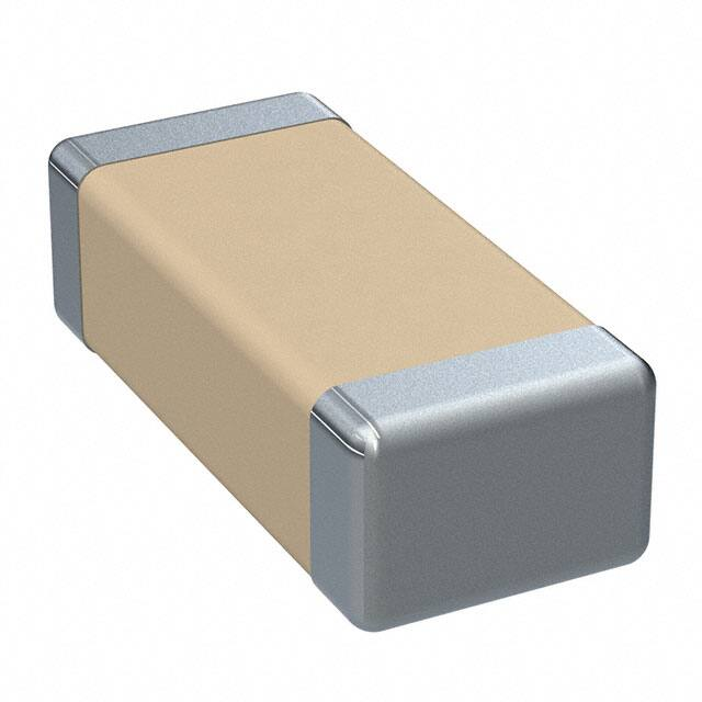

    贴片电容(MLCC) 1206 3.3µF ±5% 10V X7R
C1206C335J8RACTU 数据手册
Surface Mount Multilayer Ceramic Chip Capacitors (SMD MLCCs) X7R Dielectric, 6.3 – 250 VDC (Commercial Grade) Overview KEMET’s X7R dielectric features a 125°C maximum operating temperature and is considered temperature stable. The Electronics Components, Assemblies and Materials Association (EIA) characterizes X7R dielectric as a Class II material. Components of this classification are fixed, ceramic dielectric capacitors suited for bypass and decoupling applications or for frequency discriminating circuits where Q and stability of capacitance characteristics are not critical. X7R exhibits a predictable change in capacitance with respect to time and voltage, boasting a minimal change in capacitance with reference to ambient temperature. Capacitance change is limited to ±15% from −55°C to +125°C. Benefits • −55°C to +125°C operating temperature range • Lead (Pb)-free, RoHS, and REACH Compliant • Temperature stable dielectric • EIA 0402, 0603, 0805, 1206, 1210, 1808, 1812, 1825, 2220, and 2225 case sizes • DC voltage ratings of 6.3 V, 10 V, 16 V, 25 V, 35 V, 50 V, 100 V, 200 V, and 250 V • Capacitance offerings ranging from 10 pF to 47 μF • Available capacitance tolerances of ±5%, ±10%, and ±20% • Non-polar device, minimizing installation concerns • 100% pure matte tin-plated termination finish allowing for excellent solderability • SnPb termination finish option available upon request (5% Pb minimum) Applications Typical applications include decoupling, bypass, filtering and transient voltage suppression. Built Into Tomorrow © KEMET Electronics Corporation • KEMET Tower • One East Broward Boulevard Fort Lauderdale, FL 33301 USA • 954-766-2800 • www.kemet.com C1002_X7R_SMD • 8/17/2021 1 Surface Mount Multilayer Ceramic Chip Capacitors (SMD MLCCs) X7R Dielectric, 6.3 – 250 VDC (Commercial Grade) Ordering Information C 1206 Ceramic Case Size Specification/ (L" x W") Series1 0402 0603 0805 1206 1210 1805 1808 1812 1825 2220 2225 1 2 C C = Standard 106 M 4 R A Capacitance Code (pF) Capacitance Tolerance Rated Voltage (VDC) Dielectric Failure Rate/ Design J = ±5% K = ±10% M = ±20% 9 = 6.3 8 = 10 4 = 16 3 = 25 6 = 35 5 = 50 1 = 100 2 = 200 A = 250 R = X7R A = N/A Two significant digits and number of zeros. C TU Termination Packaging/ Finish2 Grade (C-Spec) C = 100% Matte Sn See “Packaging C-Spec Ordering Options Table” Flexible termination option is available. Please see FT-CAP product bulletin C1013_X7R_FT-CAP_SMD. Additional termination finish options may be available. Contact KEMET for details. Packaging C-Spec Ordering Options Table Packaging Type1 Bulk Bag/Unmarked 7" Reel/Unmarked 13" Reel/Unmarked 7" Reel/Marked 13" Reel/Marked 7" Reel/Unmarked/2 mm pitch2 13" Reel/Unmarked/2 mm pitch2 Packaging/Grade Ordering Code (C-Spec) Not required (Blank) TU 7411 (EIA 0603 and smaller case sizes) 7210 (EIA 0805 and larger case sizes) TM 7040 (EIA 0603) 7215 (EIA 0805 and larger case sizes) 7081 7082 Default packaging is "Bulk Bag." An ordering code C-Spec is not required for "Bulk Bag" packaging. The terms "Marked" and "Unmarked" pertain to laser marking option of capacitors. All packaging options labeled as "Unmarked" will contain capacitors that have not been laser marked. Please contact KEMET if you require a laser marked option. For more information see "Capacitor Marking." 2 The 2 mm pitch option allows for double the packaging quantity of capacitors on a given reel size. This option is limited to EIA 0603 (1608 metric) case size devices. For more information regarding 2 mm pitch option see "Tape & Reel Packaging Information." 1 1 © KEMET Electronics Corporation • KEMET Tower • One East Broward Boulevard Fort Lauderdale, FL 33301 USA • 954-766-2800 • www.kemet.com C1002_X7R_SMD • 8/17/2021 2 Surface Mount Multilayer Ceramic Chip Capacitors (SMD MLCCs) X7R Dielectric, 6.3 – 250 VDC (Commercial Grade) Dimensions – Millimeters (Inches) L W B T S 1 2 EIA Size Code Metric Size Code L Length W Width B Bandwidth S Mounting Separation Technique Minimum 0402 1005 1.00 (0.040) ±0.05 (0.002) 0.50 (0.020) ±0.05 (0.002) 0.30 (0.012) ±0.10 (0.004) 0.30 (0.012) 0603 1608 08051 2012 1206 3216 12102 3225 1805 4513 1808 4520 1812 4532 1825 4564 2220 5650 2225 5664 1.60 (0.063) ±0.15 (0.006) 2.00 (0.079) ±0.20 (0.008) 3.20 (0.126) ±0.20 (0.008) 3.20 (0.126) ±0.20 (0.008) 4.50 (0.177) ±0.50 (0.020) 4.70 (0.185) ±0.50 (0.020) 4.50 (0.177) ±0.30 (0.012) 4.50 (0.177) ±0.30 (0.012) 5.70 (0.224) ±0.40 (0.016) 5.60 (0.220) ±0.40 (0.016) 0.80 (0.032) ±0.15 (0.006) 1.25 (0.049) ±0.20 (0.008) 1.60 (0.063) ±0.20 (0.008) 2.50 (0.098) ±0.20 (0.008) 1.27 (0.050) ±0.38 (0.015) 2.00 (0.079) ±0.20 (0.008) 3.20 (0.126) ±0.30 (0.012) 6.40 (0.252) ±0.40 (0.016) 5.00 (0.197) ±0.40 (0.016) 6.40 (0.248) ±0.40 (0.016) 0.35 (0.014) ±0.15 (0.006) 0.50 (0.02) ±0.25 (0.010) 0.50 (0.02) ±0.25 (0.010) 0.50 (0.02) ±0.25 (0.010) 0.60 (0.024) ±0.35 (0.014) 0.60 (0.024) ±0.35 (0.014) 0.60 (0.024) ±0.35 (0.014) 0.60 (0.024) ±0.35 (0.014) 0.60 (0.024) ±0.35 (0.014) 0.60 (0.024) ±0.35 (0.014) 0.70 (0.028) T Thickness See Table 2 for Thickness 0.75 (0.030) N/A Solder reflow only Solder wave or Solder reflow Solder reflow only For capacitance values ≥ 2.2 µF add 0.10 (0.004) to the length tolerance dimension. For capacitance values ≥ 4.7 µF add 0.02 (0.001) to the width tolerance dimension and 0.10 (0.004) to the length tolerance dimension. © KEMET Electronics Corporation • KEMET Tower • One East Broward Boulevard Fort Lauderdale, FL 33301 USA • 954-766-2800 • www.kemet.com C1002_X7R_SMD • 8/17/2021 3 Surface Mount Multilayer Ceramic Chip Capacitors (SMD MLCCs) X7R Dielectric, 6.3 – 250 VDC (Commercial Grade) Qualification/Certification Commercial Grade products are subject to internal qualification. Details regarding test methods and conditions are referenced in Table 4, Performance & Reliability. Environmental Compliance Lead (Pb)-free, RoHS, and REACH compliant without exemptions. Lead-free Table 1A – Capacitance Range/Selection Waterfall (0402 – 1206 Case Sizes) 100 200 250 EB EB EB EB EB EB EB EB EB EB EB EB EB EB EB EB EB EB EB EB EB EB EB EB EB EB EB EB EB EB EB EB EB EB EB EB EB EB EB EB EB EB EB EB EB EB EB EB EB EB EB EB EB EB EB EB EB EB EB EB EB EB EB EB EB EB EB EB EB EB EB EB EB EB EB EB EB EB EB EB EB EB EB EB EB EB EB EB EB EB EB EB EB EB EB EB EB EB EB EB EB EB EB EB EB EB EB EB EB EB EB EB EB EB EB EB EB EB EB EB EB EB EB EB EB EB EB EB EB EB EB EB EB 100 250 5 EB EB EB EB EB EB EB EB EB EB EB EB EB EB EB EB EB EB EB EB EB EB EB 200 3 35 4 50 8 EB EB EB EB EB EB EB EB EB EB EB EB EB EB EB EB EB EB EB EB EB EB EB 35 9 DN DN DN DN DN DN DN DN DN DN DN DN DN DN DN DN DN DN DG EB EB EB EB EB EB EB EB EB EB EB EB EB EB EB EB EB EB EB EB EB EB EB 50 5 A 16 3 2 25 4 1 16 8 5 25 9 Case Size/ Series 6 10 Voltage Code 3 6.3 Rated Voltage (VDC) 4 10 CF CF CF CF CF CF CF CF CF CF CF CF CF CF CF CF CF CF 8 250 CF CF CF CF CF CF CF CF CF CF CF CF CF CF CF CF CF CF CF CF CF CF CF 9 6.3 CF CF CF CF CF CF CF CF CF CF CF CF CF CF CF CF CF CF CF CF CF CF CF A 250 CF CF CF CF CF CF CF CF CF CF CF CF CF CF CF CF CF CF CF CF CF CF CF 2 200 CF CF CF CF CF CF CF CF CF CF CF CF CF CF CF CF CF CF CF CF CF CF CF 1 200 250 CF CF CF CF CF CF CF CF CF CF CF CF CF CF CF CF CF CF CF CF CF CF CF 5 50 100 200 CF CF CF CF CF CF CF CF CF CF CF CF CF CF CF CF CF CF CF CF CF CF CF 6 100 25 50 BB BB BB BB BB BB BB BB BB BB BB BB BB BB BB BB BB BB BB BB BB BB 3 35 16 BB BB BB BB BB BB BB BB BB BB BB BB BB BB BB BB BB BB BB BB BB BB BB 4 16 10 BB BB BB BB BB BB BB BB BB BB BB BB BB BB BB BB BB BB BB BB BB BB BB 8 25 6.3 BB BB BB BB BB BB BB BB BB BB BB BB BB BB BB BB BB BB BB BB BB BB BB 2 A 9 8 4 3 6 5 1 2 A C0402C CF CF CF CF CF CF CF CF CF CF CF CF CF DN DM DN DN DN DN DN DN DN DN DN DN DN DN DN DN DN DN DN DN DN DN DN DN DM DN DN DN DN DN DN DN DN DN DN DN DN DN DN DN DN DN DN DN DN DN DN DM DN DN DN DN DN DN DN DN DN DN DN DN DN DN DN DN DN DN DN DN DN DN DM DN DN DN DN DN DN DN DN DN DN DN DN DN DN DN DN DN DN DN DN DN DN DM DN DN DN DN DN DN DN DN DN DN DN DN DN DN DN DN DN DN DN DN DN DN DM DN DN DN DN DN DN DN DN DN DN DN DN DN DN DN DN DN DN DN DN DN DN DN DN DN DN DN DN DN DN DN DN DN DN DN DN DN DN DN DN DN DN DN DP DN DN DN DN DN DN DN DN DN DN DN DN DN DN DN DN DN DN DN DN DN DN DE 100 250 6.3 10 16 25 35 50 100 Product Availability and Chip Thickness Codes – See Table 2 for Chip Thickness Dimensions 200 K K K K K K K K K K K K K K K K K K K K K K K 9 10 50 BB BB BB BB BB BB BB BB BB BB BB BB BB BB BB BB BB BB BB BB BB BB BB J J J J J J J J J J J J J J J J J J J J J J J C1206C 6.3 A 25 2 50 1 16 5 10 3 6.3 4 50 8 16 Cap Code 9 M M M M M M M M M M M M M M M M M M M M M M M Cap Tolerance Cap 5 25 3 16 4 25 8 10 100–200* 220 240–910* 101–151** 181–821** 102 122 152 182 222 272 332 392 472 562 682 822 103 123 153 183 223 273 9 C0805C 6.3 10–20 pF* 22 pF 24–91pF 100–150 pF** 180–820 pF** 1000pF 1200 pF 1500 pF 1800 pF 2200 pF 2700 pF 3300 pF 3900 pF 4700 pF 5600 pF 6800 pF 8200 pF 10000 pF 12000 pF 15000 pF 18000 pF 22000 pF 27000 pF Voltage Code Rated Voltage (VDC) C0603C 10 Cap Code C0402C 6.3 Cap Case Size/ Series 1 2 A 9 8 4 3 6 5 1 C0603C C0805C C1206C *Capacitance range Includes E24 decade values only. (i.e., 10, 11, 12, 13, 15, 16, 18, 20, 22, 24, 27, 30, 33, 36, 39, 43, 47, 51, 56, 62, 68, 75, 82, and 91). **Capacitance range Includes E12 decade values only. (i.e., 10, 12, 15, 18, 22, 27, 33, 39, 47, 56, 68, and 82). xx1 Available only in K and M tolerance. © KEMET Electronics Corporation • KEMET Tower • One East Broward Boulevard Fort Lauderdale, FL 33301 USA • 954-766-2800 • www.kemet.com C1002_X7R_SMD • 8/17/2021 4 Surface Mount Multilayer Ceramic Chip Capacitors (SMD MLCCs) X7R Dielectric, 6.3 – 250 VDC (Commercial Grade) Table 1A – Capacitance Range/Selection Waterfall (0402 – 1206 Case Sizes) cont. 35 50 100 200 250 6.3 10 3 6 5 1 2 A 250 16 25 4 EB EB EB EB EB EB EB EC EC EC EC EC EC EC EC EC ED ED ED EH EH EH EH EB EC EC EB EB EB EB EC EC EC EC EM EG EG EG EM EM EH EH EB EB ED ED ED ED EM EG EG EM EG EB EB ED ED ED ED EM EM EG EM EG 250 8 100 9 200 A 100 2 200 1 35 5 50 6 35 3 16 4 25 8 50 CF CF CF CF CF CF CJ CF CF CF CF CF CF CF CF BB¹ CF CF CF CF CF CF CJ CF CF CF CF CF CF CF CF CF CF CF CF CF CF CJ CF CF CF CF CF CF CF CF CF CF CF CF CF CF CJ CF CF CF CF CF CF CF CF CJ CF CF CF CF CJ CF CF DN DN DO DP DP DP DN DN DN DN DN DP DG DG DG DP DP DP DP DE DG DG DG CG¹ CG CG CG DN DN DO DP DP DP DN DN DN DN DN DP DG DG DG DP DP DP DP DE DG DG DG DN DN DO DP DP DP DN DN DN DN DN DP DG DG DG DP DP DP DP DE DG DG DG DN DN DO DP DP DP DN DN DN DN DN DP DG DG DG DG DG DG DG DN DN DO DP DP DP DN DP DP DG DG DP DP DE DE DH DH DN DN DO DP DP DP DN DP DP DG DG DP DP DE DE DH DH DP DP DE DE DE DE DE DG DG DG DG DE DE DG DG DG DG DG DG DG DG DG¹ DG¹ DG¹ DH DH DG DG DG DG C0402C C0603C 16 25 6 10 3 6 5 1 2 A 5 1 2 A 9 8 4 3 C0805C EB EB EB EB EB EB EB EC EC EC EC EC EC EC EC EC ED ED ED EH EH EH EH EH¹ EH¹ EH 6.3 4 EB EB EB EB EB EB EB EC EC EC EC EB EB EB EC ED EE EF EP EG EG EF EH¹ EH EH EH EH 250 8 EB EB EB EB EB EB EB EC EC EC EC EB EB EB EC ED EE EF EP ED ED ED EH¹ EN ED EF EH EH EH EH EH 200 9 EB EB EB EB EB EB EB EC EC EC EC EB EB EB EC ED EE EF EP ED ED ED EH EN ED EF EH EH EH EH EH 50 A EB EB EB EB EB EB EB EC EC EC EC EB EB EB EC ED EE EF EP ED ED ED EH EN ED EF EH EH EH EH EH 100 2 35 1 16 5 25 3 10 4 6.3 8 250 9 100 5 200 16 3 25 10 4 50 6.3 8 50 9 16 Voltage Code 25 DH DH Rated Voltage (VDC) Case Size/ Series 9 Product Availability and Chip Thickness Codes – See Table 2 for Chip Thickness Dimensions 10 Cap Code A 10 BB² 2 6.3 BB² 1 250 BB² 5 C1206C 100 BB¹ 3 C0805C 200 BB BB BB 4 25 BB BB BB BB BB BB BB 8 50 BB BB BB BB BB BB BB 6.3 Cap K K K K K K K K K K K K K K K K K K K K K K K K K K K K K K K 9 16 M BB M BB M BB M BB M BB M BB M BB M M M M BB² M M M M BB¹ M M M M M M M M M M M M M M M M Cap Tolerance J J J J J J J J J J J J J J J J J J J J J J J J J J J J J J J 5 10 3 6.3 4 C0603C 50 8 16 333 393 473 563 683 823 104 124 154 184 224 274 334 394 474 564 684 824 105 125 155 185 225 275 335 395 475 565 685 825 106 9 25 33000 pF 39000 pF 47000 pF 56000 pF 68000 pF 82000 pF 0.1 µF 0.12 µF 0.15 µF 0.18 µF 0.22 µF 0.27 µF 0.33 µF 0.39 µF 0.47 µF 0.56 µF 0.68 µF 0.82 µF 1 µF 1.2 µF 1.5 µF 1.8 µF 2.2 µF 2.7 µF 3.3 µF 3.9 µF 4.7 µF 5.6 µF 6.8 µF 8.2 µF 10 µF Voltage Code Rated Voltage (VDC) 10 Cap Code C0402C 6.3 Cap Case Size/ Series C1206C *Capacitance range Includes E24 decade values only. (i.e., 10, 11, 12, 13, 15, 16, 18, 20, 22, 24, 27, 30, 33, 36, 39, 43, 47, 51, 56, 62, 68, 75, 82, and 91). **Capacitance range Includes E12 decade values only. (i.e., 10, 12, 15, 18, 22, 27, 33, 39, 47, 56, 68, and 82). xx1 Available only in K and M tolerance. xx2 Available only in M tolerance. © KEMET Electronics Corporation • KEMET Tower • One East Broward Boulevard Fort Lauderdale, FL 33301 USA • 954-766-2800 • www.kemet.com C1002_X7R_SMD • 8/17/2021 5 Surface Mount Multilayer Ceramic Chip Capacitors (SMD MLCCs) X7R Dielectric, 6.3 – 250 VDC (Commercial Grade) Table 1B – Capacitance Range/Selection Waterfall (1210 – 1812 Case Sizes) 5 1 2 3 5 1 2 A 200 25 50 100 200 250 250 2 100 200 1 50 100 5 200 A C1812C2 100 2 5 1 Case Size/Series C1210C 2 A 5 1 C1805C 2 5 1 C1808C GB GB GB GB GB GB GB GB GB GB GB GB GB GB GB GB GB GB GB GB GB GB GB GB GB GB GB GB GB GB GB GB GB GB GB GB GB GB GB GB GB GB GB GB GB GB GB GB GB GB GB GB GB GB GB GB GB GB GB GB GB GB GB GB GB GB GB GB GB GB GB GB GB GB GB GB GB GB GB GB GB GB GB GB GB GB GB GB GB GB GD GH GB GB GB GB GB GB GB GB GB GB GB GB GB GB GB GB GB GB GB GB GB GB GB GB 250 3 NA NA NA NA NA LF LF LF LF LF LF LF LF LF LF LF LF 200 4 LF LF LF LF LF LF LF LF LF LF LF LF LF LF LD LD LD LD LD LD LD LD LD LD LD LD LD LD 100 8 LF LF LF LF LF LF LF LF LF LF LF LF LF LF LD LD LD LD LD LD LD LD LD LD LD LD LD LD 50 100 9 NC NC NC NC NC NC NC NC NC 25 50 Voltage Code NC NC NC NC NC NC NC NC NC NC NC NC NC NA NA NA NA NA NA NA NA NA NA NA NA NA 200 Rated Voltage (VDC) FB FB FB FB FB FB FB FB FB FB FB FB FB FB FB FB FC FC NC NC NC NC NC NC NC NC NC NC NC NC NC NA NA NA NA NA NA NA NA NA NA NA NA NA NA NA NA NA 100 FB FB FB FB FB FB FB FB FB FB FB FB FB FB FB FE FE FB FB FB FB FB FB FB FB FB FB FB FB FB FB FB FB FC FC 50 FB FB FB FB FB FB FB FB FB FB FB FB FB FB FB FB FB FB FB FB FB FB FB FB FB FB FB FB FB FB FB FB FB FB FB 200 FB FB FB FB FB FB FB FB FB FB FB FB FB FB FB FB FB FB FB FB FB FB FB FB FB FB FB FB FB FB FB FB FB FB FB 100 FB FB FB FB FB FB FB FB FB FB FB FB FB FB FB FB FB FB FB FB FB FB FB FB FB FB FB FB FB FB FB FB FB FB FB 50 FB FB FB FB FB FB FB FB FB FB FB FB FB FB FB FB FB FB FB FB FB FB FB FB FB FB FB FB FB FB FB FB FB FB FB 250 FB FB FB FB FB FB FB FB FB FB FB FB FB FB FB FB FB FB FB FB FB FB FB FB FB FB FB FB FB FB FB FB FB FB FB 25 M M M M M M M M M M M M M M M M M M M M M M M M M M M M M M M M M M M 200 FB FB FB FB FB FB FB FB FB FB FB FB FB FB FB FB FB FB FB FB FB FB FB FB FB FB FB FB FB FB FB FB FB FB FB 16 K K K K K K K K K K K K K K K K K K K K K K K K K K K K K K K K K K K 1 10 Cap Code J J J J J J J J J J J J J J J J J J J J J J J J J J J J J J J J J J J 5 6.3 Cap 100 - 200* 220 240 - 910* 101 - 151** 181 - 821** 221 271 331 391 471 561 681 821 102 122 152 182 222 272 332 392 472 562 682 822 103 123 153 183 223 273 333 393 473 563 3 C1808C Product Availability and Chip Thickness Codes – See Table 2 for Chip Thickness Dimensions Cap Tolerance 10 - 20 pF* 22 pF 24 - 91pF 100 - 150 pF** 180 - 820 pF** 220 pF 270 pF 330 pF 390 pF 470 pF 560 pF 680 pF 820 pF 1000pF 1200 pF 1500 pF 1800 pF 2200 pF 2700 pF 3300 pF 3900 pF 4700 pF 5600 pF 6800 pF 8200 pF 10000 pF 12000 pF 15000 pF 18000 pF 22000 pF 27000 pF 33000 pF 39000 pF 47000 pF 56000 pF 4 50 Rated Voltage (VDC) 8 25 9 16 Voltage Code C1805C 10 Cap Code 6.3 Cap C1210C 50 Case Size/ Series 2 3 5 1 2 A LD LD LD LD LD LD LD LD C1812C 2 *Capacitance range Includes E24 decade values only. (i.e., 10, 11, 12, 13, 15, 16, 18, 20, 22, 24, 27, 30, 33, 36, 39, 43, 47, 51, 56, 62, 68, 75, 82, and 91). **Capacitance range Includes E12 decade values only. (i.e., 10, 12, 15, 18, 22, 27, 33, 39, 47, 56, 68, and 82). xx1 Available only in K and M tolerance. 2 Available capacitance values available in X7R with KONNEKT Technology. © KEMET Electronics Corporation • KEMET Tower • One East Broward Boulevard Fort Lauderdale, FL 33301 USA • 954-766-2800 • www.kemet.com C1002_X7R_SMD • 8/17/2021 6 Surface Mount Multilayer Ceramic Chip Capacitors (SMD MLCCs) X7R Dielectric, 6.3 – 250 VDC (Commercial Grade) Table 1B – Capacitance Range/Selection Waterfall (1210 – 1812 Case Sizes) cont. 5 1 2 5 1 2 3 5 100 200 250 50 100 200 50 100 200 25 50 1 2 A 250 A 200 2 FS¹ Rated Voltage (VDC) 50 100 200 250 50 100 200 50 100 200 FB FC FD FD FD FD FD FD FD FD FD FF FG FL FM FH FM FJ FT¹ FC FF FG FH FM FK FK FP FM FK FS FC FF FG FH FM FK FK FP FM FK FS NA NA NA LD LD LD LD LD LD GB GB GB GB GB GB GB GB GB GB GB GC GC GE GE GB GC GE GO GJ GL GK GK Voltage Code 9 8 4 3 5 1 2 A 5 1 2 5 1 2 FS¹ GB GB GB GB GB GB GB GB GB GB GB GC GC GE GE GB GC GE GO GJ GL GK GK GB GB GB GB GB GB GB GG GG GG GG GG GG GG GG GB GC GE GO¹ GJ GL GB GB GB GB GE GG GG GG GG GG GJ GB GB GB GB GE GG GG GG GG GG GJ 250 FS¹ Case Size/Series FB FB FB FB FC FC FC FC FD FD FD FD FD FF FH FG FG FG FG FH FM FK FS 200 FB FB FB FB FC FC FC FC FD FD FD FD FD FF FH FH FH FH FJ FG FM FG FG FH FM FK FS¹ 100 FB FB FB FB FC FC FC FC FD FD FD FD FD FF FH FH FH FH FJ FE FF FG FC FF FG FH FT¹ 50 FB FB FB FB FC FC FC FC FD FD FD FD FD FF FH FH FH FH FJ FE FF FG FC FF FG FH FT¹ FM FS FS¹ 25 M M M M M M M M M M M M M M M M M M M M M M M M M M M M M M 25 FB FB FB FB FC FC FC FC FD FD FD FD FD FF FH FH FH FH FJ FE FF FG FC FF FG FH FT¹ FM FS FS¹ 16 K K K K K K K K K K K K K K K K K K K K K K K K K K K K K K C1812C2 1 10 Cap Code J J J J J J J J J J J J J J J J J J J J J J J J J J J J J J 5 C1808C 6.3 Cap 683 823 104 124 154 184 224 274 334 394 474 564 684 824 105 125 155 185 225 275 335 395 475 565 685 825 106 156 226 476 3 C1805C Product Availability and Chip Thickness Codes – See Table 2 for Chip Thickness Dimensions Cap Tolerance 68000 pF 82000 pF 0.1 µF 0.12 µF 0.15 µF 0.18 µF 0.22 µF 0.27 µF 0.33 µF 0.39 µF 0.47 µF 0.56 µF 0.68 µF 0.82 µF 1 µF 1.2 µF 1.5 µF 1.8 µF 2.2 µF 2.7 µF 3.3 µF 3.9 µF 4.7 µF 5.6 µF 6.8 µF 8.2 µF 10 µF 15 µF 22 µF 47 µF 4 50 Rated Voltage (VDC) 8 25 9 16 Voltage Code 10 Cap Code 6.3 Cap C1210C 100 Case Size/ Series 3 5 1 2 A GK C1210C C1805C C1808C C1812C 2 *Capacitance range Includes E24 decade values only. (i.e., 10, 11, 12, 13, 15, 16, 18, 20, 22, 24, 27, 30, 33, 36, 39, 43, 47, 51, 56, 62, 68, 75, 82, and 91). **Capacitance range Includes E12 decade values only. (i.e., 10, 12, 15, 18, 22, 27, 33, 39, 47, 56, 68, and 82). xx1 Available only in K and M tolerance. 2 Available capacitance values available in X7R with KONNEKT Technology. © KEMET Electronics Corporation • KEMET Tower • One East Broward Boulevard Fort Lauderdale, FL 33301 USA • 954-766-2800 • www.kemet.com C1002_X7R_SMD • 8/17/2021 7 Surface Mount Multilayer Ceramic Chip Capacitors (SMD MLCCs) X7R Dielectric, 6.3 – 250 VDC (Commercial Grade) Table 1C – Capacitance Range/Selection Waterfall (1825 – 2225 Case Sizes) 5 1 2 A 5 1 2 A 50 100 200 250 50 100 200 250 C1825C JC JC JC JC JC JC JC JC JC JC JD JD JF JF 250 2 KC KC KC KC KC KC KC KC KD KD KD KE KE KE JC JC JC JC JC JC JC JC JC JC JD JD JF JF 200 1 KC KC KC KC KC KC KC KC KD KD KD KE KE KE JE JE JE JE JE JE JE JE JB JB JB JB JB JC JC JC JC JC JC JC JC JC JC JC JD JF JF 100 5 KC KC KC KC KC KC KC KC KC KC KC KC KD KE JE JE JE JE JE JE JE JE JB JB JB JB JB JC JC JC JC JC JC JC JC JC JC JC JC JC JC JC JC JD JF JF JO JO 50 Voltage Code KC KC KC KC KC KB KB KB KB KB KB KB KB KB KC KD KD JE JE JE JE JE JE JE JE JB JB JB JB JB JC JC JC JC JC JC JC JC JC JC JC JC JC JC JC JC JD JF JF JF JO JO 250 Rated Voltage (VDC) KE KE KE KE KE KE KE 200 HB HB HB HB HB HB HB HB HB HB HB HB HB HB HB HD HD HD HD HF HF KE KE KE KE KE KE KE KE KE KE 100 HB HB HB HB HB HB HB HB HB HB HB HB HB HB HB HD HD HD HD HF HF KE KE KE KE KE KE KE KE KE KE KE 50 HB HB HB HB HB HE HE 25 HB HB HB HB HB HB HB HB HE HB HB HB HB HB HB HB HB HB HB HB HB HB HB HB HB HB HD HD HF HF Case Size/Series M M M M M M M M M M M M M M M M M M M M M M M M M M M M M M M M M M M M M M 250 HB HB HB HB HB HB HB HB HB HB HB HB HB HB HB HB HB HB HB HB HB HB HB HB HB HB HB HB HB HB HB HC HD HF 200 K K K K K K K K K K K K K K K K K K K K K K K K K K K K K K K K K K K K K K 3 100 Cap Cap Code J J J J J J J J J J J J J J J J J J J J J J J J J J J J J J J J J J J J J J A 50 392 472 562 682 822 103 123 153 183 223 273 333 393 473 563 683 823 104 124 154 184 224 274 334 394 474 564 684 824 105 125 155 185 225 475 106 156 226 2 Product Availability and Chip Thickness Codes – See Table 2 for Chip Thickness Dimensions Cap Tolerance 3900 pF 4700 pF 5600 pF 6800 pF 8200 pF 10000 pF 12000 pF 15000 pF 18000 pF 22000 pF 27000 pF 33000 pF 39000 pF 47000 pF 56000 pF 68000 pF 82000 pF 0.1 µF 0.12 µF 0.15 µF 0.18 µF 0.22 µF 0.27 µF 0.33 µF 0.39 µF 0.47 µF 0.56 µF 0.68 µF 0.82 µF 1.0 µF 1.2 µF 1.5 µF 1.8 µF 2.2 µF 4.7 µF 10 µF 15 µF 22 µF 1 25 Rated Voltage (VDC) 5 250 Voltage Code C2225C 200 Cap Code C2220C 100 Cap C1825C 50 Case Size/Series A 3 5 1 2 A 5 1 2 A C2220C C2225C *Capacitance range Includes E24 decade values only. (i.e., 10, 11, 12, 13, 15, 16, 18, 20, 22, 24, 27, 30, 33, 36, 39, 43, 47, 51, 56, 62, 68, 75, 82, and 91). **Capacitance range Includes E12 decade values only. (i.e., 10, 12, 15, 18, 22, 27, 33, 39, 47, 56, 68, and 82). xx1 Available only in K and M tolerance. 2 Available capacitance values available in X7R with KONNEKT Technology. © KEMET Electronics Corporation • KEMET Tower • One East Broward Boulevard Fort Lauderdale, FL 33301 USA • 954-766-2800 • www.kemet.com C1002_X7R_SMD • 8/17/2021 8 Surface Mount Multilayer Ceramic Chip Capacitors (SMD MLCCs) X7R Dielectric, 6.3 – 250 VDC (Commercial Grade) Table 2A – Chip Thickness/Tape & Reel Packaging Quantities Paper Quantity1 Plastic Quantity Thickness Code Case Size1 Thickness ± Range (mm) 7" Reel 13" Reel 7" Reel 13" Reel BB CF CG CD CJ DM DN DO DP DE DG DH EB EC EN ED EE EF EP EM EG EH FB FC FD FE FF FG FL FH FP FM FJ FT FK FS NA NC LD LF GB GC GD GE GH GG GK GJ GL GO 0402 0603 0603 0603 0603 0805 0805 0805 0805 0805 0805 0805 1206 1206 1206 1206 1206 1206 1206 1206 1206 1206 1210 1210 1210 1210 1210 1210 1210 1210 1210 1210 1210 1210 1210 1210 1706 1706 1808 1808 1812 1812 1812 1812 1812 1812 1812 1812 1812 1812 0.50 ± 0.05 0.80 ± 0.07* 0.80 ± 0.10* 0.80 ± 0.15 0.80 ± 0.15* 0.70 ± 0.20* 0.78 ± 0.10* 0.80 ± 0.10* 0.90 ± 0.10* 1.00 ± 0.10 1.25 ± 0.15 1.25 ± 0.20 0.78 ± 0.10 0.90 ± 0.10 0.95 ± 0.10 1.00 ± 0.10 1.10 ± 0.10 1.20 ± 0.15 1.20 ± 0.20 1.25 ± 0.15 1.60 ± 0.15 1.60 ± 0.20 0.78 ± 0.10 0.90 ± 0.10 0.95 ± 0.10 1.00 ± 0.10 1.10 ± 0.10 1.25 ± 0.15 1.40 ± 0.15 1.55 ± 0.15 1.60 ± 0.20 1.70 ± 0.20 1.85 ± 0.20 1.90 ± 0.20 2.10 ± 0.20 2.50 ± 0.30 0.90 ± 0.10 1.00 ± 0.15 0.90 ± 0.10 1.00 ± 0.15 1.00 ± 0.10 1.10 ± 0.10 1.25 ± 0.15 1.30 ± 0.10 1.40 ± 0.15 1.55 ± 0.10 1.60 ± 0.20 1.70 ± 0.15 1.90 ± 0.20 2.50 ± 0.20 10,000 4,000 4,000 4,000 4,000 4,000 4,000 4,000 4,000 0 0 0 0 0 0 0 0 0 0 0 0 0 0 0 0 0 0 0 0 0 0 0 0 0 0 0 0 0 0 0 0 0 0 0 0 0 0 0 0 0 50,000 15,000 15,000 10,000 15,000 15,000 15,000 15,000 15,000 0 0 0 0 0 0 0 0 0 0 0 0 0 0 0 0 0 0 0 0 0 0 0 0 0 0 0 0 0 0 0 0 0 0 0 0 0 0 0 0 0 0 0 0 0 0 0 0 0 0 2,500 2,500 2,500 4,000 4,000 4,000 2,500 2,500 2,500 2,500 2,500 2,000 2,000 4,000 4,000 4,000 2,500 2,500 2,500 2,000 2,000 2,000 2,000 2,000 2,000 2,000 1,000 4,000 4,000 2,500 2,500 1,000 1,000 1,000 1,000 1,000 1,000 1,000 1,000 500 500 0 0 0 0 0 0 0 0 0 10,000 10,000 10,000 10,000 10,000 10,000 10,000 10,000 10,000 10,000 10,000 8,000 8,000 10,000 10,000 10,000 10,000 10,000 10,000 8,000 8,000 8,000 8,000 8,000 8,000 8,000 4,000 10,000 10,000 10,000 10,000 4,000 4,000 4,000 4,000 4,000 4,000 4,000 4,000 2,000 2,000 Thickness Code Case Size1 Thickness ± Range (mm) 7" Reel 13" Reel 7" Reel 13" Reel Paper Quantity1 Plastic Quantity Package quantity based on finished chip thickness specifications. 1 If ordering using the 2 mm Tape and Reel pitch option, the packaging quantity outlined in the table above will be doubled. This option is limited to EIA 0603 (1608 metric) case size devices. For more information regarding 2 mm pitch option see "Tape & Reel Packaging Information." © KEMET Electronics Corporation • KEMET Tower • One East Broward Boulevard Fort Lauderdale, FL 33301 USA • 954-766-2800 • www.kemet.com C1002_X7R_SMD • 8/17/2021 9 Surface Mount Multilayer Ceramic Chip Capacitors (SMD MLCCs) X7R Dielectric, 6.3 – 250 VDC (Commercial Grade) Table 2A – Chip Thickness/Tape & Reel Packaging Quantities cont. Plastic Quantity Paper Quantity1 Thickness Code Case Size1 Thickness ± Range (mm) 7" Reel 13" Reel 7" Reel 13" Reel HB HC HD HE HF JB JC JD JE JF JO KB KC KD KE 1825 1825 1825 1825 1825 2220 2220 2220 2220 2220 2220 2225 2225 2225 2225 1.10 ± 0.15 1.15 ± 0.15 1.30 ± 0.15 1.40 ± 0.15 1.50 ± 0.15 1.00 ± 0.15 1.10 ± 0.15 1.30 ± 0.15 1.40 ± 0.15 1.50 ± 0.15 2.40 ± 0.15 1.00 ± 0.15 1.10 ± 0.15 1.30 ± 0.15 1.40 ± 0.15 0 0 0 0 0 0 0 0 0 0 0 0 0 0 0 0 0 0 0 0 0 0 0 0 0 0 0 0 0 0 1,000 1,000 1,000 1,000 1,000 1,000 1,000 1,000 1,000 1,000 500 1,000 1,000 1,000 1,000 4,000 4,000 4,000 4,000 4,000 4,000 4,000 4,000 4,000 4,000 2,000 4,000 4,000 4,000 4,000 Thickness Code Case Size1 Thickness ± Range (mm) 7" Reel 13" Reel 7" Reel 13" Reel Paper Quantity1 Plastic Quantity Package quantity based on finished chip thickness specifications. 1 If ordering using the 2 mm Tape and Reel pitch option, the packaging quantity outlined in the table above will be doubled. This option is limited to EIA 0603 (1608 metric) case size devices. For more information regarding 2 mm pitch option see "Tape & Reel Packaging Information." Table 2B – Bulk Packaging Quantities Loose Packaging Packaging Type Bulk Bag (default) Packaging C-Spec1 N/A 2 Case Size Packaging Quantities (pieces/unit packaging) EIA (in) Metric (mm) 0402 0603 0805 1206 1210 1808 1812 1825 2220 2225 1005 1608 2012 3216 3225 4520 4532 4564 5650 5664 Minimum Maximum 50,000 1 20,000 The "Packaging C-Spec" is a 4 to 8 digit code which identifies the packaging type and/or product grade. When ordering, the proper code must be included in the 15th through 22nd character positions of the ordering code. See "Ordering Information" section of this document for further details. Commercial grade product ordered without a packaging C-Spec will default to our standard "Bulk Bag" packaging. Contact KEMET if you require a bulk bag packaging option for automotive grade products. 2 A packaging C-Spec (see note 1 above) is not required for "Bulk Bag" packaging (excluding anti-static Bulk Bag and automotive grade products). The 15th through 22nd character positions of the ordering code should be left blank. All product ordered without a packaging C-Spec will default to our standard "Bulk Bag" packaging. 1 © KEMET Electronics Corporation • KEMET Tower • One East Broward Boulevard Fort Lauderdale, FL 33301 USA • 954-766-2800 • www.kemet.com C1002_X7R_SMD • 8/17/2021 10 Surface Mount Multilayer Ceramic Chip Capacitors (SMD MLCCs) X7R Dielectric, 6.3 – 250 VDC (Commercial Grade) Table 3 – Chip Capacitor Land Pattern Design Recommendations per IPC–7351 EIA Size Code Metric Size Code Density Level A: Maximum (Most) Land Protrusion (mm) Density Level B: Median (Nominal) Land Protrusion (mm) Density Level C: Minimum (Least) Land Protrusion (mm) C Y X V1 V2 C Y X V1 V2 C Y X V1 V2 0402 1005 0.50 0.72 0.72 2.20 1.20 0.45 0.62 0.62 1.90 1.00 0.40 0.52 0.52 1.60 0.80 0603 1608 0.90 1.15 1.10 4.00 2.10 0.80 0.95 1.00 3.10 1.50 0.60 0.75 0.90 2.40 1.20 0805 2012 1.00 1.35 1.55 4.40 2.60 0.90 1.15 1.45 3.50 2.00 0.75 0.95 1.35 2.80 1.70 1206 3216 1.60 1.35 1.90 5.60 2.90 1.50 1.15 1.80 4.70 2.30 1.40 0.95 1.70 4.00 2.00 1210 3225 1.60 1.35 2.80 5.65 3.80 1.50 1.15 2.70 4.70 3.20 1.40 0.95 2.60 4.00 2.90 12101 3225 1.50 1.60 2.90 5.60 3.90 1.40 1.40 2.80 4.70 3.30 1.30 1.20 2.70 4.00 3.00 1808 4520 2.30 1.75 2.30 7.40 3.30 2.20 1.55 2.20 6.50 2.70 2.10 1.35 2.10 5.80 2.40 1812 4532 2.15 1.60 3.60 6.90 4.60 2.05 1.40 3.50 6.00 4.00 1.95 1.20 3.40 5.30 3.70 1825 4564 2.15 1.60 6.90 6.90 7.90 2.05 1.40 6.80 6.00 7.30 1.95 1.20 6.70 5.30 7.00 2220 5650 2.75 1.70 5.50 8.20 6.50 2.65 1.50 5.40 7.30 5.90 2.55 1.30 5.30 6.60 5.60 2225 5664 2.70 1.70 6.90 8.10 7.90 2.60 1.50 6.80 7.20 7.30 2.50 1.30 6.70 6.50 7.00 Only for capacitance values ≥ 22 µF Density Level A: For low-density product applications. Recommended for wave solder applications and provides a wider process window for reflow solder processes. KEMET only recommends wave soldering of EIA 0603, 0805, and 1206 case sizes. Density Level B: For products with a moderate level of component density. Provides a robust solder attachment condition for reflow solder processes. Density Level C: For high component density product applications. Before adapting the minimum land pattern variations the user should perform qualification testing based on the conditions outlined in IPC Standard 7351 (IPC–7351). 1 Image below based on Density Level B for an EIA 1210 case size. V1 Y Y X X C C V2 Grid Placement Courtyard © KEMET Electronics Corporation • KEMET Tower • One East Broward Boulevard Fort Lauderdale, FL 33301 USA • 954-766-2800 • www.kemet.com C1002_X7R_SMD • 8/17/2021 11 Surface Mount Multilayer Ceramic Chip Capacitors (SMD MLCCs) X7R Dielectric, 6.3 – 250 VDC (Commercial Grade) Soldering Process Recommended Soldering Technique: • Solder wave or solder reflow for EIA case sizes 0603, 0805 and 1206 • All other EIA case sizes are limited to solder reflow only Recommended Reflow Soldering Profile: KEMET’s families of surface mount multilayer ceramic capacitors (SMD MLCCs) are compatible with wave (single or dual), convection, IR or vapor phase reflow techniques. Preheating of these components is recommended to avoid extreme thermal stress. KEMET’s recommended profile conditions for convection and IR reflow reflect the profile conditions of the IPC/ J-STD-020 standard for moisture sensitivity testing. These devices can safely withstand a maximum of three reflow passes at these conditions. Termination Finish SnPb TP 100% Matte Sn Preheat/Soak Temperature Minimum (TSmin) Temperature Maximum (TSmax) Time (tS) from TSmin to TSmax 100°C 150°C 60 – 120 seconds 150°C 200°C 60 – 120 seconds Ramp-Up Rate (TL to TP) 3°C/second maximum 3°C/second maximum Liquidous Temperature (TL) 183°C 217°C Time Above Liquidous (tL) 60 – 150 seconds 60 – 150 seconds Peak Temperature (TP) 235°C 260°C Time Within 5°C of Maximum Peak Temperature (tP) 20 seconds maximum 30 seconds maximum Ramp-Down Rate (TP to TL) 6°C/second maximum 6°C/second maximum Time 25°C to Peak Temperature 6 minutes maximum 8 minutes maximum TL Temperature Profile Feature tP Maximum Ramp-up Rate = 3°C/second Maximum Ramp-down Rate = 6°C/second tL Tsmax Tsmin 25 ts 25°C to Peak Time Note 1: All temperatures refer to the center of the package, measured on the capacitor body surface that is facing up during assembly reflow. © KEMET Electronics Corporation • KEMET Tower • One East Broward Boulevard Fort Lauderdale, FL 33301 USA • 954-766-2800 • www.kemet.com C1002_X7R_SMD • 8/17/2021 12 Surface Mount Multilayer Ceramic Chip Capacitors (SMD MLCCs) X7R Dielectric, 6.3 – 250 VDC (Commercial Grade) X7R Performance and Reliability: SMD Test Methods and Conditions Test Reference Test Condition Limits Visual and Mechanical KEMET Internal No defects that may affect performance (10X) Dimensions according KEMET Spec Sheet Capacitance (Cap) KEMET Internal C ≤ 10 µF 1 kHz ±50 Hz and 1.0 ±0.2 Vrms or 0.5 ±0.2 Vrms* C > 10 µF 120 Hz ±10 Hz and 0.5 ±0.1 Vrms * See part number specifi cation sheet for voltage Capacitance measurements (including tolerance) are indexed to a referee time of 48 or 1,000 hours Please refer to a part number specifi cation sheet for referee time details Within Tolerance Within Specifi cation EIA Case Size Rated DC Voltage < 16 0402 16 25 > 25 Capacitance < 0.1 µF 5.0 ≥ 0.1 µF 10.0 < 0.1 µF 3.5 ≥ 0.1 µF 10.0 < 0.1 µF 3.5 ≥ 0.1 µF 10.0 All 2.5 < 16 16 / 25 0603 1 16 / 25 C ≤ 10 µF Frequency: 1 kHz ±50 Hz Voltage*: 1.0 ±0.2 Vrms,0.5 ±0.2 Vrms Dissipation Factor (DF) KEMET Internal < 16 16 / 25 0805 C > 10 µF Frequency: 120 Hz ±10 Hz Voltage: 0.5 ±0.1 Vrms > 25 < 16 16 / 25 > 25 * See part number specifi cation sheet for voltage < 16 16 / 25 12062 5.0 < 1.0 µF > 25 < 16 > 25 < 16 16 / 25 16 / 25 ≥ 1.0 µF < 2.2 µF < 1.0 µF ≥ 2.2 µF < 16 < 10 µF 16 / 25 > 25 1 2 3 © KEMET Electronics Corporation • KEMET Tower • One East Broward Boulevard Fort Lauderdale, FL 33301 USA • 954-766-2800 • www.kemet.com 5.0 3.5 2.5 10.0 5.0 3.5 All 2.5 ≥ 10 µF 10.0 5.0 < 22 µF 3.5 2.5 ≥ 22 µF < 16 1808 – 2225 10.0 ≥ 1.0 µF > 25 16 / 25 3.5 2.5 < 16 1210 3 Dissipation Factor (Maximum %) 10.0 5.0 All 3.5 2.5 For Capacitance values 0.22 µF (16 and 25 V) DF is 5%. For Capacitance value 2.2 µF (25 V) and ≥ 2.2 µF (35 and 50 V) DF is 10%. For Capacitance value 10 µF (25 V) DF is 10% and for Capacitance value 4.7µF (50 V) DF is 5%.. C1002_X7R_SMD • 8/17/2021 13 Surface Mount Multilayer Ceramic Chip Capacitors (SMD MLCCs) X7R Dielectric, 6.3 – 250 VDC (Commercial Grade) X7R Performance and Reliability: SMD Test Methods and Conditions cont. Test Reference Test Condition Limits Within Specifi cation To obtain IR limit, divide MΩ - µF value by the capacitance and compare to GΩ limit. Select the lower of the two limits. Insulation Resistance (IR) Limits Table EIA Case Size Rated DC Voltage 1,000 megohm microfarads or 100 GΩ 500 megohm microfarads or 10 GΩ 100 megohm microfarads or 10 GΩ 0402 ALL < 0.012 µF ≥ 0.012 µF < 0.47 µf ≥ 0.47 µf ≤ 200 V < 0.047 µF ≥ 0.047 µf < 0.47 µf ≥ 0.47 µf 250 V N/A N/A ALL ≤ 200 V < 0.15 µF ≥ 0.15 µF < 2.2 µf ≥ 2.2 µf 250 V < .027 µF N/A ≥ .027 µF ≤ 200 V < 0.47 µF ≥ 0.47 µF < 2.2 µf ≥ 2.2 µf 250 V < 0.12 µF N/A ≥ 0.12 µF ≤ 200 V < 0.39 µF ≥ 0.39 µF < 10 µf ≥ 10 µf 250 V < 0.27 µF N/A ≥ 0.27 µF 1808 ALL ALL N/A N/A 1812 ALL < 2.2 µF ≥ 2.2 µF N/A 1825 ALL ALL N/A N/A 2220 ALL < 10 µF ≥ 10 µF N/A 2225 ALL ALL N/A N/A 0603 Insulation Resistance (IR) KEMET Internal Apply rated voltage for 120 seconds at 25°C 08051 1206 12102 1 2 For Capacitance value 1.0 µF (50 V) IR should be calculated under 100 megohm microfarads or 10 GΩ. For Capacitance value 4.7 µF (50 V) IR should be calculated under 100 megohm microfarads or 10 GΩ. © KEMET Electronics Corporation • KEMET Tower • One East Broward Boulevard Fort Lauderdale, FL 33301 USA • 954-766-2800 • www.kemet.com C1002_X7R_SMD • 8/17/2021 14 Surface Mount Multilayer Ceramic Chip Capacitors (SMD MLCCs) X7R Dielectric, 6.3 – 250 VDC (Commercial Grade) X7R Performance and Reliability: SMD Test Methods and Conditions cont. Test Temperature Coeffi cient of Capacitance (TCC) Reference Test Condition Limits C ≤ 10µF Frequency: 1 kHz ±50 Hz Voltage*: 1.0 ±0.2 Vrms, 0.5 ±0.2 Vrms, 0.2 ±0.1 Vrms C > 10µF Frequency: 120 Hz ±10 Hz Voltage: 0.5 ±0.1 Vrms KEMET Internal * See part number specifi cation sheet for voltage Step Temperature (°C) 1 +25°C 2 −55°C 3 +25°C (Reference) 4 +125°C Dielectric Withstanding Voltage (DWV) KEMET Internal 250% of rated voltage (5 ±1 seconds and charge/discharge not exceeding 50 mA) Aging Rate (Maximum % Capacitance Loss/Decade Hour) KEMET Internal Capacitance measurements (including tolerance) are indexed to a referee time of 48 or 1,000 hours. Please refer to a part number specifi c datasheet for referee time details. Capacitance ±15% over −55°C to +125°C Cap: Initial Limit DF: Initial Limit IR: Initial Limit Withstand test voltage without insulation breakdown or damage. Please refer to a part number specifi cation sheet for specifi c Aging rate Shear stress test per specifi c case size, Time: 60±1 seconds Terminal Strength Board Flex KEMET Internal AEC-Q200-005 Case Size Force 0201 2N 0402 3N 0603 5N 0805 9N ≥1206 18N Standard Termination system 2.0 mm Flexible Termination System 3.0 mm Test time: 60± 5 seconds Ramp time: 1 mm/second © KEMET Electronics Corporation • KEMET Tower • One East Broward Boulevard Fort Lauderdale, FL 33301 USA • 954-766-2800 • www.kemet.com No evidence of mechanical damage No evidence of mechanical damage C1002_X7R_SMD • 8/17/2021 15 Surface Mount Multilayer Ceramic Chip Capacitors (SMD MLCCs) X7R Dielectric, 6.3 – 250 VDC (Commercial Grade) X7R Performance and Reliability: SMD Test Methods and Conditions cont. Test Reference Test Condition Limits Solderability J-STD-002 Condition: 4 hours ± 15 minutes at 155°C dry bake apply all methods Test 245 ±5°C (SnPb and Pb-Free) Visual Inspection. 95% coverage on termination. No leaching JESD22 Method JA-104 1,000 cycles (−55°C to +125°C) 2 – 3 cycles per hour Soak Time 1 or 5 minutes Measurement at 24 hours ±4 hours after test conclusion. Cap: Initial Limit DF: Initial Limit IR: Initial Limit Temperature Cycling Measurement at 24 hours ±4 hours after test conclusion. Within Post Environmental Limits Cap: ±20% shift IR: 10% of Initial Limit Biased Humidity MIL-STD-202 Method 103 Load Humidity: 1,000 hours 85°C/85% RH and rated voltage. Low Volt Humidity: 1,000 hours 85C°/85% RH and 1.5 V. DF Limits Maximum (%) Initial Post 2.5 3.0 3.5 5.0 5.0 7.5 10.0 20.0 Measurement at 24 hours ±4 hours after test conclusion. Within Post Environmental Limits Cap: ±20% shift IR: 10% of Initial Limit Moisture Resistance Thermal Shock MIL-STD-202 Method 106 MIL-STD-202 Method 107 Number of cycles required 10, 24 hours per cycle. Steps 7a and 7b not required. Number of cycles required 5, (−55°C to 125°C) Dwell time 15 minutes. © KEMET Electronics Corporation • KEMET Tower • One East Broward Boulevard Fort Lauderdale, FL 33301 USA • 954-766-2800 • www.kemet.com DF Limits Maximum (%) Initial Post 2.5 3.0 3.5 5.0 5.0 7.5 10.0 20.0 Cap: Initial Limit DF: Initial Limit IR: Initial Limit C1002_X7R_SMD • 8/17/2021 16 Surface Mount Multilayer Ceramic Chip Capacitors (SMD MLCCs) X7R Dielectric, 6.3 – 250 VDC (Commercial Grade) X7R Performance and Reliability: SMD Test Methods and Conditions cont. Test High Temperature Life Reference MIL-STD-202 Method 108 Storage Life Test Condition Limits 1,000 hours at 125°C with 2 X rated voltage applied excluding the following: Within Post Environmental Limits Cap: ±20% shift IR: 10% of Initial Limit Case Size Capacitance 0603 & 0805 ≥ 1.0 µF 1206 & 1210 ≥ 10 µF Applied Voltage 1.5 X DF Limits Maximum (%) Initial Post 2.5 3.0 3.5 5.0 5.0 7.5 10.0 20.0 1,000 hours at 125°C, Unpowered Vibration MIL-STD-202 Method 204 5 g's for 20 minutes, 12 cycles each of 3 orientations. Test from 10 – 2,000 Hz Cap: Initial Limit DF: Initial Limit IR: Initial Limit Mechanical Shock MIL-STD-202 Method 213 1,500 g’s 0.5 ms Half-sine, Velocity Change 15.4 feet/second (Condition F) Cap: Initial Limit DF: Initial Limit IR: Initial Limit Resistance to Solvents MIL-STD-202 Method 215 Add Aqueous wash chemical OKEMCLEAN (A 6% concentrated Oakite cleaner) or equivalent. Do not use banned solvents. Visual Inspection 10X Readable marking, no decoloration or stains. No physical damage. © KEMET Electronics Corporation • KEMET Tower • One East Broward Boulevard Fort Lauderdale, FL 33301 USA • 954-766-2800 • www.kemet.com C1002_X7R_SMD • 8/17/2021 17 Surface Mount Multilayer Ceramic Chip Capacitors (SMD MLCCs) X7R Dielectric, 6.3 – 250 VDC (Commercial Grade) Storage & Handling Ceramic chip capacitors should be stored in normal working environments. While the chips themselves are quite robust in other environments, solderability will be degraded by exposure to high temperatures, high humidity, corrosive atmospheres, and long term storage. In addition, packaging materials will be degraded by high temperature – reels may soften or warp and tape peel force may increase. KEMET recommends that maximum storage temperature not exceed 40°C and maximum storage humidity not exceed 70% relative humidity. Temperature fluctuations should be minimized to avoid condensation on the parts and atmospheres should be free of chlorine and sulfur bearing compounds. For optimized solderability chip stock should be used promptly, preferably within 1.5 years of receipt. Construction (Typical) Detailed Cross Section Dielectric Material (BaTiO3) Barrier Layer (Ni) Termination Finish (100% Matte Sn) Dielectric Material (BaTiO3) End Termination/ External Electrode (Cu) Inner Electrodes (Ni) End Termination/ External Electrode (Cu) Barrier Layer (Ni) Termination Finish (100% Matte Sn) Inner Electrodes (Ni) © KEMET Electronics Corporation • KEMET Tower • One East Broward Boulevard Fort Lauderdale, FL 33301 USA • 954-766-2800 • www.kemet.com C1002_X7R_SMD • 8/17/2021 18 Surface Mount Multilayer Ceramic Chip Capacitors (SMD MLCCs) X7R Dielectric, 6.3 – 250 VDC (Commercial Grade) Capacitor Marking (Optional) These surface mount multilayer ceramic capacitors are normally supplied unmarked. If required, they can be marked as an extra cost option. Marking is available on most KEMET devices, but must be requested using the correct ordering code identifi er(s). If this option is requested, two sides of the ceramic body will be laser marked with a “K” to identify KEMET, followed by two characters (per EIA–198 - see table below) to identify the capacitance value. EIA 0603 case size devices are limited to the “K” character only. Marking appears in legible contrast. Illustrated below is an example of an MLCC with laser marking of “KA8”, which designates a KEMET device with rated capacitance of 100 µF. Orientation of marking is vendor optional. KEMET ID 2-Digit Capacitance Code Laser marking option is not available on: • C0G, ultra stable X8R and Y5V dielectric devices. • EIA 0402 case size devices. • EIA 0603 case size devices with fl exible termination option. • KPS commercial and automotive grade stacked devices. • X7R dielectric products in capacitance values outlined below. EIA Case Size Metric Size Code Capacitance 0603 0805 1206 1210 1808 1812 1825 2220 2225 1608 2012 3216 3225 4520 4532 4564 5650 5664 ≤ 170 pF ≤ 150 pF ≤ 910 pF ≤ 2,000 pF ≤ 3,900 pF ≤ 6,700 pF ≤ 0.018 µF ≤ 0.027 µF ≤ 0.033 µF © KEMET Electronics Corporation • KEMET Tower • One East Broward Boulevard Fort Lauderdale, FL 33301 USA • 954-766-2800 • www.kemet.com C1002_X7R_SMD • 8/17/2021 19 Surface Mount Multilayer Ceramic Chip Capacitors (SMD MLCCs) X7R Dielectric, 6.3 – 250 VDC (Commercial Grade) Capacitor Marking (Optional) cont. Capacitance (pF) For Various Alpha/Numeral Identifiers Numeral Alpha Character 9 A 0.10 1.0 10 100 1,000 10,000 B 0.11 1.1 11 110 1,100 11,000 C 0.12 1.2 12 120 1,200 12,000 D 0.13 1.3 13 130 1,300 E 0.15 1.5 15 150 1,500 0 1 2 3 4 5 6 7 8 100,000 1,000,000 10,000,000 100,000,000 110,000 1,100,000 11,000,000 110,000,000 120,000 1,200,000 12,000,000 120,000,000 13,000 130,000 1,300,000 13,000,000 130,000,000 15,000 150,000 1,500,000 15,000,000 150,000,000 160,000,000 Capacitance (pF) F 0.16 1.6 16 160 1,600 16,000 160,000 1,600,000 16,000,000 G 0.18 1.8 18 180 1,800 18,000 180,000 1,800,000 18,000,000 180,000,000 H 0.20 2.0 20 200 2,000 20,000 200,000 2,000,000 20,000,000 200,000,000 J 0.22 2.2 22 220 2,200 22,000 220,000 2,200,000 22,000,000 220,000,000 K 0.24 2.4 24 240 2,400 24,000 240,000 2,400,000 24,000,000 240,000,000 L 0.27 2.7 27 270 2,700 27,000 270,000 2,700,000 27,000,000 270,000,000 M 0.30 3.0 30 300 3,000 30,000 300,000 3,000,000 30,000,000 300,000,000 N 0.33 3.3 33 330 3,300 33,000 330,000 3,300,000 33,000,000 330,000,000 P 0.36 3.6 36 360 3,600 36,000 360,000 3,600,000 36,000,000 360,000,000 Q 0.39 3.9 39 390 3,900 39,000 390,000 3,900,000 39,000,000 390,000,000 R 0.43 4.3 43 430 4,300 43,000 430,000 4,300,000 43,000,000 430,000,000 470,000,000 S 0.47 4.7 47 470 4,700 47,000 470,000 4,700,000 47,000,000 T 0.51 5.1 51 510 5,100 51,000 510,000 5,100,000 51,000,000 510,000,000 U 0.56 5.6 56 560 5,600 56,000 560,000 5,600,000 56,000,000 560,000,000 V 0.62 6.2 62 620 6,200 62,000 620,000 6,200,000 62,000,000 620,000,000 W 0.68 6.8 68 680 6,800 68,000 680,000 6,800,000 68,000,000 680,000,000 X 0.75 7.5 75 750 7,500 75,000 750,000 7,500,000 75,000,000 750,000,000 Y 0.82 8.2 82 820 8,200 82,000 820,000 8,200,000 82,000,000 820,000,000 Z 0.91 9.1 91 910 9,100 91,000 910,000 9,100,000 91,000,000 910,000,000 a 0.25 2.5 25 250 2,500 25,000 250,000 2,500,000 25,000,000 250,000,000 b 0.35 3.5 35 350 3,500 35,000 350,000 3,500,000 35,000,000 350,000,000 d 0.40 4.0 40 400 4,000 40,000 400,000 4,000,000 40,000,000 400,000,000 e 0.45 4.5 45 450 4,500 45,000 450,000 4,500,000 45,000,000 450,000,000 f 0.50 5.0 50 500 5,000 50,000 500,000 5,000,000 50,000,000 500,000,000 m 0.60 6.0 60 600 6,000 60,000 600,000 6,000,000 60,000,000 600,000,000 n 0.70 7.0 70 700 7,000 70,000 700,000 7,000,000 70,000,000 700,000,000 t 0.80 8.0 80 800 8,000 80,000 800,000 8,000,000 80,000,000 800,000,000 y 0.90 9.0 90 900 9,000 90,000 900,000 9,000,000 90,000,000 900,000,000 © KEMET Electronics Corporation • KEMET Tower • One East Broward Boulevard Fort Lauderdale, FL 33301 USA • 954-766-2800 • www.kemet.com C1002_X7R_SMD • 8/17/2021 20 Surface Mount Multilayer Ceramic Chip Capacitors (SMD MLCCs) X7R Dielectric, 6.3 – 250 VDC (Commercial Grade) Tape & Reel Packaging Information KEMET offers multilayer ceramic chip capacitors packaged in 8, 12 and 16 mm tape on 7" and 13" reels in accordance with EIA Standard 481. This packaging system is compatible with all tape-fed automatic pick and place systems. See Table 2 for details on reeling quantities for commercial chips. Bar code label Anti-static reel ® Embossed plastic* or punched paper carrier. ET KEM Chip and KPS orientation in pocket (except 1825 commercial, and 1825 and 2225 Military) Sprocket holes Embossment or punched cavity 8 mm, 12 mm or 16 mm carrier tape 180 mm (7.00") or 330 mm (13.00") Anti-static cover tape (0.10 mm (0.004") maximum thickness) *EIA 01005, 0201, 0402 and 0603 case sizes available on punched paper carrier only. Table 5 – Carrier Tape Configuration, Embossed Plastic & Punched Paper (mm) EIA Case Size Tape Size (W)* Embossed Plastic 7" Reel 13" Reel Pitch (P1)* Punched Paper 7" Reel 13" Reel Pitch (P1)* 01005 – 0402 8 2 2 0603 8 2/4 2/4 0805 8 4 4 4 4 1206 – 1210 8 4 4 4 4 1805 – 1808 12 4 4 ≥ 1812 12 8 8 KPS 1210 12 8 8 KPS 1812 and 2220 16 12 12 Array 0612 8 4 4 *Refer to Figures 1 and 2 for W and P1 carrier tape reference locations. *Refer to Tables 6 and 7 for tolerance specifications. © KEMET Electronics Corporation • KEMET Tower • One East Broward Boulevard Fort Lauderdale, FL 33301 USA • 954-766-2800 • www.kemet.com New 2 mm Pitch Reel Options* Packaging Ordering Code (C-Spec) Packaging Type/Options C-3190 C-3191 C-7081 C-7082 Automotive grade 7" reel unmarked Automotive grade 13" reel unmarked Commercial grade 7" reel unmarked Commercial grade 13" reel unmarked * 2 mm pitch reel only available for 0603 EIA case size. 2 mm pitch reel for 0805 EIA case size under development. Benefits of Changing from 4 mm to 2 mm Pitching Spacing • Lower placement costs. • Double the parts on each reel results in fewer reel changes and increased effi ciency. • Fewer reels result in lower packaging, shipping and storage costs, reducing waste. C1002_X7R_SMD • 8/17/2021 21 Surface Mount Multilayer Ceramic Chip Capacitors (SMD MLCCs) X7R Dielectric, 6.3 – 250 VDC (Commercial Grade) Figure 1 – Embossed (Plastic) Carrier Tape Dimensions P2 T T2 ØD0 (10 pitches cumulative tolerance on tape ±0.2 mm) P0 A0 E1 F K0 B1 E2 B0 S1 W P1 T1 Center Lines of Cavity ØD1 Cover Tape B1 is for tape feeder reference only, including draft concentric about B0. Embossment For cavity size, see Note 1 Table 4 User Direction of Unreeling Table 6 – Embossed (Plastic) Carrier Tape Dimensions Metric will govern Constant Dimensions — Millimeters (Inches) Tape Size D0 8 mm 12 mm 1.5 +0.10/−0.0 (0.059 +0.004/−0.0) 16 mm D1 Minimum Note 1 1.0 (0.039) 1.5 (0.059) R Reference S1 Minimum T Note 2 Note 3 Maximum 25.0 (0.984) 1.75 ±0.10 4.0 ±0.10 2.0 ±0.05 0.600 0.600 (0.069 ±0.004) (0.157 ±0.004) (0.079 ±0.002) (0.024) (0.024) 30 (1.181) E1 P0 P2 T1 Maximum 0.100 (0.004) Variable Dimensions — Millimeters (Inches) Tape Size 8 mm 12 mm 16 mm B1 Maximum Note 4 4.35 Single (4 mm) (0.171) Single (4 mm) 8.2 and double (8 mm) (0.323) 12.1 Triple (12 mm) (0.476) Pitch E2 Minimum 6.25 (0.246) 10.25 (0.404) 14.25 (0.561) F P1 3.5 ±0.05 4.0 ±0.10 (0.138 ±0.002) (0.157 ±0.004) 5.5 ±0.05 8.0 ±0.10 (0.217 ±0.002) (0.315 ±0.004) 7.5 ±0.05 12.0 ±0.10 (0.138 ±0.002) (0.157 ±0.004) T2 Maximum 2.5 (0.098) 4.6 (0.181) 4.6 (0.181) W Maximum 8.3 (0.327) 12.3 (0.484) 16.3 (0.642) A0,B0 & K0 Note 5 1. The embossment hole location shall be measured from the sprocket hole controlling the location of the embossment. Dimensions of the embossment location and the hole location shall be applied independently of each other. 2. The tape with or without components shall pass around R without damage (see Figure 6.) 3. If S1 < 1.0 mm, there may not be enough area for a cover tape to be properly applied (see EIA Standard 481, paragraph 4.3, section b.) 4. B1 dimension is a reference dimension for tape feeder clearance only. 5. The cavity defined by A0, B0 and K0 shall surround the component with sufficient clearance that: (a) the component does not protrude above the top surface of the carrier tape. (b) the component can be removed from the cavity in a vertical direction without mechanical restriction, after the top cover tape has been removed. (c) rotation of the component is limited to 20° maximum for 8 and 12 mm tapes and 10° maximum for 16 mm tapes (see Figure 3.) (d) lateral movement of the component is restricted to 0.5 mm maximum for 8 and 12 mm wide tape and to 1.0 mm maximum for 16 mm tape (see Figure 4.) (e) for KPS product, A0 and B0 are measured on a plane 0.3 mm above the bottom of the pocket. (f) see addendum in EIA Standard 481 for standards relating to more precise taping requirements. © KEMET Electronics Corporation • KEMET Tower • One East Broward Boulevard Fort Lauderdale, FL 33301 USA • 954-766-2800 • www.kemet.com C1002_X7R_SMD • 8/17/2021 22 Surface Mount Multilayer Ceramic Chip Capacitors (SMD MLCCs) X7R Dielectric, 6.3 – 250 VDC (Commercial Grade) Figure 2 – Punched (Paper) Carrier Tape Dimensions T Po ØDo (10 pitches cumulative tolerance on tape ±0.2 mm) A0 F P1 T1 T1 Top Cover Tape W E2 B0 Bottom Cover Tape E1 G Cavity Size, See Note 1, Table 7 Center Lines of Cavity Bottom Cover Tape User Direction of Unreeling Table 7 – Punched (Paper) Carrier Tape Dimensions Metric will govern Constant Dimensions — Millimeters (Inches) Tape Size D0 E1 P0 P2 T1 Maximum G Minimum 8 mm 1.5 +0.10 -0.0 (0.059 +0.004 -0.0) 1.75 ±0.10 (0.069 ±0.004) 4.0 ±0.10 (0.157 ±0.004) 2.0 ±0.05 (0.079 ±0.002) 0.10 (0.004) maximum R Reference Note 2 0.75 (0.030) 25 (0.984) Variable Dimensions — Millimeters (Inches) Tape Size Pitch 8 mm Half (2 mm) 8 mm Single (4 mm) E2 Minimum F P1 T Maximum W Maximum A0 B 0 6.25 (0.246) 3.5 ±0.05 (0.138 ±0.002) 2.0 ±0.05 (0.079 ±0.002) 4.0 ±0.10 (0.157 ±0.004) 1.1 (0.098) 8.3 (0.327) 8.3 (0.327) Note 1 1. The cavity defined by A0, B0 and T shall surround the component with sufficient clearance that: a) the component does not protrude beyond either surface of the carrier tape. b) the component can be removed from the cavity in a vertical direction without mechanical restriction, after the top cover tape has been removed. c) rotation of the component is limited to 20° maximum (see Figure 3.) d) lateral movement of the component is restricted to 0.5 mm maximum (see Figure 4.) e) see addendum in EIA Standard 481 for standards relating to more precise taping requirements. 2. The tape with or without components shall pass around R without damage (see Figure 6.) © KEMET Electronics Corporation • KEMET Tower • One East Broward Boulevard Fort Lauderdale, FL 33301 USA • 954-766-2800 • www.kemet.com C1002_X7R_SMD • 8/17/2021 23 Surface Mount Multilayer Ceramic Chip Capacitors (SMD MLCCs) X7R Dielectric, 6.3 – 250 VDC (Commercial Grade) Packaging Information Performance Notes 1. Cover Tape Break Force: 1.0 kg minimum. 2. Cover Tape Peel Strength: The total peel strength of the cover tape from the carrier tape shall be: Tape Width Peel Strength 8 mm 0.1 to 1.0 newton (10 to 100 gf) 12 and 16 mm 0.1 to 1.3 newton (10 to 130 gf) The direction of the pull shall be opposite the direction of the carrier tape travel. The pull angle of the carrier tape shall be 165° to 180° from the plane of the carrier tape. During peeling, the carrier and/or cover tape shall be pulled at a velocity of 300 ±10 mm/minute. 3. Labeling: Bar code labeling (standard or custom) shall be on the side of the reel opposite the sprocket holes. Refer to EIA Standards 556 and 624. Figure 3 – Maximum Component Rotation ° T Maximum Component Rotation Top View Maximum Component Rotation Side View Typical Pocket Centerline Tape Maximum Width (mm) Rotation ( 8,12 20 16 – 200 10 Bo ° T) ° s Tape Width (mm) 8,12 16 – 56 72 – 200 Typical Component Centerline Ao Figure 4 – Maximum Lateral Movement 8 mm & 12 mm Tape 0.5 mm maximum 0.5 mm maximum Maximum Rotation ( 20 10 5 ° S) Figure 5 – Bending Radius Embossed Carrier 16 mm Tape Punched Carrier 1.0 mm maximum 1.0 mm maximum R © KEMET Electronics Corporation • KEMET Tower • One East Broward Boulevard Fort Lauderdale, FL 33301 USA • 954-766-2800 • www.kemet.com Bending Radius R C1002_X7R_SMD • 8/17/2021 24 Surface Mount Multilayer Ceramic Chip Capacitors (SMD MLCCs) X7R Dielectric, 6.3 – 250 VDC (Commercial Grade) Figure 6 – Reel Dimensions Full Radius, See Note W3 (Includes flange distortion at outer edge) Access Hole at Slot Location (Ø 40 mm minimum) W2 D A (See Note) N C (Arbor hole diameter) B (see Note) (Measured at hub) W1 (Measured at hub) If present, tape slot in core for tape start: 2.5 mm minimum width x 10.0 mm minimum depth Note: Drive spokes optional; if used, dimensions B and D shall apply. Table 8 – Reel Dimensions Metric will govern Constant Dimensions — Millimeters (Inches) Tape Size A B Minimum C D Minimum 8 mm 178 ±0.20 (7.008 ±0.008) or 330 ±0.20 (13.000 ±0.008) 1.5 (0.059) 13.0 +0.5/−0.2 (0.521 +0.02/−0.008) 20.2 (0.795) 12 mm 16 mm Variable Dimensions — Millimeters (Inches) Tape Size N Minimum W1 W2 Maximum W3 50 (1.969) 8.4 +1.5/−0.0 (0.331 +0.059/−0.0) 12.4 +2.0/−0.0 (0.488 +0.078/−0.0) 16.4 +2.0/−0.0 (0.646 +0.078/−0.0) 14.4 (0.567) 18.4 (0.724) 22.4 (0.882) Shall accommodate tape width without interference 8 mm 12 mm 16 mm © KEMET Electronics Corporation • KEMET Tower • One East Broward Boulevard Fort Lauderdale, FL 33301 USA • 954-766-2800 • www.kemet.com C1002_X7R_SMD • 8/17/2021 25 Surface Mount Multilayer Ceramic Chip Capacitors (SMD MLCCs) X7R Dielectric, 6.3 – 250 VDC (Commercial Grade) Figure 7 – Tape Leader & Trailer Dimensions Embossed Carrier Punched Carrier 8 mm & 12 mm only END Carrier Tape Round Sprocket Holes START Top Cover Tape Elongated Sprocket Holes (32 mm tape and wider) Trailer 160 mm minimum Components 100 mm minimum leader 400 mm minimum Top Cover Tape Figure 8 – Maximum Camber Elongated Sprocket Holes (32 mm & wider tapes) Carrier Tape Round Sprocket Holes 1 mm maximum, either direction Straight Edge 250 mm © KEMET Electronics Corporation • KEMET Tower • One East Broward Boulevard Fort Lauderdale, FL 33301 USA • 954-766-2800 • www.kemet.com C1002_X7R_SMD • 8/17/2021 26 Surface Mount Multilayer Ceramic Chip Capacitors (SMD MLCCs) X7R Dielectric, 6.3 – 250 VDC (Commercial Grade) KEMET Electronics Corporation Sales Offices For a complete list of our global sales offi ces, please visit www.kemet.com/sales. Disclaimer All product specifi cations, statements, information and data (collectively, the “Information”) in this datasheet are subject to change. The customer is responsible for checking and verifying the extent to which the Information contained in this publication is applicable to an order at the time the order is placed. All Information given herein is believed to be accurate and reliable, but it is presented without guarantee, warranty, or responsibility of any kind, expressed or implied. Statements of suitability for certain applications are based on KEMET Electronics Corporation’s (“KEMET”) knowledge of typical operating conditions for such applications, but are not intended to constitute – and KEMET specifi cally disclaims – any warranty concerning suitability for a specifi c customer application or use. The Information is intended for use only by customers who have the requisite experience and capability to determine the correct products for their application. Any technical advice inferred from this Information or otherwise provided by KEMET with reference to the use of KEMET’s products is given gratis, and KEMET assumes no obligation or liability for the advice given or results obtained. Although KEMET designs and manufactures its products to the most stringent quality and safety standards, given the current state of the art, isolated component failures may still occur. Accordingly, customer applications which require a high degree of reliability or safety should employ suitable designs or other safeguards (such as installation of protective circuitry or redundancies) in order to ensure that the failure of an electrical component does not result in a risk of personal injury or property damage. Although all product–related warnings, cautions and notes must be observed, the customer should not assume that all safety measures are indicted or that other measures may not be required. KEMET is a registered trademark of KEMET Electronics Corporation. © KEMET Electronics Corporation • KEMET Tower • One East Broward Boulevard Fort Lauderdale, FL 33301 USA • 954-766-2800 • www.kemet.com C1002_X7R_SMD • 8/17/2021 27
