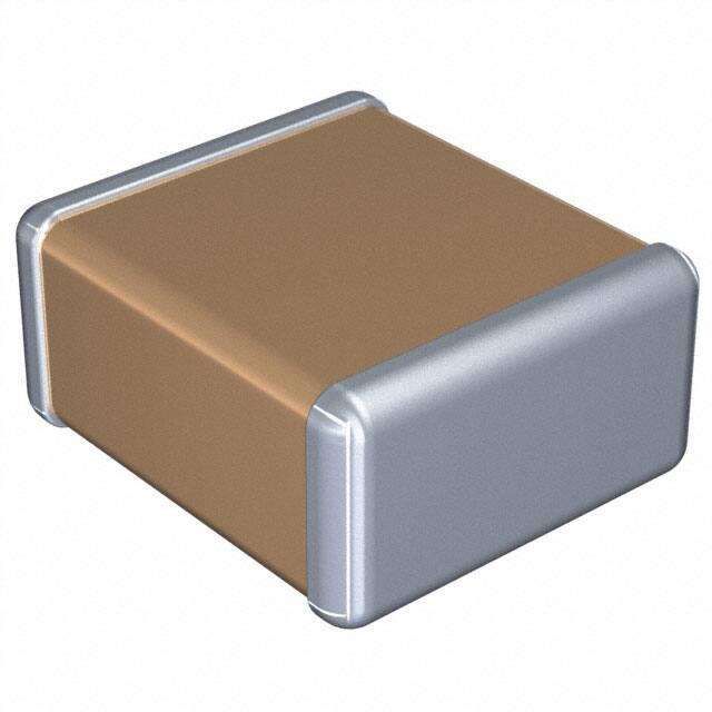

Surface Mount Multilayer Ceramic Chip Capacitors (SMD MLCCs) X7R Dielectric, 6.3 – 250 VDC (Automotive Grade) Overview The KEMET Automotive Grade Surface Mount Capacitors in X7R dielectric are suited for a variety of applications requiring proven, reliable performance in harsh environments. Whether underhood or in-cabin, these devices emphasize the vital and robust nature of capacitors required for mission and safety of critical automotive circuits. Stricter testing protocol and inspection criteria have been established for automotive grade products in recognition of potentially harsh environmental conditions. KEMET automotive grade capacitors meet the demanding Automotive Electronics Council's AEC-Q200 qualification requirements. X7R dielectric features a 125°C maximum operating temperature and is considered temperature stable. The Electronics Industries Alliance (EIA) characterizes X7R dielectric as a Class II material. Components of this classification are fixed, ceramic dielectric capacitors, suited for bypass and decoupling applications, or for frequency discriminating circuits, where Q and stability of capacitance characteristics are not critical. X7R exhibits a predictable change in capacitance with respect to time and voltage, and boasts a minimal change in capacitance with reference to ambient temperature. Capacitance change is limited to ±15% from −55°C to +125°C. Benefits • AEC–Q200 automotive qualified • −55°C to +125°C operating temperature range • Lead (Pb)-free, RoHS and REACH compliant • Temperature stable dielectric • EIA 0402, 0603, 0805, 1206, 1210, 1808, 1812, 1825, and 2220 case sizes • DC voltage ratings of 6.3 V, 10 V, 16 V, 25 V, 50 V, 100 V, 200 V and 250 V • Capacitance offerings ranging from 10 pF to 22 μF • Available capacitance tolerances of ±5%, ±10% and ±20% • Non-polar device, minimizing installation concerns • 100% pure matte tin-plated termination finish, allowing for excellent solderability Applications Typical applications include decoupling, bypass, filtering and transient voltage suppression. Built Into Tomorrow © KEMET Electronics Corporation • KEMET Tower • One East Broward Boulevard Fort Lauderdale, FL 33301 USA • 954-766-2800 • www.kemet.com C1023_X7R_AUTO_SMD • 5/24/2021 1 Surface Mount Multilayer Ceramic Chip Capacitors (SMD MLCCs) X7R Dielectric, 6.3 – 250 VDC (Automotive Grade) Ordering Information C Ceramic 0805 Case Size Specification/ (L" x W") Series 0402 0603 0805 1206 1210 1808 1812 1825 2220 1 C C = Standard 225 Capacitance Code (pF) Two significant digits and number of zeros. M 4 R A C Failure Capacitance Rated Voltage Dielectric Termination Finish1 Tolerance (VDC) Rate/Design J = ±5% K = ±10% M = ±20% 9 = 6.3 8 = 10 4 = 16 3 = 25 5 = 50 1 = 100 2 = 200 A = 250 R = X7R A = N/A C = 100% matte Sn AUTO Packaging/Grade (C-Spec) See "Packaging C-Spec Ordering Options Table" Additional termination finish options may be available. Contact KEMET for details. Packaging C-Spec Ordering Options Table Packaging Type1 7" Reel 13" Reel/Unmarked 7" Reel/Unmarked/2 mm pitch2 13" Reel/Unmarked/2 mm pitch2 Packaging/Grade Ordering Code (C-Spec)3 AUTO AUTO7411 (EIA 0603 and smaller case sizes) AUTO7210 (EIA 0805 and larger case sizes) 3190 3191 Reeling tape options (paper or plastic) are dependent on capacitor case size (L" x W") and thickness dimension. See "Chip Thickness/Tape & Reel Packaging Quantities" and "Tape & Reel Packaging Information." 2 The 2 mm pitch option allows for double the packaging quantity of capacitors on a given reel size. This option is limited to EIA 0603 (1608 metric) case size devices. For more information regarding 2 mm pitch option see "Tape & Reel Packaging Information." 3 All automotive packaging C-Specs listed exclude the option to laser mark components. Please contact KEMET if you require a laser marked option. For more information see "Capacitor Marking." 3 For additional Information regarding "AUTO" C-Spec options, see "Automotive C-Spec Information." 1 Qualification/Certification Automotive grade products meet or exceed the requirements outlined by the Automotive Electronics Council. Details regarding test methods and conditions are referenced in document AEC–Q200, Stress Test Qualification for Passive Components. For additional information regarding the Automotive Electronics Council and AEC–Q200, please visit their website at www.aecouncil.com. Environmental Compliance Lead (Pb)-free, RoHS, and REACH compliant without exemptions. © KEMET Electronics Corporation • KEMET Tower • One East Broward Boulevard Fort Lauderdale, FL 33301 USA • 954-766-2800 • www.kemet.com C1023_X7R_AUTO_SMD • 5/24/2021 2 Surface Mount Multilayer Ceramic Chip Capacitors (SMD MLCCs) X7R Dielectric, 6.3 – 250 VDC (Automotive Grade) Automotive C-Spec Information KEMET automotive grade products meet or exceed the requirements outlined by the Automotive Electronics Council. Details regarding test methods and conditions are referenced in document AEC–Q200, Stress Test Qualifi cation for Passive Components. These products are supported by a Product Change Notifi cation (PCN) and Production Part Approval Process warrant (PPAP). Automotive products offered through our distribution channel have been assigned an inclusive ordering code C-Spec, “AUTO.” This C-Spec was developed in order to better serve small and medium-sized companies that prefer an automotive grade component without the requirement to submit a customer Source Controlled Drawing (SCD) or specifi cation for review by a KEMET engineering specialist. This C-Spec is therefore not intended for use by KEMET OEM automotive customers and are not granted the same “privileges” as other automotive C-Specs. Customer PCN approval and PPAP request levels are limited (see details below.) Product Change Notification (PCN) The KEMET product change notifi cation system is used to communicate primarily the following types of changes: • Product/process changes that affect product form, fi t, function, and/or reliability • Changes in manufacturing site • Product obsolescence Process/Product change Obsolescence* Days Prior To Implementation KEMET assigned Yes (with approval and sign off) Yes 180 days minimum AUTO Yes (without approval) Yes 90 days minimum 1 1 Customer Notification Due To: KEMET Automotive C-Spec KEMET assigned C-Specs require the submittal of a customer SCD or customer specification for review. For additional information contact KEMET. Production Part Approval Process (PPAP) The purpose of the Production Part Approval Process is: • To ensure that supplier can meet the manufacturability and quality requirements for the purchased parts. • To provide the evidence that all customer engineering design records and specifi cation requirements are properly understood and fulfi lled by the manufacturing organization. • To demonstrate that the established manufacturing process has the potential to produce the part. PPAP (Product Part Approval Process) Level KEMET Automotive C-Spec 1 2 3 4 5 KEMET assigned1 ● ● ● ● ● AUTO 1 ○ KEMET assigned C-Specs require the submittal of a customer SCD or customer specification for review. For additional information contact KEMET. ● Part number specifi c PPAP available ○ Product family PPAP only © KEMET Electronics Corporation • KEMET Tower • One East Broward Boulevard Fort Lauderdale, FL 33301 USA • 954-766-2800 • www.kemet.com C1023_X7R_AUTO_SMD • 5/24/2021 3 Surface Mount Multilayer Ceramic Chip Capacitors (SMD MLCCs) X7R Dielectric, 6.3 – 250 VDC (Automotive Grade) Dimensions – Millimeters (Inches) L W B T S EIA Size Code Metric Size Code 0402 1005 06031 1608 08052 2012 12063 3216 1210 4 3225 1812 4532 2220 5650 L Length W Width 1.00 (0.040) ±0.05 (0.002) 1.60 (0.063) ±0.15 (0.006) 2.00 (0.079) ±0.20 (0.008) 3.20 (0.126) ±0.20 (0.008) 3.20 (0.126) ±0.20 (0.008) 4.50 (0.177) ±0.30 (0.012) 5.70 (0.224) ±0.40 (0.016) 0.50 (0.020) ±0.05 (0.002) 0.80 (0.032) ±0.15 (0.006) 1.25 (0.049) ±0.20 (0.008) 1.60 (0.063) ±0.20 (0.008) 2.50 (0.098) ±0.20 (0.008) 3.20 (0.126) ±0.30 (0.012) 5.00 (0.197) ±0.40 (0.016) T Thickness B Bandwidth See Table 2 for Thickness 0.30 (0.012) ±0.10 (0.004) 0.35 (0.014) ±0.15 (0.006) 0.50 (0.02) ±0.25 (0.010) 0.50 (0.02) ±0.25 (0.010) 0.50 (0.02) ±0.25 (0.010) 0.60 (0.024) ±0.35 (0.014) 0.60 (0.024) ±0.35 (0.014) S Separation Minimum Mounting Technique 0.30 (0.012) Solder reflow only 0.70 (0.028) 0.75 (0.030) N/A Solder wave or Solder reflow Solder reflow only For capacitance values ≥ 0.56 µF add 0.05 (0.002) to length tolerance dimension. For capacitance values 1.0 µF or ≥ 2.2 µF add 0.10 (0.004) to length tolerance dimension. 3 For capacitance value 1.0 µF all voltages and 10 µF with 25 V add 0.05 (0.002) to length tolerance dimension. 4 For capacitance values ≥ 4.7 µF add 0.02 (0.001) to the width tolerance dimension and 0.10 (0.004) to the length tolerance dimension. For capacitance value 22 µF, Length is [L] 3.30 (0.130) ± 0.40 (0.016) and Width [W] is 2.60 (0.102) ± 0.30 (0.012). 1 2 © KEMET Electronics Corporation • KEMET Tower • One East Broward Boulevard Fort Lauderdale, FL 33301 USA • 954-766-2800 • www.kemet.com C1023_X7R_AUTO_SMD • 5/24/2021 4 Surface Mount Multilayer Ceramic Chip Capacitors (SMD MLCCs) X7R Dielectric, 6.3 – 250 VDC (Automotive Grade) Electrical Parameters/Characteristics Item Parameters/Characteristics Operating Temperature Range −55°C to +125°C Capacitance Change with Reference to +25°C and 0 VDC Applied (TCC) ±15% Aging Rate (Maximum % Capacitance Loss/Decade Hour) 3.0% 1 2 3 4 Dielectric Withstanding Voltage (DWV) Dissipation Factor (DF) Maximum Limit at 25°C Insulation Resistance (IR) Minimum Limit at 25°C 250% of rated voltage (5 ±1 seconds and charge/discharge not exceeding 50 mA) See Dissipation Factor Limit table See Insulation Resistance Limit table (Rated voltage applied for 120 ±5 seconds at 25°C) Regarding Aging Rate: Capacitance measurements (including tolerance) are indexed to a referee time of 48 or 1,000 hours. Please refer to a part number specific datasheet for referee time details 2 DWV is the voltage a capacitor can withstand (survive) for a short period of time. It exceeds the nominal and continuous working voltage of the capacitor. 3 Capacitance and dissipation factor (DF) measured under the following conditions: 1 kHz ± 50 Hz and 1.0 ± 0.2 Vrms if capacitance ≤ 10 µF 120 Hz ± 10 Hz and 0.5 ± 0.1 Vrms if capacitance > 10 µF 4 To obtain IR limit, divide MΩ – µF value by the capacitance and compare to GΩ limit. Select the lower of the two limits. Note: When measuring capacitance it is important to ensure the set voltage level is held constant. The HP4284 and Agilent E4980 have a feature known as Automatic Level Control (ALC). The ALC feature should be switched to "ON." 1 Insulation Resistance Limit Table EIA Case Size Rated DC Voltage 1,000 megohm microfarads or 100 GΩ 500 megohm microfarads or 10 GΩ 100 megohm microfarads or 10 GΩ 0402 ALL ≤ 200 V 250 V ≤ 200 V 250 V ≤ 200 V 250 V ≤ 200 V 250 V ALL ALL ALL ALL ALL < 0.012 µF < 0.047 µF N/A < 0.15 µF < .027 µF < 0.47 µF < 0.12 µF < 0.39 µF < 0.27 µF ALL < 2.2 µF ALL < 10 µF ALL ≥ 0.012 µF< 0.47 µf ≥ 0.047 µf < 0.47 µf N/A ≥ 0.15 µF < 2.2 µf N/A ≥ 0.47 µF < 2.2 µf N/A ≥ 0.39 µF < 10 µf N/A N/A ≥ 2.2 µF N/A ≥ 10 µF N/A ≥ 0.47 µf ≥ 0.47 µf ALL ≥ 2.2 µf ≥ .027 µF ≥ 2.2 µf ≥ 0.12 µF ≥ 10 µf ≥ 0.27 µF N/A N/A N/A N/A N/A 0603 08051 1206 12101 1808 1812 1825 2220 2225 1 2 For Capacitance value 1.0 µF (50 V) IR should be calculated under 100 megohm microfarads or 10 GΩ. For Capacitance value 4.7 µF (50 V) IR should be calculated under 100 megohm microfarads or 10 GΩ. © KEMET Electronics Corporation • KEMET Tower • One East Broward Boulevard Fort Lauderdale, FL 33301 USA • 954-766-2800 • www.kemet.com C1023_X7R_AUTO_SMD • 5/24/2021 5 Surface Mount Multilayer Ceramic Chip Capacitors (SMD MLCCs) X7R Dielectric, 6.3 – 250 VDC (Automotive Grade) Dissipation Factor (DF) Limits Table EIA Case Size 0402 06031 Rated DC Voltage < 16 16/25 > 25 < 16 16/25 > 25 All < 16 16 08052 25 > 25 1206 3 1210 4 < 16 16/25 > 25 < 16 16 25 Capacitance ≥ 1.0 µF < 4.7 µF ≥ 4.7 µF < 4.7 µF ≥ 4.7 µF 25 5.0 < 16 1808 - 2225 Dissipation Factor (Maximum %) 16/25 > 25 All 3.5 2.5 For Capacitance values 0.22 µF (16 and 25 Volts) DF is 5%. For Capacitance values 2.2 µF (6.3, 10, and 16 Volts) DF is 10%. 3 For Capacitance values 4.7 and 10 µF (All Voltages) and 2.2 µF (25 and 50 Volts) DF is 10%. 4 For Capacitance values ≥ 10 µF (≤ 16 V) DF is 10% and for Capacitance value 4.7 µF (50 V) DF is 5%. 1 2 © KEMET Electronics Corporation • KEMET Tower • One East Broward Boulevard Fort Lauderdale, FL 33301 USA • 954-766-2800 • www.kemet.com C1023_X7R_AUTO_SMD • 5/24/2021 6 Surface Mount Multilayer Ceramic Chip Capacitors (SMD MLCCs) X7R Dielectric, 6.3 – 250 VDC (Automotive Grade) Post Environmental Limits High Temperature Life, Biased Humidity, Moisture Resistance EIA Case Size 0402 Rated DC Voltage Capacitance Dissipation Factor (Maximum %) < 16 All 7.5 16/25 All 5.0 > 25 All 3.0 < 16 06031 16/25 7.5 ≥ 4.7 µF 20.0 < 4.7 µF 5.0 ≥ 4.7 µF 20.0 < 2.2 µF 5.0 ≥ 2.2 µF 20.0 < 1.0 µF 3.0 ≥ 1.0 µF 20.0 < 16 All 7.5 16/25 All 5.0 > 25 All 3.0 < 16 All 7.5 16 All 5.0 < 10 µF 5.0 ≥ 10 µF 20.0 > 25 All 3.0 50 All 3.0 > 50 All 3.0 < 16 All 7.5 16/25 All 5.0 > 25 All 3.0 25 > 25 1210 4 1808 – 2225 25 10% of Initial limit 3.0 < 4.7 µF 08052 ±20% 5.0 20.0 16 12063 < 1.0 µF ≥ 1.0 µF < 16 Insulation Resistance 7.5 > 25 All Capacitance Shift For Capacitance values 0.22 µF (16 and 25 Volts) DF is 7.5%. For Capacitance values 2.2 µF (6.3, 10, and 16 Volts) DF is 20% 3 For Capacitance values 4.7 and 10 µF (All Voltages) and 2.2 µF (25 and 50 Volts) DF is 20% 4 For Capacitance values ≥ 10 µF (≤ 16 V) DF is 20% and for Capacitance value 4.7 µF (50 V) DF is 7.5% 1 2 © KEMET Electronics Corporation • KEMET Tower • One East Broward Boulevard Fort Lauderdale, FL 33301 USA • 954-766-2800 • www.kemet.com C1023_X7R_AUTO_SMD • 5/24/2021 7 Surface Mount Multilayer Ceramic Chip Capacitors (SMD MLCCs) X7R Dielectric, 6.3 – 250 VDC (Automotive Grade) Table 1A – Capacitance Range/Selection Waterfall (0402 – 1206 Case Sizes) Case Size /Series 1 2 A 250 5 200 3 EB EB EB EB EB EB EB EB EB EB EB EB EB EB EB EB EB EB EB EB EB EB EB EB EB EB EB EB EC EC EC EC EB EB EB EC ED EE EF EF ED EF ED EH EN ED EF EB EB EB EB EB EB EB EB EB EB EB EB EB EB EB EB EB EB EB EB EB EB EB EB EB EB EB EB EC EC EC EC EB EB EB EC ED EE EF EF ED EF ED EH EN ED EF EB EB EB EB EB EB EB EB EB EB EB EB EB EB EB EB EB EB EB EB EB EB EB EB EB EB EB EB EC EC EC EC EB EB EB EC ED EE EF EF ED EF ED EH EN ED EF EB EB EB EB EB EB EB EB EB EB EB EB EB EB EB EB EB EB EB EB EB EB EB EB EB EB EB EB EC EC EC EC EB EB EB EC ED EE EF EG EG EG EF EH EH EH EH EB EB EB EB EB EB EB EB EB EB EB EB EB EB EB EB EB EB EB EB EB EB EB EB EB EB EB EB EC EC EC EC EC EC EC EC EC ED ED ED EH EH EH EH EB EB EB EB EB EB EB EB EB EB EB EB EB EB EB EB EB EB EB EB EB EB EC EC EB EB EB EB EC EC EC EC EM EG EG EG EM EM EH EH EB EB EB EB EB EB EB EB EB EB EB EB EB EB EB EB EB EB EB EB EB EB EB ED ED ED ED EM EG EG EM EG EB EB EB EB EB EB EB EB EB EB EB EB EB EB EB EB EB EB EB EB ED ED ED ED EM EM EG EM EG 250 4 200 8 100 9 100 250 A 25 200 2 50 100 1 25 25 50 5 50 16 BB BB BB BB BB BB BB BB BB BB BB BB BB BB BB BB BB BB BB BB BB BB BB BB 3 16 10 BB BB BB BB BB BB BB BB BB BB BB BB BB BB BB BB BB BB BB BB BB BB BB BB BB BB BB BB 4 10 50 6.3 BB BB BB BB BB BB BB BB BB BB BB BB BB BB BB BB BB BB BB BB BB BB BB BB BB BB BB BB 8 16 16 25 BB BB BB BB BB BB BB BB BB BB BB BB BB BB BB BB BB BB BB BB BB BB BB BB BB BB BB BB 9 10 A 6.3 2 250 1 6.3 5 250 3 100 4 C1206C 200 8 50 9 16 5 25 3 10 4 A 9 8 4 3 5 1 2 A CF CF CF CF CF CF CF CF CF CF CF CF CF CF CF CF CF CF CF CF CF CF CF CF CF CF CF CF CF CF CF CF CF CF CF CF CF CF CF CF CF CF CF CF CF CF CF CF CF CF CF CF CF CF CF CF CF CF CF CF CF CF CF CF CF CF CF CF CF CF CF CF CF CF CF CF CF CF CF CF CF CF CF CF CF CF CF CF CF CF CF CF CF CF CF CF CF CF CF CF CF CF CF CF CF CF CF CF CF CF CF CF CF CF CF CF CF CF CF CF CF CF CF CF CF CF CF CF CF CF CF CF CF CF CF CF CF CF CF CF CF CF CF CF CF CF CF CF CF CF CF CF CF CF CF CF CF CF CF CF CF CF CF CF CF CF CF CF CF CF CF CF CF CF CF CF CF CF CF CF CF CF CF CF CF CF CF C0402C 6.3 10 16 25 4 250 8 3 5 1 2 A 9 8 4 3 C0603C DN DN DN DN DN DN DN DN DN DN DN DN DN DN DN DN DN DN DN DN DN DN DN DN DP DP DP DN DP DP DP DP DP DP DE DE DH DH DN DN DN DN DN DN DN DN DN DN DN DN DN DN DN DN DN DP DP DP DP DP DP DE DE DE DE DE DG DG DG DG DN DN DN DN DN DN DN DN DN DN DN DN DN DN DN DN DN DN DN DN DE DE DE DG DG DG DN DN DN DN DN DN DN DN DN DN DN DN DN DN DN DN DN DN DG DG DG DG DG DG 5 1 2 DH DG DH 200 9 DN DN DN DN DN DN DN DN DN DN DN DN DN DN DN DN DN DN DN DN DN DN DN DN DP DP DP DN DN DN DN DN DP DP DG DP DG DG DG DG 100 5 DN DN DN DN DN DN DN DN DN DN DN DN DN DN DN DN DN DN DN DN DN DN DN DN DP DP DP DN DN DN DN DN DP DP DG DP DP DP DP DP DE DG DG DG 25 3 DN DN DN DN DN DN DN DN DN DN DN DN DN DN DN DN DN DN DN DN DN DN DN DN DP DP DP DN DN DN DN DN DP DP DG DP DP DP DP DP DE DG DG DG 50 4 16 8 10 9 50 CJ¹ CJ¹ CJ¹ DN DN DN DN DN DN DN DN DN DN DN DN DN DN DN DN DN DN DN DN DN DN DN DN DP DP DP DN DN DN DN DN DP DP DG DP DP DP DP DP DE DG DG DG 100 CF CF CF CF CF CF CF CF CF CF CF CF CF CF CF CF CF CF CF CF CF CF CF CF CF CF CF CF CF CF CF CF CF CF CF CF 200 BB BB BB BB BB BB BB BB BB BB BB BB BB BB BB BB BB BB BB BB 50 Product Availability and Chip Thickness Codes – See Table 2 for Chip Thickness Dimensions 6.3 Cap Code Voltage Code 8 16 Capacitance 9 25 Rated Voltage (VDC) C0805C 10 Capacitance Tolerance J K M J K M J K M J K M J K M J K M J K M J K M J K M J K M J K M J K M J K M J K M J K M J K M J K M J K M J K M J K M J K M J K M J K M J K M J K M J K M J K M J K M J K M J K M J K M J K M J K M J K M J K M J K M J K M J K M J K M J K M J K M J K M J K M J K M J K M K M J J K M C0603C 6.3 100 - 910* 101 - 151** 181 - 821** 102 122 152 182 222 272 332 392 472 562 682 822 103 123 153 183 223 273 333 393 473 563 683 823 104 124 154 184 224 274 334 394 474 564 684 824 105 125 155 185 225 275 335 395 Voltage Code Rated Voltage (VDC) 10 10 - 91 pF* 100 - 150 pF** 180 - 820 pF** 1,000 pF 1,200 pF 1,500 pF 1,800 pF 2,200 pF 2,700 pF 3,300 pF 3,900 pF 4,700 pF 5,600 pF 6,800 pF 8,200 pF 10,000 pF 12,000 pF 15,000 pF 18,000 pF 22,000 pF 27,000 pF 33,000 pF 39,000 pF 47,000 pF 56,000 pF 68,000 pF 82,000 pF 0.10 µF 0.12 µF 0.15 µF 0.18 µF 0.22 µF 0.27 µF 0.33 µF 0.39 µF 0.47 µF 0.56 µF 0.68 µF 0.82 µF 1.0 µF 1.2 µF 1.5 µF 1.8 µF 2.2 µF 2.7 µF 3.3 µF 3.9 µF Cap Code 6.3 Capacitance C0402C 6.3 Case Size /Series C0805C C1206C *Capacitance range includes E24 decade values only (i.e., 10, 11, 12, 13, 15, 16, 18, 20, 22, 24, 27, 30, 33, 36, 39, 43, 47, 51, 56, 62, 68, 75, 82, and 91.) **Capacitance range includes E12 decade values only. (i.e., 10, 12, 15, 18, 22, 27, 33, 39, 47, 56, 68, and 82.) xx1 Available only in K and M tolerances. © KEMET Electronics Corporation • KEMET Tower • One East Broward Boulevard Fort Lauderdale, FL 33301 USA • 954-766-2800 • www.kemet.com C1023_X7R_AUTO_SMD • 5/24/2021 8 Surface Mount Multilayer Ceramic Chip Capacitors (SMD MLCCs) X7R Dielectric, 6.3 – 250 VDC (Automotive Grade) Table 1A – Capacitance Range/Selection Waterfall (0402 – 1206 Case Sizes) cont. A 250 2 200 1 250 5 200 16 3 100 4 100 8 3 5 1 2 A 25 9 50 A 25 2 50 1 10 5 6.3 3 250 4 100 8 C1206C 200 9 50 A 16 2 25 1 10 16 5 6.3 10 3 250 4 200 8 100 9 C0805C 25 5 50 C0603C 6.3 10 16 6.3 3 Capacitance Tolerance J K M J K M J K M J K M J K M Product Availability and Chip Thickness Codes – See Table 2 for Chip Thickness Dimensions DG DG DG DH Case Size /Series C0402C 3 5 C0603C 16 4 10 8 6.3 9 EH EH EH EH EH EH EH EH 250 A EH EH EH EH EH 100 2 EF EH EH EH EH 200 1 50 5 16 10 3 25 6.3 4 250 8 200 9 100 5 25 3 50 4 16 8 10 9 Cap Code Voltage Code 50 DH DH 6.3 Rated Voltage (VDC) Capacitance 4 25 8 16 475 565 685 825 106 9 25 4.7 µF 5.6 µF 6.8 µF 8.2 µF 10 µF Voltage Code Rated Voltage (VDC) 10 Cap Code 6.3 Capacitance C0402C 50 Case Size /Series 1 2 A 9 8 4 C0805C C1206C *Capacitance range Includes E24 decade values only. (i.e., 10, 11, 12, 13, 15, 16, 18, 20, 22, 24, 27, 30, 33, 36, 39, 43, 47, 51, 56, 62, 68, 75, 82 and 91) **Capacitance range Includes E12 decade values only. (i.e., 10, 12, 15, 18, 22, 27, 33, 39, 47, 56, 68 and 82) xx¹ Available only in K and M tolerance. Table 1B – Capacitance Range/Selection Waterfall (1210 – 1808 Case Sizes) Case Size /Series 9 8 4 3 5 1 2 A 5 1 2 5 1 2 16 25 50 100 200 250 50 100 200 50 100 200 Rated Voltage (VDC) C1808C 10 Voltage Code Cap Code C1805C 6.3 Capacitance C1210C 9 8 4 3 5 1 Case Size /Series C1210C 2 A 5 1 NC NC NC NC NC NC LF LF LF LF LF LF LF LF LF LF LF LD LD LD LD LD LF LF LF LF LF LF LF LF LF LF LF LD LD LD LD LD LF LF LF LF LF LF LF LF LF 200 Voltage Code NC NC NC NC NC NC NC NC NC NC 100 Rated Voltage (VDC) FB FB FB FB FB FB FB FB FB NC NC NC NC NC NC NC NC NC NC NA NA NA NA NA NA NA NA 50 FB FB FB FB FB FB FB FB FB FE FE FB FB FB FB FB FB FB FB FB 200 FB FB FB FB FB FB FB FB FB FB FB FB FB FB FB FB FB FB FB FB 100 FB FB FB FB FB FB FB FB FB FB FB FB FB FB FB FB FB FB FB FB 100 M M M M M M M M M M M M M M M M M M M M 50 FB FB FB FB FB FB FB FB FB FB FB FB FB FB FB FB FB FB FB FB 50 K K K K K K K K K K K K K K K K K K K K 250 FB FB FB FB FB FB FB FB FB FB FB FB FB FB FB FB FB FB FB FB 25 J J J J J J J J J J J J J J J J J J J J 200 FB FB FB FB FB FB FB FB FB FB FB FB FB FB FB FB FB FB FB FB 16 Cap Code FB FB FB FB FB FB FB FB FB FB FB FB FB FB FB FB FB FB FB FB 10 Capacitance 100 - 910* 101 - 181** 221 271 331 391 471 - 821** 102 122 152 182 222 272 332 392 472 562 682 822 103 6.3 Capacitance Tolerance Product Availability and Chip Thickness Codes – See Table 2 for Chip Thickness Dimensions 10 - 91 pF* 100 - 180 pF** 220 pF 270 pF 330 pF 390 pF 470 - 820 pF** 1,000 pF 1,200 pF 1,500 pF 1,800 pF 2,200 pF 2,700 pF 3,300 pF 3,900 pF 4,700 pF 5,600 pF 6,800 pF 8,200 pF 10,000 pF 2 5 1 2 NA NA NA NA NA C1805C C1808C *Capacitance range Includes E24 decade values only. (i.e., 10, 11, 12, 13, 15, 16, 18, 20, 22, 24, 27, 30, 33, 36, 39, 43, 47, 51, 56, 62, 68, 75, 82 and 91) **Capacitance range Includes E12 decade values only. (i.e., 10, 12, 15, 18, 22, 27, 33, 39, 47, 56, 68 and 82) 2 Available capacitance values available in X7R with KONNEKT Technology. © KEMET Electronics Corporation • KEMET Tower • One East Broward Boulevard Fort Lauderdale, FL 33301 USA • 954-766-2800 • www.kemet.com C1023_X7R_AUTO_SMD • 5/24/2021 9 Surface Mount Multilayer Ceramic Chip Capacitors (SMD MLCCs) X7R Dielectric, 6.3 – 250 VDC (Automotive Grade) Table 1B – Capacitance Range/Selection Waterfall (1210 – 1808 Case Sizes) cont. 9 8 4 3 5 1 2 A 5 1 2 5 1 16 25 50 100 200 250 50 100 200 50 100 Rated Voltage (VDC) C1808C 10 Voltage Code Cap Code C1805C 6.3 Capacitance C1210C 2 200 Case Size /Series FB FB FB FB FB FB FB FB FB FB FC FD FD FD FD FD FD FD FD FD FF FG FL FM FH FM FJ FK FB FB FB FB FB FB FB FB FC FC FF FG FH FM FK FK FP FM FK FS FB FB FB FB FB FB FB FB FC FC FF FG FH FM FK FK FP FM FK FS NA NA NA NA NA NA NA NA NA NA NA NA NA NA NA NA NA Rated Voltage (VDC) 250 50 100 Voltage Code 9 8 4 3 5 1 2 A 5 1 Case Size /Series C1210C C1805C LD LD LD LD LD LD LD LD LD LD LD LD LD LD LD LD LD LD LD LD LD LD LD LD 200 FB FB FB FB FB FB FB FB FB FB FB FB FB FC FC FC FC FD FD FD FD FD FF FH FG FG FG FG FH FM FK FS 200 M M M M M M M M M M M M M M M M M M M M M M M M M M M M M M M M M M M M M 100 FB FB FB FB FB FB FB FB FB FB FB FB FB FC FC FC FC FD FD FD FD FD FF FH FH FH FH FJ FG FM FG FG FH FM FK FS 100 K K K K K K K K K K K K K K K K K K K K K K K K K K K K K K K K K K K K K 50 FB FB FB FB FB FB FB FB FB FB FB FB FB FC FC FC FC FD FD FD FD FD FF FH FH FH FH FJ FE FF FG FC FF FG FH FS 50 J J J J J J J J J J J J J J J J J J J J J J J J J J J J J J J J J J J J J 200 FB FB FB FB FB FB FB FB FB FB FB FB FB FC FC FC FC FD FD FD FD FD FF FH FH FH FH FJ FE FF FG FC FF FG FH FS FS 25 Cap Code FB FB FB FB FB FB FB FB FB FB FB FB FB FC FC FC FC FD FD FD FD FD FF FH FH FH FH FJ FE FF FG FC FF FG FH FS FS 16 Capacitance 123 153 183 223 273 333 393 473 563 683 823 104 124 154 184 224 274 334 394 474 564 684 824 105 125 155 185 225 275 335 395 475 565 685 825 106 226 10 12,000 pF 15,000 pF 18,000 pF 22,000 pF 27,000 pF 33,000 pF 39,000 pF 47,000 pF 56,000 pF 68,000 pF 82,000 pF 0.10 µF 0.12 µF 0.15 µF 0.18 µF 0.22 µF 0.27 µF 0.33 µF 0.39 µF 0.47 µF 0.56 µF 0.68 µF 0.82 µF 1.0 µF 1.2 µF 1.5 µF 1.8 µF 2.2 µF 2.7 µF 3.3 µF 3.9 µF 4.7 µF 5.6 µF 6.8 µF 8.2 µF 10 µF 22 µF 6.3 Capacitance Tolerance Product Availability and Chip Thickness Codes – See Table 2 for Chip Thickness Dimensions 2 5 1 2 C1808C *Capacitance range Includes E24 decade values only. (i.e., 10, 11, 12, 13, 15, 16, 18, 20, 22, 24, 27, 30, 33, 36, 39, 43, 47, 51, 56, 62, 68, 75, 82 and 91) **Capacitance range Includes E12 decade values only. (i.e., 10, 12, 15, 18, 22, 27, 33, 39, 47, 56, 68 and 82) 2 Available capacitance values available in X7R with KONNEKT Technology. © KEMET Electronics Corporation • KEMET Tower • One East Broward Boulevard Fort Lauderdale, FL 33301 USA • 954-766-2800 • www.kemet.com C1023_X7R_AUTO_SMD • 5/24/2021 10 Surface Mount Multilayer Ceramic Chip Capacitors (SMD MLCCs) X7R Dielectric, 6.3 – 250 VDC (Automotive Grade) Table 1C – Capacitance Range/Selection Waterfall (1812 – 2220 Case Sizes) Case Size /Series 3 5 1 2 A 5 1 2 A 3 5 1 2 A 100 200 250 50 100 200 250 25 50 100 200 250 Rated Voltage (VDC) C2220C 50 Voltage Code Cap Code C1825C 25 Capacitance C1812C2 Rated Voltage (VDC) 100 Voltage Code 3 5 1 2 A 5 1 C1812C2 HB HB HB HB HB HB HB HB HB HB HB HB HB JC JC JC JC JC JC JC JC JC JC JC JC 250 HB HB HB HB HB HB HB HB HB HB HB HB HB JE JE JE JE JE JE JE JE JB JB JB JB JB JC JC JC JC JC JC 200 HB HB HB HB HB HB HB HB HB HB HB HB HB JE JE JE JE JE JE JE JE JB JB JB JB JB JB JB JB JB JB JB 100 HB HB HB HB HB HB HB HB HB HB HB HB HB JE JE JE JE JE JE JE JE JB JB JB JB JB JB JB JB JB JB JB 50 GB GB GB GB GB GB GB GB GB GB GB GB GB GB GB GB GE GG GG Case Size /Series M M M M M M M M M M M M M M M M M M M M M M M M M M M M M M 25 GB GB GB GB GB GB GB GB GB GD GH GB GB GB GB GB GB GB GB GB GB GB GB GB GB GB GB GE GG GG 50 K K K K K K K K K K K K K K K K K K K K K K K K K K K K K K 250 GB GB GB GB GB GB GB GB GB GB GB GB GB GB GB GB GB GB GB GB GB GB GB GB GB GB GB GB GB GB 250 J J J J J J J J J J J J J J J J J J J J J J J J J J J J J J 200 GB GB GB GB GB GB GB GB GB GB GB GB GB GB GB GB GB GB GB GB GB GB GB GB GB GB GB GB GB GB 200 Cap Code GB GB GB GB GB GB GB GB GB GB GB GB GB GB GB GB GB GB GB GB GB GB GB GB GB GB GB GB GB GB 100 Capacitance 471 - 821** 102 122 152 182 222 272 332 392 472 562 682 822 103 123 153 183 223 273 333 393 473 563 683 823 104 124 154 184 224 50 470 - 820 pF** 1,000 pF 1,200 pF 1,500 pF 1,800 pF 2,200 pF 2,700 pF 3,300 pF 3,900 pF 4,700 pF 5,600 pF 6,800 pF 8,200 pF 10,000 pF 12,000 pF 15,000 pF 18,000 pF 22,000 pF 27,000 pF 33,000 pF 39,000 pF 47,000 pF 56,000 pF 68,000 pF 82,000 pF 0.10 µF 0.12 µF 0.15 µF 0.18 µF 0.22 µF 25 Capacitance Tolerance Product Availability and Chip Thickness Codes – See Table 2 for Chip Thickness Dimensions 2 A 3 5 1 2 A C1825C C2220C *Capacitance range Includes E24 decade values only. (i.e., 10, 11, 12, 13, 15, 16, 18, 20, 22, 24, 27, 30, 33, 36, 39, 43, 47, 51, 56, 62, 68, 75, 82 and 91) **Capacitance range Includes E12 decade values only. (i.e., 10, 12, 15, 18, 22, 27, 33, 39, 47, 56, 68 and 82) 2 Available capacitance values available in X7R with KONNEKT Technology. © KEMET Electronics Corporation • KEMET Tower • One East Broward Boulevard Fort Lauderdale, FL 33301 USA • 954-766-2800 • www.kemet.com C1023_X7R_AUTO_SMD • 5/24/2021 11 Surface Mount Multilayer Ceramic Chip Capacitors (SMD MLCCs) X7R Dielectric, 6.3 – 250 VDC (Automotive Grade) Table 1C – Capacitance Range/Selection Waterfall (1812 – 2220 Case Sizes) cont. Case Size /Series 3 5 1 2 A 5 1 2 A 3 5 1 2 A 100 200 250 50 100 200 250 25 50 100 200 250 Rated Voltage (VDC) C2220C 50 Voltage Code Cap Code C1825C 25 Capacitance C1812C2 HB HB HD HD HD HD HF HF HB HB HD HD HD HD HF HF HB HB HD HD HD HD HF HF 5 1 2 A 5 1 2 C1825C HB HB HD HD HD HD HF HF JC JC JC JC JD JD JF JF JC JC JC JC JD JD JF JF JC JC JC JC JD JD JF JF 250 GG GG GG GJ 200 200 3 C1812C2 GG GG GG GJ 100 100 Voltage Code Case Size /Series M M M M M M M M M M M M M M M M M M M 50 Rated Voltage (VDC) 50 K K K K K K K K K K K K K K K K K K K JC JC JC JC JC JC JC JC JC JC JD JF JC JC JC JC JD JD JF JF JC JC JD JF JF JF JO JO JF JO 25 GG GG GG GG GG GG GG GG GB GC GE GG GJ GL 250 J J J J J J J J J J J J J J J J J J J 250 GB GB GB GB GC GC GE GE GB GC GE GO GJ GL GK GK 200 Cap Code GB GB GB GB GC GC GE GE GB GC GE GO GJ GL GK GK GK 100 Capacitance 274 334 394 474 564 684 824 105 125 155 185 225 275 335 395 475 106 156 226 50 0.27 µF 0.33 µF 0.39 µF 0.47 µF 0.56 µF 0.68 µF 0.82 µF 1.0 µF 1.2 µF 1.5 µF 1.8 µF 2.2 µF 2.7 µF 3.3 µF 3.9 µF 4.7 µF 10 µF 15 µF 22 µF 25 Capacitance Tolerance Product Availability and Chip Thickness Codes – See Table 2 for Chip Thickness Dimensions A 3 5 1 2 A C2220C *Capacitance range Includes E24 decade values only. (i.e., 10, 11, 12, 13, 15, 16, 18, 20, 22, 24, 27, 30, 33, 36, 39, 43, 47, 51, 56, 62, 68, 75, 82 and 91) **Capacitance range Includes E12 decade values only. (i.e., 10, 12, 15, 18, 22, 27, 33, 39, 47, 56, 68 and 82) 2 Available capacitance values available in X7R with KONNEKT Technology. © KEMET Electronics Corporation • KEMET Tower • One East Broward Boulevard Fort Lauderdale, FL 33301 USA • 954-766-2800 • www.kemet.com C1023_X7R_AUTO_SMD • 5/24/2021 12 Surface Mount Multilayer Ceramic Chip Capacitors (SMD MLCCs) X7R Dielectric, 6.3 – 250 VDC (Automotive Grade) Table 2 – Chip Thickness/Tape & Reel Packaging Quantities Paper Quantity1 Plastic Quantity Thickness Code Case Size1 Thickness ± Range (mm) 7" Reel 13" Reel 7" Reel 13" Reel BB CF CJ DN DP DE DG DH EB EC EN ED EE EF EM EG EH FB FC FD FE FF FG FL FH FP FM FJ FK FS 0402 0603 0603 0805 0805 0805 0805 0805 1206 1206 1206 1206 1206 1206 1206 1206 1206 1210 1210 1210 1210 1210 1210 1210 1210 1210 1210 1210 1210 1210 0.50 ± 0.05 0.80 ± 0.07* 0.80 ± 0.15* 0.78 ± 0.10* 0.90 ± 0.10* 1.00 ± 0.10 1.25 ± 0.15 1.25 ± 0.20 0.78 ± 0.10 0.90 ± 0.10 0.95 ± 0.10 1.00 ± 0.10 1.10 ± 0.10 1.20 ± 0.15 1.25 ± 0.15 1.60 ± 0.15 1.60 ± 0.20 0.78 ± 0.10 0.90 ± 0.10 0.95 ± 0.10 1.00 ± 0.10 1.10 ± 0.10 1.25 ± 0.15 1.40 ± 0.15 1.55 ± 0.15 1.60 ± 0.20 1.70 ± 0.20 1.85 ± 0.20 2.10 ± 0.20 2.50 ± 0.30 10,000 4,000 4,000 4,000 4,000 0 0 0 0 0 0 0 0 0 0 0 0 0 0 0 0 0 0 0 0 0 0 0 0 0 50,000 15,000 15,000 15,000 15,000 0 0 0 0 0 0 0 0 0 0 0 0 0 0 0 0 0 0 0 0 0 0 0 0 0 0 0 0 0 0 2,500 2,500 2,500 4,000 4,000 4,000 2,500 2,500 2,500 2,500 2,000 2,000 4,000 4,000 4,000 2,500 2,500 2,500 2,000 2,000 2,000 2,000 2,000 2,000 1,000 0 0 0 0 0 10,000 10,000 10,000 10,000 10,000 10,000 10,000 10,000 10,000 10,000 8,000 8,000 10,000 10,000 10,000 10,000 10,000 10,000 8,000 8,000 8,000 8,000 8,000 8,000 4,000 Thickness Code Case Size1 Thickness ± Range (mm) 7" Reel 13" Reel 7" Reel 13" Reel Paper Quantity1 Plastic Quantity Package quantity based on finished chip thickness specifications. 1 If ordering using the 2 mm Tape & Reel pitch option, the packaging quantity outlined in the table above will be doubled. This option is limited to EIA 0603 (1608 metric) case size devices. For more information regarding 2 mm pitch option see "Tape & Reel Packaging Information." © KEMET Electronics Corporation • KEMET Tower • One East Broward Boulevard Fort Lauderdale, FL 33301 USA • 954-766-2800 • www.kemet.com C1023_X7R_AUTO_SMD • 5/24/2021 13 Surface Mount Multilayer Ceramic Chip Capacitors (SMD MLCCs) X7R Dielectric, 6.3 – 250 VDC (Automotive Grade) Table 2 – Chip Thickness/Tape & Reel Packaging Quantities cont. Paper Quantity1 Plastic Quantity Thickness Code Case Size1 Thickness ± Range (mm) 7" Reel 13" Reel 7" Reel 13" Reel NA NC LD LF GB GC GD GE GH GG GK GJ GL GO HB HD HF JB JC JD JE JF JO 1706 1706 1808 1808 1812 1812 1812 1812 1812 1812 1812 1812 1812 1812 1825 1825 1825 2220 2220 2220 2220 2220 2220 0.90 ± 0.10 1.00 ± 0.15 0.90 ± 0.10 1.00 ± 0.15 1.00 ± 0.10 1.10 ± 0.10 1.25 ± 0.15 1.30 ± 0.10 1.40 ± 0.15 1.55 ± 0.10 1.60 ± 0.20 1.70 ± 0.15 1.90 ± 0.20 2.50 ± 0.20 1.10 ± 0.15 1.30 ± 0.15 1.50 ± 0.15 1.00 ± 0.15 1.10 ± 0.15 1.30 ± 0.15 1.40 ± 0.15 1.50 ± 0.15 2.40 ± 0.15 0 0 0 0 0 0 0 0 0 0 0 0 0 0 0 0 0 0 0 0 0 0 0 0 0 0 0 0 0 0 0 0 0 0 0 0 0 0 0 0 0 0 0 0 0 0 4,000 4,000 2,500 2,500 1,000 1,000 1,000 1,000 1,000 1,000 1,000 1,000 500 500 1,000 1,000 1,000 1,000 1,000 1,000 1,000 1,000 500 10,000 10,000 10,000 10,000 4,000 4,000 4,000 4,000 4,000 4,000 4,000 4,000 2,000 2,000 4,000 4,000 4,000 4,000 4,000 4,000 4,000 4,000 2,000 Thickness Code Case Size1 Thickness ± Range (mm) 7" Reel 13" Reel 7" Reel 13" Reel Paper Quantity1 Plastic Quantity Package quantity based on finished chip thickness specifications. 1 If ordering using the 2 mm Tape & Reel pitch option, the packaging quantity outlined in the table above will be doubled. This option is limited to EIA 0603 (1608 metric) case size devices. For more information regarding 2 mm pitch option see "Tape & Reel Packaging Information." © KEMET Electronics Corporation • KEMET Tower • One East Broward Boulevard Fort Lauderdale, FL 33301 USA • 954-766-2800 • www.kemet.com C1023_X7R_AUTO_SMD • 5/24/2021 14 Surface Mount Multilayer Ceramic Chip Capacitors (SMD MLCCs) X7R Dielectric, 6.3 – 250 VDC (Automotive Grade) Table 3 – Chip Capacitor Land Pattern Design Recommendations per IPC–7351 EIA Size Code Metric Size Code 0402 Density Level A: Maximum (Most) Land Protrusion (mm) Density Level B: Median (Nominal) Land Protrusion (mm) Density Level C: Minimum (Least) Land Protrusion (mm) C Y X V1 V2 C Y X V1 V2 C Y X V1 V2 1005 0.50 0.72 0.72 2.20 1.20 0.45 0.62 0.62 1.90 1.00 0.40 0.52 0.52 1.60 0.80 0603 1608 0.90 1.15 1.10 4.00 2.10 0.80 0.95 1.00 3.10 1.50 0.60 0.75 0.90 2.40 1.20 0805 2012 1.00 1.35 1.55 4.40 2.60 0.90 1.15 1.45 3.50 2.00 0.75 0.95 1.35 2.80 1.70 1206 3216 1.60 1.35 1.90 5.60 2.90 1.50 1.15 1.80 4.70 2.30 1.40 0.95 1.70 4.00 2.00 1210 3225 1.60 1.35 2.80 5.65 3.80 1.50 1.15 2.70 4.70 3.20 1.40 0.95 2.60 4.00 2.90 12101 3225 1.50 1.60 2.90 5.60 3.90 1.40 1.40 2.80 4.70 3.30 1.30 1.20 2.70 4.00 3.00 1812 4532 2.15 1.60 3.60 6.90 4.60 2.05 1.40 3.50 6.00 4.00 1.95 1.20 3.40 5.30 3.70 2220 5650 2.75 1.70 5.50 8.20 6.50 2.65 1.50 5.40 7.30 5.90 2.55 1.30 5.30 6.60 5.60 Only for capacitance values ≥ 22 µF Density Level A: For low-density product applications. Recommended for wave solder applications and provides a wider process window for reflow solder processes. KEMET only recommends wave soldering of EIA 0603, 0805, and 1206 case sizes. Density Level B: For products with a moderate level of component density. Provides a robust solder attachment condition for reflow solder processes. Density Level C: For high component density product applications. Before adapting the minimum land pattern variations the user should perform qualification testing based on the conditions outlined in IPC Standard 7351 (IPC–7351). 1 Image below based on Density Level B for an EIA 1210 case size. V1 Y Y X X C C V2 Grid Placement Courtyard © KEMET Electronics Corporation • KEMET Tower • One East Broward Boulevard Fort Lauderdale, FL 33301 USA • 954-766-2800 • www.kemet.com C1023_X7R_AUTO_SMD • 5/24/2021 15 Surface Mount Multilayer Ceramic Chip Capacitors (SMD MLCCs) X7R Dielectric, 6.3 – 250 VDC (Automotive Grade) Soldering Process Recommended Soldering Technique: • Solder wave or solder reflow for EIA case sizes 0603, 0805 and 1206 • All other EIA case sizes are limited to solder reflow only Recommended Reflow Soldering Profile: The KEMET families of surface mount multilayer ceramic capacitors (SMD MLCCs) are compatible with wave (single or dual), convection, IR or vapor phase reflow techniques. Preheating of these components is recommended to avoid extreme thermal stress. The KEMET recommended profile conditions for convection and IR reflow reflect the profile conditions of the IPC/ J-STD-020 standard for moisture sensitivity testing. These devices can safely withstand a maximum of three reflow passes at these conditions. Preheat/Soak Temperature Minimum (TSmin) Temperature Maximum (TSmax) Time (tS) from TSmin to TSmax Termination Finish SnPb TP 100% Matte Sn Ramp-Up Rate (TL to TP) 100°C 150°C 60 – 120 seconds 3°C/second maximum 150°C 200°C 60 – 120 seconds 3°C/second maximum Liquidous Temperature (TL) 183°C 217°C Time Above Liquidous (tL) 60 – 150 seconds 60 – 150 seconds Peak Temperature (TP) 235°C 260°C TL Temperature Profile Feature tP Maximum Ramp-up Rate = 3°C/second Maximum Ramp-down Rate = 6°C/second tL Tsmax Tsmin 25 ts 25°C to Peak Time Time Within 5°C of Maximum Peak Temperature (tP) 20 seconds 30 seconds maximum maximum 6°C/second 6°C/second Ramp-Down Rate (TP to TL) maximum maximum Time 25°C to Peak 6 minutes 8 minutes Temperature maximum maximum Note: All temperatures refer to the center of the package, measured on the capacitor body surface that is facing up during assembly reflow. Storage & Handling Ceramic chip capacitors should be stored in normal working environments. While the chips themselves are quite robust in other environments, solderability will be degraded by exposure to high temperatures, high humidity, corrosive atmospheres, and long term storage. In addition, packaging materials will be degraded by high temperature – reels may soften or warp and tape peel force may increase. KEMET recommends that maximum storage temperature not exceed 40ºC and maximum storage humidity not exceed 70% relative humidity. Temperature fluctuations should be minimized to avoid condensation on the parts and atmospheres should be free of chlorine and sulfur bearing compounds. For optimized solderability chip stock should be used promptly, preferably within 1.5 years of receipt. © KEMET Electronics Corporation • KEMET Tower • One East Broward Boulevard Fort Lauderdale, FL 33301 USA • 954-766-2800 • www.kemet.com C1023_X7R_AUTO_SMD • 5/24/2021 16 Surface Mount Multilayer Ceramic Chip Capacitors (SMD MLCCs) X7R Dielectric, 6.3 – 250 VDC (Automotive Grade) Construction (Typical) Detailed Cross Section Dielectric Material (BaTiO3) Barrier Layer (Ni) Termination Finish (100% Matte Sn) Dielectric Material (BaTiO3) End Termination/ External Electrode (Cu) Inner Electrodes (Ni) End Termination/ External Electrode (Cu) Barrier Layer (Ni) Termination Finish (100% Matte Sn) Inner Electrodes (Ni) © KEMET Electronics Corporation • KEMET Tower • One East Broward Boulevard Fort Lauderdale, FL 33301 USA • 954-766-2800 • www.kemet.com C1023_X7R_AUTO_SMD • 5/24/2021 17 Surface Mount Multilayer Ceramic Chip Capacitors (SMD MLCCs) X7R Dielectric, 6.3 – 250 VDC (Automotive Grade) Capacitor Marking (Optional) These surface mount multilayer ceramic capacitors are normally supplied unmarked. If required, they can be marked as an extra cost option. Marking is available on most KEMET devices, but must be requested using the correct ordering code identifi er(s). If this option is requested, two sides of the ceramic body will be laser marked with a “K” to identify KEMET, followed by two characters (per EIA–198 - see table below) to identify the capacitance value. EIA 0603 case size devices are limited to the “K” character only. Marking appears in legible contrast. Illustrated below is an example of an MLCC with laser marking of “KA8”, which designates a KEMET device with rated capacitance of 100 µF. Orientation of marking is vendor optional. KEMET ID 2-Digit Capacitance Code Laser marking option is not available on: • C0G, ultra stable X8R and Y5V dielectric devices. • EIA 0402 case size devices. • EIA 0603 case size devices with fl exible termination option. • KPS commercial and automotive grade stacked devices. • X7R dielectric products in capacitance values outlined below. EIA Case Size Metric Size Code Capacitance 0603 0805 1206 1210 1808 1812 1825 2220 2225 1608 2012 3216 3225 4520 4532 4564 5650 5664 ≤ 170 pF ≤ 150 pF ≤ 910 pF ≤ 2,000 pF ≤ 3,900 pF ≤ 6,700 pF ≤ 0.018 µF ≤ 0.027 µF ≤ 0.033 µF © KEMET Electronics Corporation • KEMET Tower • One East Broward Boulevard Fort Lauderdale, FL 33301 USA • 954-766-2800 • www.kemet.com C1023_X7R_AUTO_SMD • 5/24/2021 18 Surface Mount Multilayer Ceramic Chip Capacitors (SMD MLCCs) X7R Dielectric, 6.3 – 250 VDC (Automotive Grade) Capacitor Marking (Optional) cont. Capacitance (pF) For Various Alpha/Numeral Identifiers Numeral Alpha Character 9 A 0.10 1.0 10 100 1,000 10,000 B 0.11 1.1 11 110 1,100 11,000 C 0.12 1.2 12 120 1,200 12,000 D 0.13 1.3 13 130 1,300 E 0.15 1.5 15 150 1,500 0 1 2 3 4 5 6 7 8 100,000 1,000,000 10,000,000 100,000,000 110,000 1,100,000 11,000,000 110,000,000 120,000 1,200,000 12,000,000 120,000,000 13,000 130,000 1,300,000 13,000,000 130,000,000 15,000 150,000 1,500,000 15,000,000 150,000,000 160,000,000 Capacitance (pF) F 0.16 1.6 16 160 1,600 16,000 160,000 1,600,000 16,000,000 G 0.18 1.8 18 180 1,800 18,000 180,000 1,800,000 18,000,000 180,000,000 H 0.20 2.0 20 200 2,000 20,000 200,000 2,000,000 20,000,000 200,000,000 J 0.22 2.2 22 220 2,200 22,000 220,000 2,200,000 22,000,000 220,000,000 K 0.24 2.4 24 240 2,400 24,000 240,000 2,400,000 24,000,000 240,000,000 L 0.27 2.7 27 270 2,700 27,000 270,000 2,700,000 27,000,000 270,000,000 M 0.30 3.0 30 300 3,000 30,000 300,000 3,000,000 30,000,000 300,000,000 N 0.33 3.3 33 330 3,300 33,000 330,000 3,300,000 33,000,000 330,000,000 P 0.36 3.6 36 360 3,600 36,000 360,000 3,600,000 36,000,000 360,000,000 Q 0.39 3.9 39 390 3,900 39,000 390,000 3,900,000 39,000,000 390,000,000 R 0.43 4.3 43 430 4,300 43,000 430,000 4,300,000 43,000,000 430,000,000 470,000,000 S 0.47 4.7 47 470 4,700 47,000 470,000 4,700,000 47,000,000 T 0.51 5.1 51 510 5,100 51,000 510,000 5,100,000 51,000,000 510,000,000 U 0.56 5.6 56 560 5,600 56,000 560,000 5,600,000 56,000,000 560,000,000 V 0.62 6.2 62 620 6,200 62,000 620,000 6,200,000 62,000,000 620,000,000 W 0.68 6.8 68 680 6,800 68,000 680,000 6,800,000 68,000,000 680,000,000 X 0.75 7.5 75 750 7,500 75,000 750,000 7,500,000 75,000,000 750,000,000 Y 0.82 8.2 82 820 8,200 82,000 820,000 8,200,000 82,000,000 820,000,000 Z 0.91 9.1 91 910 9,100 91,000 910,000 9,100,000 91,000,000 910,000,000 a 0.25 2.5 25 250 2,500 25,000 250,000 2,500,000 25,000,000 250,000,000 b 0.35 3.5 35 350 3,500 35,000 350,000 3,500,000 35,000,000 350,000,000 d 0.40 4.0 40 400 4,000 40,000 400,000 4,000,000 40,000,000 400,000,000 e 0.45 4.5 45 450 4,500 45,000 450,000 4,500,000 45,000,000 450,000,000 f 0.50 5.0 50 500 5,000 50,000 500,000 5,000,000 50,000,000 500,000,000 m 0.60 6.0 60 600 6,000 60,000 600,000 6,000,000 60,000,000 600,000,000 n 0.70 7.0 70 700 7,000 70,000 700,000 7,000,000 70,000,000 700,000,000 t 0.80 8.0 80 800 8,000 80,000 800,000 8,000,000 80,000,000 800,000,000 y 0.90 9.0 90 900 9,000 90,000 900,000 9,000,000 90,000,000 900,000,000 © KEMET Electronics Corporation • KEMET Tower • One East Broward Boulevard Fort Lauderdale, FL 33301 USA • 954-766-2800 • www.kemet.com C1023_X7R_AUTO_SMD • 5/24/2021 19 Surface Mount Multilayer Ceramic Chip Capacitors (SMD MLCCs) X7R Dielectric, 6.3 – 250 VDC (Automotive Grade) Tape & Reel Packaging Information KEMET offers multilayer ceramic chip capacitors packaged in 8, 12 and 16 mm tape on 7" and 13" reels in accordance with EIA Standard 481. This packaging system is compatible with all tape-fed automatic pick and place systems. See Table 2 for details on reeling quantities for commercial chips. Bar code label Anti-static reel ® Embossed plastic* or punched paper carrier. ET KEM Chip and KPS orientation in pocket (except 1825 commercial, and 1825 and 2225 Military) Sprocket holes Embossment or punched cavity 8 mm, 12 mm or 16 mm carrier tape 180 mm (7.00") or 330 mm (13.00") Anti-static cover tape (0.10 mm (0.004") maximum thickness) *EIA 01005, 0201, 0402 and 0603 case sizes available on punched paper carrier only. Table 5 – Carrier Tape Configuration, Embossed Plastic & Punched Paper (mm) EIA Case Size Tape Size (W)* Embossed Plastic 7" Reel 13" Reel Pitch (P1)* Punched Paper 7" Reel 13" Reel Pitch (P1)* 01005 – 0402 8 2 2 0603 8 2/4 2/4 0805 8 4 4 4 4 1206 – 1210 8 4 4 4 4 1805 – 1808 12 4 4 ≥ 1812 12 8 8 KPS 1210 12 8 8 KPS 1812 and 2220 16 12 12 Array 0612 8 4 4 *Refer to Figures 1 and 2 for W and P1 carrier tape reference locations. *Refer to Tables 6 and 7 for tolerance specifications. © KEMET Electronics Corporation • KEMET Tower • One East Broward Boulevard Fort Lauderdale, FL 33301 USA • 954-766-2800 • www.kemet.com New 2 mm Pitch Reel Options* Packaging Ordering Code (C-Spec) Packaging Type/Options C-3190 C-3191 C-7081 C-7082 Automotive grade 7" reel unmarked Automotive grade 13" reel unmarked Commercial grade 7" reel unmarked Commercial grade 13" reel unmarked * 2 mm pitch reel only available for 0603 EIA case size. 2 mm pitch reel for 0805 EIA case size under development. Benefits of Changing from 4 mm to 2 mm Pitching Spacing • Lower placement costs. • Double the parts on each reel results in fewer reel changes and increased effi ciency. • Fewer reels result in lower packaging, shipping and storage costs, reducing waste. C1023_X7R_AUTO_SMD • 5/24/2021 20 Surface Mount Multilayer Ceramic Chip Capacitors (SMD MLCCs) X7R Dielectric, 6.3 – 250 VDC (Automotive Grade) Figure 1 – Embossed (Plastic) Carrier Tape Dimensions P2 T T2 ØD0 (10 pitches cumulative tolerance on tape ±0.2 mm) P0 A0 E1 F K0 B1 E2 B0 S1 W P1 T1 Center Lines of Cavity ØD1 Cover Tape B1 is for tape feeder reference only, including draft concentric about B0. Embossment For cavity size, see Note 1 Table 4 User Direction of Unreeling Table 6 – Embossed (Plastic) Carrier Tape Dimensions Metric will govern Constant Dimensions — Millimeters (Inches) Tape Size D0 8 mm 12 mm 1.5 +0.10/−0.0 (0.059 +0.004/−0.0) 16 mm D1 Minimum Note 1 1.0 (0.039) 1.5 (0.059) R Reference S1 Minimum T Note 2 Note 3 Maximum 25.0 (0.984) 1.75 ±0.10 4.0 ±0.10 2.0 ±0.05 0.600 0.600 (0.069 ±0.004) (0.157 ±0.004) (0.079 ±0.002) (0.024) (0.024) 30 (1.181) E1 P0 P2 T1 Maximum 0.100 (0.004) Variable Dimensions — Millimeters (Inches) Tape Size 8 mm 12 mm 16 mm B1 Maximum Note 4 4.35 Single (4 mm) (0.171) Single (4 mm) 8.2 and double (8 mm) (0.323) 12.1 Triple (12 mm) (0.476) Pitch E2 Minimum 6.25 (0.246) 10.25 (0.404) 14.25 (0.561) F P1 3.5 ±0.05 4.0 ±0.10 (0.138 ±0.002) (0.157 ±0.004) 5.5 ±0.05 8.0 ±0.10 (0.217 ±0.002) (0.315 ±0.004) 7.5 ±0.05 12.0 ±0.10 (0.138 ±0.002) (0.157 ±0.004) T2 Maximum 2.5 (0.098) 4.6 (0.181) 4.6 (0.181) W Maximum 8.3 (0.327) 12.3 (0.484) 16.3 (0.642) A0,B0 & K0 Note 5 1. The embossment hole location shall be measured from the sprocket hole controlling the location of the embossment. Dimensions of the embossment location and the hole location shall be applied independently of each other. 2. The tape with or without components shall pass around R without damage (see Figure 6.) 3. If S1 < 1.0 mm, there may not be enough area for a cover tape to be properly applied (see EIA Standard 481, paragraph 4.3, section b.) 4. B1 dimension is a reference dimension for tape feeder clearance only. 5. The cavity defined by A0, B0 and K0 shall surround the component with sufficient clearance that: (a) the component does not protrude above the top surface of the carrier tape. (b) the component can be removed from the cavity in a vertical direction without mechanical restriction, after the top cover tape has been removed. (c) rotation of the component is limited to 20° maximum for 8 and 12 mm tapes and 10° maximum for 16 mm tapes (see Figure 3.) (d) lateral movement of the component is restricted to 0.5 mm maximum for 8 and 12 mm wide tape and to 1.0 mm maximum for 16 mm tape (see Figure 4.) (e) for KPS product, A0 and B0 are measured on a plane 0.3 mm above the bottom of the pocket. (f) see addendum in EIA Standard 481 for standards relating to more precise taping requirements. © KEMET Electronics Corporation • KEMET Tower • One East Broward Boulevard Fort Lauderdale, FL 33301 USA • 954-766-2800 • www.kemet.com C1023_X7R_AUTO_SMD • 5/24/2021 21 Surface Mount Multilayer Ceramic Chip Capacitors (SMD MLCCs) X7R Dielectric, 6.3 – 250 VDC (Automotive Grade) Figure 2 – Punched (Paper) Carrier Tape Dimensions T Po ØDo (10 pitches cumulative tolerance on tape ±0.2 mm) A0 F P1 T1 T1 Top Cover Tape W E2 B0 Bottom Cover Tape E1 G Cavity Size, See Note 1, Table 7 Center Lines of Cavity Bottom Cover Tape User Direction of Unreeling Table 7 – Punched (Paper) Carrier Tape Dimensions Metric will govern Constant Dimensions — Millimeters (Inches) Tape Size D0 E1 P0 P2 T1 Maximum G Minimum 8 mm 1.5 +0.10 -0.0 (0.059 +0.004 -0.0) 1.75 ±0.10 (0.069 ±0.004) 4.0 ±0.10 (0.157 ±0.004) 2.0 ±0.05 (0.079 ±0.002) 0.10 (0.004) maximum R Reference Note 2 0.75 (0.030) 25 (0.984) Variable Dimensions — Millimeters (Inches) Tape Size Pitch 8 mm Half (2 mm) 8 mm Single (4 mm) E2 Minimum F P1 T Maximum W Maximum A0 B 0 6.25 (0.246) 3.5 ±0.05 (0.138 ±0.002) 2.0 ±0.05 (0.079 ±0.002) 4.0 ±0.10 (0.157 ±0.004) 1.1 (0.098) 8.3 (0.327) 8.3 (0.327) Note 1 1. The cavity defined by A0, B0 and T shall surround the component with sufficient clearance that: a) the component does not protrude beyond either surface of the carrier tape. b) the component can be removed from the cavity in a vertical direction without mechanical restriction, after the top cover tape has been removed. c) rotation of the component is limited to 20° maximum (see Figure 3.) d) lateral movement of the component is restricted to 0.5 mm maximum (see Figure 4.) e) see addendum in EIA Standard 481 for standards relating to more precise taping requirements. 2. The tape with or without components shall pass around R without damage (see Figure 6.) © KEMET Electronics Corporation • KEMET Tower • One East Broward Boulevard Fort Lauderdale, FL 33301 USA • 954-766-2800 • www.kemet.com C1023_X7R_AUTO_SMD • 5/24/2021 22 Surface Mount Multilayer Ceramic Chip Capacitors (SMD MLCCs) X7R Dielectric, 6.3 – 250 VDC (Automotive Grade) Packaging Information Performance Notes 1. Cover Tape Break Force: 1.0 kg minimum. 2. Cover Tape Peel Strength: The total peel strength of the cover tape from the carrier tape shall be: Tape Width Peel Strength 8 mm 0.1 to 1.0 newton (10 to 100 gf) 12 and 16 mm 0.1 to 1.3 newton (10 to 130 gf) The direction of the pull shall be opposite the direction of the carrier tape travel. The pull angle of the carrier tape shall be 165° to 180° from the plane of the carrier tape. During peeling, the carrier and/or cover tape shall be pulled at a velocity of 300 ±10 mm/minute. 3. Labeling: Bar code labeling (standard or custom) shall be on the side of the reel opposite the sprocket holes. Refer to EIA Standards 556 and 624. Figure 3 – Maximum Component Rotation ° T Maximum Component Rotation Top View Maximum Component Rotation Side View Typical Pocket Centerline Tape Maximum Width (mm) Rotation ( 8,12 20 16 – 200 10 Bo ° T) ° s Tape Width (mm) 8,12 16 – 56 72 – 200 Typical Component Centerline Ao Figure 4 – Maximum Lateral Movement 8 mm & 12 mm Tape 0.5 mm maximum 0.5 mm maximum Maximum Rotation ( 20 10 5 ° S) Figure 5 – Bending Radius Embossed Carrier 16 mm Tape Punched Carrier 1.0 mm maximum 1.0 mm maximum R © KEMET Electronics Corporation • KEMET Tower • One East Broward Boulevard Fort Lauderdale, FL 33301 USA • 954-766-2800 • www.kemet.com Bending Radius R C1023_X7R_AUTO_SMD • 5/24/2021 23 Surface Mount Multilayer Ceramic Chip Capacitors (SMD MLCCs) X7R Dielectric, 6.3 – 250 VDC (Automotive Grade) Figure 6 – Reel Dimensions Full Radius, See Note W3 (Includes flange distortion at outer edge) Access Hole at Slot Location (Ø 40 mm minimum) W2 D A (See Note) N C (Arbor hole diameter) B (see Note) (Measured at hub) W1 (Measured at hub) If present, tape slot in core for tape start: 2.5 mm minimum width x 10.0 mm minimum depth Note: Drive spokes optional; if used, dimensions B and D shall apply. Table 8 – Reel Dimensions Metric will govern Constant Dimensions — Millimeters (Inches) Tape Size A B Minimum C D Minimum 8 mm 178 ±0.20 (7.008 ±0.008) or 330 ±0.20 (13.000 ±0.008) 1.5 (0.059) 13.0 +0.5/−0.2 (0.521 +0.02/−0.008) 20.2 (0.795) 12 mm 16 mm Variable Dimensions — Millimeters (Inches) Tape Size N Minimum W1 W2 Maximum W3 50 (1.969) 8.4 +1.5/−0.0 (0.331 +0.059/−0.0) 12.4 +2.0/−0.0 (0.488 +0.078/−0.0) 16.4 +2.0/−0.0 (0.646 +0.078/−0.0) 14.4 (0.567) 18.4 (0.724) 22.4 (0.882) Shall accommodate tape width without interference 8 mm 12 mm 16 mm © KEMET Electronics Corporation • KEMET Tower • One East Broward Boulevard Fort Lauderdale, FL 33301 USA • 954-766-2800 • www.kemet.com C1023_X7R_AUTO_SMD • 5/24/2021 24 Surface Mount Multilayer Ceramic Chip Capacitors (SMD MLCCs) X7R Dielectric, 6.3 – 250 VDC (Automotive Grade) Figure 7 – Tape Leader & Trailer Dimensions Embossed Carrier Punched Carrier 8 mm & 12 mm only END Carrier Tape Round Sprocket Holes START Top Cover Tape Elongated Sprocket Holes (32 mm tape and wider) Trailer 160 mm minimum Components 100 mm minimum leader 400 mm minimum Top Cover Tape Figure 8 – Maximum Camber Elongated Sprocket Holes (32 mm & wider tapes) Carrier Tape Round Sprocket Holes 1 mm maximum, either direction Straight Edge 250 mm © KEMET Electronics Corporation • KEMET Tower • One East Broward Boulevard Fort Lauderdale, FL 33301 USA • 954-766-2800 • www.kemet.com C1023_X7R_AUTO_SMD • 5/24/2021 25 Surface Mount Multilayer Ceramic Chip Capacitors (SMD MLCCs) X7R Dielectric, 6.3 – 250 VDC (Automotive Grade) KEMET Electronics Corporation Sales Offices For a complete list of our global sales offi ces, please visit www.kemet.com/sales. Disclaimer All product specifi cations, statements, information and data (collectively, the “Information”) in this datasheet are subject to change. The customer is responsible for checking and verifying the extent to which the Information contained in this publication is applicable to an order at the time the order is placed. All Information given herein is believed to be accurate and reliable, but it is presented without guarantee, warranty, or responsibility of any kind, expressed or implied. Statements of suitability for certain applications are based on KEMET Electronics Corporation’s (“KEMET”) knowledge of typical operating conditions for such applications, but are not intended to constitute – and KEMET specifi cally disclaims – any warranty concerning suitability for a specifi c customer application or use. The Information is intended for use only by customers who have the requisite experience and capability to determine the correct products for their application. Any technical advice inferred from this Information or otherwise provided by KEMET with reference to the use of KEMET’s products is given gratis, and KEMET assumes no obligation or liability for the advice given or results obtained. Although KEMET designs and manufactures its products to the most stringent quality and safety standards, given the current state of the art, isolated component failures may still occur. Accordingly, customer applications which require a high degree of reliability or safety should employ suitable designs or other safeguards (such as installation of protective circuitry or redundancies) in order to ensure that the failure of an electrical component does not result in a risk of personal injury or property damage. Although all product–related warnings, cautions and notes must be observed, the customer should not assume that all safety measures are indicted or that other measures may not be required. KEMET is a registered trademark of KEMET Electronics Corporation. © KEMET Electronics Corporation • KEMET Tower • One East Broward Boulevard Fort Lauderdale, FL 33301 USA • 954-766-2800 • www.kemet.com C1023_X7R_AUTO_SMD • 5/24/2021 26

物料型号:文档中描述的是KEMET公司生产的车规级表面贴装多层陶瓷片式电容器(SMD MLCCs),X7R介质,电压等级从6.3VDC至250VDC。
器件简介:这些电容器适用于需要在恶劣环境下证明可靠性能的汽车级应用。无论是在引擎盖下还是车内,这些设备都强调了电容器对于关键汽车电路任务和安全性的重要性。为了应对可能的恶劣环境条件,已经为汽车级产品建立了更严格的测试协议和检查标准。
引脚分配:文档中没有明确提到引脚分配,因为MLCC是无引脚的表面贴装器件。
参数特性:包括AEC-Q200汽车认证、-55°C至+125°C的工作温度范围、无铅、符合RoHS和REACH标准、温度稳定的介质、多种EIA标准尺寸(0402, 0603, 0805, 1206, 1210, 1808, 1812, 1825, 和 2220)、直流电压等级从6.3V至250V、电容值从10pF至22μF、电容公差为±5%, ±10%和±20%、非极性装置、100%纯雾锡镀层终止面,提供出色的焊接性。
功能详解:X7R介质具有125°C的最高工作温度,被认为是温度稳定的。电子工业联盟(EIA)将X7R介质归类为II类材料。这类分类的组件是固定的陶瓷介质电容器,适用于旁路和去耦应用,或用于频率鉴别电路,其中Q值和电容特性的稳定性不是关键。X7R显示出可预测的电容随时间和电压的变化,并在环境温度变化时保持最小的电容变化。电容变化限制在-55°C至+125°C时的±15%以内。
应用信息:典型应用包括去耦、旁路、滤波和瞬态电压抑制。
