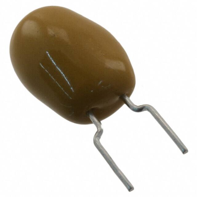

Radial Leaded Ceramic Disc Capacitors Safety Standard Recognized, C900, Encapsulated, AC Type, X1 440 VAC/Y2 300 VAC (Industrial Grade) Overview KEMET’s 900 encapsulated radial leaded ceramic disc capacitors are specifically designed for interference-suppression AC line filtering applications. Having internationally recognized safety certifications, these capacitors are well-suited for applications that require keeping potentially disruptive or damaging line transients and EMI out of susceptible equipment. They are also an ideal solution when needing to suppress line disturbances at the source. Safety Certified Capacitors are classified as either X and/ or Y capacitors. Class X capacitors are primarily used in line-to-line (across-the-line) applications. In this application, there is no danger of electric shock to humans should the capacitor fail, but could result in a risk of fire. The class Y capacitor is primarily used in line-to-ground (line by-pass) applications. In this application, failure of the capacitor could lead to danger of electric shock. With a working voltage of 440 VAC in line-to-line (Class X) and 300 VAC in line-to-ground (Class Y) applications, these safety capacitors meet the impulse test criteria outlined in IEC Standard 60384. Meeting subclass X1 and Y2 requirements, these devices are certified to withstand impulses up to 4 KV (X1) and 5 KV (Y2) respectively. These encapsulated devices also meet the flame test requirements outlined in UL Standard 94 V–0. Benefits • Safety standard recognized (IEC 60384–14) • Reliable operation up to 125°C • Class X1/Y2 • 7.5 and 10 mm lead spacing • Lead (Pb)-free and RoHS Compliant • Halogen-free • Capacitance offerings ranging from 10 pF up to 10 nF • Available capacitance tolerances of ±5%, ±10%, and ±20% • High reliability • Preformed (crimped) or straight lead configurations • Non-polar device, minimizing installation concerns • Encapsulation meets flammability standard UL 94 V–0 Click image above for interactive 3D content Open PDF in Adobe Reader for full functionality Applications Typical applications include: • Line-to-line (Class X) filtering • Line-to-ground (Class Y) filtering • Antenna coupling • Primary and secondary coupling (switching power supplies) • Line disturbances suppression (motors and motor controls, relays, switching power supplies, and invertors) One world. One KEMET © KEMET Electronics Corporation • KEMET Tower • One East Broward Boulevard Fort Lauderdale, FL 33301 USA • 954-766-2800 • www.kemet.com C1065_X1_440 VAC_Y2_300 VAC • 05/23/19 1 Radial Leaded Ceramic Disc Capacitors Safety Standard Recognized, C900, Encapsulated, AC Type, X1 440 VAC/Y2 300 VAC (Industrial Grade) Ordering Information C9 7 1 U Ceramic Series Body Diameter Lead Spacing1,3 Spec. C9 = Ceramic 900 Series 0 = 7.0 mm 1 = 8.0 mm 2 = 9.0 mm 3 = 10.0 mm 4 = 11.0 mm 6 = 13.0 mm 8 = 15.0 mm 7 = 7.5 mm 1 = 10.0 mm 472 M Capacitance Capacitance Code (pF) Tolerance U= Safety Two significant digits and number of zeroes J = ±5% K = ±10% M = ±20% Z W D A A Rated Voltage Dielectric/ Lead Failure Design Temp. Char. Configuration2,3 Rate Z = X1 440 VAC /Y2 300 VAC S = SL Y = Y5P W = Y5U V = Y5V D= Disc A = Straight B = Vertical Kink C = Outside Kink A= N/A 7317 Packaging (C-Spec) See "Packaging C-Spec Ordering Options Table" Capacitor body diameter will limit available lead spacing and packaging options. See "Dimensions" and "Product Ordering Codes and Ratings" sections of this document to determine availability. 2 "Vertical Kink" and "Outside Kink" lead configurations cannot be combined with the bulk/20 mm lead length option (WL20). 20 mm lead length is only available on capacitors with straight leads (lead configuration ordering code "A"). For nonstandard lead length inquiries, please contact KEMET. 3 Bulk packaging lead length availability is dependent upon "Lead Configuration" and "Lead Spacing." See "Dimensions" section of this document to verify availability of a specific lead length option. For nonstandard lead length inquiries, please contact KEMET. 1 Packaging C-Spec Ordering Options Table Packaging Type Ammo Pack Bulk Bag Lead Length (mm)2,3 Packaging Ordering Code (C-Spec) See Note 5 3.0±1.0 3.5±1.0 4.0±1.0 4.5±1.0 5.0±1.0 20.0 minimum4 7317 WL30 WL35 WL40 WL45 WL50 WL20 Preformed (crimped) lead configurations include "Vertical Kink" and "Outside Kink." See "Lead Configurations" and "Ordering Information" sections of this document for further details. 2 "Vertical Kink" and "Outside Kink" lead configurations cannot be combined with the bulk/20 mm lead length option (WL20). 20 mm lead length is only available on capacitors with straight leads (lead configuration ordering code "A"). For nonstandard lead length inquiries, please contact KEMET. 3 For nonstandard lead length inquiries, please contact KEMET. 4 Lead length of 20.0 mm minimum only available for straight leads. 1 5 Lead length for ammo pack packaging is defined by the H and H0 dimensions in Table 3. © KEMET Electronics Corporation • KEMET Tower • One East Broward Boulevard Fort Lauderdale, FL 33301 USA • 954-766-2800 • www.kemet.com C1065_X1_440 VAC_Y2_300 VAC • 05/23/19 2 Radial Leaded Ceramic Disc Capacitors Safety Standard Recognized, C900, Encapsulated, AC Type, X1 440 VAC/Y2 300 VAC (Industrial Grade) Lead Configurations Straight Vertical Kink T D Outside Kink T D T D 3.0 Maximum 3.0 Maximum 3.0 Maximum 5.0 Maximum 4.0 Maximum LL LL F F S S LL F S Dimensions – Millimeters Lead Lead Configuration Configuration Ordering Code1 Straight A Vertical Kink (Preformed) B Outside Kink (Preformed) C S Lead Spacing2 Lead Spacing Tolerance 7.5 ±1.0 10.0 ±1.0 7.5 ±1.0 10.0 ±1.0 7.5 ±1.0 10.0 ±1.0 D T e ØF Body Diameter2 Body Thickness Lead Meniscus Lead Diameter 3.0 maximum 0.55±0.1 See Table 1 "Product Ordering Codes and Ratings" Lead Configuration is identified in the 13th character of the ordering code. See "Lead Configuration" and "Ordering Information" sections of this document for further details. 2 Body diameter of capacitor will limit available lead spacing and packaging options. See "Product Ordering Codes and Ratings" sections of this document for further details. 1 © KEMET Electronics Corporation • KEMET Tower • One East Broward Boulevard Fort Lauderdale, FL 33301 USA • 954-766-2800 • www.kemet.com C1065_X1_440 VAC_Y2_300 VAC • 05/23/19 3 Radial Leaded Ceramic Disc Capacitors Safety Standard Recognized, C900, Encapsulated, AC Type, X1 440 VAC/Y2 300 VAC (Industrial Grade) Approval Standard and Certification No. Safety Standard Standard No. VDE (ENEC) IEC 60384–14 UL CAN/CSA UL 60384–14 and E60384–14 Subclass Working Voltage X1 440 VAC Y2 300 VAC X1 440 VAC Y2 300 VAC Certificate No. 40036415 E356389 These devices are VDE/ENEC and UL recognized for antenna coupling and AC line-to-line (Class X) and line-to-ground (Class Y) applications per IEC60384–14 and UL 60384–14. Environmental Compliance These devices are Halogen-free and RoHS Compliant. They meet all requirements set forth by both EU and China RoHS directives. General Specifications/Performance Characteristics Dielectric/Temperature Characteristic SL Y5P Operating Temperature Range: Capacitance Change with Reference to +25°C and 0 VDC Applied (TCC): Y5V +20%/−55% ~ +30%/−80% −40°C to +125°C −1,000 ~ +350 ppm/ ºC ±10% Dielectric Withstanding Voltage (7.5 and 10 mm Lead Spacing) 2,600 VAC (60 ±5 seconds at 25ºC) Quality Factor (Q) 30 pF and above: ≥ 1,000 Below 30 pF: ≥ 400 +(20xC)* Dissipation Factor (tanδ) at +25ºC1 See “Quality Factor” Insulation Resistance (IR) Limit at +25°C Y5U See “Dissipation Factor” 2.50% 2.50% 5.0% 10,000 MΩ Minimum (500 VDC applied for 60 ±5 seconds at 25°C) *C = Nominal capacitance 1 Capacitance and Dissipation Factor (DF) measured under the following conditions: SL: 1 MHz ±100 kHz and 1.0 ±0.2 Vrms X5P, Y5U and Y5V: 1 kHz ±50 Hz and 1.0 ±0.2 Vrms Note: When measuring capacitance, it is important to ensure the set voltage level is held constant. The HP4284 and Agilent E4980 have a feature known as Automatic Level Control (ALC). The ALC feature should be switched to "ON." © KEMET Electronics Corporation • KEMET Tower • One East Broward Boulevard Fort Lauderdale, FL 33301 USA • 954-766-2800 • www.kemet.com C1065_X1_440 VAC_Y2_300 VAC • 05/23/19 4 Radial Leaded Ceramic Disc Capacitors Safety Standard Recognized, C900, Encapsulated, AC Type, X1 440 VAC/Y2 300 VAC (Industrial Grade) Table 1 – Product Ordering Codes and Ratings Dimensions (mm) Dielectric/ Temp. Char. KEMET Part Number Capacitance SL C90(1)U100JZSD(2)A(3) C90(1)U120JZSD(2)A(3) C90(1)U150JZSD(2)A(3) C90(1)U180JZSD(2)A(3) C90(1)U200JZSD(2)A(3) C90(1)U220JZSD(2)A(3) C90(1)U240JZSD(2)A(3) C90(1)U270JZSD(2)A(3) C90(1)U300JZSD(2)A(3) C90(1)U330JZSD(2)A(3) C90(1)U360JZSD(2)A(3) C90(1)U390JZSD(2)A(3) C90(1)U470JZSD(2)A(3) C90(1)U500JZSD(2)A(3) C90(1)U510JZSD(2)A(3) C91(1)U560JZSD(2)A(3) C91(1)U620JZSD(2)A(3) C91(1)U680JZSD(2)A(3) C91(1)U750JZSD(2)A(3) C92(1)U820JZSD(2)A(3) C93(1)U101JZSD(2)A(3) 10 pF 12 pF 15 pF 18 pF 20 pF 22 pF 24 pF 27 pF 30 pF 33 pF 36 pF 39 pF 47 pF 50 pF 51 pF 56 pF 62 pF 68 pF 75 pF 82 pF 100 pF C90(1)U101KZYD(2)A(3) C90(1)U151KZYD(2)A(3) C90(1)U221KZYD(2)A(3) C90(1)U331KZYD(2)A(3) C90(1)U471KZYD(2)A(3) C91(1)U561KZYD(2)A(3) C91(1)U681KZYD(2)A(3) C92(1)U821KZYD(2)A(3) C92(1)U102KZYD(2)A(3) 100 pF 150 pF 220 pF 330 pF 470 pF 560 pF 680 pF 820 pF 1,000 pF C90(1)U102MZWD(2)A(3) C92(1)U152MZWD(2)A(3) C92(1)U222MZWD(2)A(3) C94(1)U332MZWD(2)A(3) C96(1)U392MZWD(2)A(3) C96(1)U472MZWD(2)A(3) 1,000 pF 1,500 pF 2,200 pF 3,300 pF 3,900 pF 4,700 pF C90(1)U102MZVD(2)A(3) C90(1)U152MZVD(2)A(3) C90(1)U222MZVD(2)A(3) C92(1)U332MZVD(2)A(3) C94(1)U392MZVD(2)A(3) C94(1)U472MZVD(2)A(3) C96(1)U682MZVD(2)A(3) C98(1)U103MZVD(2)A(3) 1,000 pF 1,500 pF 2,200 pF 3,300 pF 3,900 pF 4,700 pF 6,800 pF 10,000 pF ±20% KEMET Part Number Capacitance Capacitance Tolerance Y5P Y5U Y5V Capacitance Tolerance Body Diameter (Maximum) Lead Spacing Body Thickness (Maximum) Lead Diameter 5.0 0.55±0.1 7.5 mm or 10 mm 5.0 0.55±0.1 7.5 mm or 10 mm 5.0 0.55±0.1 7.5 mm or 10 mm 5.0 0.55±0.1 7.5 mm or 10 mm Body Thickness (Maximum) Lead Diameter Lead Spacing Bulk Packaging Ammo Packaging 7.0 ±5% 8.0 9.0 10.0 7.0 ±10% 8.0 9.0 7.0 ±20% 9.0 11.0 13.0 7.0 9.0 11.0 13.0 15.0 Body Diameter (Maximum) (1) To properly complete ordering code, insert the one-digit numeric code to reflect required lead spacing: (Note that select capacitance values and packaging options may limit lead spacing availability. See table above to verify availability.) 7 = 7.5 mm 1 = 10.0 mm (2) To properly complete ordering code, insert the one-digit character code to reflect the required lead configuration: (See "Lead Configuration" section of this document, page 2, for further details.) A = Straight B = Vertical Kink C = Outside Kink (3) To properly complete ordering code, enter the four-digit numeric or alphanumeric "Packaging C-Spec Ordering Code." See "Dimensions" section of this document, page 2, for available options. © KEMET Electronics Corporation • KEMET Tower • One East Broward Boulevard Fort Lauderdale, FL 33301 USA • 954-766-2800 • www.kemet.com C1065_X1_440 VAC_Y2_300 VAC • 05/23/19 5 Radial Leaded Ceramic Disc Capacitors Safety Standard Recognized, C900, Encapsulated, AC Type, X1 440 VAC/Y2 300 VAC (Industrial Grade) Table 2 – Performance & Reliability: Test Methods and Conditions Item Specification −40ºC to +125ºC Operating Temperature Range Dielectric Strength Between lead wires No failures Body Insulation No failures Insulation Resistance (IR) 10,000 MΩ minimum Capacitance Within specified tolerance Dissipation Factor (DF) or Q Test Method Temperature Characteristics Specification Y5P, Y5U DF ≤ 2.5% Y5V DF ≤ 5.0% SL ≥ 30 pF: Q ≥ 1,000 < 30 pF: Q ≥ 400 +(20 x C) C = Nominal capacitance The capacitor shall not be damaged when 2,600 VAC (rms) is applied between the lead wires for 60 seconds. The terminals (leads) of the capacitor shall be connected together. A metal foil is tightly wrapped around the body of the capacitor at a distance of about 3 to 4 mm from each Metal about terminal. The capacitor is then inserted Foil 3 to 4 mm into a container filled with metal balls approximately 1 mm in diameter. 2,600 VAC Metal Balls (rms) is applied for 60 seconds between the capacitor lead wires and metal balls. The insulation resistance shall be measured with 500 ±50 VDC applied after 60 ±5 seconds of charging. Y5P, Y5U, and Y5V: Capacitance is measured at 1 kHz ±20% and 5 Vrms or less. (20±2°C) SL: Capacitance is measured at 1 MHz ±20% and 1.0 ±0.2 Vrms (25°C) A capacitance measurement is made at each step specified: Temperature Characteristics Temperature Characteristics Capacitance Change Y5P Within ±10% Y5U Within +20%/−55% Y5V Within ~+30%/−80% SL −1,000 ~+350 ppmºC (+20ºC ~+85ºC) Tensile Lead wire or capacitor body shall not break. Bending Lead wire or capacitor body shall not break. Terminal Strength 1 Step Temperature 1 +20±2ºC 2 −25±2ºC 3 +20±2ºC 4 +85±2ºC 5 +20±2ºC Pre-treatment: Capacitor is stored at 85±2ºC for 1 hour and then placed at room condition1 for 24±2 hours before measurement. With the termination in its normal position, the specimen is held by its body in such a manner that the axis of the termination is vertical; a tensile force of 10 N is applied to the termination in the direction of its axis and acting in a direction away from the body of the specimen. With the termination in its normal position, the specimen is held by its body in such a manner that the axis of the termination is vertical; a mass force of 5 N is then suspended from the end of the termination. The body of the specimen is then inclined within a period of 2 to 3 seconds, through an angle of approximately 90° in the vertical plane and then resumed to its initial position over the same period of time; this operation constitutes one bend. One bend immediately followed by a second bend in the opposite direction. “Room Condition” is defined as follows: Temperature: 15 ~ 35°C/Humidity: 45 ~ 75%/Atmospheric Pressure: 86 ~ 106 kPa. © KEMET Electronics Corporation • KEMET Tower • One East Broward Boulevard Fort Lauderdale, FL 33301 USA • 954-766-2800 • www.kemet.com C1065_X1_440 VAC_Y2_300 VAC • 05/23/19 6 Radial Leaded Ceramic Disc Capacitors Safety Standard Recognized, C900, Encapsulated, AC Type, X1 440 VAC/Y2 300 VAC (Industrial Grade) Table 2 – Performance & Reliability: Test Methods and Conditions cont'd Item Specification Lead wire should have a uniform coating of solder in the axial direction and over 3/4 of its circumference. Solderability Appearance No visual defect IR Dielectric Strength 1,000 MΩ Per item 1 Thermal Screen Soldering Effect (Non-Preheat) Capacitance Y5P, Y5U, and Y5V: Within ±10% SL: Within ±2.5% or ±0.25 pF, whichever is larger Appearance IR Dielectric Strength No visual defect 1,000 MΩ Per item 1 Capacitance Y5P, Y5U, and Y5V: Within ±10% SL: Within ±2.5% or ±0.25 pF, whichever is larger Appearance No visual defect Capacitance Biased Humidity DF Q IR Dielectric Strength Temperature Characteristics Capacitance Change Y5P Within ±10% Y5U Within ±20% Y5V Within ±30% SL Within ±2.5% or ±0.25 pF, whichever is larger Y5P and Y5U: 5.0% maximum Y5V: 7.5% maximum SL: Less than 30 pF: Q ≥ 100 + 10 × C/3 More than 30 pF: Q ≥ 200 C = Nominal capacitance Y5P, Y5V, and Y5U: 3,000 MΩ minimum SL: 1,000 MΩ minimum Capacitor 1.5 to 2.0 mm Molten Solder Pre-treatment: Capacitor is stored at 85°C ±2°C for 1 hour and then placed at room condition1 for 24 ±2 hours before initial measurements. Post-treatment: Capacitor is stored for 1 to 2 hours at room condition1. Capacitor is stored at 120°C +0/−5°C for 60 +0/−5 seconds. Then, as shown in the figure below, the lead wires are immersed in molten solder up to 1.5 mm (+5/-0mm) from the end of the epoxy meniscus (root of lead wire). Duration/Solder Temperature: 7.5 +0/−1 seconds/260°C ±5°C Thermal Screen Soldering Effect (Preheat) 1 Test Method The lead wire of the capacitor is dipped into molten solder for 5±0.5 seconds. The depth of immersion is up to 1.5 mm (+5/−0 mm) from the root of lead wires. Solder Temperature: Lead free solder (Sn-3Ag – 0.5 Cu) 245°C ±5°C. As shown in the figure below, the lead wires are immersed in molten solder up to 1.5 mm (+5/−0 mm) from the end of the epoxy meniscus (root of lead wire). Duration/Solder Temperature: 3.5±0.5 seconds/350°C ±10°C or 10±1 seconds/260°C ±5°C Capacitor 1.5 to 2.0 mm Molten Solder Pre-treatment: Capacitor is stored at 85°C ±2°C for 1 hour and then placed at room condition1 for 24 ±2 hours before initial measurements. Post-treatment: Capacitor is stored for 1 to 2 hours at room condition1. Steady State Humidity: Load Humidity: 90 to 95% humidity at 40°C ±2°C for 500 ±12 hours. 90 to 95% humidity at 40°C ±2°C for 500 ±12 hours with full rated voltage applied. Post Treatment: Capacitor is stored for 1 to 2 hours at room condition1. Post Treatment: Capacitor is stored for 1 to 2 hours at room condition1. No failures “Room Condition” is defined as follows: Temperature: 15 ~ 35°C/Humidity: 45 ~ 75%/Atmospheric Pressure: 86 ~ 106 kPa. © KEMET Electronics Corporation • KEMET Tower • One East Broward Boulevard Fort Lauderdale, FL 33301 USA • 954-766-2800 • www.kemet.com C1065_X1_440 VAC_Y2_300 VAC • 05/23/19 7 Radial Leaded Ceramic Disc Capacitors Safety Standard Recognized, C900, Encapsulated, AC Type, X1 440 VAC/Y2 300 VAC (Industrial Grade) Table 2 – Performance & Reliability: Test Methods and Conditions cont'd Item Specification Y5P, Y5V, and Y5U: Within ±20% SL: Within ±3 or ±0.3 pF, whichever is larger. 3,000 MΩ minimum SL: 1,000 MΩ minimum U PP No failures The capacitor flame extinguishes as follows: Cycle Time 1~4 30 seconds maximum 5 60 seconds maximum td (uS) 46 47 0.5Vp tr Dielectric Strength Flame Test 0.9Vp Cx tr (uF) (uS) 0.01 1.2 0.1 1.5 U PR Vp Voltage IR High Temperature Life Impulse Voltage: Each individual capacitor is subjected to three 5 kv impulses prior to life testing. No visual defect Appearance Capacitance Change Test Method Time td Capacitors are placed in a circulating air oven for a period of 1,000 hours. The air in the oven is maintained at a temperature of 125°C ±2 throughout the test. The capacitors are subjected to AC 510 Vrms. Each hour the voltage is increased to 1,000 Vrms for 0.1 seconds. The capacitor is exposed to a flame for 15 seconds and then removed for 15 seconds. This test is repeated for 5 cycles. Capacitor Flame 76 38 127 Gas Burner 20º (Unit:mm) The capacitors are individually wrapped in at least one, but not more than two, complete layers of cheesecloth. They are then subjected to 20 discharges. The interval between successive discharges is 5 seconds. The VAC is maintained for 2 minutes after the last discharge. F S1 Tr C1 S2 Vac L1 L2 C2 L3 C3 L4 R CX Ct Vt Oscilloscope Active Flammability The cheesecloth should not ignite. C1, 2 1 μF ±10% C3 0.033 μF ±5% 10 kV L1-4 1.5 Mh ±20% 16A Rod core choke Cx Test capacitor R 100±2% VAC VR ±5% Ct 3 μF ±5% 10 kV VR Rated Voltage F Fuse, Rated 10A Vt Voltage applied to Ct Vx 5kV time 1 “Room Condition” is defined as follows: Temperature: 15 ~ 35°C/Humidity: 45 ~ 75%/Atmospheric Pressure: 86 ~ 106 kPa. © KEMET Electronics Corporation • KEMET Tower • One East Broward Boulevard Fort Lauderdale, FL 33301 USA • 954-766-2800 • www.kemet.com C1065_X1_440 VAC_Y2_300 VAC • 05/23/19 8 Radial Leaded Ceramic Disc Capacitors Safety Standard Recognized, C900, Encapsulated, AC Type, X1 440 VAC/Y2 300 VAC (Industrial Grade) Table 2 – Performance & Reliability: Test Methods and Conditions cont'd Item Specification Test Method The capacitor under test is held into a flame and in a position which best promotes burning. Each specimen is exposed to the flame one time. Passive Flammability About 8mm The burning time should not exceed 30 seconds. The tissue paper should not ignite. Test Specimen 200 45º ±5mm Tissue About 10mm Thick Board Time of exposure to flame: Length of flame: Gas burner length: Inside diameter: Outside diameter: Gas butane gas purity: Appearance Capacitance Temperature Cycle No visual defect Temperature Characteristics Capacitance Change SL Within ±5% Y5P Within ±10% Y5U, Y5V Within ±20% SL ≥ 30 pF: Q ≥ 350 < 30 pF: Q ≥ 275 +5/2C C = Nominal capacitance DF/Q 1 30 seconds 12 ±1 mm 35 mm minimum 0.5 ±0.1 mm 0.9 mm maximum 95% minimum Y5P DF ≤ 5% Y5U, Y5V DF ≤ 7.5% IR 3,000 MΩ minimum Dielectric Strength No failures The capacitor is subjected to 5 temperature cycles. Temperature Cycle Step Dwell Transition Temperature (°C) Time Time (minutes) (minutes) 1 −40+0/−3 30 2 Room temperature 3 3 125+3/−0 30 4 Room temperature 3 3 Pre-treatment: Capacitor shall be stored at 85 ±2 for 1 hour then placed at room condition1 for 24 ±2 hours. Post-treatment: Capacitor is stored for 1 to 2 hours at room condition1. “Room Condition” is defined as follows: Temperature: 15 ~ 35°C/Humidity: 45 ~ 75%/Atmospheric Pressure: 86 ~ 106 kPa. © KEMET Electronics Corporation • KEMET Tower • One East Broward Boulevard Fort Lauderdale, FL 33301 USA • 954-766-2800 • www.kemet.com C1065_X1_440 VAC_Y2_300 VAC • 05/23/19 9 Radial Leaded Ceramic Disc Capacitors Safety Standard Recognized, C900, Encapsulated, AC Type, X1 440 VAC/Y2 300 VAC (Industrial Grade) Soldering and Mounting Information Soldering: When soldering this product to a PCB/PWB, do not exceed the solder heat resistance specification of the capacitor. Subjecting this product to excessive heating could reflow the solder joint between the lead and ceramic element and/or may result in thermal shocks that can crack the ceramic element. When soldering these capacitors with a soldering iron, it should be performed under the following conditions: • Temperature of iron-tip: 400ºC maximum • Soldering iron wattage: 50 W maximum • Soldering time: 3.5 seconds maximum Cleaning (ultrasonic cleaning): To perform ultrasonic cleaning, observe the following conditions: • Rinse bath capacity: Output of 20 watts per liter or less • Rinsing time: 5 minute maximum • Do not vibrate the PCB/PWB directly • Excessive ultrasonic cleaning may lead to fatigue destruction of the lead wires Construction Epoxy Encapsulation (0.4 mm Minimum Thickness, Pigment = Blue/UL 94 V-0) Detailed Cross Section Lead Attach Solder (Sn96.5/Ag3/Cu0.5) Dielectric Material (BaTiO3) Electrode (Ag – Glass Frit) Lead Attach Solder (Sn96.5/Ag3/Cu0. Electrode (Ag – Glass Frit) Lead Wire Steel Cu 100% Sn Finish Layer (3-7 µm) Core Metal Barrier Layer © KEMET Electronics Corporation • KEMET Tower • One East Broward Boulevard Fort Lauderdale, FL 33301 USA • 954-766-2800 • www.kemet.com Dielectric Material (BaTiO3) C1065_X1_440 VAC_Y2_300 VAC • 05/23/19 10 Radial Leaded Ceramic Disc Capacitors Safety Standard Recognized, C900, Encapsulated, AC Type, X1 440 VAC/Y2 300 VAC (Industrial Grade) Marking These capacitors shall be stamped or laser marked with KEMET's trademark, type designation, capacitor class, rated voltage, rated capacitance, and capacitance tolerance codes. In addition, all devices are marked with the recognized approval mark and a date/lot code for traceability. Marking will be supplied either on one side or both sides of the encapsulated capacitor body. All marking shall be legible to allow for clear identification of the component. Marking appears in legible contrast. Illustrated below is an example of the marking format and content. (Two-sided marking is limited to capacitors with body diameters ≤ 8.0 mm) Single Sided Rated Capacitance (3 Numeric Characters) KEMET ID Type Designation (2 Characters) Capacitance Tolerance Code (1 Character) VDE & ENEC approval marks IEC 60384-14 3rd (2005) Date/Lot Code (See Table Below) Capacitor Class and Rated Voltage UL approval mark Double Sided Front Back Rated Capacitance (3 Numeric Characters) KEMET ID Capacitance Tolerance Code (1 Character) Type Designation (2 Characters) Capacitor Class and Rated Voltage UL approval mark VDE & ENEC approval marks IEC 60384-14 3rd (2005) Date/Lot Code (See Table Below) Date/Lot Code Explanation 6 Last digit of year, e.g., 6 = 2016 C 6 1234 Manufacturing Month: Manufacturing Location Code 1-9 = Jan - Sept A = October N = November D = December Last 4 digits of lot number © KEMET Electronics Corporation • KEMET Tower • One East Broward Boulevard Fort Lauderdale, FL 33301 USA • 954-766-2800 • www.kemet.com C1065_X1_440 VAC_Y2_300 VAC • 05/23/19 11 Radial Leaded Ceramic Disc Capacitors Safety Standard Recognized, C900, Encapsulated, AC Type, X1 440 VAC/Y2 300 VAC (Industrial Grade) Packaging Quantities Capacitor Body Diameter (mm) Body Diameter Code1 7.0 0 8.0 1 9.0 2 10.0 3 11.0 4 12.0 5 13.0 6 14.0 7 15.0 8 Bulk Bag (Loose) Ammo Pack (Carrier Tape) Component pitch on carrier tape2 12.7 mm 15 mm 25.4 mm 1,000 pieces/box 500 pieces/bag 1,000 pieces/box 500 pieces/box The "Body Diameter Code" is located in the third character position of the ordering code. This code identifies the maximum diameter of the capacitor body in millimeters. For more information regarding the ordering code, see "Ordering Information" section of this document. 2 For details regarding component pitch on carrier tape, see "Ammo Pack Taping Format" and "Ammo Pack Taping Specifications" sections of this document. 1 © KEMET Electronics Corporation • KEMET Tower • One East Broward Boulevard Fort Lauderdale, FL 33301 USA • 954-766-2800 • www.kemet.com C1065_X1_440 VAC_Y2_300 VAC • 05/23/19 12 Radial Leaded Ceramic Disc Capacitors Safety Standard Recognized, C900, Encapsulated, AC Type, X1 440 VAC/Y2 300 VAC (Industrial Grade) Figure 1 - Ammo Pack Taping Format 5 mm and 7.5 mm Lead Spacing: P2 P For All Lead Spacing: ∆S D ∆h1 e P1 Ød F T maximum Marking Side W2 L W1 W0 ℓ P0 0 ∆h2 W t2 ØD0 t1 10 mm Lead Spacing: P2 P ∆S D e P1 F Ød L W2 W1 W0 P0 H H0 W ØD0 ℓ Table 3 – Ammo Pack Taping Specifications Lead Spacing 5 mm Lead Style Item Straight Preformed1 Symbol 7.5 mm Straight Preformed1 10 mm Straight Preformed1 Dimensions (mm) Lead Spacing F 5.0+0.8/−0.2 7.5±1.0 10.0±1.0 Component Pitch P 12.7 15.0 25.4±2 Sprocket Hole Pitch P0 12.7±0.3 15.0±0.3 12.7±0.3 Sprocket Hole Center to Component Center P2 6.35±1.5 7.5±1.5 12.7±1.5 Sprocket Hole Center to Lead Center P1 3.75±1.0 3.75±1.0 7.7±1.5 Body Diameter D See "Product Ordering Codes and Ratings" section of this document. Component Alignment (side/side) ∆S 0±2.0 Carrier Tape Width W 18.0+1.0/−0.5 Prefromed (crimped) lead configurations include vertical kink and outside kink. See "Lead Configurations" and "Ordering Information" sections of this document for further details. 2 Also referred to as "lead length" in this document. 1 © KEMET Electronics Corporation • KEMET Tower • One East Broward Boulevard Fort Lauderdale, FL 33301 USA • 954-766-2800 • www.kemet.com C1065_X1_440 VAC_Y2_300 VAC • 05/23/19 13 Radial Leaded Ceramic Disc Capacitors Safety Standard Recognized, C900, Encapsulated, AC Type, X1 440 VAC/Y2 300 VAC (Industrial Grade) Table 3 – Ammo Pack Taping Specifications cont'd Lead Spacing 5 mm Lead Style Straight Item 7.5 mm Preformed 1 Straight 10 mm Preformed 1 Straight Preformed1 Symbol Dimensions (mm) Sprocket Hole Position W1 9.0±0.5 Height to Seating Plane (preformed leads1) H0 N/A 18.0+2.0/−0 N/A 18.0+2.0/−0 N/A 18.0+2.0/−0 Height to Seating Plane2 (straight leads) H 20.0+1.5/−1.0 N/A 20.0+1.5/−1.0 N/A 20.0+1.5/−1.0 N/A Lead Protrusion ℓ 2.0 maximum Diameter of Sprocket Hole D0 4.0±0.2 Lead Diameter φd 0.55±0.1 Carrier Tape Thickness t1 0.6±0.3 Total Thickness (Carrier Tape, Hold-Down Tape and Lead) t2 1.5 maximum Component Alignment (front/ back ) ∆h1 ∆h2 2.0 maximum 2 Cut Out Length L Hold-Down Tape Width W0 11.0 minimum 11.0 maximum 11.5 minimum Hold-Down Tape Position W2 3.0 maximum 1.5±1.5 Prefromed (crimped) lead configurations include vertical kink and outside kink. See "Lead Configurations" and "Ordering Information" sections of this document for further details. 2 Also referred to as "lead length" in this document. 1 Application Notes: Storage and Operating Conditions: The insulating coating of these devices does not form an air and moisture-tight seal. Avoid exposure to moisture and do not use or store these devices in a corrosive atmosphere, especially where chloride gas, sulfide gas, acid, alkali, salt, or the like are present. Before cleaning, bonding or molding these devices, it is important to verify that your process does not affect product quality and performance. KEMET recommends testing and evaluating the performance of a cleaned, bonded or molded product prior to implementing and/or qualifying any of these processes. Store the capacitors where the temperature and relative humidity do not exceed 40 degrees Centigrade and 70% respectively. For optimum solderability, capacitor stock should be used promptly, preferably within 6 months of receipt. Working Voltage: Application voltage (Vp-p or Vo-p) must not exceed the voltage rating of the capacitor. Irregular voltages can be generated for a transient period of time when voltage is initially applied and/or removed from a circuit. It is important to choose a capacitor with a voltage rating greater than or equal to these irregular voltages. © KEMET Electronics Corporation • KEMET Tower • One East Broward Boulevard Fort Lauderdale, FL 33301 USA • 954-766-2800 • www.kemet.com C1065_X1_440 VAC_Y2_300 VAC • 05/23/19 14 Radial Leaded Ceramic Disc Capacitors Safety Standard Recognized, C900, Encapsulated, AC Type, X1 440 VAC/Y2 300 VAC (Industrial Grade) Operating Temperature and Self-Generating Heat: The surface temperature of a capacitor should be kept below the upper limit of its rated operating temperature range. Be sure to take into account the heat generated by the capacitor itself. When the capacitor is used in a high-frequency current, pulse current or similar current, it may self-generate heat due to dielectric loss. Temperature rise due to self-generated heating should not exceed 20°C (while operated at an atmosphere temperature of 25°C). Handling - Vibration and Impact: Do not expose these devices or their leads to excessive shock or vibration during use. FAILURE TO FOLLOW THE ABOVE CAUTIONS MAY RESULT, WORST CASE, IN A SHORT CIRCUIT AND CAUSE FUMING OR PARTIAL DISPERSION WHEN THE PRODUCT IS USED. © KEMET Electronics Corporation • KEMET Tower • One East Broward Boulevard Fort Lauderdale, FL 33301 USA • 954-766-2800 • www.kemet.com C1065_X1_440 VAC_Y2_300 VAC • 05/23/19 15 Radial Leaded Ceramic Disc Capacitors Safety Standard Recognized, C900, Encapsulated, AC Type, X1 440 VAC/Y2 300 VAC (Industrial Grade) KEMET Electronics Corporation Sales Offices For a complete list of our global sales offices, please visit www.kemet.com/sales. Disclaimer All product specifications, statements, information and data (collectively, the “Information”) in this datasheet are subject to change. The customer is responsible for checking and verifying the extent to which the Information contained in this publication is applicable to an order at the time the order is placed. All Information given herein is believed to be accurate and reliable, but it is presented without guarantee, warranty, or responsibility of any kind, expressed or implied. Statements of suitability for certain applications are based on KEMET Electronics Corporation’s (“KEMET”) knowledge of typical operating conditions for such applications, but are not intended to constitute – and KEMET specifically disclaims – any warranty concerning suitability for a specific customer application or use. The Information is intended for use only by customers who have the requisite experience and capability to determine the correct products for their application. Any technical advice inferred from this Information or otherwise provided by KEMET with reference to the use of KEMET’s products is given gratis, and KEMET assumes no obligation or liability for the advice given or results obtained. Although KEMET designs and manufactures its products to the most stringent quality and safety standards, given the current state of the art, isolated component failures may still occur. Accordingly, customer applications which require a high degree of reliability or safety should employ suitable designs or other safeguards (such as installation of protective circuitry or redundancies) in order to ensure that the failure of an electrical component does not result in a risk of personal injury or property damage. Although all product–related warnings, cautions and notes must be observed, the customer should not assume that all safety measures are indicted or that other measures may not be required. KEMET is a registered trademark of KEMET Electronics Corporation. © KEMET Electronics Corporation • KEMET Tower • One East Broward Boulevard Fort Lauderdale, FL 33301 USA • 954-766-2800 • www.kemet.com C1065_X1_440 VAC_Y2_300 VAC • 05/23/19 16

物料型号:KEMET的C900系列,这是一系列被封装的径向引线陶瓷圆盘电容器。
器件简介:这些电容器专为干扰抑制交流线路滤波应用而设计。它们具有国际认可的安全认证,适合用于需要防止潜在破坏性或有害线路瞬变和电磁干扰进入敏感设备的场合。
引脚分配:电容具有不同的引脚间距和引脚配置选项,包括直引脚、垂直弯曲引脚和外部弯曲引脚。
参数特性:电容的工作电压为线对线(Class X)440 VAC和线对地(Class Y)300 VAC。满足IEC标准60384的脉冲测试标准,分别满足子类X1和Y2的要求,能够承受高达4 KV(X1)和5 KV(Y2)的脉冲。此外,这些被封装的设备还满足UL标准94 V-0的火焰测试要求。
功能详解:电容符合IEC 60384-14标准,可靠运行温度高达125°C。它们是无铅和符合RoHS标准的,并且是无卤的。电容范围从10 pF到10 nF,具有±5%、±10%和±20%的容差选项。
应用信息:典型应用包括线路对线路(Class X)滤波、线路对地(Class Y)滤波、天线耦合、一次和二次耦合(开关电源)、线路干扰抑制(电机和电机控制器、继电器、开关电源和逆变器)。
封装信息:电容的封装满足UL 94 V-0的易燃性标准。它们还提供了预成型(折叠)或直引脚配置。
