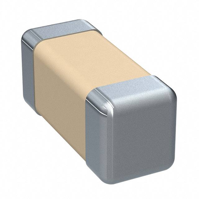

Surface Mount Multilayer Ceramic Capacitors (SMD MLCCs) for High Power Applications HiQ-CBR Series, C0G Dielectric, Low ESR 6.3 – 500 VDC, 1 MHz – 50 GHz (RF & Microwave) Overview KEMET’s CBR Series surface mount multilayer ceramic capacitors (MLCCs) in C0G dielectric feature a robust and exceptionally stable copper electrode dielectric system that offers excellent low loss performance (high Q). These devices provide extremely low ESR and high self-resonance characteristics, and are well-suited for resonant circuit applications or those where Q and stability of capacitance characteristics are required. CBR Series capacitors exhibit no change in capacitance with respect to time and voltage, and boast a negligible change in capacitance with reference to ambient temperature. Capacitance change is limited to ±30 ppm/°C from −55°C to +125°C. CBR Series devices are suitable for many circuit applications including RF power amplifiers, mixers, oscillators, low noise amplifiers, filter networks, antenna tuning, timing circuits, delay lines, and MRI imaging coils. Benefits • High Q and low ESR • High SRF • High thermal stability • 1 MHz to 50 GHz frequency range • Operating temperature range of −55°C to +125°C • Base metal electrode (BME) dielectric system • Pb-free and RoHS compliant • 0201, 0402, 0603, and 0805 case sizes (inches) • DC voltage ratings of 6.3 V, 10 V, 25 V, 50 V, 100 V, 200 V, 250 V, and 500 V • Capacitance offerings ranging from 0.1 pF up to 100 pF Click image above for interactive 3D content Open PDF in Adobe Reader for full functionality Ordering Information CBR 02 C 330 F 9 G Series Case Size (L"x W") Specification/ Series Capacitance Code (pF) Capacitance Tolerance Rated Voltage (VDC) Dielectric 02 = 0201 04 = 0402 06 = 0603 08 = 0805 C = Standard Two significant digits and number of zeros Use 9 for 1.0 – 9.9 pF Use 8 for 0.1 – 0.99 pF e.g., 2.2 pF = 229 e.g., 0.5 pF = 508 A = ±0.05 pF B = ±0.1 pF C = ±0.25 pF D = ±0.5 pF F = ±1% G = ±2% J = ±5% CBR 1 9 = 6.3 V 8 = 10 V 3 = 25 V 5 = 50 V 1 = 100 V 2 = 200 V A = 250 V C = 500 V G = C0G A C Termination Termination Finish Style A = N/A C = 100% Matte Sn Packaging/ Grade (C-Spec)1 Blank = 7" Reel Unmarked When ordering CBR Series devices, a "suffix" or "C-Spec" is not required to indicate a 7" reel packaging option. CBR devices are only available and shipped on 7" reels (paper tape). Bulk bag and cassette packaging options are not available. Please contact KEMET if you have a specific, non-standard packaging requirement. One world. One KEMET © KEMET Electronics Corporation • KEMET Tower • One East Broward Boulevard Fort Lauderdale, FL 33301 USA • 954-766-2800 • www.kemet.com C1030_C0G_CBR • 7/9/2019 1 Surface Mount Multilayer Ceramic Capacitors (SMD MLCCs) for High Power Applications HiQ-CBR Series, C0G Dielectric, Low ESR 6.3 – 500 VDC, 1 MHz – 50 GHz (RF & Microwave) Benefits cont. • Available capacitance tolerances of ±0.05 pF, ±0.1 pF, ±0.25 pF, ±0.5 pF, ±1%, ±2%, and ±5% • No piezoelectric noise • No capacitance change with respect to applied rated DC voltage • Negligible capacitance change with respect to temperature • No capacitance decay with time • Non-polar device, minimizing installation concerns • 100% pure matte tin-plated termination finish allowing for excellent solderability Applications Typical applications include critical timing, tuning, bypass, coupling, feedback, filtering, impedance matching and DC blocking. Field applications include wireless and cellular base stations, wireless LAN, subscriber-based wireless services, wireless broadcast equipment, satellite communications, RF power amplifier (PA) modules, filters, voltage-controlled oscillators (VCOs), PAs, matching networks, RF modules, satellite communications and medical electronics. Qualification RF and microwave products are subject to internal qualification. Details regarding test methods and conditions are referenced in Table 4, Performance & Reliability. Environmental Compliance Pb-free and RoHS compliant. © KEMET Electronics Corporation • KEMET Tower • One East Broward Boulevard Fort Lauderdale, FL 33301 USA • 954-766-2800 • www.kemet.com C1030_C0G_CBR • 7/9/2019 2 Surface Mount Multilayer Ceramic Capacitors (SMD MLCCs) for High Power Applications HiQ-CBR Series, C0G Dielectric, Low ESR 6.3 – 500 VDC, 1 MHz – 50 GHz (RF & Microwave) Dimensions – Millimeters (Inches) W L T B Case Size (in.) Case Size (mm) L Length W Width T Thickness B Bandwidth 0201 0603 0402 1005 0603 1608 0805 2012 0.60±0.03 (0.024±0.001) 1.00±0.05 (0.040±0.002) 1.60±0.10 (0.063±0.004) 2.00±0.20 (0.079±0.008) 0.30±0.03 (0.012±0.001) 0.50±0.05 (0.020±0.002) 0.80±0.10 (0.031±0.004) 1.25±0.20 (0.049±0.008) 0.30±0.03 (0.012±0.001) 0.50±0.05 (0.020±0.002) 0.80±0.07 (0.031±0.003) 0.85±0.10 (0.031±0.004) 0.15±0.05 (0.006±0.002) 0.25+0.05/−0.10 (0.010+0.002/−0.004) 0.40±0.15 (0.016±0.006) 0.50±0.20 (0.020±0.008) Mounting Technique Solder Reflow Only Solder Wave or Solder Reflow Electrical Parameters/Characteristics Item Parameters/Characteristics Operating Temperature Range: Capacitance Change with Reference to +25°C and 0 VDC Applied (TCC): Aging Rate (Maximum % Capacitance Loss/Decade Hour): Dielectric Withstanding Voltage (DWV): 1 2 3 Quality Factor (Q): Insulation Resistance (IR) Limit at 25°C: −55°C to +125°C 0 ±30 ppm/°C (0 ±60 ppm/°C for 0201 case size product ≥ 22 pF) 0% See Dielectric Withstanding Voltage Table (5±1 seconds and charge/discharge not exceeding 50 mA) ≥ 1,000 for capacitance values ≥ 30 pF ≥ 400 + 20°C for capacitance values < 30 pF (C = Capacitance in pF) 10 GΩ minimum (rated voltage applied for 120±5 seconds) DWV is the voltage a capacitor can withstand (survive) for a short period of time. It exceeds the nominal and continuous working voltage of the capacitor. 2 Capacitance and quality factor (Q) measured at 1 MHz ±100 kHz and 1.0 ±0.2 Vrms. 3 To obtain IR limit, divide MΩ-µF value by the capacitance and compare to GΩ limit. Select the lower of the two limits. Note: When measuring capacitance it is important to ensure the set voltage level is held constant. The HP4284 & Agilent E4980 have a feature known as Automatic Level Control (ALC). The ALC feature should be switched to "ON." 1 © KEMET Electronics Corporation • KEMET Tower • One East Broward Boulevard Fort Lauderdale, FL 33301 USA • 954-766-2800 • www.kemet.com C1030_C0G_CBR • 7/9/2019 3 Surface Mount Multilayer Ceramic Capacitors (SMD MLCCs) for High Power Applications HiQ-CBR Series, C0G Dielectric, Low ESR 6.3 – 500 VDC, 1 MHz – 50 GHz (RF & Microwave) Dielectric Withstanding Voltage Table Rated Voltage (VDC) ≤100 V 200 V 250 V 500 V DWV 250% 200% 200% 150% Electrical Characteristics SRF (MHz) vs. Cap (pF) 100,000 0201 SRF (MHz) 0402 0603 10,000 0805 1,000 100 0.1 1 Cap (pF) 10 100 © KEMET Electronics Corporation • KEMET Tower • One East Broward Boulevard Fort Lauderdale, FL 33301 USA • 954-766-2800 • www.kemet.com C1030_C0G_CBR • 7/9/2019 4 Surface Mount Multilayer Ceramic Capacitors (SMD MLCCs) for High Power Applications HiQ-CBR Series, C0G Dielectric, Low ESR 6.3 – 500 VDC, 1 MHz – 50 GHz (RF & Microwave) Electrical Characteristics cont. Q vs. Frequency 0402 ESR vs. Frequency 0402 10,000 1 1.8pF 1,000 4.7pF 4.7pF 10pF 0.1 18pF Q ESR (Ohms) 1.8pF 10pF 100 18pF 22pF 22pF 10 0.01 100 1,000 Freq (MHz) 10,000 1 100 ESR vs. Frequency 0603 10,000 Q vs. Frequency 0603 10,000 1 2.2pF 1,000 2.2pF 4.7pF 4.7pF 10pF 0.1 10pF Q ESR (Ohms) 1,000 Freq (MHz) 20pF 20pF 100 47pF 47pF 10 0.01 100 1,000 Freq (MHz) 1 100 10,000 ESR vs. Frequency 0805 10,000 2.2pF 1,000 2.2pF 10pF 33pF 0.1 33pF Q 10pF 47pF 100 100pF 47pF 100pF 0.01 100 10,000 Q vs. Frequency 0805 1 ESR (Ohms) 1,000 Freq (MHz) 1,000 Freq (MHz) 10,000 © KEMET Electronics Corporation • KEMET Tower • One East Broward Boulevard Fort Lauderdale, FL 33301 USA • 954-766-2800 • www.kemet.com 10 1 100 1,000 Freq (MHz) C1030_C0G_CBR • 7/9/2019 10,000 5 Surface Mount Multilayer Ceramic Capacitors (SMD MLCCs) for High Power Applications HiQ-CBR Series, C0G Dielectric, Low ESR 6.3 – 500 VDC, 1 MHz – 50 GHz (RF & Microwave) Table 1 – CBR Series, Capacitance Range Waterfall Case Size – Inches (mm) Length Width Thickness Bandwidth mm (Inches) mm (Inches) mm (Inches) mm (Inches) 0201 (0603) 0402 (1005) 0603 (1608) 0805 (2012) 0.60 ± 0.03 (0.024 ± 0.001) 0.30 ± 0.03 (0.012 ± 0.001) 0.30 ± 0.03 (0.012 ± 0.001) 0.15 ± 0.05 (0.006 ± 0.002) 1.00 ± 0.05 (0.040 ± 0.002) 0.50 ± 0.05 (0.020 ± 0.002) 0.50 ± 0.05 (0.020 ± 0.002) 0.25 + 0.05 / -0.10 (0.010 + 0.002 / -0.004) 1.60 ± 0.10 (0.063 ± 0.004) 0.80 ± 0.10 (0.031 ± 0.004) 0.80 ± 0.07 (0.031 ± 0.003) 0.40 ± 0.15 (0.016 ± 0.006) 2.00 ± 0.20 (0.079 ± 0.008) 1.25 ± 0.20 (0.049 ± 0.008) 0.85 ± 0.10 (0.031 ± 0.004) 0.50 ± 0.20 (0.020 ± 0.008) Rated Voltage (VDC) 6.3 10 25 50 25 Voltage Code 9 8 3 5 3 108* 208 308 408 508 608 708 808 908 109 119 129 139 149 159 169 179 189 199 209 219 229 239 249 259 269 279 289 299 309 319 329 339 349 359 369 379 389 399 409 419 429 439 449 459 469 479 489 499 108* 208 308 408 508 608 708 808 908 109 119 129 139 149 159 169 179 189 199 209 219 229 239 249 259 269 279 289 299 309 319 329 339 349 359 369 379 389 399 409 419 429 439 449 459 469 479 489 499 108* 208 308 408 508 608 708 808 908 109 119 129 139 149 159 169 179 189 199 209 219 229 239 249 259 269 279 289 299 309 319 329 339 349 359 369 379 389 399 409 419 429 439 449 459 469 479 489 499 108* 208 308 408 508 608 708 808 908 109 119 129 139 149 159 169 179 189 199 209 219 229 239 249 259 269 279 289 299 309 319 329 339 349 359 369 379 389 399 409 419 429 439 449 459 469 479 489 499 108 208 308 408 508 608 708 808 908 109 119 129 139 149 159 169 179 189 199 209 219 229 239 249 259 269 279 289 299 309 319 329 339 349 359 369 379 389 399 409 419 429 439 449 459 469 479 489 499 108 208 308 408 508 608 708 808 908 109 119 129 139 149 159 169 179 189 199 209 219 229 239 249 259 269 279 289 299 309 319 329 339 349 359 369 379 389 399 409 419 429 439 449 459 469 479 489 499 108* 208 308 408 508 608 708 808 908 109 119 129 139 149 159 169 179 189 199 209 219 229 239 249 259 269 279 289 299 309 319 329 339 349 359 369 379 389 399 409 419 429 439 449 459 469 479 489 499 108* 208 308 408 508 608 708 808 908 109 119 129 139 149 159 169 179 189 199 209 219 229 239 249 259 269 279 289 299 309 319 329 339 349 359 369 379 389 399 409 419 429 439 449 459 469 479 489 499 308 408 508 608 708 808 908 109 119 129 139 149 159 169 179 189 199 209 219 229 239 249 259 269 279 289 299 309 319 329 339 349 359 369 379 389 399 409 419 429 439 449 459 469 479 489 499 308 408 508 608 708 808 908 109 119 129 139 149 159 169 179 189 199 209 219 229 239 249 259 269 279 289 299 309 319 329 339 349 359 369 379 389 399 409 419 429 439 449 459 469 479 489 499 Rated Voltage (VDC) 6.3 10 25 50 25 50 100 200 50 Voltage Code 9 8 3 5 3 5 1 2 5 Capacitance Capacitance Tolerance 0.1 pF 0.2 pF 0.3 pF 0.4 pF 0.5 pF 0.6 pF 0.7 pF 0.8 pF 0.9 pF 1.0 pF 1.1 pF 1.2 pF 1.3 pF 1.4 pF 1.5 pF 1.6 pF 1.7 pF 1.8 pF 1.9 pF 2.0 pF 2.1 pF 2.2 pF 2.3 pF 2.4 pF 2.5 pF 2.6 pF 2.7 pF 2.8 pF 2.9 pF 3.0 pF 3.1 pF 3.2 pF 3.3 pF 3.4 pF 3.5 pF 3.6 pF 3.7 pF 3.8 pF 3.9 pF 4.0 pF 4.1 pF 4.2 pF 4.3 pF 4.4 pF 4.5 pF 4.6 pF 4.7 pF 4.8 pF 4.9 pF A = ±0.05 pF B = ±0.1 pF A = ±0.05 pF B = ±0.1 pF C = ±0.25 pF 50 100 200 50 5 1 2 5 100 250 50 100 250 500 1 A 5 1 A C 308 408 508 608 708 808 908 109 119 129 139 149 159 169 179 189 199 209 219 229 239 249 259 269 279 289 299 309 319 329 339 349 359 369 379 389 399 409 419 429 439 449 459 469 479 489 499 308 408 508 608 708 808 908 109 119 129 139 149 159 169 179 189 199 209 219 229 239 249 259 269 279 289 299 309 319 329 339 349 359 369 379 389 399 409 419 429 439 449 459 469 479 489 499 308 408 508 608 708 808 908 109 119 129 139 149 159 169 179 189 199 209 219 229 239 249 259 269 279 289 299 309 319 329 339 349 359 369 379 389 399 409 419 429 439 449 459 469 479 489 499 308 408 508 608 708 808 908 109 119 129 139 149 159 169 179 189 199 209 219 229 239 249 259 269 279 289 299 309 319 329 339 349 359 369 379 389 399 409 419 429 439 449 459 469 479 489 499 308 408 508 608 708 808 908 109 119 129 139 149 159 169 179 189 199 209 219 229 239 249 259 269 279 289 299 309 319 329 339 349 359 369 379 389 399 409 419 429 439 449 459 469 479 489 499 100 250 50 100 250 500 1 A 5 1 A C Capacitance Code (Available Capacitance) *Available only in "B" ( ±0.1pF) capacitance tolerance. © KEMET Electronics Corporation • KEMET Tower • One East Broward Boulevard Fort Lauderdale, FL 33301 USA • 954-766-2800 • www.kemet.com C1030_C0G_CBR • 7/9/2019 6 Surface Mount Multilayer Ceramic Capacitors (SMD MLCCs) for High Power Applications HiQ-CBR Series, C0G Dielectric, Low ESR 6.3 – 500 VDC, 1 MHz – 50 GHz (RF & Microwave) Table 1 – CBR Series, Capacitance Range Waterfall cont. Case Size – Inches (mm) Length Width Thickness Bandwidth mm (Inches) mm (Inches) mm (Inches) mm (Inches) Rated Voltage (VDC) 6.3 Voltage Code 9 Capacitance Capacitance Tolerance 0201 (0603) 0402 (1005) 0603 (1608) 0805 (2012) 0.60 ± 0.03 (0.024 ± 0.001) 0.30 ± 0.03 (0.012 ± 0.001) 0.30 ± 0.03 (0.012 ± 0.001) 0.15 ± 0.05 (0.006 ± 0.002) 1.00 ± 0.05 (0.040 ± 0.002) 0.50 ± 0.05 (0.020 ± 0.002) 0.50 ± 0.05 (0.020 ± 0.002) 0.25 + 0.05 / -0.10 (0.010 + 0.002 / -0.004) 1.60 ± 0.10 (0.063 ± 0.004) 0.80 ± 0.10 (0.031 ± 0.004) 0.80 ± 0.07 (0.031 ± 0.003) 0.40 ± 0.15 (0.016 ± 0.006) 2.00 ± 0.20 (0.079 ± 0.008) 1.25 ± 0.20 (0.049 ± 0.008) 0.85 ± 0.10 (0.031 ± 0.004) 0.50 ± 0.20 (0.020 ± 0.008) 10 25 50 25 8 3 5 3 50 100 200 50 5 1 2 5 100 250 50 100 250 500 1 A 5 1 A C Capacitance Code (Available Capacitance) A = ±0.05 pF B = ±0.1 pF C = ±0.25 pF 509 509 509 509 509 509 509 509 509 509 509 509 509 509 509 B = ±0.1 pF C = ±0.25 pF D = ±0.5 pF 519 529 539 549 559 569 579 589 599 609 619 629 639 649 659 669 679 689 699 709 719 729 739 749 759 769 779 789 799 809 819 829 839 849 859 869 879 889 899 909 919 929 939 949 959 519 529 539 549 559 569 579 589 599 609 619 629 639 649 659 669 679 689 699 709 719 729 739 749 759 769 779 789 799 809 819 829 839 849 859 869 879 889 899 909 919 929 939 949 959 519 529 539 549 559 569 579 589 599 609 619 629 639 649 659 669 679 689 699 709 719 729 739 749 759 769 779 789 799 809 819 829 839 849 859 869 879 889 899 909 919 929 939 949 959 519 529 539 549 559 569 579 589 599 609 619 629 639 649 659 669 679 689 699 709 719 729 739 749 759 769 779 789 799 809 819 829 839 849 859 869 879 889 899 909 919 929 939 949 959 519 529 539 549 559 569 579 589 599 609 619 629 639 649 659 669 679 689 699 709 719 729 739 749 759 769 779 789 799 809 819 829 839 849 859 869 879 889 899 909 919 929 939 949 959 519 529 539 549 559 569 579 589 599 609 619 629 639 649 659 669 679 689 699 709 719 729 739 749 759 769 779 789 799 809 819 829 839 849 859 869 879 889 899 909 919 929 939 949 959 519 529 539 549 559 569 579 589 599 609 619 629 639 649 659 669 679 689 699 709 719 729 739 749 759 769 779 789 799 809 819 829 839 849 859 869 879 889 899 909 919 929 939 949 959 519 529 539 549 559 569 579 589 599 609 619 629 639 649 659 669 679 689 699 709 719 729 739 749 759 769 779 789 799 809 819 829 839 849 859 869 879 889 899 909 919 929 939 949 959 519 529 539 549 559 569 579 589 599 609 619 629 639 649 659 669 679 689 699 709 719 729 739 749 759 769 779 789 799 809 819 829 839 849 859 869 879 889 899 909 919 929 939 949 959 519 529 539 549 559 569 579 589 599 609 619 629 639 649 659 669 679 689 699 709 719 729 739 749 759 769 779 789 799 809 819 829 839 849 859 869 879 889 899 909 919 929 939 949 959 519 529 539 549 559 569 579 589 599 609 619 629 639 649 659 669 679 689 699 709 719 729 739 749 759 769 779 789 799 809 819 829 839 849 859 869 879 889 899 909 919 929 939 949 959 519 529 539 549 559 569 579 589 599 609 619 629 639 649 659 669 679 689 699 709 719 729 739 749 759 769 779 789 799 809 819 829 839 849 859 869 879 889 899 909 919 929 939 949 959 519 529 539 549 559 569 579 589 599 609 619 629 639 649 659 669 679 689 699 709 719 729 739 749 759 769 779 789 799 809 819 829 839 849 859 869 879 889 899 909 919 929 939 949 959 519 529 539 549 559 569 579 589 599 609 619 629 639 649 659 669 679 689 699 709 719 729 739 749 759 769 779 789 799 809 819 829 839 849 859 869 879 889 899 909 919 929 939 949 959 519 529 539 549 559 569 579 589 599 609 619 629 639 649 659 669 679 689 699 709 719 729 739 749 759 769 779 789 799 809 819 829 839 849 859 869 879 889 899 909 919 929 939 949 959 Rated Voltage (VDC) 6.3 10 25 50 25 50 100 200 50 100 250 50 100 250 500 Voltage Code 9 8 3 5 3 5 1 2 5 1 A 5 1 A C 5.0 pF 5.1 pF 5.2 pF 5.3 pF 5.4 pF 5.5 pF 5.6 pF 5.7 pF 5.8 pF 5.9 pF 6.0 pF 6.1 pF 6.2 pF 6.3 pF 6.4 pF 6.5 pF 6.6 pF 6.7 pF 6.8 pF 6.9 pF 7.0 pF 7.1 pF 7.2 pF 7.3 pF 7.4 pF 7.5 pF 7.6 pF 7.7 pF 7.8 pF 7.9 pF 8.0 pF 8.1 pF 8.2 pF 8.3 pF 8.4 pF 8.5 pF 8.6 pF 8.7 pF 8.8 pF 8.9 pF 9.0 pF 9.1 pF 9.2 pF 9.3 pF 9.4 pF 9.5 pF © KEMET Electronics Corporation • KEMET Tower • One East Broward Boulevard Fort Lauderdale, FL 33301 USA • 954-766-2800 • www.kemet.com C1030_C0G_CBR • 7/9/2019 7 Surface Mount Multilayer Ceramic Capacitors (SMD MLCCs) for High Power Applications HiQ-CBR Series, C0G Dielectric, Low ESR 6.3 – 500 VDC, 1 MHz – 50 GHz (RF & Microwave) Table 1 – CBR Series, Capacitance Range Waterfall cont. Case Size – Inches (mm) Length Width Thickness Bandwidth mm (Inches) mm (Inches) mm (Inches) mm (Inches) 0201 (0603) 0402 (1005) 0603 (1608) 0805 (2012) 0.60 ± 0.03 (0.024 ± 0.001) 0.30 ± 0.03 (0.012 ± 0.001) 0.30 ± 0.03 (0.012 ± 0.001) 0.15 ± 0.05 (0.006 ± 0.002) 1.00 ± 0.05 (0.040 ± 0.002) 0.50 ± 0.05 (0.020 ± 0.002) 0.50 ± 0.05 (0.020 ± 0.002) 0.25 + 0.05 / -0.10 (0.010 + 0.002 / -0.004) 1.60 ± 0.10 (0.063 ± 0.004) 0.80 ± 0.10 (0.031 ± 0.004) 0.80 ± 0.07 (0.031 ± 0.003) 0.40 ± 0.15 (0.016 ± 0.006) 2.00 ± 0.20 (0.079 ± 0.008) 1.25 ± 0.20 (0.049 ± 0.008) 0.85 ± 0.10 (0.031 ± 0.004) 0.50 ± 0.20 (0.020 ± 0.008) Rated Voltage (VDC) 6.3 10 25 50 25 Voltage Code 9 8 3 5 3 969 979 989 999 100 110 120 130 150 160 180 200 220 240 270 300 330 969 979 989 999 100 110 120 130 150 160 180 200 220 240 270 300 330 969 979 989 999 100 110 120 130 150 160 180 200 220 240 270 300 330 969 979 989 999 100 110 120 130 150 160 180 200 969 979 989 999 100 110 120 130 150 160 180 200 220 240 270 300 330 360 390 430 470 510 560 620 680 750 820 910 101 969 979 989 999 100 110 120 130 150 160 180 200 220 240 270 300 330 360 390 430 470 510 560 969 979 989 999 100 110 120 130 150 160 180 200 220 240 270 300 330 360 390 430 470 510 560 969 979 989 999 100 110 120 130 150 160 180 200 220 240 270 300 330 969 979 989 999 100 110 120 130 150 160 180 200 220 240 270 300 330 360 390 430 470 510 560 620 680 750 820 910 101 969 979 989 999 100 110 120 130 150 160 180 200 220 240 270 300 330 360 390 430 470 510 560 620 680 750 820 910 101 Rated Voltage (VDC) 6.3 10 25 50 25 50 100 200 50 Voltage Code 9 8 3 5 3 5 1 2 5 Capacitance Capacitance Tolerance 9.6 pF 9.7 pF 9.8 pF 9.9 pF 10 pF 11 pF 12 pF 13 pF 15 pF 16 pF 18 pF 20 pF 22 pF 24 pF 27 pF 30 pF 33 pF 36 pF 39 pF 43 pF 47 pF 51 pF 56 pF 62 pF 68 pF 75 pF 82 pF 91 pF 100 pF B = ±0.1 pF C = ±0.25 pF D = ±0.5 pF F = ±1% G = ±2% J = ±5% 50 100 200 50 5 1 2 5 100 250 50 100 250 500 1 A 5 1 A C 969 979 989 999 100 110 120 130 150 160 180 200 220 240 270 300 330 360 390 430 470 510 560 620 680 750 820 910 101 969 979 989 999 100 110 120 130 150 160 180 200 220 240 270 300 330 360 390 430 470 510 560 620 680 750 820 910 101 969 979 989 999 100 110 120 130 150 160 180 200 220 240 270 300 330 360 390 430 470 510 560 620 680 750 820 910 101 969 979 989 999 100 110 120 130 150 160 180 200 220 240 270 300 330 360 390 430 470 510 560 620 680 750 820 910 101 969 979 989 999 100 110 120 130 150 160 180 200 220 240 270 300 330 360 390 430 470 510 560 620 680 100 250 50 100 250 500 1 A 5 1 A C Capacitance Code (Available Capacitance) © KEMET Electronics Corporation • KEMET Tower • One East Broward Boulevard Fort Lauderdale, FL 33301 USA • 954-766-2800 • www.kemet.com C1030_C0G_CBR • 7/9/2019 8 Surface Mount Multilayer Ceramic Capacitors (SMD MLCCs) for High Power Applications HiQ-CBR Series, C0G Dielectric, Low ESR 6.3 – 500 VDC, 1 MHz – 50 GHz (RF & Microwave) Table 2 – Chip Thickness/Reeling Quantities Chip Size Inches (mm) Chip Thickness (mm) 0201 (0603) 0.30 ±0.03 15,000 0402 (1005) 0.50 ±0.05 10,000 0603 (1608) 0.80 ±0.07 4,000 0805 (2012) 0.85 ±0.10 4,000 Reel Quantity 7" Paper 13" Paper Contact KEMET for availability. Table 3 – Chip Capacitor Land Pattern Design Recommendations per IPC–7351 (mm) Case Size (Inches) Case Size (mm) 0201 Density Level A: Maximum (Most) Land Protrusion Density Level B: Median (Nominal) Land Protrusion Density Level C: Minimum (Least) Land Protrusion C Y X V1 V2 C Y X V1 V2 C Y X V1 V2 0603 0.38 0.56 0.52 1.80 1.00 0.33 0.46 0.42 1.50 0.80 0.28 0.36 0.32 1.20 0.60 0402 1005 0.50 0.72 0.72 2.20 1.20 0.45 0.62 0.62 1.90 1.00 0.40 0.52 0.52 1.60 0.80 0603 1608 0.90 1.15 1.10 4.00 2.10 0.80 0.95 1.00 3.10 1.50 0.60 0.75 0.90 2.40 1.20 0805 2012 1.00 1.35 1.55 4.40 2.60 0.90 1.15 1.45 3.50 2.00 0.75 0.95 1.35 2.80 1.70 Density Level A: For low-density product applications. Recommended for wave solder applications and provides a wider process window for reflow solder processes. KEMET only recommends wave soldering of 0603(1608) and 0805 (2012) case sizes. Density Level B: For products with a moderate level of component density. Provides a robust solder attachment condition for reflow solder processes. Density Level C: For high component density product applications. Before adapting the minimum land pattern variations the user should perform qualification testing based on the conditions outlined in IPC Standard 7351 (IPC–7351). Image below based on Density Level B for an EIA 1608 case size. V1 Y Y X V2 X C C Grid Placement Courtyard © KEMET Electronics Corporation • KEMET Tower • One East Broward Boulevard Fort Lauderdale, FL 33301 USA • 954-766-2800 • www.kemet.com C1030_C0G_CBR • 7/9/2019 9 Surface Mount Multilayer Ceramic Capacitors (SMD MLCCs) for High Power Applications HiQ-CBR Series, C0G Dielectric, Low ESR 6.3 – 500 VDC, 1 MHz – 50 GHz (RF & Microwave) Soldering Process Recommended Soldering Technique: • Solder wave or solder reflow for 0603 and 0805 case sizes • 0201 and 0402 case sizes are limited to solder reflow only Recommended Soldering Profile: • KEMET recommends following the guidelines outlined in IPC/JEDEC J–STD–020 Recommended Solder Alloys: Alloy Composition Solidus Liquidous In50 50 In, 50 Pb 180°C 209°C In52 52 In, 48 Sn 118°C 118°C Sn62 62.5 Sn, 36.1 Pb, 1.4 Ag 179°C 179°C Sn63 63 Sn, 37 Pb 183°C 183°C Pb-Free 95.5 Sn, 3.8 Ag, 0.7 Cu 217°C 217°C Hi-Temp 5 Sn, 93.5 Pb, 1.5 Ag 296°C 301°C Sn5 5 Sn, 95 Pb 308°C 312°C © KEMET Electronics Corporation • KEMET Tower • One East Broward Boulevard Fort Lauderdale, FL 33301 USA • 954-766-2800 • www.kemet.com C1030_C0G_CBR • 7/9/2019 10 Surface Mount Multilayer Ceramic Capacitors (SMD MLCCs) for High Power Applications HiQ-CBR Series, C0G Dielectric, Low ESR 6.3 – 500 VDC, 1 MHz – 50 GHz (RF & Microwave) Table 4 – Performance & Reliability: Test Methods & Conditions Stress Test or Inspection Method Requirements Pressurizing force: 0201 case size: 2N 0402 & 0603 case sizes: 5N 0805 case size: 10N Test time: 10±1 second No visible damage or separation of termination system. Vibration frequency: 10 ~ 55 Hz/minimum Total amplitude: 1.5 mm Test time: 6 hours (Two hours each in three mutually perpendicular directions.) No visible damage. Cap change and Q/DF: To meet initial specification Solder temperature: 235±5°C Dipping time: 2±0.5 seconds 95% minimum coverage of termination finish. Board Flex Capacitor is mounted to a substrate which is flexed by means of ram at a rate of 1 mm per second until the deflection becomes 1 mm. (Deflection is maintained for 5±1 second) Store at room temperature for 24±2 hours before measuring electrical properties. No visible damage. Capacitance change: within ±5.0% or ±0.5 pF, whichever is larger. (Capacitance change is monitored during flexure.) Resistance to Soldering Heat Solder temperature: 260±5°C Dipping time: 10±1 second Preheating: 120 to 150°C for 1 minute before immerse the capacitor in a eutectic solder. Store at room temperature for 24±2 hours before measuring electrical properties. No visible damage. Capacitance change: within ±2.5% or ±0.25 pF, whichever is larger. Q/DF, IR and dielectric strength: To meet initial requirements. 25% maximum leaching on each edge. Terminal Strength Vibration Resistance Solderability 5 cycles of steps 1 - 4: Temperature Cycling Step Temperature (°C) Time (min.) 1 Minimum operating temperature +0/−3 30 ±3 2 Room temperature 2~3 3 Maximum operating temperature +3/−0 30 ±3 4 Room temperature (25°C) 2~3 No visible damage. Capacitance change: within ±2.5% or ±0.25 pF, whichever is larger. Q/DF, IR and dielectric strength: To meet initial requirements. Store at room temperature for 24±2 hours before measuring electrical properties. © KEMET Electronics Corporation • KEMET Tower • One East Broward Boulevard Fort Lauderdale, FL 33301 USA • 954-766-2800 • www.kemet.com C1030_C0G_CBR • 7/9/2019 11 Surface Mount Multilayer Ceramic Capacitors (SMD MLCCs) for High Power Applications HiQ-CBR Series, C0G Dielectric, Low ESR 6.3 – 500 VDC, 1 MHz – 50 GHz (RF & Microwave) Table 4 – Performance & Reliability: Test Methods & Conditions cont. Stress Humidity (Damp Heat) Steady State Humidity (Damp Heat) Load High Temperature Life ESR Test or Inspection Method Test temperature: 40±2°C Humidity: 90 ~ 95% RH Test time: 500 +24/−0 hours Store at room temperature for 24±2 hours before measuring electrical properties. Test temperature: 40±2°C Humidity: 90 ~ 95% RH Test time: 500 +24/−0 hours Applied voltage: rated voltage Store at room temperature for 24±2 hours before measuring electrical properties. Test temperature: 125±3°C Applied voltage: 200% of rated voltage (10 VDC – 250 VDC) 150% of rated voltage (6.3 VDC and 500 VDC) Test time: 1,000 +24/−0 hours Store at room temperature for 24±2 hours before measuring electrical properties. The ESR should be measured at room temperature and tested at frequency 1±0.1 GHz. The ESR should be measured at room temperature and tested at frequency 500±50 MHz. © KEMET Electronics Corporation • KEMET Tower • One East Broward Boulevard Fort Lauderdale, FL 33301 USA • 954-766-2800 • www.kemet.com Requirements No visible damage. Capacitance change: within ±5.0% or ±0.5 pF, whichever is larger. Q/DF value: Capacitance ≥ 30 pF, Q ≥ 350, 10 pF ≤ Capacitance < 30 pF, Q ≥ 275+2.5°C Capacitance < 10 pF; Q ≥ 200+10°C IR: ≥ 1GΩ No visible damage. Capacitance change: within ±7.5% or ±0.75 pF, whichever is larger. Q/DF value: Capacitance ≥ 30 pF, Q ≥ 200, Capacitance < 30 pF, Q ≥ 100+10/3°C IR: ≥ 500MΩ No visible damage. Capacitance change: within ±3.0% or ±0.3 pF, whichever is larger. Q/DF value: Capacitance ≥ 30 pF, Q ≥350, 10 pF ≤ Capacitance < 30 pF, Q ≥ 275 +2.5°C Capacitance 10 pF: < 200 mΩ < 200 mΩ 0201 case size, 22pF ≤ Cap ≤ 33pF: < 300 mΩ C1030_C0G_CBR • 7/9/2019 12 Surface Mount Multilayer Ceramic Capacitors (SMD MLCCs) for High Power Applications HiQ-CBR Series, C0G Dielectric, Low ESR 6.3 – 500 VDC, 1 MHz – 50 GHz (RF & Microwave) Storage and Handling Ceramic chip capacitors should be stored in normal working environments. While the chips themselves are quite robust in other environments, solderability will be degraded by exposure to high temperatures, high humidity, corrosive atmospheres, and long term storage. In addition, packaging materials will be degraded by high temperature–reels may soften or warp and tape peel force may increase. KEMET recommends that maximum storage temperature not exceed 40°C and maximum storage humidity not exceed 70% relative humidity. Temperature fluctuations should be minimized to avoid condensation on the parts and atmospheres should be free of chlorine and sulfur bearing compounds. For optimized solderability chip stock should be used promptly, preferably within 1.5 years of receipt. Construction Detailed Cross Section Dielectric Material (BaTiO3 Based) Barrier Layer (Ni) Dielectric Material (BaTiO3 Based) Termination Finish (100% Matte Sn) End Termination/ External Electrode (Cu) Inner Electrodes (Cu) End Termination/ External Electrode (Cu) Barrier Layer (Ni) Termination Finish (100% Matte Sn) Inner Electrodes (Cu) Marking CBR series devices are supplied unmarked. If you require marked product, please contact KEMET for availability of a laser-marked option. © KEMET Electronics Corporation • KEMET Tower • One East Broward Boulevard Fort Lauderdale, FL 33301 USA • 954-766-2800 • www.kemet.com C1030_C0G_CBR • 7/9/2019 13 Surface Mount Multilayer Ceramic Capacitors (SMD MLCCs) for High Power Applications HiQ-CBR Series, C0G Dielectric, Low ESR 6.3 – 500 VDC, 1 MHz – 50 GHz (RF & Microwave) Tape & Reel Packaging Information KEMET offers RF and Microwave Multilayer Ceramic Chip Capacitors packaged in 8 mm tape on 7" reels. This packaging system is compatible with all tape-fed automatic pick and place systems. Bar Code Label Anti-Static Reel ® ET KEM Punched Paper Carrier Sprocket Holes Punched Cavity 8 mm Carrier Tape 180 mm (7.00") Anti-Static Cover Tape (0.10mm (0.004") Maximum Thickness) Table 5 – Carrier Tape Configuration (mm) EIA Case Size Tape Size (W)* Lead Space (P1)* 0201 – 0402 8 2 0603 – 1210 8 4 *Refer to Figure 1 for W and P1 carrier tape reference locations. *Refer to Table 6 for tolerance specifications. © KEMET Electronics Corporation • KEMET Tower • One East Broward Boulevard Fort Lauderdale, FL 33301 USA • 954-766-2800 • www.kemet.com C1030_C0G_CBR • 7/9/2019 14 Surface Mount Multilayer Ceramic Capacitors (SMD MLCCs) for High Power Applications HiQ-CBR Series, C0G Dielectric, Low ESR 6.3 – 500 VDC, 1 MHz – 50 GHz (RF & Microwave) Figure 1 – Punched (Paper) Carrier Tape Dimensions P0 T E P2 A0 D0 F W B0 D1 P1 K1 A0 Table 6 – Punched (Paper) Carrier Tape Dimensions Metric will govern Constant Dimensions — Millimeters (Inches) Tape Size D0 E1 P0 P2 8 mm 1.55+0.05 (0.061+0.002) 1.55±0.05 (0.061±0.002) 4.0±0.10 (0.157±0.004) 2.0±0.05 (0.079±0.002) R Reference Note 2 25.0 (0.984) K0 - Variable Dimensions — Millimeters (Inches) Tape Size 8 mm 8 mm Pitch Half (2 mm) Single (4 mm) A0 B0 0.37±0.03 (0.015±0.001) 0.62±0.05 (0.025±0.002) 1.00±0.10 (0.040±0.004) 1.50±0.10 (0.06±0.004) 0.67±0.03 (0.03±0.001) 1.12±0.05 (0.04±0.002) 1.80±0.10 (0.07±0.004) 2.30±0.10 (0.09±0.004) F 3.5±0.05 (0.138±0.002) P1 T W 0.42±0.03 (0.017±0.001) 2.0±0.05 (0.079±0.002) 0.60±0.05 (0.024±0.002) 8.0±0.10 0.95±0.05 (0.315±0.004) (0.037±0.002) 4.0±0.10 (0.157±0.004) 0.95±0.05 (0.037±0.002) D1 - 2. The tape with or without components shall pass around R without damage (see Figure 3). © KEMET Electronics Corporation • KEMET Tower • One East Broward Boulevard Fort Lauderdale, FL 33301 USA • 954-766-2800 • www.kemet.com C1030_C0G_CBR • 7/9/2019 15 Surface Mount Multilayer Ceramic Capacitors (SMD MLCCs) for High Power Applications HiQ-CBR Series, C0G Dielectric, Low ESR 6.3 – 500 VDC, 1 MHz – 50 GHz (RF & Microwave) Packaging Information Performance Notes 1. Cover Tape Break Force: 1.0 Kg minimum. 2. Cover Tape Peel Strength: The total peel strength of the cover tape from the carrier tape shall be: Tape Width Peel Strength 8 mm 0.1 to 1.0 newton (10 to 100 gf) 12 and 16 mm 0.1 to 1.3 newton (10 to 130 gf) The direction of the pull shall be opposite the direction of the carrier tape travel. The pull angle of the carrier tape shall be 165° to 180° from the plane of the carrier tape. During peeling, the carrier and/or cover tape shall be pulled at a velocity of 300 ±10 mm/minute. 3. Labeling: Bar code labeling (standard or custom) shall be on the side of the reel opposite the sprocket holes. Refer to EIA Standards 556 and 624. Figure 2 – Bending Radius Punched Carrier Bending Radius R Figure 3 – Tape Leader & Trailer Dimensions Punched Carrier 8mm END Carrier Tape Round Sprocket Holes Leader Top Cover Tape Trailer 110mm minimum Top Cover Tape Components 20mm minimum 400mm ~ 560mm Minimum (empty cavities and leader) © KEMET Electronics Corporation • KEMET Tower • One East Broward Boulevard Fort Lauderdale, FL 33301 USA • 954-766-2800 • www.kemet.com C1030_C0G_CBR • 7/9/2019 16 Surface Mount Multilayer Ceramic Capacitors (SMD MLCCs) for High Power Applications HiQ-CBR Series, C0G Dielectric, Low ESR 6.3 – 500 VDC, 1 MHz – 50 GHz (RF & Microwave) Figure 4 – Maximum Camber Carrier Tape Round Sprocket Holes 1 mm maximum, either direction Straight Edge 250 mm Figure 5 – Reel Dimensions C A N W1 Table 7 – Reel Dimensions Metric will govern Constant Dimensions — Millimeters (Inches) Tape Size Reel Size A C 8 mm 7 178±0.10 (7.008±0.004) 13.0±0.20 (0.512±0.008) Variable Dimensions — Millimeters (Inches) Tape Size N Minimum See Note 2, Table 6 W1 8 mm 60±0.10 (2.4±0.04) 8.4+1.5/−0.0 (0.331+0.059/−0.0) © KEMET Electronics Corporation • KEMET Tower • One East Broward Boulevard Fort Lauderdale, FL 33301 USA • 954-766-2800 • www.kemet.com C1030_C0G_CBR • 7/9/2019 17 Surface Mount Multilayer Ceramic Capacitors (SMD MLCCs) for High Power Applications HiQ-CBR Series, C0G Dielectric, Low ESR 6.3 – 500 VDC, 1 MHz – 50 GHz (RF & Microwave) KEMET Electronics Corporation Sales Offices For a complete list of our global sales offi ces, please visit www.kemet.com/sales. Disclaimer All product specifi cations, statements, information and data (collectively, the “Information”) in this datasheet are subject to change. The customer is responsible for checking and verifying the extent to which the Information contained in this publication is applicable to an order at the time the order is placed. All Information given herein is believed to be accurate and reliable, but it is presented without guarantee, warranty, or responsibility of any kind, expressed or implied. Statements of suitability for certain applications are based on KEMET Electronics Corporation’s (“KEMET”) knowledge of typical operating conditions for such applications, but are not intended to constitute – and KEMET specifi cally disclaims – any warranty concerning suitability for a specifi c customer application or use. The Information is intended for use only by customers who have the requisite experience and capability to determine the correct products for their application. Any technical advice inferred from this Information or otherwise provided by KEMET with reference to the use of KEMET’s products is given gratis, and KEMET assumes no obligation or liability for the advice given or results obtained. Although KEMET designs and manufactures its products to the most stringent quality and safety standards, given the current state of the art, isolated component failures may still occur. Accordingly, customer applications which require a high degree of reliability or safety should employ suitable designs or other safeguards (such as installation of protective circuitry or redundancies) in order to ensure that the failure of an electrical component does not result in a risk of personal injury or property damage. Although all product–related warnings, cautions and notes must be observed, the customer should not assume that all safety measures are indicted or that other measures may not be required. KEMET is a registered trademark of KEMET Electronics Corporation. © KEMET Electronics Corporation • KEMET Tower • One East Broward Boulevard Fort Lauderdale, FL 33301 USA • 954-766-2800 • www.kemet.com C1030_C0G_CBR • 7/9/2019 18

物料型号:HiQ-CBR Series
器件简介:KEMET的CBR系列是用于高功率应用的表面贴装多层陶瓷电容器(SMD MLCCs),采用C0G介质,具有低等效串联电阻(ESR)的特性。
这些电容器提供了极高的品质因数(Q)和低损耗性能,非常适合于谐振电路应用或需要Q和电容特性稳定性的场合。
CBR系列电容器在电压和时间上表现出电容的极小变化,并且具有极高的温度稳定性。
引脚分配:CBR系列电容器的引脚分配遵循标准的SMD MLCC布局,具体引脚分配取决于电容器的尺寸和封装。
参数特性: - 工作温度范围:-55°C 至 +125°C - 电容变化率:在-55°C至+125°C范围内,电容变化限制在±30 ppm/°C - 直流电压等级:6.3 V、10 V、25 V、50 V、100 V、200 V、250 V 和 500 V - 电容范围:从0.1 pF 至 100 pF - 电容公差:±0.05 pF、±0.1 pF、±0.25 pF、±0.5 pF、±1%、±2% 和 ±5% - 基底金属电极(BME)介质系统 - Pb-free 和 RoHS 合规
功能详解: - 高Q和低ESR - 高自谐振频率(SRF) - 1 MHz 至 50 GHz 的频率范围 - 无压电噪声 - 无电容随额定直流电压变化 - 随温度变化的电容变化可忽略不计 - 无电容随时间衰减 - 非极性设备,最小化安装问题 - 100%纯亚光锡镀层,提供出色的可焊性
应用信息: - 典型应用包括关键定时、调谐、旁路、耦合、反馈、滤波、阻抗匹配和直流阻断。
- 应用领域包括无线和蜂窝基站、无线局域网、基于用户的无线服务、无线广播设备、卫星通信、射频功率放大器模块、滤波器、电压控制振荡器(VCOs)、功率放大器、匹配网络、射频模块、卫星通信和医疗电子。
封装信息: - 提供的封装尺寸包括0201、0402、0603和0805英寸。
- 电容器仅在7英寸卷轴(纸带)上提供和发货,不提供散装袋和盒式包装选项。
