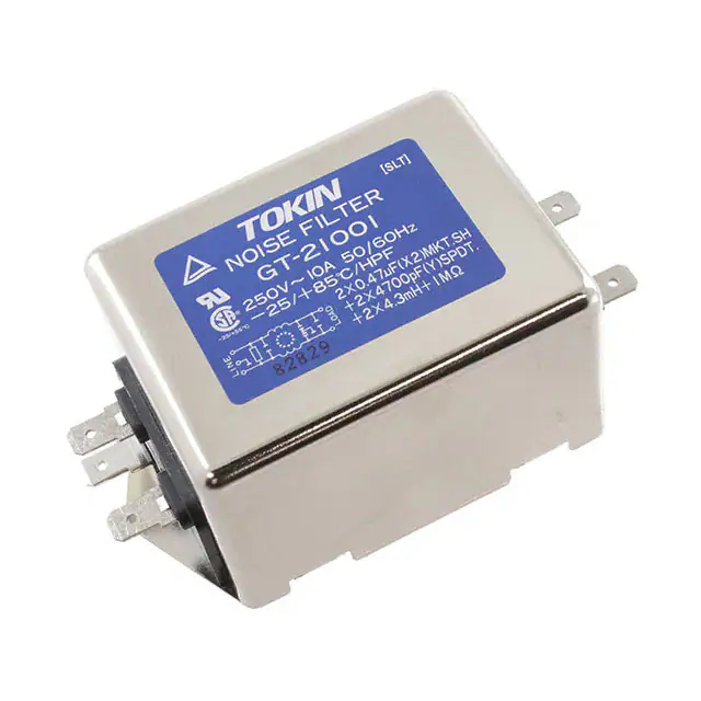

EMI-RFI Filters GT Metal Box Single-Phase Filters Overview Applications The KEMET GT metal box filters cover single-phase requirements with a wide variety of characteristics. These filters are optimized for conduction noise. Their input/ output terminals are screw type or Faston® type. • Industrial equipment • Electronic equipment • Vending machines Benefits • Single-phase 250 VAC • Current range from 3 to 20 A • Operating temperature range from −25°C to +55°C • UL, CSA, or TÜV approved versions available • RoHS compliant Part Number System GT- 2 20 01V Series Phase Rated Current (A) Specification GT 2 = Single-phase 0x = 0x A xx = xx A 0 = Standard, no approvals 01 = High performance at low frequency, single common choke, Faston® terminal 02 = High performance at low frequency, double common choke, Faston® terminal 01V = High performance at low frequency, single common choke, screw terminal J = Faston® terminal with DC input support R = High performance to pulse noise U = UL, CSA, and/or TÜV approved Note: Faston® is a registered trademark of Tyco Electronics AMP Built Into Tomorrow © KEMET Electronics Corporation • KEMET Tower • One East Broward Boulevard Fort Lauderdale, FL 33301 USA • 954-766-2800 • www.kemet.com ERF0002_GT • 12/2/2020 1 EMI-RFI Filters – GT Metal Box Single-Phase Filters Dimensions – Millimeters GT-205U, GT-2050R Recommended torque (N-m) maximum • Line terminal (M4: 0.78) • Earth terminal (M4: 1.18) GT-2150R, GT-2100, GT-2150, GT-2200, GT-210U, GT-215U, GT-220U Recommended torque (N-m) maximum • Line terminal (M4: 0.78) • Earth terminal (M4: 1.18) © KEMET Electronics Corporation • KEMET Tower • One East Broward Boulevard Fort Lauderdale, FL 33301 USA • 954-766-2800 • www.kemet.com ERF0002_GT • 12/2/2020 2 EMI-RFI Filters – GT Metal Box Single-Phase Filters Dimensions – Millimeters cont. GT-205J Faston® is a registered trademark of Tyco Electronics AMP. GT-210J, GT-215J © KEMET Electronics Corporation • KEMET Tower • One East Broward Boulevard Fort Lauderdale, FL 33301 USA • 954-766-2800 • www.kemet.com ERF0002_GT • 12/2/2020 3 EMI-RFI Filters – GT Metal Box Single-Phase Filters Dimensions – Millimeters cont. GT-20301, GT-21001, GT-20302 Faston® is a registered trademark of Tyco Electronics AMP. Part Number A B C D E GT-20301 GT-21001 GT-20302 93.0 105.5 93.0 53.0 57.5 53.0 30.0 44.5 46.0 74.7 87.0 74.7 85.0 96.5 84.3 GT-20501V, GT-21001V,GT-22001V Recommended torque (N-m) maximum • Line terminal (M4: 0.78) • Earth terminal (M4: 1.18) © KEMET Electronics Corporation • KEMET Tower • One East Broward Boulevard Fort Lauderdale, FL 33301 USA • 954-766-2800 • www.kemet.com ERF0002_GT • 12/2/2020 4 EMI-RFI Filters – GT Metal Box Single-Phase Filters Environmental Compliance KEMET GT EMI-RFI Filters comply with EU RoHS Directive 2011/65/EU and (EU) 2015/863. Products that fall under the exemptions listed in below table are also included. Part Number RoHS Compliant RoHS Exemption Code GT-205U Yes 6(c) and 7(c)-I GT-2050R Yes 6(c) GT-2150R Yes 6(c) GT-2100 Yes 6(c) 6(c) GT-2150 Yes GT-2200 Yes 6(c) GT-210U Yes 6(c) and 7(c)-I GT-215U Yes 6(c) and 7(c)-I GT-220U Yes 6(c) and 7(c)-I GT-205J Yes 7(c)-I GT-210J Yes 7(c)-I GT-215J Yes 7(c)-I GT-20301 Yes 6(c) and 7(c)-I GT-21001 Yes 6(c) and 7(c)-I GT-20302 Yes 6(c) and 7(c)-I GT-20501V Yes 6(c) and 7(c)-I GT-21001V Yes 6(c) and 7(c)-I GT-22001V Yes 6(c) and 7(c)-I Code Exemption 6(c) Copper alloy containing up to 4% lead by weight 7(c)-I Electrical and electronic components containing lead in a glass or ceramic other than dielectric ceramic in capacitors, e.g. piezoelectronic devices, or in a glass or ceramic matrix compound © KEMET Electronics Corporation • KEMET Tower • One East Broward Boulevard Fort Lauderdale, FL 33301 USA • 954-766-2800 • www.kemet.com ERF0002_GT • 12/2/2020 5 EMI-RFI Filters – GT Metal Box Single-Phase Filters Approvals Certification Body File Number Part Number UL E59551 GT-205U, GT-210U, GT-215U, GT-220U, GT-205J, GT-210J, GT-215J, GT-20301, GT-21001, GT-20302, GT-21001V and GT-22001V CAS LR50413 GT-205U, GT-210U, GT-205J, GT-210J, GT-215J, GT-20301, GT-21001, GT-20302 and GT-21001V R50004761 GT-21001V R50007113 GT-22001V R50014761 GT-205J, GT-210J and GT-215J R50015833 GT-205U, GT-210U, GT-20301, GT-21001 and GT-20302 R9651191 GT-220U TÜV Rheinland Japan Ltd. Performance Characteristics Item Rated Voltage Rated Current Range Performance Characteristics Insulation Resistance Leakage Current Range Input/Output Terminal Type 250 V 3 – 20 A 1,500 VAC (1 minute, line to ground) except GT-2**01V: 2,000 VAC (1 minute, line to ground) 300 MΩ minimum at 500 VDC (1 minute, line to ground) 0.5 – 1.0 mA maximum at 250 V/60 Hz Screw and Faston® Operating Temperature Range −25°C to +55°C (not including self temperature rise) Withstanding Voltage © KEMET Electronics Corporation • KEMET Tower • One East Broward Boulevard Fort Lauderdale, FL 33301 USA • 954-766-2800 • www.kemet.com ERF0002_GT • 12/2/2020 6 EMI-RFI Filters – GT Metal Box Single-Phase Filters Table 1 – Ratings & Part Number Reference Part Number Phase Rated Voltage AC (V) Rated Current AC (A) Leakage Operating DC Current at 250 Temperature Rise (K) Temperature Available V/60 Hz (mA) Maximum Range Maximum Terminal Type Approval UL, CSA and TÜV Weight (g) GT-205U Single-phase 250 5 Yes 0.5 35 −25°C to +55°C Screw GT-2050R Single-phase 250 5 Yes 0.5 35 −25°C to +55°C Screw 160 170 GT-2150R Single-phase 250 15 Yes 0.5 35 −25°C to +55°C Screw 280 GT-2100 Single-phase 250 10 Yes 0.5 35 −25°C to +55°C Screw 260 GT-2150 Single-phase 250 15 Yes 0.5 35 −25°C to +55°C Screw 270 GT-2200 Single-phase 250 20 Yes 0.5 35 −25°C to +55°C Screw GT-210U Single-phase 250 10 Yes 0.5 35 −25°C to +55°C Screw UL, CSA and TÜV 260 270 GT-215U Single-phase 250 15 Yes 0.5 35 −25°C to +55°C Screw UL 270 GT-220U Single-phase 250 20 Yes 0.5 35 −25°C to +55°C Screw UL and TÜV 270 GT-205J Single-phase 250 5 Yes 0.5 35 −25°C to +55°C Faston UL, CSA and TÜV 135 GT-210J Single-phase 250 10 Yes 0.5 35 −25°C to +55°C Faston UL, CSA and TÜV 240 GT-215J Single-phase 250 15 Yes 0.5 35 −25°C to +55°C Faston UL, CSA and TÜV 255 GT-20301 Single-phase 250 3 No 1.0 30 −25°C to +55°C Faston UL, CSA and TÜV 160 300 GT-21001 Single-phase 250 10 No 1.0 30 −25°C to +55°C Faston UL, CSA and TÜV GT-20302 Single-phase 250 3 No 1.0 30 −25°C to +55°C Faston UL, CSA and TÜV GT-20501V Single-phase 250 5 No 0.5 35 −25°C to +55°C Screw 215 220 GT-21001V Single-phase 250 10 No 0.5 35 −25°C to +55°C Screw UL, CSA and TÜV 280 GT-22001V Single-phase 250 20 No 0.5 35 −25°C to +55°C Screw UL and TÜV 285 © KEMET Electronics Corporation • KEMET Tower • One East Broward Boulevard Fort Lauderdale, FL 33301 USA • 954-766-2800 • www.kemet.com ERF0002_GT • 12/2/2020 7 EMI-RFI Filters – GT Metal Box Single-Phase Filters Circuit Diagram GT-2**0, GT-2**0R GT-2**U, GT-2**01V GT-2**J, GT-2**01 GT-2**02 Measuring Circuit - Common Mode Measuring Circuit - Normal Mode (Only for GT-2**01V, GT-2**01, GT-2**02) © KEMET Electronics Corporation • KEMET Tower • One East Broward Boulevard Fort Lauderdale, FL 33301 USA • 954-766-2800 • www.kemet.com ERF0002_GT • 12/2/2020 8 EMI-RFI Filters – GT Metal Box Single-Phase Filters Pulse Attenuation Characteristics Pulse Attenuation Example Pulse Attenuation Example Pulse Characteristic Measuring Circuit © KEMET Electronics Corporation • KEMET Tower • One East Broward Boulevard Fort Lauderdale, FL 33301 USA • 954-766-2800 • www.kemet.com ERF0002_GT • 12/2/2020 9 EMI-RFI Filters – GT Metal Box Single-Phase Filters Attenuation (Static Characteristics) GT-205U GT-2050R GT-2150R GT-2100, GT-210U GT-2150, GT-215U GT-2200, GT-220U © KEMET Electronics Corporation • KEMET Tower • One East Broward Boulevard Fort Lauderdale, FL 33301 USA • 954-766-2800 • www.kemet.com ERF0002_GT • 12/2/2020 10 EMI-RFI Filters – GT Metal Box Single-Phase Filters Attenuation (Static Characteristics) cont. GT-205J GT-210J GT-215J GT-20301, GT-21001 GT-20302 GT-20501V © KEMET Electronics Corporation • KEMET Tower • One East Broward Boulevard Fort Lauderdale, FL 33301 USA • 954-766-2800 • www.kemet.com ERF0002_GT • 12/2/2020 11 EMI-RFI Filters – GT Metal Box Single-Phase Filters Attenuation (Static Characteristics) cont. GT-21001V GT-22001V Packaging Part Type GT-205U GT-2050R GT-2150R GT-2100 GT-2150 GT-2200 GT-210U GT-215U GT-220U GT-205J GT-210J GT-215J GT-20301 GT-21001 GT-20302 GT-20501V GT-21001V GT-22001V Packaging Type Pieces per Box Tray 10 30 20 40 10 10 40 10 10 50 40 40 30 32 30 40 10 40 © KEMET Electronics Corporation • KEMET Tower • One East Broward Boulevard Fort Lauderdale, FL 33301 USA • 954-766-2800 • www.kemet.com ERF0002_GT • 12/2/2020 12 EMI-RFI Filters – GT Metal Box Single-Phase Filters Handling Precautions Precautions for product storage EMI-RFI Filters should be stored in normal working environments. While the filters themselves are quite robust in other environments, solderability will be degraded by exposure to high temperatures, high humidity, corrosive atmospheres, and long term storage. KEMET recommends that maximum storage temperature not exceed 40°C, maximum storage humidity not exceed 70% relative humidity, and atmospheres should be free of chlorine and sulfur bearing compounds. Temperature fluctuations should be minimized to avoid condensation on the parts. Also, avoid storage near strong magnetic fields as this might magnetize the product. EMI-RFI Filters’ stock should be used promptly, preferably within 12 months of receipt. © KEMET Electronics Corporation • KEMET Tower • One East Broward Boulevard Fort Lauderdale, FL 33301 USA • 954-766-2800 • www.kemet.com ERF0002_GT • 12/2/2020 13 EMI-RFI Filters – GT Metal Box Single-Phase Filters KEMET Electronics Corporation Sales Offices For a complete list of our global sales offi ces, please visit www.kemet.com/sales. Disclaimer All product specifi cations, statements, information and data (collectively, the “Information”) in this datasheet are subject to change. The customer is responsible for checking and verifying the extent to which the Information contained in this publication is applicable to an order at the time the order is placed. All Information given herein is believed to be accurate and reliable, but it is presented without guarantee, warranty, or responsibility of any kind, expressed or implied. Statements of suitability for certain applications are based on KEMET Electronics Corporation’s (“KEMET”) knowledge of typical operating conditions for such applications, but are not intended to constitute – and KEMET specifi cally disclaims – any warranty concerning suitability for a specifi c customer application or use. The Information is intended for use only by customers who have the requisite experience and capability to determine the correct products for their application. Any technical advice inferred from this Information or otherwise provided by KEMET with reference to the use of KEMET’s products is given gratis, and KEMET assumes no obligation or liability for the advice given or results obtained. Although KEMET designs and manufactures its products to the most stringent quality and safety standards, given the current state of the art, isolated component failures may still occur. Accordingly, customer applications which require a high degree of reliability or safety should employ suitable designs or other safeguards (such as installation of protective circuitry or redundancies) in order to ensure that the failure of an electrical component does not result in a risk of personal injury or property damage. Although all product–related warnings, cautions and notes must be observed, the customer should not assume that all safety measures are indicted or that other measures may not be required. When providing KEMET products and technologies contained herein to other countries, the customer must abide by the procedures and provisions stipulated in all applicable export laws and regulations, including without limitation the International Traffi c in Arms Regulations (ITAR), the US Export Administration Regulations (EAR) and the Japan Foreign Exchange and Foreign Trade Act. KEMET is a registered trademark of KEMET Electronics Corporation. © KEMET Electronics Corporation • KEMET Tower • One East Broward Boulevard Fort Lauderdale, FL 33301 USA • 954-766-2800 • www.kemet.com ERF0002_GT • 12/2/2020 14
