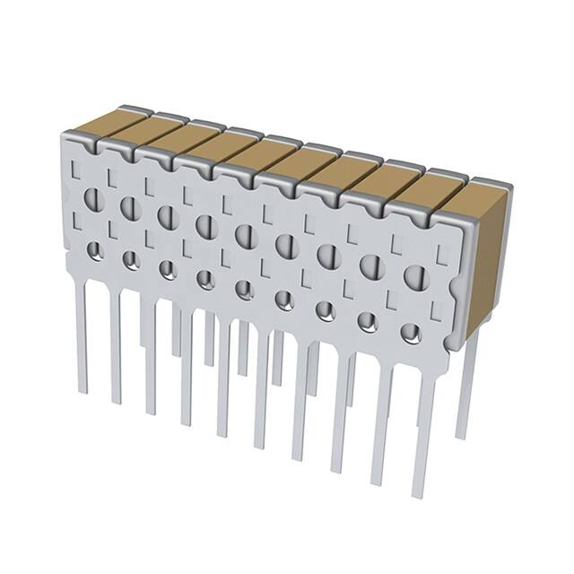

Surface Mount and Through-Hole Multilayer Ceramic Capacitors KPS-MCL Low-Loss High Temperature 200°C SMPS Stacks, 200 – 2,000 VDC (Industrial Grade) Overview KEMET Power Solutions - Low loss (KPS MCL) High Temperature SMPS Ceramic Stacked Capacitors combine a robust and proprietary C0G/NPO base metal electrode (BME) dielectric system with a durable lead-frame technology for high temperature and high power SMPS applications. These devices are specifically designed to withstand the demands of harsh industrial environments such as down-hole oil exploration and automotive/avionics engine compartment circuitry. The KPS-MCL is constructed with large chip multilayer ceramic capacitors (MLCCs), vertically stacked and secured to a lead-frame termination system, using a high melting point (HMP) solder alloy. Vertically stacking the capacitors in lead frames allows for much lower ESR (low loss) and thermal resistance, which translates to very high ripple current capability. The lead-frame isolates the MLCCs from the printed circuit board (PCB), while establishing a parallel circuit configuration. Mechanically isolating the capacitors from the PCB improves mechanical and thermal stress performance, while the parallel circuit configuration allows for bulk capacitance in the same or smaller design footprint. KEMET’s high temperature C0G capacitors are temperaturecompensating and are well suited for resonant circuit applications, or for those where Q and stability of capacitance characteristics are required. They exhibit no change in capacitance with respect to time and voltage, and boast a negligible change in capacitance with reference to ambient temperature. Capacitance change is limited to ±30 ppm/ºC from −55°C to +200°C. In addition, these capacitors exhibit high insulation resistance with low dissipation factor at elevated temperatures up to +200°C. They also exhibit low ESR at high frequencies and offer greater volumetric efficiency over competitive high temperature BME ceramic capacitor devices. Benefits • Low-Loss • Low ESR and ESL • High thermal stability • High ripple current capability • Straight Pin lead wires for "through-hole" mounting • Formed "J" and "L" lead wires for surface mounting • Operating temperature range of −55°C to +200°C • Case Codes (Case Sizes) – 69 (2220) and 70 (2225) • DC voltage ratings of 200 – 2,000 V • Capacitance offerings ranging from 11 nF – 1.2 µF • Industrial grade • High frequency performance and bulk capacitance in a reduced footprint Click image above for interactive 3D content Open PDF in Adobe Reader for full functionality One world. One KEMET © KEMET Electronics Corporation • KEMET Tower • One East Broward Boulevard Fort Lauderdale, FL 33301 USA • 954-766-2800 • www.kemet.com C1102_KPS-MCL_200C_STACKS • 3/31/2020 1 Surface Mount and Through-Hole Multilayer Ceramic Capacitors KPS-MCL Low-Loss High Temperature 200°C SMPS Stacks, 200 – 2,000 VDC (Industrial Grade) Applications • SMPS • Input and output filtering on power supplies, often found on “capacitor banks“ • Snubber circuits and DC link • Resonator circuits • Industrial • Down-hole • Defense and aerospace • Hybrid and Electric Vehicles (HEVs, BEVs) Ordering Information L1 Product Family L1 G N 69 Dielectric Lead Case Size/ Classification/ Configuration1 Case Code (CC) Characteristic G= 200°C C0G (BME) N = Straight pin L = Formed "L" J = Formed "J" 69 70 C 224 K A 03 Rated Voltage (DC) Capacitance Code (pF) Capacitance Tolerance Lead/ Termination Finish2 Number of Chips 2 = 200 V C = 500 V B = 630 V D = 1,000 V F = 1,500 V G = 2,000 V Two Significant Digits and number of zeros J = ±5% K = ±10% A = Silver 03 – 3 Chips H = Solder 05 – 5 Chips Coated (60/40) 10 – 10 Chips Lead configuration and dimension details are outlined in the "Dimensions" section of this document. Additional lead configurations may be available. Contact KEMET for details. 2 Solder coated (60/40) lead termination finish (H) only available for Straight pin (N) lead configuration. 1 Lead Configurations – Inches (Millimeters) Lead Style Symbol Lead Style L Lead Length N (N) Straight 0.250 minimum (6.35) L (L) Formed 0.055±0.005 (1.4±0.13) J (J) Formed 0.055±0.005 (1.4±0.13) Additional lead configurations may be available. Contact KEMET for details. © KEMET Electronics Corporation • KEMET Tower • One East Broward Boulevard Fort Lauderdale, FL 33301 USA • 954-766-2800 • www.kemet.com C1102_KPS-MCL_200C_STACKS • 3/31/2020 2 Surface Mount and Through-Hole Multilayer Ceramic Capacitors KPS-MCL Low-Loss High Temperature 200°C SMPS Stacks, 200 – 2,000 VDC (Industrial Grade) Dimensions – Inches (Millimeters) Straight Lead (N) Formed J Lead (J) Formed L Lead (L) E E C Straight Lead (N) Formed J (J) and L (L) Lead G D D A B A B L L C E J F L C J H G H B K F K LEAD ALIGNMENT Note: Lead alignment within pin rows shall be 0.01” maximum. Case Code C Lead Spacing2 ±0.025 (0.635) 69 0.25 (6.35) 70 1 2 E Length For straight lead (N) and (J) lead: E = 0.30 (7.62) maximum For (L) lead: E = 0.38 (9.65) maximum Number Of Leads Per Side D Width ±0.025 (0.635) 3 0.32 (8.13) 5 0.53 (13.5) 10 1.06 (26.9) 3 0.32 (8.13) 5 0.53 (13.5) 10 1.06 (26.9) A Height Maximum B Height Maximum 0.21 (5.33) 0.29 (7.37) H Lead Pitch 0.1 (2.54) 0.26 (6.60) 0.34 (8.64) K Lead Width 0.02 (0.5) F Seating Plane1 ±0.010 (0.250) For straight lead (N), seating plane is 0.055" For (L) and (J) lead, seating plane is 0.070" Mounting Technique Solder reflow only Seating plane is the distance between the circuit board and the bottom of the lowest capacitor in the stack. Lead spacing dimension from outside of lead frame. © KEMET Electronics Corporation • KEMET Tower • One East Broward Boulevard Fort Lauderdale, FL 33301 USA • 954-766-2800 • www.kemet.com C1102_KPS-MCL_200C_STACKS • 3/31/2020 3 Surface Mount and Through-Hole Multilayer Ceramic Capacitors KPS-MCL Low-Loss High Temperature 200°C SMPS Stacks, 200 – 2,000 VDC (Industrial Grade) Environmental Compliance KPS-MCL part types ≥ 500 V with silver (Ag) plating are RoHS compliant with exemption 7a. Electrical Parameters/Performance Characteristics Item Parameters/Characteristics Operating Temperature Range Capacitance Change with Reference to +25°C and 0 VDC Applied (TCC) Aging Rate (Maximum % Capacitance Loss/Decade Hour) Dielectric Withstanding Voltage (DWV) 1 Dissipation Factor (DF) Maximum Limit at 25°C 2 Insulation Resistance (IR) Minimum Limit at 25°C3 –55°C to +200°C ±30 ppm/°C (up to 200°C) 0% 250% of rated voltage for voltage rating of < 500 V 130% of rated voltage for voltage rating of ≥ 500 to < 1,000 V 120% of rated voltage for voltage rating of ≥ 1,000 V (5 ±1 seconds and charge/discharge not exceeding 50 mA) 0.1% 1,000 MΩ µF or 100 GΩ (Rated voltage applied for 120 ±5 seconds at 25°C) DWV is the voltage a capacitor can withstand for a short period of time. It exceeds the nominal and continuous working voltage of a capacitor. Capacitance and dissipation factor (DF) measured under the following conditions: 1 MHz ±100 kHz and 1.0 ±0.2 Vrms if capacitance ≤ 1,000 pF. 1 kHz ±50 Hz and 1.0 ±0.2 Vrms if capacitance > 1,000 pF. 3 To obtain IR limit, divide MΩ - µF value by the capacitance and compare to GΩ limit. Select the lower of the two limits. Note: When measuring capacitance, it is important to ensure the set voltage level is held constant. The HP4284 and Agilent E4980 have a feature known as Automatic Level Control (ALC). The ALC feature should be switched to "ON." 1 2 © KEMET Electronics Corporation • KEMET Tower • One East Broward Boulevard Fort Lauderdale, FL 33301 USA • 954-766-2800 • www.kemet.com C1102_KPS-MCL_200C_STACKS • 3/31/2020 4 Surface Mount and Through-Hole Multilayer Ceramic Capacitors KPS-MCL Low-Loss High Temperature 200°C SMPS Stacks, 200 – 2,000 VDC (Industrial Grade) Table 1 - Product Ordering Codes & Ratings Height A Inch (mm) Maximum D Inch (mm) Maximum RoHS Compliance 3 3 5 5 10 10 0.21 (5.3) 0.26 (6.6) 0.21 (5.3) 0.26 (6.6) 0.21 (5.3) 0.26 (6.6) 0.32 (8.13) 0.32 (8.13) 0.53 (13.5) 0.53 (13.5) 1.06 (26.92) 1.06 (26.92) No No No No No No 3 3 5 5 10 10 0.21 (5.3) 0.26 (6.6) 0.21 (5.3) 0.26 (6.6) 0.21 (5.3) 0.26 (6.6) 0.32 (8.13) 0.32 (8.13) 0.53 (13.5) 0.53 (13.5) 1.06 (26.9) 1.06 (26.9) Yes (see Note 4) 3 3 5 5 10 10 0.21 (5.3) 0.26 (6.6) 0.21 (5.3) 0.26 (6.6) 0.21 (5.3) 0.26 (6.6) 0.32 (8.13) 0.32 (8.13) 0.53 (13.5) 0.53 (13.5) 1.06 (26.9) 1.06 (26.9) Yes (see Note 4) 3 3 5 5 10 10 0.21 (5.3) 0.26 (6.6) 0.21 (5.3) 0.26 (6.6) 0.21 (5.3) 0.26 (6.6) 0.32 (8.13) 0.32 (8.13) 0.53 (13.5) 0.53 (13.5) 1.06 (26.9) 1.06 (26.9) Yes (see Note 4) 3 3 5 5 10 10 0.21 (5.3) 0.26 (6.6) 0.21 (5.3) 0.26 (6.6) 0.21 (5.3) 0.26 (6.6) 0.32 (8.13) 0.32 (8.13) 0.53 (13.5) 0.53 (13.5) 1.06 (26.9) 1.06 (26.9) Yes (see Note 4) 2220 2225 2220 2225 2220 2225 3 3 5 5 10 10 0.21 (5.3) 0.26 (6.6) 0.21 (5.3) 0.26 (6.6) 0.21 (5.3) 0.26 (6.6) 0.32 (8.13) 0.32 (8.13) 0.53 (13.5) 0.53 (13.5) 1.06 (26.9) 1.06 (26.9) Yes (see Note 4) Chip Size Number of Chips Height A Inch (mm) Maximum D Inch (mm) Maximum RoHS Compliance KEMET Part Number1 Capacitance (µF)2,3 Case Code Chip Size L1G(a)692284(b)(c)03 L1G(a)702364(b)(c)03 L1G(a)692464(b)(c)05 L1G(a)702604(b)(c)05 L1G(a)692924(b)(c)10 L1G(a)702125(b)(c)10 0.28 0.36 0.46 0.6 0.92 1.2 69 70 69 70 69 70 2220 2225 2220 2225 2220 2225 L1G(a)69C114(b)(c)03 L1G(a)70C144(b)(c)03 L1G(a)69C184(b)(c)05 L1G(a)70C234(b)(c)05 L1G(a)69C364(b)(c)10 L1G(a)70C474(b)(c)10 0.11 0.14 0.18 0.23 0.36 0.47 69 70 69 70 69 70 2220 2225 2220 2225 2220 2225 L1G(a)69B663(b)(c)03 L1G(a)70B843(b)(c)03 L1G(a)69B114(b)(c)05 L1G(a)70B144(b)(c)05 L1G(a)69B224(b)(c)10 L1G(a)70B284(b)(c)10 0.066 0.084 0.11 0.14 0.22 0.28 69 70 69 70 69 70 2220 2225 2220 2225 2220 2225 L1G(a)69D393(b)(c)03 L1G(a)70D543(b)(c)03 L1G(a)69D653(b)(c)05 L1G(a)70D903(b)(c)05 L1G(a)69D134(b)(c)10 L1G(a)70D184(b)(c)10 0.039 0.054 0.065 0.090 0.130 0.180 69 70 69 70 69 70 2220 2225 2220 2225 2220 2225 L1G(a)69F163(b)(c)03 L1G(a)70F203(b)(c)03 L1G(a)69F273(b)(c)05 L1G(a)70F343(b)(c)05 L1G(a)69F533(b)(c)10 L1G(a)70F683(b)(c)10 0.016 0.020 0.027 0.034 0.053 0.068 69 70 69 70 69 70 2220 2225 2220 2225 2220 2225 L1G(a)69G113(b)(c)03 L1G(a)70G143(b)(c)03 L1G(a)69G183(b)(c)05 L1G(a)70G233(b)(c)05 L1G(a)69G363(b)(c)10 L1G(a)70G473(b)(c)10 0.011 0.014 0.018 0.023 0.036 0.047 69 70 69 70 69 70 KEMET Part Number1 Capacitance (µF)2,3 Case Code Number of Chips 200 V 500 V 630 V 1,000 V 1,500 V 2,000 V Complete part number requires additional characters in the numbered positions provided in order to indicate lead configuration, capacitance tolerance and lead finish. For each numbered position, available options are as follows: (a) Lead style character "N," "L," or "J." (b) Capacitance tolerance character "J" or "K." (c) Lead finish character "A" for 100% Ag, "H" for solder coated. 2 Capacitance values listed are for stacked components and do not follow E12, E24 format defined by BS 2488 standard. Please contact factory to inquire about capacitance values not listed. 3 Identical capacitance values may be listed for the same voltage rating. User can select which case size and chip count is desired for the given capacitance value. 4 KPS-MCL Stacked Capacitors ≥ 500 V with Ag plating are RoHS compliant by exemption 7a. 1 © KEMET Electronics Corporation • KEMET Tower • One East Broward Boulevard Fort Lauderdale, FL 33301 USA • 954-766-2800 • www.kemet.com C1102_KPS-MCL_200C_STACKS • 3/31/2020 5 Surface Mount and Through-Hole Multilayer Ceramic Capacitors KPS-MCL Low-Loss High Temperature 200°C SMPS Stacks, 200 – 2,000 VDC (Industrial Grade) Soldering Process The capacitors and assemblies outlined in this specification sheet are susceptible to thermal shock damage due to their large ceramic mass. Temperature profiles used should provide adequate temperature rise and cool-down time to prevent damage from thermal shock. In general, KEMET recommends against hand-soldering for these types of large ceramic devices, but if hand-soldering cannot be avoided, refer to hand-soldering section below. Recommended Soldering Technique: • Solder reflow Recommended Reflow Soldering Profile: TP Temperature TL tP Maximum Ramp Up Rate = 2°C/second Maximum Ramp Down Rate = 2°C/second tL Tsmax Tsmin 25 ts 25°C to Peak Time Profile Feature Sn-Pb Pb-Free Temperature Minimum (TSmin) Temperature Maximum (TSmax) Time (ts) from Tsmin to Tsmax) Ramp-up rate (TL to TP) Liquidous temperature (TL) Time above liquidous (tL) Peak temperature (TP) 100°C 150°C 60 – 90 seconds 2°C/second 183°C 95 seconds 240°C 150°C 200°C 60 – 120 seconds 3°C/second 217°C 95 seconds 260°C Time within 5°C of maximum peak temperature (tP) 5 seconds 5 seconds Ramp-down rate (TP to TL) Time 25°C to peak temperature 2°C/second 3.5 minutes 2°C/second 3.5 minutes Preheat/Soak Note: All temperatures refer to the center of the package, measured on the package body surface that is facing up during assembly reflow. Preheating and Reflow Profile Notes: Due to the differences in the coefficient of the thermal expansion for the different materials of construction, it is critical to monitor and control the heating and cooling rates during the soldering process. To ensure optimal component reliability, KEMET's recommended heating and cooling rate is 2°C/second. After soldering, the capacitors should be air cooled to room temperature before further processing. Forced air cooling is not recommended. © KEMET Electronics Corporation • KEMET Tower • One East Broward Boulevard Fort Lauderdale, FL 33301 USA • 954-766-2800 • www.kemet.com C1102_KPS-MCL_200C_STACKS • 3/31/2020 6 Surface Mount and Through-Hole Multilayer Ceramic Capacitors KPS-MCL Low-Loss High Temperature 200°C SMPS Stacks, 200 – 2,000 VDC (Industrial Grade) Soldering Process cont. Recommendations for Hand-Soldering: Care should be taken when hand-soldering large ceramic stacks. Excessive thermal shock on the ceramic material can lead to cracking and reliability issues. To reduce risk of thermal shock, KEMET recommends solder reflow, but if hand soldering cannot be avoided, please see recommended guidelines below. Pre-Heating Stacks should be preheated to a temperature within 50°C of reflow temperature. KEMET recommends a ramp rate of 2°C/ second to avoid thermal shock during the pre-heating process. Hand-Soldering When using a solder iron, keep tip of the iron as far away from ceramic body to avoid excessive heating. Cool Down After reflow, stacks should be allowed to cool at a preferable rate of 2°C/second until room temperature is reached. Storage & Handling Ceramic capacitors should be stored in normal working environments. While the chips themselves are quite robust in other environments, solderability will be degraded by exposure to high temperatures, high humidity, corrosive atmospheres, and long term storage. In addition, packaging materials will be degraded by high temperature–reels and may soften or warp, and tape peel force may increase. KEMET recommends that maximum storage temperature does not exceed 40°C and maximum storage humidity does not exceed 70% relative humidity. Temperature fluctuations should be minimized to avoid condensation on the parts. Atmospheres should be free of chlorine and sulfur bearing compounds. For optimized solderability chip stock should be used promptly, preferably within 1.5 years of receipt. © KEMET Electronics Corporation • KEMET Tower • One East Broward Boulevard Fort Lauderdale, FL 33301 USA • 954-766-2800 • www.kemet.com C1102_KPS-MCL_200C_STACKS • 3/31/2020 7 Surface Mount and Through-Hole Multilayer Ceramic Capacitors KPS-MCL Low-Loss High Temperature 200°C SMPS Stacks, 200 – 2,000 VDC (Industrial Grade) Table 2 - Performance & Reliability: Test Methods & Conditions Inspection Test Method Test Conditions Reliability/Environmental Tests High Temperature Life MIL–STD–202, Method 108 200°C, rated voltage, 1,000 hours JESD22, Method JA–104 –55°C to +200°C, 300 cycles Thermal Shock MIL–STD–202, Method 107 –55°C to +200°C, 20 seconds transfer, 15 minutes dwell, 20 cycles Moisture Resistance MIL–STD–202, Method 106 20 cycles, no voltage applied Temperature Cycling Physical, Mechanical and Process Tests Vibration MIL–STD–202, Method 204 Condition D per MIL–PRF–49470, simple harmonic, 20 g peak, 10 – 2,000 Hz, 20 minute sweep, 12 sweeps per axis Resistance to Soldering Heat MIL–STD–202, Method 210 Condition B, 260°C, 10 seconds Terminal Strength MIL–STD–202, Method 202 Condition A Immersion MIL–STD–202, Method 104 Condition B J–STD–002C Category 3 For Sn-Pb solder alloy: Method A, 245°C, 5 seconds Method S, 220°C peak For Pb-Free solder alloy: Method A1, 260°C, 5 seconds Method S1, 245°C peak Solderability © KEMET Electronics Corporation • KEMET Tower • One East Broward Boulevard Fort Lauderdale, FL 33301 USA • 954-766-2800 • www.kemet.com C1102_KPS-MCL_200C_STACKS • 3/31/2020 8 Surface Mount and Through-Hole Multilayer Ceramic Capacitors KPS-MCL Low-Loss High Temperature 200°C SMPS Stacks, 200 – 2,000 VDC (Industrial Grade) Construction Detailed Cross Section Dielectric material (CaZrO3) Lead-frame (Phosphor Bronze -Alloy 510) Inner electrodes (Ni) Dielectric material (CaZrO3) Lead-frame attach solder End termination/ External electrode (Cu) Barrier layer (Ni) Termination finish (Sn10/Pb88/Ag2) Barrier layer (Ni) Inner electrodes (Ni) Lead-frame finish (Ag or Sn60/Pb40) End termination/ External electrode (Cu) Termination finish (Sn10/Pb88/Ag2) Packaging Waffle Packaging Quantities 1 Case Code Lead Style 69 L/J/N 70 L/J/N Number of Chips in Stack Waffle Pack Quantity1 3 and 5 10 3 and 5 10 50 25 50 25 Minimum order value applies. Contact KEMET for details. © KEMET Electronics Corporation • KEMET Tower • One East Broward Boulevard Fort Lauderdale, FL 33301 USA • 954-766-2800 • www.kemet.com C1102_KPS-MCL_200C_STACKS • 3/31/2020 9 Surface Mount and Through-Hole Multilayer Ceramic Capacitors KPS-MCL Low-Loss High Temperature 200°C SMPS Stacks, 200 – 2,000 VDC (Industrial Grade) KEMET Electronics Corporation Sales Offices For a complete list of our global sales offices, please visit www.kemet.com/sales. Disclaimer All product specifications, statements, information and data (collectively, the “Information”) in this datasheet are subject to change. The customer is responsible for checking and verifying the extent to which the Information contained in this publication is applicable to an order at the time the order is placed. All Information given herein is believed to be accurate and reliable, but it is presented without guarantee, warranty, or responsibility of any kind, expressed or implied. Statements of suitability for certain applications are based on KEMET Electronics Corporation’s (“KEMET”) knowledge of typical operating conditions for such applications, but are not intended to constitute – and KEMET specifically disclaims – any warranty concerning suitability for a specific customer application or use. The Information is intended for use only by customers who have the requisite experience and capability to determine the correct products for their application. Any technical advice inferred from this Information or otherwise provided by KEMET with reference to the use of KEMET’s products is given gratis, and KEMET assumes no obligation or liability for the advice given or results obtained. Although KEMET designs and manufactures its products to the most stringent quality and safety standards, given the current state of the art, isolated component failures may still occur. Accordingly, customer applications which require a high degree of reliability or safety should employ suitable designs or other safeguards (such as installation of protective circuitry or redundancies) in order to ensure that the failure of an electrical component does not result in a risk of personal injury or property damage. Although all product–related warnings, cautions and notes must be observed, the customer should not assume that all safety measures are indicted or that other measures may not be required. KEMET is a registered trademark of KEMET Electronics Corporation. © KEMET Electronics Corporation • KEMET Tower • One East Broward Boulevard Fort Lauderdale, FL 33301 USA • 954-766-2800 • www.kemet.com C1102_KPS-MCL_200C_STACKS • 3/31/2020 10
