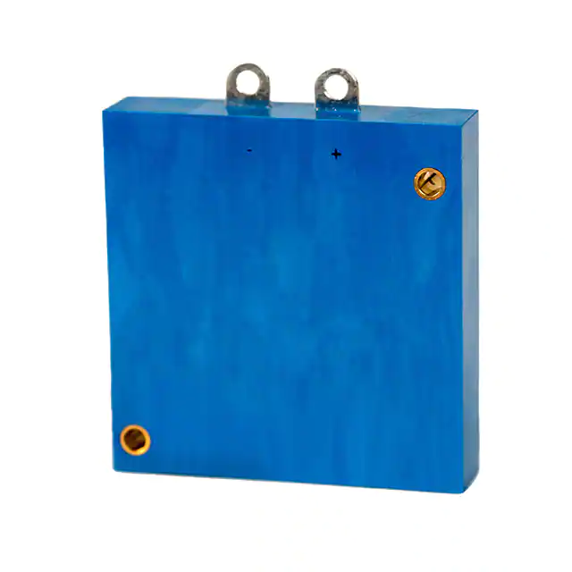

Tantalum Through-Hole Capacitors – Hermetically Sealed M55 Module Polymer Hermetic Seal Overview KEMET's M550 and M551 Modular Series are manufactured by placing T550 or T551 Polymer Hermetic Sealed Capacitors (PHS) in parallel or series. The T550 and T551 Series are made utilizing KEMET's exclusive F-Tech process and are 100% tested per KEMET’s patented Simulated Breakdown Screening process. This configuration provides high and stable capacitance (up to 8,200 µF), extremely low ESR (down to 15 mΩ) and extremely low and stable leakage current, all in a mechanically robust package. The M55 Modules are available in two temperature offerings: 105°C (M550 Series) and 125°C (M551 Series). With reduced ESR and enhanced capacitance retention at higher frequencies and low temperatures, KEMET modules provide the highest total capacitance and the lowest total cost of ownership for high power applications. Benefits Applications • Extremely low and stable ESR (as low as 15 mΩ) • Voltage Ratings from 6 to 180 VDC • High frequency capacitance retention • Low temperature capacitance stability • High ripple current capability (17,500 mArms) • High inrush current capability • Excellent power dissipation capability • Stackable packaging • Mechanically robust assembly and epoxy housing • Operates at up to 80% rated voltage • Customized solutions available • RoHS compliant terminations available Designed for mission critical applications requiring high power, filtering, hold-up, and current pulse generation. Module 1 Module 2 Built Into Tomorrow © KEMET Electronics Corporation • KEMET Tower • One East Broward Boulevard Fort Lauderdale, FL 33301 USA • 954-766-2800 • www.kemet.com T2074_M55_Module • 10/22/2020 1 Tantalum Through-Hole Capacitors – Hermetically Sealed M55 Module Polymer Hermetic Seal Ordering Information M 550 B 108 Capacitor Class Series Case Size Capacitance Code (pF) B First two digits represent significant figures. Third digit specifies number of zeros. M= Module 550 = Capacitor series (PHS 105°C) 551 = Capacitor series (PHS 125°C) M 060 A A Product Level Termination Finish A = N/A B* = DLA 13030 standard reliability T* = DLA 13030 high reliability A = 100% Silver (Ag) T = 100% Tin (Sn)-plated H = Tin/lead (SnPb) solder-coated (5% Pb minimum) S = Solder-coated (60% Sn, 40% Pb) G = 100% gold (Au) Capacitance Rated Voltage Tolerance (VDC) K = ±10% M = ±20% 006 = 6 008 = 8 010 = 10 015 = 15 025 = 25 030 = 30 040 = 40 050 = 50 060 = 60 075 = 75 100 = 100 180 = 180 * Only available on DLA discrete part numbers. Refer to part number table for details. Performance Characteristics Item Performance Characteristics Operating Temperature Rated Capacitance Range Capacitance Tolerance Rated Voltage Range −55°C to 105°C/125°C* 60 – 8,200 μF at 120 Hz/25°C K Tolerance (10%), M Tolerance (20%) 6 – 180 V DF (120 Hz at 25°C) Refer to Part Number Electrical Specification Table ESR (100 kHz at 25°C) Refer to Part Number Electrical Specification Table Leakage Current Refer to Part Number Electrical Specification Table * Refer to the part number specification table. © KEMET Electronics Corporation • KEMET Tower • One East Broward Boulevard Fort Lauderdale, FL 33301 USA • 954-766-2800 • www.kemet.com T2074_M55_Module • 10/22/2020 22 Tantalum Through-Hole Capacitors – Hermetically Sealed M55 Module Polymer Hermetic Seal Qualification Test Performed Method Reference Test Conditions Reliability and Environmental Tests AC Ripple Life at 85˚C, 0.67 Vr MIL–PRF–39006 85˚C, 40 kHz ripple current, 2,000 hours Thermal Shock MIL–PRF–39006 Condition A, −55°C to +105°C 5 cycles Temperature Stability MIL–PRF–39006 Extreme temperature exposure at a succession of continuous steps at +25°C, −55°C, +25°C, +85°C, +105, +25°C Physical, Mechanical and Process Tests Mechanical Shock MIL–PRF–39006 Condition I Vibration High Frequency MIL–PRF–39006 Method 204, Test condition D, 20 g peak Dimensions – Millimeters (Inches) FRAME 1 FRAME 2 RIGHT SIDE VIEW FRONT VIEW - FRONT VIEW F S + H2 ød LL RIGHT SIDE VIEW LL S FRONT VIEW S2 F W1 H ød LL W1 H1 W ød L W1 H1 H2 + SIDE VIEW C F W2 W2 L L S - H2 W2 ød FRAME 3 H1 W ød H W H F2 TOP VIEW Dimensions mm (In) Frame Size L W H ±0.38 ±0.38 ±0.20 (0.015) (0.015) (0.008) S ref S2 ref LL ± 0.1 (0.004) F ref C ref H1 W1 H2 W2 ± 0.1 ± 0.1 ± 0.1 ± 0.1 (0.004) (0.004) (0.004) (0.004) F2 ref d ref Weight per module (g) 1 52.1 (2.05) 50.6 (1.99) 11.1 (0.44) 12.71 (0.50) N/A 5.6 (0.22) 0.81 (0.03) N/A 4.5 (0.18) 3.2 (0.13) 8.2 (0.32) 4.4 (0.17) N/A 3.2 (0.13) 80 2 48.4 (1.90) 28.2 (1.11) 11.1 (0.44) 11.50 (0.45) N/A 3.2 (0.13) 0.81 (0.03) N/A 4.5 (0.18) 3.2 (0.13) 8.2 (0.32) 4.4 (0.17) N/A 3.2 (0.13) 50 3 52.1 (2.05) 50.6 (1.99) 11.1 (0.44) 21.00 (0.83) 7.5 5.6 (0.22) 0.81 (0.03) 5.34 (0.21) 4.5 (0.18) 3.2 (0.13) 8.2 (0.32) 4.4 (0.17) 3.70 (0.15) 3.2 (0.13) 90 © KEMET Electronics Corporation • KEMET Tower • One East Broward Boulevard Fort Lauderdale, FL 33301 USA • 954-766-2800 • www.kemet.com T2074_M55_Module • 10/22/2020 33 Tantalum Through-Hole Capacitors – Hermetically Sealed M55 Module Polymer Hermetic Seal Table 1 – Ratings & Part Number Reference Rated Voltage (V) 85°C Rated Capacitance (µF) 6 6 6 6 6 6 8 8 8 8 8 8 10 10 10 10 10 10 10 10 15 15 15 15 15 15 15 15 25 25 25 25 25 25 30 30 30 30 30 30 40 40 40 40 40 40 40 40 50 50 50 50 50 50 50 700 700 4100 4100 8200 8200 1100 1100 3400 3400 6800 6800 500 500 900 900 2200 2200 5600 5600 350 350 600 600 2000 2000 3900 3900 250 250 500 500 1000 1000 200 200 340 340 680 680 500 500 600 600 1000 1000 1200 1200 120 120 240 240 500 500 600 Frame Size KEMET Module Part Number DC Leakage µA at 25°C max/5min DF% at 25°C 120 Hz Max Maximum ESR mΩ at 25°C 100 kHz Ripple Current mArms at 85°C/40 kHz Maximum Operating Temperature (°C) 2 2 2 2 1 1 2 2 2 2 1 1 2 2 2 2 2 2 1 1 2 2 2 2 2 2 1 1 2 2 2 2 1 1 2 2 2 2 1 1 2 2 2 2 1 1 1 1 2 2 2 2 2 2 2 M550B707(1)006A(3) M551B707(1)006A(3) M550B418(1)006A(3) M551B418(1)006A(3) M550B828(1)006A(3) M551B828(1)006A(3) M550B118(1)008A(3) M551B118(1)008A(3) M550B348(1)008A(3) M551B348(1)008A(3) M550B688(1)008A(3) M551B688(1)008A(3) M550B507(1)010A(3) M551B507(1)010A(3) M550B907(1)010A(3) M551B907(1)010A(3) M550B228(1)010A(3) M551B228(1)010A(3) M550B568(1)010A(3) M551B568(1)010A(3) M550B357(1)015A(3) M551B357(1)015A(3) M550B607(1)015A(3) M551B607(1)015A(3) M550B208(1)015A(3) M551B208(1)015A(3) M550B398(1)015A(3) M551B398(1)015A(3) M550B257(1)025A(3) M551B257(1)025A(3) M550B507(1)025(2)(3) * M551B507(1)025(2)(3) * M550B108(1)025(2)(3) * M551B108(1)025A(3) M550B207(1)030A(3) M551B207(1)030A(3) M550B347(1)030A(3) M551B347(1)030A(3) M550B687(1)030A(3) M551B687(1)030A(3) M550B507(1)040(2)(3) * M551B507(1)040(2)(3) * M550B607(1)040(2)(3) * M551B607(1)040(2)(3) * M550B108(1)040(2)(3) * M551B108(1)040A(3) M550B128(1)040(2)(3) * M551B128(1)040A(3) M550B127(1)050A(3) M551B127(1)050A(3) M550B247(1)050A(3) M551B247(1)050A(3) M550B507(1)050(2)(3) * M551B507(1)050(2)(3) * M550B607(1)050(2)(3) * 32 32 185 185 369 369 66 66 204 204 408 408 38 38 68 68 210 210 420 420 40 40 68 68 225 225 439 439 47 47 94 94 188 188 45 45 77 77 153 153 150 150 180 180 300 300 360 360 47 47 90 90 188 188 225 5 5 5 5 5 5 5 5 5 5 5 5 5 5 5 5 5 5 5 5 5 5 5 5 5 5 5 5 5 5 5 5 5 5 5 5 5 5 5 5 5 5 5 5 5 5 5 5 5 5 5 5 5 5 5 40 40 30 30 15 15 40 40 30 30 15 15 50 50 40 40 30 30 15 15 50 50 40 40 30 30 15 15 50 50 60 60 30 30 50 50 50 50 25 25 50 50 40 40 25 25 20 20 50 50 50 50 40 40 30 7550 7550 8750 8750 17500 17500 7550 7550 8750 8750 17500 17500 7000 7000 7900 7900 8750 8750 17500 17500 7000 7000 7900 7900 8750 8750 17500 17500 6375 6375 6000 6000 12000 12000 6375 6375 7000 7000 14000 14000 6750 6750 6750 6750 13500 13500 15100 15100 6375 6375 6750 6750 7250 7250 8750 105 125 105 125 105 125 105 125 105 125 105 125 105 125 105 125 105 125 105 125 105 125 105 125 105 125 105 125 105 125 105 125 105 125 105 125 105 125 105 125 105 125 105 125 105 125 105 125 105 125 105 125 105 125 105 (1) To complete KEMET part number, insert M for ±20% or K for ±10%. Designates capacitance tolerance. (2) To complete KEMET part number, insert B = standard reliability, or T = high reliability. See Ordering Information table for details. (3) To complete KEMET part number, insert T = 100% matte tin (Sn) plated, H = standard solder coated (SnPb 5% Pb minimum), S = 60% tin (Sn) 40% lead (Pb) , G = 100% gold (Au) , A = 100% silver (Ag). Designates termination finish. © KEMET Electronics Corporation • KEMET Tower • One East Broward Boulevard Fort Lauderdale, FL 33301 USA • 954-766-2800 • www.kemet.com T2074_M55_Module • 10/22/2020 44 Tantalum Through-Hole Capacitors – Hermetically Sealed M55 Module Polymer Hermetic Seal Table 1 – Ratings & Part Number Reference cont. Rated Voltage (V) 85°C Rated Capacitance (µF) 50 50 50 50 50 60 60 60 60 60 60 75 75 100 100 108 108 135 180 600 1000 1000 1200 1200 100 100 500 500 1000 1000 370 750 120 250 250 250 180 60 Frame Size KEMET Module Part Number DC Leakage µA at 25°C max/5min DF% at 25°C 120 Hz Max Maximum ESR mΩ at 25°C 100 kHz Ripple Current mArms at 85°C/40 kHz Maximum Operating Temperature (°C) 2 1 1 1 1 2 2 2 2 1 1 2 1 2 1 3 3 3 3 M551B607(1)050(2)(3) * M550B108(1)050(2)(3) * M551B108(1)050A(3) M550B128(1)050(2)(3) * M551B128(1)050A(3) M550B107(1)060A(3) M551B107(1)060A(3) M550B507(1)060A(3) M551B507(1)060A(3) M550B108(1)060(2)(3) * M551B108(1)060A(3) M550B377(1)075A(3) M550B757(1)075(2)(3) * M550B127(1)100A(3) M550B257(1)100(2)(3) * M550B257(1)108A(3) M551B257(1)108A(3) M550B187(1)135A(3) M550B606(1)180A(3) 225 375 375 450 450 45 45 225 225 450 450 208 422 90 188 350 350 302 141 5 5 5 5 5 5 5 5 5 5 5 5 5 5 5 5 5 5 5 30 20 20 15 15 60 60 50 50 25 25 40 20 60 30 50 50 50 80 8750 14500 14500 17500 17500 5875 5875 8300 8300 16600 16600 7900 15800 6375 12750 8300 8300 7900 6000 125 105 125 105 125 105 125 105 125 105 125 105 105 105 105 105 125 105 105 (1) To complete KEMET part number, insert M for ±20% or K for ±10%. Designates capacitance tolerance. (2) To complete KEMET part number, insert B = standard reliability, or T = high reliability. See Ordering Information table for details. (3) To complete KEMET part number, insert T = 100% matte tin (Sn) plated, H = standard solder coated (SnPb 5% Pb minimum), S = 60% tin (Sn) 40% lead (Pb) , G = 100% gold (Au) , A = 100% silver (Ag). Designates termination finish. © KEMET Electronics Corporation • KEMET Tower • One East Broward Boulevard Fort Lauderdale, FL 33301 USA • 954-766-2800 • www.kemet.com T2074_M55_Module • 10/22/2020 55 Tantalum Through-Hole Capacitors – Hermetically Sealed M55 Module Polymer Hermetic Seal % Change in Working DC Voltage with Temperature Recommended Maximum Application Voltage (As % of Rated Voltage) −55°C to 105°C 105°C to 125°C 78% of VR 66% of VR 63% of VR 54% of VR % Working Voltage Recommended Voltage Derating Guidelines 100% 90% 80% 70% 60% 50% 40% 30% 20% 10% 0% % Change in Working DC Voltage with temperature 78% 66% Recommended Maximum Application Voltage -55 25 45 54% 85 105 125 Temperature (°C) Ripple Current/Ripple Voltage Permissible AC ripple voltage and current are related to equivalent series resistance (ESR) and the power dissipation capabilities of the device. Permissible AC ripple voltage that may be applied is limited by two criteria: 1. The positive peak AC voltage plus the DC bias voltage, if any, must not exceed the DC voltage rating of the capacitor. 2. The negative peak AC voltage in combination with bias voltage, if any, must not exceed the allowable limits specified for reverse voltage. The maximum power dissipation by case size can be determined using the below left table. The maximum power dissipation rating stated in the table must be reduced with increasing environmental operating temperatures. Refer to the below right table for temperature compensation requirements. Case Code KEMET MIL–PRF–39006/22/ 25/30/31 Case Size B T2 Maximum Power Dissipation (Pmax) mWatts at 25°C with +60°C Rise 715 Temperature Compensation Multipliers for Maximum Power Dissipation (Pmax) T ≤ 45°C 1.00 45°C < T ≤ 85°C 0.70 T= Environmental Temperature 85°C < T ≤ 125°C 0.10 Using the Pmax of the device, the maximum allowable rms ripple current or voltage may be determined. I(max) = √Pmax /R E(max) = Z √Pmax /R I = rms ripple current (amperes) E = rms ripple voltage (volts) Pmax = maximum power dissipation (watts) R = ESR at specified frequency (ohms) Z = Impedance at specified frequency (ohms) The maximum power dissipation rating must be reduced with increasing environmental operating temperatures. Refer to the Temperature Compensation Multiplier table for details. © KEMET Electronics Corporation • KEMET Tower • One East Broward Boulevard Fort Lauderdale, FL 33301 USA • 954-766-2800 • www.kemet.com T2074_M55_Module • 10/22/2020 66 Tantalum Through-Hole Capacitors – Hermetically Sealed M55 Module Polymer Hermetic Seal Reverse Voltage Solid tantalum polymer capacitors are polar devices and may be permanently damaged or destroyed if connected with the wrong polarity. A small reverse voltage is permissible for time periods per the table at right. KEMET can offer lower capacitance in this voltage with higher reverse voltage capability. In addition, we continue to improve our capability for this characteristic. Temperature Permissible Reverse Voltage 25°C 70ºC 1 V for 8 hours Maximum 1 V for 2 hours Maximum Mounting The M550 and M551 Modular Series are suitable for stacking to the board. The use of a heat sink is recommended. These products are not suitable for reflow soldering. For manual-soldering process with soldering iron, the maximum recommended temperature is 350°C for no more than 3 seconds. Care should be taken to avoid contact of the soldering iron to the epoxy housing. The iron should be used to heat the solder pad, applying solder between the pad and the terminal of the module, until reflow occurs. © KEMET Electronics Corporation • KEMET Tower • One East Broward Boulevard Fort Lauderdale, FL 33301 USA • 954-766-2800 • www.kemet.com T2074_M55_Module • 10/22/2020 77 Tantalum Through-Hole Capacitors – Hermetically Sealed M55 Module Polymer Hermetic Seal Construction Module 1 Mounting Eyelet (Brass) Detailed Cross Section Molded Plastic Case (Epoxy Potting Not Shown) Wire Lead (+) Solder Anode Tube HermeticSeal System (Glass Seal and Ring) T550/T551 Capacitors (Qty = 10, Parallel) Module Frame (Cu) Solder Brass Can Tantalum Wire Carbon (Third Layer) Terminals (See Ordering Information for Finish Options) Ta2O5 Dielectric (First Layer) Molded Plastic Case (Bottom Panel) Silver Paint (Fourth Layer) Polymer (Second Layer) Tantalum Wire Lead (−) Solder Module 2 Mounting Eyelet (Brass) Molded Plastic Case (Epoxy Potting Not Shown) T550/T551 Capacitors (Qty = 5, Parallel) Module Frame (Cu) Terminals (See Ordering Information for Finish Options) Molded Plastic Case (Bottom Panel) © KEMET Electronics Corporation • KEMET Tower • One East Broward Boulevard Fort Lauderdale, FL 33301 USA • 954-766-2800 • www.kemet.com T2074_M55_Module • 10/22/2020 88 Tantalum Through-Hole Capacitors – Hermetically Sealed M55 Module Polymer Hermetic Seal Construction cont. Module 3 Mounting Eyelet (Brass) Molded Plastic Case (Epoxy Potting Not Shown) T550/T551 Capacitors (Qty = 10, Parallel) Module Frame (Cu) Terminals (See Ordering Information for Finish Options) Molded Plastic Case (Bottom Panel) © KEMET Electronics Corporation • KEMET Tower • One East Broward Boulevard Fort Lauderdale, FL 33301 USA • 954-766-2800 • www.kemet.com T2074_M55_Module • 10/22/2020 99 Tantalum Through-Hole Capacitors – Hermetically Sealed M55 Module Polymer Hermetic Seal Capacitor Marking Polarity Indicators (−)(+) KEMET ID Series Capacitance Code, Tolerance Code Rated Voltage (VDC) 4 Digit Date Code, Batch Code Storage Polymer Hermetic Seal Modules should be stored in normal working environments. KEMET recommends that maximum storage temperature not exceed 40°C and maximum storage humidity not exceed 90% RH. For optimal solderability, module stock should be used promptly, preferably within three years of receipt. Packaging Modules shall be packaged in carton boxes. Packaging methods and materials used shall prevent degradation of physical and mechanical characteristics. MSL 1 © KEMET Electronics Corporation • KEMET Tower • One East Broward Boulevard Fort Lauderdale, FL 33301 USA • 954-766-2800 • www.kemet.com Series Carton Box Qty M55 10 max T2074_M55_Module • 10/22/2020 10 10 Tantalum Through-Hole Capacitors – Hermetically Sealed M55 Module Polymer Hermetic Seal KEMET Electronics Corporation Sales Offices For a complete list of our global sales offi ces, please visit www.kemet.com/sales. Disclaimer All product specifi cations, statements, information and data (collectively, the “Information”) in this datasheet are subject to change. The customer is responsible for checking and verifying the extent to which the Information contained in this publication is applicable to an order at the time the order is placed. All Information given herein is believed to be accurate and reliable, but it is presented without guarantee, warranty, or responsibility of any kind, expressed or implied. Statements of suitability for certain applications are based on KEMET Electronics Corporation’s (“KEMET”) knowledge of typical operating conditions for such applications, but are not intended to constitute – and KEMET specifi cally disclaims – any warranty concerning suitability for a specifi c customer application or use. The Information is intended for use only by customers who have the requisite experience and capability to determine the correct products for their application. Any technical advice inferred from this Information or otherwise provided by KEMET with reference to the use of KEMET’s products is given gratis, and KEMET assumes no obligation or liability for the advice given or results obtained. Although KEMET designs and manufactures its products to the most stringent quality and safety standards, given the current state of the art, isolated component failures may still occur. Accordingly, customer applications which require a high degree of reliability or safety should employ suitable designs or other safeguards (such as installation of protective circuitry or redundancies) in order to ensure that the failure of an electrical component does not result in a risk of personal injury or property damage. Although all product–related warnings, cautions and notes must be observed, the customer should not assume that all safety measures are indicted or that other measures may not be required. KEMET is a registered trademark of KEMET Electronics Corporation. © KEMET Electronics Corporation • KEMET Tower • One East Broward Boulevard Fort Lauderdale, FL 33301 USA • 954-766-2800 • www.kemet.com T2074_M55_Module • 10/22/2020 11 11

物料型号: - M550系列:工作温度范围为-55°C至105°C。 - M551系列:工作温度范围为-55°C至125°C。
器件简介: - KEMET的M550和M551模块系列通过并联或串联放置T550或T551聚合物密封电容(PHS)来制造。 - 使用KEMET独有的F-Tech工艺制造,并通过专利的模拟击穿筛选过程100%测试。
引脚分配: - 未在文档中明确指出具体的引脚分配图,但提到了模块的机械组装和引脚完成选项。
参数特性: - 极高的稳定电容值(高达8,200 µF)。 - 极低的ESR(低至15 mΩ)。 - 高频下电容保持率高。 - 低温度下电容稳定性好。 - 高纹波电流能力(17,500 mArms)。 - 高浪涌电流能力。 - 出色的功率耗散能力。 - 可堆叠封装。
功能详解: - 设计用于需要高功率、滤波、保持和电流脉冲生成的关键任务应用。
应用信息: - 适用于高功率应用,具有最高的总电容和最低的总拥有成本。
封装信息: - 提供详细的物理尺寸和重量信息,以及推荐的电压降额指南和安装说明。
