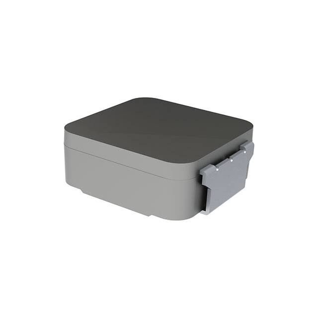

    固定电感器 Nonstandard 47µH ±20% 3A 182.6mΩ 4.5MHz
MPEV1D1040L470 数据手册
SMD Inductors Metal Composite Power Inductors MPEV Overview Applications The KEMET MPEV metal composite inductors are ideal for use in DC to DC switching power supplies for automotive applications. The metal composite core has high saturation characteristics maintaining functionality with high current transients and is characterized by temperature stable inductance. The high heat resistance property of the inductor has been further improved and allows for operating temperature up to +180°C. Automotive ECU applications such as: • LED headlights • Meter cluster panels • Head-up displays (HUD) • Electric water pumps (EWP) • Electric oil pumps (EOP) • Electric power steering (EPS) Benefits • Metal composite powder • Shielded construction, SMD configuration • Inductance range from 0.47 – 47.00 µH • Operating temperature up to +180°C • Low acoustic noise • Low magnetic flux leakage • AEC–Q200 qualified Part Number System MPEV 1 D0630 L 1R5 Series Version Size Code Inductor Inductance Code µH MPEV 1 D0630 = 6x6x3.0 mm D1040 = 10x10x4.0 mm   The first two digits represent the inductance value. The third digit indicates the number of zeros to be added. R = decimal point Examples: 100 = 10.00 μH R68 = 0.68 µH 1R5 = 1.50 µH 101 = 100.00 µH Built Into Tomorrow © KEMET Electronics Corporation • KEMET Tower • One East Broward Boulevard Fort Lauderdale, FL 33301 USA • 954-766-2800 • www.kemet.com L9016_MPEV • 9/29/2021 1 SMD Inductors Metal Composite Power Inductors MPEV Performance Characteristics Item Performance Characteristics Operating Temperature Rated Inductance Range Inductance Tolerance Rated DC Resistance Range Rated Current Range −55°C to +180°C (including self-temperature rise) 0.47 – 47.00 µH at 100 kHz, 1 mA ±20% 2.4 – 186.3 mΩ maximum 2.7 – 26.4 A Table 1 – Ratings & Part Number Reference Part Number Inductance (µH) at 100 kHz, 1 mA Inductance Tolerance DC Resistance (mΩ) Typical DC Resistance (mΩ) Maximum Rated Current (A) Irms1 (Reference) Isat2 (Reference) Isat3 (Reference) SelfResonance Frequency (MHz) MPEV1D0630LR47 0.47 ±20% 3.50 4.00 18.7 15.0 21.0 70.0 MPEV1D0630LR68 0.68 ±20% 5.30 6.20 15.1 11.5 17.0 55.0 MPEV1D0630L1R0 1.00 ±20% 7.10 8.20 13.1 9.0 13.0 43.0 MPEV1D0630L1R5 1.50 ±20% 11.00 12.70 10.5 7.0 11.0 38.0 MPEV1D0630L2R2 2.20 ±20% 15.90 18.30 8.7 6.5 9.0 30.0 MPEV1D0630L3R3 3.30 ±20% 26.30 30.30 6.8 5.0 7.0 26.0 MPEV1D0630L4R7 4.70 ±20% 31.80 36.70 6.2 4.5 6.5 21.0 MPEV1D0630L6R8 6.80 ±20% 44.20 50.90 5.2 4.0 5.5 16.0 MPEV1D0630L100 10.00 ±20% 67.80 78.00 4.2 3.5 4.5 15.0 MPEV1D0630L150 15.00 ±20% 113.20 130.20 3.3 3.0 4.0 13.0 MPEV1D0630L220 22.00 ±20% 162.00 186.30 2.7 2.5 3.5 9.6 MPEV1D1040LR47 0.47 ±20% 2.10 2.40 26.4 29.0 42.0 65.0 MPEV1D1040LR68 0.68 ±20% 2.70 3.20 23.1 23.0 34.5 47.0 MPEV1D1040L1R0 1.00 ±20% 3.30 3.80 21.1 19.5 29.0 35.0 MPEV1D1040L1R5 1.50 ±20% 4.60 5.40 17.7 18.0 26.0 30.0 MPEV1D1040L2R2 2.20 ±20% 6.80 7.90 14.6 13.0 18.5 23.0 MPEV1D1040L3R3 3.30 ±20% 11.10 12.80 11.4 11.0 15.0 18.0 MPEV1D1040L4R7 4.70 ±20% 13.80 15.90 10.3 10.0 14.0 17.0 MPEV1D1040L6R8 6.80 ±20% 20.90 24.10 8.3 8.0 11.5 14.0 MPEV1D1040L100 10.00 ±20% 29.60 34.10 7.0 7.5 10.5 11.0 MPEV1D1040L150 15.00 ±20% 44.50 51.20 5.7 5.5 8.5 8.0 MPEV1D1040L220 22.00 ±20% 66.20 76.10 4.7 5.0 7.0 7.0 MPEV1D1040L330 33.00 ±20% 104.10 119.70 3.7 3.5 5.0 5.0 MPEV1D1040L470 47.00 ±20% 158.80 182.60 Part Number Inductance (µH) at 100 kHz, 1 mA Inductance Tolerance DC Resistance DC Resistance (mΩ) Typical (mΩ) Maximum 3.0 3.0 4.0 4.5 Irms1 Isat2 Isat3 Self-Resonance Frequency (MHz) Rated Current (A) T = 40 K rise at rated current Inductance drop 20% at rated current 3 Inductance drop 30% at rated current All electrical characteristics data is referenced to 25°C. 1 2 © KEMET Electronics Corporation • KEMET Tower • One East Broward Boulevard Fort Lauderdale, FL 33301 USA • 954-766-2800 • www.kemet.com L9016_MPEV • 9/29/2021 2 SMD Inductors Metal Composite Power Inductors MPEV DC-Superposed Characteristics MPEV1D0630 MPEV1D0630LR47 MPEV1D0630LR68 0.8 0.5 Inductance [uH] Inductance [uH] 0.6 0.4 0.3 0.2 0.1 0.0 0 5 10 15 20 25 DC Current [A] 30 0.6 0.4 0.2 0.0 35 0 5 MPEV1D0630L1R0 Inductance [uH] Inductance [uH] 1.2 0.9 0.6 0.3 0 5 10 15 DC Current [A] 1.5 1.0 0.5 0.0 20 0 5 10 15 DC Current [A] 20 MPEV1D0630L3R3 MPEV1D0630L2R2 5 3.0 2.5 2.0 1.5 1.0 0.5 0.0 Inductance [uH] Inductance [uH] 30 2.0 0.0 0 2 4 6 8 10 12 DC Current [A] 14 4 3 2 1 0 16 0 2 4 6 8 10 DC Current [A] 12 14 MPEV1D0630L6R8 MPEV1D0630L4R7 8 Inductance [uH] Inductance [uH] 25 MPEV1D0630L1R5 1.5 6 5 4 3 2 1 0 10 15 20 DC Current [A] 0 2 4 6 8 DC Current [A] 10 12 © KEMET Electronics Corporation • KEMET Tower • One East Broward Boulevard Fort Lauderdale, FL 33301 USA • 954-766-2800 • www.kemet.com 6 4 2 0 0 2 4 6 DC Current [A] 8 10 L9016_MPEV • 9/29/2021 3 SMD Inductors Metal Composite Power Inductors MPEV DC-Superposed Characteristics cont. MPEV1D0630 cont. MPEV1D0630L100 MPEV1D0630L150 20 10 Inductance [uH] Inductance [uH] 12 8 6 4 2 0 0 2 4 DC Current [A] 6 8 15 10 5 0 0 1 2 3 4 DC Current [A] 5 6 MPEV1D0630L220 Inductance [uH] 25 20 15 10 5 0 0 1 2 3 DC Current [A] 4 5 © KEMET Electronics Corporation • KEMET Tower • One East Broward Boulevard Fort Lauderdale, FL 33301 USA • 954-766-2800 • www.kemet.com L9016_MPEV • 9/29/2021 4 SMD Inductors Metal Composite Power Inductors MPEV DC-Superposed Characteristics cont. MPEV1D1040 MPEV1D1040LR68 MPEV1D1040LR47 1.0 0.5 Inductance [uH] Inductance [uH] 0.6 0.4 0.3 0.2 0.1 0.0 0 10 20 30 DC Current [A] 40 0.8 0.6 0.4 0.2 0.0 50 0 MPEV1D1040L1R0 Inductance [uH] Inductance [uH] 0.8 0.6 0.4 0.2 0 5 10 15 20 25 DC Current [A] 30 1.0 0.5 MPEV1D1040L2R2 0 5 10 15 20 DC Current [A] 25 30 MPEV1D1040L3R3 5 Inductance [uH] Inductance [uH] 40 1.5 0.0 35 2.5 2.0 1.5 1.0 0.5 0.0 0 5 10 15 DC Current [A] 20 4 3 2 1 0 25 0 MPEV1D1040L4R7 5 10 DC Current [A] 15 20 MPEV1D1040L6R8 6 8 5 Inductance [uH] Inductance [uH] 30 2.0 1.0 4 3 2 1 0 20 DC Current [A] MPEV1D1040L1R5 1.2 0.0 10 0 5 10 DC Current [A] 15 20 © KEMET Electronics Corporation • KEMET Tower • One East Broward Boulevard Fort Lauderdale, FL 33301 USA • 954-766-2800 • www.kemet.com 6 4 2 0 0 3 6 9 DC Current [A] 12 15 L9016_MPEV • 9/29/2021 5 SMD Inductors Metal Composite Power Inductors MPEV DC-Superposed Characteristics cont. MPEV1D1040 cont. MPEV1D1040L150 MPEV1D1040L100 20 10 Inductance [uH] Inductance [uH] 12 8 6 4 2 0 15 10 5 0 0 3 6 9 DC Current [A] 12 15 0 MPEV1D1040L220 10 12 40 20 Inductance [uH] Inductance [uH] 4 6 8 DC Current [A] MPEV1D1040L330 25 15 10 5 0 2 0 2 4 6 DC Current [A] 8 10 30 20 10 0 0 2 4 6 DC Current [A] 8 10 MPEV1D1040L470 Inductance [uH] 60 50 40 30 20 10 0 0 1 2 3 4 DC Current [A] 5 6 © KEMET Electronics Corporation • KEMET Tower • One East Broward Boulevard Fort Lauderdale, FL 33301 USA • 954-766-2800 • www.kemet.com L9016_MPEV • 9/29/2021 6 SMD Inductors Metal Composite Power Inductors MPEV Dimensions Case Size Dimensions (mm) Land Pattern (mm) 8.255 3.429 (1.3) 3.2 ± 0.3 6.5 ± 0.2 MPEV1D0630 (1.3) 3.0 Maximum 7.0 ± 0.25 3.429 12.192 (2.0) (2.0) 4.7 ± 0.3 10.0 ± 0.2 MPEV1D1040 For values up to 1.5 μH or below 4.0 Maximum 4.953 10.8 ± 0.30 5.842 12.065 (2.0) 3.251 (2.0) 3.0 ± 0.3 MPEV1D1040 For values from 2.2 μH or above 4.0 Maximum 10.0 ± 0.2 10.8 ± 0.3 5.817 © KEMET Electronics Corporation • KEMET Tower • One East Broward Boulevard Fort Lauderdale, FL 33301 USA • 954-766-2800 • www.kemet.com L9016_MPEV • 9/29/2021 7 SMD Inductors Metal Composite Power Inductors MPEV Construction Metal Composite Copper Coil Metal Terminal Taping Specification Dimensions of Indented Square Hole Plastic Tape P0 øD0 P2 E1 W F T P1 Case Size Reel Quantity MPEV1D0630 1,500 MPEV1D1040 500 A B Dimensions Enlarged A0 C   Dimensions (mm) W F Tolerance Nominal ±0.30 16.00 ±0.10 7.50 ±0.10 1.75 ±0.10 12.00 ±0.10 2.00 ±0.10 4.00 ±0.10 1.55 ±0.05 0.40 Tolerance Nominal ±0.30 24.00 ±0.10 11.50 ±0.10 1.75 ±0.10 16.00 ±0.10 2.00 ±0.10 4.00 ±0.05 1.55 ±0.05 0.40 Enlarged A0 C W1 E1 P1 P2 P0 øD0 T D W2 © KEMET Electronics Corporation • KEMET Tower • One East Broward Boulevard Fort Lauderdale, FL 33301 USA • 954-766-2800 • www.kemet.com D L9016_MPEV • 9/29/2021 8 W SMD Inductors P 1 Metal Composite Power Inductors MPEV Reel Specifications A B W1 A0 C Enlarged D W2 D Dimensions (mm) Case Size A B C D A0 W1 W2 MPEV1D0630 Tolerance Nominal ±2.0 ø330 ±2.0 ø100 ±0.2 ø13.2 ±0.8 ø21.5 ±0.5 2.5 16.9 21.3 MPEV1D1040 Tolerance Nominal ±3.0 ø330 ±2.0 ø100 ±0.5 ø13.0 ±0.8 ø21.5 ±0.5 2.6 25.0 29.4 Soldering Process Recommended Reflow Soldering Profile Reference ICP/JEDEC J-STD-020E Profile Feature Pb-Free Assembly Preheat/Soak Temperature Minimum (TSmin) Temperature Maximum (TSmax) Time (ts) from Tsmin to Tsmax 150°C 200°C 60 – 120 seconds Ramp-Up Rate (TL to TP) 3°C/second maximum Time Above Liquidous (tL) 60 – 150 seconds Peak Temperature (TP) 250°C for MPEV1D0630 245°C for MPEV1D1040 Time within 5°C of Maximum Peak Temperature (tP) 30 seconds maximum Ramp-Down Rate (TP to TL) Time 25°C to Peak Temperature 6°C/second maximum 8 minutes maximum Liquidous Temperature (TL) 217°C © KEMET Electronics Corporation • KEMET Tower • One East Broward Boulevard Fort Lauderdale, FL 33301 USA • 954-766-2800 • www.kemet.com TP TL Temperature A0 C tP Maximum Ramp-up Rate = 3°C/second Maximum Ramp-down Rate = 6°C/second tL Tsmax Tsmin 25 ts 25°C to Peak Time L9016_MPEV • 9/29/2021 9 SMD Inductors Metal Composite Power Inductors MPEV Handling Precautions Inductors should be stored in normal working environments. While the inductors themselves are quite robust in other environments, exposure to high temperatures, high humidity, corrosive atmospheres, and long-term storage degrades solderability. KEMET recommends that maximum storage temperature not exceed 40°C and maximum storage humidity not exceed 70% relative humidity. Atmospheres should be free of chlorine-bearing and sulfur-bearing compounds. Temperature fluctuations should be minimized to avoid condensation on the parts. For optimized solderability, inductor stock should be used promptly, preferably within six months of receipt. © KEMET Electronics Corporation • KEMET Tower • One East Broward Boulevard Fort Lauderdale, FL 33301 USA • 954-766-2800 • www.kemet.com L9016_MPEV • 9/29/2021 10 SMD Inductors Metal Composite Power Inductors MPEV KEMET Electronics Corporation Sales Offices For a complete list of our global sales offi ces, please visit www.kemet.com/sales. Disclaimer All product specifi cations, statements, information and data (collectively, the “Information”) in this datasheet are subject to change. The customer is responsible for checking and verifying the extent to which the Information contained in this publication is applicable to an order at the time the order is placed. All Information given herein is believed to be accurate and reliable, but it is presented without guarantee, warranty, or responsibility of any kind, expressed or implied. Statements of suitability for certain applications are based on KEMET Electronics Corporation’s (“KEMET”) knowledge of typical operating conditions for such applications, but are not intended to constitute – and KEMET specifi cally disclaims – any warranty concerning suitability for a specifi c customer application or use. The Information is intended for use only by customers who have the requisite experience and capability to determine the correct products for their application. Any technical advice inferred from this Information or otherwise provided by KEMET with reference to the use of KEMET’s products is given gratis, and KEMET assumes no obligation or liability for the advice given or results obtained. Although KEMET designs and manufactures its products to the most stringent quality and safety standards, given the current state of the art, isolated component failures may still occur. Accordingly, customer applications which require a high degree of reliability or safety should employ suitable designs or other safeguards (such as installation of protective circuitry or redundancies) in order to ensure that the failure of an electrical component does not result in a risk of personal injury or property damage. Although all product–related warnings, cautions and notes must be observed, the customer should not assume that all safety measures are indicted or that other measures may not be required. When providing KEMET products and technologies contained herein to other countries, the customer must abide by the procedures and provisions stipulated in all applicable export laws and regulations, including without limitation the International Traffi c in Arms Regulations (ITAR), the US Export Administration Regulations (EAR) and the Japan Foreign Exchange and Foreign Trade Act. KEMET is a registered trademark of KEMET Electronics Corporation. © KEMET Electronics Corporation • KEMET Tower • One East Broward Boulevard Fort Lauderdale, FL 33301 USA • 954-766-2800 • www.kemet.com L9016_MPEV • 9/29/2021 11
