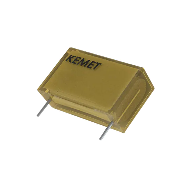

P278SJ333M480A
P278SJ333M480A
    KEMET(基美)
    插件,P=22.5mm
    薄膜电容 径向 33nF ±20% 27.00 x 8.00mm
P278SJ333M480A 数据手册
AC Line EMI Suppression and RC Networks P278, Metallized Impregnated Paper, Class X1, 480 VAC Overview Applications Multilayer metallized paper encapsulated and impregnated in self-extinguishing material that meets the requirements of UL 94 V–0. Typical applications include worldwide use as an electromagnetic interference suppressor in all X1 and across-the-line applications. Benefits • Approvals: ENEC, UL, cUL • Rated voltage: 480 VAC 50/60 Hz • Capacitance range: 0.001 – 0.15 µF • Lead Spacing: 10.2 – 25.4 mm • Capacitance tolerance: ±20% • Climatic category: 40/110/56, IEC 60068–1 • Tape & Reel in accordance with IEC 60286–2 • RoHS compliance and lead-free terminations • Operating temperature range of −40°C to +110°C • 100% screening factory test at 2,700 VDC • Highest possible safety regarding active and passive flammability • Excellent self-healing properties that ensure long life, even when subjected to frequent over-voltages • Good resistance to ionization due to impregnated paper dielectric • Impregnated paper that ensures excellent stability and reliability properties, particularly in applications that operate continuously Part Number System P 278 H E 102 M 480 A Capacitor Class Series Lead Spacing (mm) Size Code Capacitance Code (pF) Capacitance Tolerance Rated Voltage (VAC) Packaging P = Paper X1, Metallized Paper First two digits represent significant figures. Third digit specifies number of zeros. M = ±20% 480 = 480 H = 10.2 Q = 15.2 C = 20.3 S = 22.5 E = 25.4 See Dimension Table See Ordering Options Table Built Into Tomorrow © KEMET Electronics Corporation • KEMET Tower • One East Broward Boulevard Fort Lauderdale, FL 33301 USA • 954-766-2800 • www.kemet.com F3087_P278_X1_480 • 2/9/2022 1 Film Capacitors – AC Line EMI Suppression and RC Networks P278, Metallized Impregnated Paper, Class X1, 480 VAC Ordering Options Table Lead Spacing Nominal (mm) Type of Leads and Packaging Lead Length (mm) Part Number (Insert at 14th character) Standard Lead and Packaging Options 10.2 Bulk – Short Leads 6 +0/−1 C Bulk – Maximum Length Leads 30 +5/−0 A H0= 18.5 ±0.5 L H0= 18.5 ±0.5 XLAF1 H0= 18.5 ±0.5 P 6 +0/−1 C Tape & Reel (Standard Reel) Other Lead and Packaging Options Ammo Pack formed to Tape & Reel (Large Reel) Standard Lead and Packaging Options Bulk – Short Leads 15.2 Bulk – Maximum Length Leads Tape & Reel (Standard Reel) 30 +5/−0 A H0= 18.5 ±0.5 L H0= 18.5 ±0.5 P 6 +0/−1 C Other Lead and Packaging Options Tape & Reel (Large Reel) Standard Lead and Packaging Options Tray – Short Leads 20.3 Bulk – Maximum Length Leads Tape & Reel (Standard Reel) 30 +5/−0 A H0= 18.5 ±0.5 L H0= 18.5 ±0.5 P Other Lead and Packaging Options Tape & Reel (Large Reel) Standard Lead and Packaging Options 22.5 Tray – Short Leads 6 +0/−1 C Bulk – Maximum Length Leads 30 +5/−0 A H0= 18.5 ±0.5 L H0= 18.5 ±0.5 P Tape & Reel (Standard Reel) Other Lead and Packaging Options Tape & Reel (Large Reel) Standard Lead and Packaging Options 25.4 Tray – Short Leads 6 +0/−1 C Bulk – Maximum Length Leads 30 +5/−0 A © KEMET Electronics Corporation • KEMET Tower • One East Broward Boulevard Fort Lauderdale, FL 33301 USA • 954-766-2800 • www.kemet.com F3087_P278_X1_480 • 2/9/2022 2 Film Capacitors – AC Line EMI Suppression and RC Networks P278, Metallized Impregnated Paper, Class X1, 480 VAC Dimensions – Millimeters FRONT VIEW SIDE VIEW L T H S LL d b S T H L d b Size Code Nominal Tolerance Nominal Tolerance Nominal Tolerance Nominal Tolerance Nominal Tolerance Tolerance HE HH HL QE QJ QS CE CJ CP SJ SP SU EJ EL 10.2 10.2 10.2 15.2 15.2 15.2 20.3 20.3 20.3 22.5 22.5 22.5 25.4 25.4 ±0.4 ±0.4 ±0.4 ±0.4 ±0.4 ±0.4 ±0.4 ±0.4 ±0.4 ±0.4 ±0.4 ±0.4 ±0.4 ±0.4 3.9 4.1 5.1 5.2 5.5 8.5 7.6 9.0 11.3 8.0 10.0 12.0 12.1 15.3 Maximum Maximum Maximum Maximum Maximum Maximum Maximum Maximum Maximum Maximum Maximum Maximum Maximum Maximum 7.5 8.2 10.5 10.5 11.1 14.3 14.0 15.0 16.5 17.0 19.0 22.0 19.0 22.0 Maximum Maximum Maximum Maximum Maximum Maximum Maximum Maximum Maximum Maximum Maximum Maximum Maximum Maximum 13.5 13.5 13.5 18.5 18.5 18.5 24.0 24.0 24.0 27.0 27.0 27.0 30.5 30.5 Maximum Maximum Maximum Maximum Maximum Maximum Maximum Maximum Maximum Maximum Maximum Maximum Maximum Maximum 0.6 0.6 0.6 0.8 0.8 0.8 0.8 0.8 0.8 0.8 0.8 0.8 1.0 1.0 ±0.05 ±0.05 ±0.05 ±0.05 ±0.05 ±0.05 ±0.05 ±0.05 ±0.05 ±0.05 ±0.05 ±0.05 ±0.05 ±0.05 ±0.4 ±0.4 ±0.4 ±0.4 ±0.4 ±0.4 ±0.4 ±0.4 ±0.4 ±0.4 ±0.4 ±0.4 ±0.4 ±0.4 Note: See Ordering Options Table for lead length (LL) options. © KEMET Electronics Corporation • KEMET Tower • One East Broward Boulevard Fort Lauderdale, FL 33301 USA • 954-766-2800 • www.kemet.com F3087_P278_X1_480 • 2/9/2022 3 Film Capacitors – AC Line EMI Suppression and RC Networks P278, Metallized Impregnated Paper, Class X1, 480 VAC Performance Characteristics Rated Voltage Capacitance Range Capacitance Tolerance Temperature Range Climatic Category Approvals 480 VAC 50/60Hz 0.001 – 0.15 µF ±20% −40°C to +110°C 40/110/56/B ENEC, UL, cUL Maximum Values at +23°C Dissipation Factor Test Voltage Between Terminals 1 kHz The 100% screening factory test is carried out at 2,700 VDC. The voltage level is selected to meet the requirements in applicable equipment standards. All electrical characteristics are checked after the test. This test may not be repeated due to potential capacitor damage. KEMET is not liable for any failures that result from performing the test again. Minimum Value Between Terminals: Insulation Resistance In DC Applications Resonance Frequency 1.3% ≥ 12,000 MΩ Recommended voltage ≤ 1,000 VDC Tabulated self-resonance frequencies (f0) refer to 5 mm lead length Environmental Test Data Test IEC Publication Procedure Endurance IEC 60384–14 1.25 x V R VAC 50 Hz , once every hour increase to 1,000 VAC for 0.1 seconds, 1,000 hours at upper rated temperature Vibration IEC 60068–2–6 Test Fc 3 directions at 2 hours each 10 – 500 Hz at 0.75 mm or 98m/seconds2 Bump IEC 60068–2–29 Test Eb 4,000 bumps at 390 m/seconds2 Change of Temperature IEC 60068–2–14 Test Na Upper and lower rated temperature 5 cycles Active Flammability IEC 60384–14 V R + 20 surge pulses at 4.0 kV (pulse every 5 seconds) Passive Flammability IEC 60384–14 IEC 60384–1, IEC 60695–11–5 Needle-flame test Damp Heat Steady State IEC 60068–2–78 Test Cab +40°C and 93% RH, 56 days © KEMET Electronics Corporation • KEMET Tower • One East Broward Boulevard Fort Lauderdale, FL 33301 USA • 954-766-2800 • www.kemet.com F3087_P278_X1_480 • 2/9/2022 4 Film Capacitors – AC Line EMI Suppression and RC Networks P278, Metallized Impregnated Paper, Class X1, 480 VAC Approvals Certification Body Mark Specification File Number Intertek Semko AB EN/IEC 60384–14 SE/0140–35A UL UL 60384–14 CAN/CSA-E60384–14–09 E73869 Environmental Compliance All KEMET EMI capacitors are RoHS compliant. Table 1 – Ratings & Part Number Reference Capacitance Value (µF) Maximum Dimensions in mm B H L Lead Spacing (p) fo (MHz) dV/dt (V/µs) KEMET Part Number 0.001 0.0015 0.0022 0.0033 0.0047 0.0068 0.010 0.015 0.022 0.033 0.047 0.068 0.033 0.047 0.068 0.1 0.1 0.15 3.9 3.9 3.9 4.1 5.1 5.2 5.2 5.5 8.5 7.6 9.0 11.3 8.0 8.0 10.0 12.0 12.1 15.3 7.5 7.5 7.5 8.2 10.5 10.5 10.5 11.1 14.3 14.0 15.0 16.5 17.0 17.0 19.0 22.0 19.0 22.0 13.5 13.5 13.5 13.5 13.5 18.5 18.5 18.5 18.5 24.0 24.0 24.0 27.0 27.0 27.0 27.0 30.5 30.5 10.2 10.2 10.2 10.2 10.2 15.2 15.2 15.2 15.2 20.3 20.3 20.3 22.5 22.5 22.5 22.5 25.4 25.4 53 44 37 30 24 18.5 15.5 13 9.6 9.6 7.5 6.2 7.2 6 4.8 3.6 3.9 3.2 2,000 2,000 2,000 2,000 2,000 1,400 1,400 1,400 1,400 1,000 1,000 1,000 1,000 1,000 1,000 600 600 600 P278HE102M480(1) P278HE152M480(1) P278HE222M480(1) P278HH332M480(1) P278HL472M480(1) P278QE682M480(1) P278QE103M480(1) P278QJ153M480(1) P278QS223M480(1) P278CE333M480(1) P278CJ473M480(1) P278CP683M480(1) P278SJ333M480(1) P278SJ473M480(1) P278SP683M480(1) P278SU104M480(1) P278EJ104M480(1) P278EL154M480(1) Capacitance Value (µF) B (mm) H (mm) L (mm) Lead Spacing (p) fo (MHz) dV/dt (V/µs) KEMET Part Number (1) Insert ordering code for lead type and packaging. See Ordering Options Table for available options. © KEMET Electronics Corporation • KEMET Tower • One East Broward Boulevard Fort Lauderdale, FL 33301 USA • 954-766-2800 • www.kemet.com F3087_P278_X1_480 • 2/9/2022 5 Film Capacitors – AC Line EMI Suppression and RC Networks P278, Metallized Impregnated Paper, Class X1, 480 VAC Soldering Process The implementation of the RoHS directive has resulted in the selection of SnAuCu (SAC) alloys or SnCu alloys as primary solder. This has increased the liquidus temperature from that of 183ºC for the SnPb eutectic alloy to 217 – 221ºC for the new alloys. As a result, the heat stress to the components, even in wave soldering, has increased considerably due to higher pre-heat and wave temperatures. Polypropylene capacitors are especially sensitive to heat (the melting point of polypropylene is 160 – 170ºC). Wave soldering can be destructive, especially for mechanically small polypropylene capacitors (with lead spacing of 5 mm to 15 mm), and great care has to be taken during soldering. The recommended solder profiles from KEMET should be used. Please consult KEMET with any questions. In general, the wave soldering curve from IEC Publication 61760-1 Edition 2 serves as a solid guideline for successful soldering. Please see Figure 1. Reflow soldering is not recommended for through-hole film capacitors. Exposing capacitors to a soldering profile in excess of the above the recommended limits may result in degradation of or permanent damage to the capacitors. Do not place the polypropylene capacitor through an adhesive curing oven to cure resin for surface mount components. Insert through-hole parts after the curing of surface mount parts. Consult KEMET to discuss the actual temperature profile in the oven, if through-hole components must pass through the adhesive curing process. A maximum of two soldering cycles is recommended. Allow time for the capacitor surface temperature to return to a normal temperature before the second soldering cycle. Figure 1 Wave Soldering Recommendations 300 2+3 seconds max 260°C 250 Second Wave First Wave Temperature (°C) 200 ∆ T < 150°C Cooling Preheating 150 ca. 2°C/second ca. 3.5°C/second typical ca. 5°C/second Tpreheat 100 Typical 50 0 0 40 80 120 160 200 240 Time (seconds) © KEMET Electronics Corporation • KEMET Tower • One East Broward Boulevard Fort Lauderdale, FL 33301 USA • 954-766-2800 • www.kemet.com F3087_P278_X1_480 • 2/9/2022 6 Film Capacitors – AC Line EMI Suppression and RC Networks P278, Metallized Impregnated Paper, Class X1, 480 VAC Soldering Process cont. Wave Soldering Recommendations cont. 1. The table indicates the maximum set-up temperature of the soldering process. Dielectric film material Maximum Preheat Temperature Maximum Peak Soldering Temperature Capacitor Capacitor Capacitor Capacitor Pitch ≥ 10 mm Pitch > 15 mm Pitch ≤ 15 mm Pitch > 15 mm Polyester 130°C 130°C 270°C 270°C Polypropylene 110°C 130°C 260°C 270°C Paper 130°C 140°C 270°C 270°C Polyphenylene Sulphide 150°C 160°C 270°C 270°C 2. The maximum temperature measured inside the capacitor: set the temperature so that inside the element the maximum temperature is below the limit: Dielectric Film Material Maximum Temperature Measured Inside the Element Polyester 160°C Polypropylene 110°C Paper 160°C Polyphenylene Sulphide 160°C Temperature monitored inside the capacitor. Selective Soldering Recommendations Selective dip soldering is a variation of reflow soldering. In this method, the printed circuit board with through-hole components to be soldered is preheated and transported over the solder bath, as in normal-flow soldering, without touching the solder. When the board is over the bath, it is stopped. Pre-designed solder pots are lifted from the bath with molten solder only at the places of the selected components, and then pressed against the lower surface of the board to solder the components. The temperature profile for selective soldering is similar to the temperature profile for double-wave flow soldering outlined in this document. However, instead of two baths, there is only one with a time from 3 to 10 seconds. In selective soldering, the risk of overheating is greater than in double-wave flow soldering, and great care must be taken so that the parts do not overheat. © KEMET Electronics Corporation • KEMET Tower • One East Broward Boulevard Fort Lauderdale, FL 33301 USA • 954-766-2800 • www.kemet.com F3087_P278_X1_480 • 2/9/2022 7 Film Capacitors – AC Line EMI Suppression and RC Networks P278, Metallized Impregnated Paper, Class X1, 480 VAC Construction Detailed Cross Section Metallized Impregnated Paper (First Layer) Self-Extinguishing Resin Self-Extinguishing Resin Metallized Impregnated Paper (Second Layer) Margin Margin Metal Contact Layer Margin Leads Metal Contact Layer Winding Scheme Metal Spraying Material Metallization Metal Spraying Material Impregnated Paper Impregnated Paper Single Design — Multilayer Impregnated Paper Dielectric 1 Section © KEMET Electronics Corporation • KEMET Tower • One East Broward Boulevard Fort Lauderdale, FL 33301 USA • 954-766-2800 • www.kemet.com Metallization Series Design — Multilayer Impregnated Paper Dielectric 2 Section F3087_P278_X1_480 • 2/9/2022 8 Film Capacitors – AC Line EMI Suppression and RC Networks P278, Metallized Impregnated Paper, Class X1, 480 VAC Marking FRONT BACK KEMET Logo Series IEC Climatic Category Voltage Self Healing Approval Mark Approval Mark Manufacturing Date Code TOP Capacitance Safety Class Manufacturing Date Code (IEC–60062) Y = Year, Z = Month Year 2010 2011 2012 2013 2014 2015 2016 2017 2018 2019 2020 2021 2022 2023 2024 2025 2026 2027 2028 2029 2030 Code A B C D E F H J K L M N P R S T U V W X A Month January February March April May June July August September October November December Code 1 2 3 4 5 6 7 8 9 O N D © KEMET Electronics Corporation • KEMET Tower • One East Broward Boulevard Fort Lauderdale, FL 33301 USA • 954-766-2800 • www.kemet.com F3087_P278_X1_480 • 2/9/2022 9 Film Capacitors – AC Line EMI Suppression and RC Networks P278, Metallized Impregnated Paper, Class X1, 480 VAC Packaging Quantities Lead Spacing (mm) Thickness (mm) Height (mm) Length (mm) Bulk Short Leads Bulk Long Leads Standard Reel 360 mm Large Reel 500 mm Ammo Formed 7.5 8.2 10.5 13.5 13.5 13.5 2,000 2,000 1,600 1,000 1,000 800 700 600 600 1,400 10.2 3.9 4.1 5.1 800 780 630 5.5 6.5 7.5 8.5 5.2 5.5 6.0 7.3 7.8 8.5 12.5 12.5 14.5 16.0 10.5 11.1 12.5 13.0 13.5 14.3 18.0 18.0 18.0 18.0 18.5 18.5 18.5 18.5 18.5 18.5 1,000 600 600 400 1000 1,000 600 600 600 500 500 400 400 250 500 500 400 400 400 300 600 400 400 400 600 500 400 400 400 350 7.6 8.4 9.0 11.3 14.0 14.0 15.0 16.5 24.0 24.0 24.0 24.0 1,500 1,200 1,500 1,000 250 200 200 150 250 250 250 180 400 8.0 10.0 12.0 17.0 19.0 22.0 27.0 27.0 27.0 1,200 1,000 800 200 150 100 200 180 350 10.6 10.5 12.1 15.3 16.1 17.3 19.0 22.0 30.5 30.5 30.5 30.5 1,000 1,000 800 600 150 100 100 75 15.2 20.3 22.5 25.4 © KEMET Electronics Corporation • KEMET Tower • One East Broward Boulevard Fort Lauderdale, FL 33301 USA • 954-766-2800 • www.kemet.com 1,200 800 500 500 F3087_P278_X1_480 • 2/9/2022 10 Film Capacitors – AC Line EMI Suppression and RC Networks P278, Metallized Impregnated Paper, Class X1, 480 VAC Lead Taping & Packaging (IEC 60286–2) Taping Specification Standard IEC 60286-2 Dimensions in mm Lead Spacing +0.6/−0.1 F 5 7.5 Formed 7.5 10 15 22.5 27.5 F ±0.5 W 18 18 18 18 18 18 18 18+1/−0.5 Minimum W0 5 5 5 5 5 5 5 Position of Sprocket Hole ±0.5 W1 9 9 9 9 9 9 9 9+0.75/−0.5 Distance Between Tapes Maximum W2 3 3 3 3 3 3 3 3 Sprocket Hole Diameter ±0.2 D0 4 4 4 4 4 4 4 4 Feed Hole Lead Spacing ±0.3 P0 (1) 12.7 12.7 12.7 (4) 12.7 12.7 12.7 12.7 12.7 Distance Lead – Feed Hole ±0.7 P1 3.85 3.75 3.75 7.7 5.2 5.3 5.3 P1 Deviation Tape – Plane Maximum ∆ p 1.3 1.3 1.3 1.3 1.3 1.3 1.3 1.3 Lateral Deviation Maximum ∆ h 2 2 2 2 2 2 2 2 0.7 0.9 Maximum 0.9 Maximum 0.9 Maximum 18.5±0.5 18.5±0.5 18.0+2/−0 58 58 58 Maximum Carrier Tape Width Hold-down Tape Width Total Thickness Sprocket Hole/Cap Body Sprocket Hole/ Top of Cap Body ±0.2 t Nominal H0 (2) Maximum H1 (3) 0.7 0.7 0.7 18.5±0.5 18.5±0.5 18.5±0.5 32 (1) Maximum cumulative feed hole error, 1 mm per 20 parts (2) 16.5 mm available on request 31 43 0.7 18.5±0.5 18.5±0.5 43 43 (3) Depending on case size (4) 15 mm available on request © KEMET Electronics Corporation • KEMET Tower • One East Broward Boulevard Fort Lauderdale, FL 33301 USA • 954-766-2800 • www.kemet.com F3087_P278_X1_480 • 2/9/2022 11 Film Capacitors – AC Line EMI Suppression and RC Networks P278, Metallized Impregnated Paper, Class X1, 480 VAC Lead Taping & Packaging (IEC 60286–2) cont. Ammo Specifications Series P278 Dimensions (mm) H W T 330 330 50 H Reel Specifications Series P278 T W Dimensions (mm) D H W 360 500 30 46 (Max) D H W © KEMET Electronics Corporation • KEMET Tower • One East Broward Boulevard Fort Lauderdale, FL 33301 USA • 954-766-2800 • www.kemet.com F3087_P278_X1_480 • 2/9/2022 12 Film Capacitors – AC Line EMI Suppression and RC Networks P278, Metallized Impregnated Paper, Class X1, 480 VAC KEMET Electronics Corporation Sales Offices For a complete list of our global sales offi ces, please visit www.kemet.com/sales. Disclaimer All product specifi cations, statements, information and data (collectively, the “Information”) in this datasheet are subject to change. The customer is responsible for checking and verifying the extent to which the Information contained in this publication is applicable to an order at the time the order is placed. All Information given herein is believed to be accurate and reliable, but it is presented without guarantee, warranty, or responsibility of any kind, expressed or implied. Statements of suitability for certain applications are based on KEMET Electronics Corporation’s (“KEMET”) knowledge of typical operating conditions for such applications, but are not intended to constitute – and KEMET specifi cally disclaims – any warranty concerning suitability for a specifi c customer application or use. The Information is intended for use only by customers who have the requisite experience and capability to determine the correct products for their application. Any technical advice inferred from this Information or otherwise provided by KEMET with reference to the use of KEMET’s products is given gratis, and KEMET assumes no obligation or liability for the advice given or results obtained. Although KEMET designs and manufactures its products to the most stringent quality and safety standards, given the current state of the art, isolated component failures may still occur. Accordingly, customer applications which require a high degree of reliability or safety should employ suitable designs or other safeguards (such as installation of protective circuitry or redundancies) in order to ensure that the failure of an electrical component does not result in a risk of personal injury or property damage. Although all product–related warnings, cautions and notes must be observed, the customer should not assume that all safety measures are indicted or that other measures may not be required. KEMET is a registered trademark of KEMET Electronics Corporation. © KEMET Electronics Corporation • KEMET Tower • One East Broward Boulevard Fort Lauderdale, FL 33301 USA • 954-766-2800 • www.kemet.com F3087_P278_X1_480 • 2/9/2022 13
