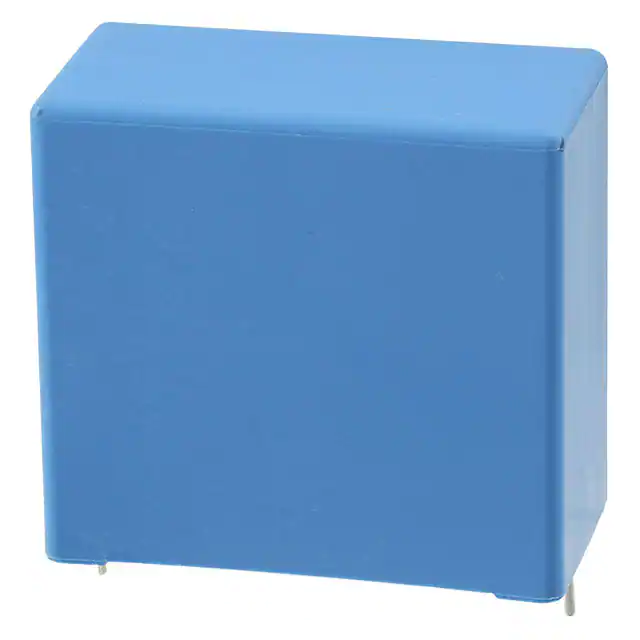

Metallized Polypropylene Film EMI Suppression Capacitors PHE844, Class X1, 440/480 VAC, 105°C Overview Applications The PHE844 series is constructed of metallized polypropylene film encapsulated with self-extinguishing resin in a box of material that meets the requirements of UL 94 V–0. For use as an electromagnetic interference (EMI) suppression filter in across-the-line applications that require X1 safety classification. Suitable for use in situations in which capacitor failure does not pose a danger of electric shock. Benefits • Approvals: ENEC, UL, cUL • Class X1 (IEC 60384-14) • THB Grade IA: 40°C, 93% RH, 500 hours at 480 V URAC acc. to IEC 60384-14 • Rated voltage: 440 VAC 50/60 Hz (ENEC), 480 VAC 50/60 Hz (UL, cUL) • Capacitance range: 0.1 – 2.2 µF • Lead spacing: 22.5 – 37.5 mm • Capacitance tolerance: ±20%, ±10% • Climatic category 40/105/56/B, IEC 60068–1 • Tape & Reel in accordance with IEC 60286–2 • RoHS Compliant and lead-free terminations • Operating temperature range of −40°C to +105°C • 100% screening factory test at 3,000 VDC • Self-healing properties Customer Part Number PHE844 R D 6100 M R06L2 Series Rated Voltage (VAC) Lead Spacing (mm) Capacitance Code (pF) Capacitance Tolerance Packaging X1, Metallized Polypropylene R = 440 D = 22.5 F = 27.5 R = 37.5 The last three digits represent significant figures. The first digit specifies the total number of digits. K = ±10% M = ±20% See Ordering Options Table KEMET Internal Part Number F 844 D H 104 M 440 C Capacitor Class Series Lead Spacing (mm) Size Code Capacitance Code (pF) Capacitance Tolerance Rated Voltage (VAC) Packaging D = 22.5 F = 27.5 R = 37.5 See Dimension Table The first two digits represent significant figures. The third digit specifies number of zeros. F = Film X1, Metallized Polypropylene K = ±10% M = ±20% 440 = 440 See Ordering Options Table Built Into Tomorrow © KEMET Electronics Corporation • KEMET Tower • One East Broward Boulevard Fort Lauderdale, FL 33301 USA • 954-766-2800 • www.kemet.com F3108_PHE844_X1_440-480 • 2/7/2022 1 Film Capacitors – Metallized Polypropylene Film EMI Suppression Capacitors PHE844, Class X1, 440/480 VAC, 105°C Ordering Options Table Lead Spacing Nominal (mm) Lead Length (mm) KEMET Lead and Packaging Code Legacy Lead and Packaging Code 6 +0/-1 C R06L2(1) Pizza Pack 6 +0/−1 Z R06L2(1) Bulk (Tray)–Long Leads 30 +0/−1 ALW0L R30L2 Tape & Reel (Standard Reel) H0= 18.5 ±0.5 L R17T0 Tape & Reel (Large Reel) H0= 18.5 ±0.5 P R17T1 6 +0/−1 C R06L2(1) Pizza Pack Bulk (Tray)–Long Leads 6 +0/−1 30 +0/−1 Z ALW0L R06L2(1) R30L2 Tape & Reel (Large Reel) H0= 18.5 ±0.5 P R17T1 6 +0/−1 C R06L2(1) 6 +0/−1 Z R06L2(1) Type of Leads and Packaging Standard Lead and Packaging Options Bulk (Tray)–Short Leads Other Lead and Packaging Options 22.5 Standard Lead and Packaging Options Bulk (Tray)–Short Leads 27.5 37.5 Other Lead and Packaging Options Standard Lead and Packaging Options Bulk (Tray)–Short Leads Other Lead and Packaging Options Pizza Pack (1) Please specify Bulk (Tray) or Pizza Packaging © KEMET Electronics Corporation • KEMET Tower • One East Broward Boulevard Fort Lauderdale, FL 33301 USA • 954-766-2800 • www.kemet.com F3108_PHE844_X1_440-480 • 2/7/2022 2 Film Capacitors – Metallized Polypropylene Film EMI Suppression Capacitors PHE844, Class X1, 440/480 VAC, 105°C Dimensions – Millimeters FRONT VIEW SIDE VIEW L T H S 0.5 LL F KEMET Size Code Legacy Size Code DH DM DT DW DY FE FK FM FR FV RF RH RM RP D14 D15 D16 D20 D19 F11 F03 F13 F14 F16 R05 R04 R03 R06 S T H L F Nominal Tolerance Nominal Tolerance Nominal Tolerance Nominal Tolerance Nominal Tolerance 22.5 22.5 22.5 22.5 22.5 27.5 27.5 27.5 27.5 27.5 37.5 37.5 37.5 37.5 ±0.4 ±0.4 ±0.4 ±0.4 ±0.4 ±0.4 ±0.4 ±0.4 ±0.4 ±0.4 ±0.5 ±0.5 ±0.5 ±0.5 8.0 9.0 11.0 13.5 15.5 10.5 13.5 14.5 17.5 21.0 13.0 15.0 19.0 21.0 Maximum Maximum Maximum Maximum Maximum Maximum Maximum Maximum Maximum Maximum Maximum Maximum Maximum Maximum 16.0 18.5 21.5 23.0 24.5 20.5 23.0 24.5 28.0 30.0 24.0 26.0 36.0 38.0 Maximum Maximum Maximum Maximum Maximum Maximum Maximum Maximum Maximum Maximum Maximum Maximum Maximum Maximum 26.0 26.0 26.0 26.0 26.0 31.5 31.5 31.5 31.5 31.5 41.0 41.0 41.0 41.0 Maximum Maximum Maximum Maximum Maximum Maximum Maximum Maximum Maximum Maximum Maximum Maximum Maximum Maximum 0.8 0.8 0.8 0.8 0.8 0.8 0.8 0.8 0.8 0.8 1.0 1.0 1.0 1.0 ±0.05 ±0.05 ±0.05 ±0.05 ±0.05 ±0.05 ±0.05 ±0.05 ±0.05 ±0.05 ±0.05 ±0.05 ±0.05 ±0.05 Note: See the Ordering Options Table for lead length (LL) options. © KEMET Electronics Corporation • KEMET Tower • One East Broward Boulevard Fort Lauderdale, FL 33301 USA • 954-766-2800 • www.kemet.com F3108_PHE844_X1_440-480 • 2/7/2022 3 Film Capacitors – Metallized Polypropylene Film EMI Suppression Capacitors PHE844, Class X1, 440/480 VAC, 105°C Performance Characteristics Dielectric Plates Winding Leads Protection Rated Voltage VR Polypropylene film Metal layer deposited by evaporation under vacuum Non-inductive type. Series design. Tinned wire Plastic case, thermosetting resin-filled. Box material is solvent-resistant and flame-retardant according to UL94 V–0. 440 VAC 50/60 Hz (ENEC) – 480 VAC 50/60 Hz (UL,cUL) Capacitance Range 0.10 – 2.2 µF Capacitance Values E6 series (IEC 60063) Capacitance Tolerance Temperature Range Climatic Category Approvals Related Documents ±20% standard, ±10% option -40°C to 105°C 40/105/56/B IEC 60068-1 ENEC, UL, cUL EN/IEC 60384-14:2005, UL 60384-14, CAN/CSA E60384-14:09 Maximum Values at +23°C Dissipation Factor (tanδ) Frequency C ≤ 0.1 μF 0.1 µF < C ≤ 1 µF C > 1 µF 1 kHz 0.1% 0.1% 0.1% 10 kHz 0.2% 0.4% 0.8% 100 kHz 0.6% - - Test Voltage Between Terminals The 100% screening factory test is carried out at 3,000 VDC. The voltage level is selected to meet the requirements in applicable equipment standards. All electrical characteristics are checked after the test. Do not repeat this test, as there is a risk of damaging the capacitor. KEMET is not liable for any failures if the test has been repeated. Resonance Frequency Tabulated Self-resonance Frequencies fo (see Table 1 – Ratings & Part Number Reference) Measured at +25°C ±5°C, according to IEC 60384-2 Insulation Resistance In DC Applications Minimum Values Between Terminals C ≤ 0.33 μF C > 0.33 μF ≥ 30,000 MΩ ≥ 10,000 MΩ • µF Recommended voltage ≤ 1,000 VDC © KEMET Electronics Corporation • KEMET Tower • One East Broward Boulevard Fort Lauderdale, FL 33301 USA • 954-766-2800 • www.kemet.com F3108_PHE844_X1_440-480 • 2/7/2022 4 Film Capacitors – Metallized Polypropylene Film EMI Suppression Capacitors PHE844, Class X1, 440/480 VAC, 105°C Environmental Test Data Test IEC Publication Endurance IEC 60384-14:2005 Vibration IEC 60068-2-6 Test Fc Bump IEC 60068-2-29 Test Eb Change of Temperature IEC 60068-2-14 Test Na Active Flammability IEC 60384-14:2005 VR + 20 surge pulses at 4 kV (pulse every 5 seconds) Passive Flammability IEC 60384-14:2005 IEC 60384–1, IEC 60695–11–5 Needle Flame Test Damp Heat Steady State IEC 60068-2-78 Test Cab THB Test According to Grade IA Procedure 1.25 x VR VAC 50 Hz, once every hour increase to 1,000 VAC for 0.1 second, 1,000 hours at upper rated temperature 3 directions at 2 hours each 10 – 55 Hz at 0.75 mm or 98 m/s2 No visible damage. No open or short circuit. 1,000 bumps at 390 m/s2 No visible damage. No open or short circuit. Upper and lower rated temperature 5 cycles No visible damage. +40°C and 90 – 95% RH, 56 days +40°C and 90 - 95% RH, 21 days at rated AC-voltage Capacitance change (∆C/C): ≤ 10% Dissipation factor change (∆tan δ): ≤ 24 * 10−3 (at 10 kHz) for C ≤ 1 µF Dissipation factor change (∆tan δ): ≤ 15 * 10−3 (at 1 kHz) for C > 1 µF Insulation resistance IR in seconds or time constant τ = CR Rins: ≥ 50% of initial limit Approvals Certification Body Mark Specification File Number Intertek Semko AB EN/IEC 60384-14 SE/0140–1D UL UL 60384 and CAN/CSA E60384-14:09 (480 VAC) E73869 Environmental Compliance All KEMET EMI capacitors are RoHS compliant. © KEMET Electronics Corporation • KEMET Tower • One East Broward Boulevard Fort Lauderdale, FL 33301 USA • 954-766-2800 • www.kemet.com F3108_PHE844_X1_440-480 • 2/7/2022 5 Film Capacitors – Metallized Polypropylene Film EMI Suppression Capacitors PHE844, Class X1, 440/480 VAC, 105°C Table 1 – Ratings & Part Number Reference Capacitance Value (µF) Size Code (KEMET/ Legacy) 0.10 0.15 0.22 0.33 0.47 0.22 0.33 0.47 0.68 1.0 0.47 0.68 1.0 1.5 2.2 DH/D14 DM/D15 DT/D16 DW/D20 DY/D19 FE/F11 FK/F03 FM/F13 FR/F14 FV/F16 RF/R05 RF/R05 RH/R04 RM/R03 RP/R06 Capacitance Value (µF) Size Code (KEMET/Legacy) Maximum Dimensions in mm T H L Lead Spacing (S) fo (MHz) dV/dt (V/ µs) KEMET Part Number Legacy Part Number 8.0 9.0 11.0 13.5 15.5 10.5 13.5 14.5 17.5 21.0 13.0 13.0 15.0 19.0 21.0 16.0 18.5 21.5 23.0 24.5 20.5 23.0 24.5 28.0 30.0 24.0 24.0 26.0 36.0 38.0 26.0 26.0 26.0 26.0 26.0 31.5 31.5 31.5 31.5 31.5 41.0 41.0 41.0 41.0 41.0 22.5 22.5 22.5 22.5 22.5 27.5 27.5 27.5 27.5 27.5 37.5 37.5 37.5 37.5 37.5 3.2 2.6 2.1 1.8 1.5 2.2 1.7 1.4 1.1 1.0 1.3 1.1 0.92 0.74 0.60 100 100 100 100 100 100 100 100 100 100 100 100 100 100 100 F844DH104(1)440(2) F844DM154(1)440(2) F844DT224(1)440(2) F844DW334(1)440(2) F844DY474(1)440(2) F844FE224(1)440(2) F844FK334(1)440(2) F844FM474(1)440(2) F844FR684(1)440(2) F844FV105(1)440(2) F844RF474(1)440(2) F844RF684(1)440(2) F844RH105(1)440(2) F844RM155(1)440(2) F844RP225(1)440(2) PHE844RD6100(1)(2) PHE844RD6150(1)(2) PHE844RD6220(1)(2) PHE844RD6330(1)(2) PHE844RD6470(1)(2) PHE844RF6220(1)(2) PHE844RF6330(1)(2) PHE844RF6470(1)(2) PHE844RF6680(1)(2) PHE844RF7100(1)(2) PHE844RR6470(1)(2) PHE844RR6680(1)(2) PHE844RR7100(1)(2) PHE844RR7150(1)(2) PHE844RR7220(1)(2) T (mm) H (mm) L (mm) Lead Spacing (S) fo (MHz) dV/dt (V/µs) KEMET Part Number Legacy Part Number (1) M = ±20%, K = ±10%. (2) Insert ordering code for lead type and packaging. See the Ordering Options Table for available options. © KEMET Electronics Corporation • KEMET Tower • One East Broward Boulevard Fort Lauderdale, FL 33301 USA • 954-766-2800 • www.kemet.com F3108_PHE844_X1_440-480 • 2/7/2022 6 Film Capacitors – Metallized Polypropylene Film EMI Suppression Capacitors PHE844, Class X1, 440/480 VAC, 105°C Soldering Process The implementation of the RoHS directive has resulted in the selection of SnAuCu (SAC) alloys or SnCu alloys as primary solder. This implementation has increased the liquidus temperature from 183ºC for SnPb eutectic alloys to 217 – 221ºC for the new alloys. As a result, the heat stress to the components, even in wave soldering, has increased considerably due to higher pre-heat and wave temperatures. Polypropylene capacitors are especially sensitive to heat (the melting point of polypropylene is 160 – 170ºC). Wave soldering can be destructive, especially for mechanically small polypropylene capacitors (with lead spacing of 5 – 15 mm), and great care must be taken during soldering. The recommended solder profiles from KEMET should be used. Consult KEMET with any questions. In general, the wave soldering curve from IEC Publication 61760-1 Edition 2 serves as a solid guideline for successful soldering. See Figure 1. Reflow soldering is not recommended for through-hole film capacitors. Exposing capacitors to a soldering profile in excess of the recommended limits may result in degradation of or permanent damage to the capacitors. Do not place the polypropylene capacitor through an adhesive curing oven to cure resin for surface-mount components. Insert through-hole parts after curing the surface mount parts. Consult KEMET to discuss the actual temperature profile in the oven, if through-hole components must pass through the adhesive curing process. A maximum of two soldering cycles is recommended. Allow time for the capacitor surface temperature to return to normal before the second soldering cycle. Wave Soldering Recommendations Manual Soldering Recommendations 300 Following is the recommendation for manual soldering with a soldering iron. 2+3 seconds max 260°C 250 Second Wave First Wave Recommended Soldering Temperature Temperature (°C) 200 400 Soldering Iron Bit Temperature (°C) 350 300 ∆ T < 150°C Cooling Preheating 150 ca. 2°C/second ca. 3.5°C/second typical ca. 5°C/second Tpreheat 100 Typical 250 50 200 150 0 100 0 40 80 120 160 200 240 Time (seconds) 50 0 0 1 2 3 4 5 6 7 8 Soldering Time (seconds) Soldering iron tip temperature should be set at 350°C (+10°C maximum), with the soldering duration not to exceed 3 seconds. © KEMET Electronics Corporation • KEMET Tower • One East Broward Boulevard Fort Lauderdale, FL 33301 USA • 954-766-2800 • www.kemet.com F3108_PHE844_X1_440-480 • 2/7/2022 7 Film Capacitors – Metallized Polypropylene Film EMI Suppression Capacitors PHE844, Class X1, 440/480 VAC, 105°C Soldering Process cont. Wave Soldering Recommendations cont. 1. The table indicates the maximum set-up temperature of the soldering process. Figure 1 Dielectric film material Maximum Preheat Temperature Maximum Peak Soldering Temperature Capacitor Capacitor Capacitor Capacitor Pitch ≥ 10 mm Pitch > 15 mm Pitch ≤ 15 mm Pitch > 15 mm Polyester 130°C 130°C 270°C 270°C Polypropylene 110°C 130°C 260°C 270°C Paper 130°C 140°C 270°C 270°C Polyphenylene Sulphide 150°C 160°C 270°C 270°C 2. The maximum temperature measured inside the capacitor: set the temperature so that the maximum temperature is below the limit inside the element. Dielectric Film Material Maximum Temperature Measured Inside the Element Polyester 160°C Polypropylene 110°C Paper 160°C Polyphenylene Sulphide 160°C Temperature monitored inside the capacitor. Selective Soldering Recommendations Selective dip soldering is a variation of reflow soldering. In this method, the printed circuit board with through-hole components to be soldered is preheated and transported over the solder bath, as in normal flow soldering, without touching the solder. When the board is over the bath, it is stopped. Pre-designed solder pots are lifted from the bath with molten solder only at the places of the selected components, and then pressed against the lower surface of the board to solder the components. The temperature profile for selective soldering is similar to the double-wave flow soldering outlined in this document. However, instead of two baths, there is only one with a time from 3 to 10 seconds. In selective soldering, the risk of overheating is greater than in double-wave flow soldering. Great care must be taken so that the parts do not overheat. © KEMET Electronics Corporation • KEMET Tower • One East Broward Boulevard Fort Lauderdale, FL 33301 USA • 954-766-2800 • www.kemet.com F3108_PHE844_X1_440-480 • 2/7/2022 8 Film Capacitors – Metallized Polypropylene Film EMI Suppression Capacitors PHE844, Class X1, 440/480 VAC, 105°C Construction Molded Plastic Case Single-sided Metallized Polypropylene Film (First Layer) Detailed Cross Section Molded Plastic Self-Extinguishing Case Resin Single-sided Metallized Polypropylene Film (Second Layer) Margin Margin Metal Contact Layer Metal Contact Layer Margin FILM WINDING SCHEME OPTIONS Leads tallized Polypropylene Film Double-sided Metallized Polyester Film Winding Scheme sided zed pylene m Single-sided Metallized Polypropylene Film 2 Sections 1 Section 2 Sections sided zed pylene m Double-sided Metallized Polypropylene Polyester Carrier Film Dielectric Film Double-sided Metallized Polyester Carrier Film Single-sided Metallized Polypropylene Film Double-sided Metallized Polyester Carrier Film 4 Sections ©Metallized KEMET Electronics Corporation • KEMET Tower • One East Broward Boulevard Polyphenylene Fort Lauderdale, 33301 USA • 954-766-2800 • www.kemet.com Sulfide FilmFL(SMR) Polypropylene Film Dielectric Double-sided Metallized Polyester Carrier Film 3 Sections 4 Sections F3108_PHE844_X1_440-480 • 2/7/2022 Polypropylene Film/Foil 9 Film Capacitors – Metallized Polypropylene Film EMI Suppression Capacitors PHE844, Class X1, 440/480 VAC, 105°C Marking FRONT TOP RIFA Logo Approval Mark Series Rated Voltage IEC Climatic Category Capacitance Approval Mark Capacitance Tolerance Manufacturing Date Code Manufacturing Date Code (IEC-60062) Year Code Month Code 2010 A January 1 2011 B February 2 2012 C March 3 4 2013 D April 2014 E May 5 2015 F June 6 2016 H July 7 2017 J August 8 2018 K September 9 2019 L October O 2020 M November N 2021 N December D 2022 P 2023 R 2024 S 2025 T 2026 U 2027 V 2028 W 2029 X 2030 A © KEMET Electronics Corporation • KEMET Tower • One East Broward Boulevard Fort Lauderdale, FL 33301 USA • 954-766-2800 • www.kemet.com F3108_PHE844_X1_440-480 • 2/7/2022 10 Film Capacitors – Metallized Polypropylene Film EMI Suppression Capacitors PHE844, Class X1, 440/480 VAC, 105°C Packaging Quantities Lead Spacing KEMET Legacy Thickness Size Code Size Code (mm) Height (mm) Length (mm) Bulk Short Leads 22.5 DD DH DM DT DF DR DY DW D13 D14 D15 D16 D17 D18 D19 D20 6.5 8.0 9.0 11.0 7.0 10.5 15.5 13.5 14.5 16.0 18.5 21.5 16.5 19.0 24.5 23.0 26.0 26.0 26.0 26.0 26.0 26.0 26.0 26.0 234 186 308 253 216 264 176 209 27.5 FK FE FG FM FR FS FV FH FT FQ F03 F11 F12 F13 F14 F15 F16 F17 F18 F19 13.5 10.5 11.5 14.5 17.5 19.0 21.0 21.0 31.0 27.5 23.0 20.5 22.5 24.5 28.0 29.0 30.0 12.5 18.5 16.0 31.5 31.5 31.5 31.5 31.5 31.5 31.5 31.5 31.5 31.5 171 216 198 153 126 117 108 108 72 81 37.5 RK RM RH RF RP RS R02 R03 R04 R05 R06 R08 16.5 19.0 15.0 13.0 21.0 28.0 32.0 36.0 26.0 24.0 38.0 43.0 41.0 41.0 41.0 41.0 41.0 41.0 105 91 119 140 84 54 © KEMET Electronics Corporation • KEMET Tower • One East Broward Boulevard Fort Lauderdale, FL 33301 USA • 954-766-2800 • www.kemet.com Standard Large Reel Reel ø 355 mm ø 500 mm 300 250 250 200 300 200 110 160 Ammo Bulk (Pizza) 600 500 500 400 600 400 250 300 440 352 308 253 396 264 176 209 250 350 300 250 171 216 198 153 126 117 108 108 72 81 105 91 119 140 84 54 F3108_PHE844_X1_440-480 • 2/7/2022 11 Film Capacitors – Metallized Polypropylene Film EMI Suppression Capacitors 0 PHE844, Class X1, 440/480 VAC, 105°C Lead Taping & Packaging (IEC 60286-2) Lead Spacing 22.5 – 27.5 mm 0 rom 10 and 15 mmSpecification to 7.5 mm Taping Description Dimensions (mm) Symbol Lead Space 22.5 27.5 Tolerance Lead Spacing F 22.5 27.5 +0.6/−0.1 Carrier Tape Width W 18 18 +1/−0.5 Hold Down Tape Width W0 5 5 Minimum Hole Position W1 9 9 +0.75/−0.5 Hold Down Tape Position W2 3 3 Maximum Feed Hole Diameter D0 4 4 ±0.2 Feed-hole Lead Space * P0 12.7 12.7 ±0.2 ** Centering of the Lead Wire P1 7.8 5.3 ±0.7 Component Alignment ∆h 2 2 ±2 Deviation Tape – Plane ∆p 1.3 1.3 Maximum t 0.9 0.9 Maximum H0 *** 18.5 18.5 ±0.5 Tape Thickness Height of Component from Tape Center *Available also 15mm **Maximum 1 mm on 20 lead spaces *** H0 = 16.5 mm is available upon request © KEMET Electronics Corporation • KEMET Tower • One East Broward Boulevard Fort Lauderdale, FL 33301 USA • 954-766-2800 • www.kemet.com F3108_PHE844_X1_440-480 • 2/7/2022 12 Film Capacitors – Metallized Polypropylene Film EMI Suppression Capacitors PHE844, Class X1, 440/480 VAC, 105°C KEMET Electronics Corporation Sales Offices For a complete list of our global sales offi ces, please visit www.kemet.com/sales. Disclaimer All product specifi cations, statements, information and data (collectively, the “Information”) in this datasheet are subject to change. The customer is responsible for checking and verifying the extent to which the Information contained in this publication is applicable to an order at the time the order is placed. All Information given herein is believed to be accurate and reliable, but it is presented without guarantee, warranty, or responsibility of any kind, expressed or implied. Statements of suitability for certain applications are based on KEMET Electronics Corporation’s (“KEMET”) knowledge of typical operating conditions for such applications, but are not intended to constitute – and KEMET specifi cally disclaims – any warranty concerning suitability for a specifi c customer application or use. The Information is intended for use only by customers who have the requisite experience and capability to determine the correct products for their application. Any technical advice inferred from this Information or otherwise provided by KEMET with reference to the use of KEMET’s products is given gratis, and KEMET assumes no obligation or liability for the advice given or results obtained. Although KEMET designs and manufactures its products to the most stringent quality and safety standards, given the current state of the art, isolated component failures may still occur. Accordingly, customer applications which require a high degree of reliability or safety should employ suitable designs or other safeguards (such as installation of protective circuitry or redundancies) in order to ensure that the failure of an electrical component does not result in a risk of personal injury or property damage. Although all product–related warnings, cautions and notes must be observed, the customer should not assume that all safety measures are indicted or that other measures may not be required. KEMET is a registered trademark of KEMET Electronics Corporation. © KEMET Electronics Corporation • KEMET Tower • One East Broward Boulevard Fort Lauderdale, FL 33301 USA • 954-766-2800 • www.kemet.com F3108_PHE844_X1_440-480 • 2/7/2022 13
