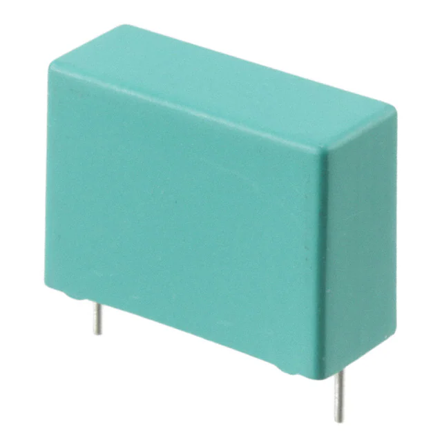

    等级:Y2 33NF ±20% 300V
PHE850EB5330MB12R17 数据手册
NOT FOR NEW DESIGN PHE850 RoHS Compliant • EMI suppressor, class Y2, metallized polypropylene •C • New, small dimensions including low profile capacitors L typical applications The capacitors are intended for use as interference suppressors in Y2 (line-toearth) applications. B Construction Winding of metallized polypropylene. Encapsulated in self-extinguishing material meeting the requirements of UL 94V-0. H 0.5 Not for use in series with the mains. See www.kemet.com for more information. ∅d p Rated voltage 300 VAC, 50/60 Hz (ENEC,UL,cUL) Capacitance range µF 0.001–1.0 Temperature range °C –55/+110 Climatic category IEC 55/110/56/B Capacitance tolerance ± 20% standard, other tolerances on request Approvals ENEC, UL, cUL Dissipation factor tanδ Maximum values at +23 °C C ≤ 0.1 µF 0.1 µF < C ≤ 1 µF 1 kHz 0.2% 0.15% 10 kHz 0.3% 0.4% 100 kHz 0.6% – p d l b Technical data std l max l 10.0 ± 0.4 0.6 17 15.0 ± 0.4 0.6/0.8* 17 22.5 ± 0.4 0.8 6 27.5 ± 0.4 0.8 6 37.5 ± 0.5 1.0 6 30 30 30 30 30 b ±0.4 ±0.4 ±0.4 ±0.4 ±0.7 * Size 7.5 x 14.5 x 18.0 and bigger, d = 0.8 mm. Tolerance in lead length < 30 mm +0 mm –1 C > 1 µF 0.1% 0.8% – 30 mm Insulation resistance C ≤ 0.33 µF: ≥ 30 000 MΩ C > 0.33 µF: ≥ 10 000 s Resonance frequency Tabulated self-resonance frequencies f0 refer to 5 mm lead lengths. Test voltage between terminals The 100% screening factory test is carried out at 5000 VDC and 2500 VAC. The voltage level is selected to meet the requirements in applicable equipment standards. All electrical characteristics are checked after the test. In DC applications Recommended voltage: ≤ 1250 VDC +5 –0 mm Environmental test data Endurance EN/IEC 60384-14:2005 Vibration IEC 60068-2-6, Test Fc 3 directions at 2 hour each, 10 – 55 Hz at 0.75 mm or 98 m/s2 No visible damage, No open or short circuit Bump IEC 60068-2-29, Test Eb 1000 bumps at 390 m/s2 No visible damage, No open or short circuit Change of temperature IEC 60068–2–14 Test Na 1.7 x UR VAC 50 Hz, once every hour increased to 1000 VAC for 0.1 s, 1000 h at upper rated temperature Upper and lower rated temperature 5 cycles Active flammability EN/IEC 60384-14:2005 Passive flammability EN/IEC 60384-14:2005 Humidity IEC 60068-2-3, Test Ca +40°C and 90 – 95% R.H. No visible damage 56 days NOT FOR NEW DESIGN PHE850 article table Capaci- Box Max dimensions Max tance code in mm fO dU/dt Article code µF B H L MHz V/µs Capaci- Box Max dimensions Max tance code in mm fO dU/dt Article code µF B H L MHz V/µs lead spacing 10 mm 0.0010 A06 0.0012 A06 0.0015 A01 0.0018 A01 0.0022 A01 0.0027 A02 0.0033 A02 0.0039 A03 0.0047 A03 0.0056 A04 0.0068 A04 0.0068 A05 4.0 4.0 4.0 4.0 4.0 4.5 4.5 5.0 5.0 6.0 6.0 9.5 8.0 8.0 9.0 9.0 9.0 10.5 10.5 11.0 11.0 12.0 12.0 7.5 13.0 13.0 13.0 13.0 13.0 13.0 13.0 13.0 13.0 13.0 13.0 1 3.0 50 45 43 40 36 34 31 29 26 23 20 21 100 100 100 100 100 100 100 100 100 100 100 100 PHE850EA4100MA06R17 PHE850EA4120MA06R17 PHE850EA4150MA01R17 PHE850EA4180MA01R17 PHE850EA4220MA01R17 PHE850EA4270MA02R17 PHE850EA4330MA02R17 PHE850EA4390MA03R17 PHE850EA4470MA03R17 PHE850EA4560MA04R17 PHE850EA4680MA04R17 PHE850EP4680MA05R17 Lead spacing 22.5 mm 0.033 0.039 0.047 0.056 0.068 0.082 0.10 0.12 0.15 0.18 0.22 D13 6.5 D13 6.5 D13 6.5 D17 7.0 D17 7.0 D15 9.0 D18 10.5 D18 10.5 D16 11.0 D20 13.5 D20 13.5 4.5 1 14.5 14.5 16.5 16.5 18.5 19.0 19.0 21.5 23.0 23.0 2 6.0 2 6.0 2 6.0 26.0 26.0 2 6.0 2 6.0 26.0 26.0 26.0 26.0 5.7 5.4 5.0 4.7 4.3 4.0 3.6 3.3 2.8 2.5 2.3 100 100 100 100 100 100 100 100 100 100 100 PHE850ED5330MD13R06L2 PHE850ED5390MD13R06L2 PHE850ED5470MD13R06L2 PHE850ED5560MD17R06L2 PHE850ED5680MD17R06L2 PHE850ED5820MD15R06L2 PHE850ED6100MD18R06L2 PHE850ED6120MD18R06L2 PHE850ED6150MD16R06L2 PHE850ED6180MD20R06L2 PHE850ED6220MD20R06L2 Lead spacing 27.5 mm Lead spacing 15 mm 0.0068 B04 5.5 0.0082 B04 5.5 0.010 B04 5.5 0.012 B05 5.5 0.015 B15 6.0 0.018 B10 6.5 0.022 B06 7.5 0.027 B06 7.5 0.033 B12 8.0 0.039 B11 8.5 0.047 B14 9.5 0.047 B17 13.0 0.056 B16 11.0 0.068 B16 11.0 0.5 1 10.5 10.5 12.5 12.0 12.5 14.5 14.5 15.0 16.0 17.5 12.5 19.0 19.0 1 8.0 1 8.0 1 8.0 1 8.0 1 8.0 18.0 18.0 18.0 18.0 18.0 18.0 1 8.0 18.0 18.0 14 14 13 12 11 10 9.5 8.6 7.8 7.0 6.3 6.3 5.5 4.7 100 100 100 100 100 100 100 100 100 100 100 100 100 100 PHE850EB4680MB04R17 PHE850EB4820MB04R17 PHE850EB5100MB04R17 PHE850EB5120MB05R17 PHE850EB5150MB15R17 PHE850EB5180MB10R17 PHE850EB5220MB06R17 PHE850EB5270MB06R17 PHE850EB5330MB12R17 PHE850EB5390MB11R17 PHE850EB5470MB14R17 PHE850EH5470MB17R17 PHE850EB5560MB16R17 PHE850EB5680MB16R17 0.15 0.15 0.18 0.22 0.27 0.33 0.39 0.47 0.47 0.56 0.68 ENEC EN/IEC 60384-14:2013 UL UL 60384-14 CAN/CSA-E60384-14:09 20.5 12.5 20.5 22.5 23.0 24.5 28.0 28.0 16.0 30.0 30.0 31.5 31.5 31.5 3 1.5 31.5 31.5 31.5 31.5 3 1.5 31.5 31.5 2.4 2.4 2.2 2.1 1.9 1.7 1.6 1.4 1.5 1.3 1.2 100 100 100 100 100 100 100 100 100 100 100 PHE850EF6150MF11R06L2 PHE850ET6150MF17R06L2 PHE850EF6180MF11R06L2 PHE850EF6220MF12R06L2 PHE850EF6270MF03R06L2 PHE850EF6330MF13R06L2 PHE850EF6390MF14R06L2 PHE850EF6470MF14R06L2 PHE850ET6470MF19R06L2 PHE850EF6560MF16R06L2 PHE850EZ6680MF16R06L2 * Lead spacing 37.5 mm 0.33 R05 13.0 24.0 0.39 R05 13.0 24.0 0.47 R05 13.0 24.0 0.56 R04 15.0 26.0 0.68 R02 16.5 32.0 0.82 R02 16.5 32.0 1.0 R03 19.0 36.0 1.2 R06 21.0 38.0 1.5 R06 21.0 38.0 1.8 R08 28.0 43.0 2.2 R08 28.0 43.0 * Only ± ��������������� 20% tolerance 41.0 41.0 41.0 41.0 41.0 41.0 41.0 41.0 41.0 41.0 41.0 1.2 1.1 1.1 1.0 0.94 0.88 0.81 0.74 0.66 0.58 0.54 100 PHE850Er6330mR05R06L2 100 PHE850Er6390mR05R06L2 100 PHE850Er6470mR05R06L2 100 PHE850Er6560mR04R06L2 100 PHE850ER6680MR02R06L2 100 PHE850ER6820MR02R06L2 100 PHE850ER7100MR03R06L2 100 PHE850ER7120MR06R06L2 100 PHE850EW7150MR06R06L2 * 100 PHE850ER7180MR08R06L2 100 PHE850ER7220MR08R06L2 Marking Approvals Certification Body Specification F11 10.5 F17 21.0 F11 10.5 F12 11.5 F03 13.5 F13 14.5 F14 17.5 F14 17.5 F19 27.5 F16 21.0 F16 21.0 • • • • • • • • • • RIFA RIFA article code Rated capacitance Capacitance tolerance code Rated voltage Y2 Approval marks IEC Climatic category Passive flammability class Manufacturing date code oRdERing inFoRmation The article code for the standard part is given in the article table. Statements of suitability for certain applications are based on our knowledge of typical operating conditions for such applications, but are not intended to constitute – and we specifically disclaim – any warranty concerning suitability for a specific customer application or use. This Information is intended for use only by customers who have the requisite experience and capability to determine the correct products for their application. Any technical advice inferred from this Information or otherwise provided by us with reference to the use of our products is given gratis, and we assume no obligation or liability for the advice given or results obtained.
